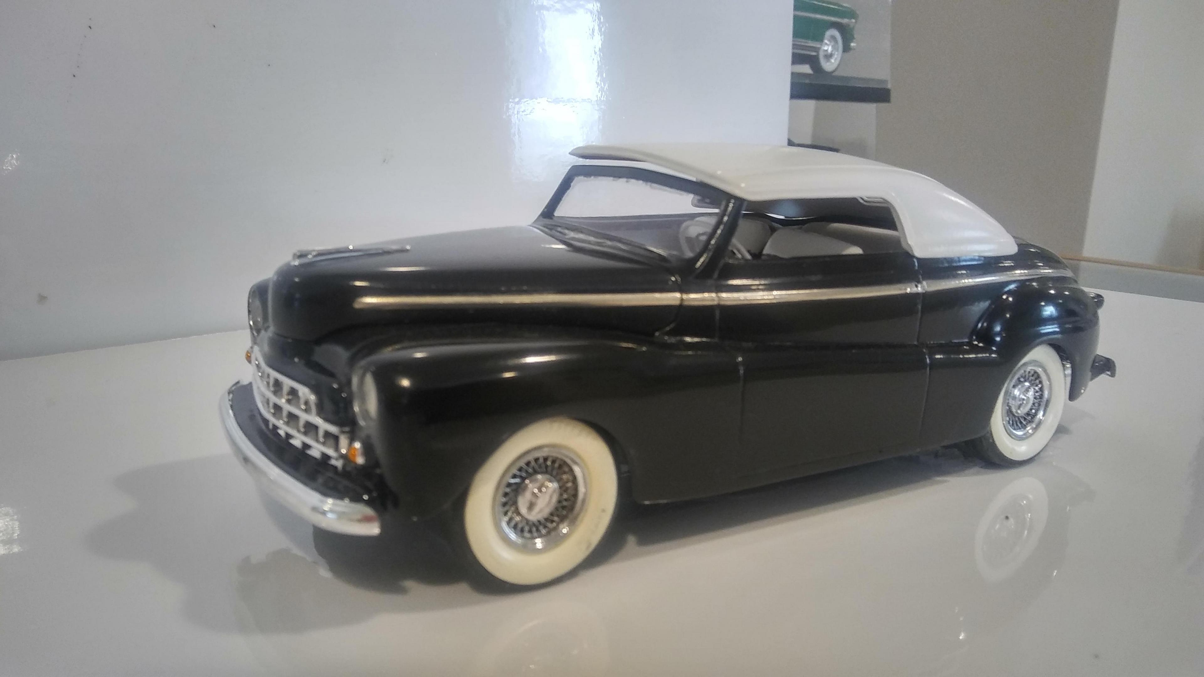

Chuckyg1 Posted July 3, 2020 Posted July 3, 2020 I've had success with Rustoleum paint/primer. It too is better when polished. Here it is on a 48 ford custom over plastikote gray primer.
