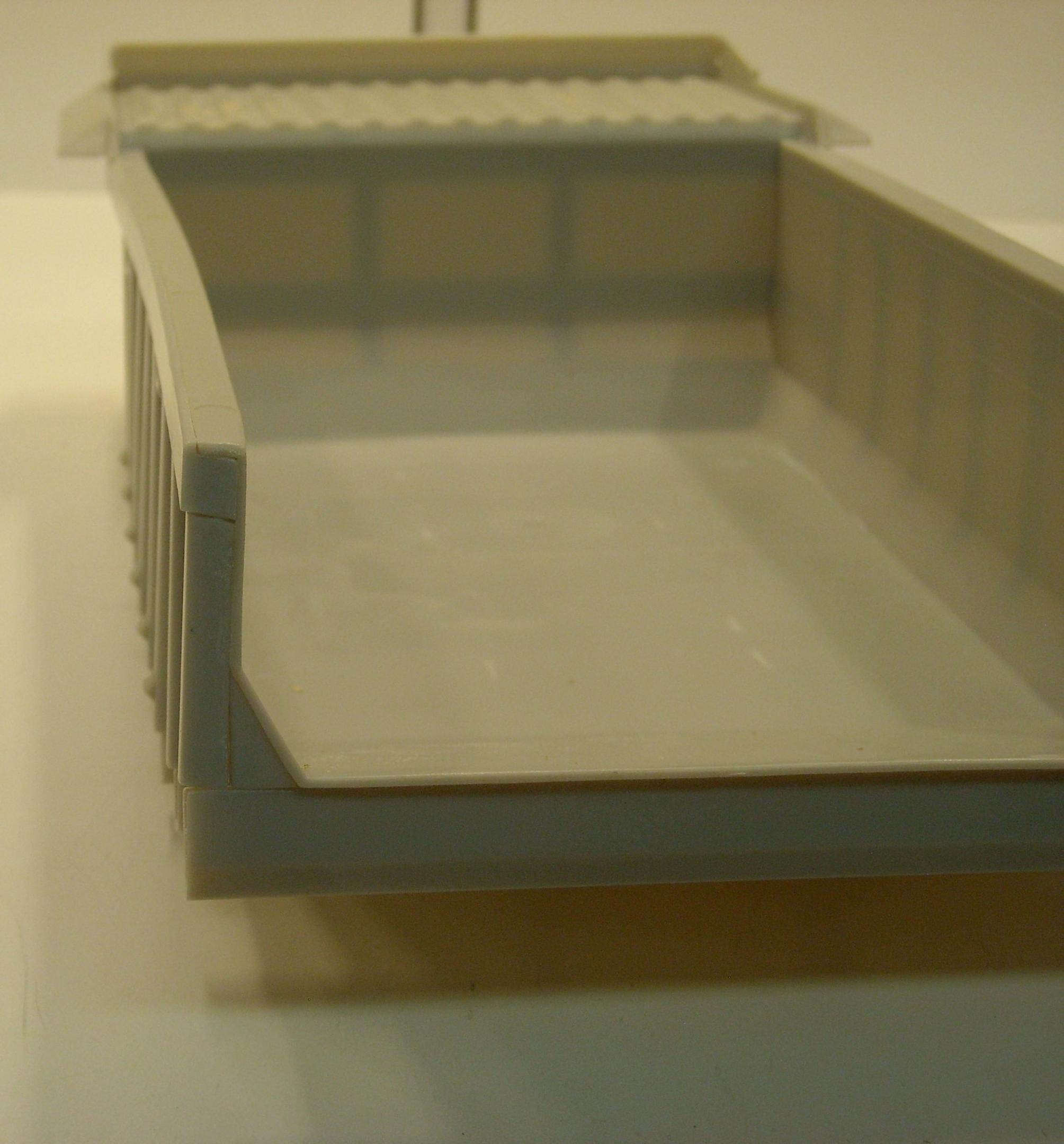

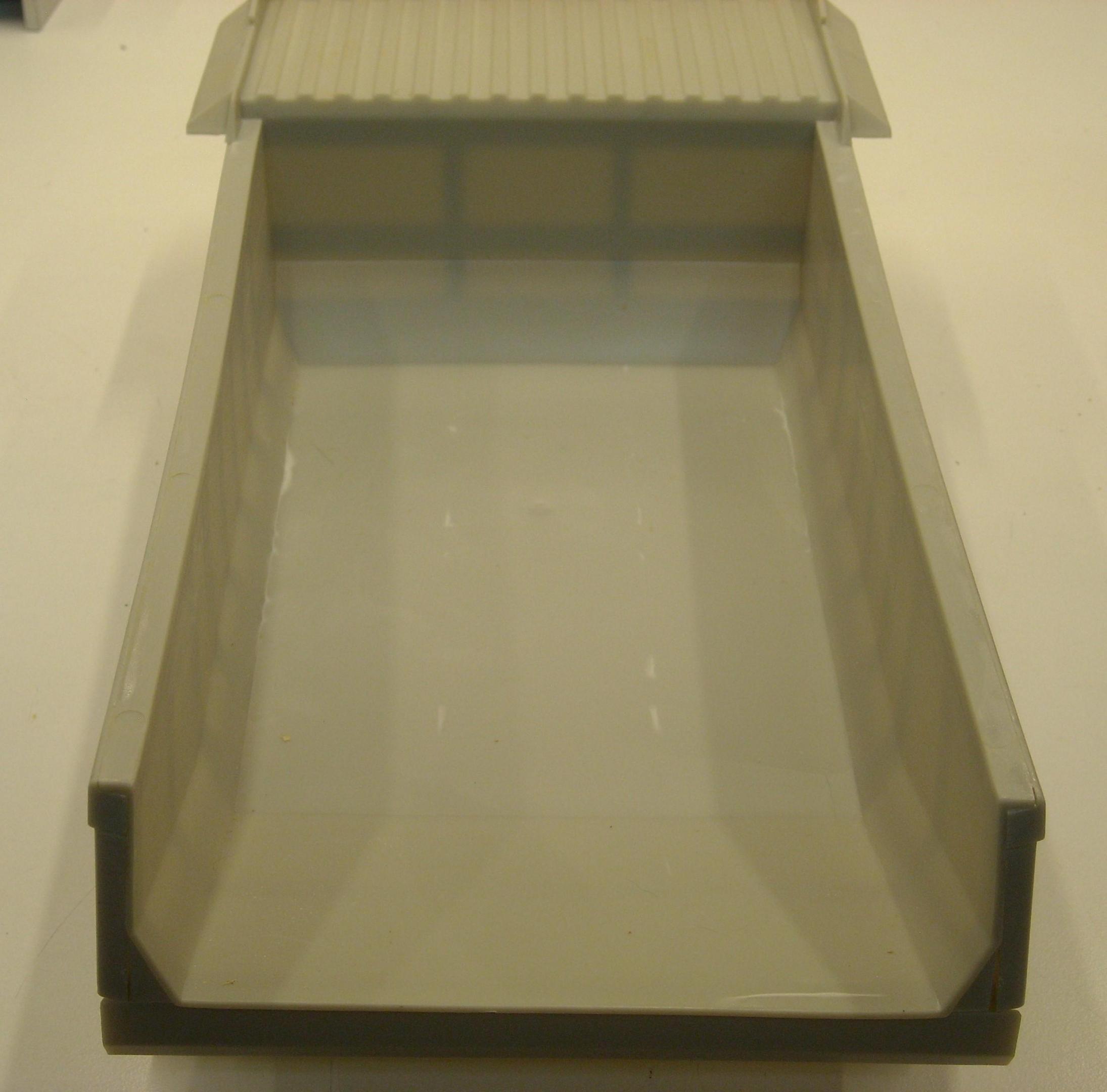

Kit Basher Posted July 6, 2020 Posted July 6, 2020 (edited) I'm working on the AMT Payhauler 350. The dump bed is badly warped. I've attached most of the bracing to it, holding it in the proper shape while doing so. I had hoped the bracing might correct the warp. No such luck. Is there any way to permanently correct the warp? I've heard about using hot water, but I have no idea about temperature or duration. Any advice would be greatly appreciated. I'm adding some photos to show my problem. Originally, the bed floor was humped up. By clamping the floor flat as I added the bottom braces, I was able to pretty much fix that problem, although those bottom braces are still under some stress. The result of flattening the bottom was to pull the sides in, as you can see in the photos. The side braces did not correct that problem. The side braces are not 100% glued, and with clamping and gluing might help to straighten the sides, but those braces would also be under some stress. I am hoping to remove that stress. Edited July 6, 2020 by Kit Basher

Kit Basher Posted July 6, 2020 Author Posted July 6, 2020 4 hours ago, gman said: It isn't an exact science, but worth a shot. You'll have to bend it beyond true, hold it for a while. The idea is to heat it to the point it takes the stresses and warp out of the plastic, and hold it there until it cools enough to hold its new and improved shape. Most kit parts warp because they have been taken out of the mold and packed too soon (with some kit contents virtually being crammed into the box)- when they cool, rather than taking the shape they were molded in, their shape becomes distorted. There is a good chance only a portion of the part has taken on a warp, and that is exactly the area you'll want to concentrate on with hot water and reshaping. Posting some pictures may illustrate the magnitude of the problem with your parts. I've added some photos to my original post to show what I'm up against. I think you are right about the cause of the warp. One of the sprues is also badly warped, but the parts are still usable.

gman Posted July 7, 2020 Posted July 7, 2020 Heat up the worst of the warped area, plus a good margin on either side. Apply pressure to the area marked by the arrow, pushing it outward at least the same distance as the warp is inwards. Hold it in that position for a while until it cools, or speed it up by running cold water over it while you hold it beyond the desired position. That looks like something that can be corrected, though it may take a few tries. If the plastic lightens while you push the warped area outwards, that is a sign it isn't hot enough to make the plastic malleable enough to be un-warped. A hair dryer is another method (as mentioned), but a heat gun would probably be too much.
