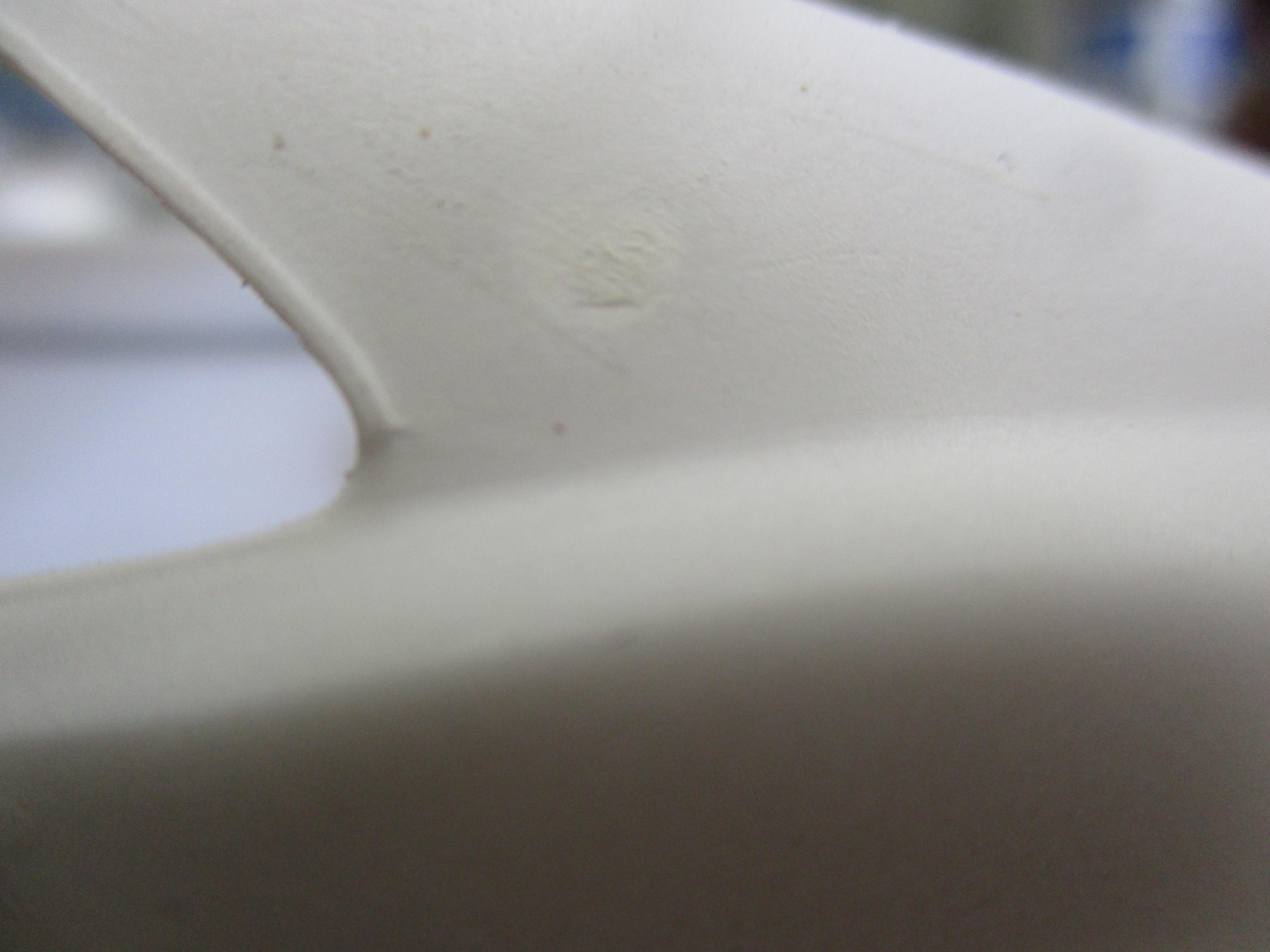

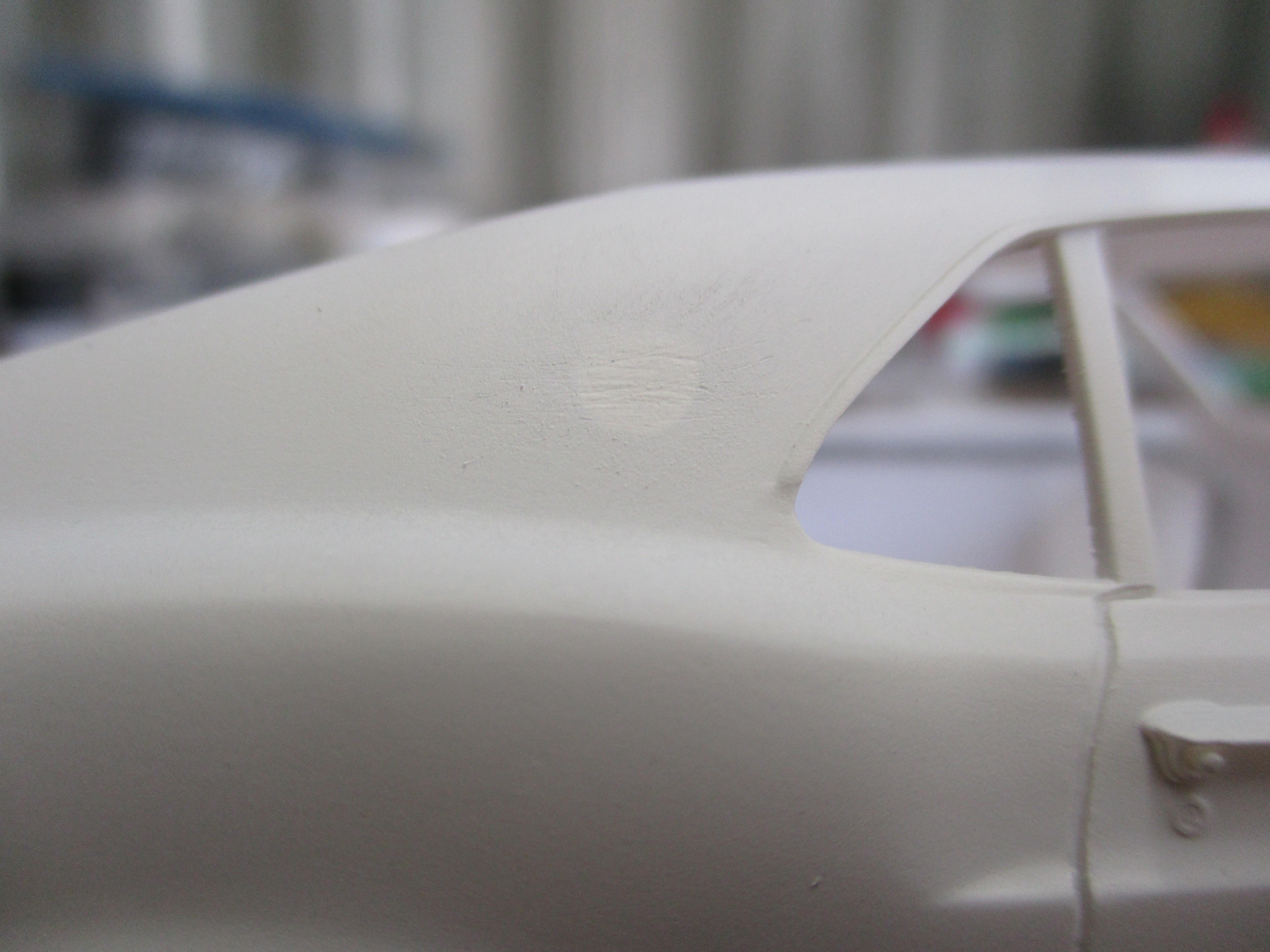

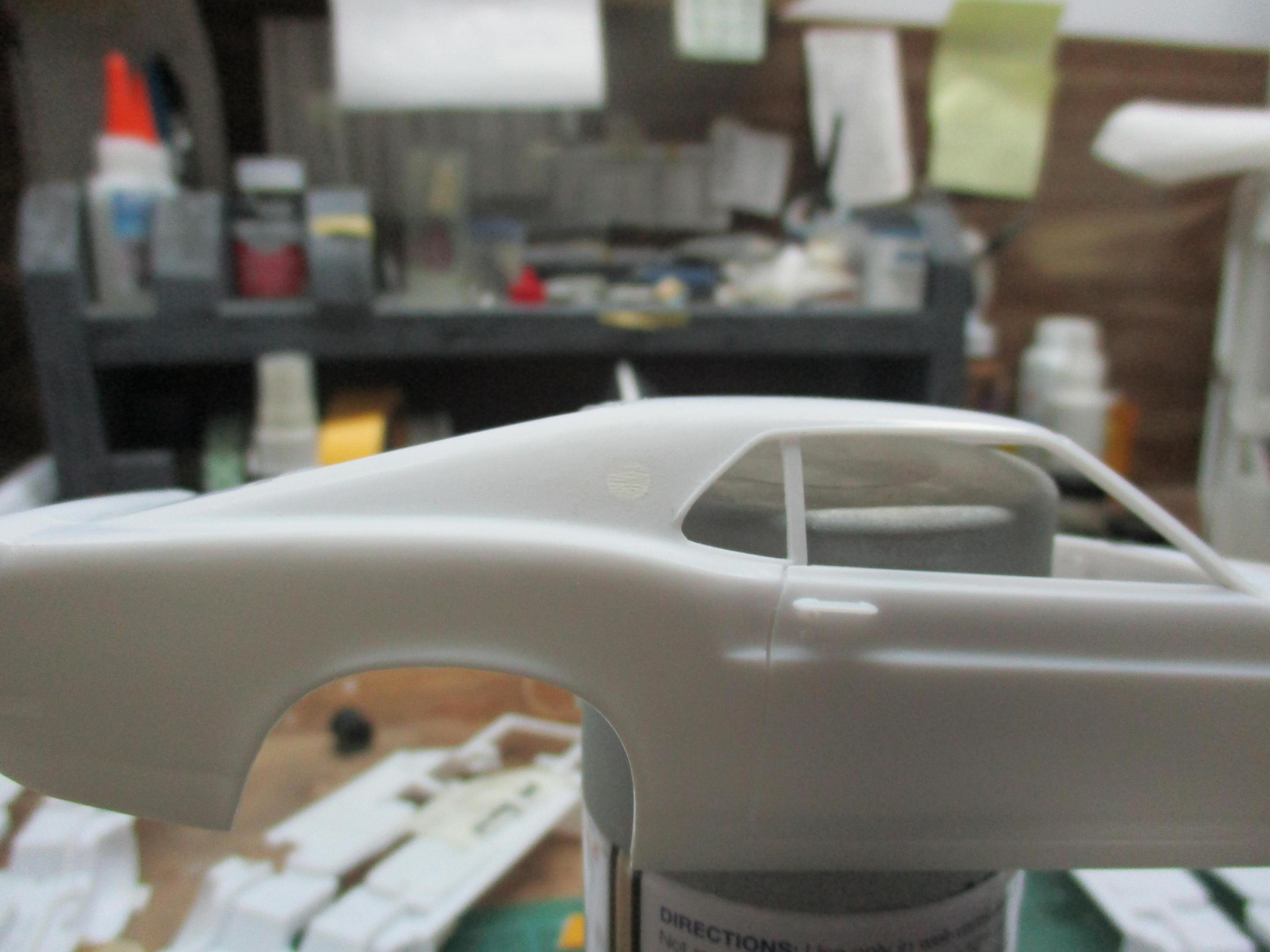

porschercr Posted July 11, 2020 Author Posted July 11, 2020 (edited) Primed the body on the '69 Boss 302, with Dupli-Color, still have putty showing through. Suggestions? Edited July 11, 2020 by porschercr Added text
espo Posted July 12, 2020 Posted July 12, 2020 The picture looks as if the area was rough sanded but not sanded smooth with a high # sand paper. I would use an old #11 blade and put a smooth layer of putty, just enough to fill the scratches. After it has dried go over the area with a sanding pad in the 1500 to 1800 range. I would try sanding at two different directions to help eliminate scratches and use very light pressure letting the sanding pads do the work. Another light coat of primer should tell you if you're getting to the finish you want.
64SS350 Posted July 12, 2020 Posted July 12, 2020 Not sure how the Tamiya handles it, but with regular putty, I will put a light coat of THIN CA glue to seal the area. Then sand with fine sandpaper.
STYRENE-SURFER Posted July 12, 2020 Posted July 12, 2020 These Lacquer based puttys are my least favorite. It does look like from those pic's that you need one more application and follow through with finer grit sandpaper. you are nearly there, 1 hour ago, 64SS350 said: Not sure how the Tamiya handles it, but with regular putty, I will put a light coat of THIN CA glue to seal the area. Then sand with fine sandpaper. A lick of thin CA glue is good recommendation.
porschercr Posted July 12, 2020 Author Posted July 12, 2020 (edited) 4 hours ago, espo said: The picture looks as if the area was rough sanded but not sanded smooth with a high # sand paper. I would use an old #11 blade and put a smooth layer of putty, just enough to fill the scratches. After it has dried go over the area with a sanding pad in the 1500 to 1800 range. I would try sanding at two different directions to help eliminate scratches and use very light pressure letting the sanding pads do the work. Another light coat of primer should tell you if you're getting to the finish you want. Edited July 12, 2020 by porschercr
porschercr Posted July 12, 2020 Author Posted July 12, 2020 The peimer was a bit "dry" when I did it. Thanks for the suggestions...
doorsovdoon Posted July 13, 2020 Posted July 13, 2020 Regular car body filler works for me. You can also use a finishing product called "stopper" for fine pin holes.
Rocking Rodney Rat Posted July 14, 2020 Posted July 14, 2020 Trying to fill large areas with putty is most likley not going to give you results you want. On the Mustang above, I would suggest cutting out a thin piece of styrene to fill that area, glue it in with super glue and sand down to level it out, you might need to glue and sand down a couple of times.Then a bit of putty to fill in any remaining bits that the piece of styrene didn't fill in and you're good to go. Putty shrinks, especially over time. What might look good initially, will eventually cave in after some time. Putty is good for small fixes but I don't like using it to fill in. Covering up door/trunk/boot/bonnet/hood scribe lines, slice a thin piece of styrene, glue it into the seam and sand form there, a skosh of putty to take care of nooks and crannies.... My $.02, ya get what ya pay for.... -RRR
porschercr Posted July 14, 2020 Author Posted July 14, 2020 1 hour ago, Rocking Rodney Rat said: Trying to fill large areas with putty is most likley not going to give you results you want. On the Mustang above, I would suggest cutting out a thin piece of styrene to fill that area, glue it in with super glue and sand down to level it out, you might need to glue and sand down a couple of times.Then a bit of putty to fill in any remaining bits that the piece of styrene didn't fill in and you're good to go. Putty shrinks, especially over time. What might look good initially, will eventually cave in after some time. Putty is good for small fixes but I don't like using it to fill in. Covering up door/trunk/boot/bonnet/hood scribe lines, slice a thin piece of styrene, glue it into the seam and sand form there, a skosh of putty to take care of nooks and crannies.... My $.02, ya get what ya pay for.... -RRR Thanks RRR, Appreciate the advice.
