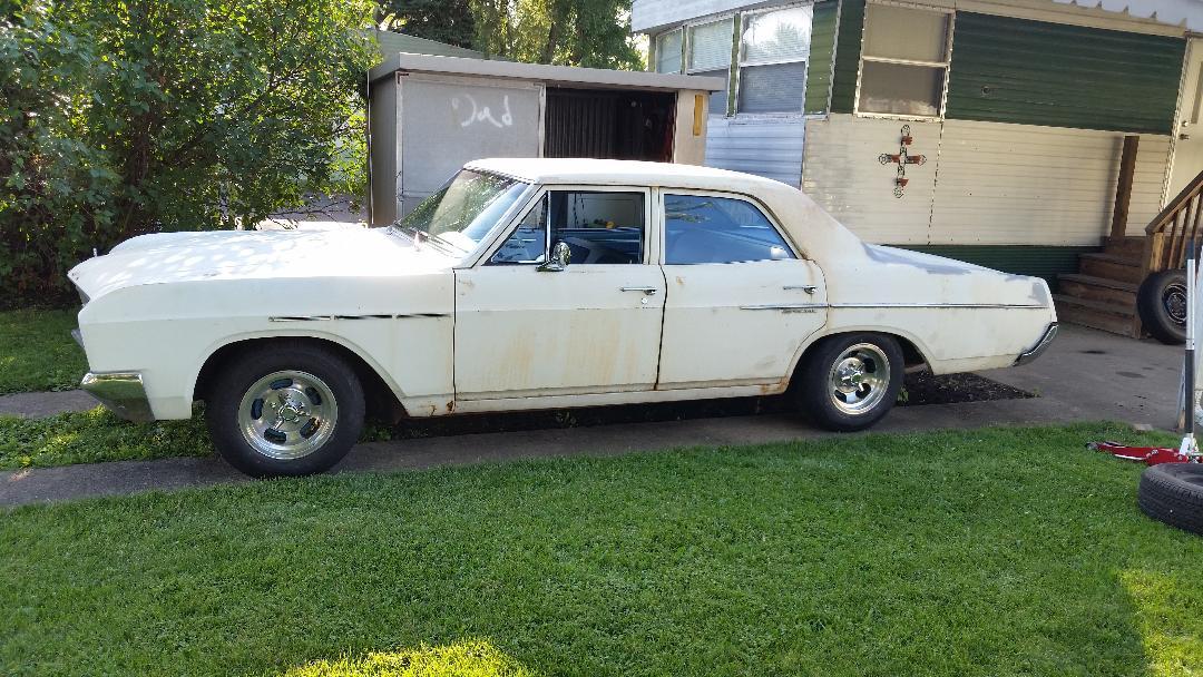

OldTrucker Posted July 12, 2020 Posted July 12, 2020 Need to roll one wheel well lip and do rear springs and shocks. Still trying to get my head wrapped around how to tune this odd fire 225 V6!
Tom Geiger Posted July 12, 2020 Posted July 12, 2020 (edited) Wheels look good! BTW, your V6 is in the Jeepster / Commando kit! Edited July 12, 2020 by Tom Geiger
espo Posted July 12, 2020 Posted July 12, 2020 (edited) We used to roll the fender lips by placing a base ball bat between the tire and the fender and roll the car back and forth. Start with the handle area of the bat and work your way up to the big end. This way you're bending just a little bit with each pass. Usually this can be done without breaking the paint on the fender and no cutting needed. A good set of Hijackers would go a long way to level out the rear end. Edited July 12, 2020 by espo
OldTrucker Posted July 12, 2020 Author Posted July 12, 2020 10 minutes ago, espo said: We used to roll the fender lips by placing a base ball bat between the tire and the fender and roll the car back and forth. Start with the handle area of the bat and work your way up to the big end. This way you're bending just a little bit with each pass. Usually this can be done without breaking the paint on the fender and no cutting needed. A good set of Hijackers would go a long way to level out the rear end. I thought of that but the lip is double thickness and I'm afraid it will flare the well out if I try it. Going to use some small relief cuts and wood block and big hammer. Don't need much bareley touches the side wall on the speed bumps in the street. Also will be replacing rear springs which are very weak and new shocks. If that result isn't satisfactory then I will go to air shocks.

espo Posted July 12, 2020 Posted July 12, 2020 5 minutes ago, OldTrucker said: I thought of that but the lip is double thickness and I'm afraid it will flare the well out if I try it. Going to use some small relief cuts and wood block and big hammer. Don't need much bareley touches the side wall on the speed bumps in the street. Also will be replacing rear springs which are very weak and new shocks. If that result isn't satisfactory then I will go to air shocks. Be real careful with any type of impact from the back side as this can distort the metal. The reason we used the old base ball bat thing is that the tire will give a little bit and the bat is applying a slow rolling pressure.

espo Posted July 19, 2020 Posted July 19, 2020 15 hours ago, OldTrucker said: After new springs and shocks I no longer have a tire clearance issue! That's good. Much better than taking a chance on messing up the body panels.
