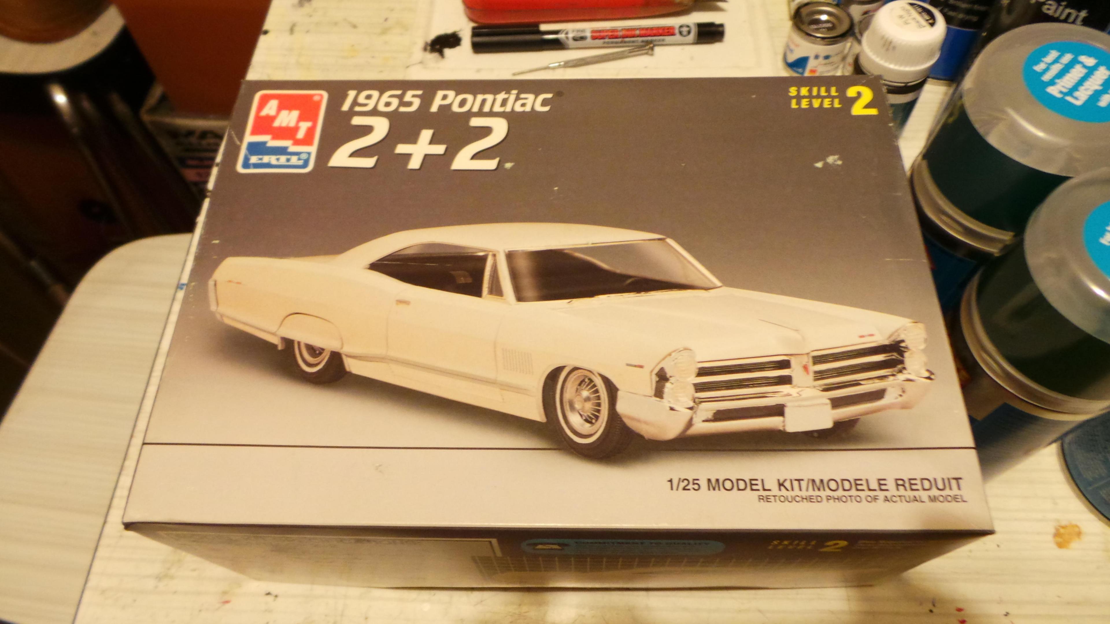

doorsovdoon Posted July 17, 2020 Posted July 17, 2020 After completing my 1970 Bonneville I've been looking for earlier models from each year to go with it. I saw this 65' 2+2 model on ebay, which was the only one listed in the UK, so I decided to buy it instead of wishing I had done when it was available! So, here we go again, haha.

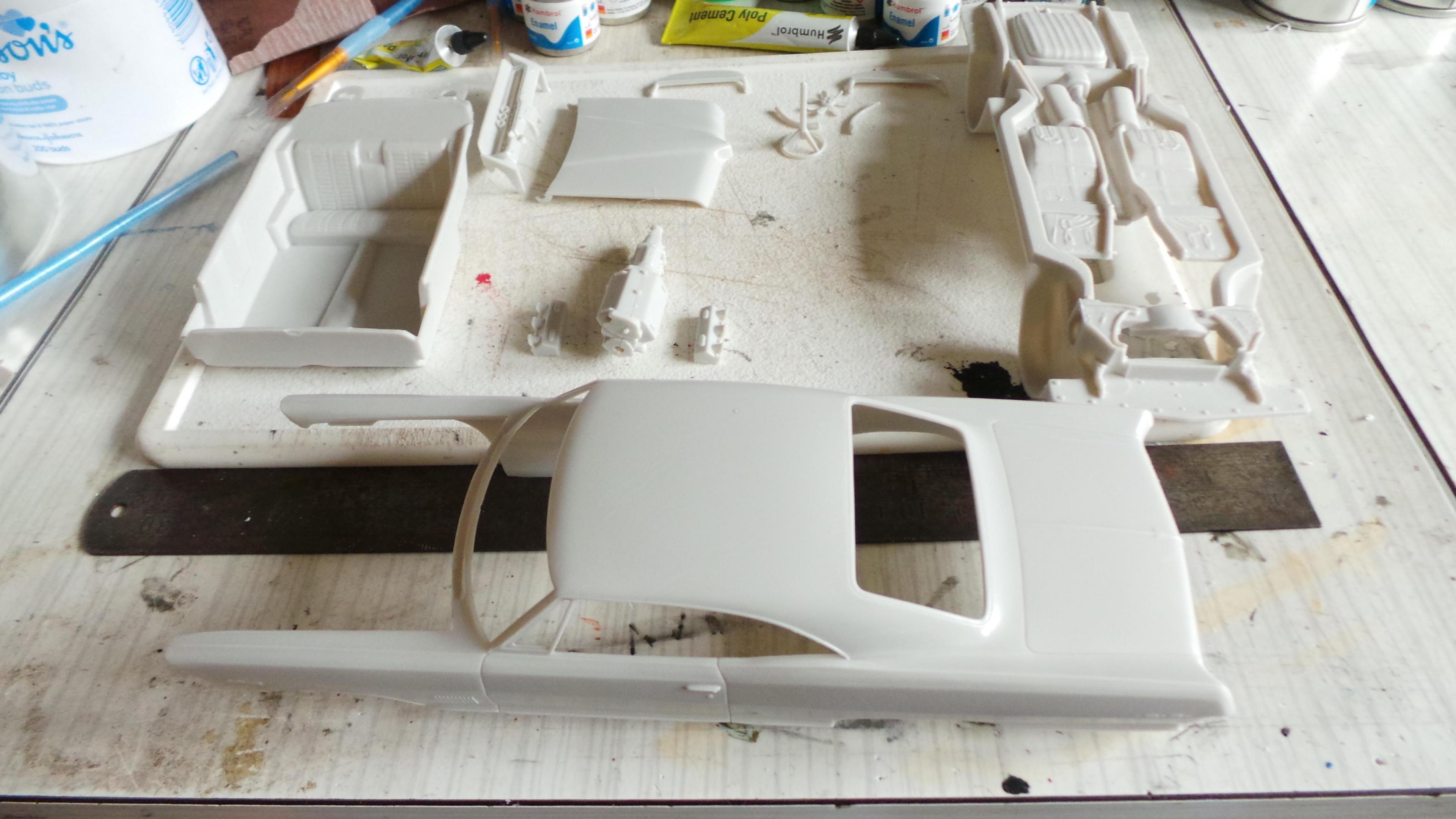

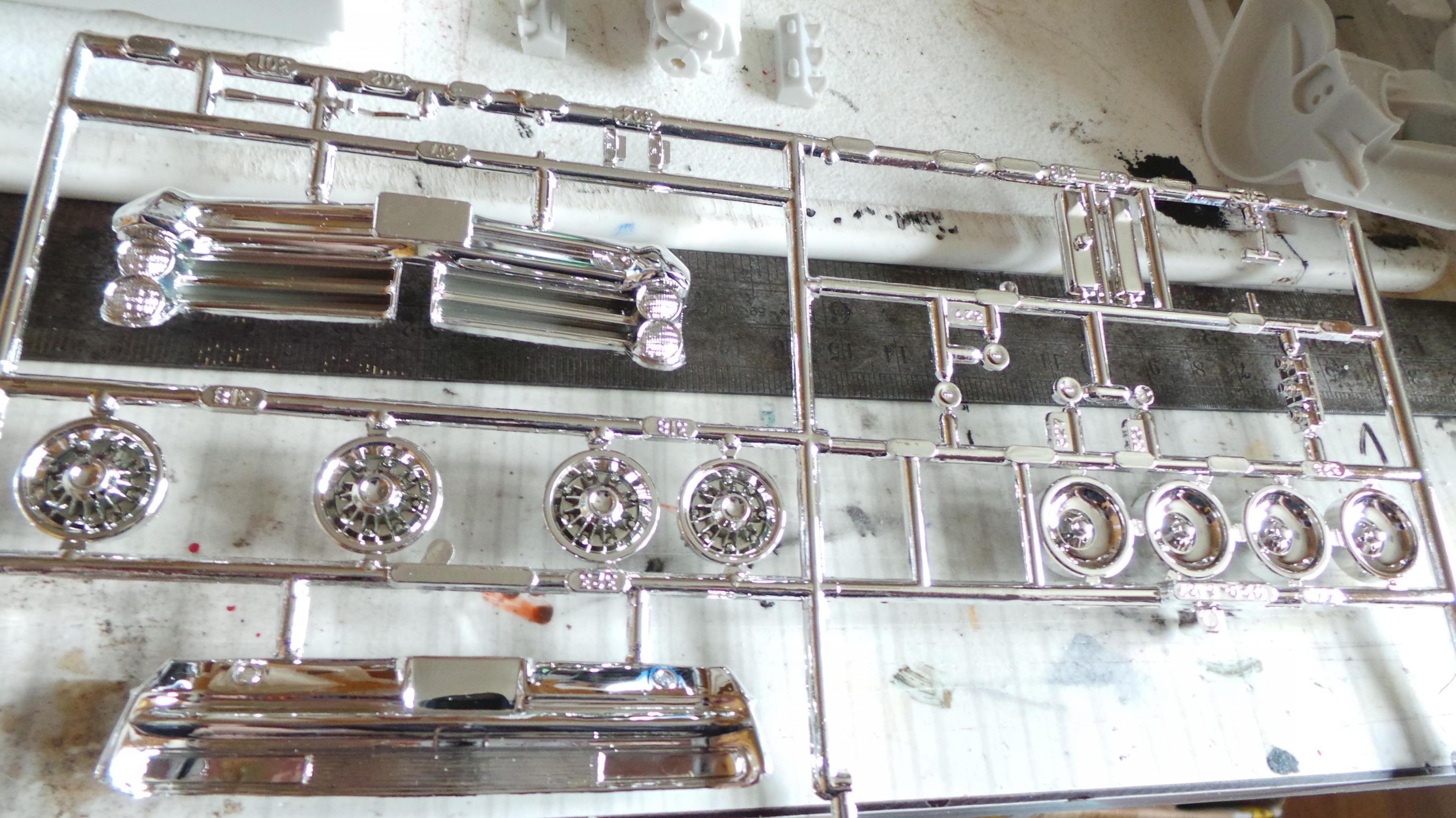

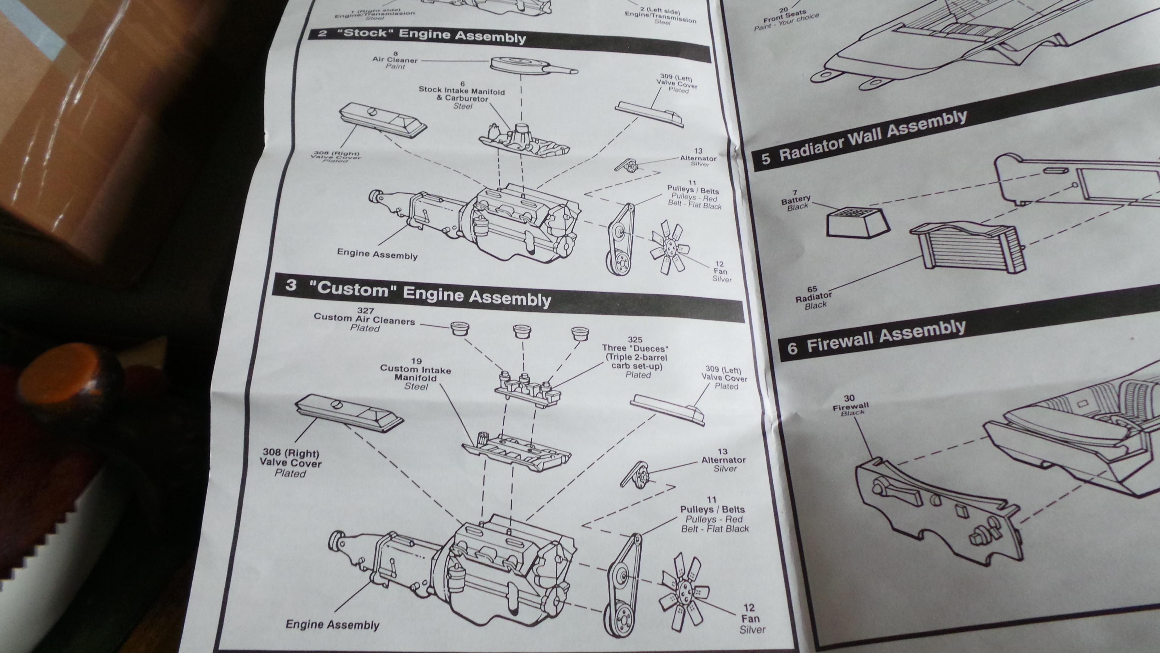

doorsovdoon Posted July 18, 2020 Author Posted July 18, 2020 Starting on the kit today and there's two choices of wheels and carb set up. The instructions say the engine, heads, and transmission are all coloured "steel" is this right? Body colours I'm thinking of are light yellow and tan roof with white interior, or just black all over with either a red, white or navy blue interior. Early days yet though, it may end being a completely different colour combo. Another idea floating in head is a convertible conversion. Suggestions always welcome:)
blunc Posted July 18, 2020 Posted July 18, 2020 pontiac engine color for that time period is like a light turquoise blue. taking the time to check fitment of the grille assembly to the front fenders will make it look better when done, reference real car pix for examples. I had a 67 Tempest, sometimes when I see builds of 66/67 GTO's, I cringe when I see the fitment of the headlights to the fenders (similar style as the 2+2).
espo Posted July 18, 2020 Posted July 18, 2020 This is going to be another great build to watch. The 2 + 2 was based on the shorter wheel base Catalina body. Think of a GTO and a Catalina as kissing cousins. The 8 lug wheels in this kit represent a unique brake upgrade that Pontiac offered until they went to disk brakes. The center section is the brake drums that was an aluminum alloy that had an iron brake drum inside. Beyond looking very nice this also added in brake cooling. The raised fins were usually a machined surface and the area in between was a little rougher as cast finish. The outer wheel was painted a silver color and the trim rigs made it look like a chromed wheel. Converting to a convertible would be little more than chopping off the top and the boot, that's what we call the material that covers the folded top, can be found in the AMT '65 Impala convertible kit. Just have to find one. Knowing that you like to stay close to an OEM look the white interior would look good on a convertible. They would have had the dash board and carpet as well as the very low portion of the door carpet all the same color. The seats and most of the side panels would be white. These could be black or many other colors were offered.

doorsovdoon Posted July 18, 2020 Author Posted July 18, 2020 Thanks, Mike. Yeah, the kit comes with the option of the triple carb set up which I prefer over the stock version, so that's happening, haha.

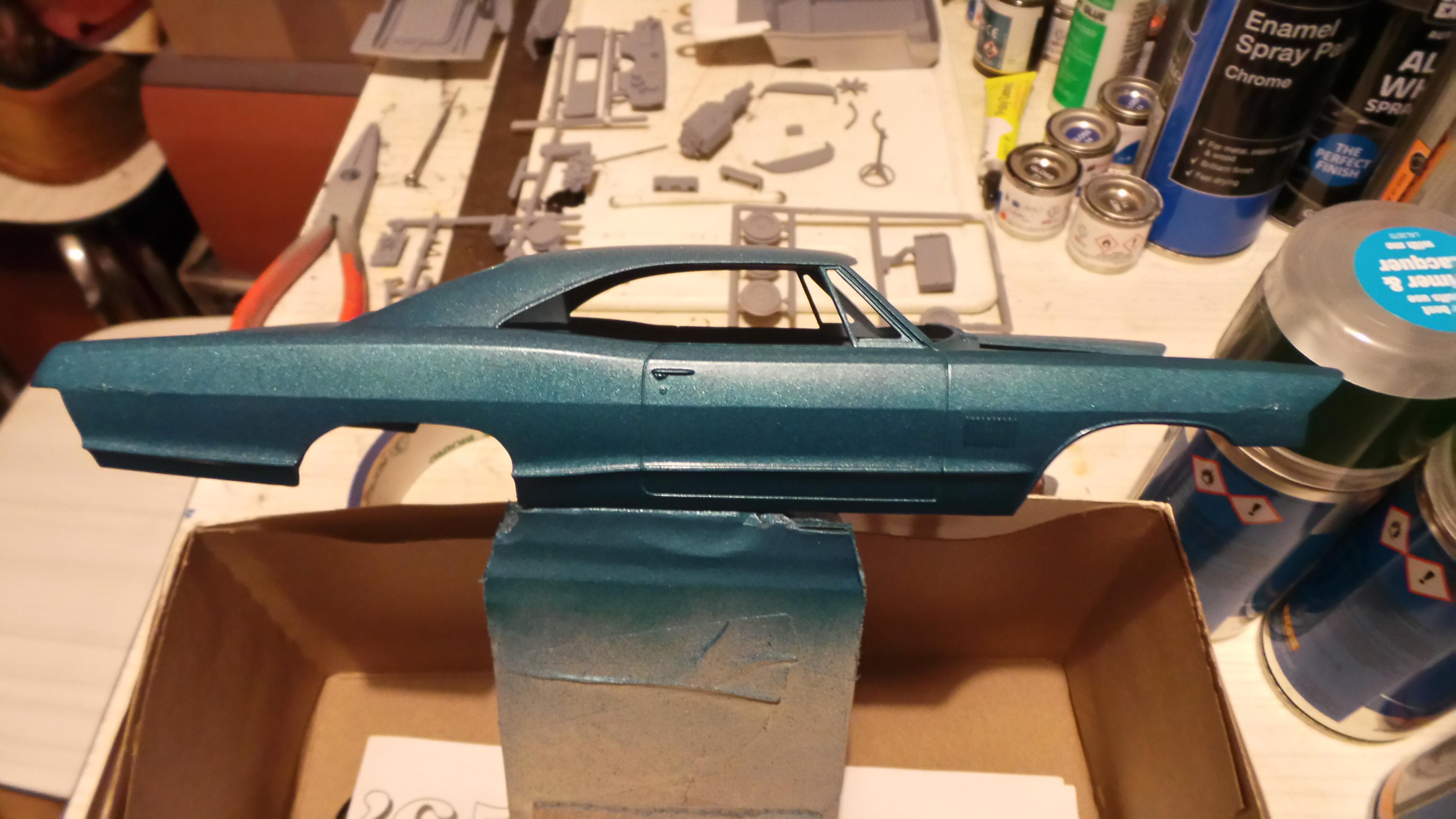

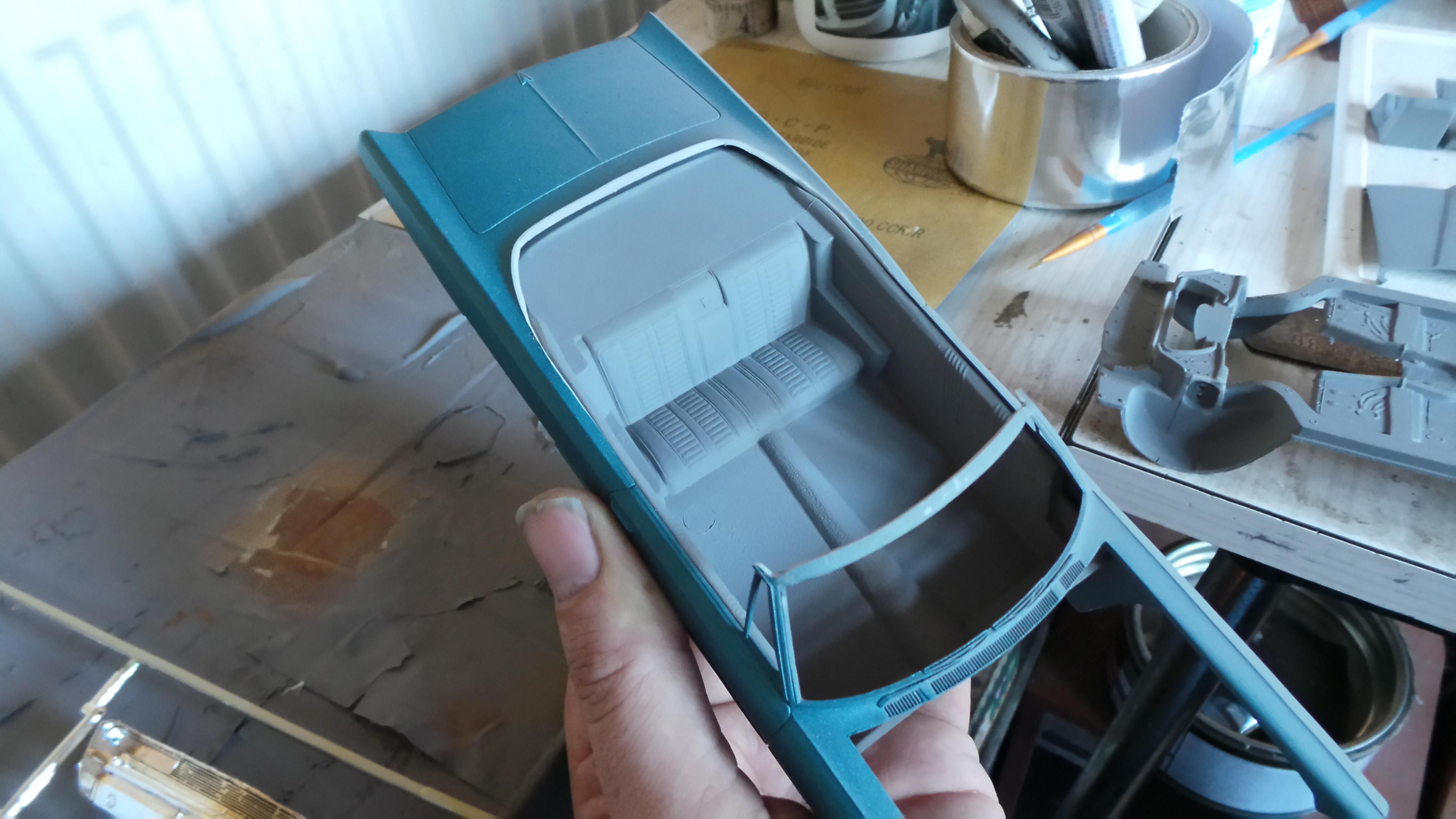

doorsovdoon Posted July 18, 2020 Author Posted July 18, 2020 I just laid a light coat of metallic blue on the car and looks really nice!, a bit of squinting and imagination and I think convertible is the way to go:) I'll take a better picture tomorrow as the camera shows it a bit dark here. Try to imagine it with a white folded top:D

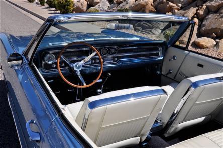

doorsovdoon Posted July 19, 2020 Author Posted July 19, 2020 I think I've decided on the interior! Came across this picture while looking for colour options. Looks stunning.

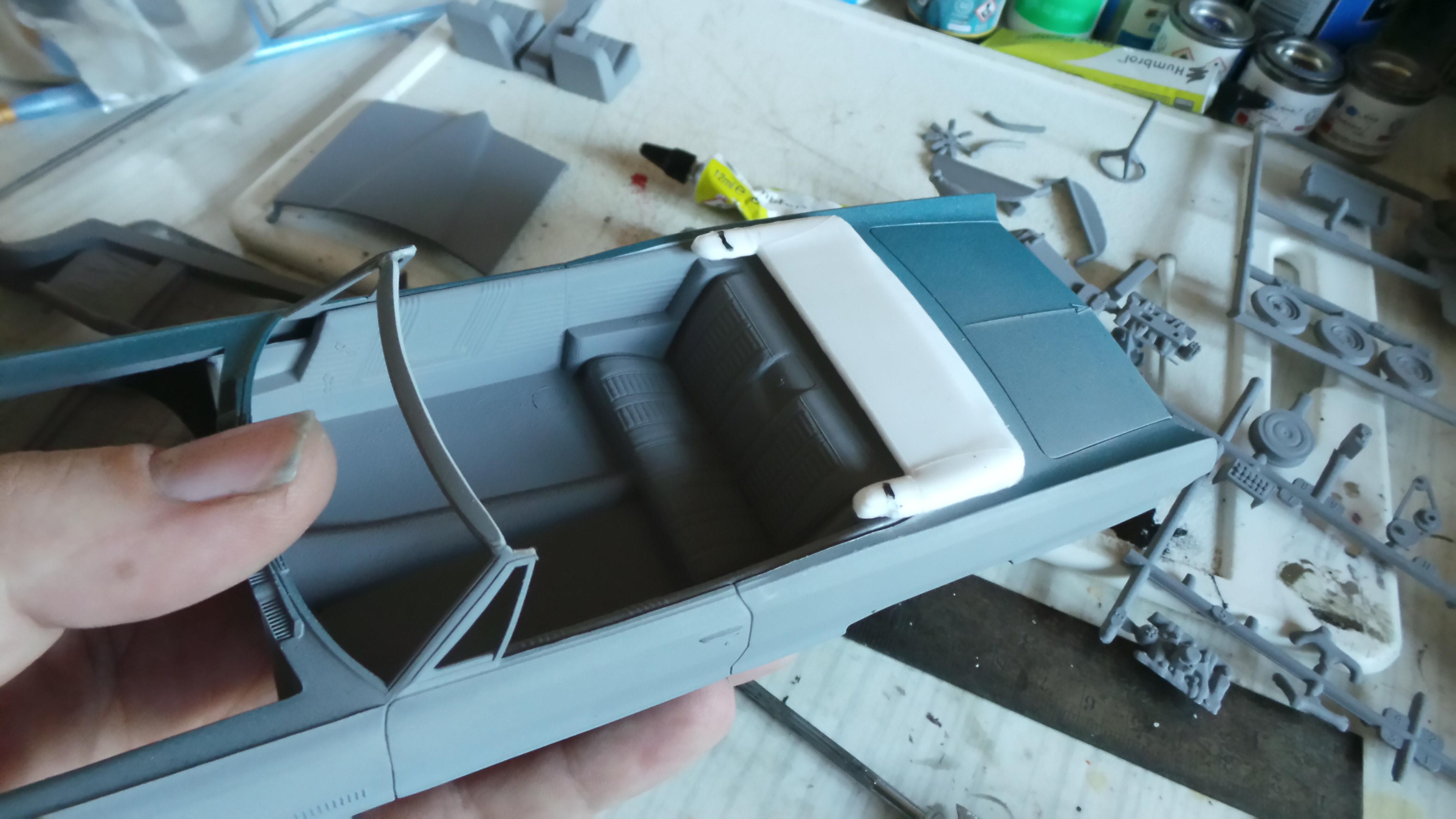

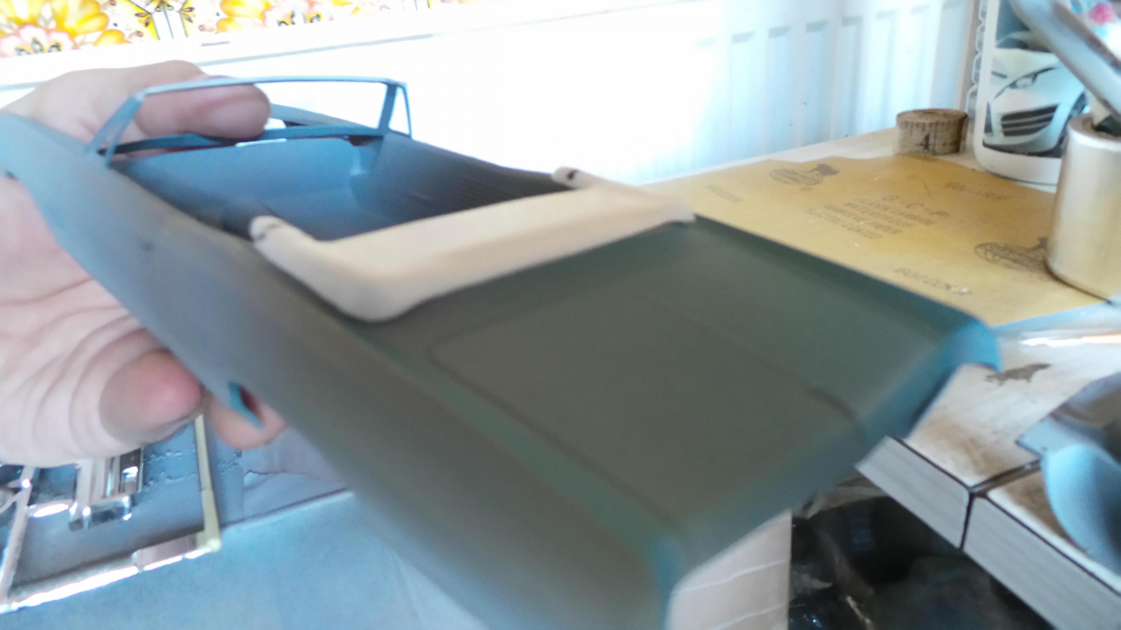

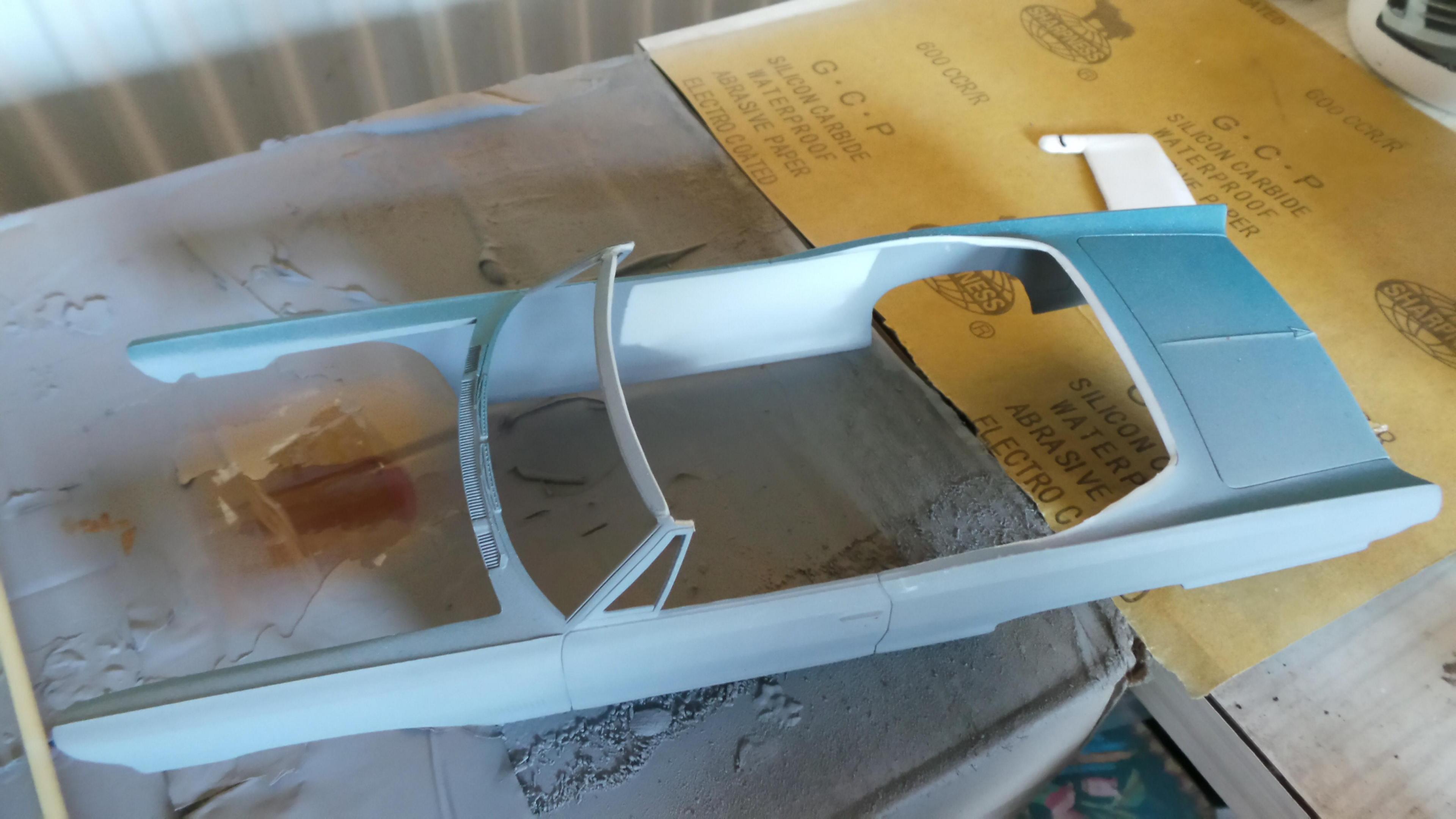

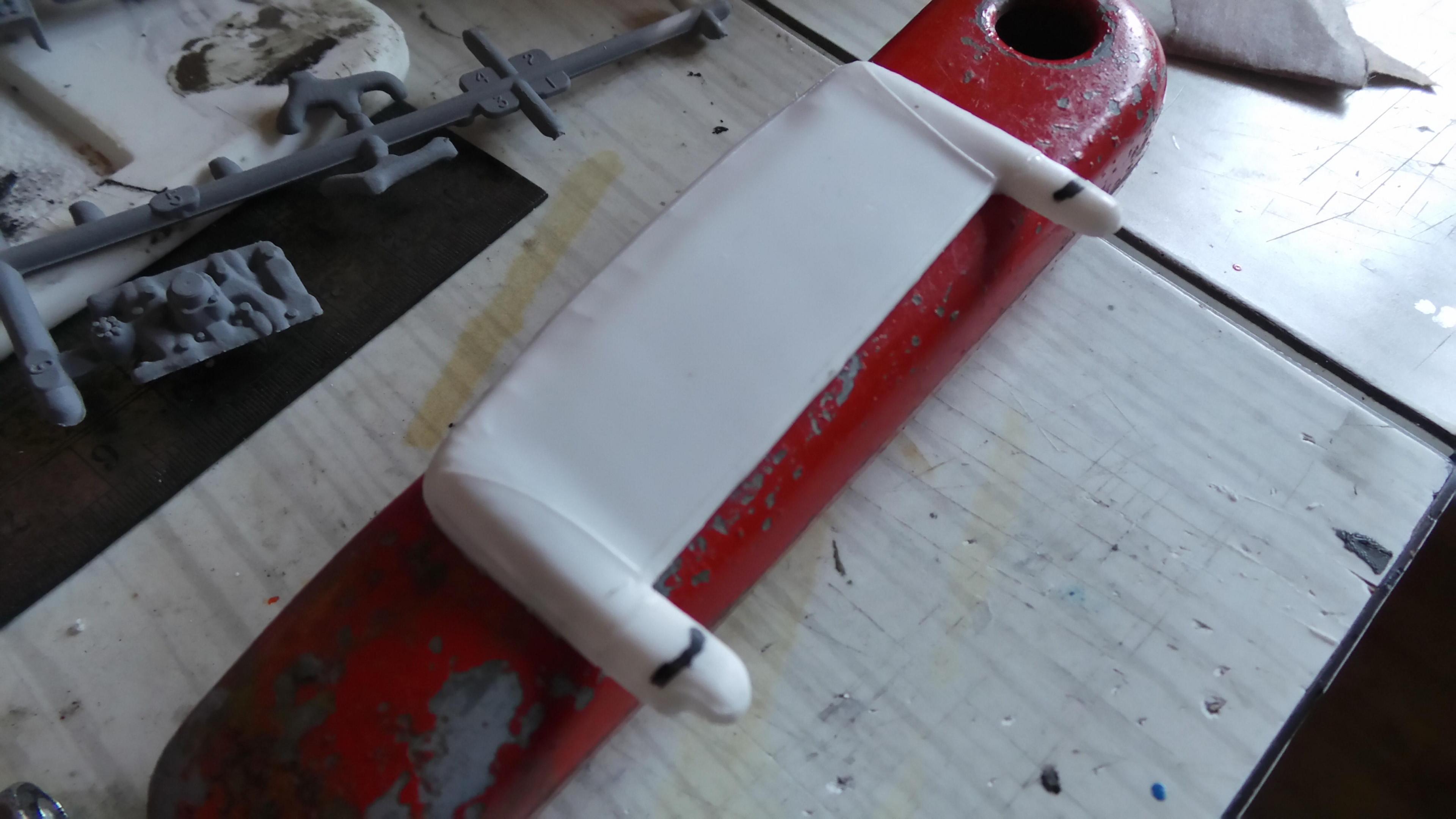

doorsovdoon Posted July 19, 2020 Author Posted July 19, 2020 No going back now! Roof is off. I'm getting everything trimmed nicely to fit right. The fold down roof is a good fit but I needed to cut back the arms, they were a bit too long. It's not the right roof for this car but it'll look good, trust me! I may need to use some filler to finish but so far it's going well. This is my first time I've got this deep into a build, I've never cut the roof off a model before so this is kind of scary for me, Lol!
Slotto Posted July 19, 2020 Posted July 19, 2020 There you go. You never know what you can do until you do it. You got this
doorsovdoon Posted July 19, 2020 Author Posted July 19, 2020 2 hours ago, Slotto said: There you go. You never know what you can do until you do it. You got this It's more involved than I thought. I think the boot/trunk is longer on the convertible.

Tom Geiger Posted July 20, 2020 Posted July 20, 2020 6 hours ago, doorsovdoon said: It's more involved than I thought. I think the boot/trunk is longer on the convertible. On some American convertibles of this era, quarter panels, tulip panel (panel between rear glass and front of boot lid) and boot lid can be different shaped parts. Also the rear seat in a convertible can be more narrow to account for the pocket on each side that the roof bows fold down into. Sometimes with models of that era, the kit manufacturer only tooled the convertible interior and put it in the hardtop version of the kit too.
