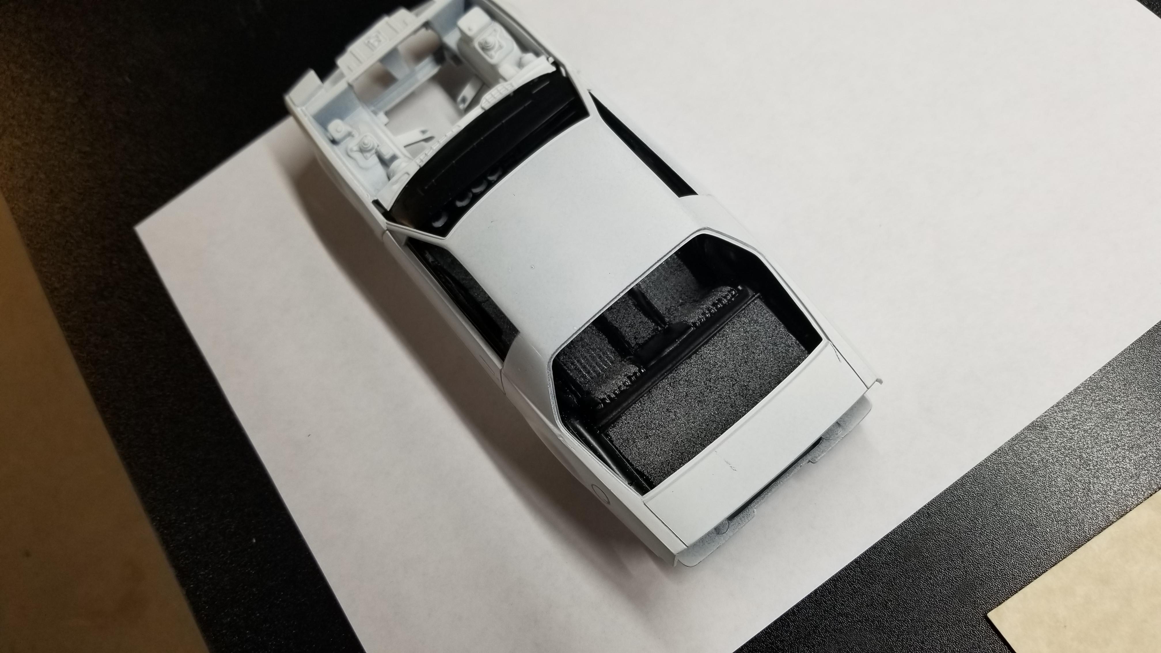

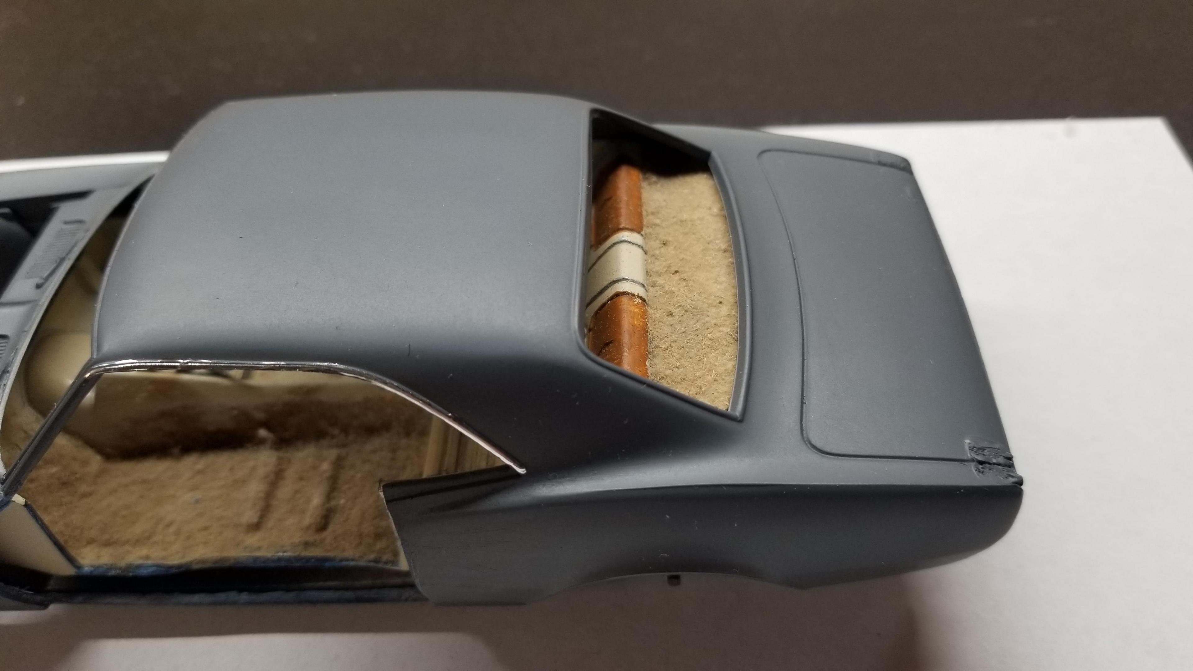

Plastic_Passion Posted July 19, 2020 Author Posted July 19, 2020 Felt...... goes without saying... cut. Paste. Carpet.... not a huge fan of this but sometimes...meh.... I did a bed carpet in this lightning . It's one of those never going to tow? Going to the show kinda rides.

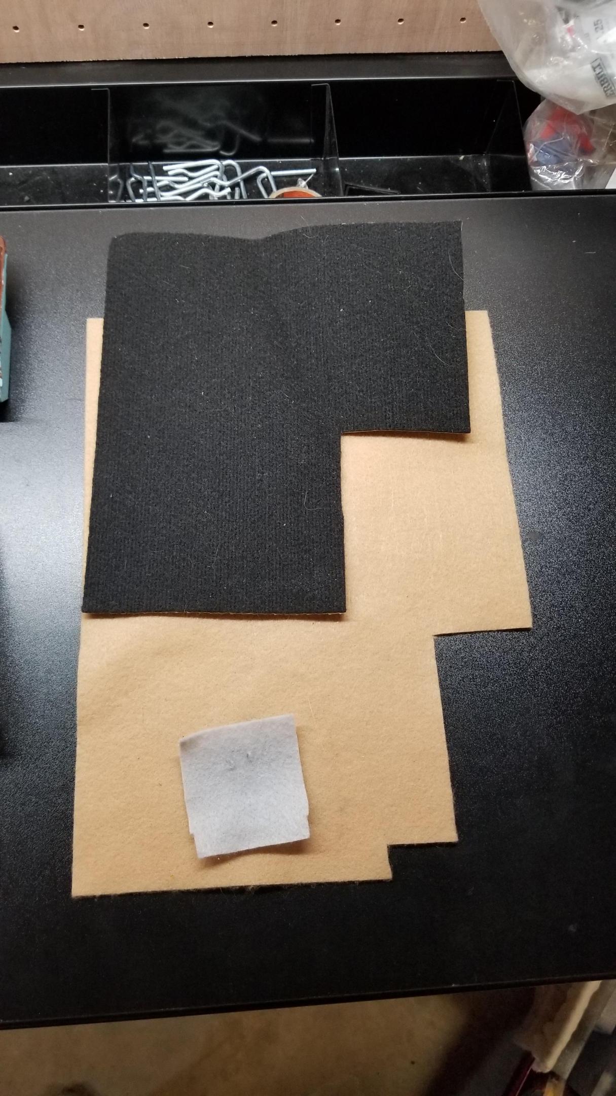

Plastic_Passion Posted July 19, 2020 Author Posted July 19, 2020 Felt is very readily available and I use (if I use) non self-adhesive.

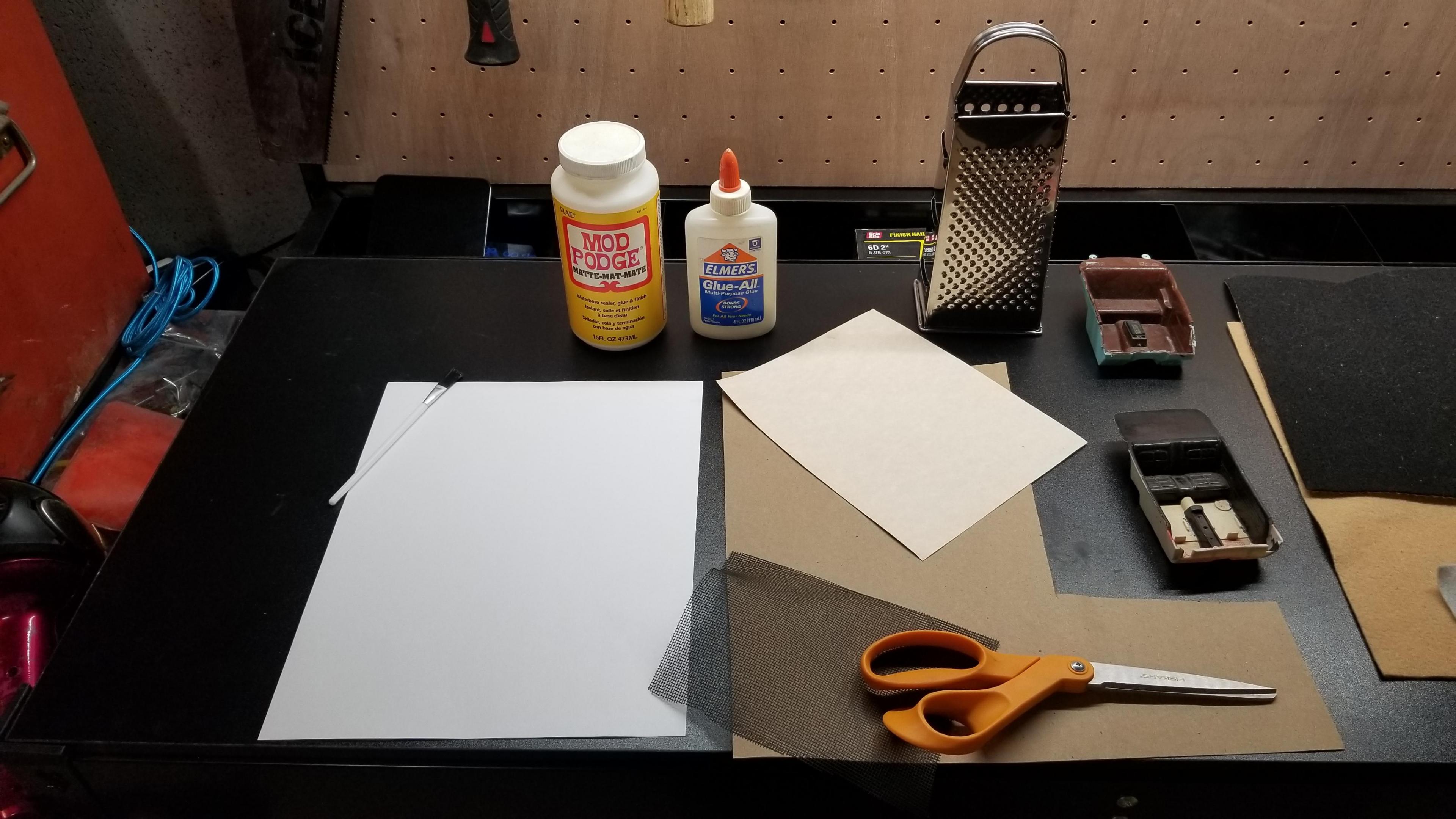

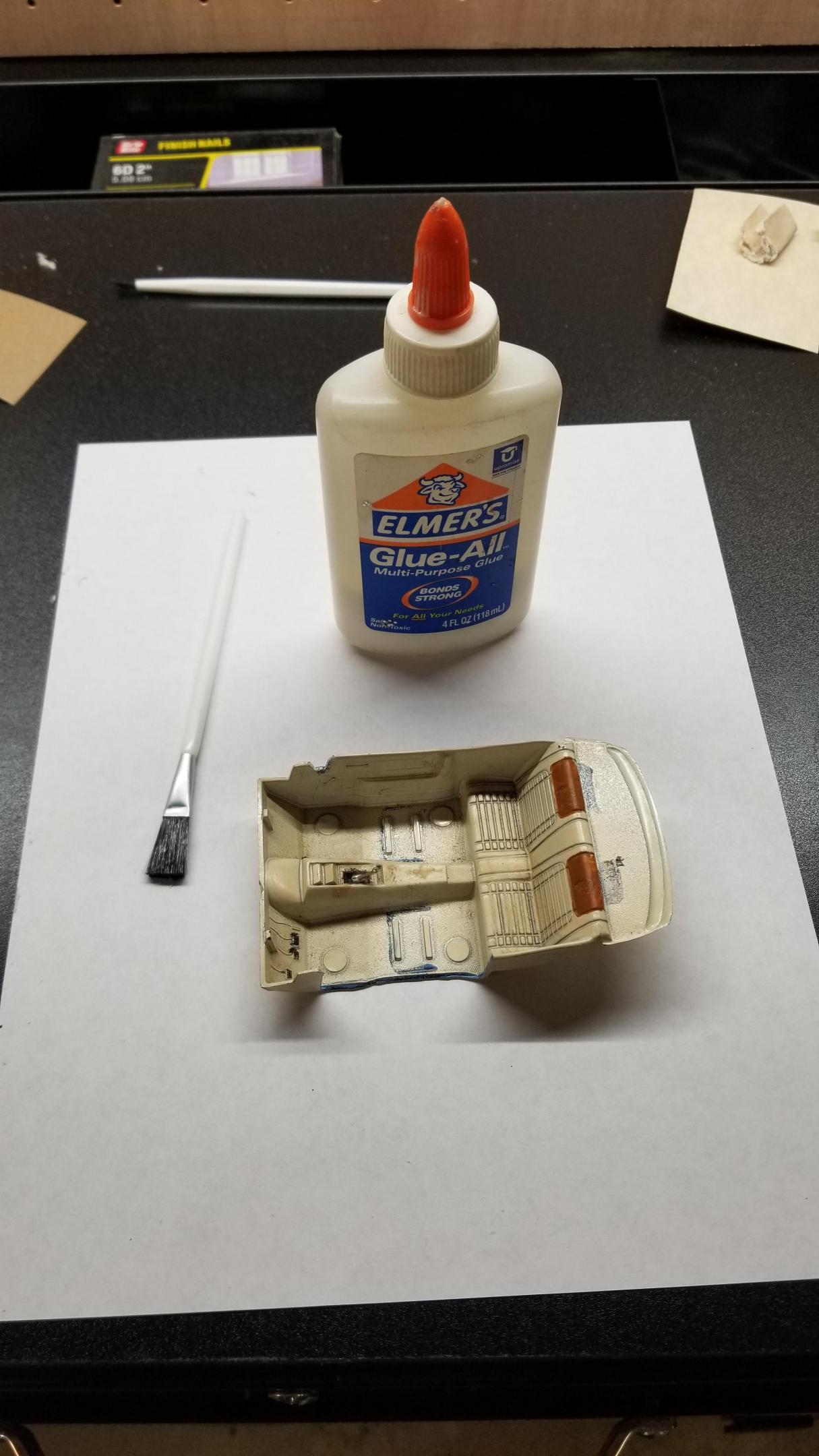

Plastic_Passion Posted July 19, 2020 Author Posted July 19, 2020 For this you'll need some things. Here is my layout. Modge podge, or Elmer's glue, (Both are acrylic and water washup) a couple different sized brushes, 2 sheets of computer paper, screen, a cheese/veggie grater, scissors, and your cardstock.

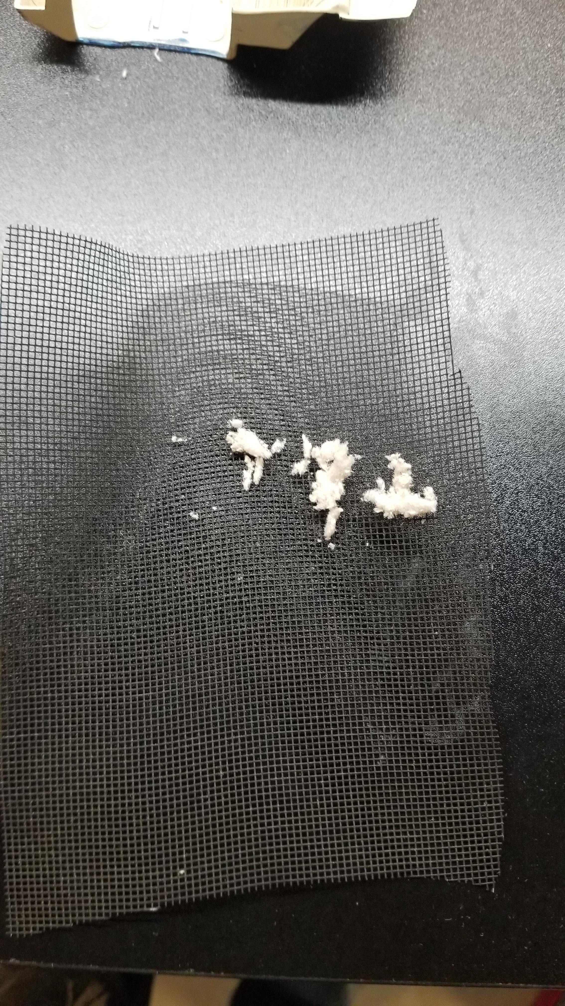

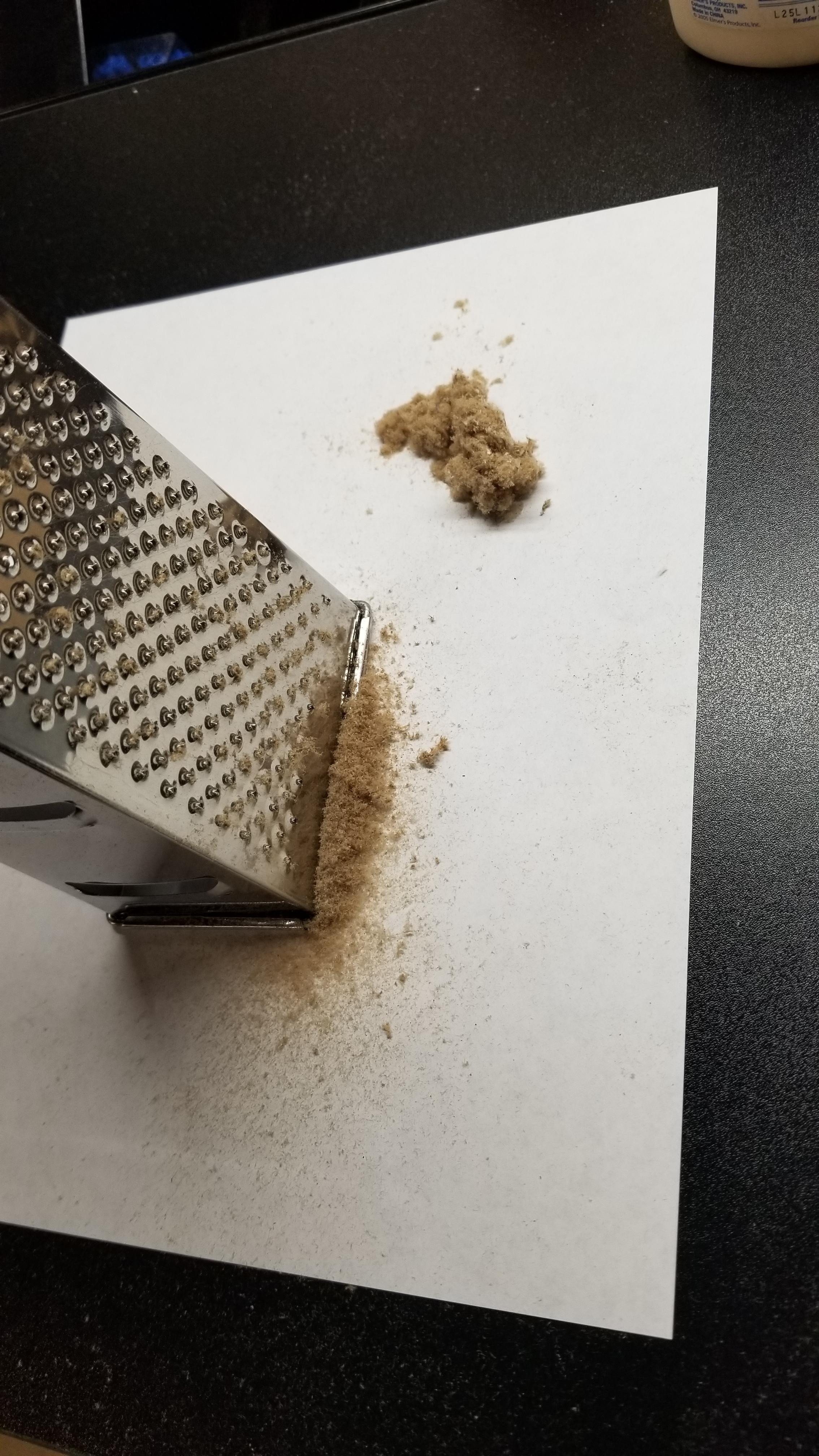

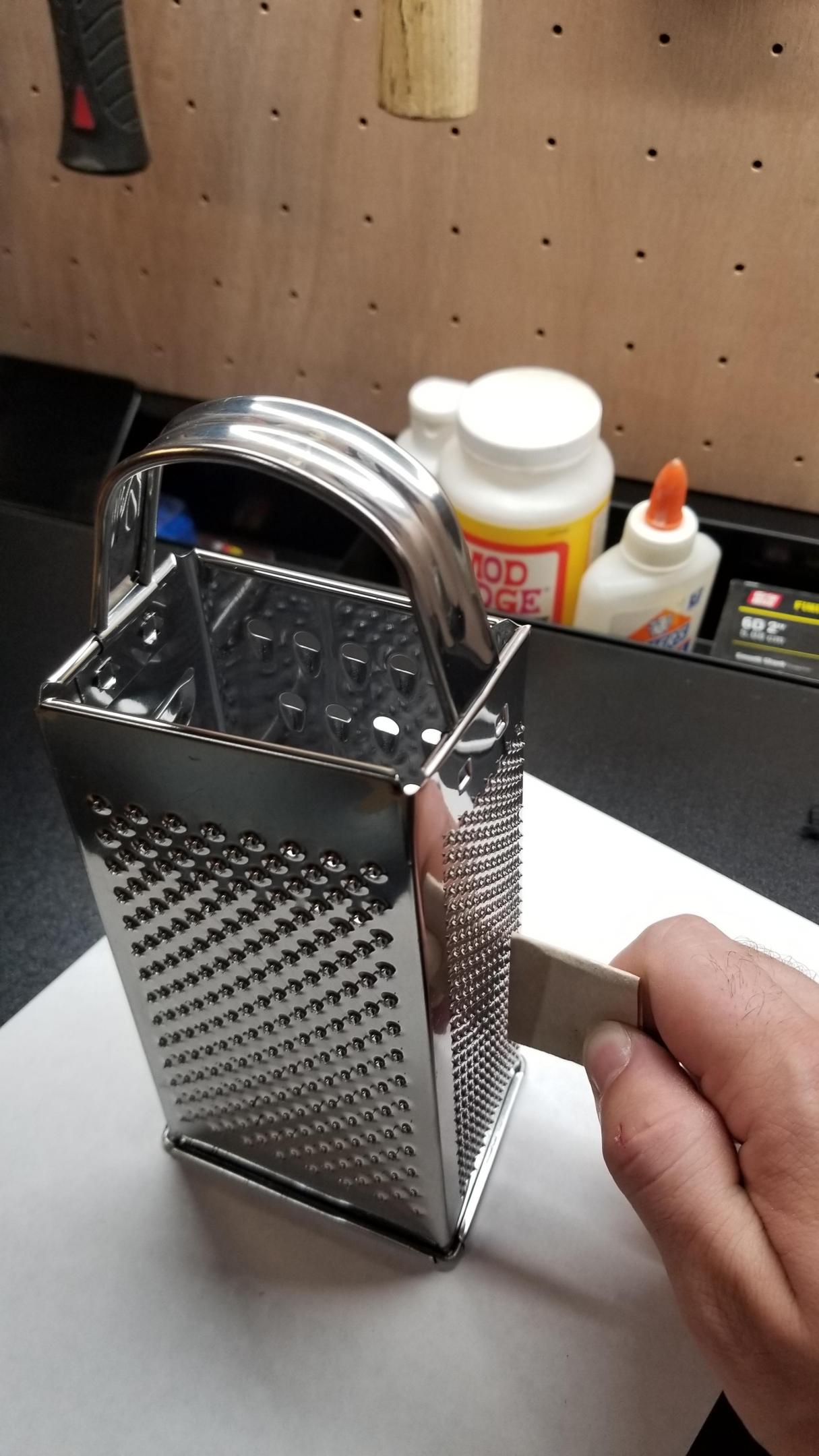

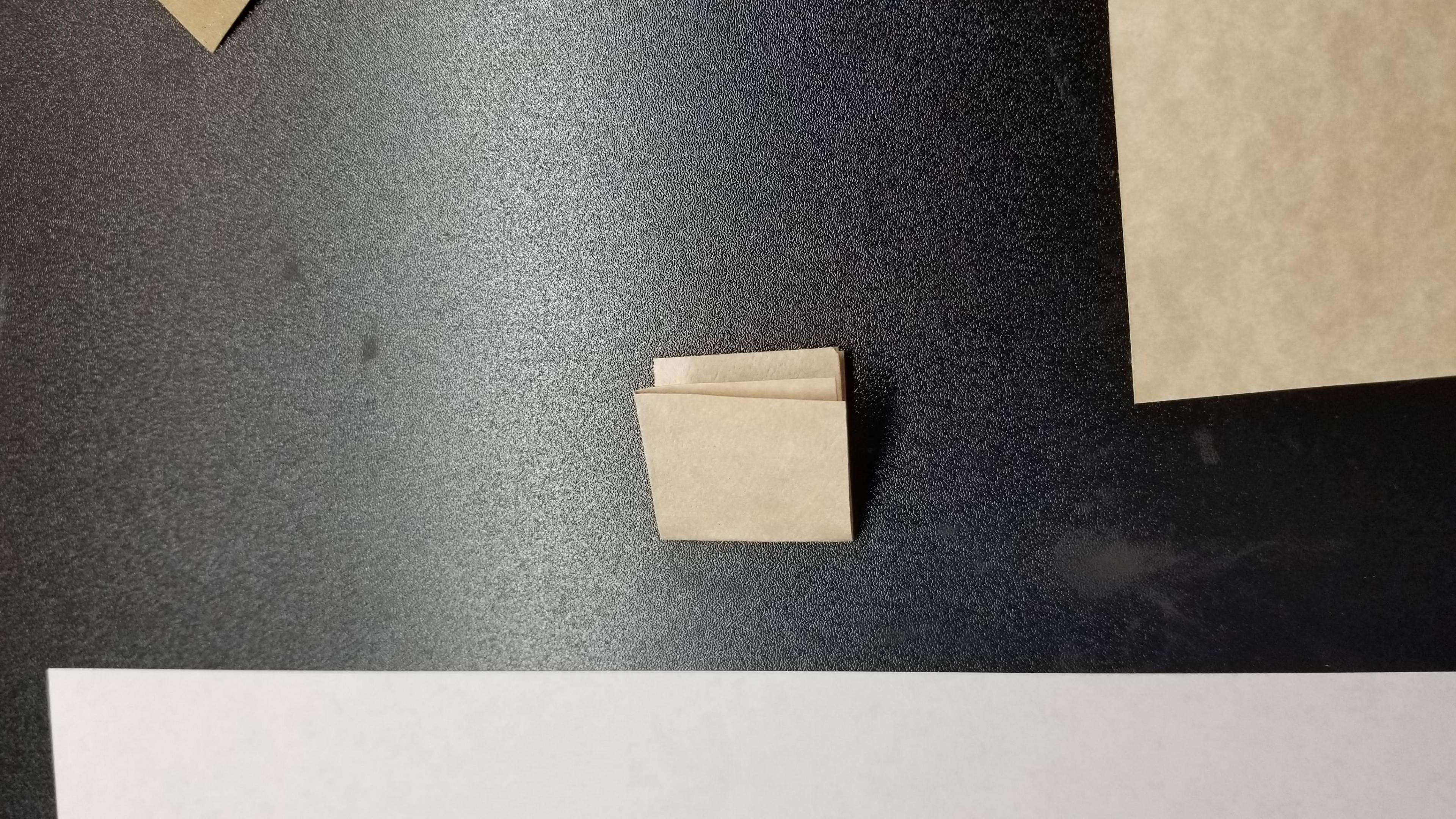

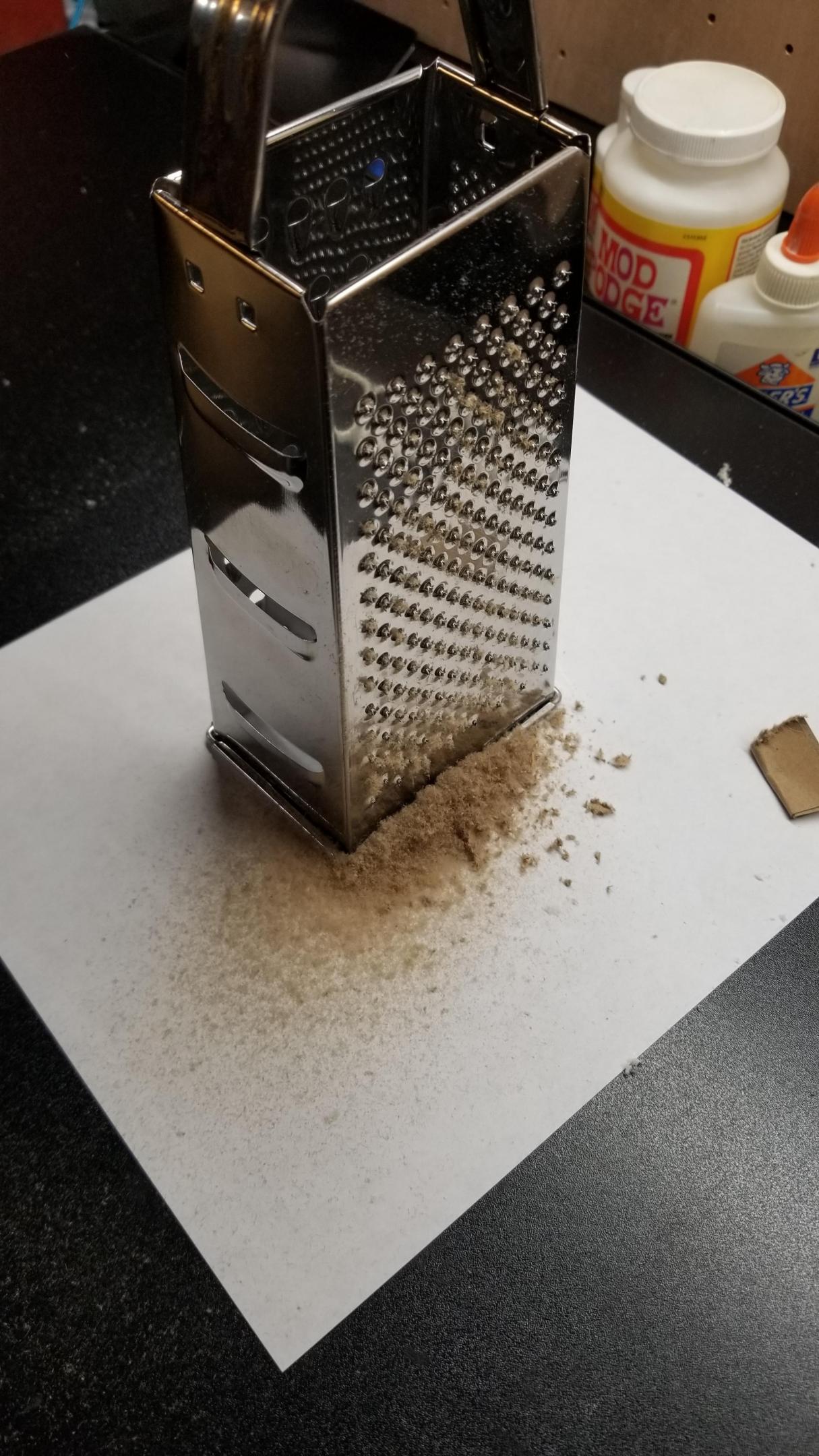

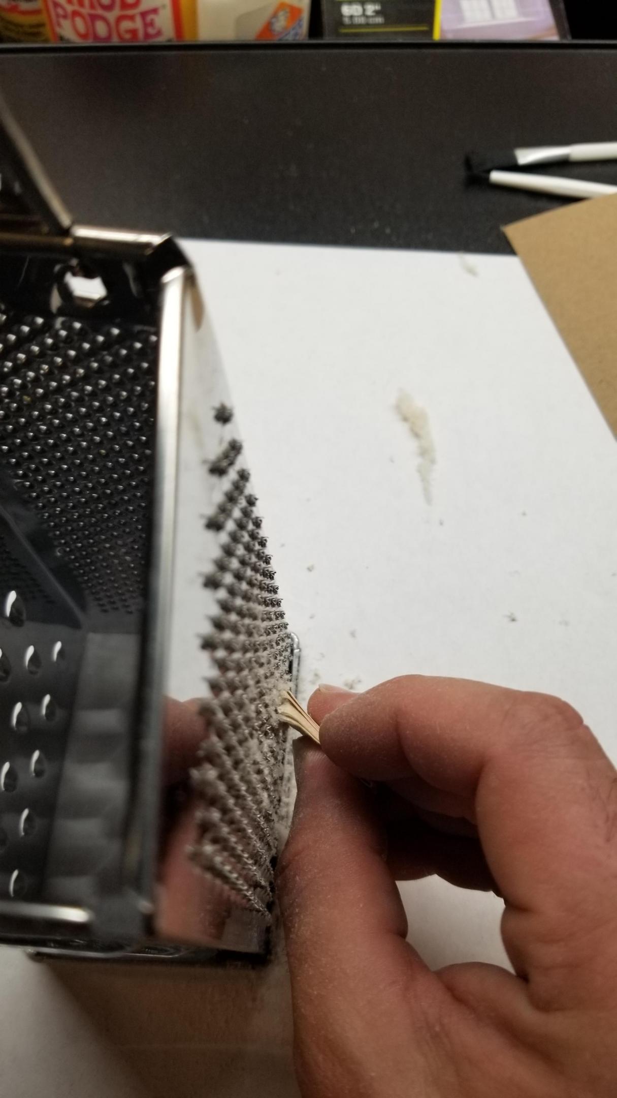

Plastic_Passion Posted July 19, 2020 Author Posted July 19, 2020 I cut up my cardstock and fold it over a few times to give my a rigid piece to grind down. I try to keep my paper at a 45° angle on the grater. Also I use the medium sized holes. The small holes make a mess. You can see the result of this on the following pic of the screen. This is unusable. Its essentially twine.

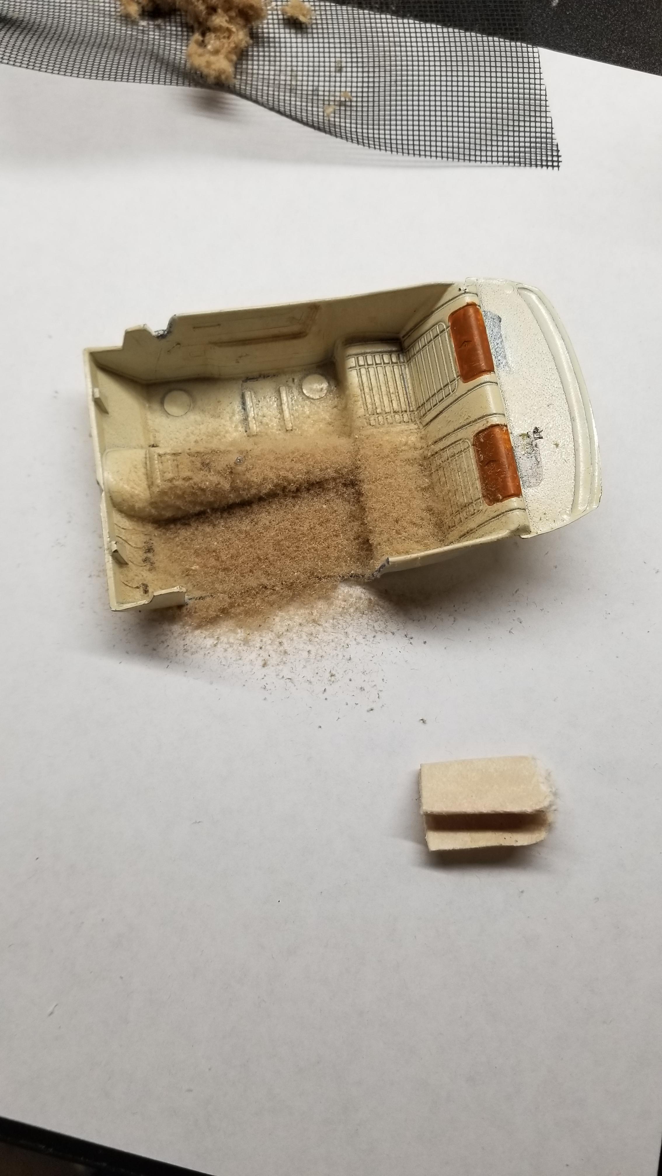

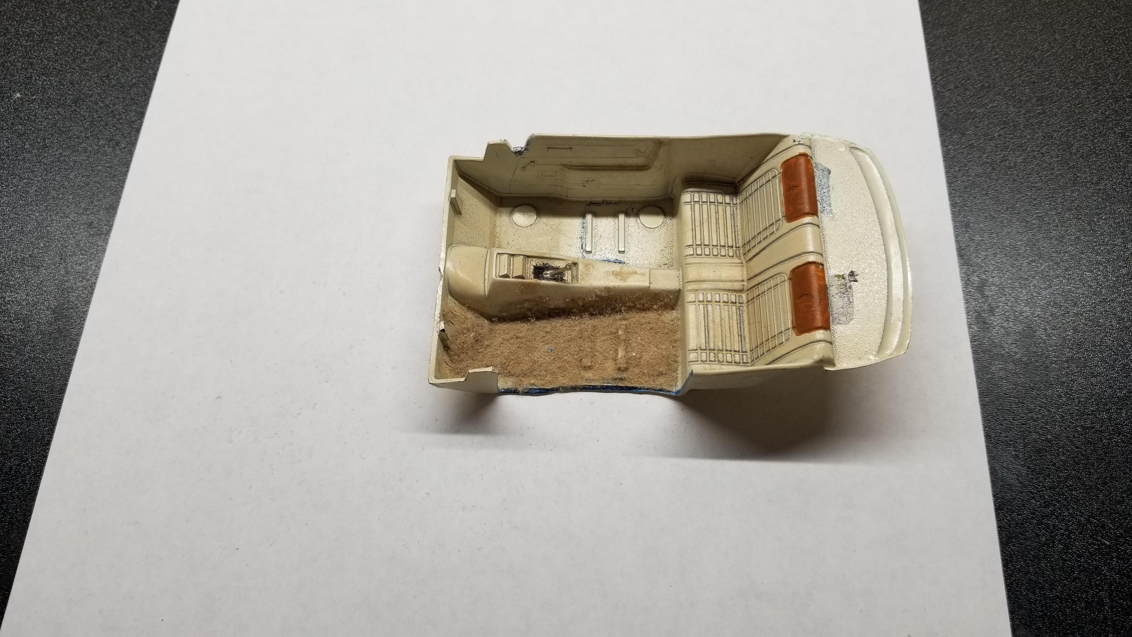

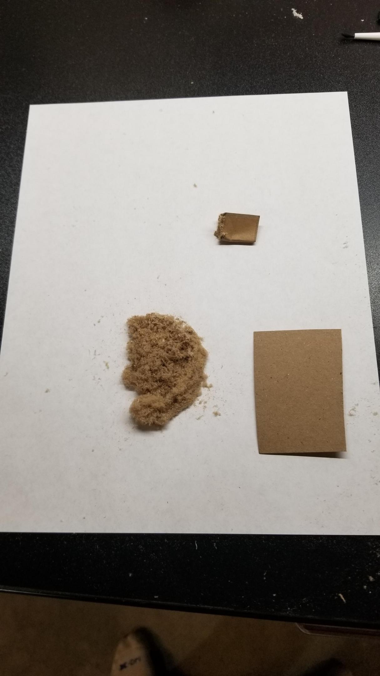

Plastic_Passion Posted July 19, 2020 Author Posted July 19, 2020 So using the medium holes and going at a 45° angle in all directions, (Dont have to really press. Let the grater shred the paper. Not your fingers.) You should end up with a decent pile of stuff. The pile shown is made from a cardstock the size shown next to it.

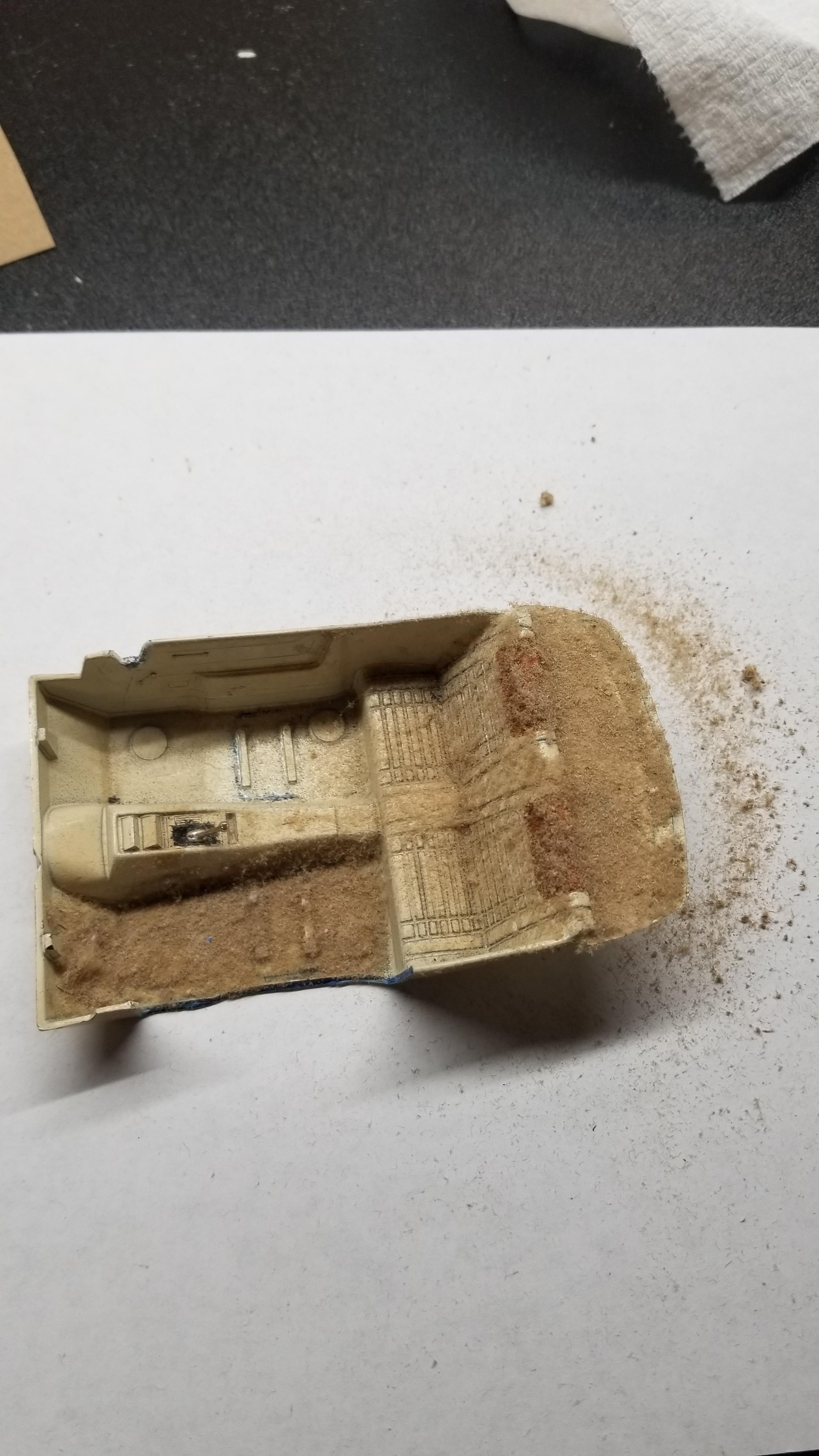

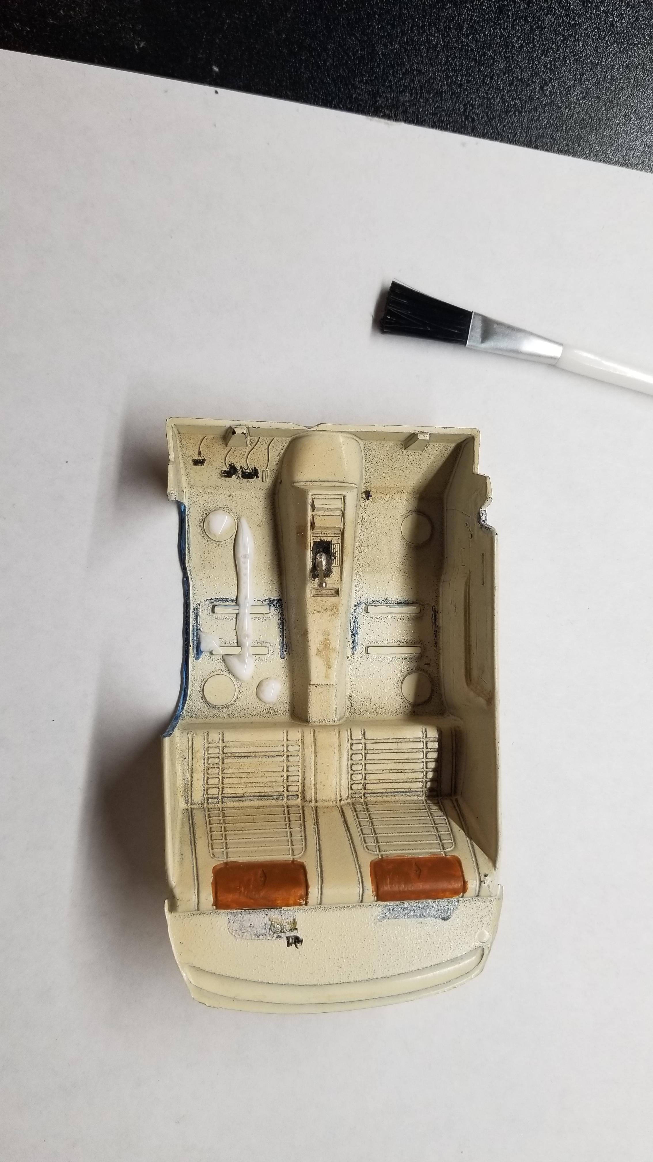

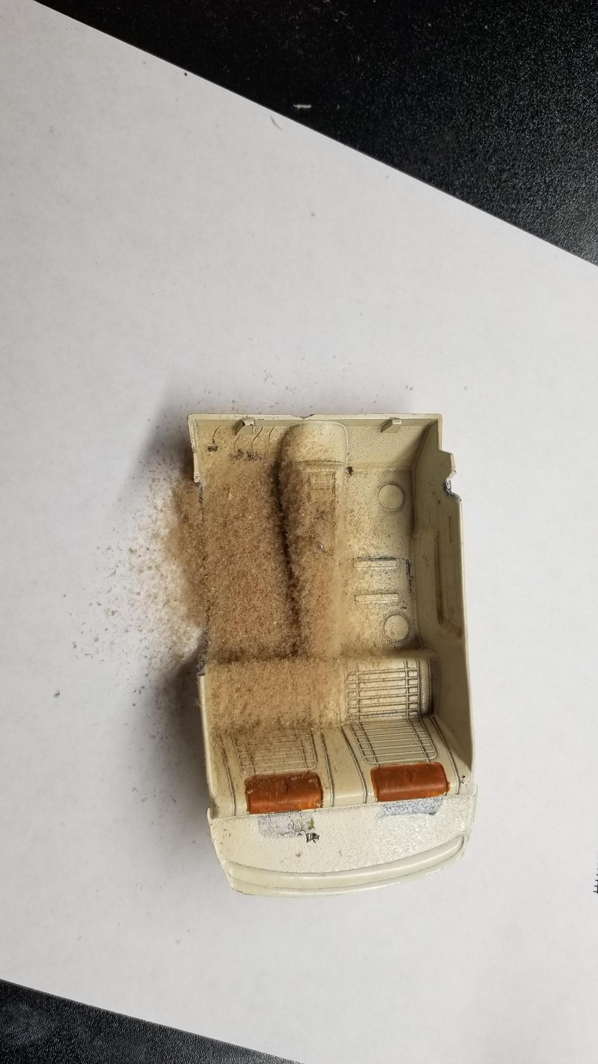

Plastic_Passion Posted July 19, 2020 Author Posted July 19, 2020 Next paint your modge podge or Elmer's on your part/tub. Work in sections and rinse your brush fairly quickly after. No need to rush for the brush but dont forget it.

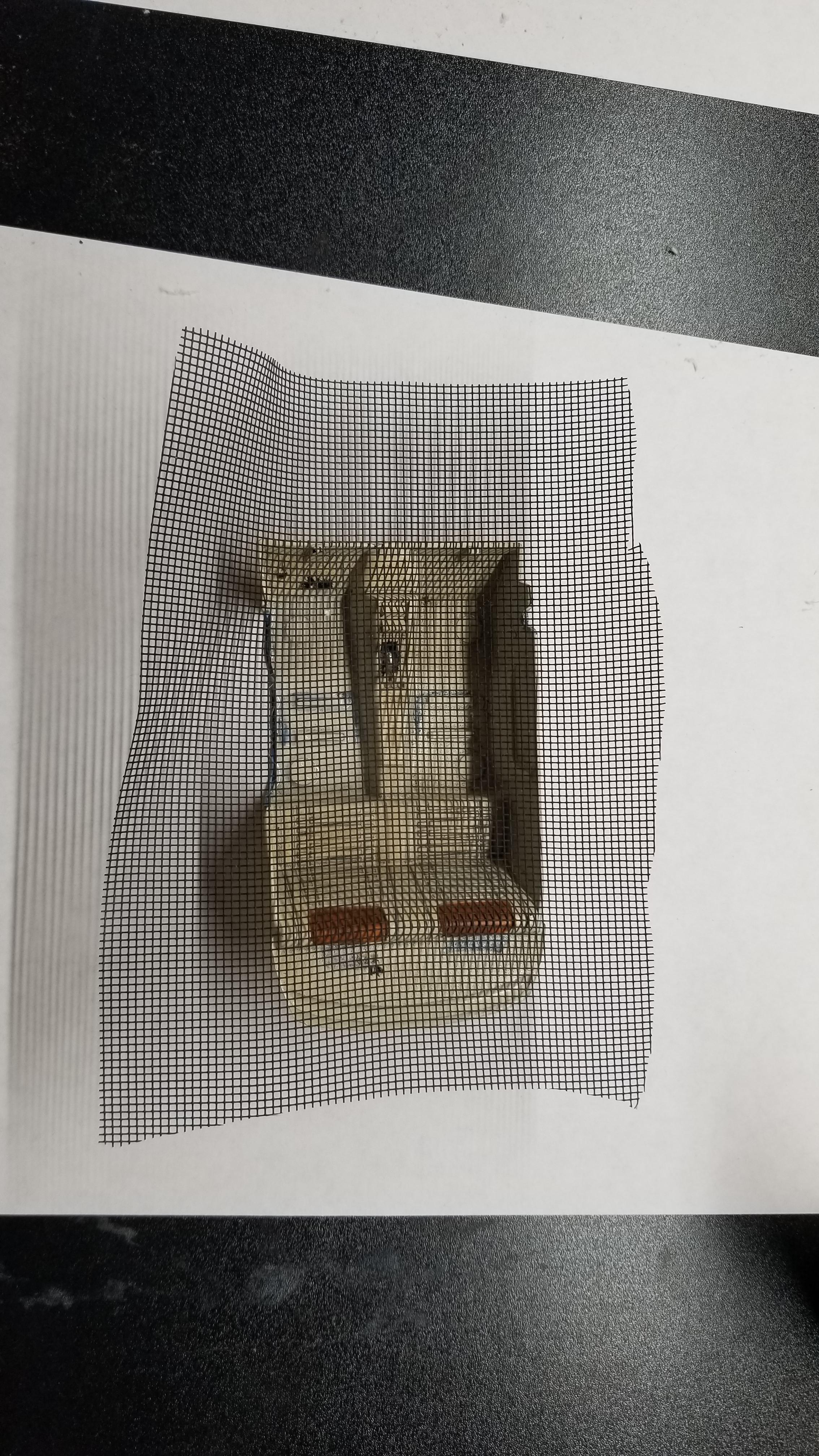

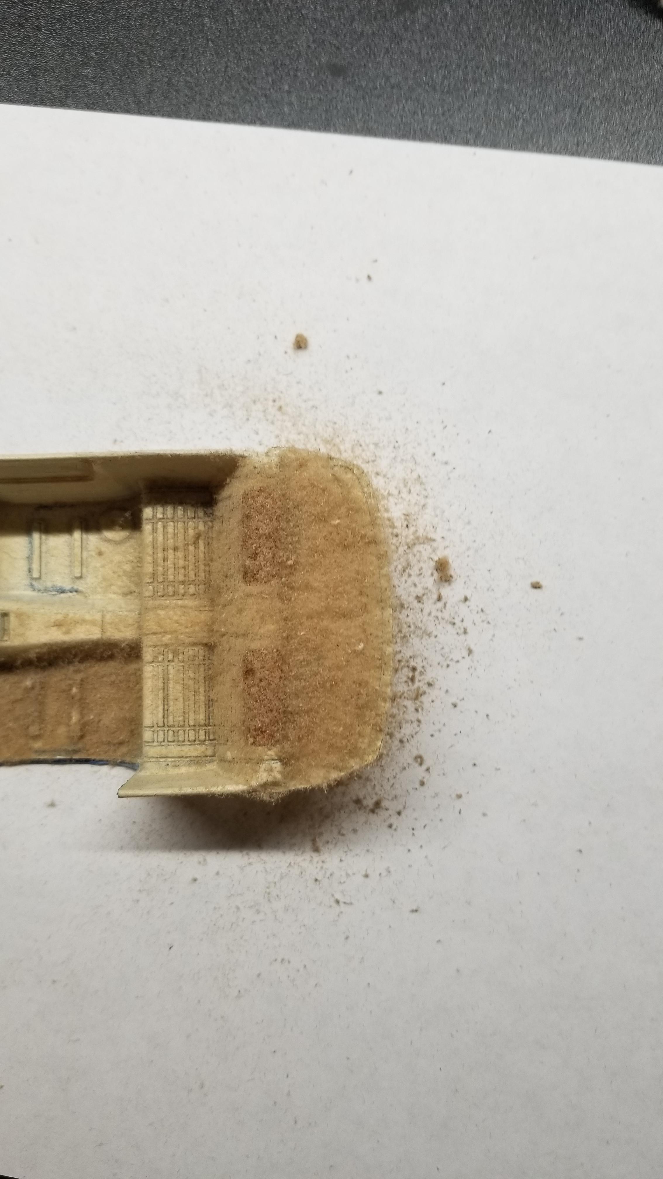

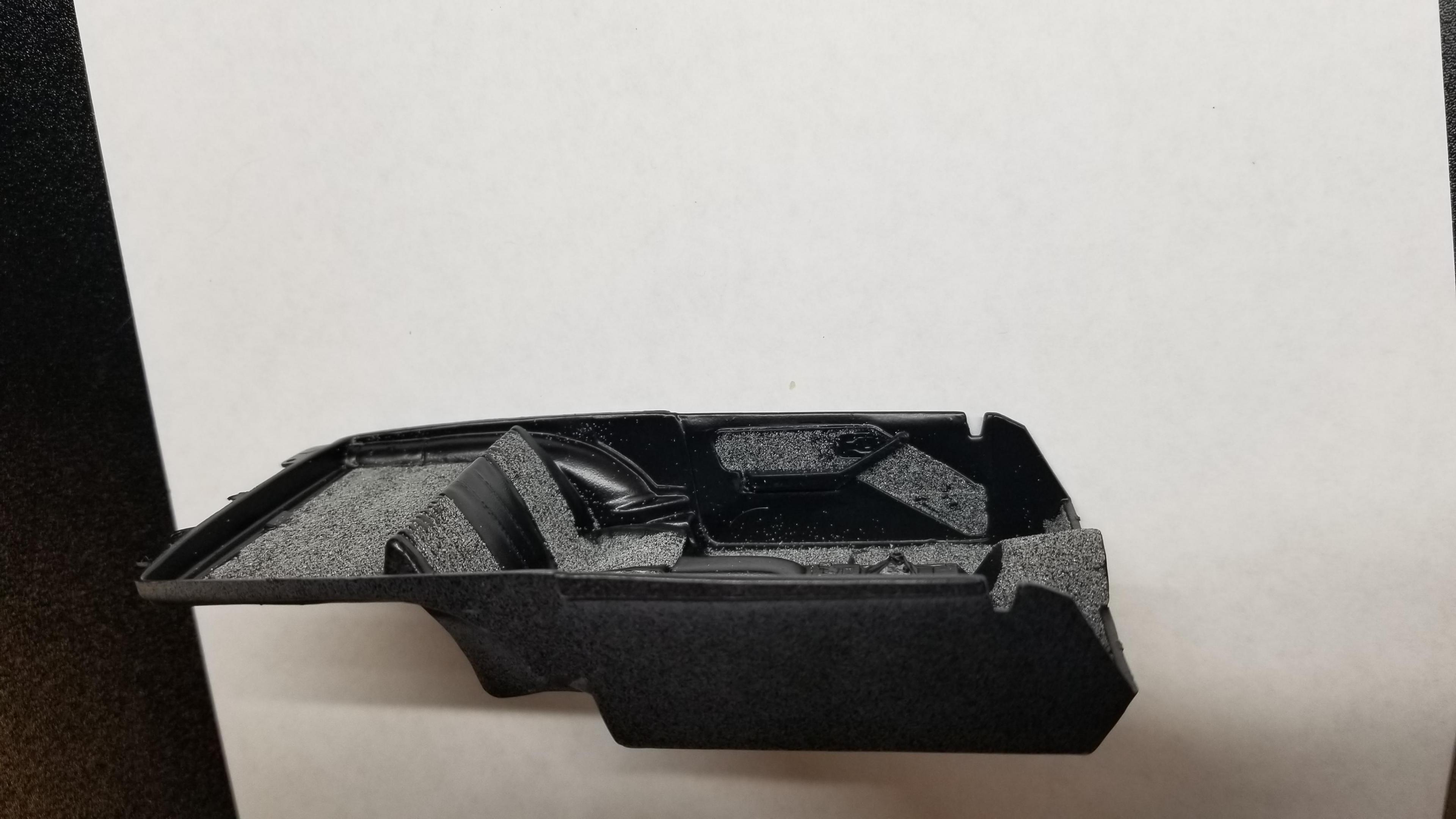

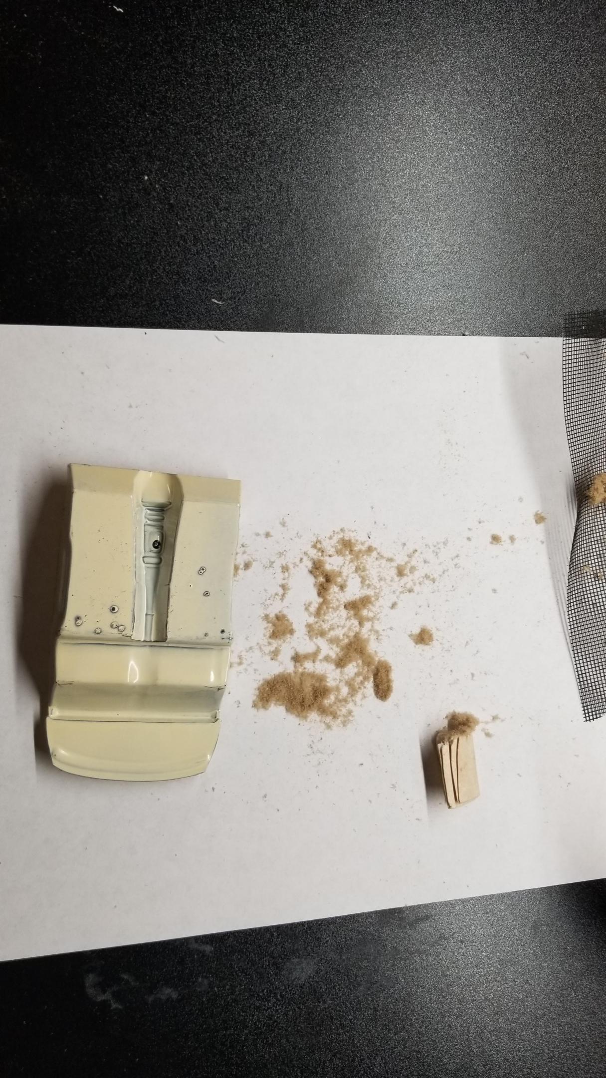

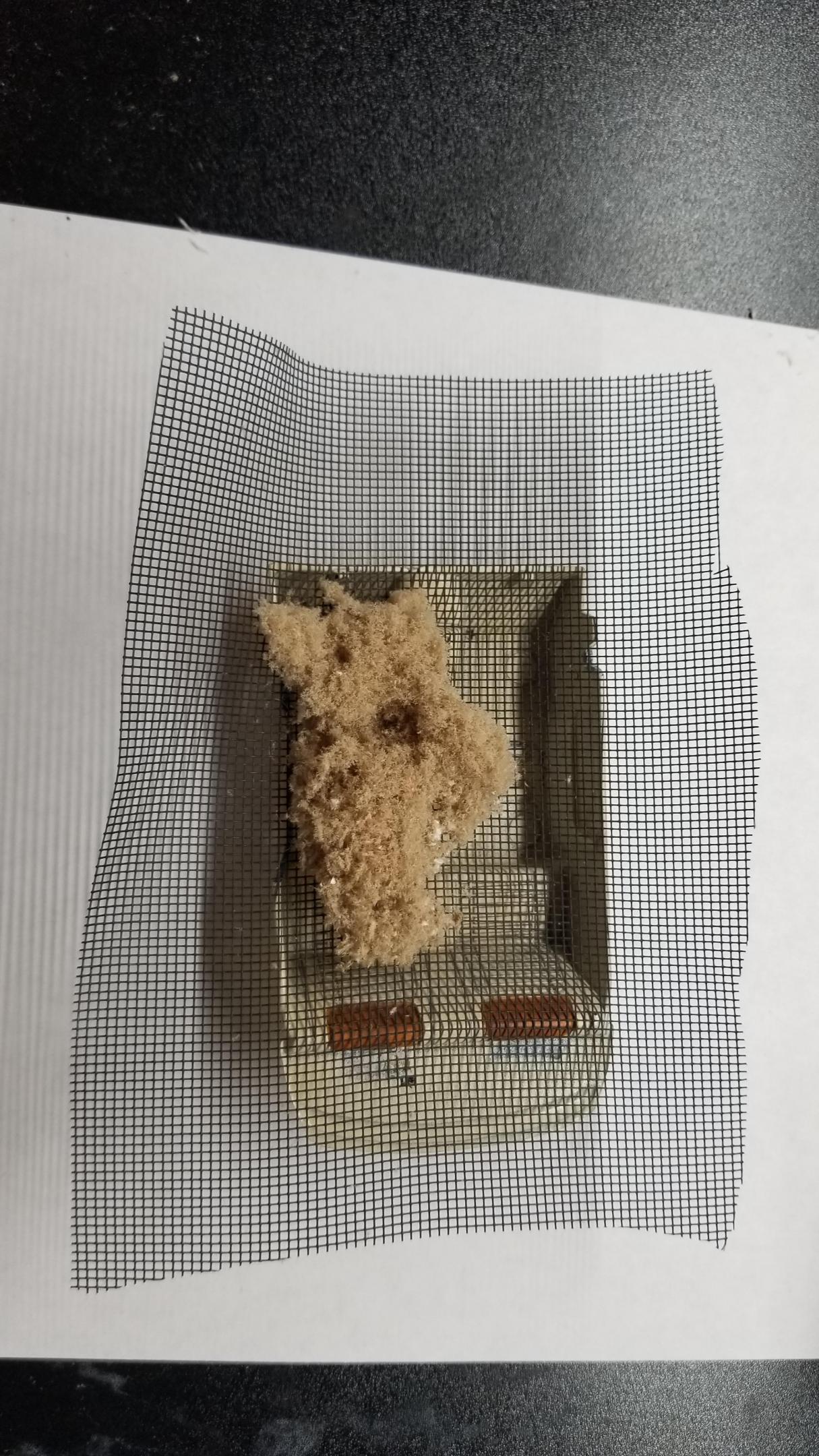

Plastic_Passion Posted July 19, 2020 Author Posted July 19, 2020 If your doing carpet you can just put your screen right over your tub. If doing like seats or doors then I'd suggest a small container. Transfer your shavings from the paper to the screen. Put the part on a fresh sheet of paper. Rub the shavings over the screen. You can push the material down a little with your finger or some other tool. Wait a few for it to dry then tap off the extra on the paper you originally used. This can be recycled for the next section of carpet material. You can always touch up areas too. Just be careful how far you go with the brush and glue.

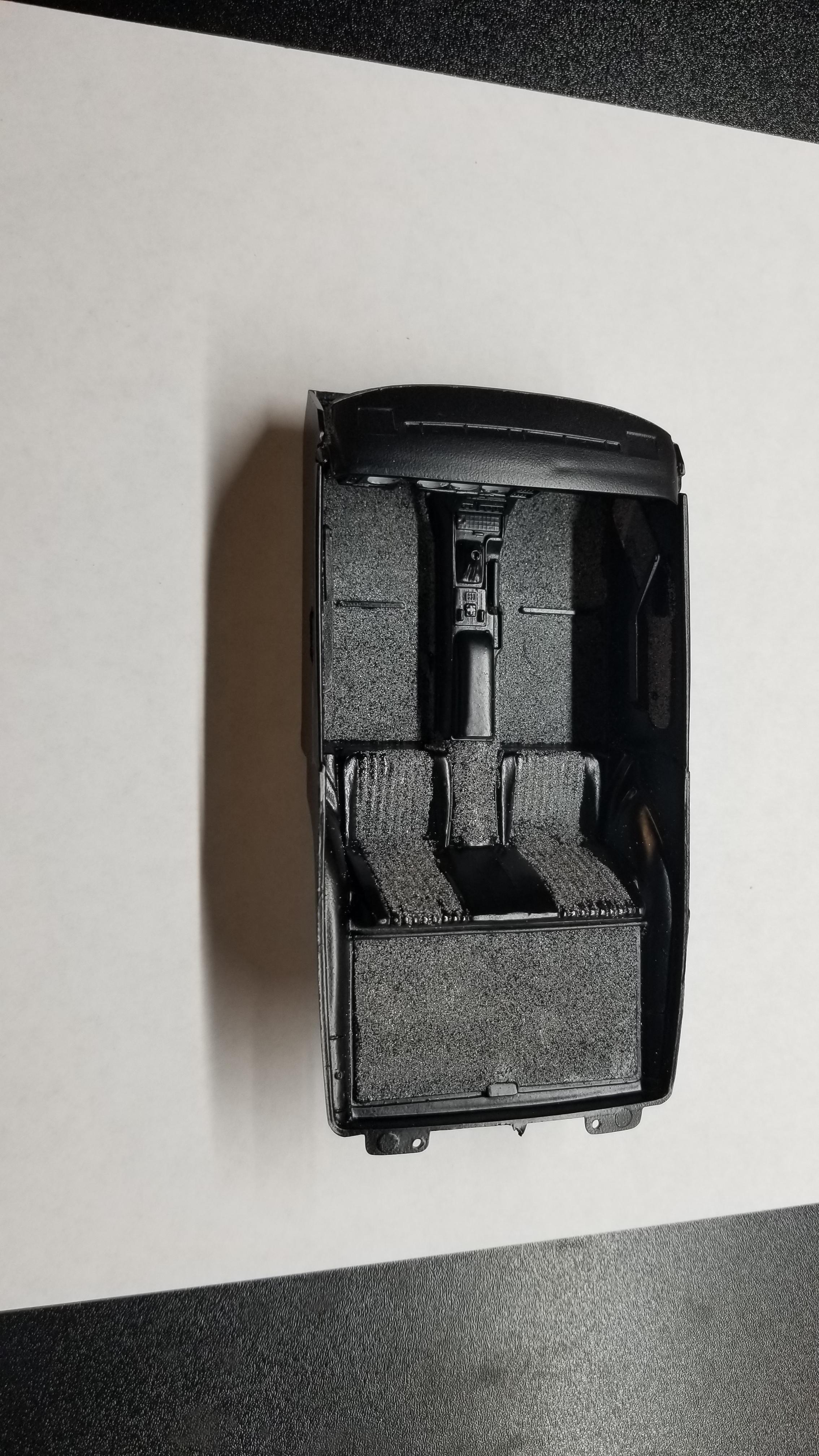

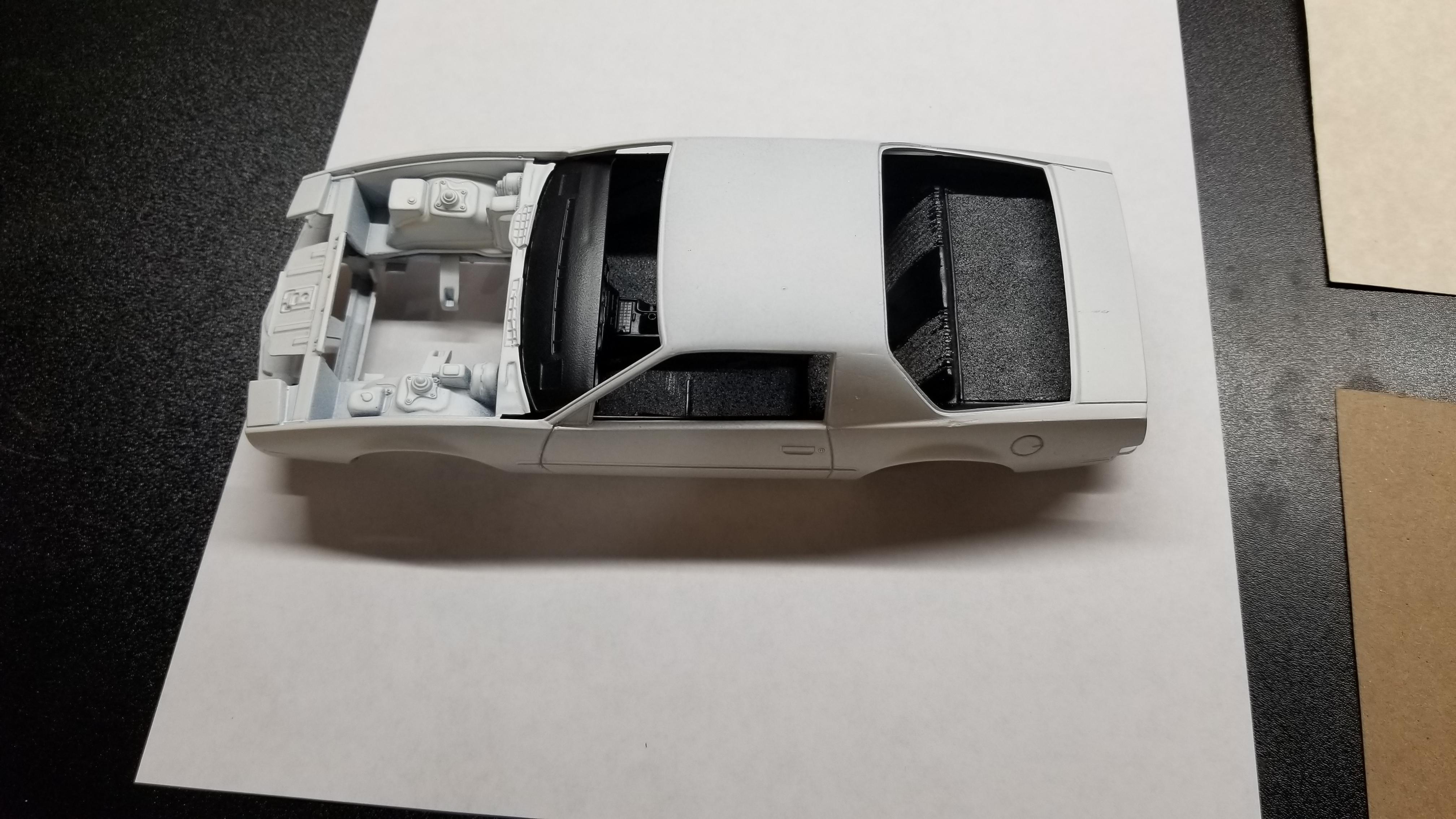

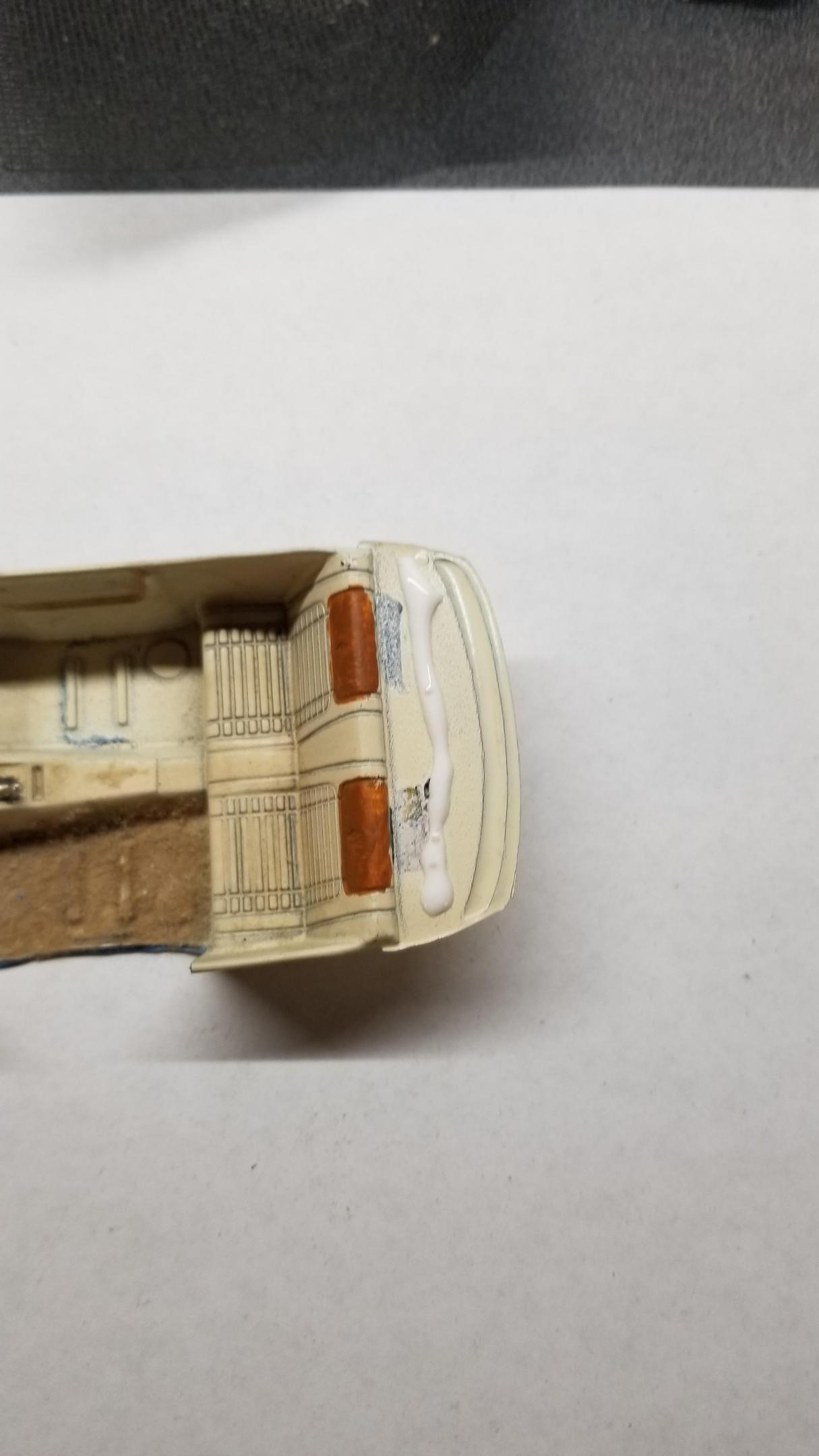

Plastic_Passion Posted July 19, 2020 Author Posted July 19, 2020 As I said I work in sections so I'm not racing the glue. Had to make more for the rear deck.

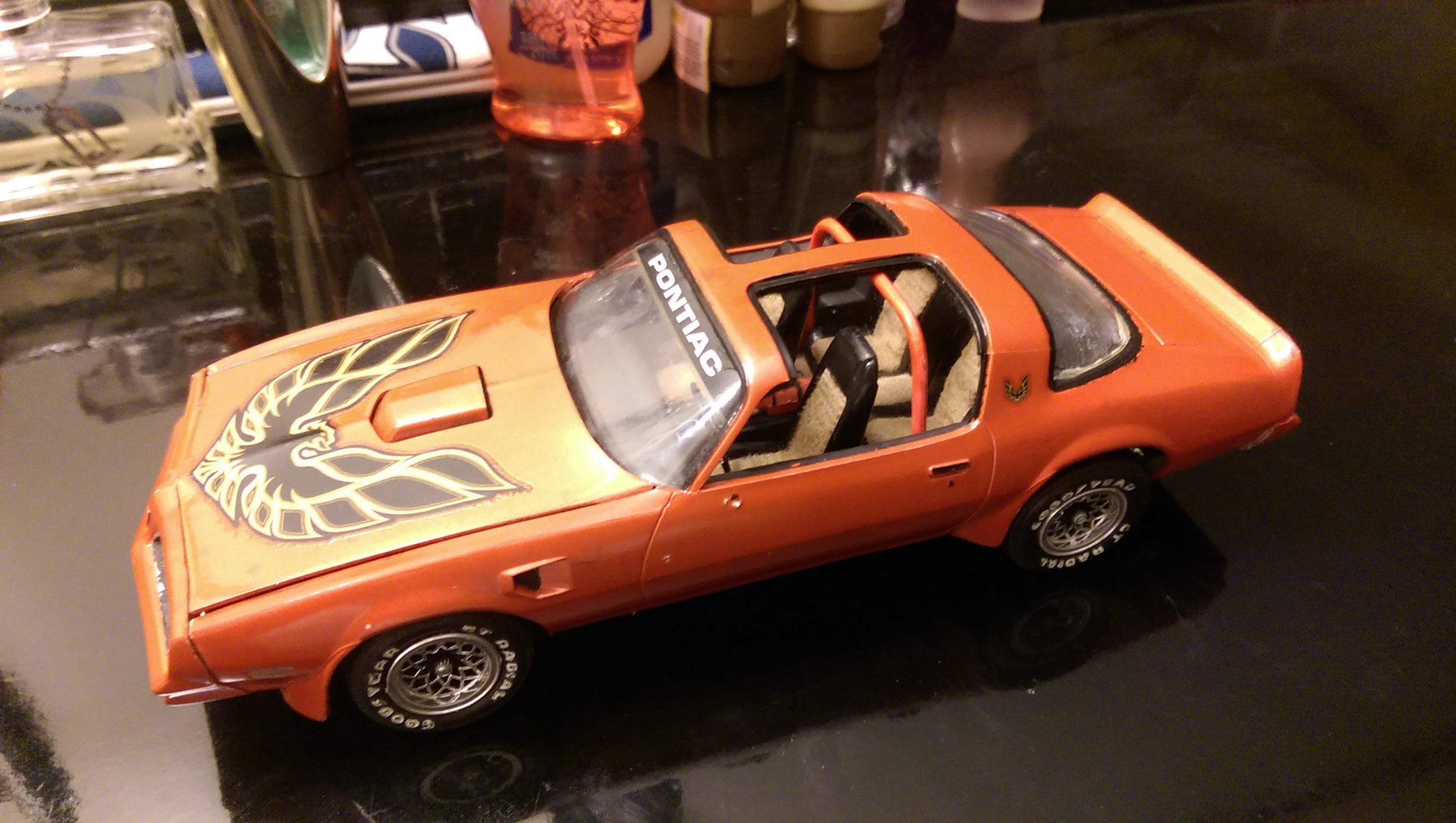

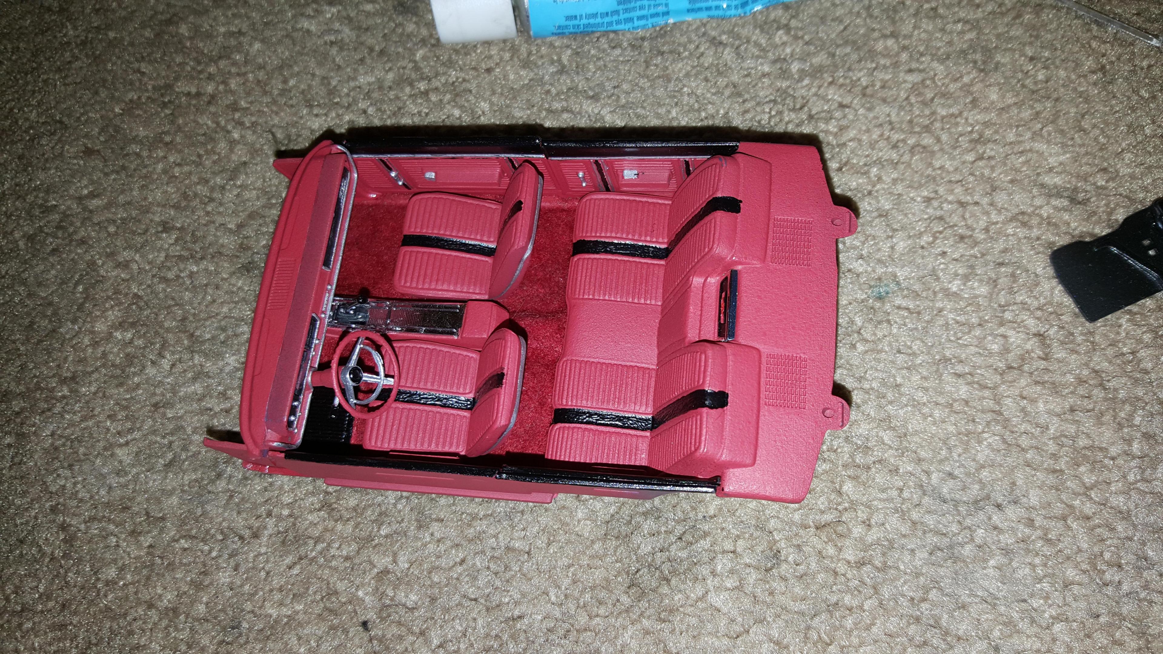

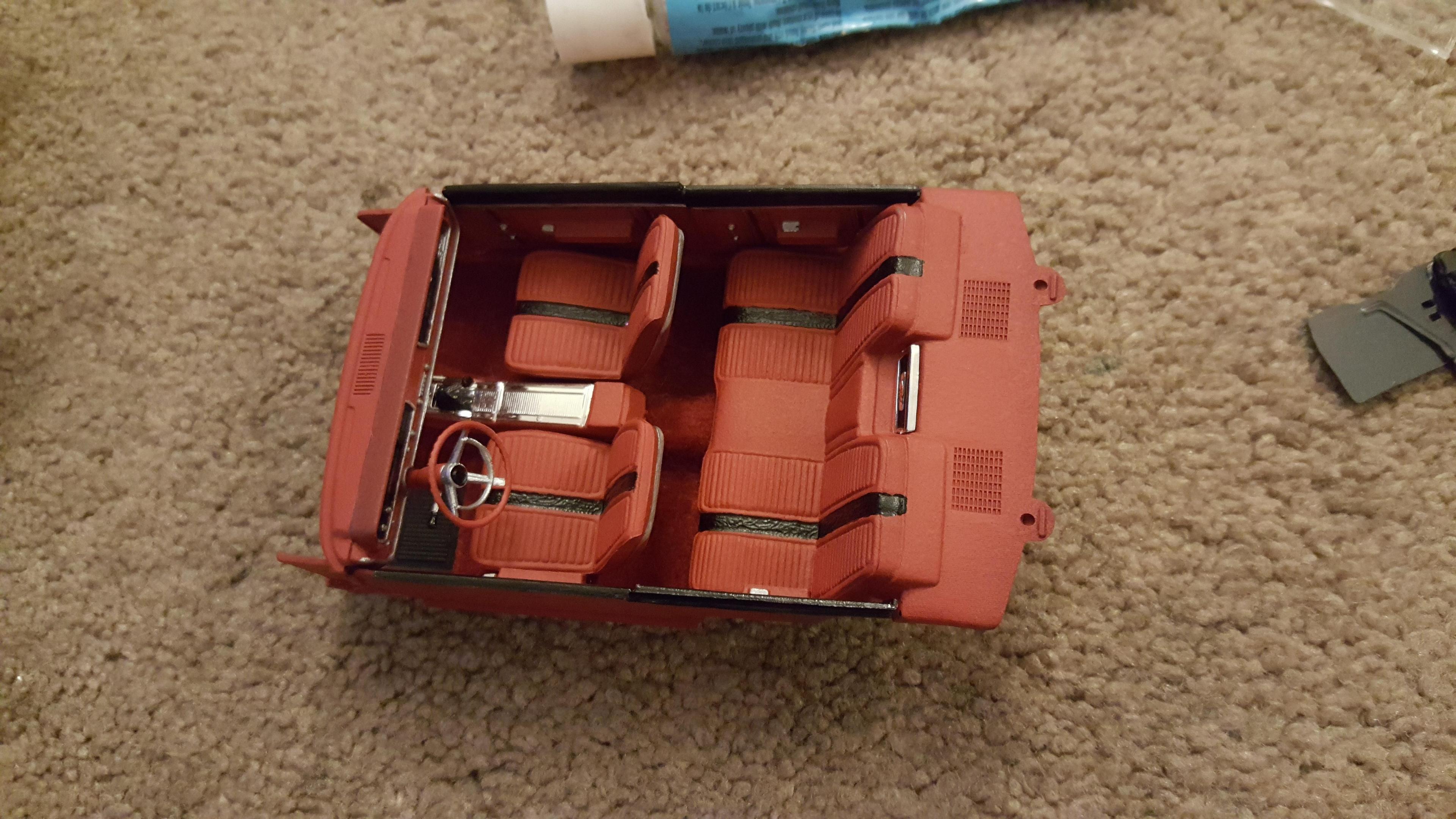

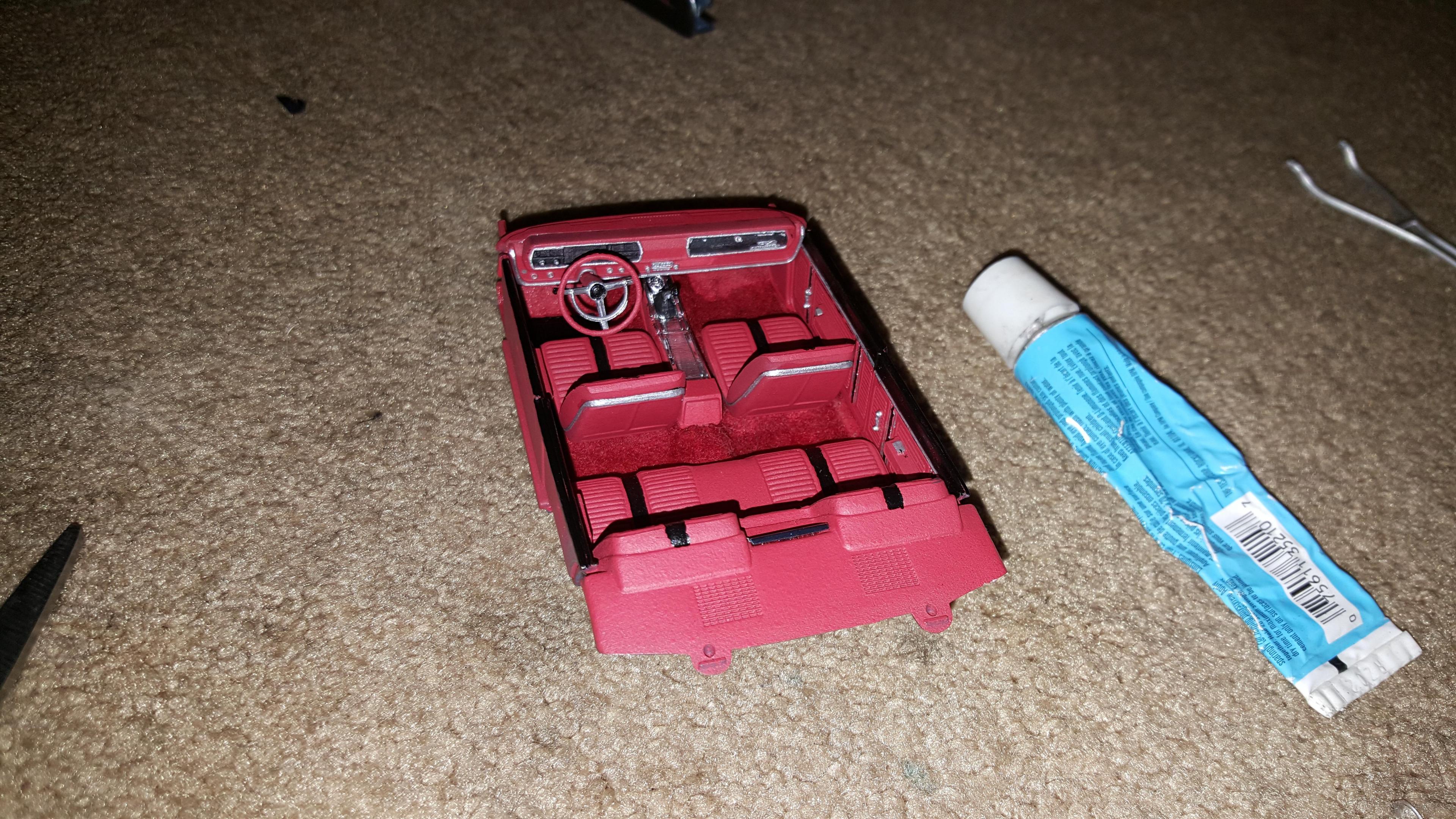

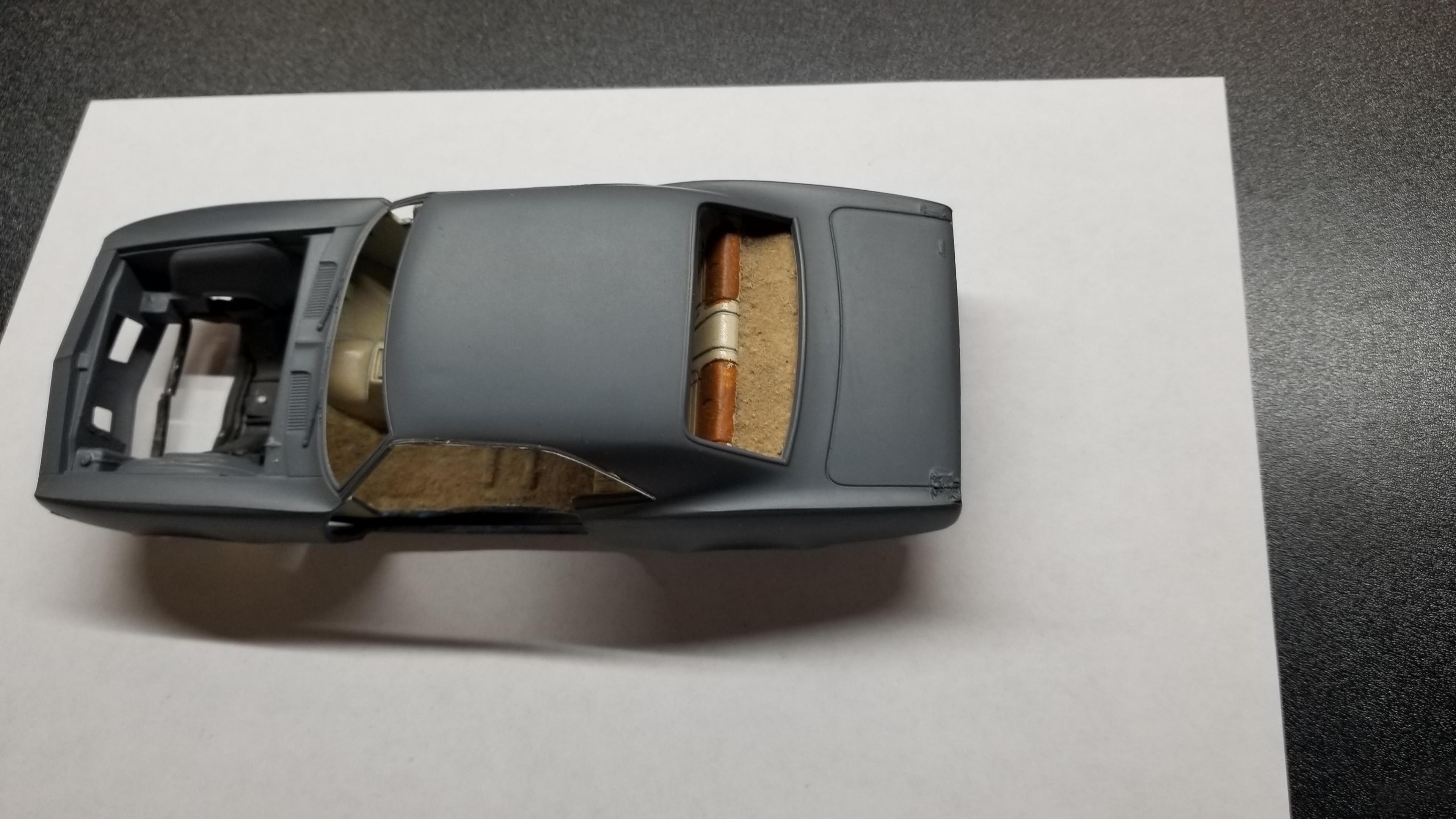

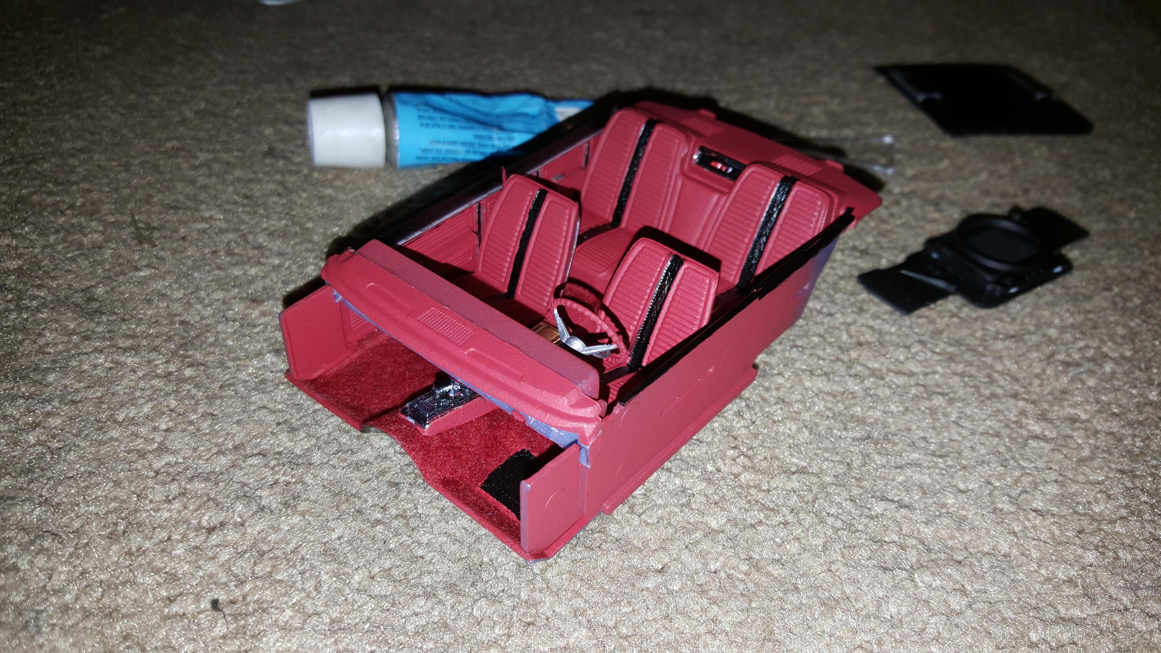

Plastic_Passion Posted July 19, 2020 Author Posted July 19, 2020 You can always mix colors too. I mixed a little black in with red. For this GTX

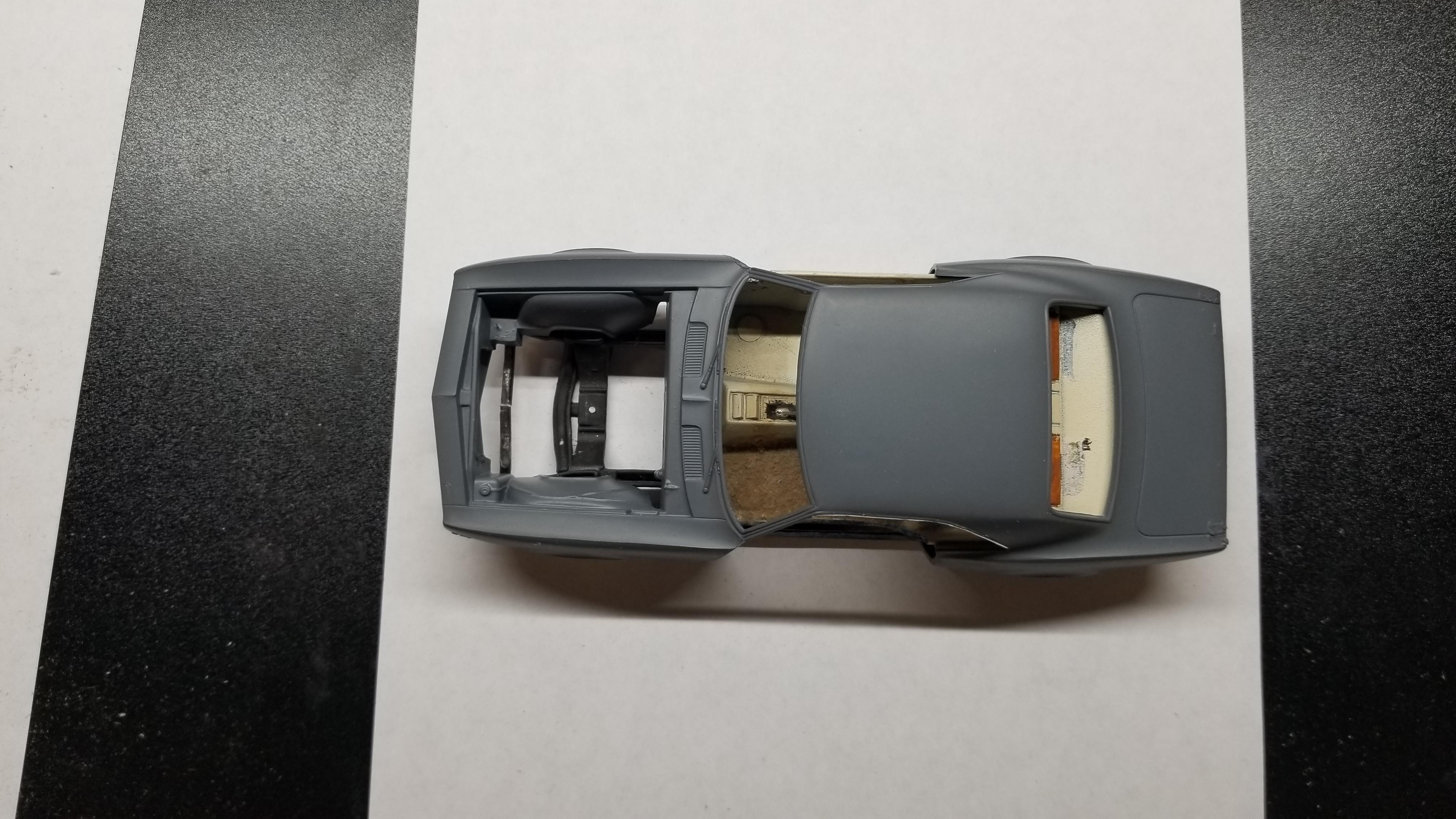

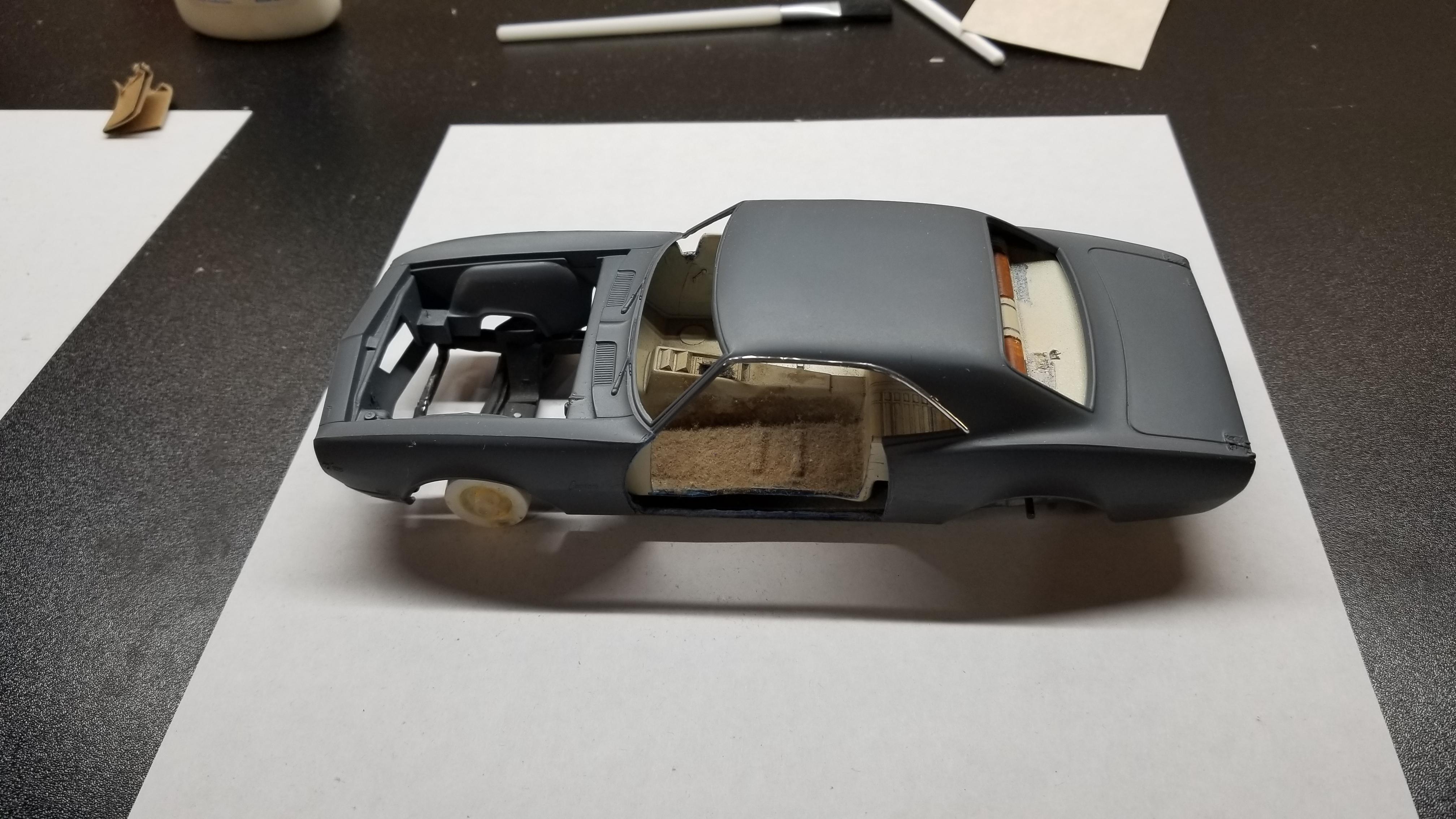

Plastic_Passion Posted July 19, 2020 Author Posted July 19, 2020 Brought this black and silver to black leather/tan cloth. Sorry the pics aren't great for this.

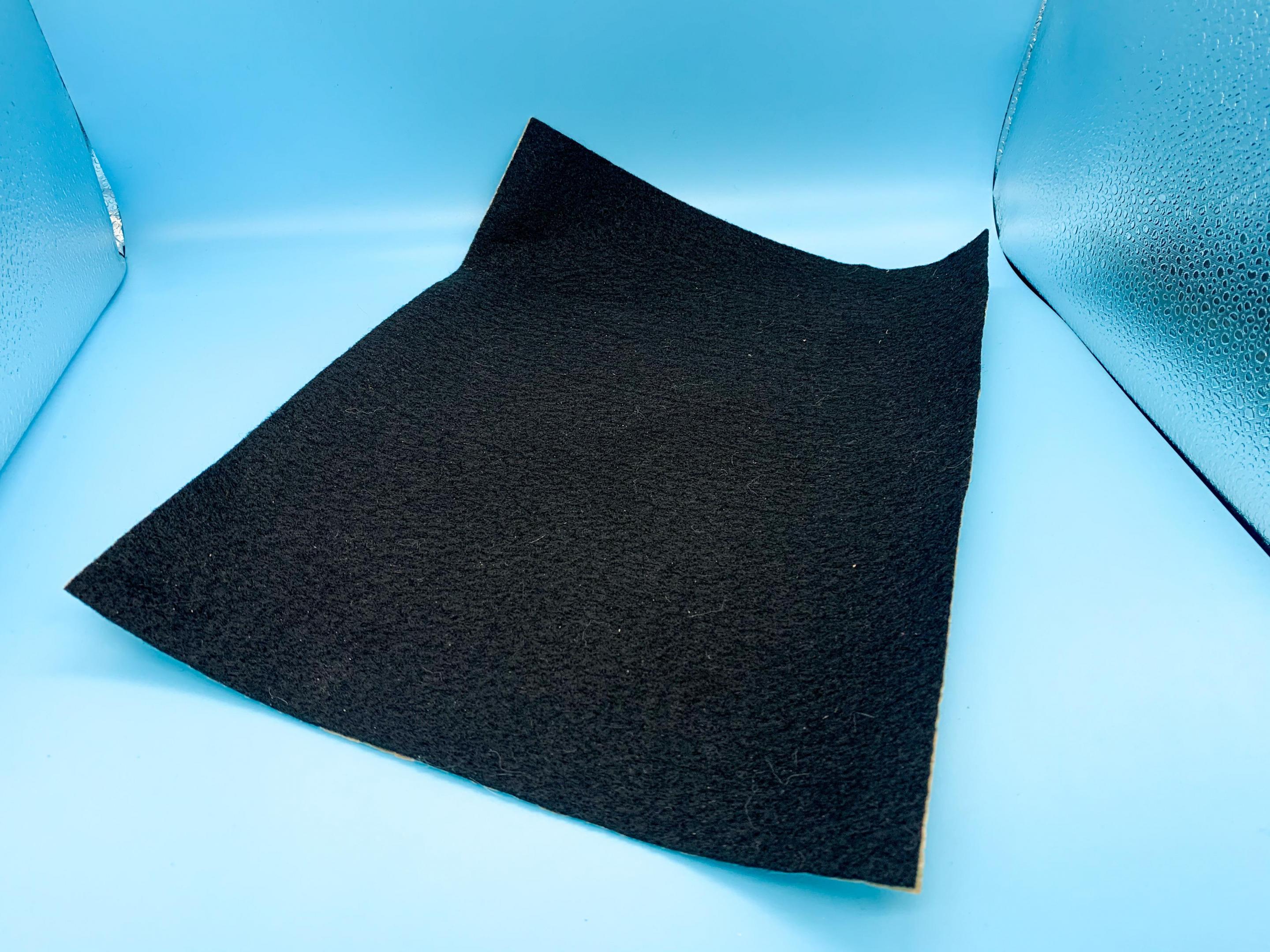

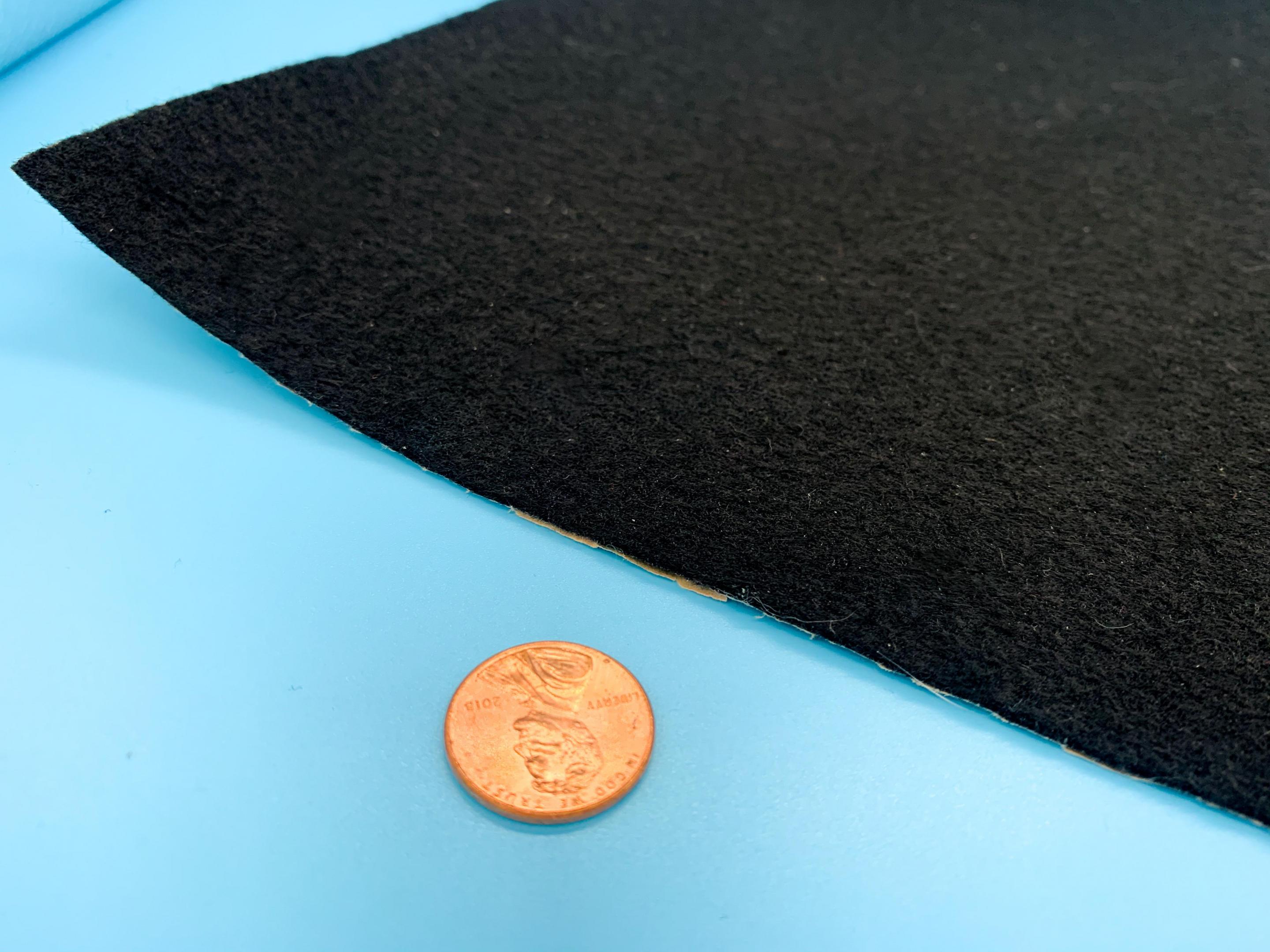

OldNYJim Posted July 20, 2020 Posted July 20, 2020 10 hours ago, DiscoRover007 said: Nice write up! Personally I think the best method is flocking in combination with spray adhesive. You have to mask off the areas you don't want covered which can be a pain but the results are worth in in my opinion. You can patch any mistakes with the white glue method afterwards. But it really delivers a clean and even finish. That looks really good! I picked up this self-adhesive sheet of fuzzy whatever-it-is from Michael’s last time I went there to bring home and compare to my flocked and embossing powder efforts at carpet - I think it looks promising! Not super deep and fluffy looking like felt sheets which don’t look realistic, and a little more carpet-y than some of the embossing powders I’ve tried...I need to try some on an actual build and see how it looks with the other components but it might work out ok I think;
Plastic_Passion Posted July 20, 2020 Author Posted July 20, 2020 32 minutes ago, CabDriver said: That looks really good! I picked up this self-adhesive sheet of fuzzy whatever-it-is from Michael’s last time I went there to bring home and compare to my flocked and embossing powder efforts at carpet - I think it looks promising! Not super deep and fluffy looking like felt sheets which don’t look realistic, and a little more carpet-y than some of the embossing powders I’ve tried...I need to try some on an actual build and see how it looks with the other components but it might work out ok I think; I used this in my lightning model as a bed rug. Was decent tho seems more like the fabric you'd see on a woofer box generally speaking. The only other thing I didnt really like was how kind of unforgiving it is. Like going around molded in center consoles.
OldNYJim Posted July 20, 2020 Posted July 20, 2020 Just now, Plastic_Passion said: I used this in my lightning model as a bed rug. Was decent tho seems more like the fabric you'd see on a woofer box generally speaking. The only other thing I didnt really like was how kind of unforgiving it is. Like going around molded in center consoles. That is a benefit of flocking and embossing powder, it’s true - no issues in going over trans humps or curved sections or whatever
Tom Geiger Posted July 21, 2020 Posted July 21, 2020 22 hours ago, CabDriver said: That is a benefit of flocking and embossing powder, it’s true - no issues in going over trans humps or curved sections or whatever I’ve had sheets of self adhesive carpet, I believe it was for dollhouses. I avoided using it in cars for the reasons you state. I used the red in my Dodge A100 van
