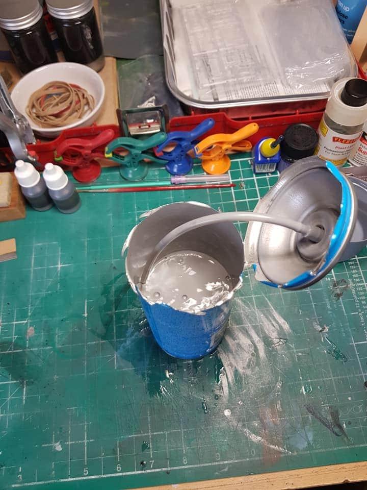

OldNYJim Posted July 21, 2020 Posted July 21, 2020 I’ve got a BUNCH to try decanting seeing as I seem to be having a run of them lately that have clogged themselves. Just got refunded on a can today from Amazon that clogged the first time I used it and spat paint everywhere. I think my trick will be piercing the can to let the propellant out, let it sit overnight (NOT inside!? ) and then slice the top off and put it in a different container. HATE wasting perfectly good paint!

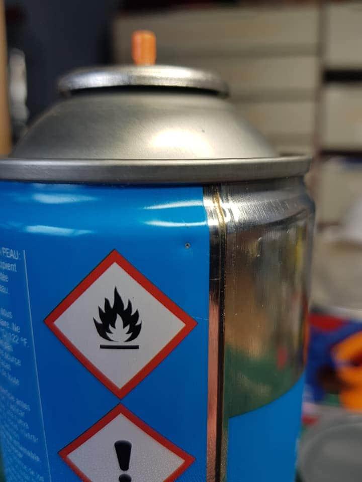

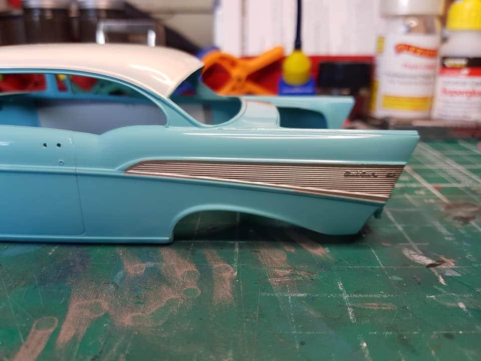

GeeBee Posted July 21, 2020 Posted July 21, 2020 (edited) The only time I've used Rustoleum paint on a model was some Stainless steel I had left over from a different job, I knew spraying it from the can would be a nightmare to try and spray the side trim panels on the 57 Bel Air, so j decanted it and airbrushed it, sprayed a treat, like everything I decant from the can, I pop a pin hole towards the top of the can and once the gas has escaped I agitate the paint until it no longer boils, then it's time to pop it into a glass bottle The aerosol can I've photographed here is a different brand, but it doesn't matter what brand of paint it is, I use the same method. Edited July 21, 2020 by GeeBee 2
