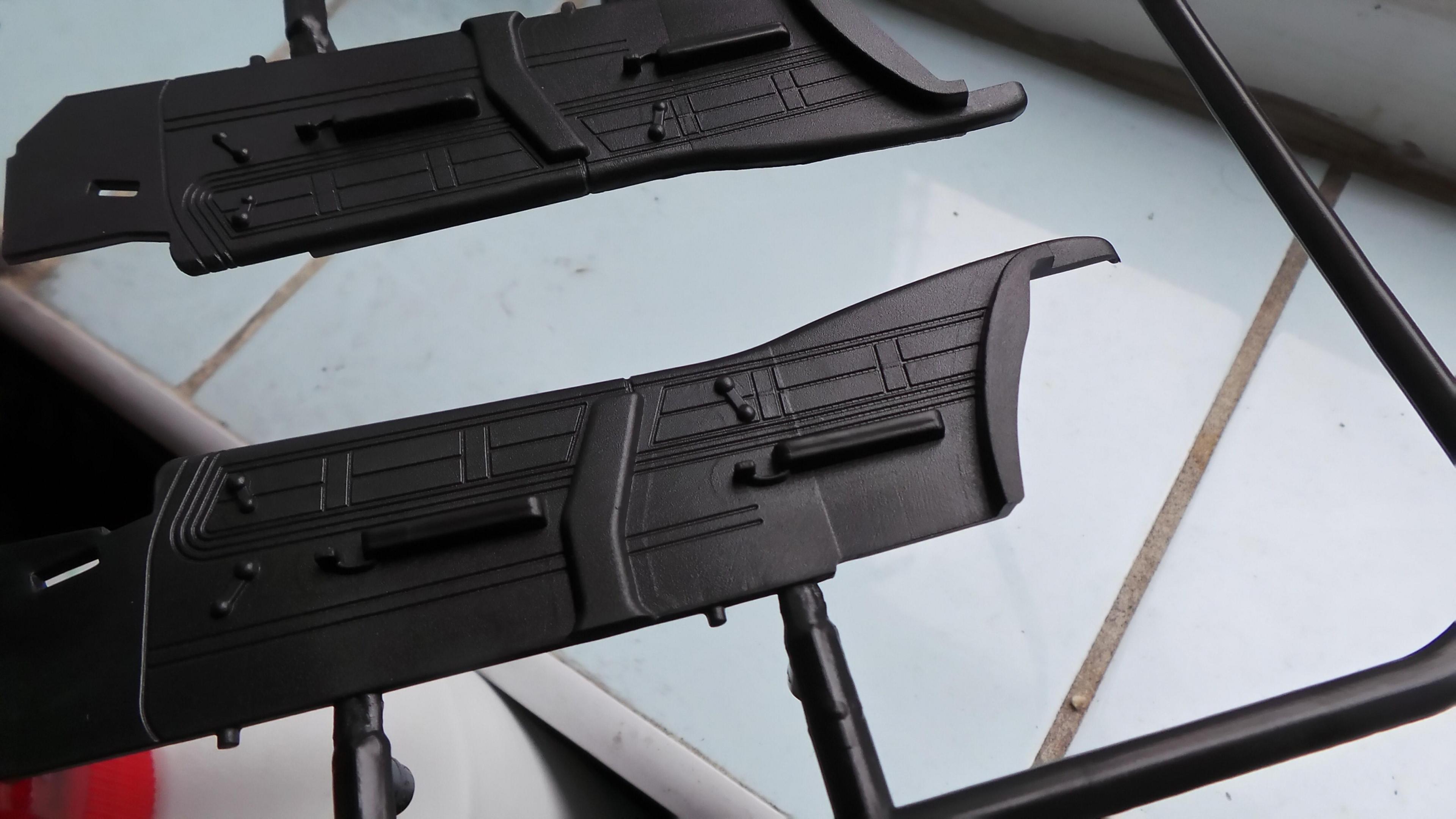

espo Posted August 1, 2020 Posted August 1, 2020 1 hour ago, doorsovdoon said: Found something interesting on the door cards in this kit. You can see the seem line where it looks like they've used the mould from the two door to make the four door panels. Hope they didn't butcher the two door moulds to make this! I agree on this door panel. I hadn't noticed that until now. The '67 SS has been a pretty good seller for Round 2 so I wouldn't think they would destroy the interior mold.
doorsovdoon Posted August 1, 2020 Author Posted August 1, 2020 It's possible they made a whole new mould for the two door and repurposed the old one for this.

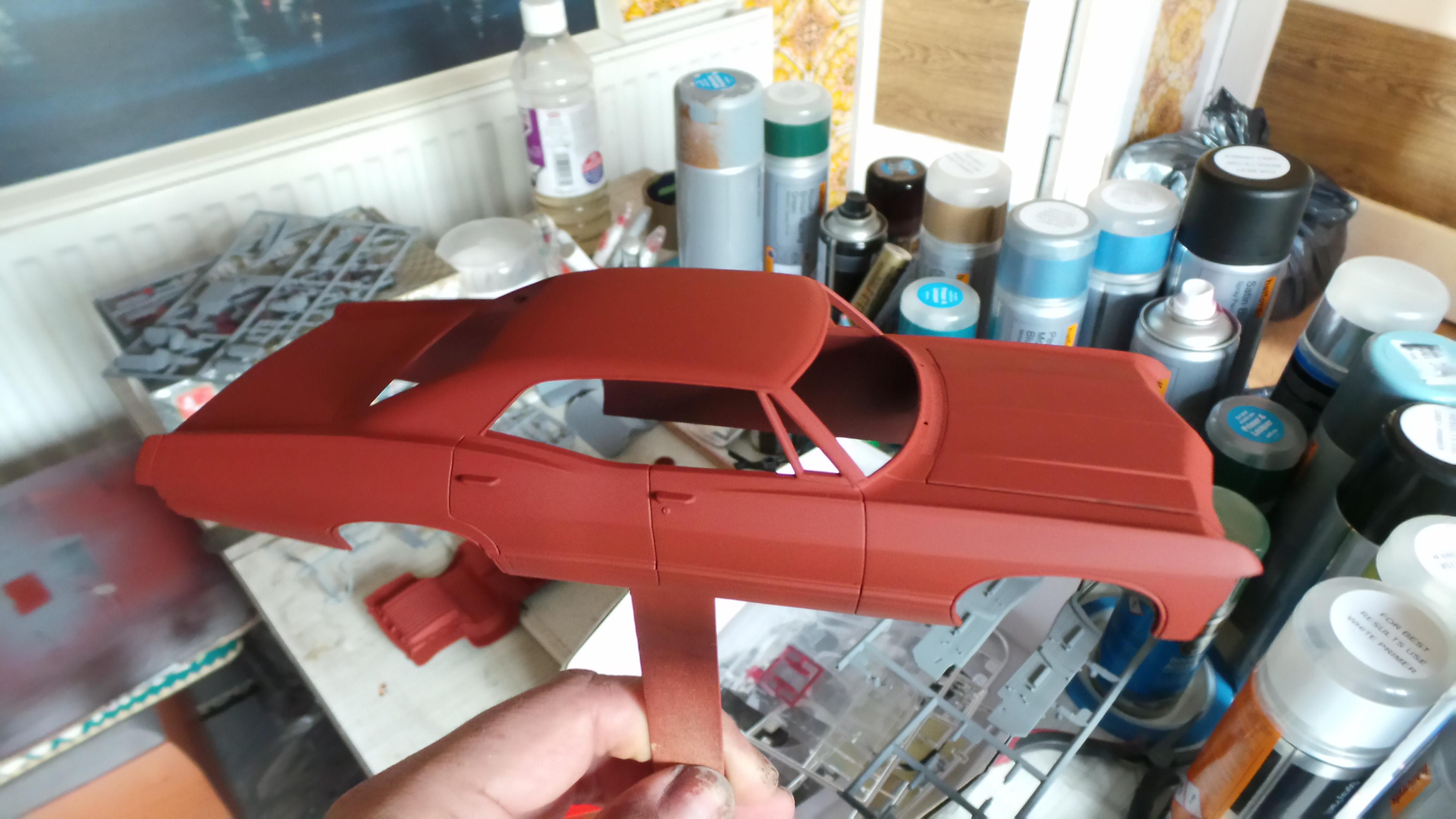

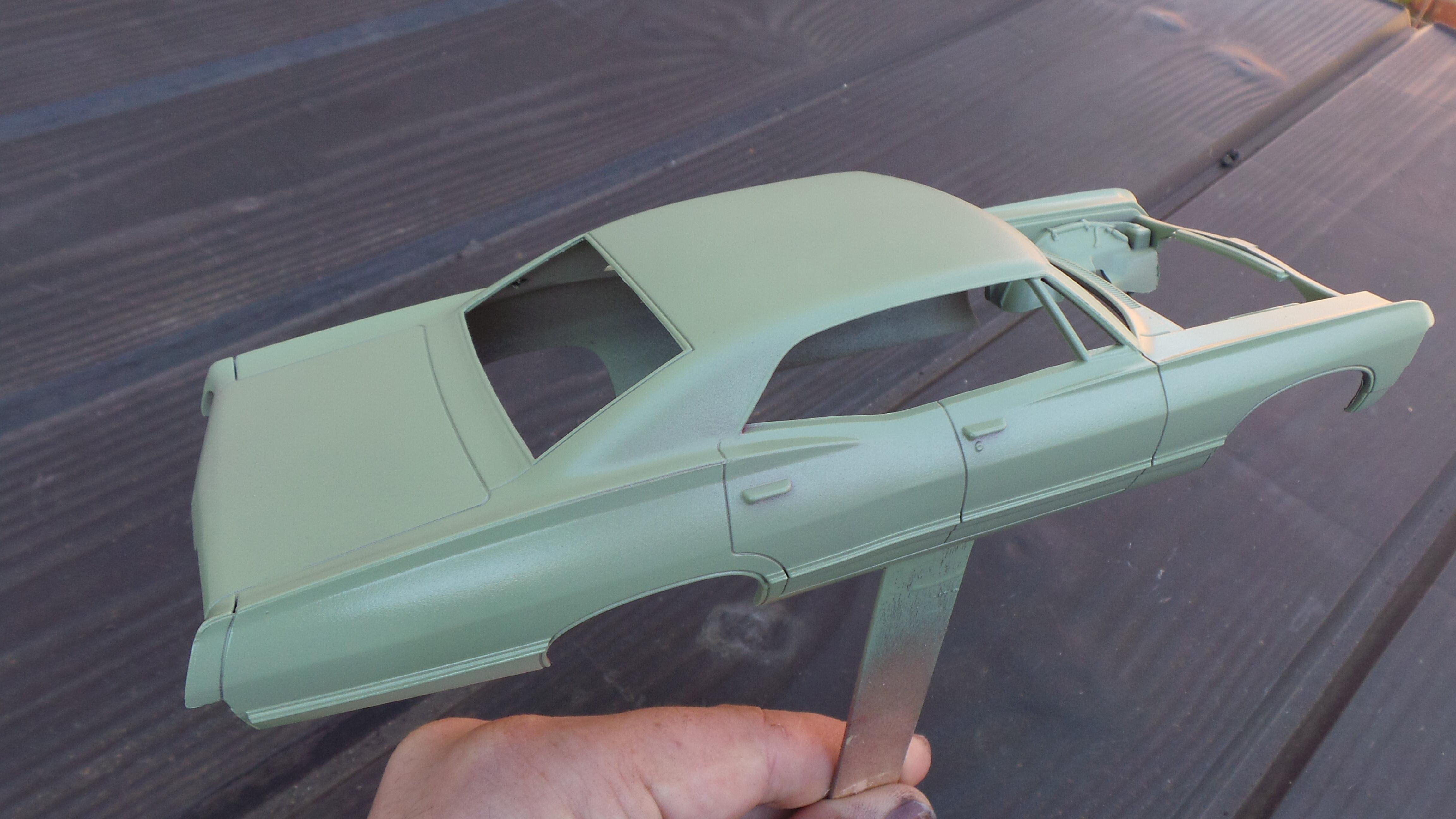

doorsovdoon Posted August 1, 2020 Author Posted August 1, 2020 Got the primer coats on, black first then this red oxide colour. I'm going with this green I picked up on offer. If it doesn't look right, I'll paint it some other colour over the top of it and say it was repainted at one time which will show through when I do the weathering. I'll either do a black interior or white.
doorsovdoon Posted August 1, 2020 Author Posted August 1, 2020 hmm, I'm not really digging this colour. Looks more suited for a military vehicle?

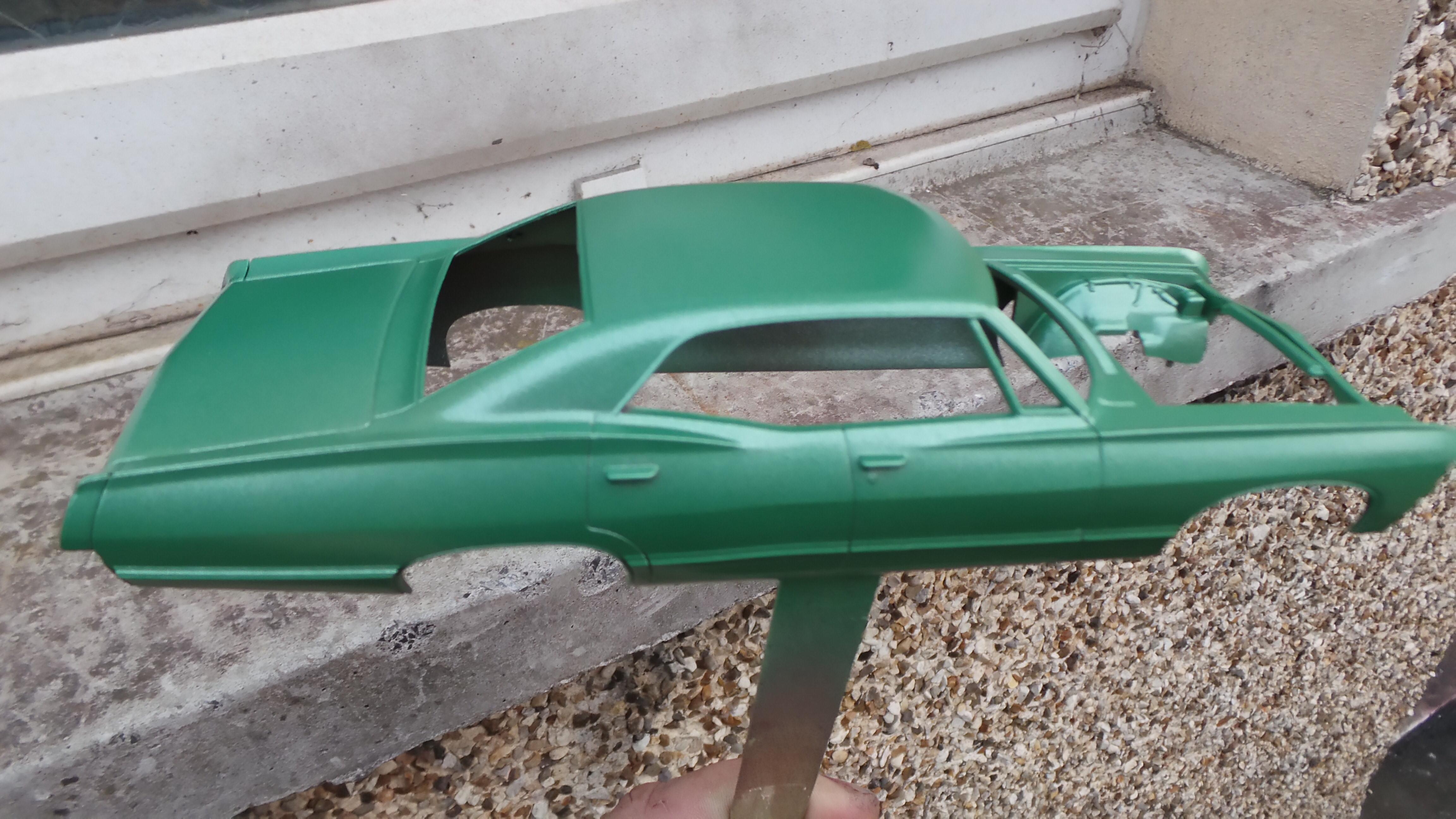

doorsovdoon Posted August 1, 2020 Author Posted August 1, 2020 Yeah, a little bit. Looks a lot paler on the real car. A vinyl roof might work, it would take the eye away from all that green maybe. I'll have to have a think on this. If I go with this green I'll do a vinyl roof, if not, I'll paint the whole car Jade Green, a colour I nearly went for earlier.
doorsovdoon Posted August 1, 2020 Author Posted August 1, 2020 Yep, I'm going with Jade green. Looks so much better, almost a shame to scuff it all up for weathering!

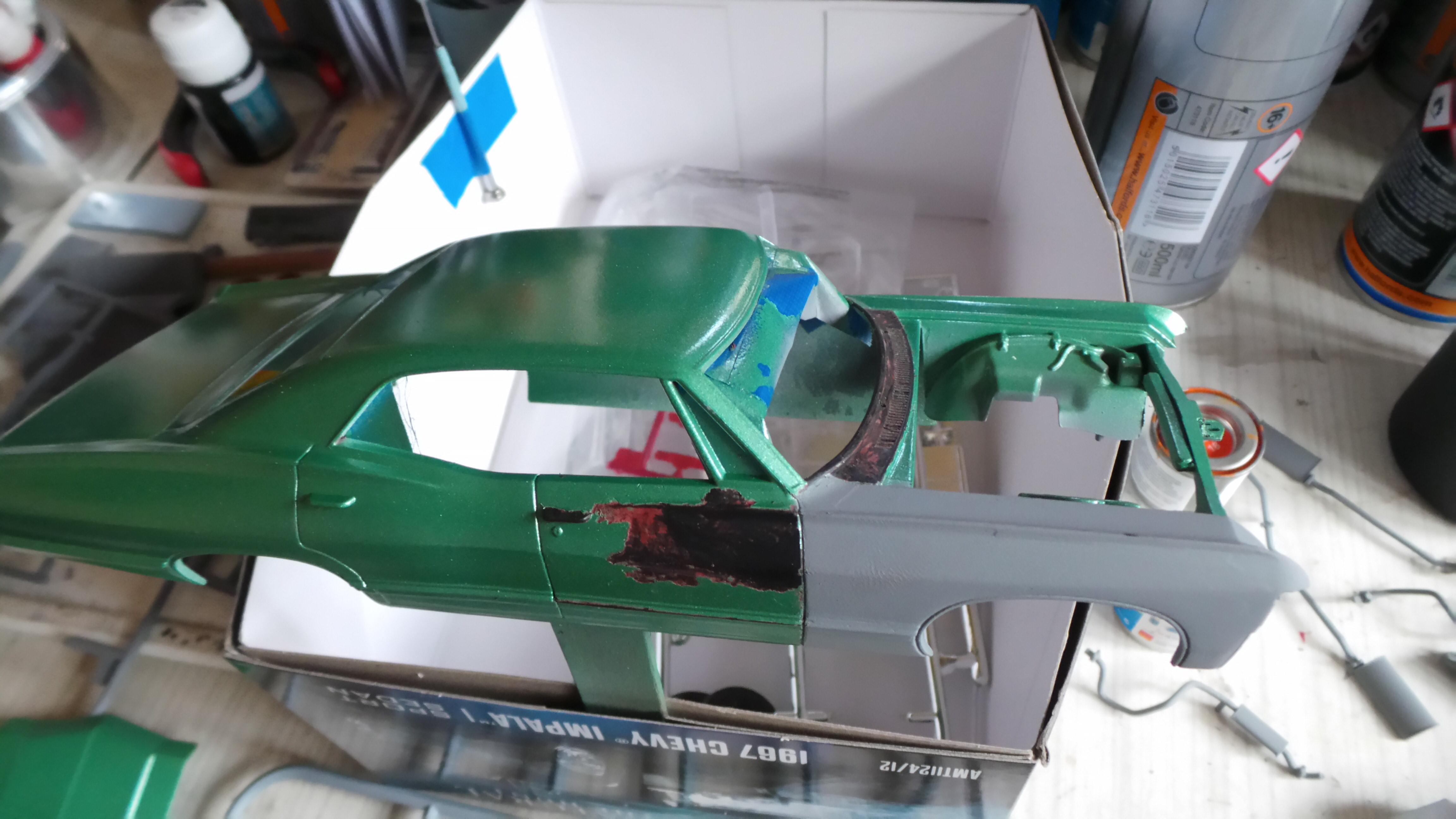

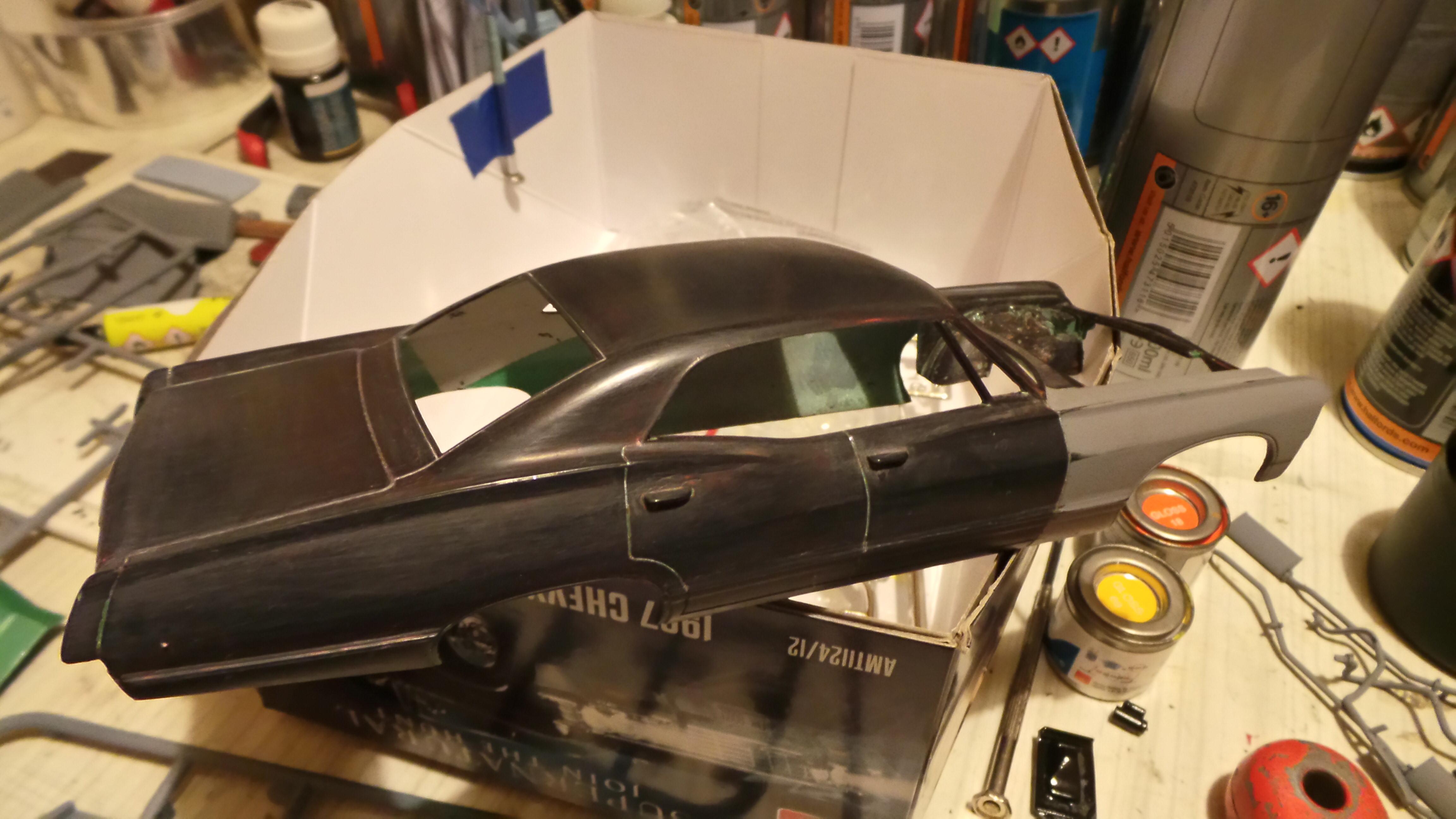

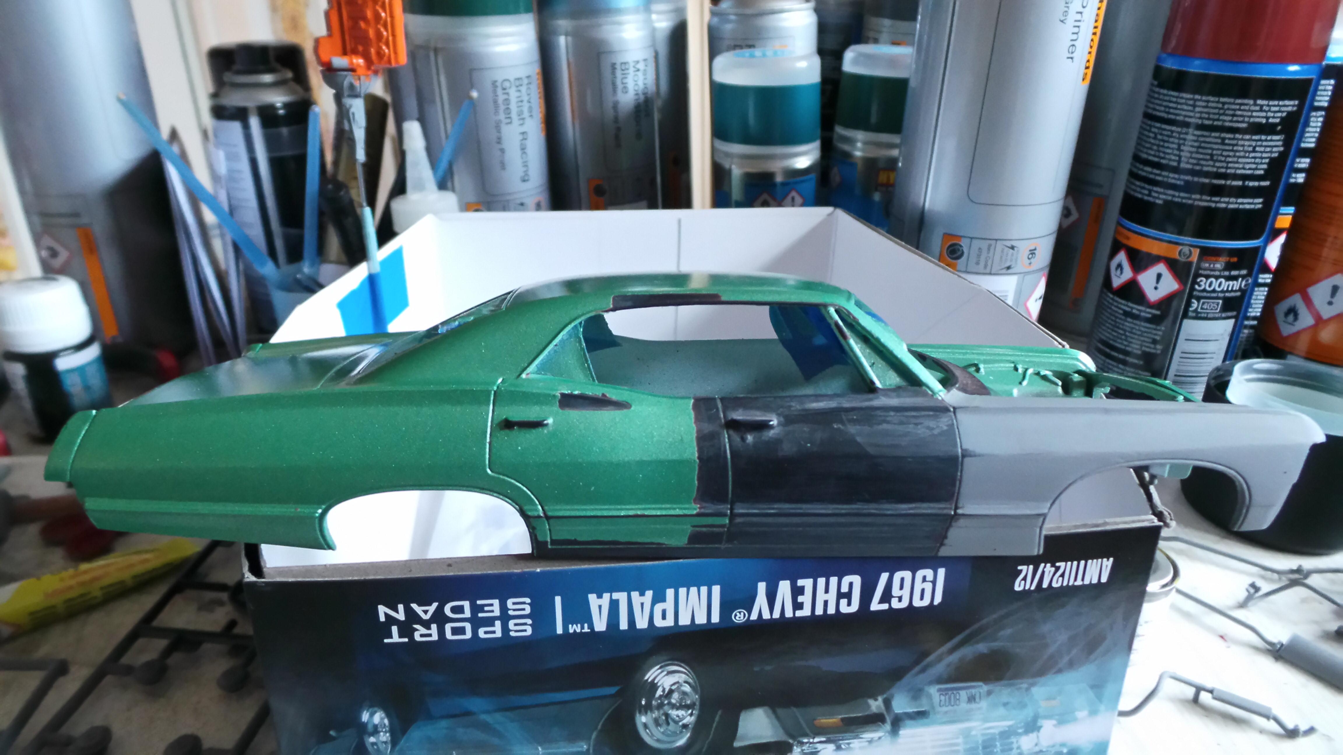

doorsovdoon Posted August 3, 2020 Author Posted August 3, 2020 Every time I touch this car with masking tape the paint keeps coming off, the whole front wing stripped itself clean. Seeing as this is going to be a weathered car, I painted the wing in grey primer but on removing the masking tape the paint again peeled off the door and windscreen panel. I've never had this trouble with paint not sticking. There is so little bond to the plastic that if I hold it for too long the paint actually comes off from my fingerprints alone. Is it something to do with black plastic that this kit is moulded from? The kit was washed of all mould release before paint. Maybe I need to scuff up the plastic with wire wool, like on a real car! Lol
doorsovdoon Posted August 3, 2020 Author Posted August 3, 2020 (edited) 28 minutes ago, Deuces ll said: Did you use Duplicolor primer?????..... No, the same primer I always use from the local motor factors, Halfords. EDIT: I used a red primer from Halfords which I've used before with no issues, but I did use a black primer by Motip which I've never used before. Might be that, but I've never had issues with that brand when it comes to paint. Edited August 3, 2020 by doorsovdoon
Spottedlaurel Posted August 3, 2020 Posted August 3, 2020 Oh, that's a shame. That was what put me off masking anything for years and years, something I've only just managed to get beyond. Might be best to strip it and start again? That's when you'll find that it won't come off......
doorsovdoon Posted August 3, 2020 Author Posted August 3, 2020 Yep, did it again when I wanted to primer the door! I'm just chasing the damage. I'm going to have to strip the paint off this. Easy enough, all I have to do is cover it in masking tape, Lol!
doorsovdoon Posted August 3, 2020 Author Posted August 3, 2020 (edited) Paint is off and I've scuffed the body up with a brillo pad, so hopefully the paint will stick this time! The grey primer isn't budging and that's on un-scuffed plastic, so I'm betting it was the black primer that was the issue here. Edited August 3, 2020 by doorsovdoon Including additional info

doorsovdoon Posted August 3, 2020 Author Posted August 3, 2020 1 minute ago, Deuces ll said: Why didn't they mold the parts in white styrene????..... I'm just thinking out loud over here....? Not sure to be honest. Maybe for beginners to make a quick build? I don't think the plastic was the issue with this, I'd say it was the black primer.

Jantrix Posted August 4, 2020 Posted August 4, 2020 19 hours ago, doorsovdoon said: The grey primer isn't budging and that's on un-scuffed plastic, so I'm betting it was the black primer that was the issue here. That could be. Also, where I would hesitate to debate Tom in matters of weathering, as the body is molded black, adding a black paint layer probably isn't necessary. I've done a few projects like this and my method is similar to Toms, where I use red and grey primer, but I layer them based on which color will contrast better with the top coat, and that one goes on last. Then a very light coat of a color, and then my top color. This could offer the effect that the car was painted more than once in the past, again I use a contrasting color like white. Get a very low tack tape and when it's time to sand, 600 grit wet with very little pressure.
doorsovdoon Posted August 4, 2020 Author Posted August 4, 2020 4 hours ago, slusher said: I really hope it works out for you.. Thanks mate. Yeah, it's all good. I've just painted the headliner white again, I always paint the headliner first, so just waiting for that to set so I can mask it off.
doorsovdoon Posted August 4, 2020 Author Posted August 4, 2020 Thanks, Rob. Black plastic go's grey when scuffed up, it can be polished back to black but then looks like shinny black paint, I can see the reasoning for black primer on black plastic. Anyway, I won't be using that black primer again. I'll probably do a lighter weathering, like a lightly sun burned paint job showing areas of red primer, either that, or factory fresh box stock. "Stick to what you know" speaks loudly to me, Lol!
