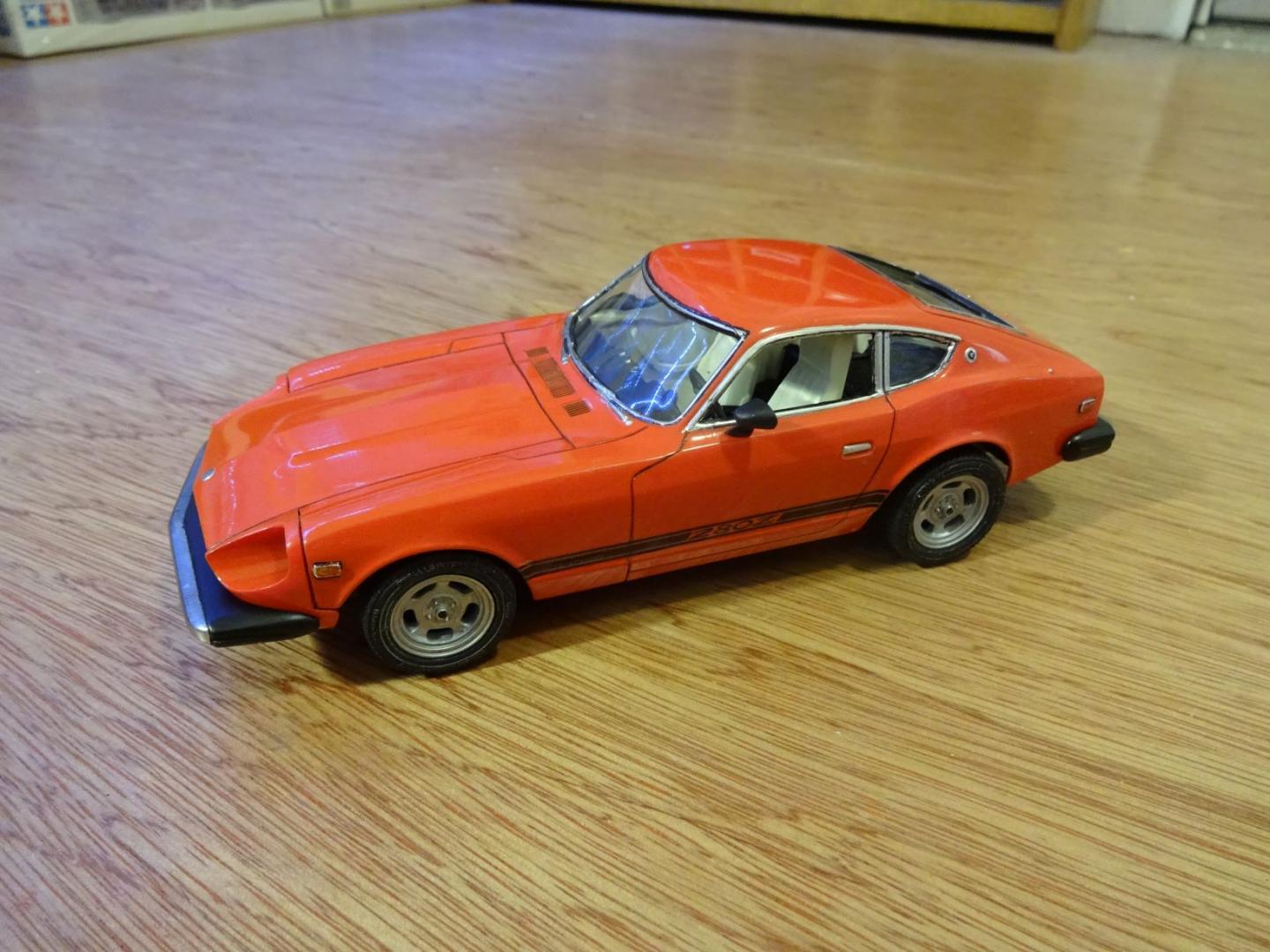

http://www.modelcarsmag.com/forums/uploads/monthly_2019_01/DSC04407.thumb.JPG.b457d0a3e9a64f0c316d229e57afcf74.JPG

http://www.modelcarsmag.com/forums/uploads/monthly_2019_01/DSC04407.thumb.JPG.b457d0a3e9a64f0c316d229e57afcf74.JPG 257.34 kB · 0 downloads
