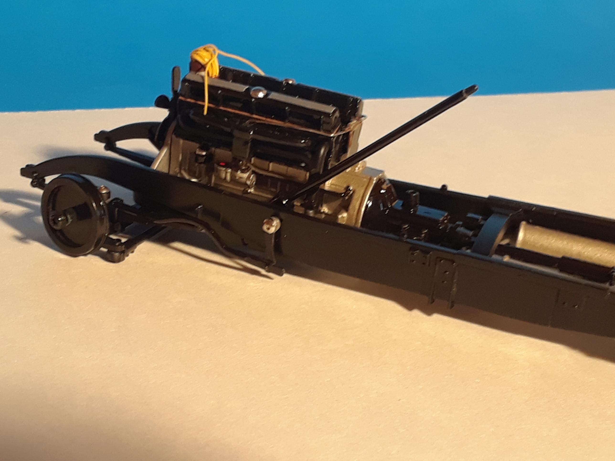

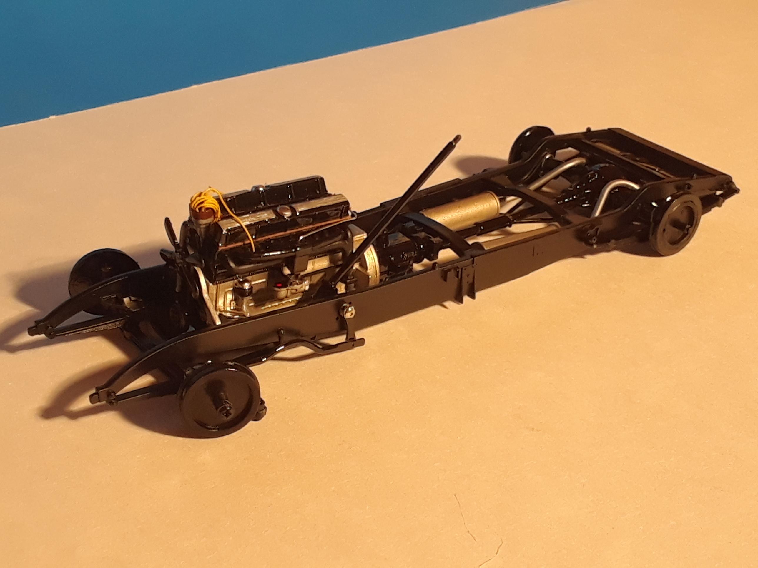

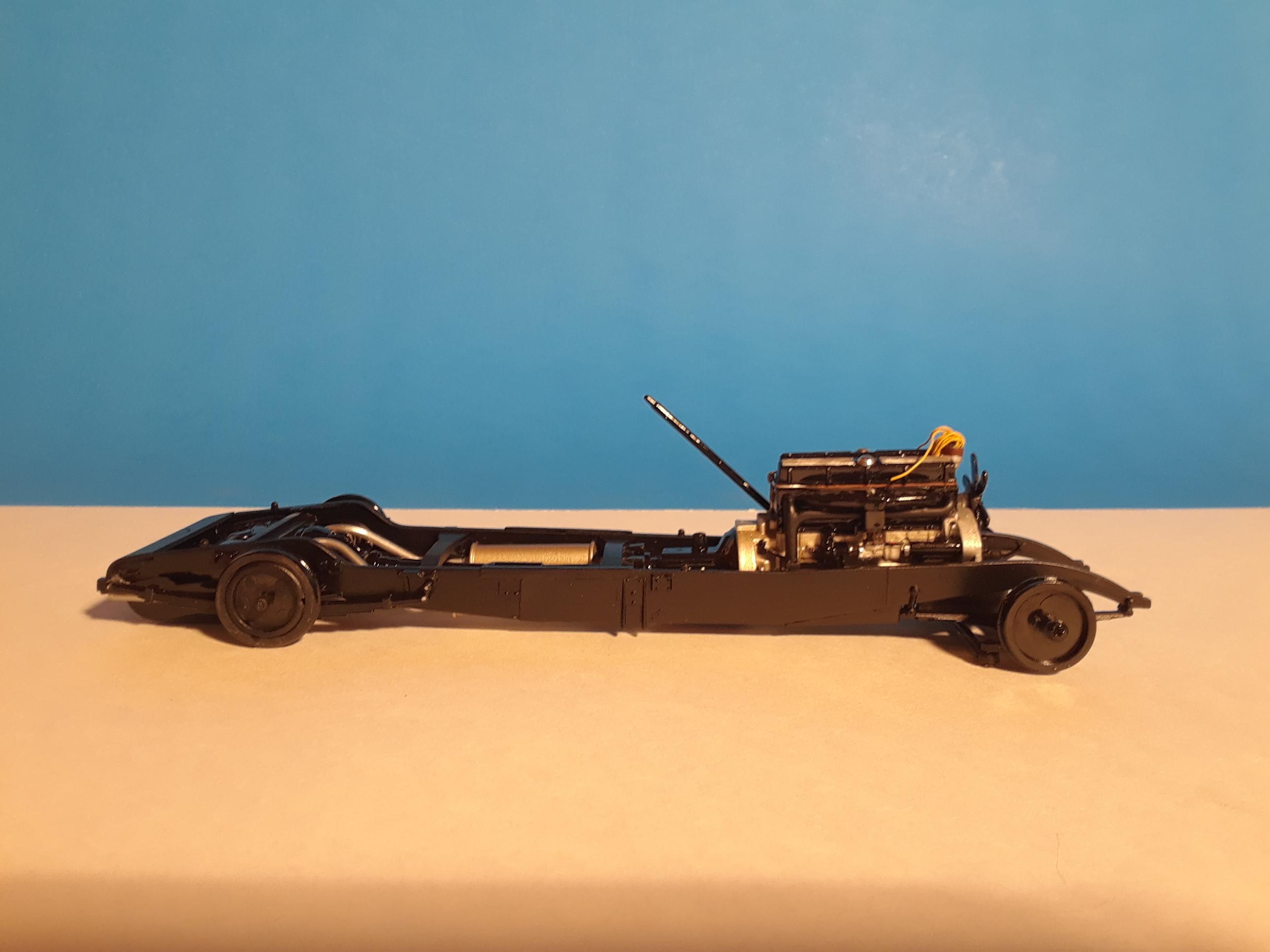

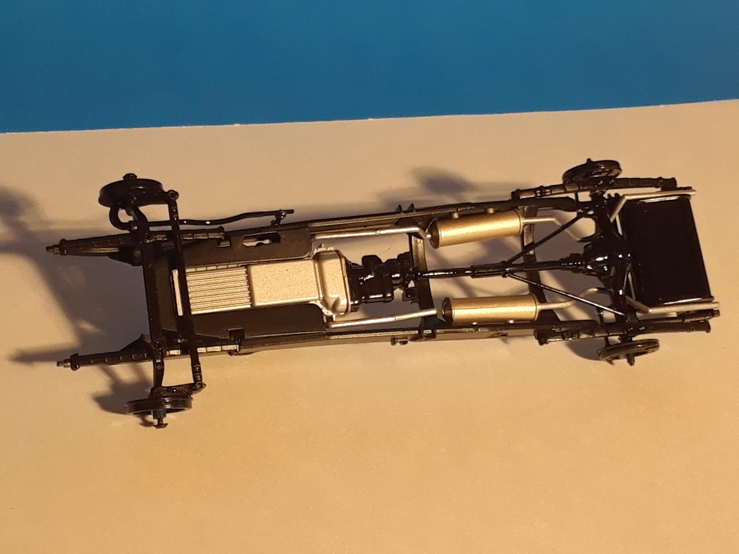

Hoffman Posted August 22, 2022 Author Posted August 22, 2022 Hello Guys! ? Ok, latest update, here's the completed engine and chassis. Quote

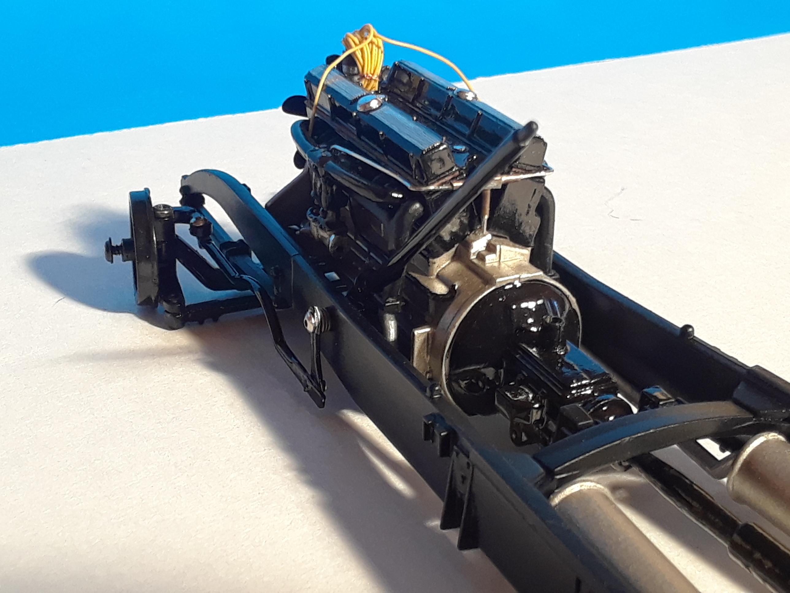

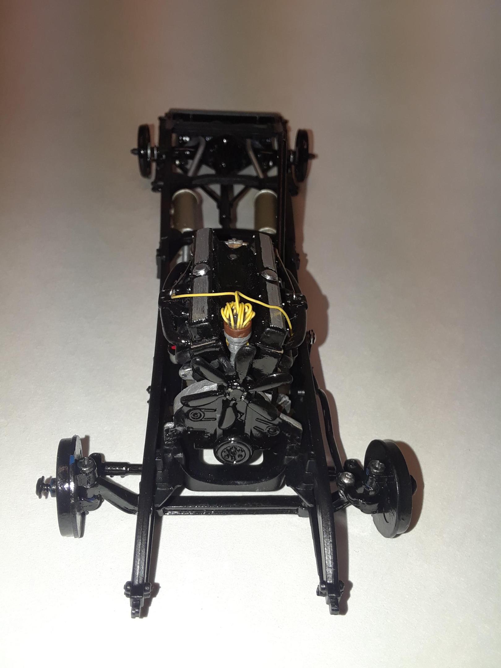

Hoffman Posted August 22, 2022 Author Posted August 22, 2022 The chassis is Italeri, shortened from a scale 149" to 143", matching the car I'm replicating. The front axle is from a Franklin Mint '32 Cadillac. The engine is the Italeri V-16, with some modifications. The valve covers are from the Monogram '32 Cadillac. I used the intake and exhaust manifolds and carburetors as well. They're slightly larger than the Italeri pieces and look more authentic. I made the distributor from several sizes of aluminum tubing, and yes, there are sixteen individual plug wires in the bundle. The two stray wires go to the twin ignition coils that are mounted in the top of the radiator. Next set of pictures are full size '33 Cadillac for reference. Quote
Hoffman Posted August 22, 2022 Author Posted August 22, 2022 One thing I noticed while pouring over photos is the valve cover gaskets. From the right angle, they're pretty noticeable on the full size engines. I think they're cork. I thought it would be fun to replicate that. I did it using thin paper gasket material from Napa Auto Parts. The thickness was about right for the scale model and the color was right. For the chrome pipes you see running from the top of the intake manifolds to the back of then engine, I used thin stainless safety wire, bent and routed appropriately. The 'T' fitting behind the cylinder heads is bits of brass tubing that I soldered together. Quote
Hoffman Posted August 22, 2022 Author Posted August 22, 2022 (edited) Thanks, Guys! Here's some close up shots. Edited August 22, 2022 by Hoffman Blury. Let's try again. Quote

Perspective Customs Posted August 24, 2022 Posted August 24, 2022 Beautiful work. Only thing, the spark plug wires may be a bit out of scale. Quote
