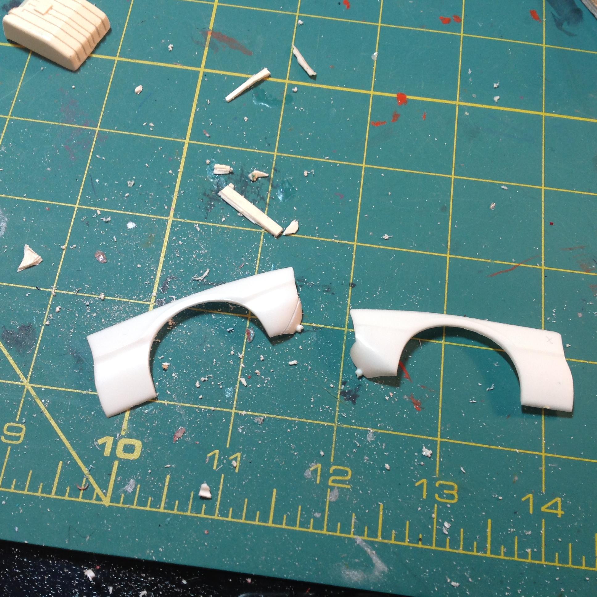

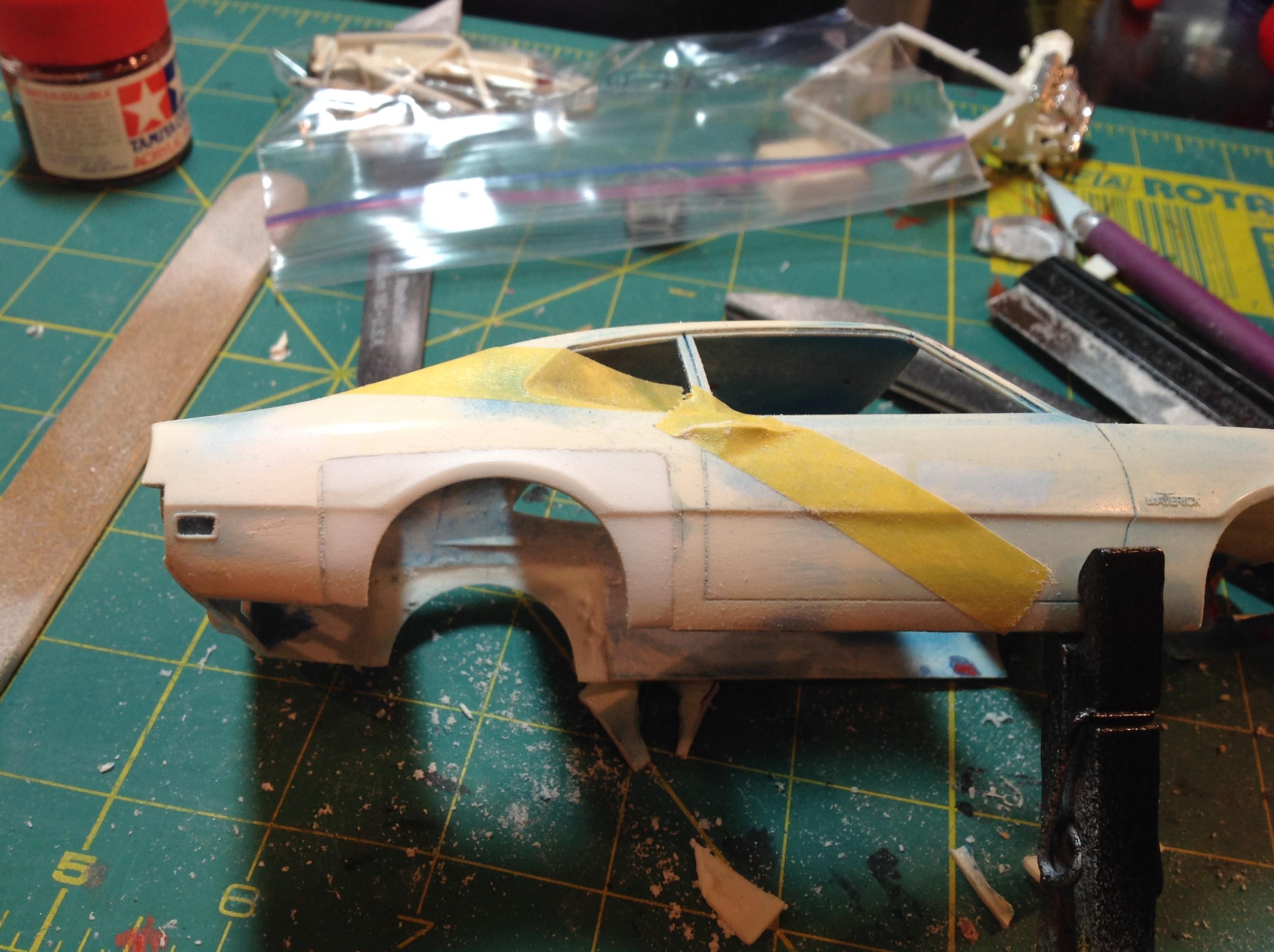

Back in 2017 I posted a repair I did on an EBay  Maverick find where the rear wheel openings were butchered and I repaired them. I’m finally getting back to this build. I’ve collected parts from AMT 67 Mustang and the Revell Nova kits to do the build .
Nice! Great job on fixing the rear wheel openings! I never knew Slixx had that sheet, and I often look close at their quarter panel sheets as I have found some treasures in them before.

Did the replacement wheel opening come from another Maverick body?
The post is buried some where back in 2017, I used the left over front fenders from the Multi Maverick AA/GS MPC kit.

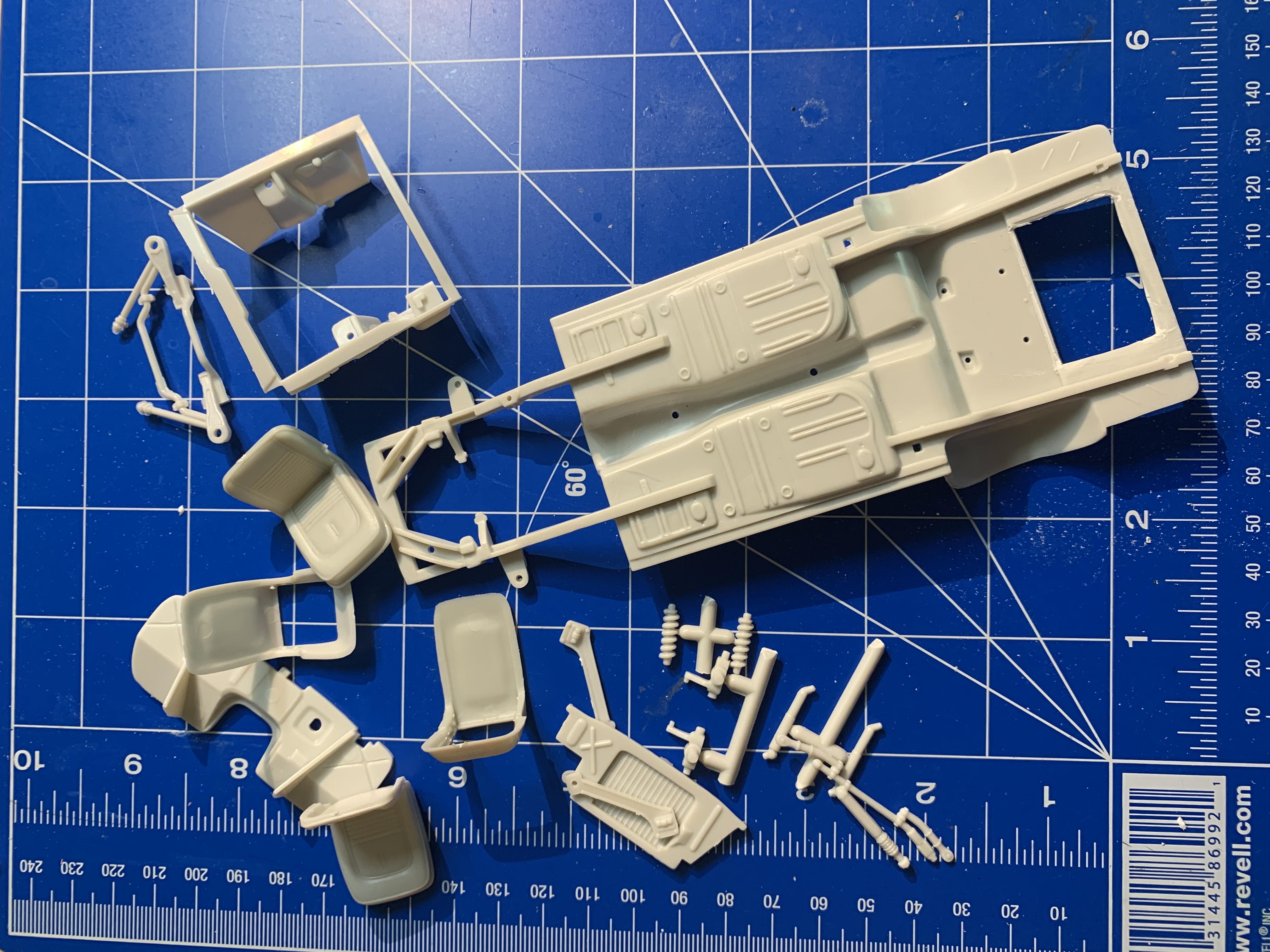

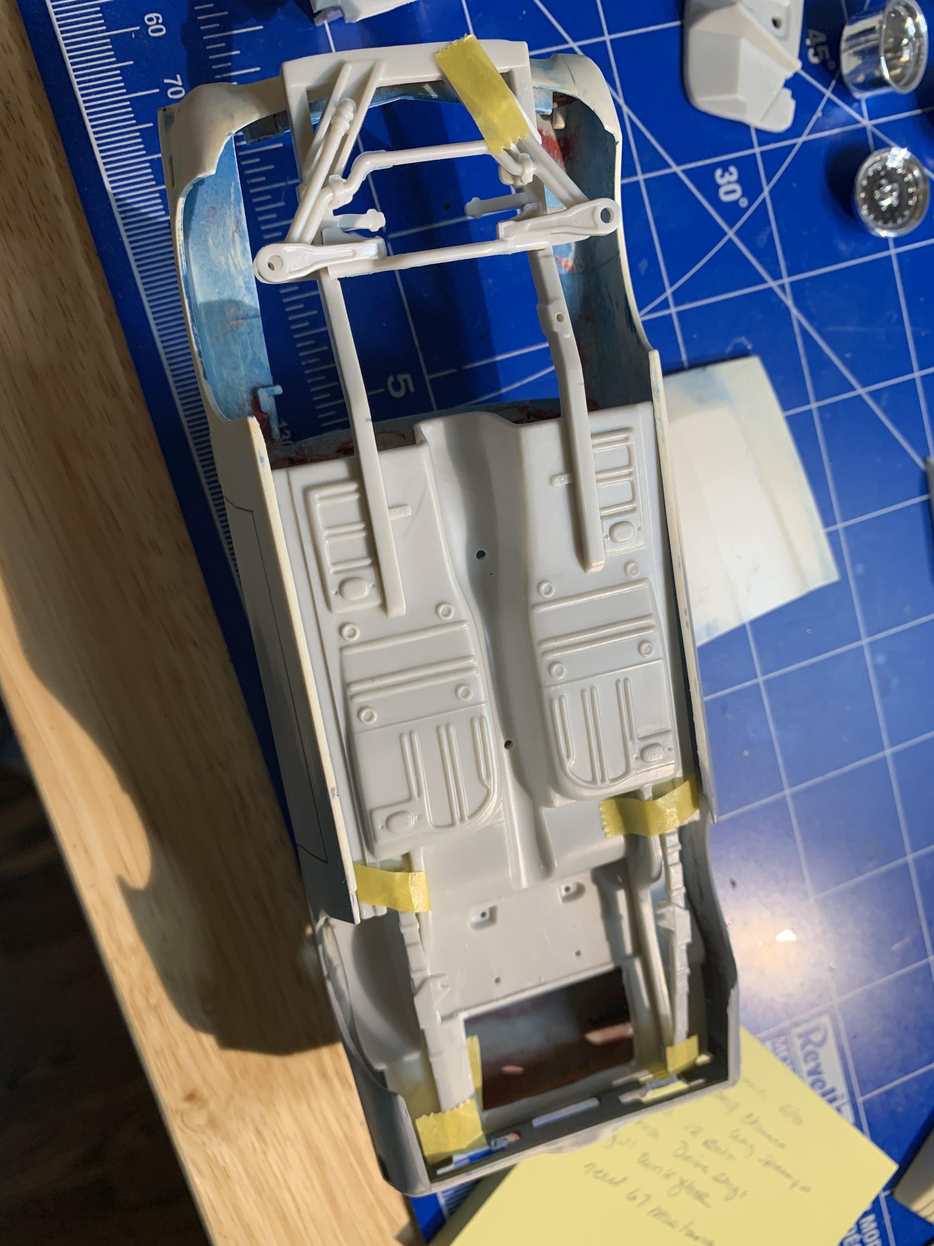

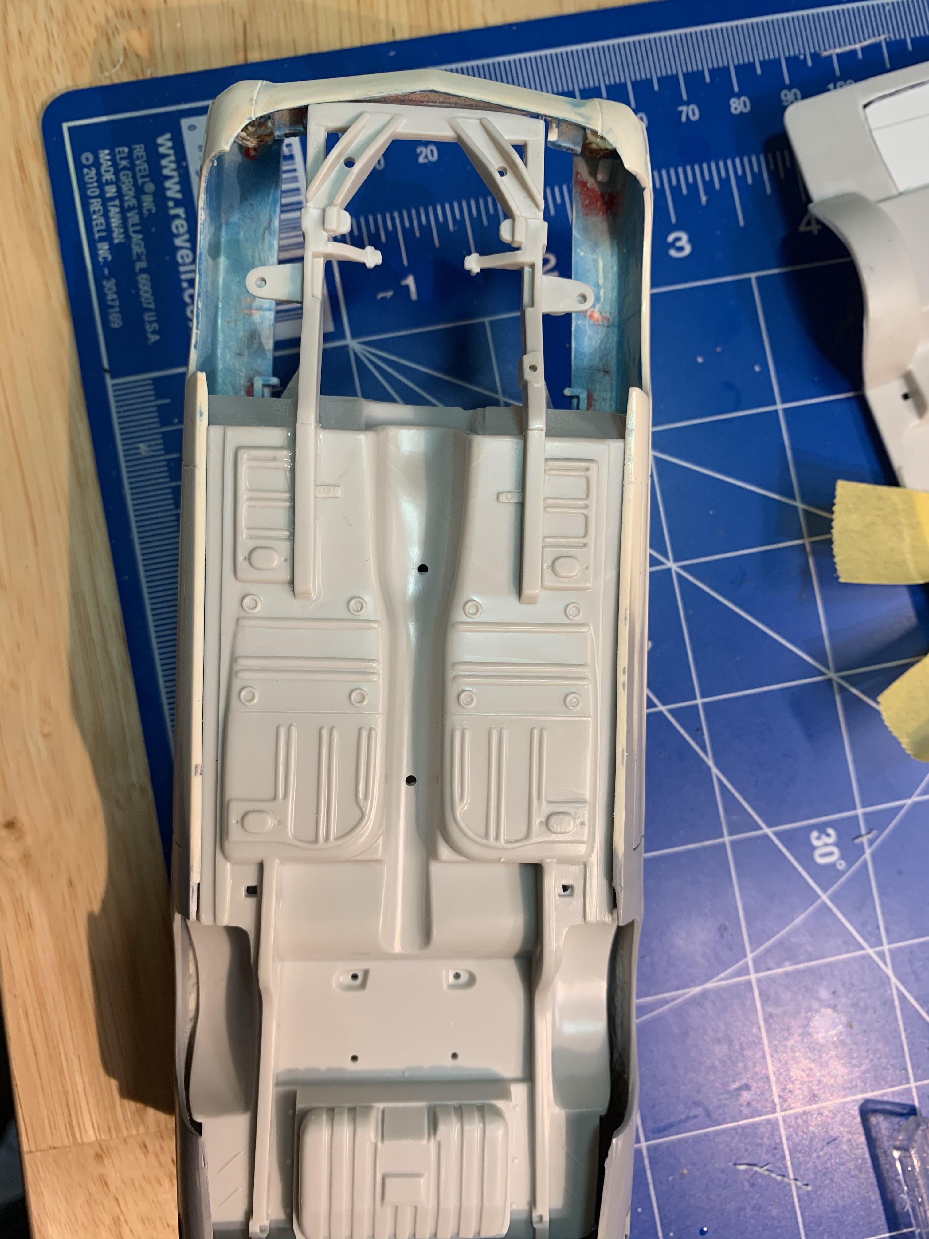

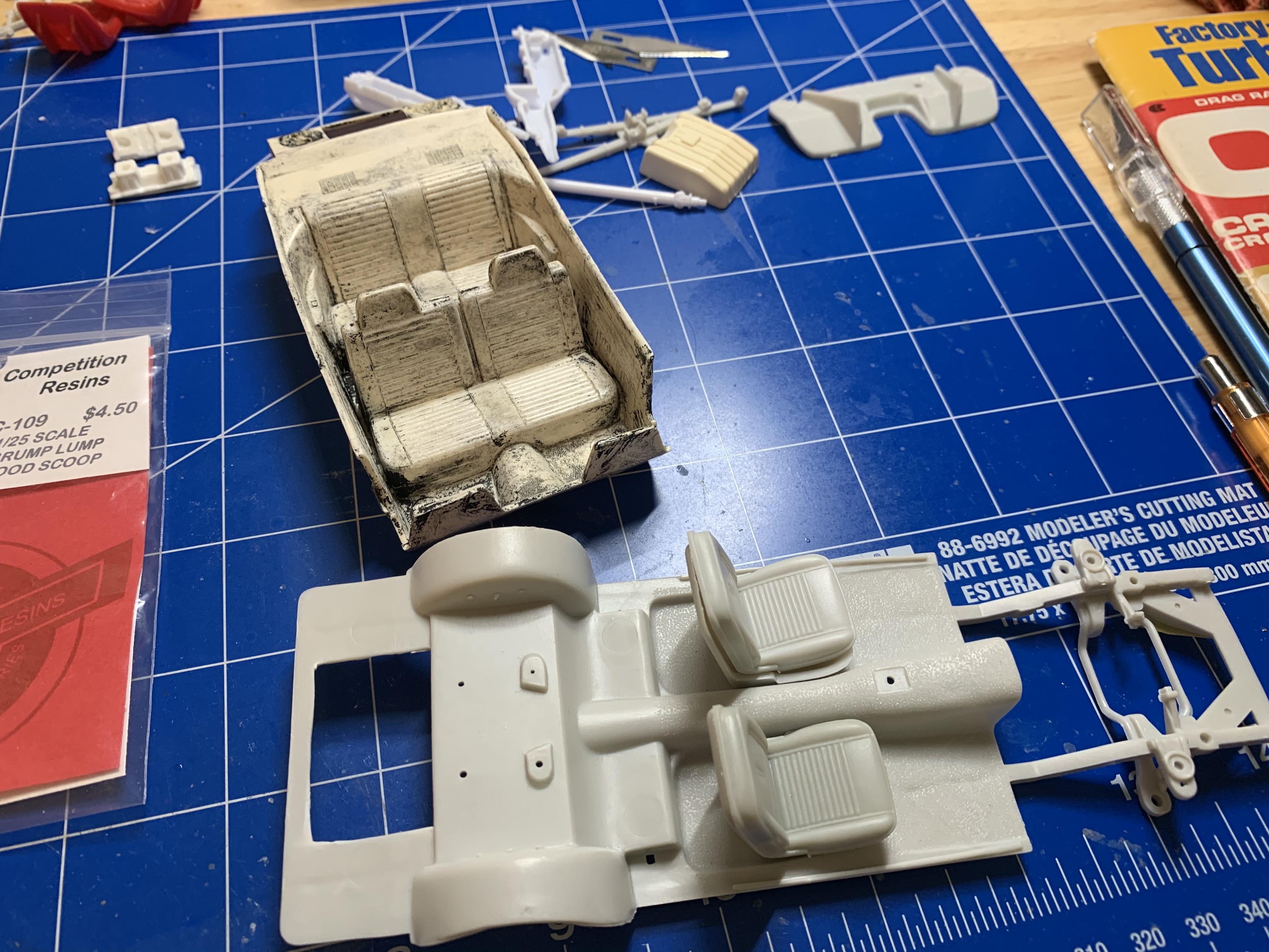

Ok I’ve finally got a couple things finished up and I can concentrate on the Maverick. When I started this, I pulled the AMT 67 Mustang kit for the chassis as the original Johan chassis leaves a lot to be desired, and the one that came with mine was a mess. I pulled several other kits for other options, the AMT 67 Shelby Mustang has the same parts as the AMT 67 Mustang, the 68 AMT Shelby Mustang is old school with an inaccurate chassis pan, seems like the 67 chassis parts would fall into the 68, making it a much better build. I tried the Revell 69 Mustang SCJ kit and it’s not a good fit. The Revell 68 Mustang needs way too much work to work.
Returning to my original thought, and test fitting it, it’s amazing how well the firewall fits. The front frame rails need shortening only a small amount. I had already removed the fuel tank from the Maverick and the Mustang . I will use the Maverick tank.
The rule book states no light weight aftermarket seats, any factory seat is allowable. I have no reference for the interior of the actual car, so I may have to get creative.

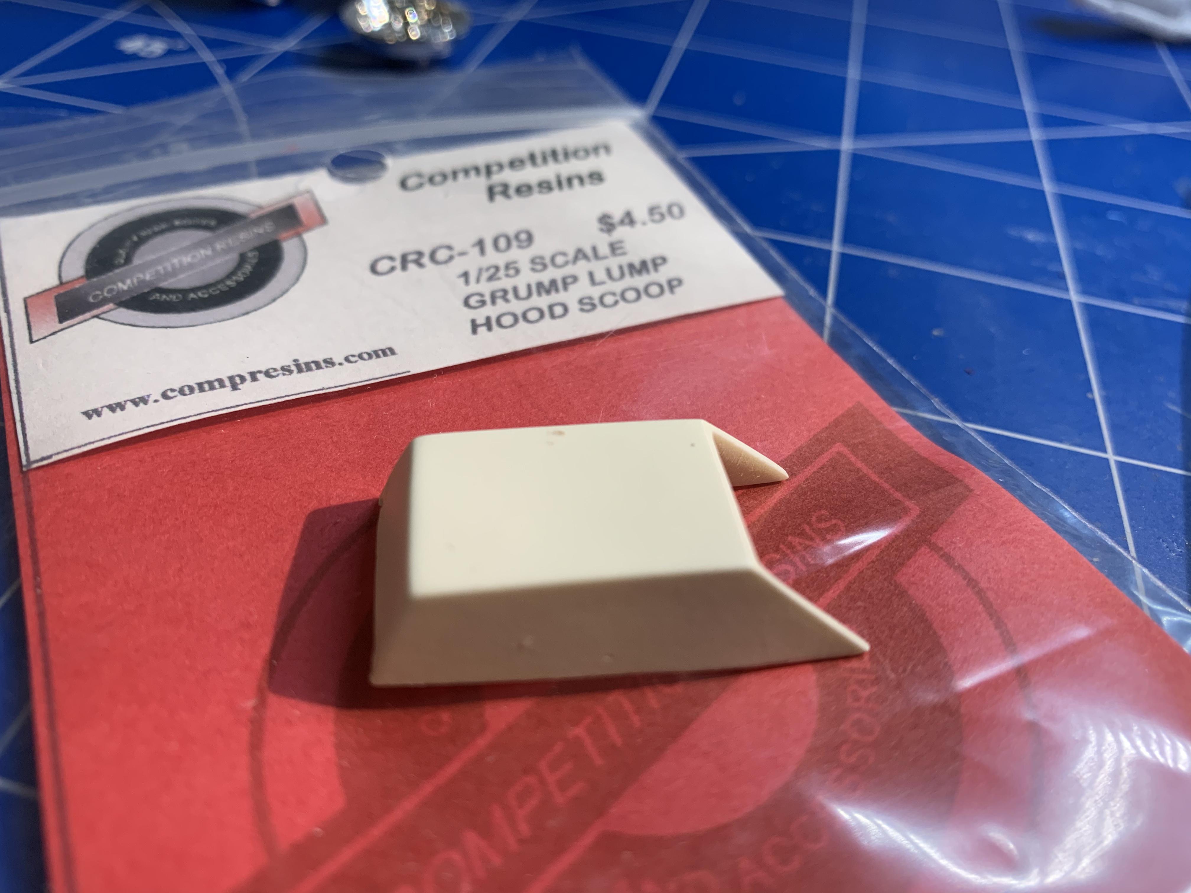

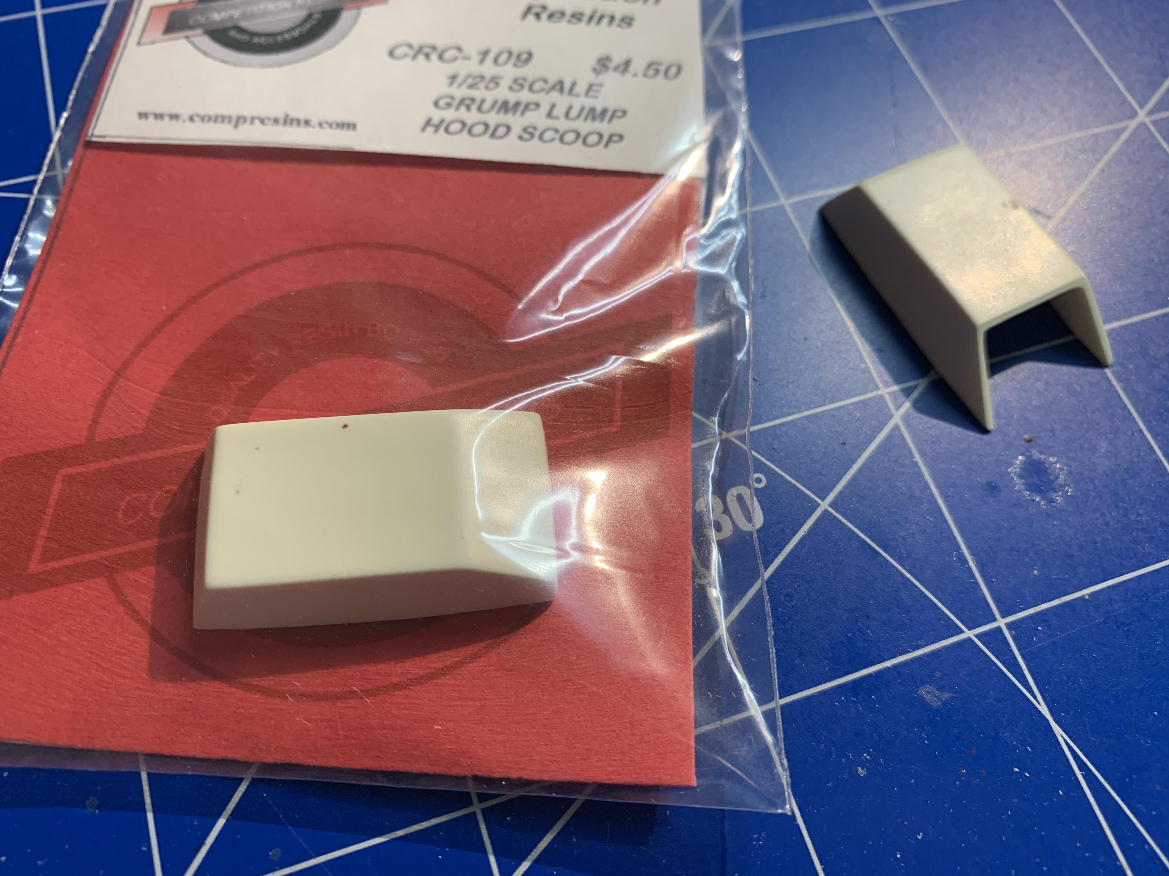

I used a Comp resin Grumpys toy scoop and cut the end off at an angle , looks pretty good.

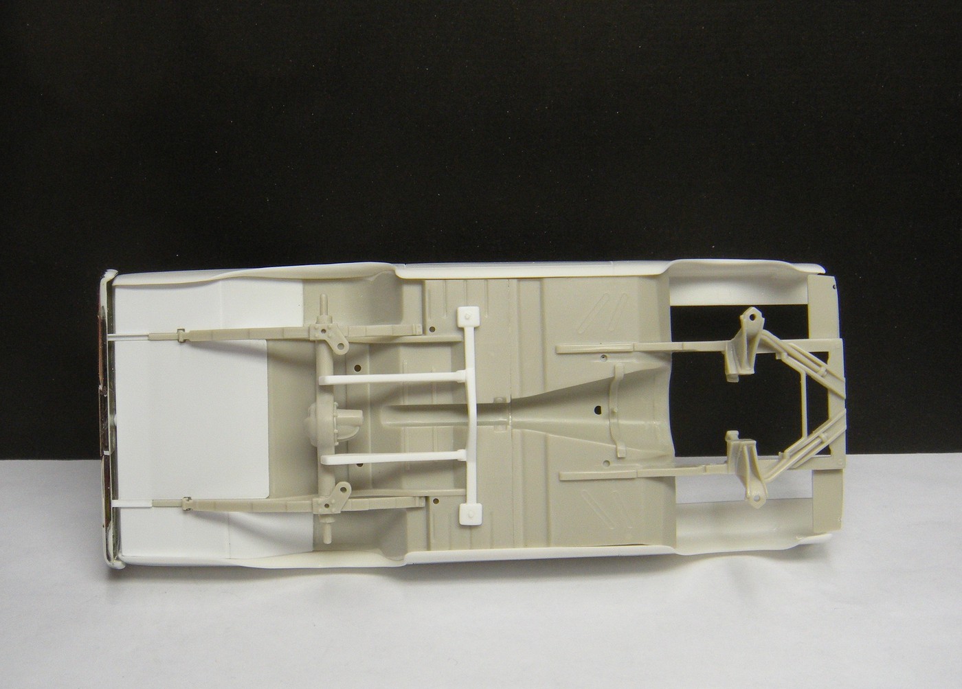

The '67 Mustang chassis does look like a good fit.  I'm using the chassis from the Mobius A/FX Comet for my "65 Falcon AWB project - might be worth looking into for your project.  The stock Comet chassis might be better choice as the A/FX kit has the raised front suspension and your Maverick looks like it had a nose down stance.

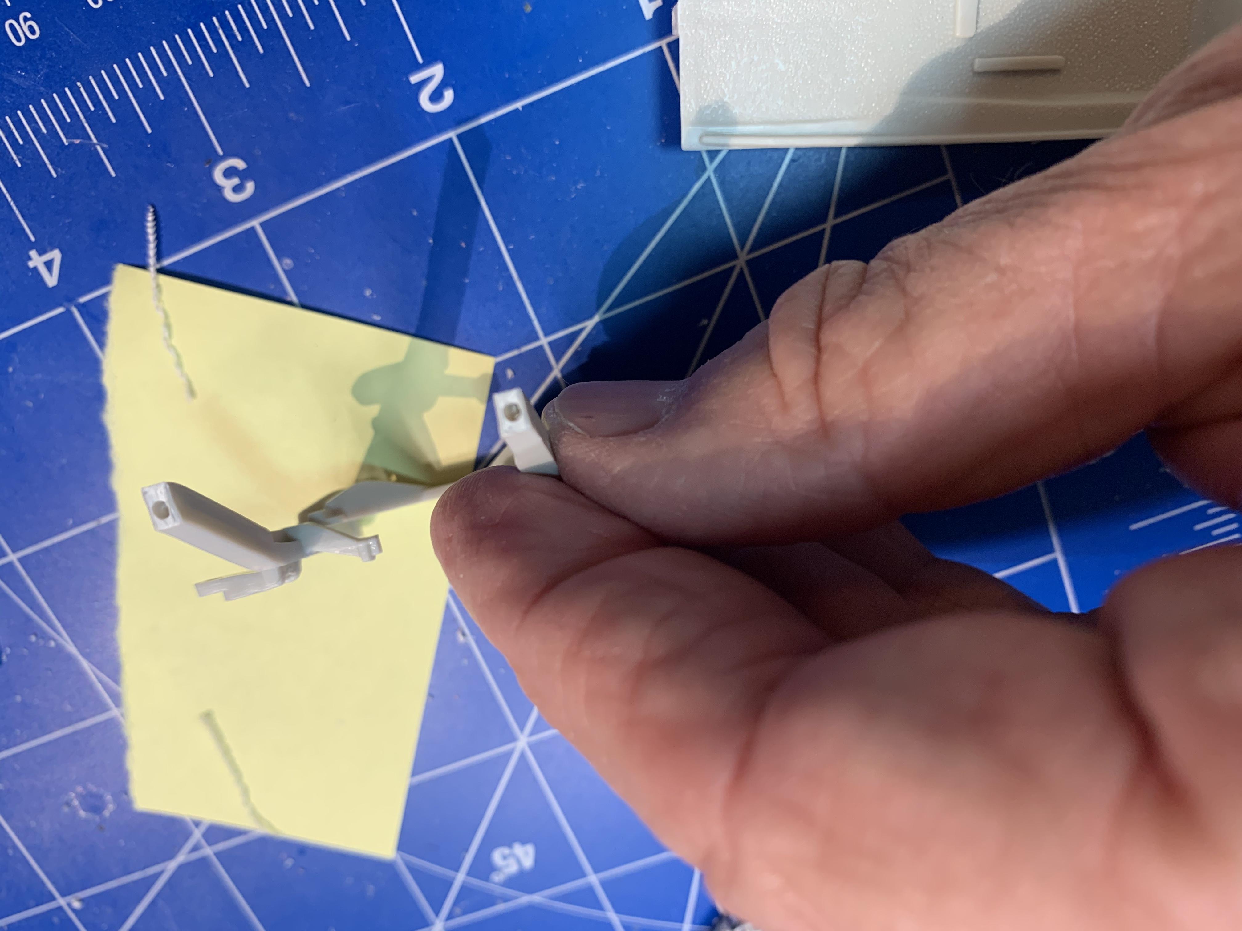

I adapted the traction bars from the Revel T-Bolt kit.

I actually looked into the Comet chassis, and the rules for Modified stated stock chassis so the Mustang is a better fit for this particular car.

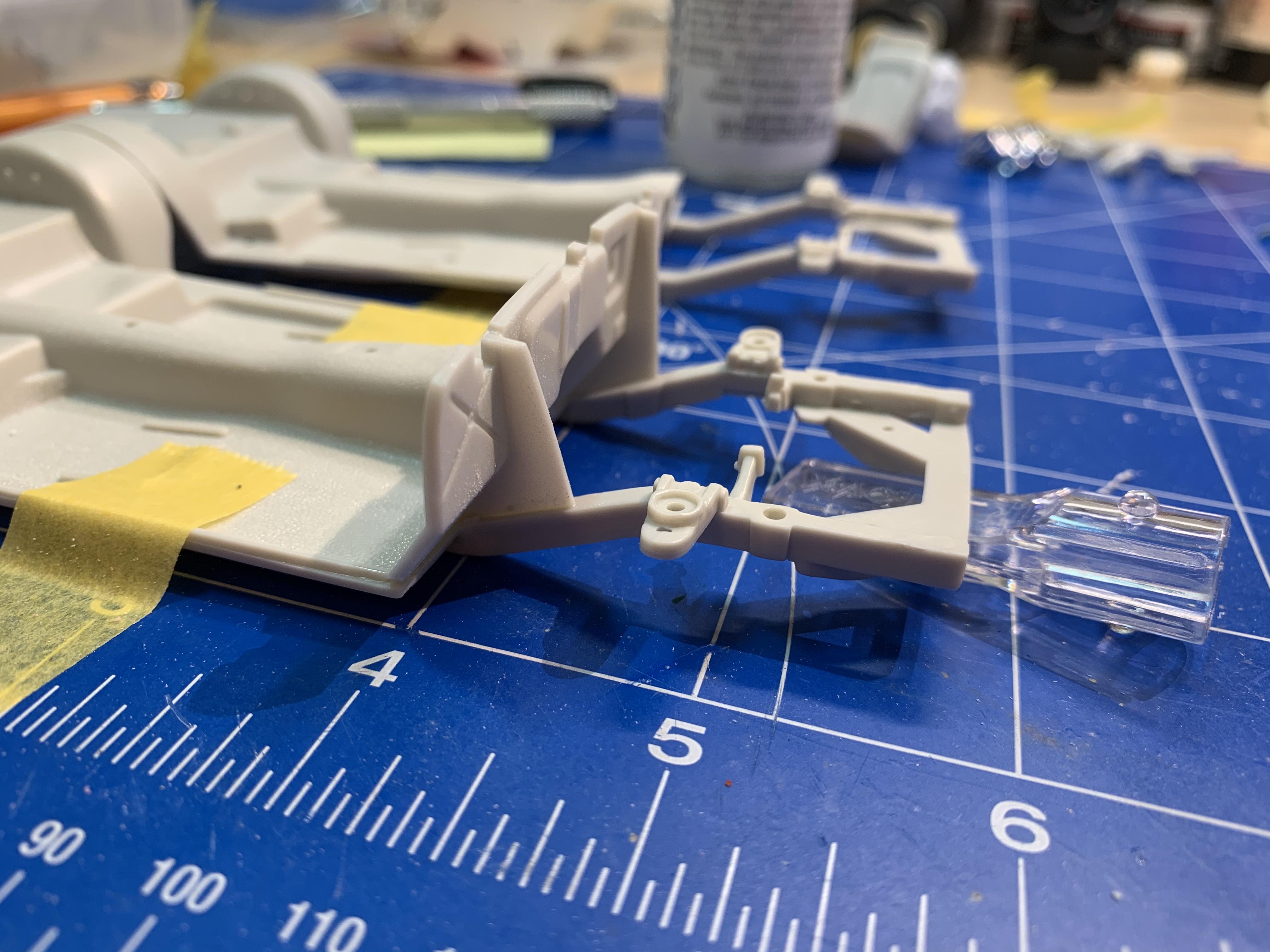

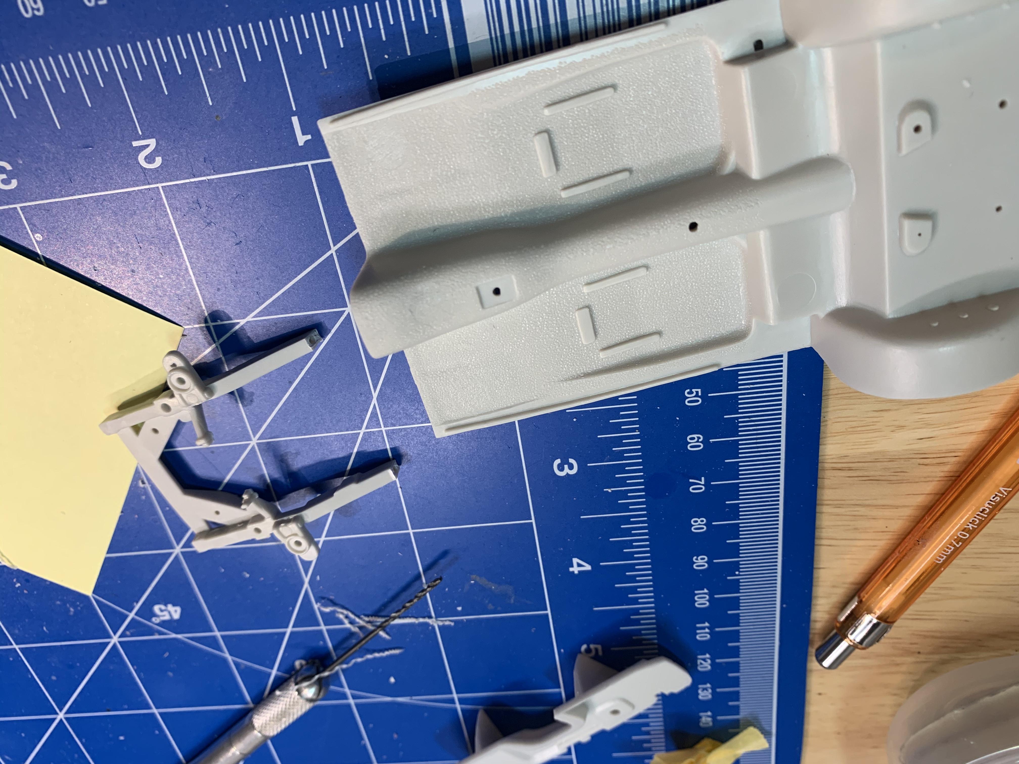

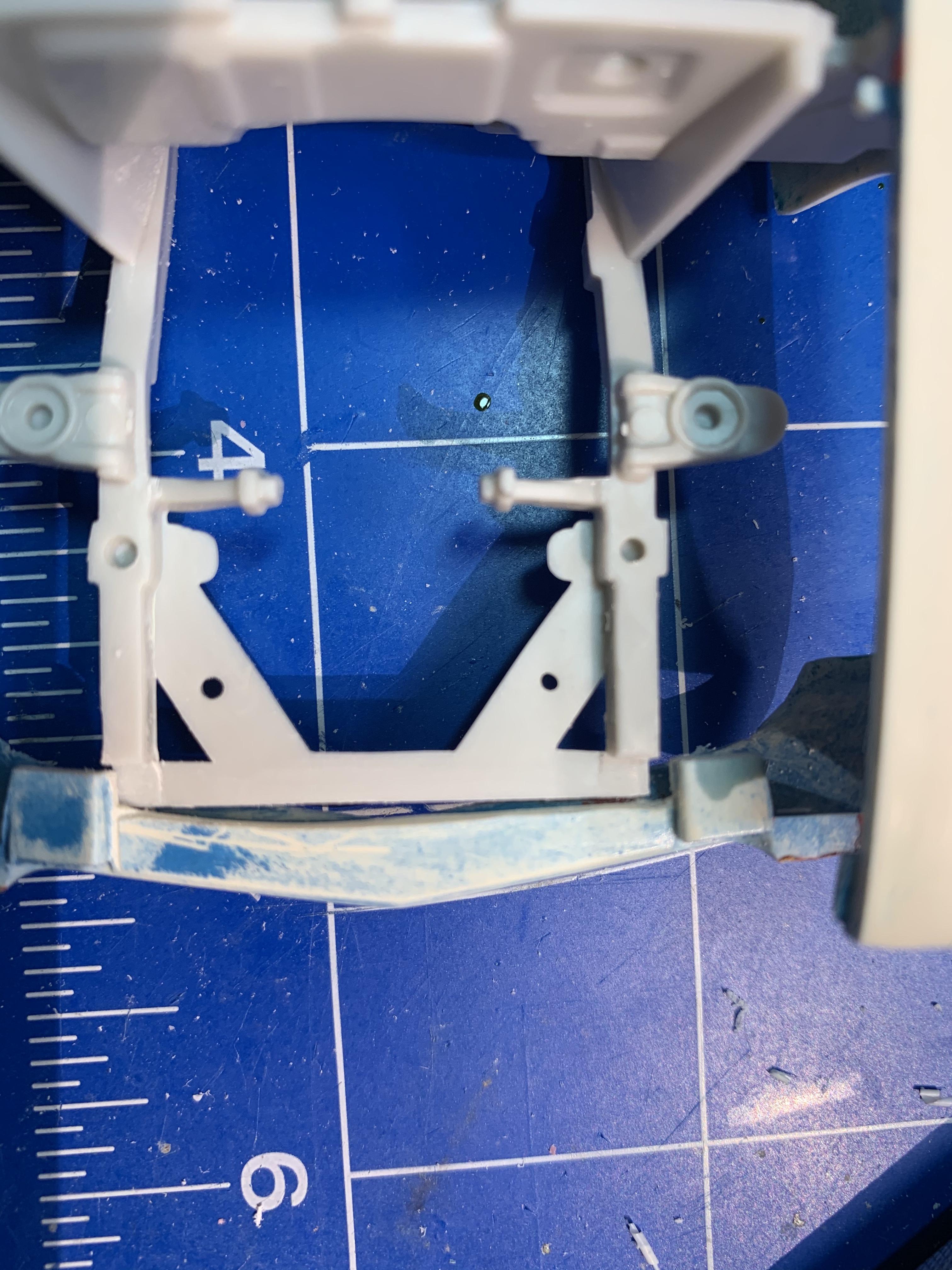

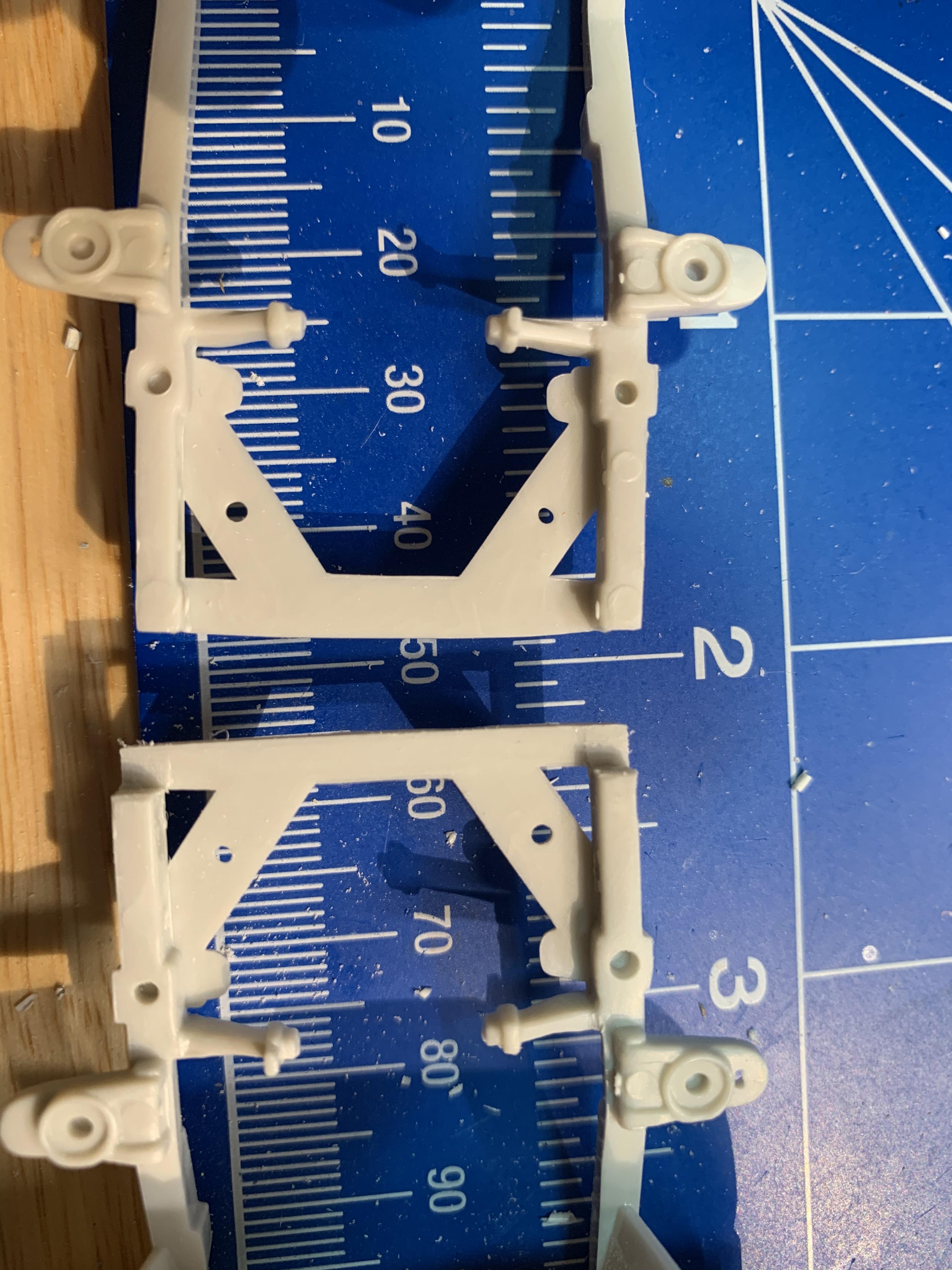

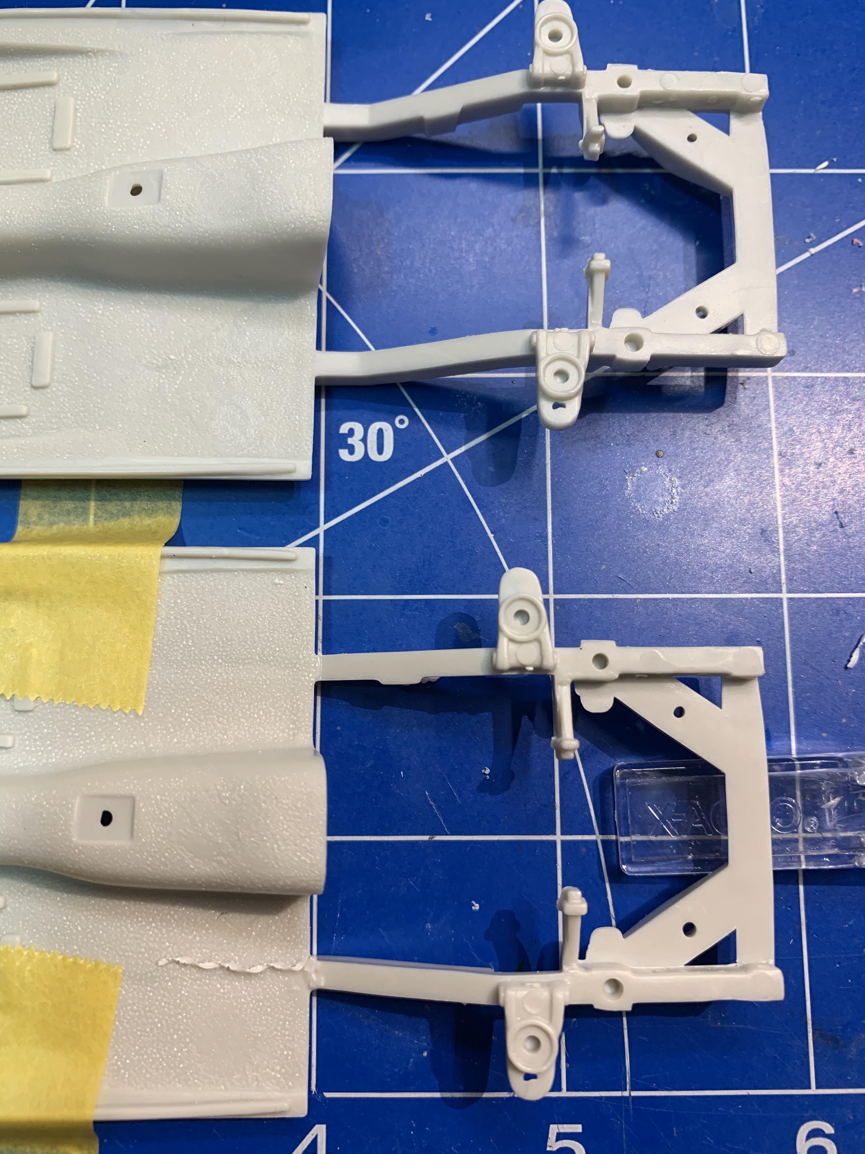

I’m getting stuff done today. I shortened the front rails, and pinned them for strength as I knew this thing was going through a lot of trial and error and I needed it as strong as possible. In the last photo you can see the difference compared to an original chassis.

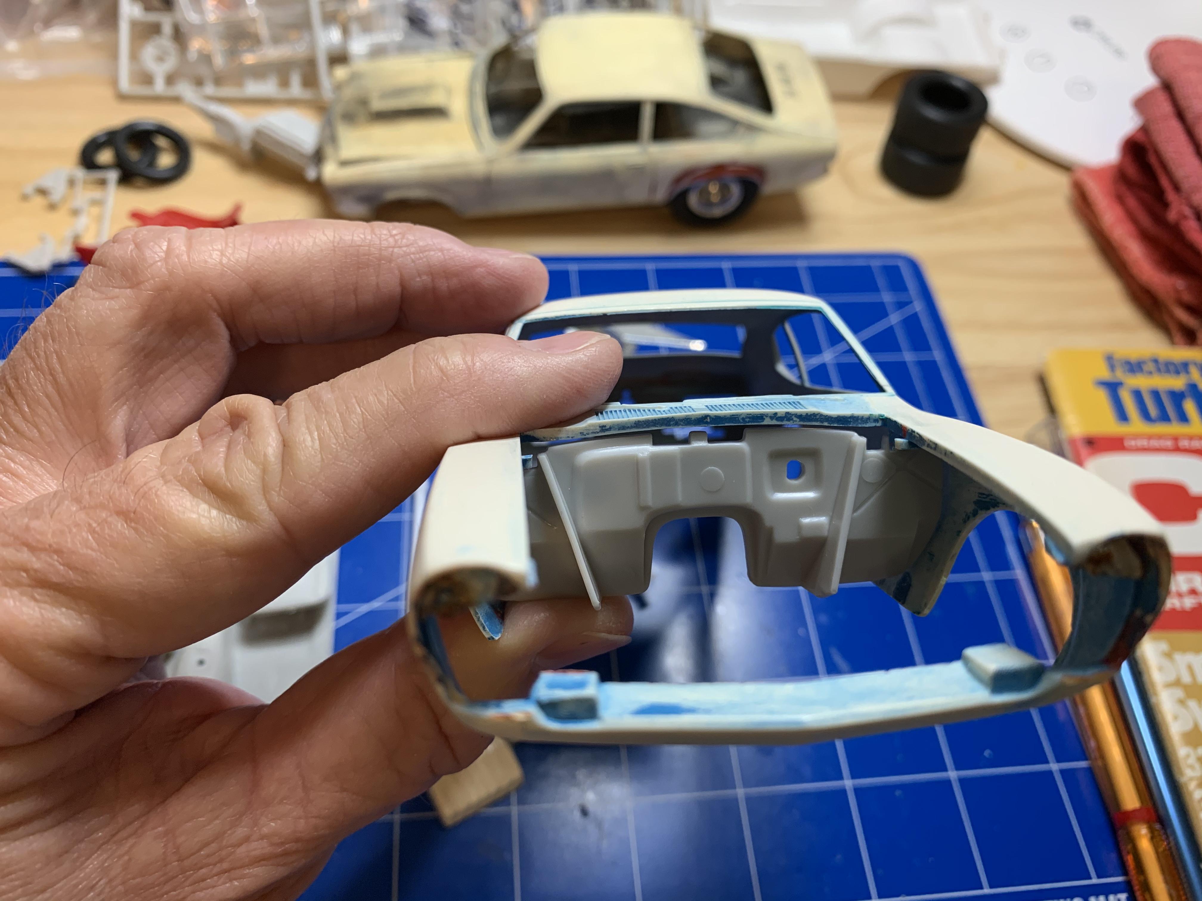

On my first trial fit, the chassis sat too far back, I started trimming the area behind the front valance panel, see before and after.
This helped a lot but I needed a smidge more, so I trimmed the front of the chassis and notched the rails, this did the trick and now it fits and it looks like the wheel base is close to correct.

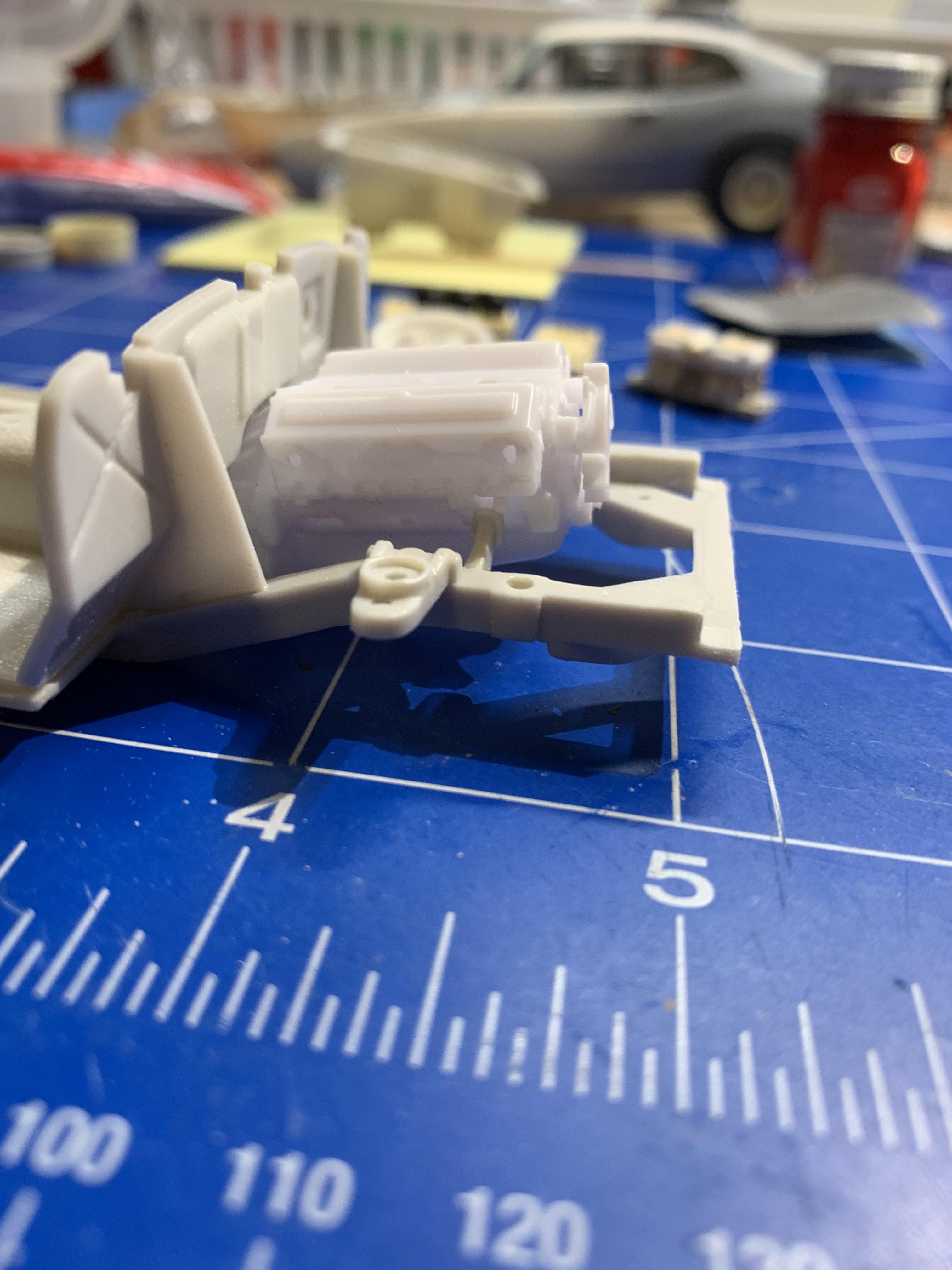

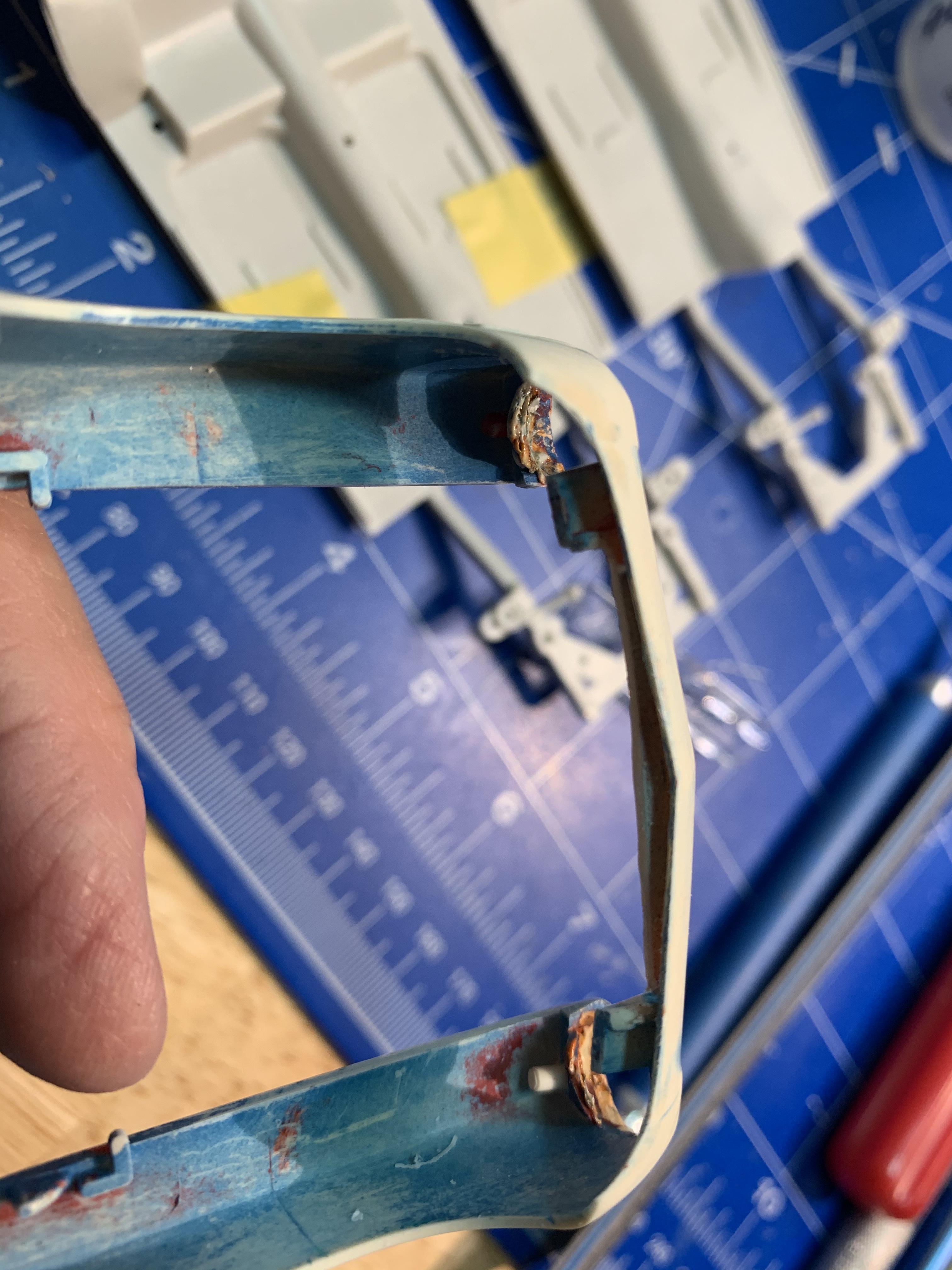

Handling the body so much, I broke the windshield pillar again, so I glued it and set it aside till it sets up. I started putting the motor together, at this  point, I’m watching glue dry.....so I’ll probably call it a day

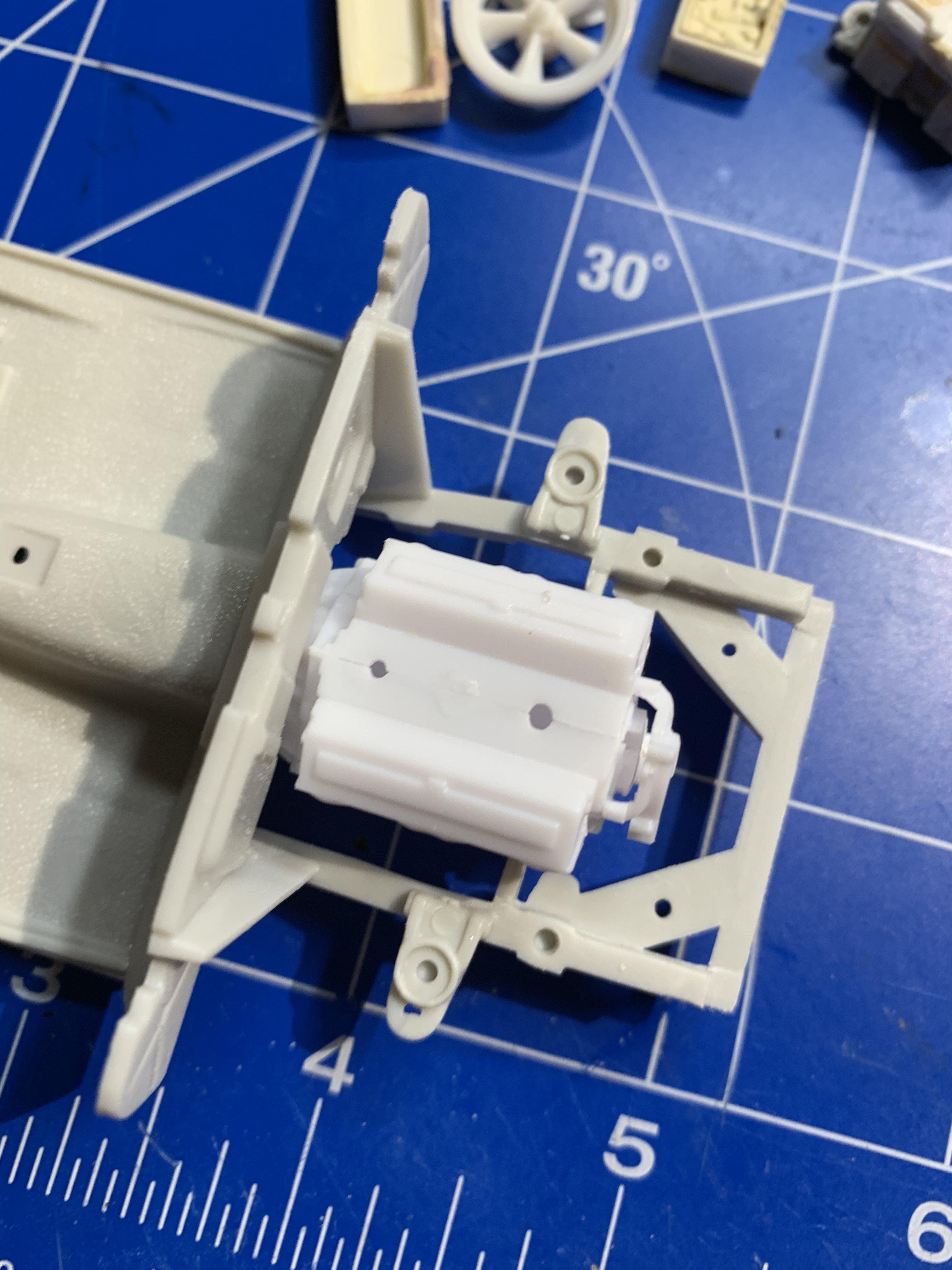

21 hours ago, afx said:

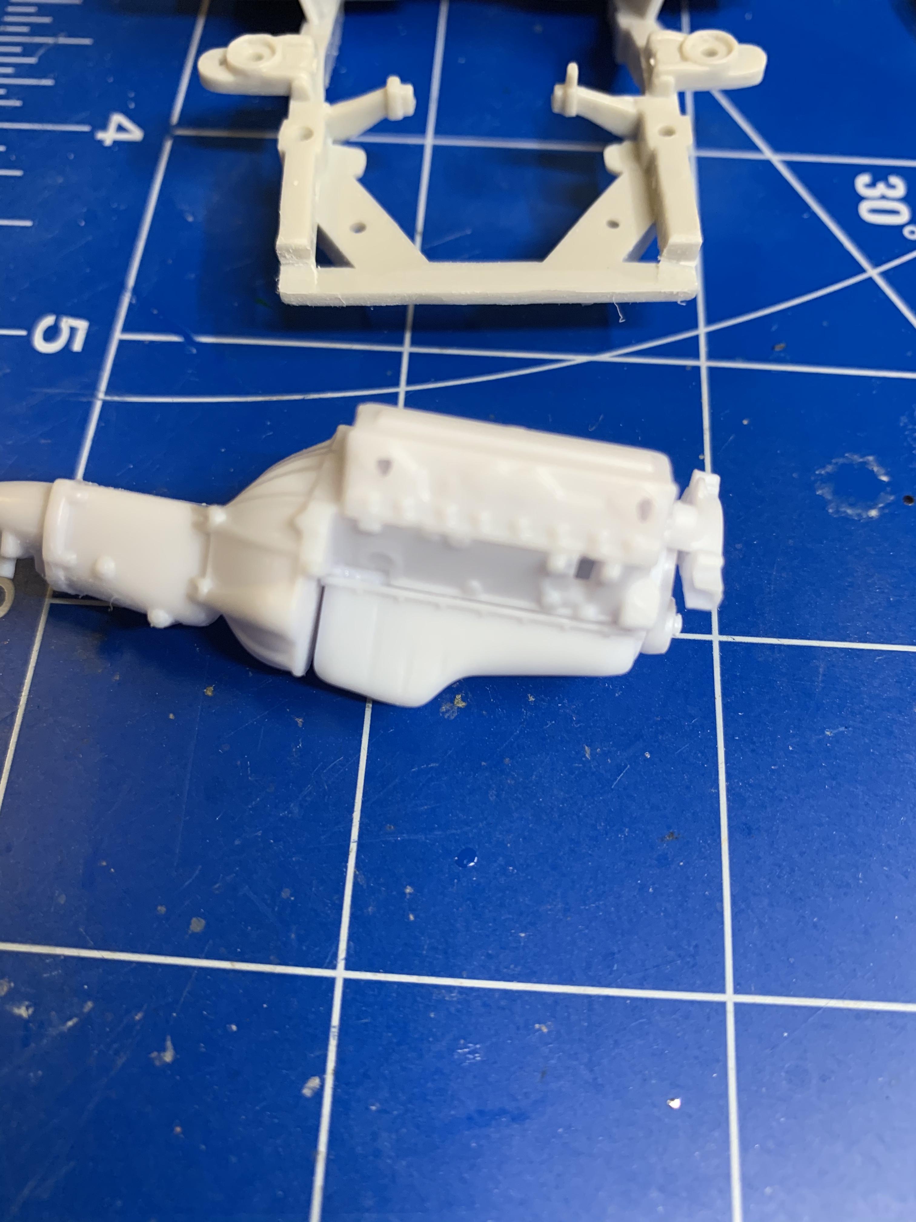

Any engine fit issues from shortening the front clip?

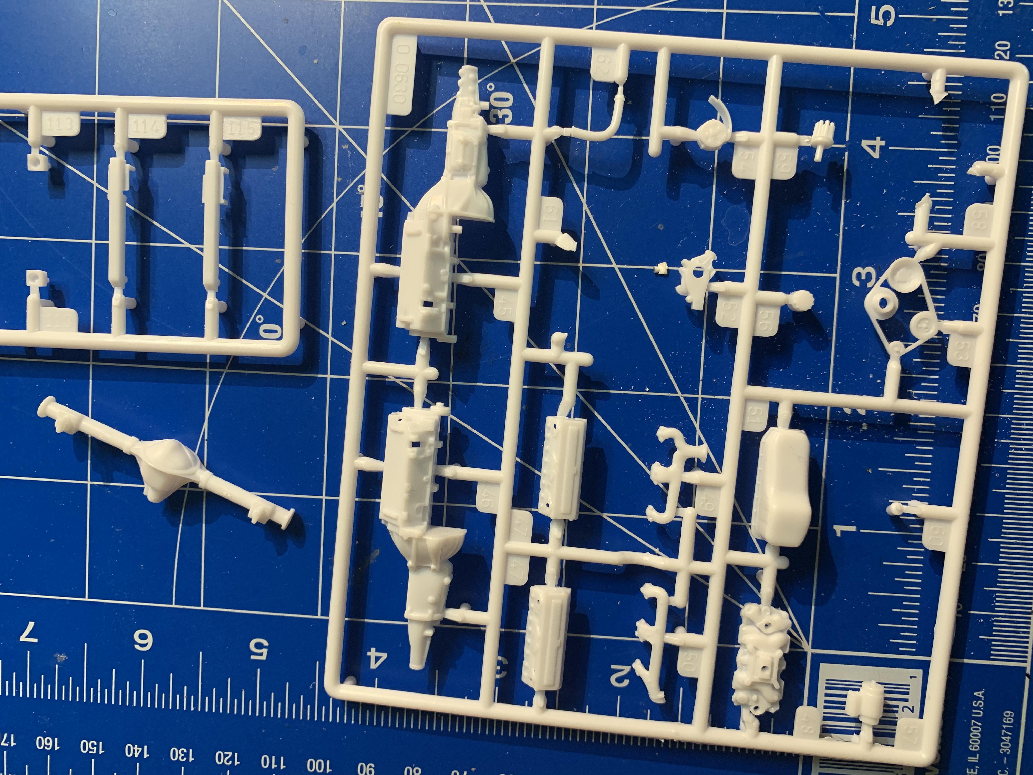

The Revell Nova small block has notches in the block for mounting the engine, and they line up very nicely with the AMT chassis. Headers are my next concern.
