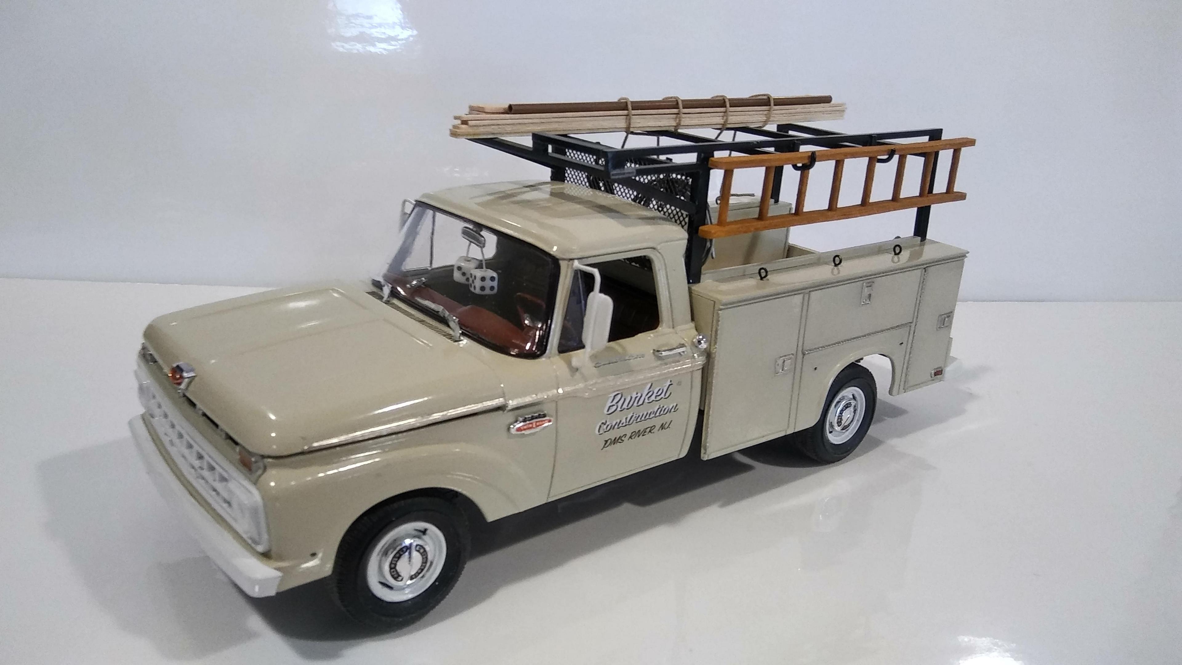

Chuckyg1 Posted August 14, 2020 Posted August 14, 2020 I also use the panel line accent on chrome for washes. Grills, hubcaps, trim pieces, etc. Like everything else, there's a learning curve. Here, I used it on the hubcaps of my work truck. Sometimes multiple applications are needed.

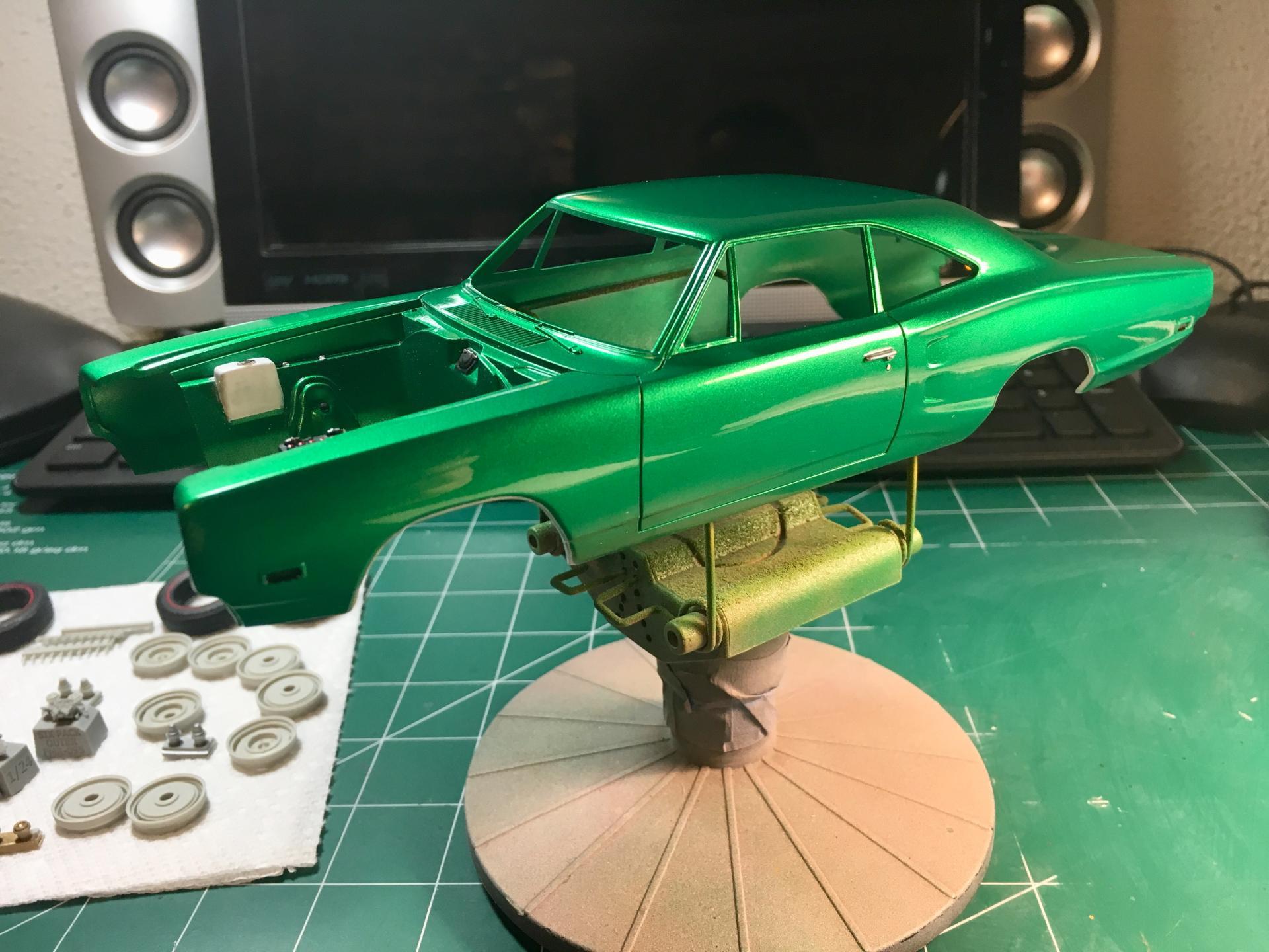

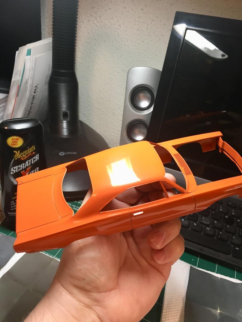

Brutalform Posted August 16, 2020 Posted August 16, 2020 (edited) Never used the Tamiya Accent over enamel or lacquer, but always under it with no problems. After scribing door and trunk lines, I add it to the deepened lines, right to the bare plastic. After it dries, excess is removed with Tamiya enamel thinner. Shouldn’t be a lot of cleanup as the Accent flows nicely into the grooves by capillary action. Sometimes a second or third application will get the lines really dark. Then I do all my priming and painting. The accent still will show through. These bodies have the Accent treatment. Edited August 16, 2020 by Brutalform
