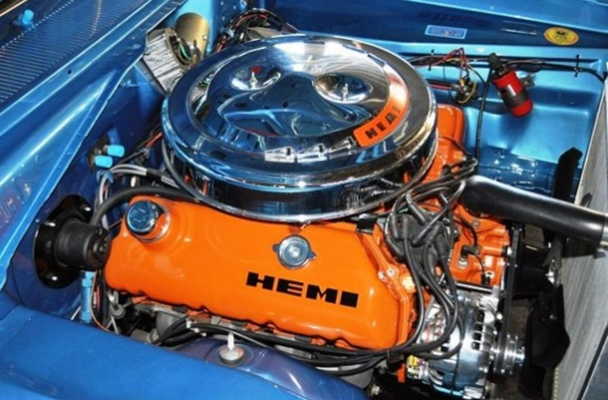

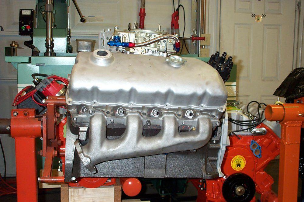

I worked at the Chrysler Tech Center from 1965 till 2007 in the performance engine/ race  engine development group. There was going to be a Hemi for 1972 (before insurance and regulations killed it) but it was going to be the 444" Ball Stud Hemi which I worked on. We had one engine installed in a 1971 Plymouth GTX and it was a runner. Engine displacement shown on machined boss on front of block below distributor mounting area. There was also going to be a 400" version also and we were going to eliminate the 383 and 440 engines.
23 hours ago, Deuces ll said:
Cool!.... There's plenty more pictures of that motor... I'll dig those up and post them....?
Thanks for the info and pics guys, I didn't know anything about this engine.  Would be an interesting engine to build for another Mopar project...  another rarity... ?
Strange that the spark plugs are placed like a wedge engine but advertised as hemi heads?  The engine seem to be under the hood of a 68 or 69 Barracuda?
Now I know which door to knock if I need more information on this mysterious engine!
