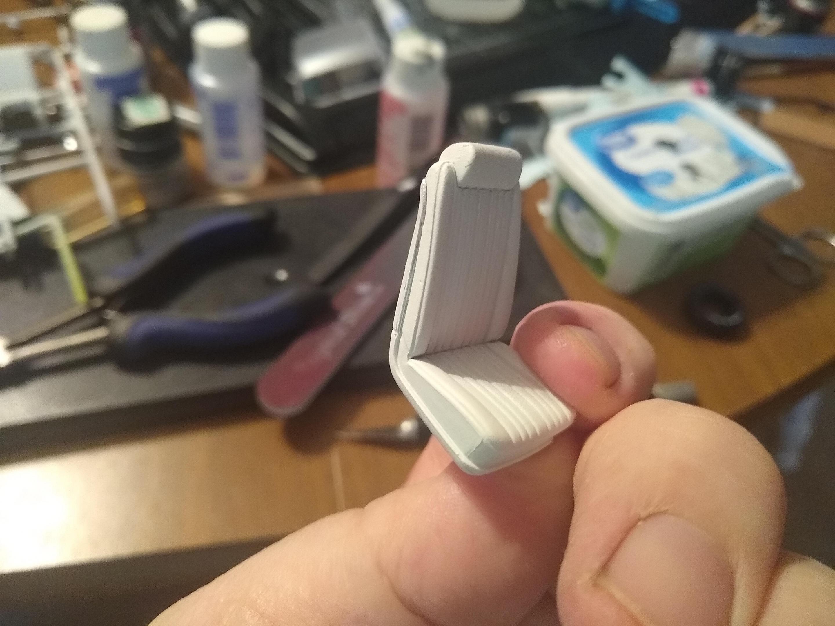

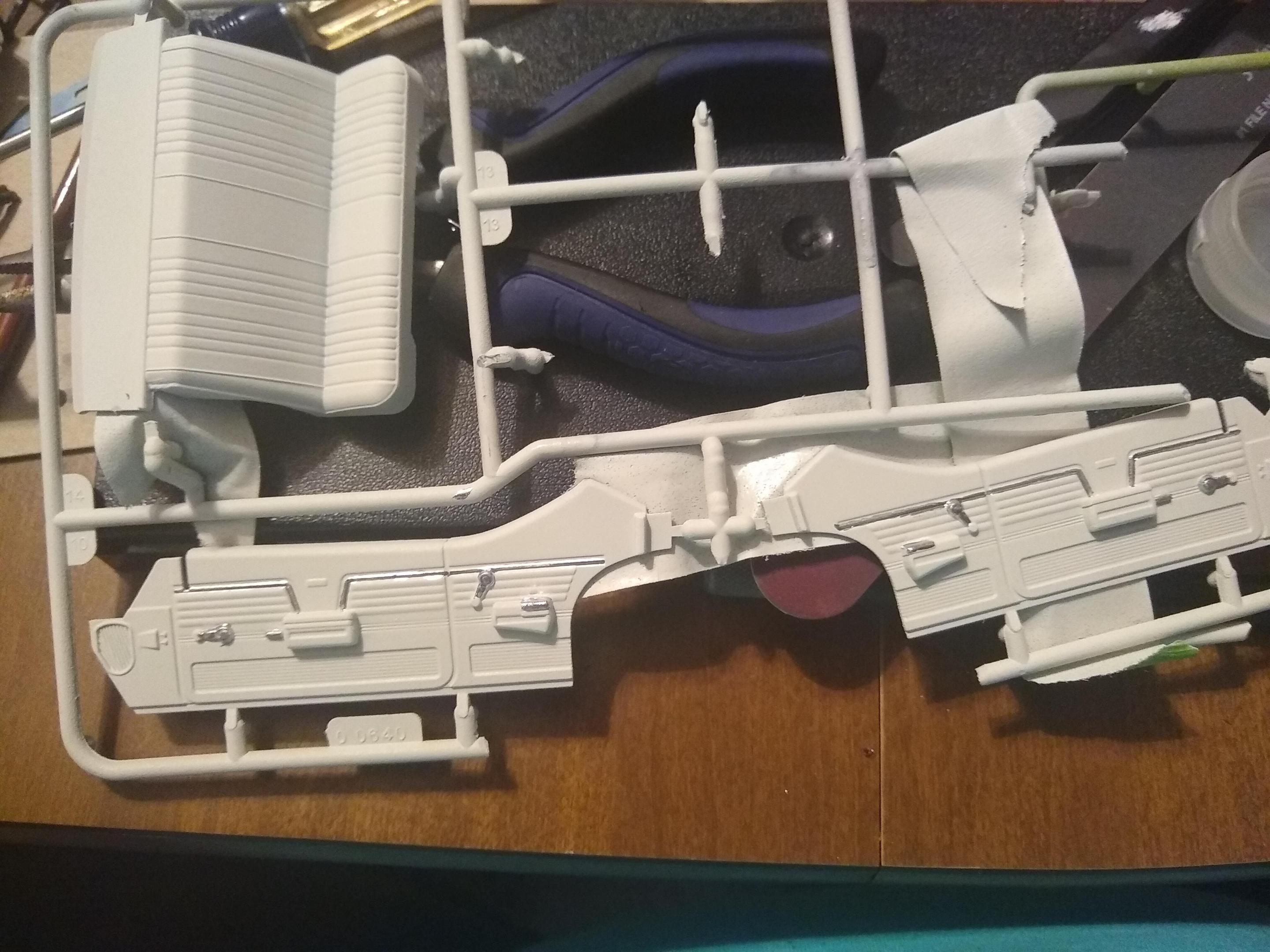

randyc Posted August 17, 2020 Posted August 17, 2020 (edited) I took some pics and made some progress on teh Chevelle. Here we go. Incorrect wheels. I found a set that may be more accurate in an AMT Roadrunner/GTX/Coronet kit. Didn't get around to working on them this weekend. Here's the grille painted up. no lenses yet. Grille fits nicely with a little fitting work. Just a little filing and scraping to get a better fit. Chassis Here's an area that needs work. THe seat backs just kinda fade into the sides. THe plastic area at bottom is not defined, so I fixed that - It's not prefect, but better than presented. Top seat is filed. Bottom seat is just glued together. Once painted, I'll run some sort of chrome or silver bead around the edge on teh seat back only. IN researching, the chrom around bottom is only correct for the Chevelles that ended up with Buick seats. I think that's how it read. There were some cars with Buick and Olds interiors that came from factory that way. Edited August 17, 2020 by randyc

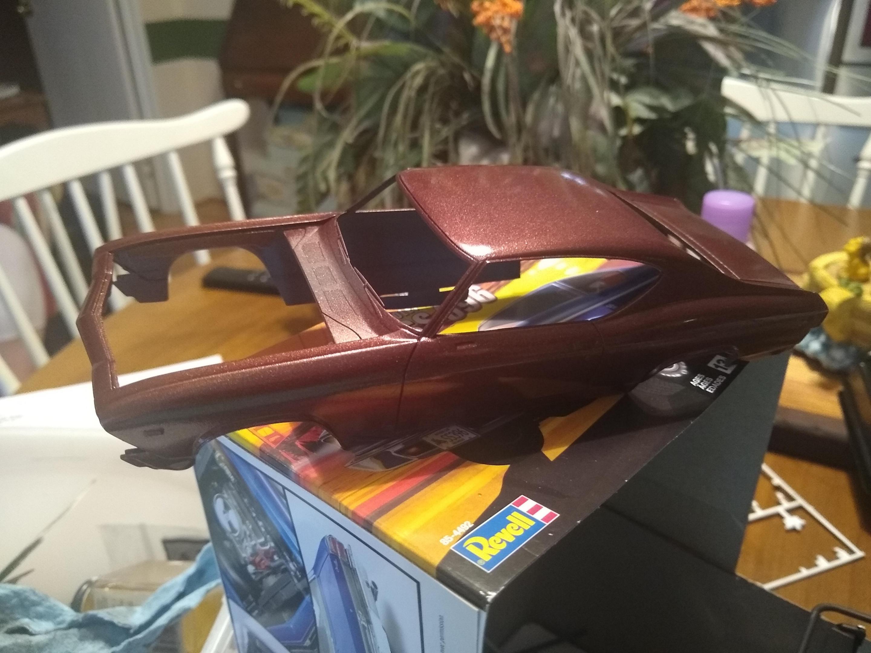

randyc Posted August 17, 2020 Author Posted August 17, 2020 (edited) Here's my process on trying to fix the rear bumper gap issue. I cut the bumper off, sanded it smooth, reglued it. Took a bit of the gap[ out and I can live with it. I tapered the bottom of the quarter up to meet. I'm sure some of you will still not like it and will come up with other solutions. To me, it's one car in about 200 in my collection on display. Nary one of them are perfect. Here is the lower quarter tapered up to match height or rear bumper. I think the whole thing will look better once I get the gap blacked in and on the painted body. The body has color on it, but paint is a little rough - was a little dry. I think some polishing will fis that. I get to working on the GT4 and didn't get back to the 69. I did work on the weird gap in the photo below some. We'll see how it turns out later. My photography was pretty bad. I apologize. I was hurrying along trying to get that done without losing my train of thought. Photos looked pretty good on my phone but on my 21" monitor, it's pretty bad. Edited August 17, 2020 by randyc

Snake45 Posted August 17, 2020 Posted August 17, 2020 Your rear bumper fix looks good, but I won't be able to live with that gap between the bumper and the end caps. I'll have to plug that with some styrene or something. Drive on!

randyc Posted August 17, 2020 Author Posted August 17, 2020 24 minutes ago, Snake45 said: Your rear bumper fix looks good, but I won't be able to live with that gap between the bumper and the end caps. I'll have to plug that with some styrene or something. Drive on! My car ended up brown. A rarely seen color and mine isn't a perfcet match. But hte dark color will hopefully hide some of that. And you are more particular than I am - this I know already. ? And I know others will come up with solutions as well. Just wanted to go ahead and get one out there for everyone asking about it. Once I really saw it, I couldn't unsee it - kinda like that DM diecast we've discussed elsewhere.

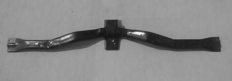

bisc63 Posted August 17, 2020 Posted August 17, 2020 I never noticed until your pic above, but that trans cross-member is bogus. The "groove" running the length of it needs to be puttied in to create a nearly smooth profile. Real ones begin life as round steel tubing that is pressed into shape, leaving an oval cross section.
Elmer Fudd Posted August 18, 2020 Posted August 18, 2020 (edited) 48 minutes ago, bisc63 said: I never noticed until your pic above, but that trans cross-member is bogus. It is. It appears that the mold maker was trying to save a little plastic but he saved on the wrong side of the part. To his credit, though, my fading memory says that the 1968-72 midsize BOP crossmembers were made from channel steel. It's not as egregious an error as the master cylinder mounted on the passenger side of the Moebius 1961 Pontiacs. You'd need a co-pilot everywhere you went in a Moebius 1961 Catalina. "BRAKE NOW, I SAID!" Edited August 18, 2020 by Elmer Fudd
