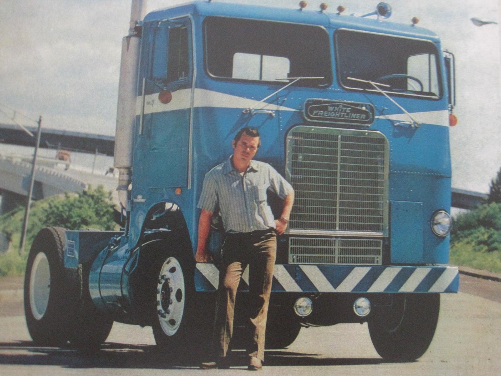

  • We'll call this (blue on blue) mid 1970's an owner operator rig because its dressed up a bit.  It's the 61 series cab which was an upgrade from the 21 series.  Still a single bar down the center of the grille but note the perforated panel below the grille.  Loop steps below the door and on the cab skirt would be standard and what most fleets ran. The ladder step on the cab skirt on this one would have been an option.
  • The tooled ladder step puzzles me. It may have been a later modification to make it look like a newer truck.  There have been two types of ladder steps, tooled or the earlier fabricated step.  This may have been a very late 61 series after the tooled step became available but the White Freightliner name plates tell me it's an earlier truck
