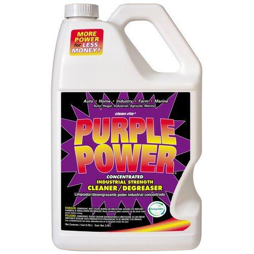

Goodwrench3 Posted August 22, 2020 Author Posted August 22, 2020 1 minute ago, espo said: When all else fails, use Purple Power. You might want to use rubber gloves if you're fishing bodies and parts out of the soup. This stuff can do a number on your skin with any prolonged exposure. Purple Power? I've seen a lot of references to products with "Purple" in the name. Just want to make sure we're talking about the same stuff. Is this the stuff ?

martinfan5 Posted August 22, 2020 Posted August 22, 2020 (edited) 26 minutes ago, Goodwrench3 said: Purple Power? I've seen a lot of references to products with "Purple" in the name. Just want to make sure we're talking about the same stuff. Is this the stuff ? No, while that will "work", its a generic knock off and its not as strong, this is what you want Edited August 22, 2020 by martinfan5 1

StevenGuthmiller Posted August 23, 2020 Posted August 23, 2020 7 hours ago, martinfan5 said: No, while that will "work", its a generic knock off and its not as strong, this is what you want I agree wholeheartedly! Super Clean is a far superior product to the other "degreasing cleaners" such as Purple Power or Simple Green. That said, there are some paints that are resistant to many of the strippers that we use for modeling. If Super Clean doesn't do the trick, you might give isopropyl alcohol a try, or I have heard that some have good luck with products such as Testors "ELO", if it's still available. Steve
oldscool Posted August 23, 2020 Posted August 23, 2020 12 hours ago, martinfan5 said: No, while that will "work", its a generic knock off and its not as strong, this is what you want This is stronger than Purple power from my experience as well.
espo Posted August 23, 2020 Posted August 23, 2020 14 hours ago, Goodwrench3 said: Purple Power? I've seen a lot of references to products with "Purple" in the name. Just want to make sure we're talking about the same stuff. Is this the stuff ? That's the one I use. As an example. I bought an inexpensive oblong plastic container with lid at Wal Mart. Think Tuperware type stuff. I also got a smaller container for doing very small parts. I then submerge what ever I'm striping in the Purple Power in the container. Snap on the lid and check on it the next day. I mentioned the chemical reaction to your skin, and that's why I suggested the rubber gloves. I get a box of them at Harbor Freight , 5 mil. Nitrile 100 count for less than $10. You my not need the gloves if you can get the parts out of the PP without touching them and run them under the tap and rinse them. I reuse the PP by pouring it back into it's container using a small strainer to catch most of the old paint in it. Sometimes paint will still be in the door jams and body lines. I just put it back in for additional soak time and that will usually get it cleaned up. Hope this helps.
