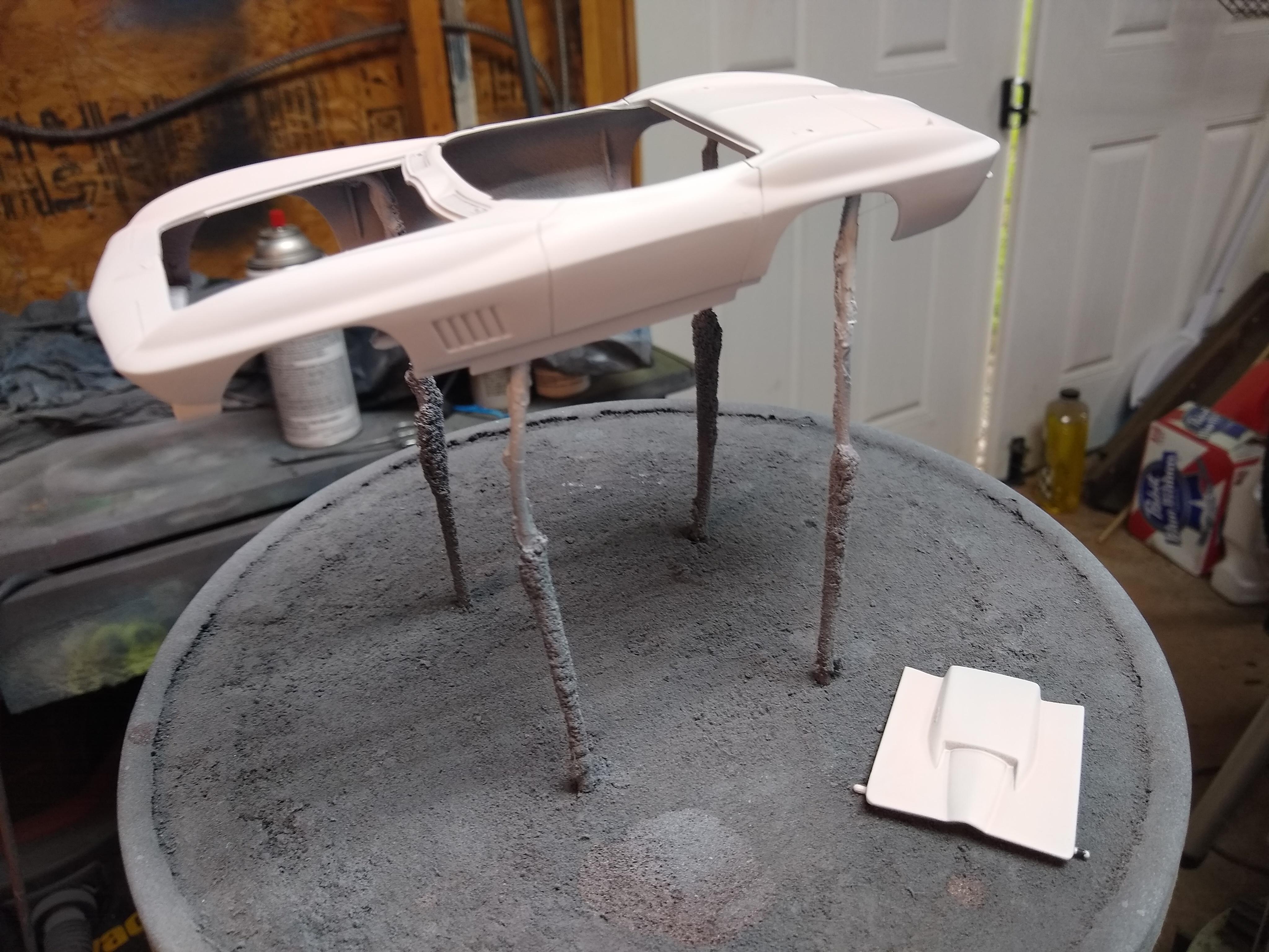

randyc Posted August 25, 2020 Posted August 25, 2020 (edited) New build and experiment. So I have this old 67 Vette molded in red. No interest in it whatsoever anymore. You can see I started sanding and filing parting lines off sometime ago. That will be part of the experiment as well. Will the paint hide these? After my primer debacle recently, I figured I'd do this "in the name of science". On those other two builds, I had some of this Miracal dollar store paint overspray on the hood of the 69 Chevelle. When I put it in the purple pond, the "bad" primer came off, but the black overspray remained. So I thought this might be a paint that might block reds, might be a primer, etc. Let's just see what happens. I thought my Miracal can had more in it. I wanted to paint the entire kit with the Miracal, but I wasn't going out in the rain to get paint. (That can be another part of the experiment - the weather). When there wasn't enough paint, I thought I would just experiment with it and what I have on hand. Some color place flat black this might be old paint of the wife's?. Some Rusto X2 primer. In the second photo, you can see what I have primed each set of parts with. he weather was warm, 80 ish in the building and raining lightly - southern US summer humidity. And the body will be spray canned with gloss white from the Miracal line - $1.35 at Dollar General. To start with, the white will be sprayed directly over the black Miracal. DG has some more expensive paints at $3.35 per can, but we need to know if the cheap stuff will block the red plastic and how the cheap paints work. Engine block will be Chevy orange spray from parts store. Minimal, if any air brush will be used. No aftermarket parts unless you guys want to send them. Probably no flocking or embossing powder. Unless you guys reply enough to do it. WE'll see how all this works. I'll try to document the paints used as we go. It might be a giant failure. White car with red? interior? I have some red or burgundy vinyl dye in spray can. Or saddle? I don't like black interiors. Who knows. But the only stinger on my decal sheet that's any good is the red one - tires laid on decals at some point, ruining the other stingers. I like decals. The point will be to paint over the cheap primers and see how various paints react with others and plastic. Next installment will be the white on the body, hopefully. Minimal prep to the body. I painted it and left it to dry - have no idea what it will look like next time I look at it. We'll see. Edited August 25, 2020 by randyc

randyc Posted August 29, 2020 Author Posted August 29, 2020 Well, the Miracal experiment ends. A coat of flat black for primer, then white gloss does not block red. Spray conditions are 75 degrees with 70% humidity. The white went flat, probably due to humidity. Label says less than 60% humidity. No big deal to me as I want to use Pledge for final clear. I'm thinking I may paint it green now work some old paint I have when this cures properly.

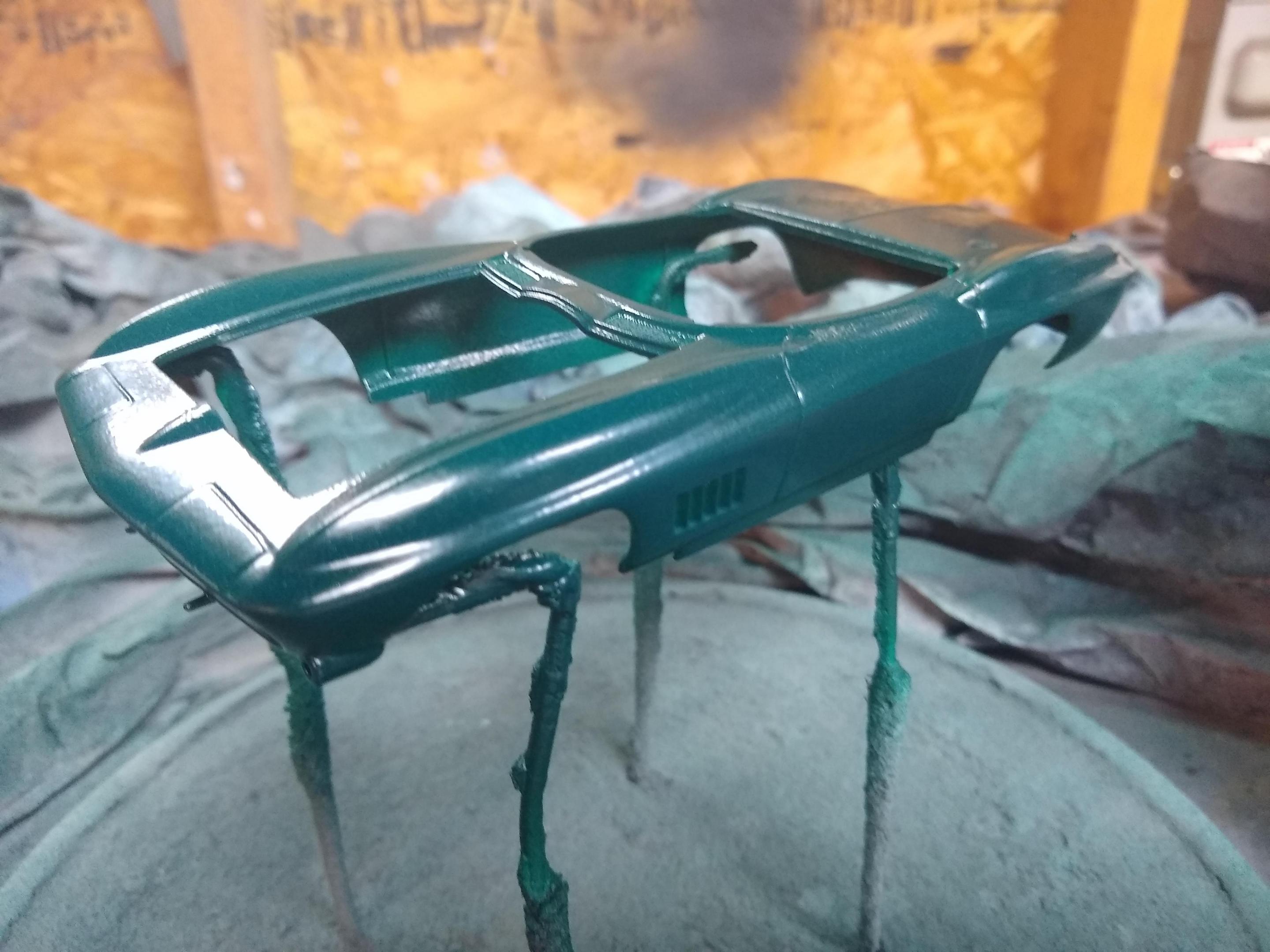

randyc Posted August 29, 2020 Author Posted August 29, 2020 Thanks but not necessary. As I said early, this kit has no emotional bond. I flashed the paint in the dehydrator and have already repainted it with a can of green from 1994. Duplicolor emerald green. It's probably going to blush due to humidity, but whatever. I'll put pledge on it and be done with it. Probably won't go on display work my cars unless it turns out really spectacular. The white ideas was to see if the DG paint would block the red. Now we know.
randyc Posted September 5, 2020 Author Posted September 5, 2020 And it's back. I am having a love/hate with this kit. I really don't need this build, but I started the experiment and am carrying it through to completion. Trying different things with it. It's mostly built. Down to the details now. I have discovered that I can polish Pledge. I have used headlight polish and the moto tool on this one. It will shine what is there. I might still try some heavier cutting polish to see what happens. Unlike hobby clear, you can beat down with the moto tool on the pledge. I hate red plastic. Even when you get it painted, when you snip a part off the tree, you have to touch up the red spot. Interior came out nice but not a correct shade. The kit decals are no good at this point and they are terrible anyway. Looks like monogram tried to rip off Fred Cady and failed. Hopefully finish this one this weekend. I really have no next project, but I'll find something. Might be time to clean up my work area. Next stop should be under glass.
