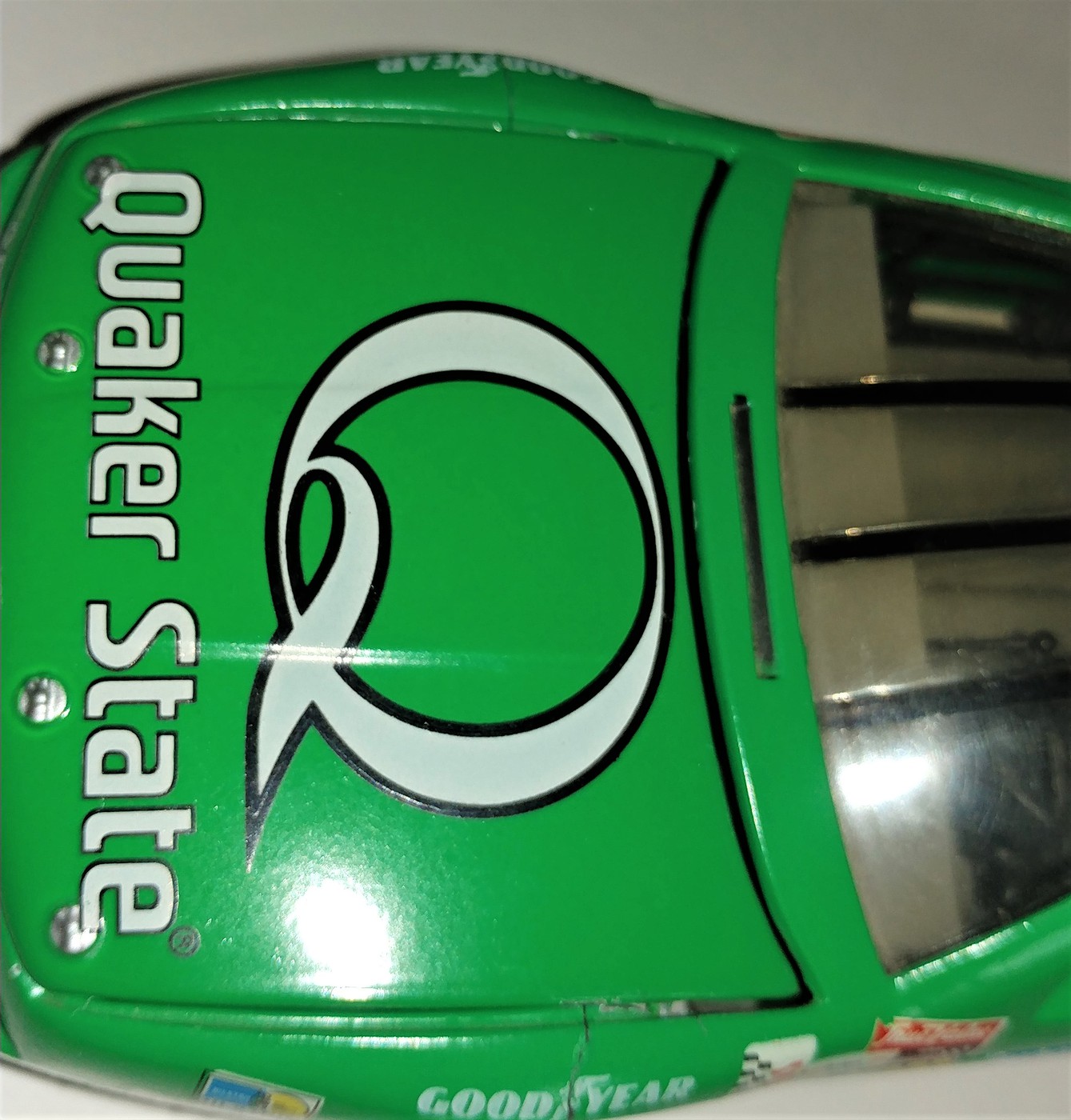

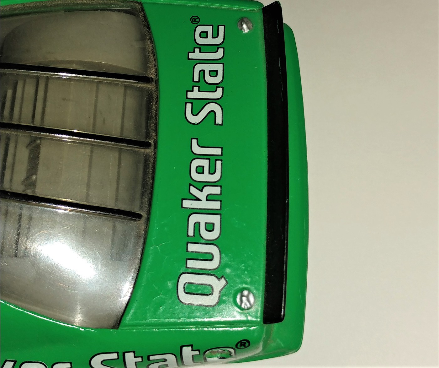

THarrison351 Posted August 29, 2020 Author Posted August 29, 2020 I've seen the train disasters. Those are wallet busters. Here are some more more photos of the Brett Bodine Quaker State Thunderbird. You can see some bubbles in the Q. Cracked and glued fenders. Bubbles and cracks in trunk lid. The car is covered in them. I have two other cars with some bubbling, but no failure as of yet. Both are older Danbury Mint. A 1958 Impala Convertible's trunk lid and 1934 Packard V12 LeBaron Speedster's main body. They were cheap to buy, so I'm not upset.

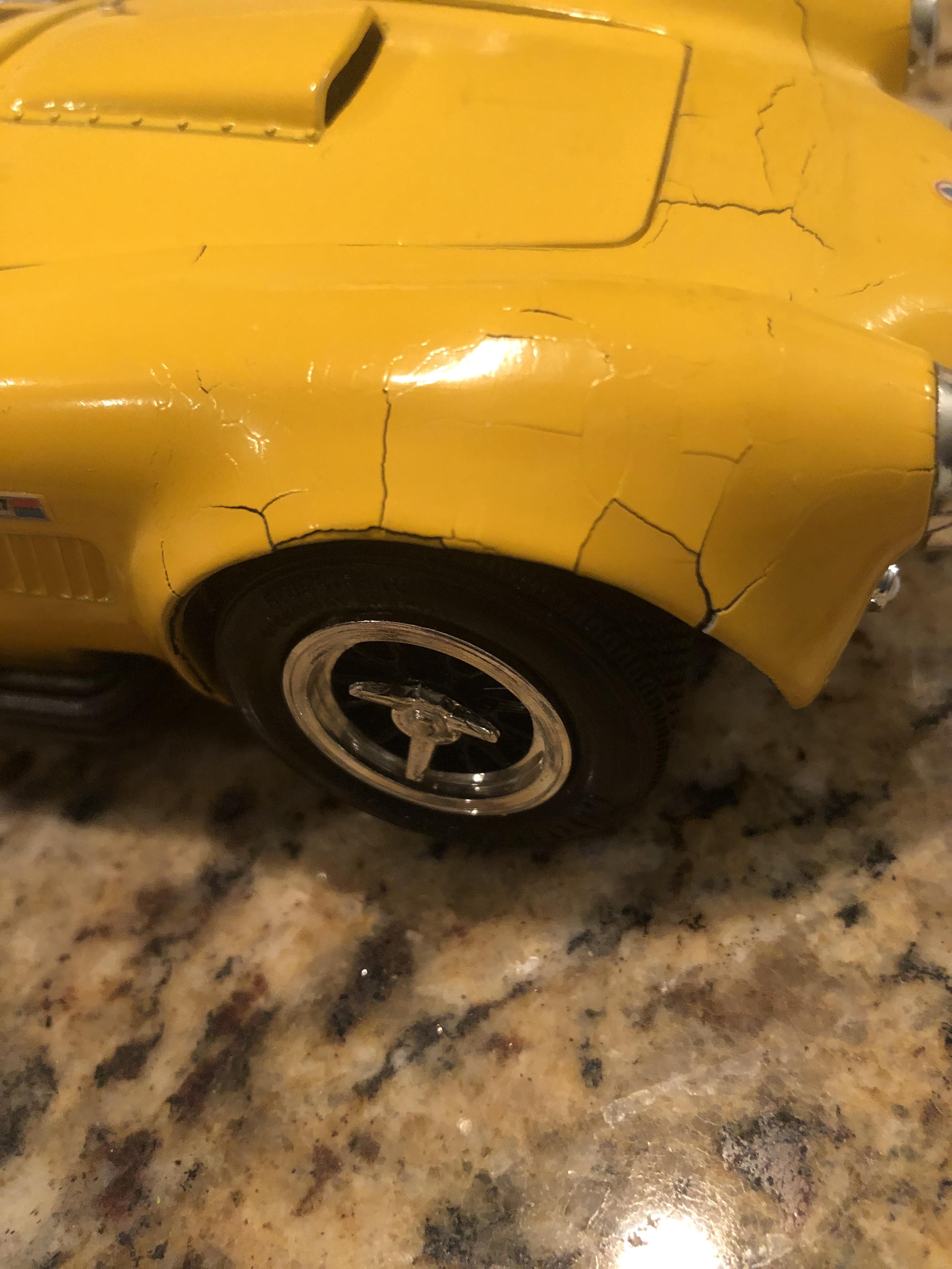

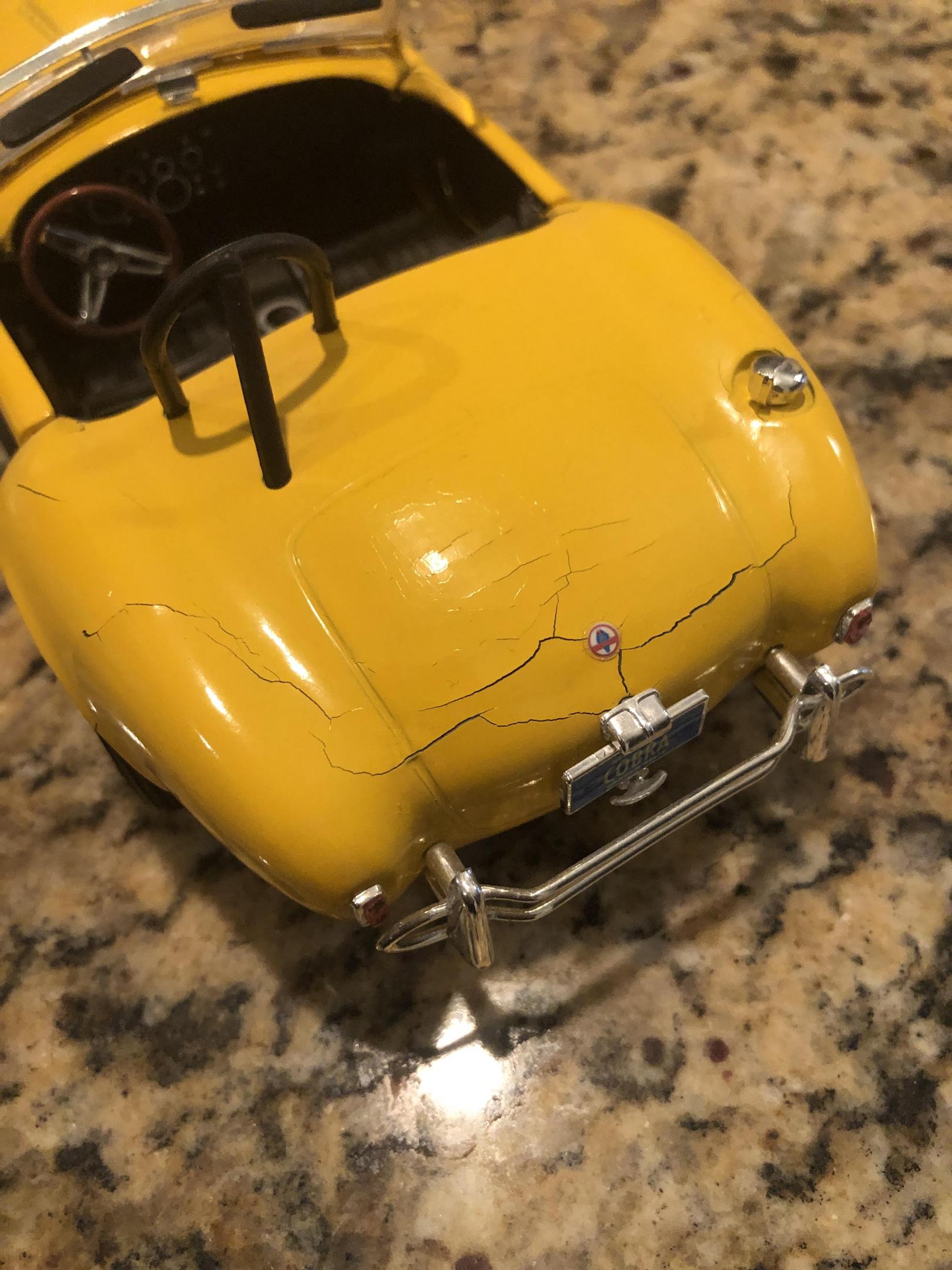

cobraman Posted August 29, 2020 Posted August 29, 2020 I have one Cobra out of my collection that is breaking down pretty bad .
THarrison351 Posted August 29, 2020 Author Posted August 29, 2020 Yeah, that's bad! A lot like the Mercedes. When I was researching this in the past, I looked up zinc pest as Dave Van mentioned in his post. The pictures of these $$$ trains literally exploded in their boxes were amazing. I've seen some pretty nasty corrosion in aircraft aluminum, but this Zamak is crazy the way it expands!

cobraman Posted August 29, 2020 Posted August 29, 2020 The yellow Cobra was bought new as a built example. I also bought the same car, same color that was offered in kit form. The kit one has not shown any breakdown........ yet ?
Ace-Garageguy Posted August 29, 2020 Posted August 29, 2020 (edited) 3 hours ago, cobraman said: ... yet ? It all depends on who did the makeup of the batch of molten metal your particular model was cast from, and whether he allowed the contaminants in it that cause disintegration (lead, which can be sourced very cheaply from recycled batteries and incorporated in "zamak" by unscrupulous manufacturers). I have cast zinc and "zamak" model railroad locomotive shells, rolling stock, and parts from the 1940s through the '60s that have shown no sign whatsoever of coming apart, blistering, or anything else. They were, however, made in the US, Japan, or Korea. Edited August 29, 2020 by Ace-Garageguy

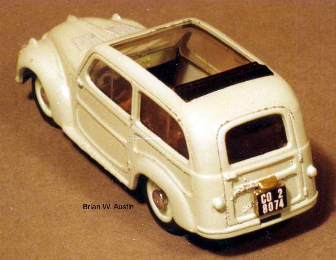

Brian Austin Posted September 8, 2020 Posted September 8, 2020 I inherited some old HO loco parts (boilers and tenders etc.) in the '80s that were already cracking and breaking. I also have some Lesney-era Matchbox cars with a bit of a sandy texture. So don't blame the Chinese for inventing zinc rot. :-) While I'm at it, here's a little warning relating to diecast corrosion: DO NOT use baking soda to represent snow in dioramas. I made that mistake and ruined a few 1:43 diecasts. The metal was severely pitted in areas, and chrome plating was also removed in spots. Both the chrome finish and the metal contain aluminum. My mother often warned of using baking soda with aluminum pans when baking. I found out what happens. :-(
