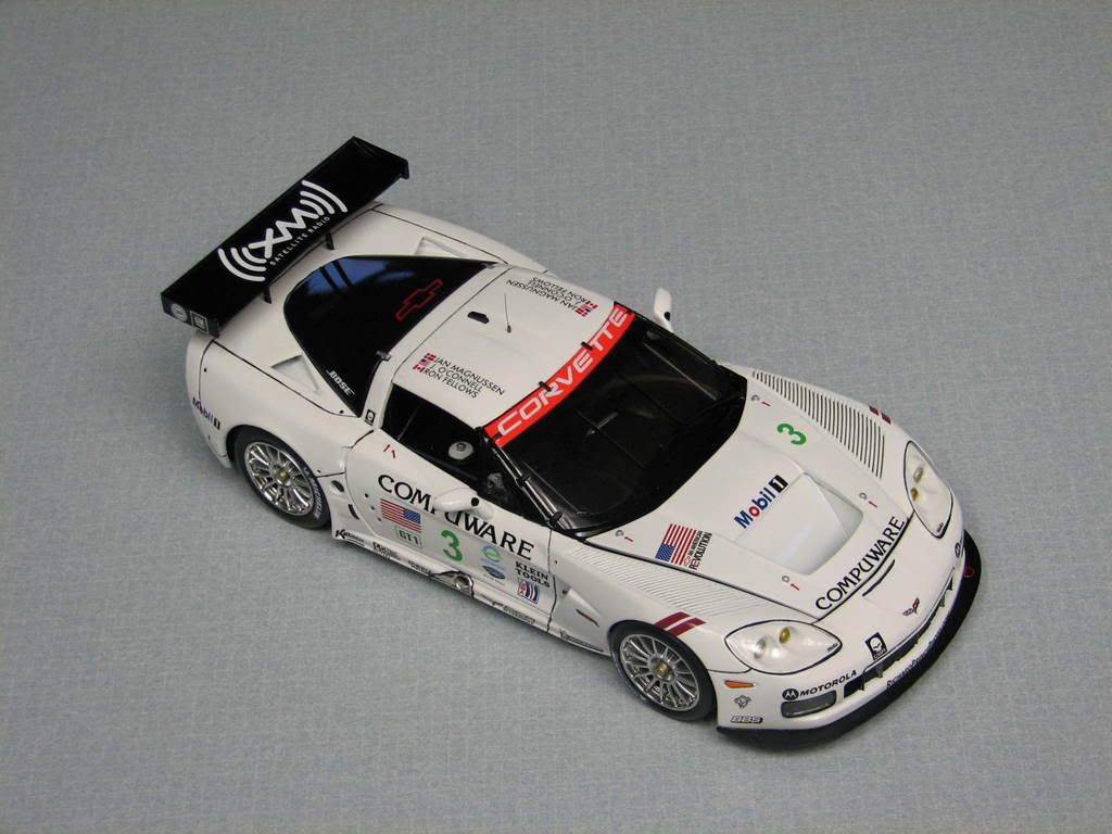

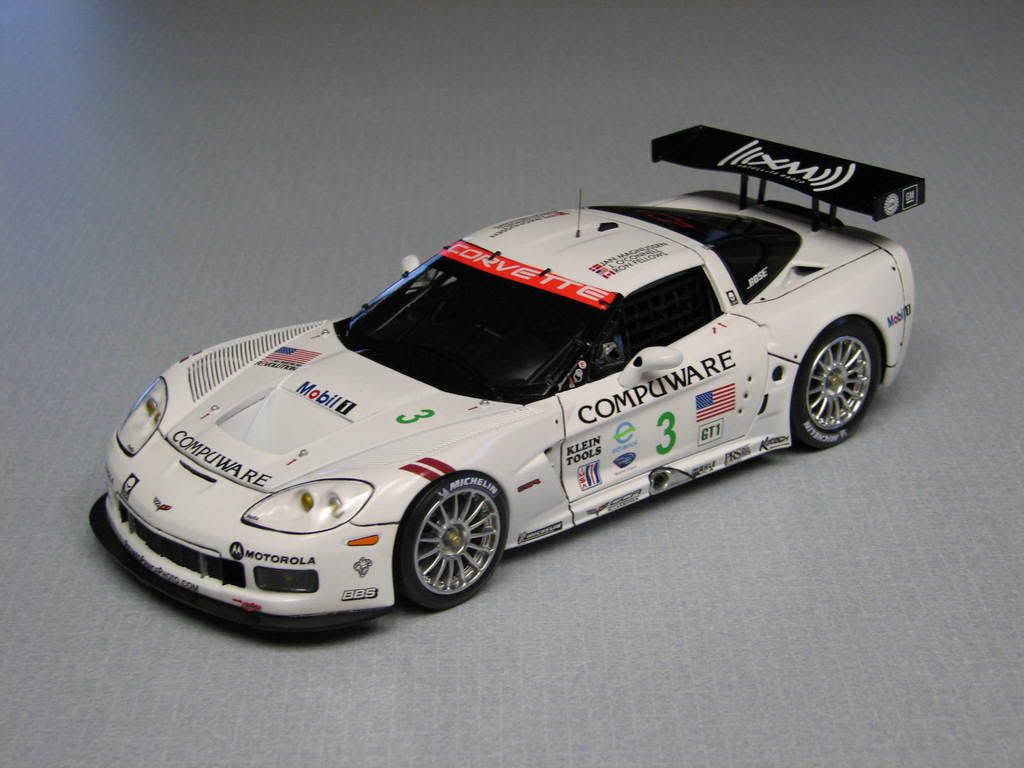

Brendan Posted November 5, 2008 Posted November 5, 2008 Bob, the best clear coat I've used that won't hurt decals is Floquil Crystal Coat. I've used it on all my cars that have had extensive decaling since I mainly do race cars. I have never had it yellow on white cars. Photo attached of Crystal Coat over a Corvette.

E St. Kruiser50 Posted November 5, 2008 Posted November 5, 2008 Bob, the best clear coat I've used that won't hurt decals is Floquil Crystal Coat. I've used it on all my cars that have had extensive decaling since I mainly do race cars. I have never had it yellow on white cars. Photo attached of Crystal Coat over a Corvette. I know this is off the subject a bit, and I'm invading your thread Bob, but Brendan, this is a beautiful build man .
