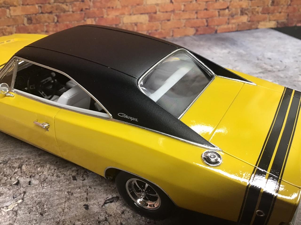

jamesG Posted September 13, 2020 Posted September 13, 2020 Here's a pic of a 68 charger I did several years ago using the spray technique described above by plowboy.
Plowboy Posted September 13, 2020 Posted September 13, 2020 10 minutes ago, jamesG said: Here's a pic of a 68 charger I did several years ago using the spray technique described above by plowboy. That's how a vinyl top should look! Notice that the lap is barely visible. Another method that works well is to lap the paint the desired amount. It doesn't work well with white as the lap comes out a different shade. I learned that lesson on a build. It should work fine on darker colors.

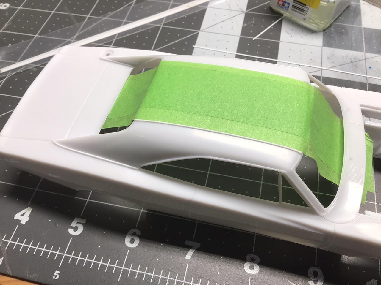

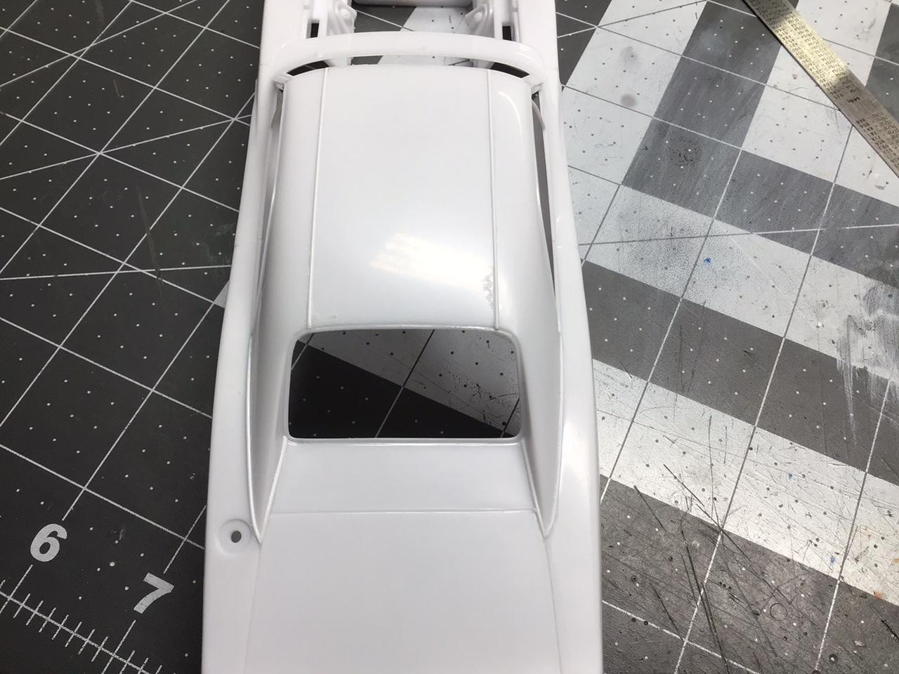

NOBLNG Posted September 13, 2020 Posted September 13, 2020 (edited) This is how I get the seams straight, parallel, and centered. Decide on the spacing between the seams and cut a strip of masking tape to suit. Once you get the tape centered, you can use it as a guide for gluing the seam strips on. I use Tamiya extra thin quick set cement in VERY tiny amounts and remove the tape asap. I then apply more cement If needed. Edit: That green painters tape left some residue that wasn’t the easiest to remove, so some better quality tape would be advisable. Edited September 13, 2020 by NOBLNG

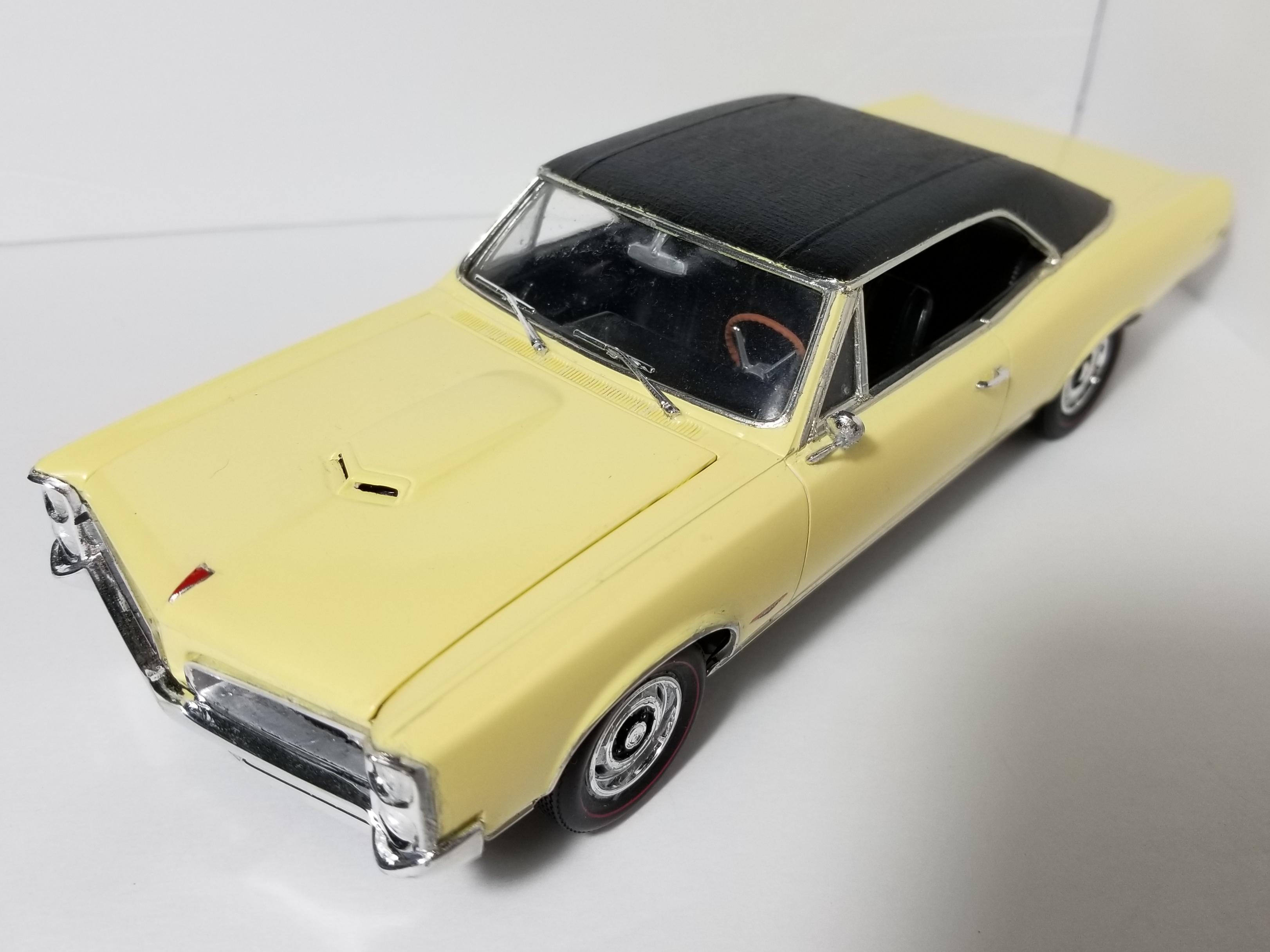

TransAmMike Posted September 14, 2020 Posted September 14, 2020 Here's my '66 GTO vinyl top. Masking tape, painted with craft acrylic. The seams are just an overlap of the tape and the chrome trim around the bottom of the sail panel is styrene strip.
