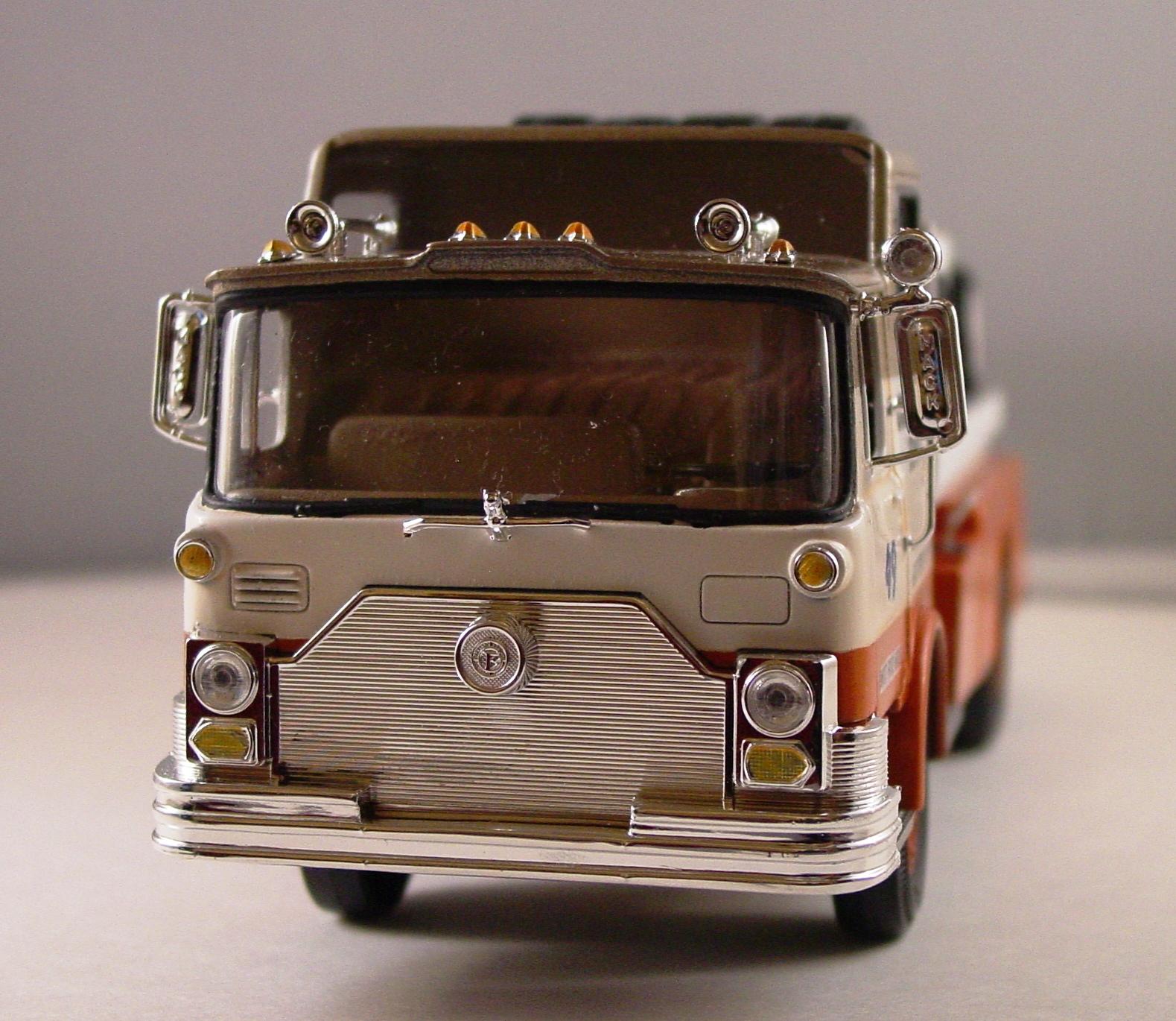

TarheelRick Posted September 17, 2020 Posted September 17, 2020 (edited) I remember this very technique presented as a "How To" article in one of the model car magazines. They used a cookie tray for a mold. Some of those trays come with excellent diamond patterns and other designs. They can also be cut and flocked to make cushions, like the sleeper cushion in my Mack race car hauler. Edited September 17, 2020 by TarheelRick
