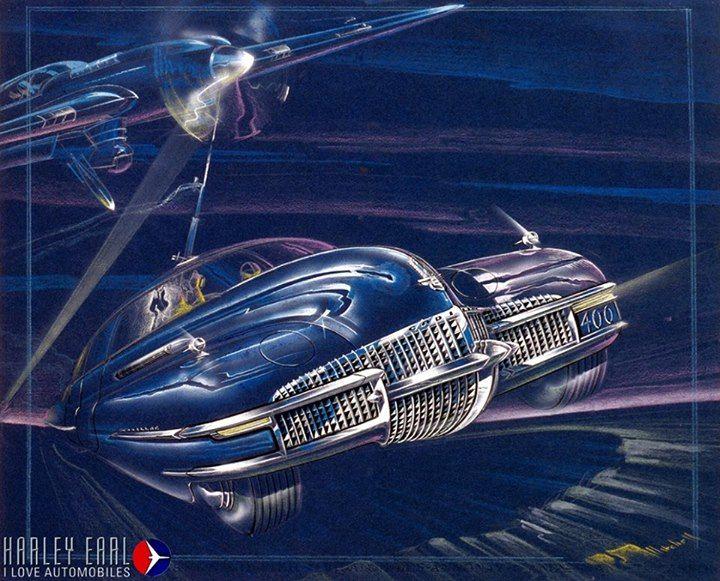

Paul Payne Posted September 14, 2020 Posted September 14, 2020 Does anyone make egg crate grille material thick enough to file into complex curves and shapes? I found this picture on line but scratchbuilding this grille would be daunting- I have no idea how I would even start. Any ideas appreciated!
Paul Payne Posted October 4, 2020 Author Posted October 4, 2020 After a lot of thought, I am going to try Evergreen structural shapes for something similar to what is pictured.
Lunajammer Posted October 28, 2020 Posted October 28, 2020 I would check the model railroad catalogs. I've purchased plastic grids and catwalks and/or fencing that have made nice automotive grills.
Paul Payne Posted October 29, 2020 Author Posted October 29, 2020 Lunajammer, I discovered some Evergreen structural shapes I am experimenting with. I tried the model railroad suppliers but what I found didn't have enough depth to contour. Right now I am laminating these together (WF sections) flat to flat and edge to edge. Laminating layers of the items you mention would probably work too, just didn't think of it. I will post pictures when I get a minute......

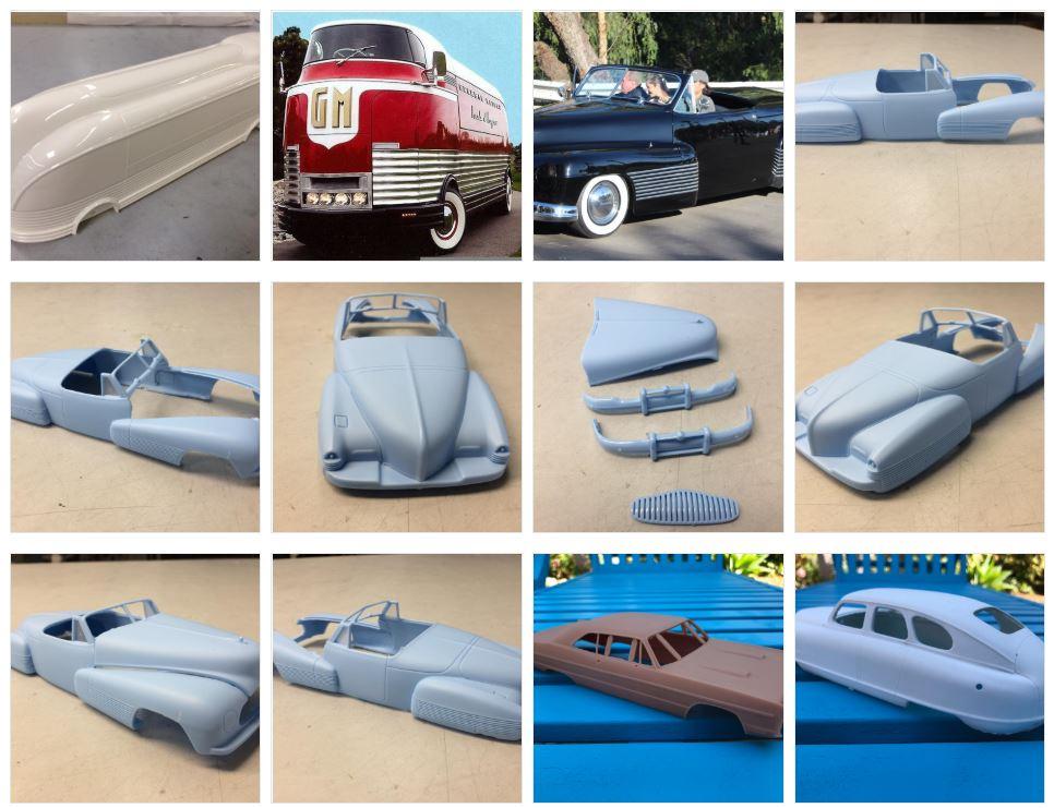

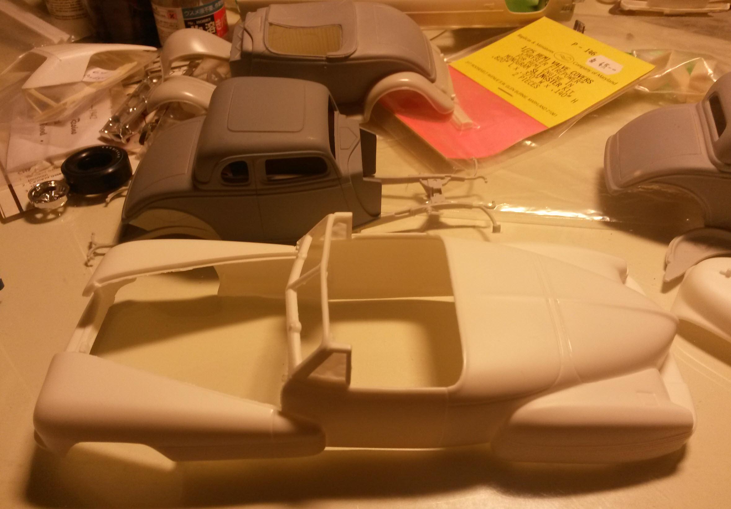

Claes Ericsson Posted November 16, 2020 Posted November 16, 2020 (edited) Robert Burns does a partial Y-job. Body, hood, bumpers & grille. He's on facebook as "Too many projects" and if you scroll way down in his gallery, you'll find these pics: Edited November 16, 2020 by Claes Ericsson
Paul Payne Posted November 16, 2020 Author Posted November 16, 2020 That looks really good- I assume it is 1/25th or 1/24th scale? Shouldn't be hard to fit a chassis and engine, as well as the interior.
Claes Ericsson Posted November 17, 2020 Posted November 17, 2020 Doing an approximate measure of the wheelbase, it seems to scale out to 1/24. AMT 34 Fords in the background.
