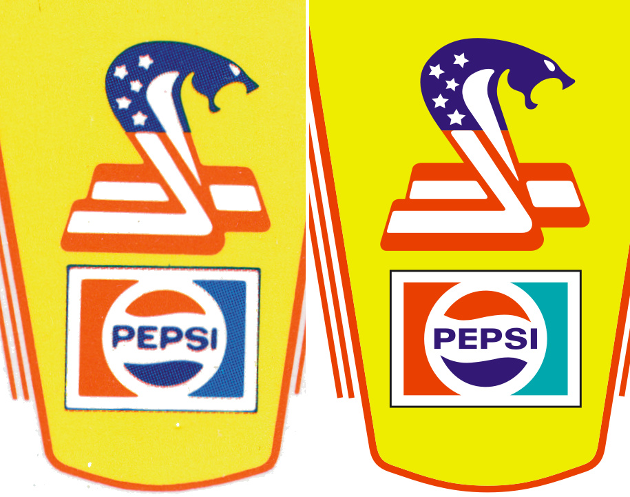

peteski Posted September 16, 2020 Posted September 16, 2020 (edited) Regardless of how high the scan resolution was, converting it to vector graphic will result in the best possible quality. And yes, it takes lots of time to create good quality print-ready artwork. I also own an old ink jet printer (HP DeskJet 890C) for non-decal printing. Here is an example of a scanned decal (left), and the image I converted to vector format (right). Of course this image itself its a bitmap, but it still shows how much clearer and sharper the vector-based artwork can be. Even the colors can be easily manipulated (made richer). Edited September 16, 2020 by peteski

Exotics_Builder Posted September 16, 2020 Posted September 16, 2020 9 hours ago, peteski said: Regardless of how high the scan resolution was, converting it to vector graphic will result in the best possible quality. And yes, it takes lots of time to create good quality print-ready artwork. I also own an old ink jet printer (HP DeskJet 890C) for non-decal printing. Here is an example of a scanned decal (left), and the image I converted to vector format (right). Of course this image itself its a bitmap, but it still shows how much clearer and sharper the vector-based artwork can be. Even the colors can be easily manipulated (made richer). You are quite right. I use CorelDraw to do my vector artwork. I will use the trace feature to get a rough vector and work from there. I have "cheated" a couple of times with a good bitmap or doing a hi-res scan. But the quality of the artwork is key
peteski Posted September 17, 2020 Posted September 17, 2020 On 9/16/2020 at 11:30 AM, Exotics_Builder said: You are quite right. I use CorelDraw to do my vector artwork. I will use the trace feature to get a rough vector and work from there. I have "cheated" a couple of times with a good bitmap or doing a hi-res scan. But the quality of the artwork is key I've been using Corel Draw since version 3, (I'm only up to version 12 now with no plans to go any higher). I have tried Corel Trace many times, but I have never been successful. Wither the tracings are too loose, or they have too many nodes. I have played quite a bit with the settings, and the resolutions of the scanned images, and I just gave up. It would take me more time to clean the traced images than to manually trace the bitmaps. I got quite good at manual tracing.
