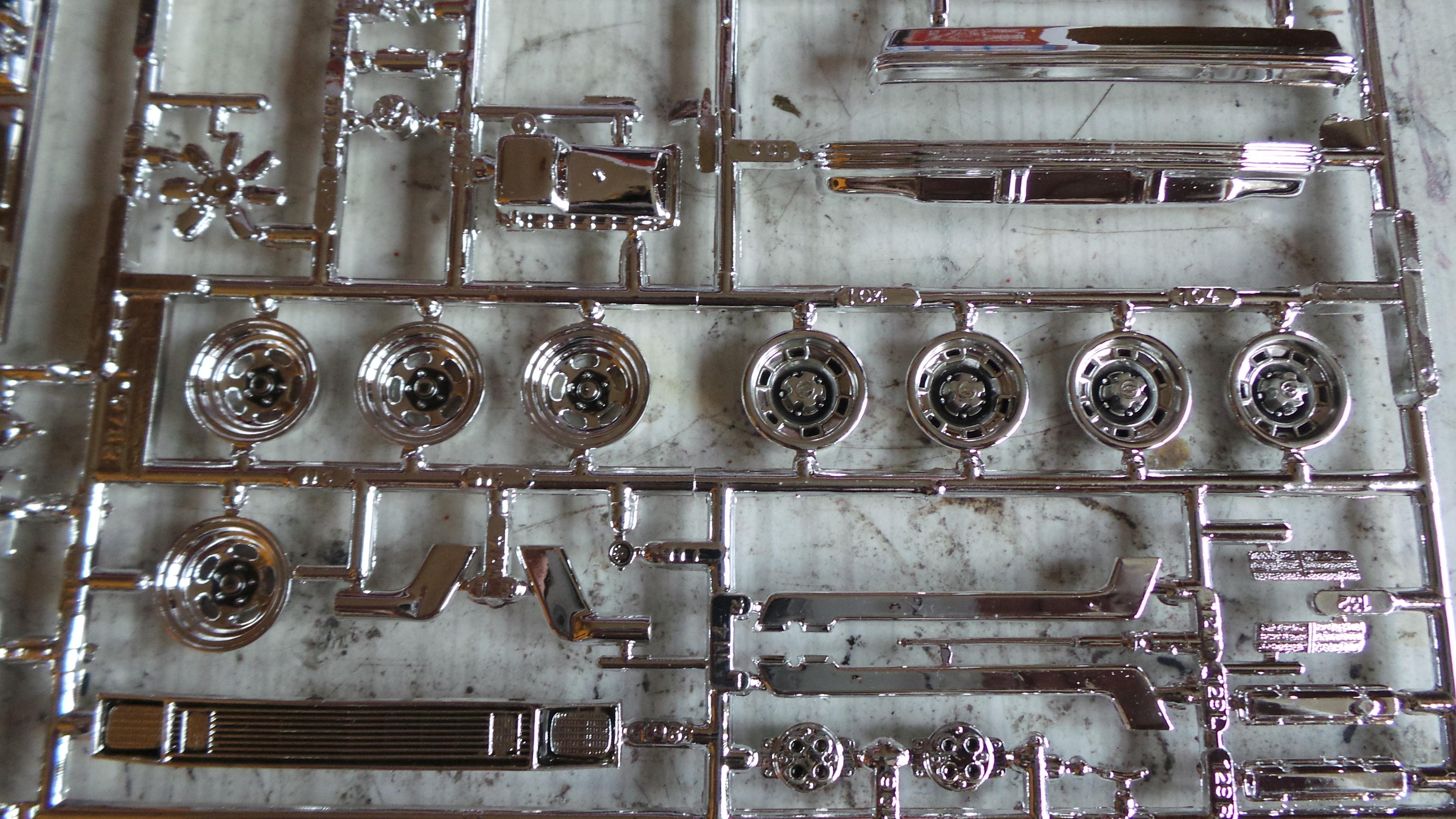

doorsovdoon Posted September 16, 2020 Posted September 16, 2020 (edited) While I'm waiting for the paint to arrive for my Pontiac Grand Slam I've started on this 1979 Chevy Nova Squad Rod. I certainly won't be building the toy that's on the box art, I'll be doing factory stock with a vinyl roof and some aftermarket Rostyle wheels. Going through the contents the kit looks to be very well moulded with basically no flash or seam lines. The chrome pieces look very well done and the interior is nicely moulded with good detail in the dashboard and some very nice looking bucket seats. Another kit it would seem where the box art doesn't do the contents justice. Edited September 16, 2020 by doorsovdoon

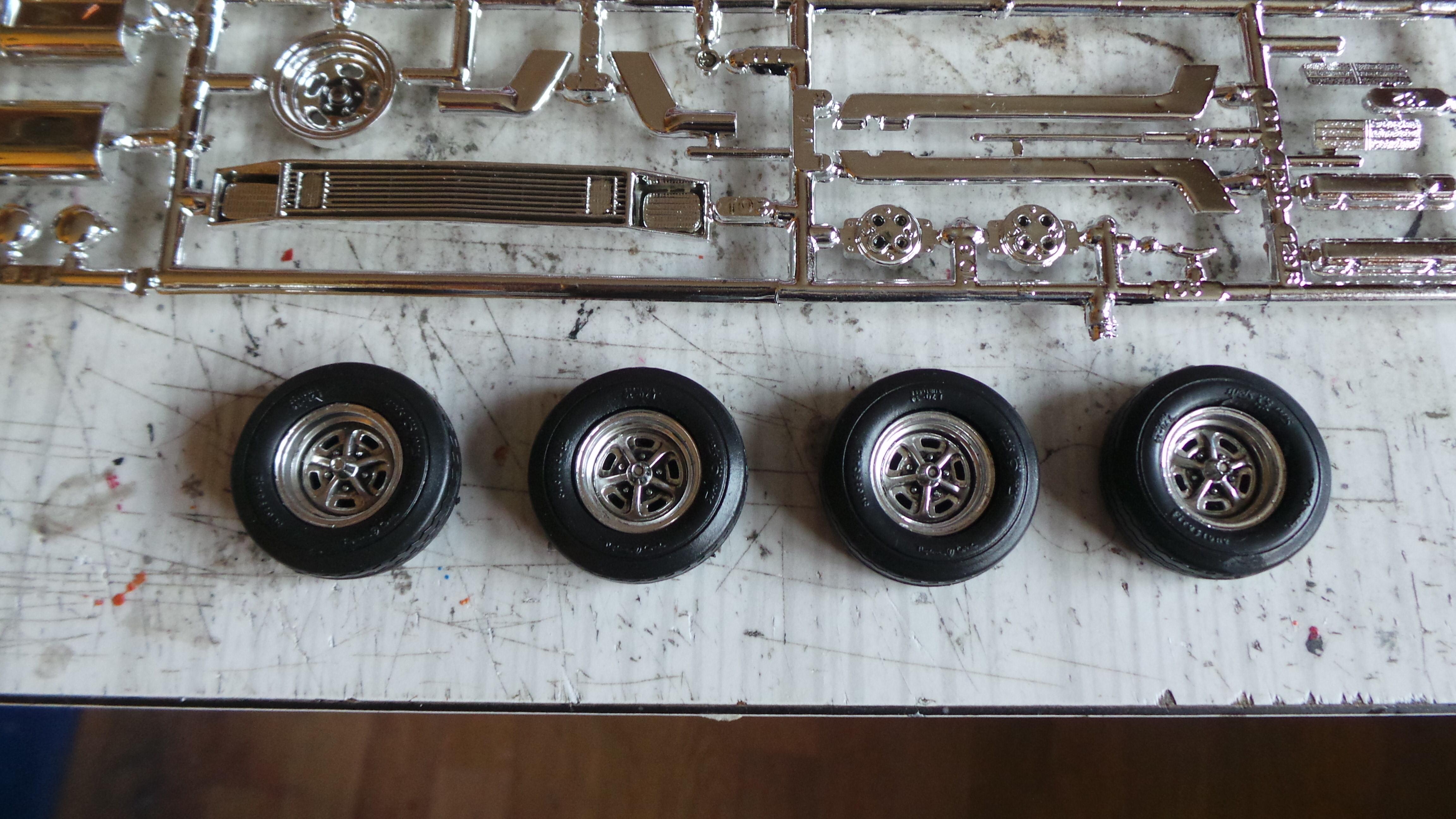

doorsovdoon Posted September 16, 2020 Author Posted September 16, 2020 The only real changes I'll be making to this is a set of Rostyle wheels from the '66 Olds 442 and a vinyl roof.
espo Posted September 16, 2020 Posted September 16, 2020 Good looking vinyl roof. You mention using Rally Wheels, and the OEM Chevrolet Rally Wheels are on the chrome parts tree. The Oldsmobile wheels look good also.

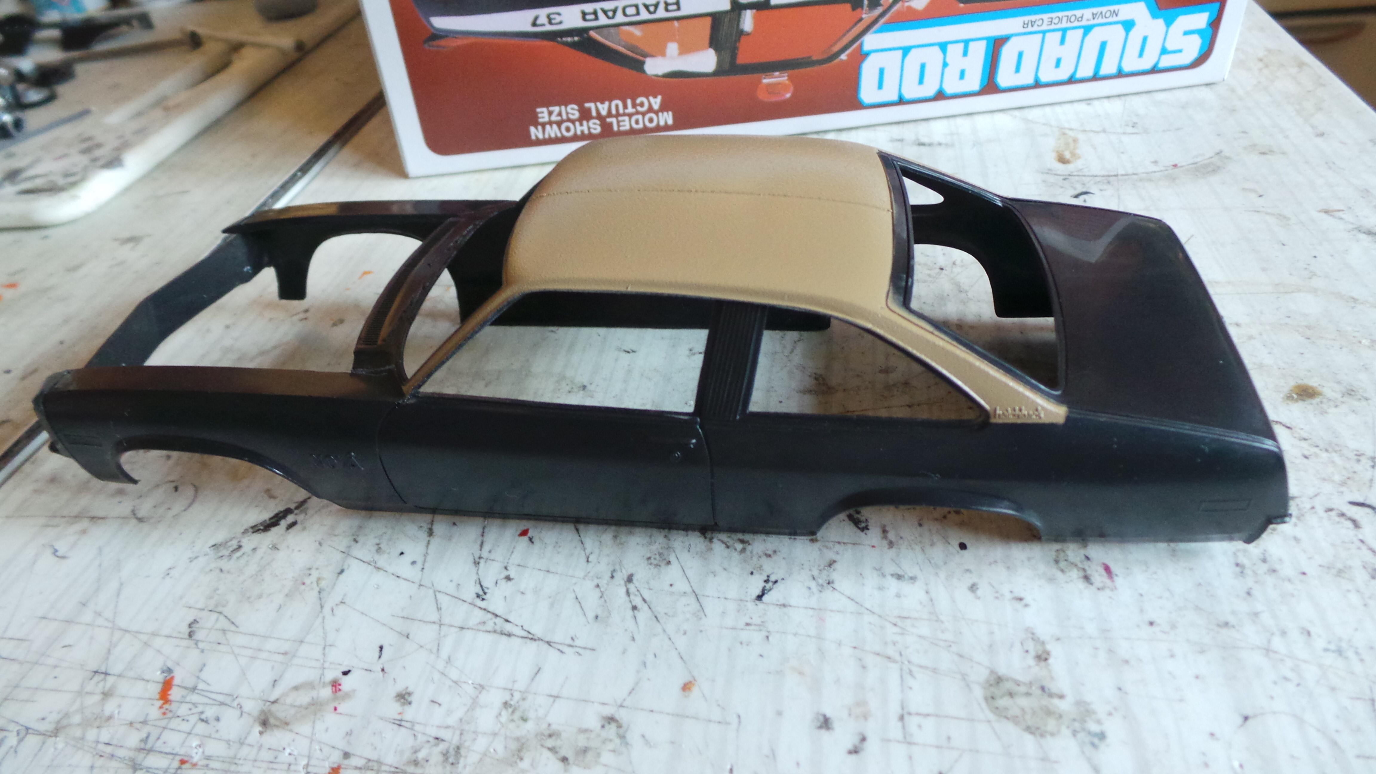

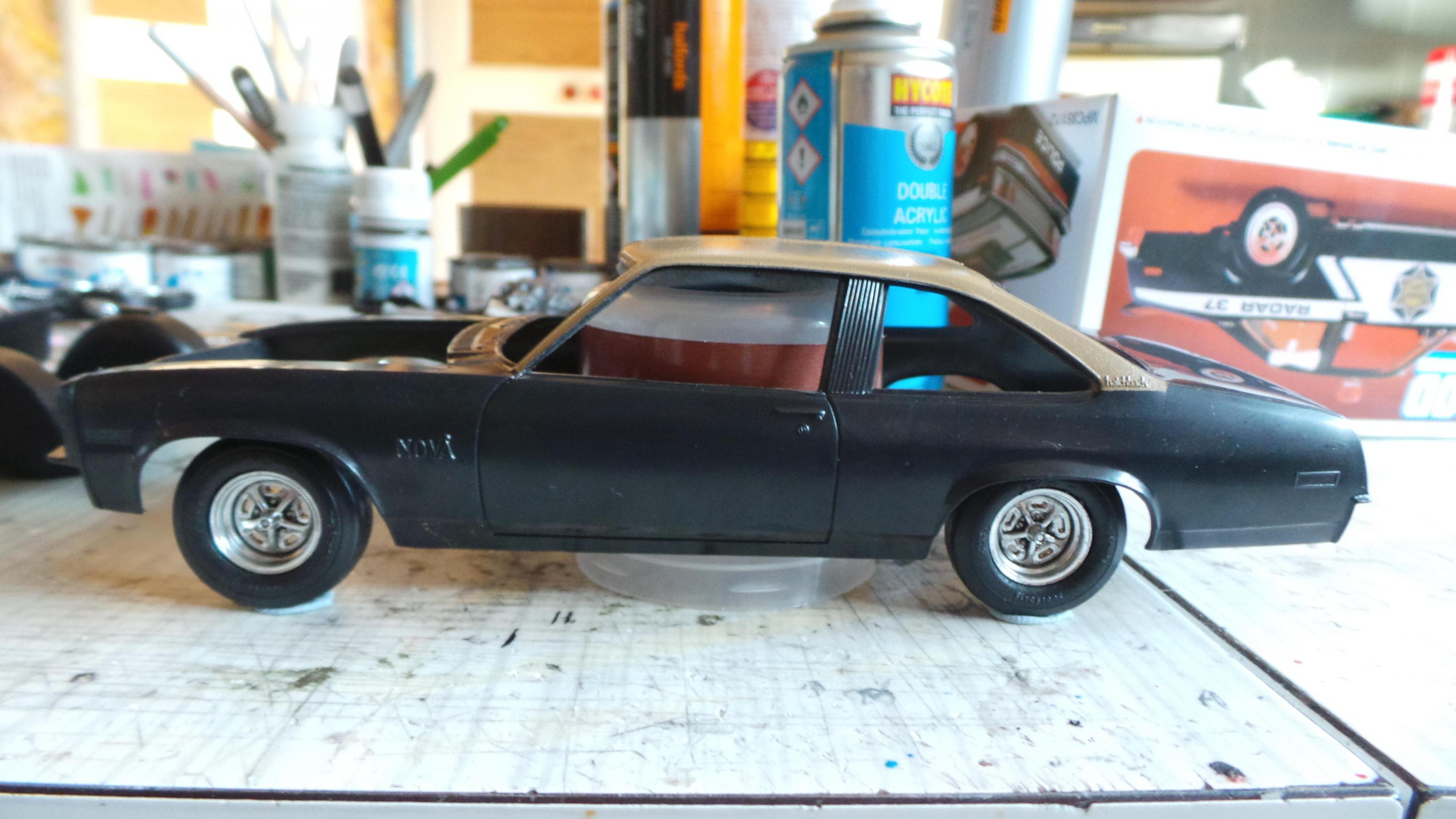

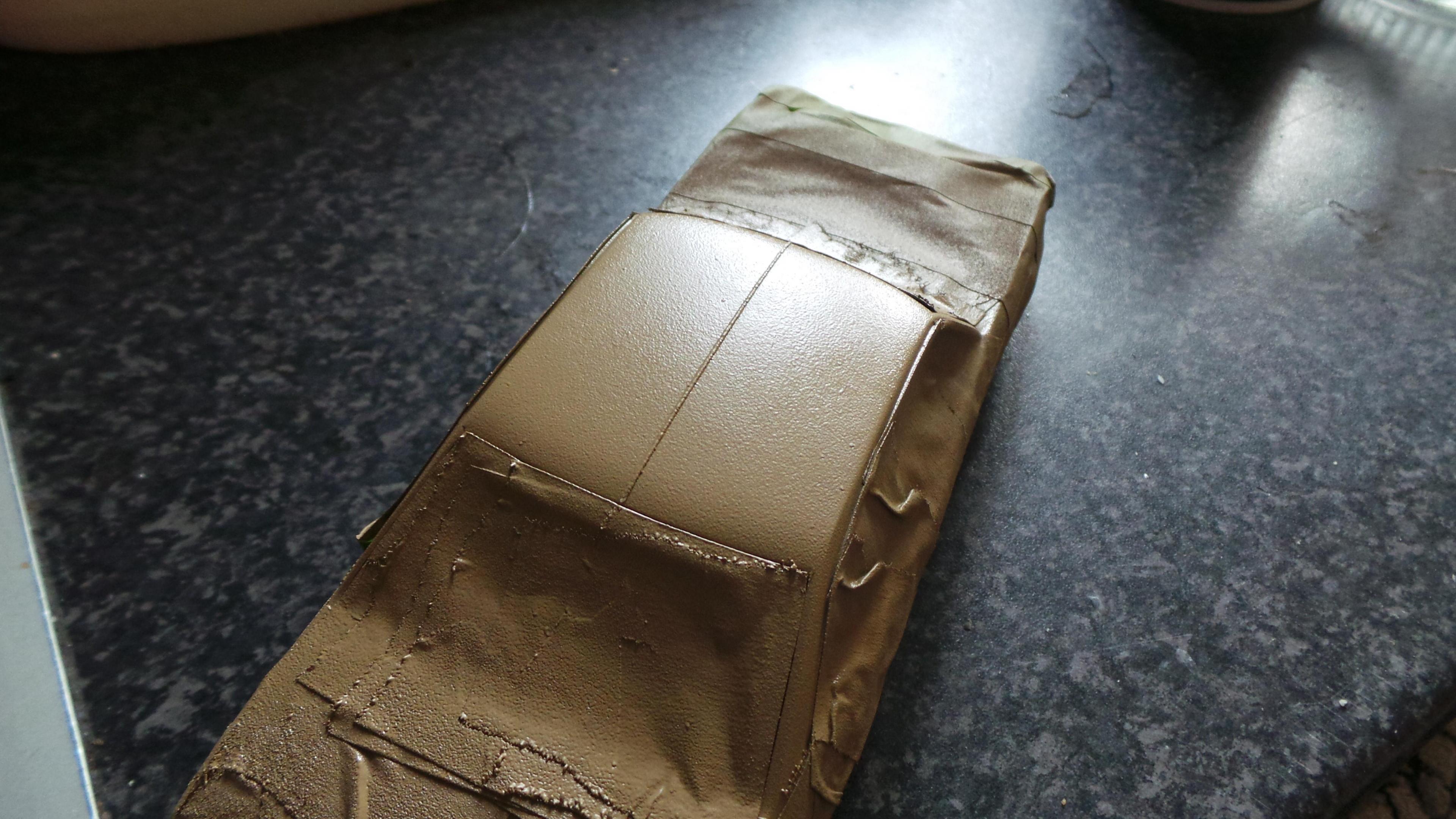

doorsovdoon Posted September 16, 2020 Author Posted September 16, 2020 Rostyle, not Rally. The Olds 442 wheel design is called Rostyle in the UK. Vinyl roofs are easy. The seam line is done with high build primer after laying down two strips of masking tape with a gap between. I then peel the tape off leaving a raised line of primer. I then paint the whole roof in the colour I want by holding the can a good three feet away so that the aerosol almost dries before it hits the roof, leaving a texture. I'll either give it a slightly heavier once over at the end or polish it to remove the dusty look this method gives.
doorsovdoon Posted September 16, 2020 Author Posted September 16, 2020 Vinyl roof already done and a quick mock up of what it'll look like. The colour I'm going with is Aztec Bronze.
