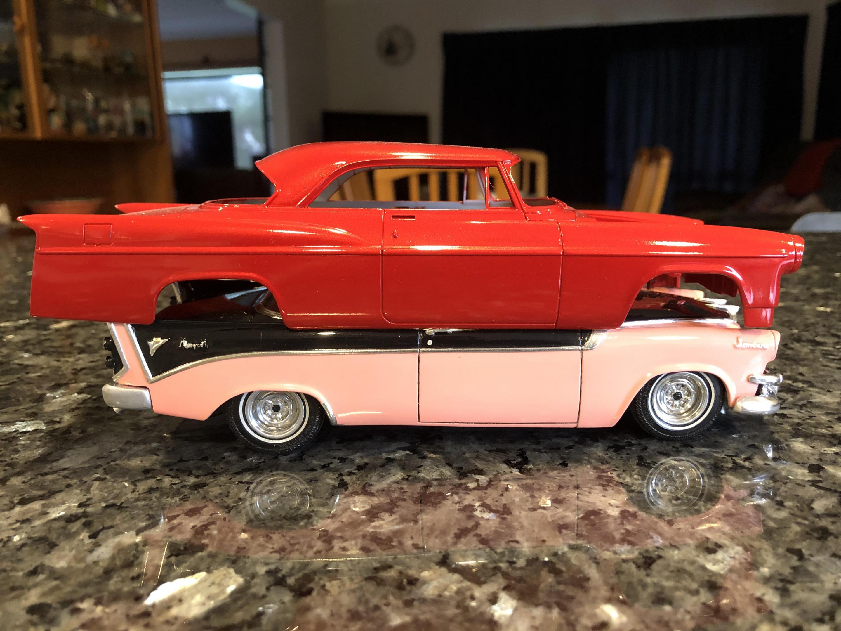

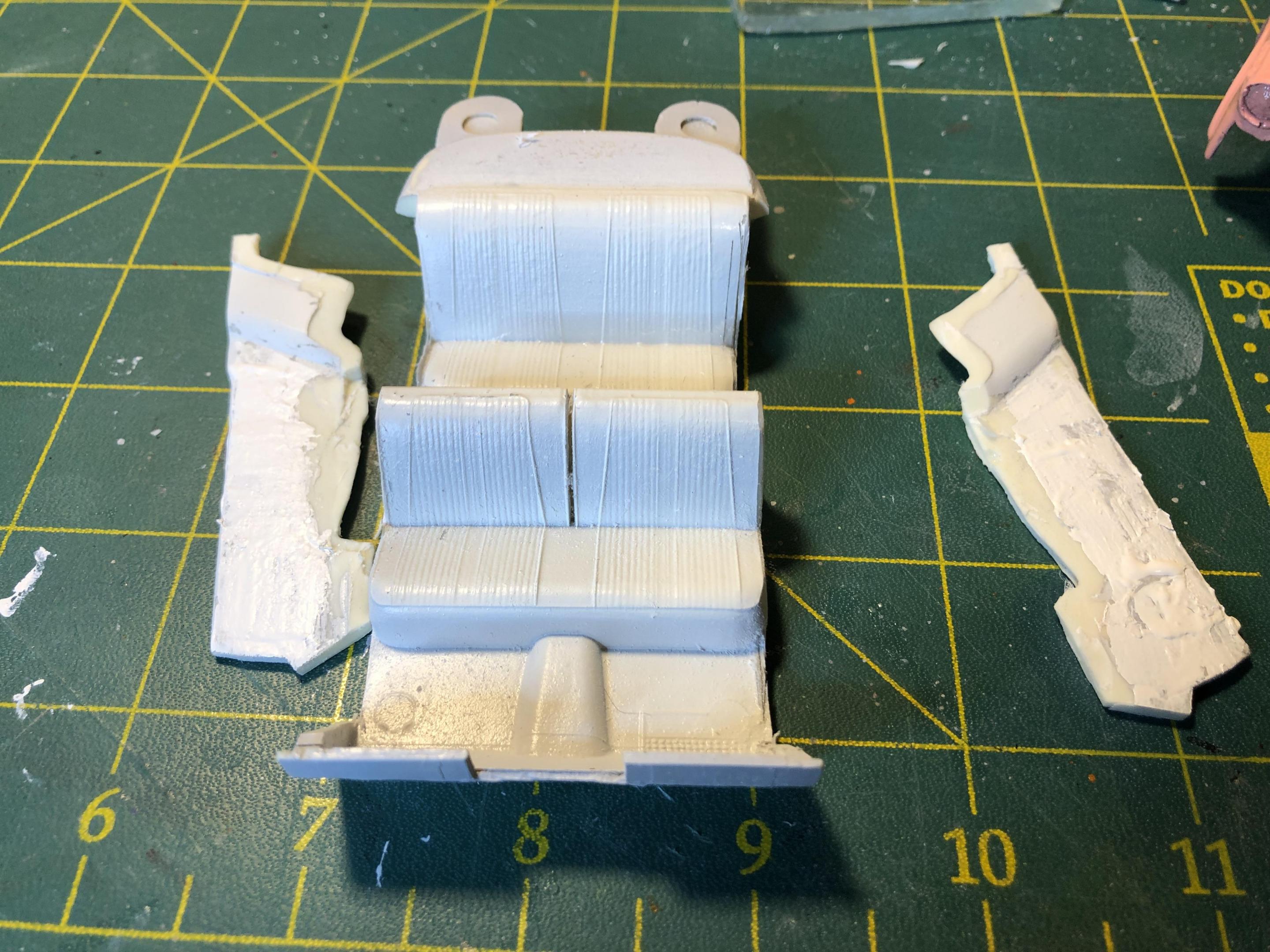

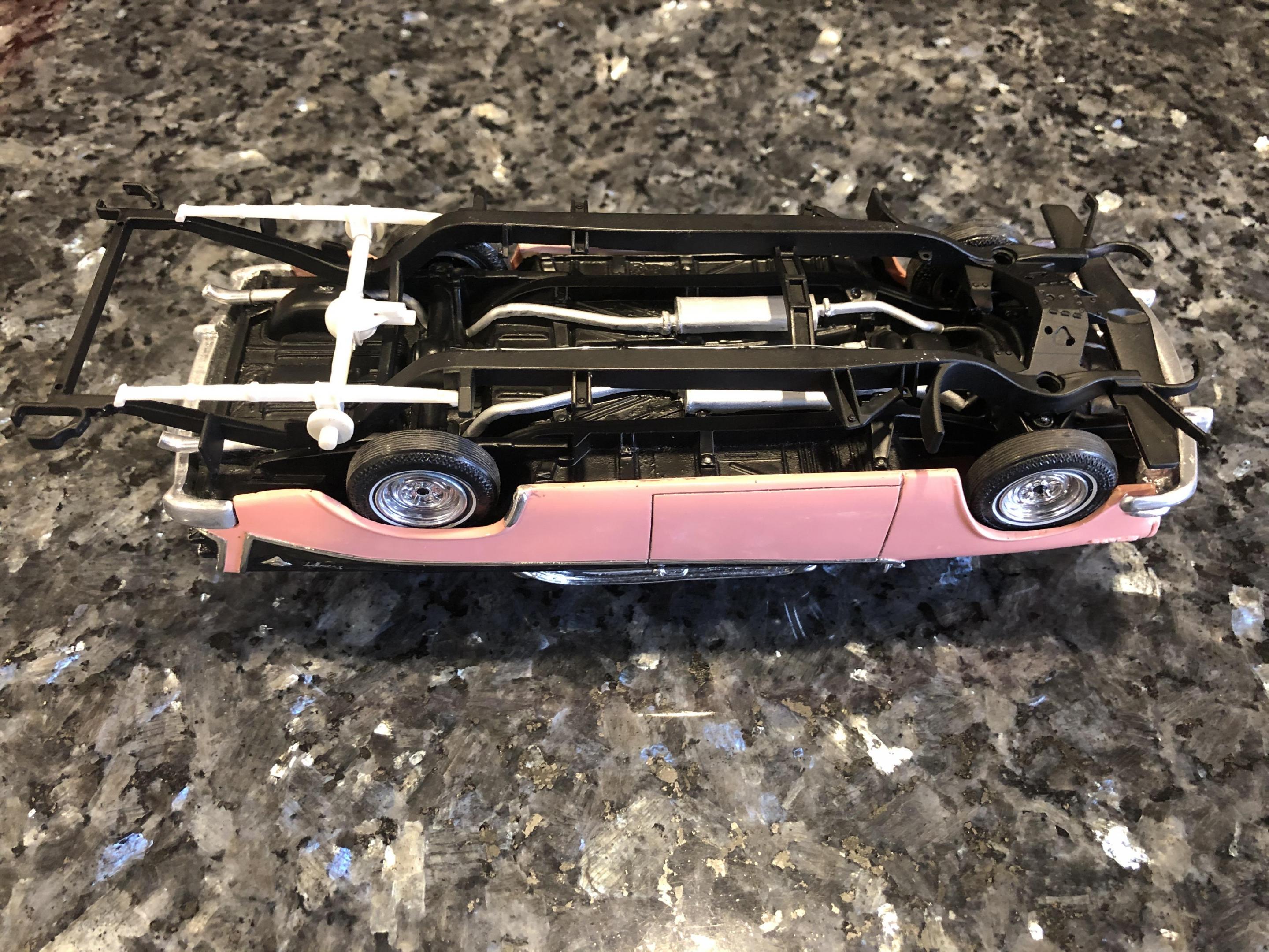

bill-e-boy Posted October 2, 2020 Posted October 2, 2020 The 55/56 Chrysler is way bigger than the Dodge. In 1/25 and in real life See pix below where I have piggy backed the 56 300B on top of the 56 Dodge and a chassis shot I did a build up of a MCW 56 Dodge Custom Royal Lancer earlier this year. The interior is tub style so I cut the sides off to detail them then glued it all back together I did not go much further with detail upgrades and stayed with the resin chassis and built it curb side I modeled it after the full size car I own The 55 and 56 Dodges were very similar and were the last of the old style chassis. The 57 is a totally different beast. I suppose the 57 Plymouth "Christine" may be considered as a donor but there are a lot of differences. Same deal between the 56 P and 57 P cars as for Dodge Doug - the rendering looks awesome
