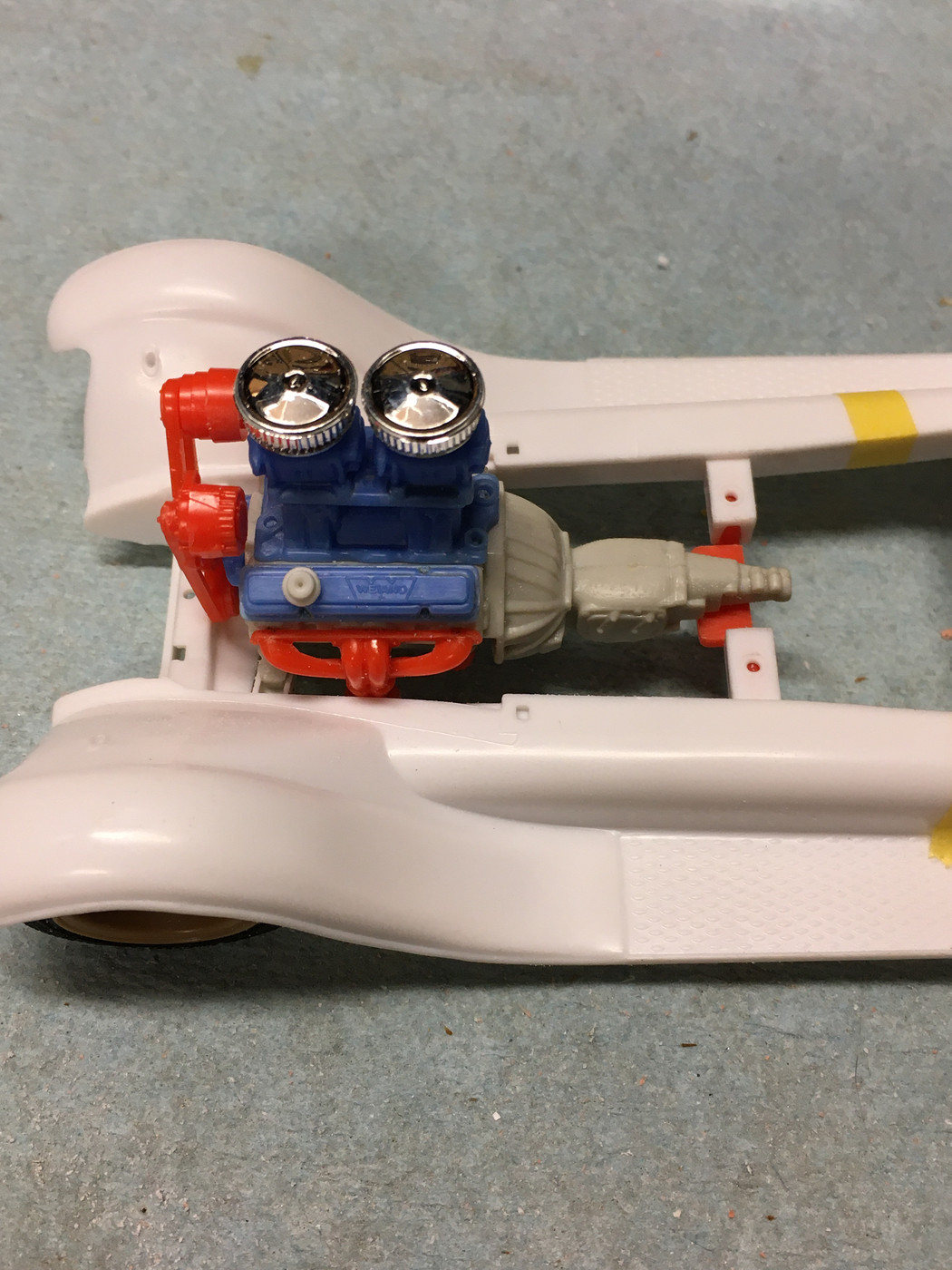

Dennis Lacy Posted September 28, 2020 Posted September 28, 2020 (edited) Many of you should know the name Tim Boyd @tim boyd by now as he has been a regular contributor to model car magazines for decades. One of his biggest focusses in the hobby is scale Hot Rods and Street Rods and the pages of those magazines have been filled with his how-to projects. He also used to do a monthly column for Street Rodder Magazine called "Modelers Corner". One particular issue, the May 1990, left a huge impression on me and remains one of my favorite scale Street Rod how-to articles of all-time. I was 10 years old when this issue came out and actually didn't discover it until I was 13 when I spent a summer reading through my Dad's entire back catalog of Street Rodder. I ended up keeping the May 1990 issue aside and over the years read it until the binding came apart. Not only did I love the scale Street Rod that Tim created and the detailed how-to that he provided, I also loved that the Editor saw fit to print the article all in one shot rather than break it up over 2 or 3 issues as Tim has stated was the original plan. Here is the intro to the article. Note that with this being printed in 1990 this means the model was actually created in 1989 using the best Street Rod kit bashing parts available at the time from such kits as Monogram's 1937 Ford Sedan and ZZ Top Eliminator Coupe, as well as, AMT's controversial 1933 Ford Sedan Street Rod - Not to mention Revell's 1929 Pickup kit as a foundation. Current pictures of this model can be found in Tim's Fotki account and today it still looks to be in pristine condition: https://public.fotki.com/funman1712/tim-boyds-124th--12/boyd-street-rods-ra/boyd-closed-cab-hot/ When I was about 16 I finally felt decent enough at model building to set out and build my version. While it wasn't an exact copy it borrowed heavily from Tim's ideas and parts sources. my version turned out pretty nice but, unfortunately, didn't stand the test of time and no longer exists. This new version isn't going to be an exact copy either but, like the first one 24 years ago, will be heavily influenced once again by Tim's article. Starting out with an initial mock up I decided to deviate on the wheel selection. Tim used the Boyd Coddington "billet" wheels from Monogram's original '37 Sedan release. I am going to be using these equally 80's correct 3-piece style wheels from AMT's (not so great) 1957 Corvette Flip-Nose Gasser. I've been hanging onto these wheels for about 25 years now(!) and I've finally found the just-right model for them. I stripped the chrome and they will be treated to a satin finish down the road. I'm using the same rear tires as Tim, the FAT BFG radials found in many of Monogram's kits in the 80's and 90's. The front tires are from AMT's Gasser wheels and tires parts pack of a few years ago. The wheels were a loose fit in those big rear tires so I wrapped them in 1/8" wide strips of .015" Evergreen sheet to tighten them up. I then took a pair of front inner wheels from Revell's '32 Ford kits and cut the spokes and hubs out to create the inner wheel halves. Up front I thinned down the inner wheel halves from AMT's 1949 Ford Coupe. I also took care of the engine set up today. In Tims article he has a close up of his finished engine and states, "Now get bust on your version of a small block Chevy...", encouraging you to have your own ideas. Tim used the engine block, trans, heads and front cover/water pump from AMT's '33 Sedan Street Rod. I am using the same pieces although in reissued form from the 5-Window Coupe follow up to the Sedan which used the identical chassis and engine. This engine was great for fitting into early Ford hot rod frames because of the easy to use mounts coming off the front corners of the oil pan. My version uses the Weiand valve covers and tunnel ram intake set up from AMT's 1966 Nova Pro Street along with the same engines timing cover / water pump. The belt drive, accessories, oil filter and headers are from the original issue of Monogram's 1937 Sedan. The air filters are from Revell's Stacey David Rat Roaster. I also added separate breathers to the valve covers which come with the '34 5-Window engine. I modified the header flanges by thinning them down to a more realistic appearance. I also cleaned up the radius' of the pipes that this exposed. Prior to doing this access to the inner spark plug locations were obstructed so that was my main motivation. Also note that originally the oil filter was molded together with the oil pan. I cut that away so a separate, better detailed filter could be used. That's as far as I got today as I didn't have the full day at the bench I usually do. Definitely more to come soon! Edited September 28, 2020 by Dennis Lacy 3
Plowboy Posted September 28, 2020 Posted September 28, 2020 Cool project Dennis! I'll be tuned in 'til the end! Can't wait to see what you do with this! Just an FYI. Those wheels have plenty of material to spare to open up the spokes and it makes a world of difference in their appearance.

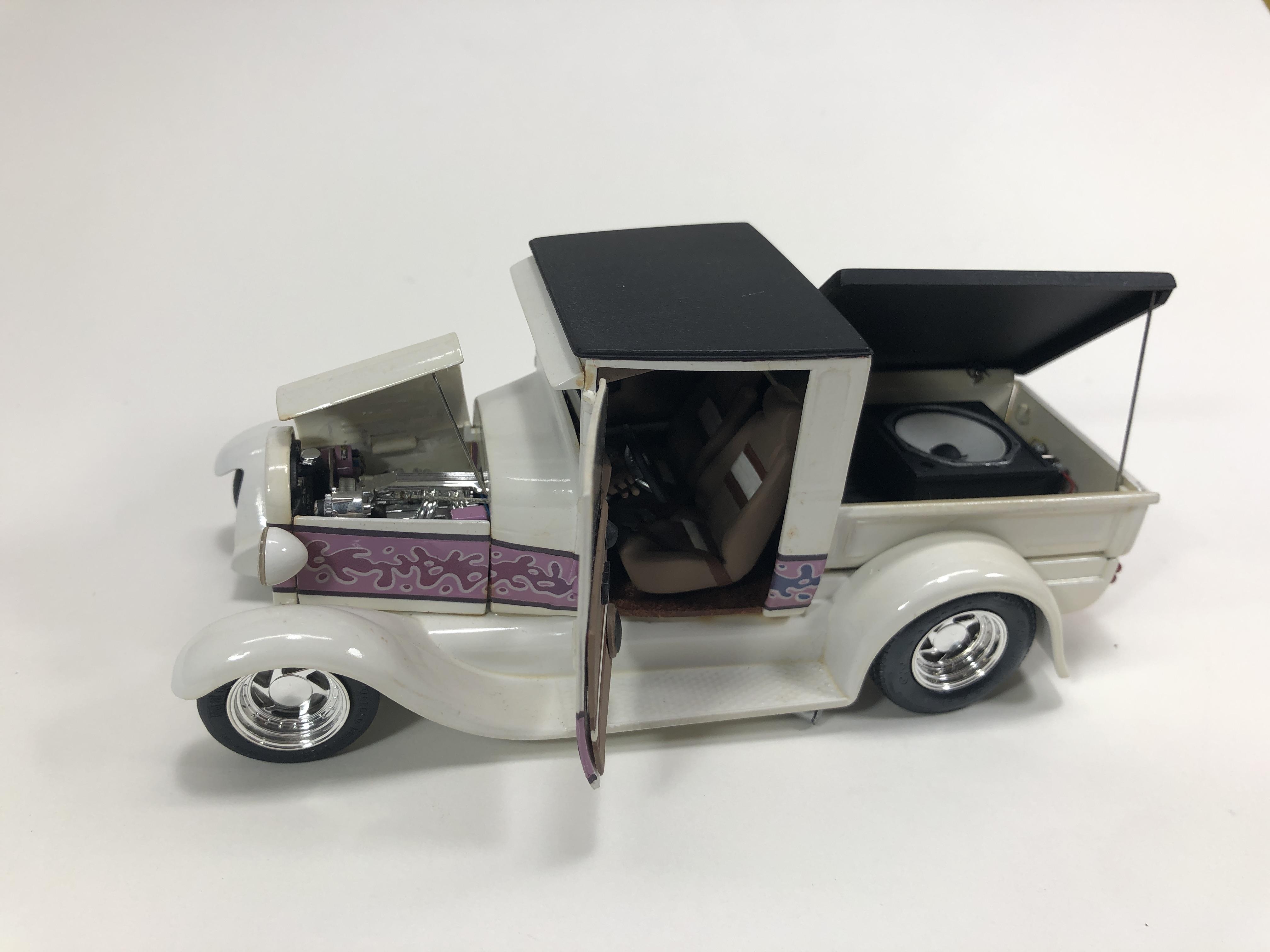

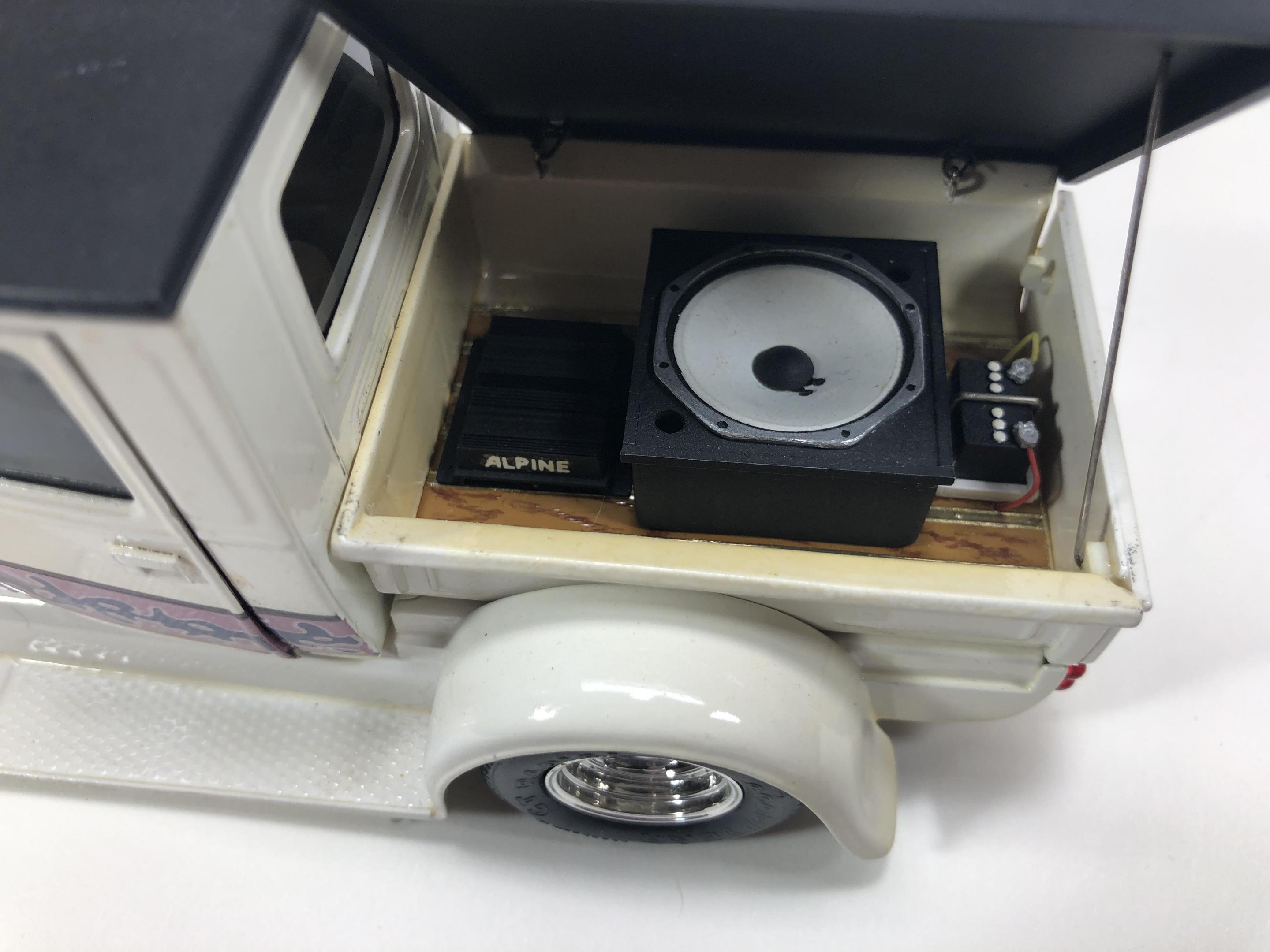

Rocking Rodney Rat Posted September 28, 2020 Posted September 28, 2020 (edited) THIS IS GOING TO FUN! Not to hijack your thread, ADL, but I too was influenced by Tim Boyd to build my version of this when the article came out in 1990. I used a Corvette IRS, but did use the same TPI induction as Tim did. I'm not sure where the wheels came from! Ugly now, but the bomb then! I also filled the bed with a subwoofer (a suction cup in a scratched made enclosure) and an amp. Unfortunately, this build has not fared very well, got dropped once by a club member taking it to a show, I put it back together. I snapped a few quick pix today. The white paint has yellowed. It did win Best Use of Graphics in the Pacific NW NNL in Portland OR in 1991. It's survived a few moves....here it is in all it's glory (again, sorry for stomping on our post).... -RRR Edited September 30, 2020 by Rocking Rodney Rat 3

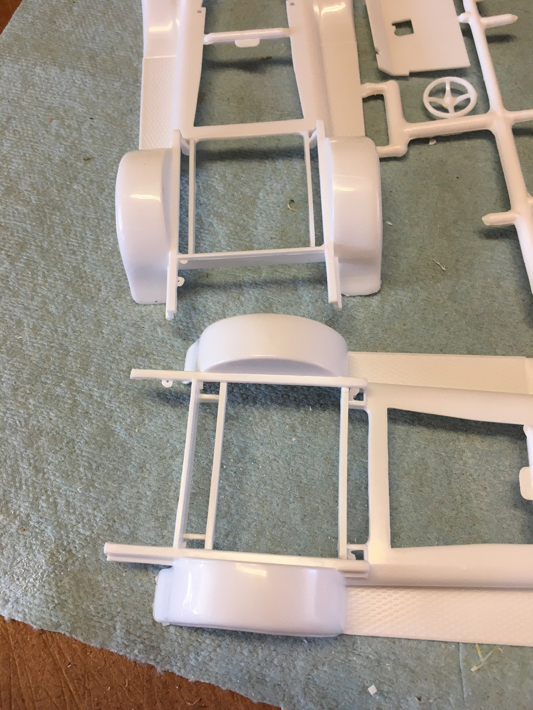

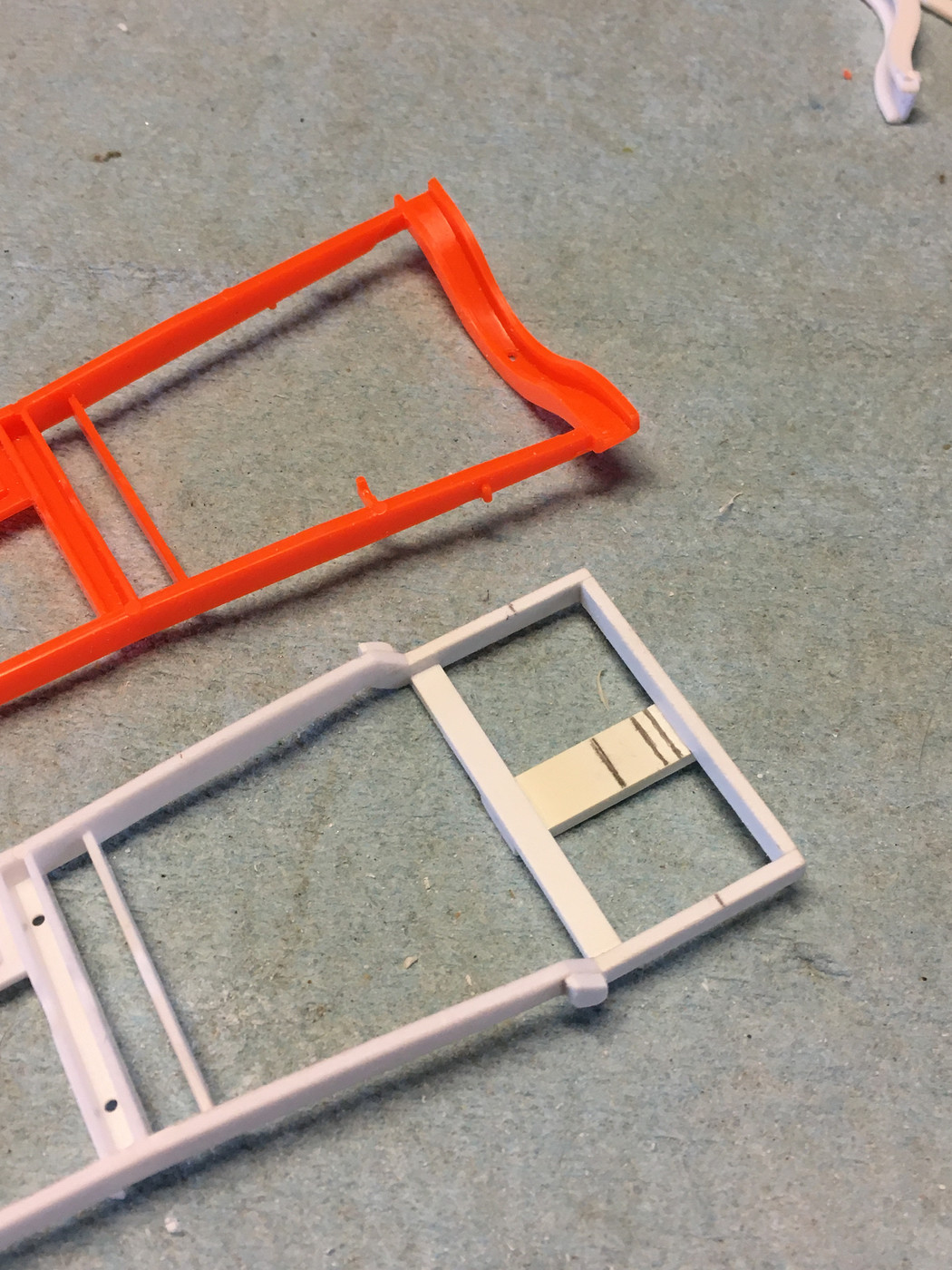

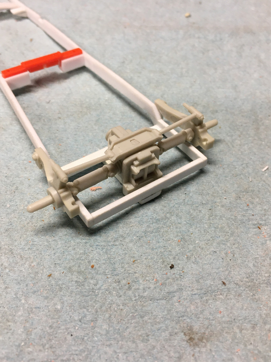

Dennis Lacy Posted October 12, 2020 Author Posted October 12, 2020 UPDATE! Back at it and now it's time to focus on updating the chassis. The first order of business was to modify the under bed supports to accommodate Z'ing the frame. The original front-to-back supports would be in the way so I installed a pair of left-to-right braces made from Evergreen rectangle rod then removed the middle sections of the original supports. (Original top, modified bottom.) Here you can see in the original article that Tim Z'd the back of his frame to help get the back end low. He was able to do this using a single frame and then trimming the rear cross member to still fit beneath the bed. I approached mine different by cutting off the back end of the frame and building a new rear section from Evergreen rectangle stock. I stacked the front edge on top of the original frame rails and then angle cut the tops and bottoms to create the "Z" look. I then added an aditional cross brace and fore/aft member which will make more sense later. Here you can see how the Z'd frame fits up into the modified under bed structure. Tim used a modified Monogram Jaguar XKE independent rear suspension which he fit the modified original rear cross member. I don't have a Jag IRS on-hand so I decided to go with another staple hot rod IRS, a Corvette unit. This one comes from AMT's 1934 5-Window Coupe Street Rod. The whole reason for running a Jag or Vette IRS in one of these Model A pickups is the impressive wide open view from the rear to show it off! Tim built his transmission mount and center "X" structure using pieces cut up from Monogram's '37 Ford creating a very stout and realistic looking frame. I started to modify the center cross member the same way Tim did, by cutting the center member out of a Monogram '37 Ford frame (left) and trimming it down to fit inside the stock Model A center member (middle). A stock Revell A frame is shown (right) for reference. I didn't get to creating the "X" braces yet, that will have to wait for next time. I made some front engine brackets from .040" bottom plates and .020" side gussets. I had to get the engine as far forward as possible so the tunnel ram induction will clear the firewall. I don't have the rear wheels adapted to the Corvette IRS yet and I didn't get to the front axle set up so I simply taped the frame to the fender unit and then set the fenders onto the wheels and tires. With the engine located and mocked up we can at least get a look at how that stacked tunnel ram small block fills the engine bay with the air filters just above the top of the cowl. I couldn't have hoped for a better result! That's where I ended up this afternoon. Let me know what you guys think! @tim boyd 4

Rocking Rodney Rat Posted October 12, 2020 Posted October 12, 2020 (edited) I was waiting for your update as well (I got sneak peek via text last night)....nice going....having a Jag IRS available at a reasonable price sure would be cool. Maybe Norm at RMCM would be able to make one of these? -RRR Edited October 12, 2020 by Rocking Rodney Rat 1
