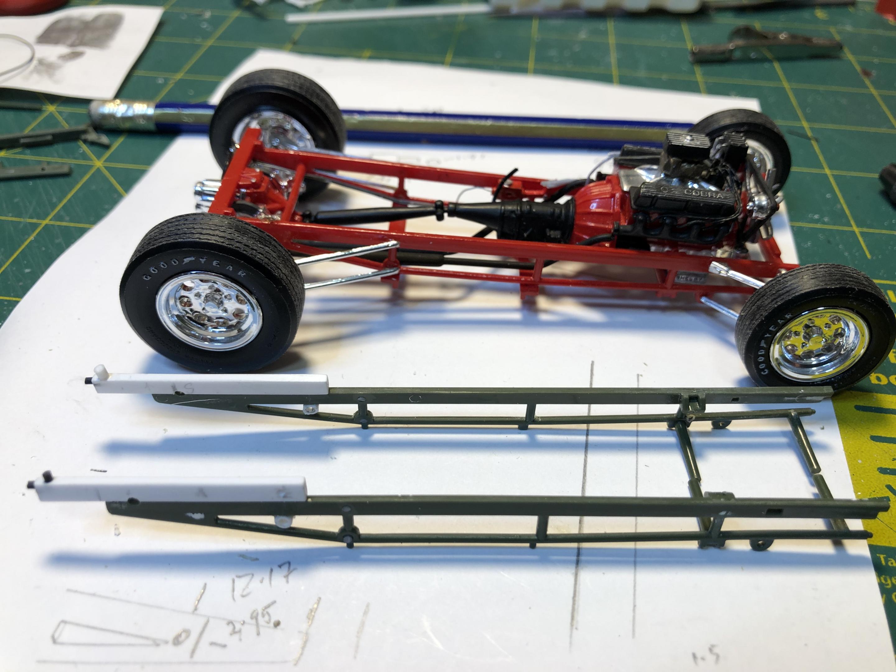

I measured the T frame and wheel base is 99mm. I them mocked up the A guards with the Lil John chassis and got a measurement of 106mm so I will need to stretch the frame by that amount. I ended up by gluing on a piece of 3x1.5mm rectangular on which I had picked up the rear cross member and shock mounting tabs. I then relocated the mounting points for the rear end radius rods. The rear tubular cross member will be replaced by some 1.6mm round stock as it mounts the disc brake calipers
This should put the tires into the rear fenders better. I will need to work on the splash apron as the front wheels need to be moved forward by about 1mm
Pix shows modified frame in front of assemble Lil John chassis

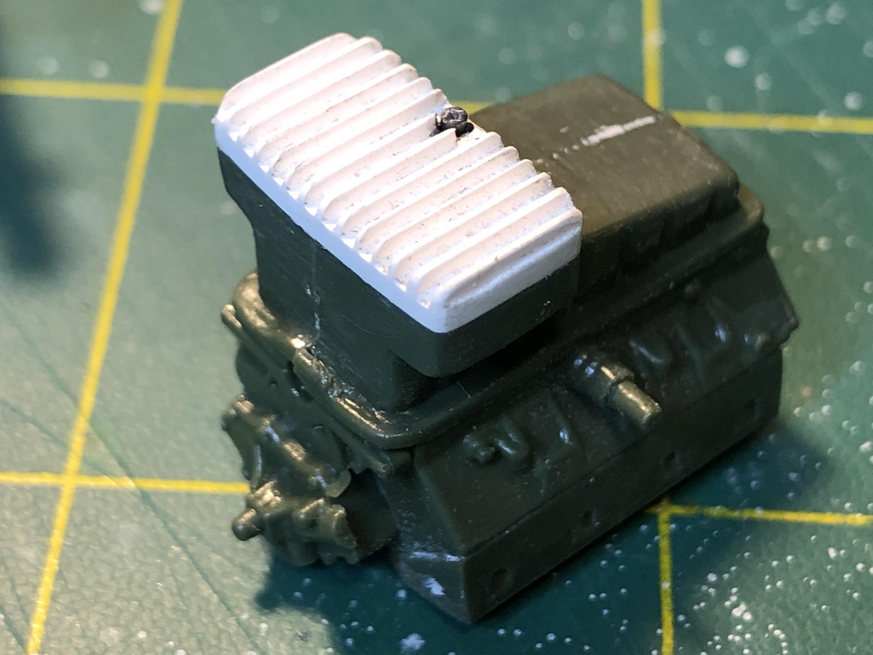

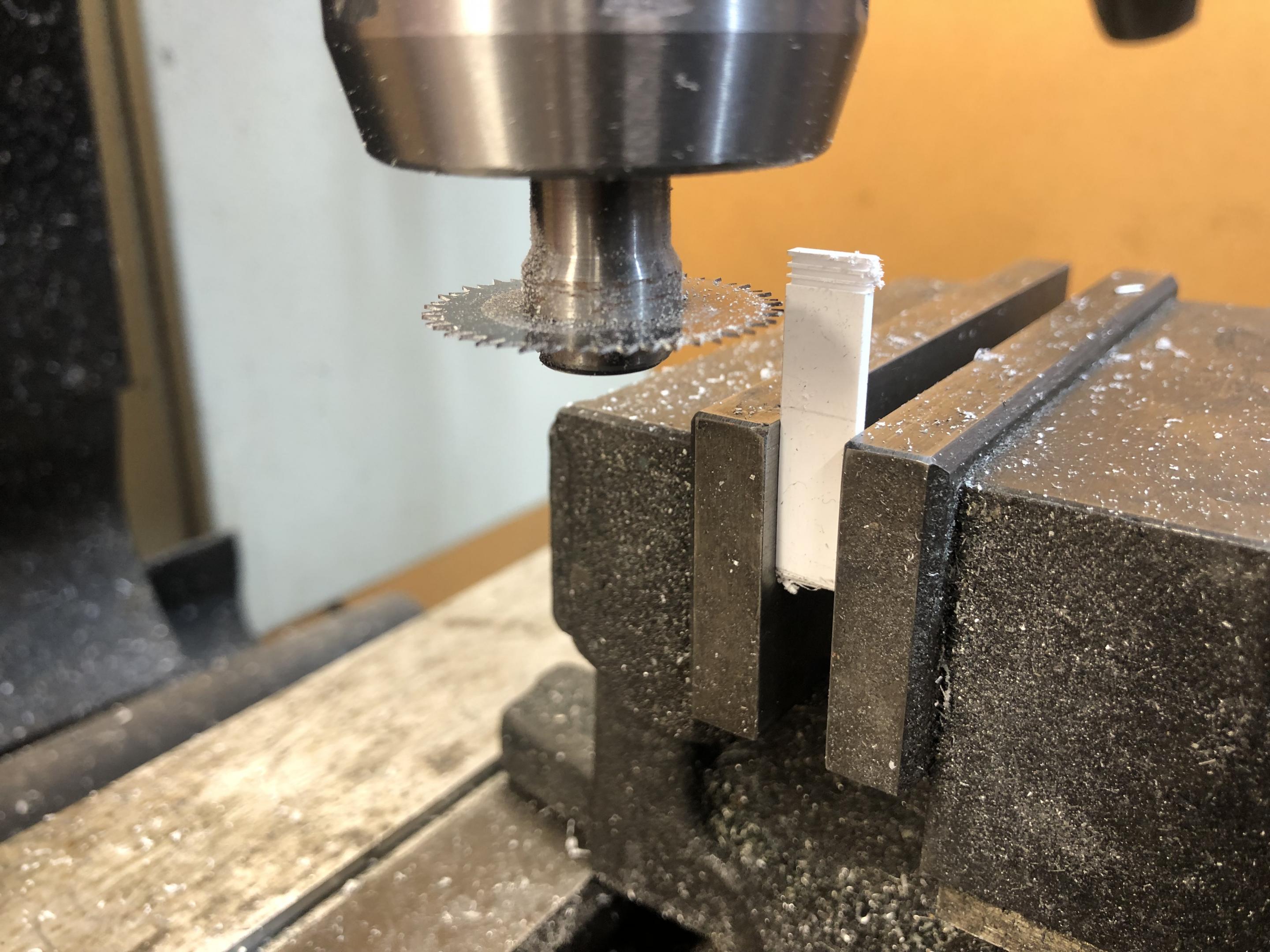

On with my build - I was not happy with the Revell take on the finned oil pan on the motor. I can se how this came about due to the shape of the motor as it was moulded in two halves with the oil pan incorporated with the motor. Answer was to machine up a block of plastic to represent the fins and to glue that ono the motor and shape it up. Un fortunately the Cobra script got sanded off in the shaping process.
Pix are of milling the fins and the motor with fins added
Milling the fins

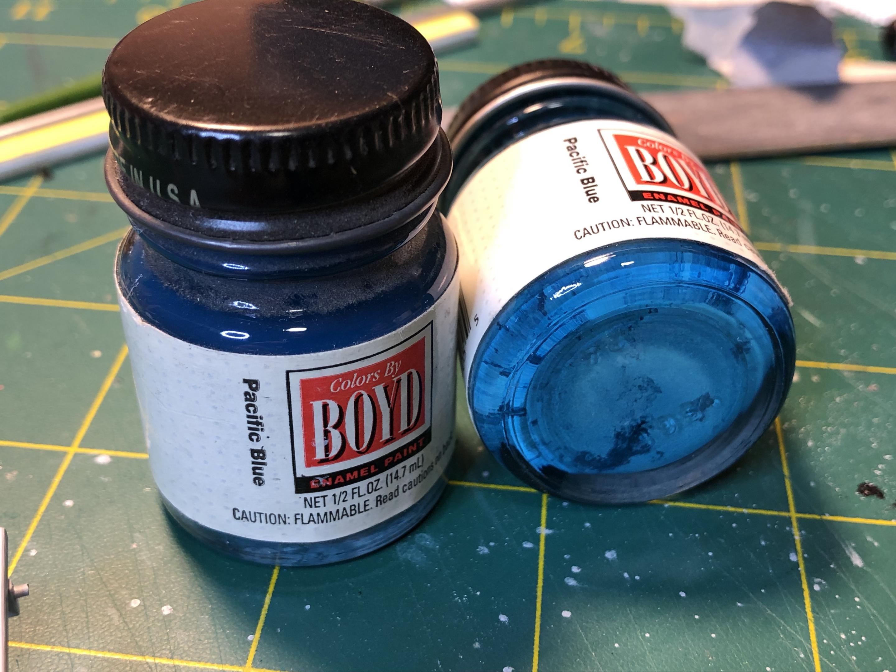

The next on the list was a colour - not happy with a clone pink - times have moved on from the 80/90's
Looked at the new lacquer options from Tamiya and nothing turned my crank other than a dark blue metallic so I got some but still not overly happy. I dug out my stash of old Testers enamels and found a few bottles of Boyds Pacific Blue - that ticks a few boxes - Boyd Coddington the famous billet rod builder, colour choice period perfect and the enamel medium suits the time period
So next step finishing prep work on the chassis and getting some colour laid down
 thanks for looking
  • Like 1
Bill....Colors by Boyd (Coddington) Pacific Blue...truly a period-perfect choice (and one that still looks cool today, too).  TIM

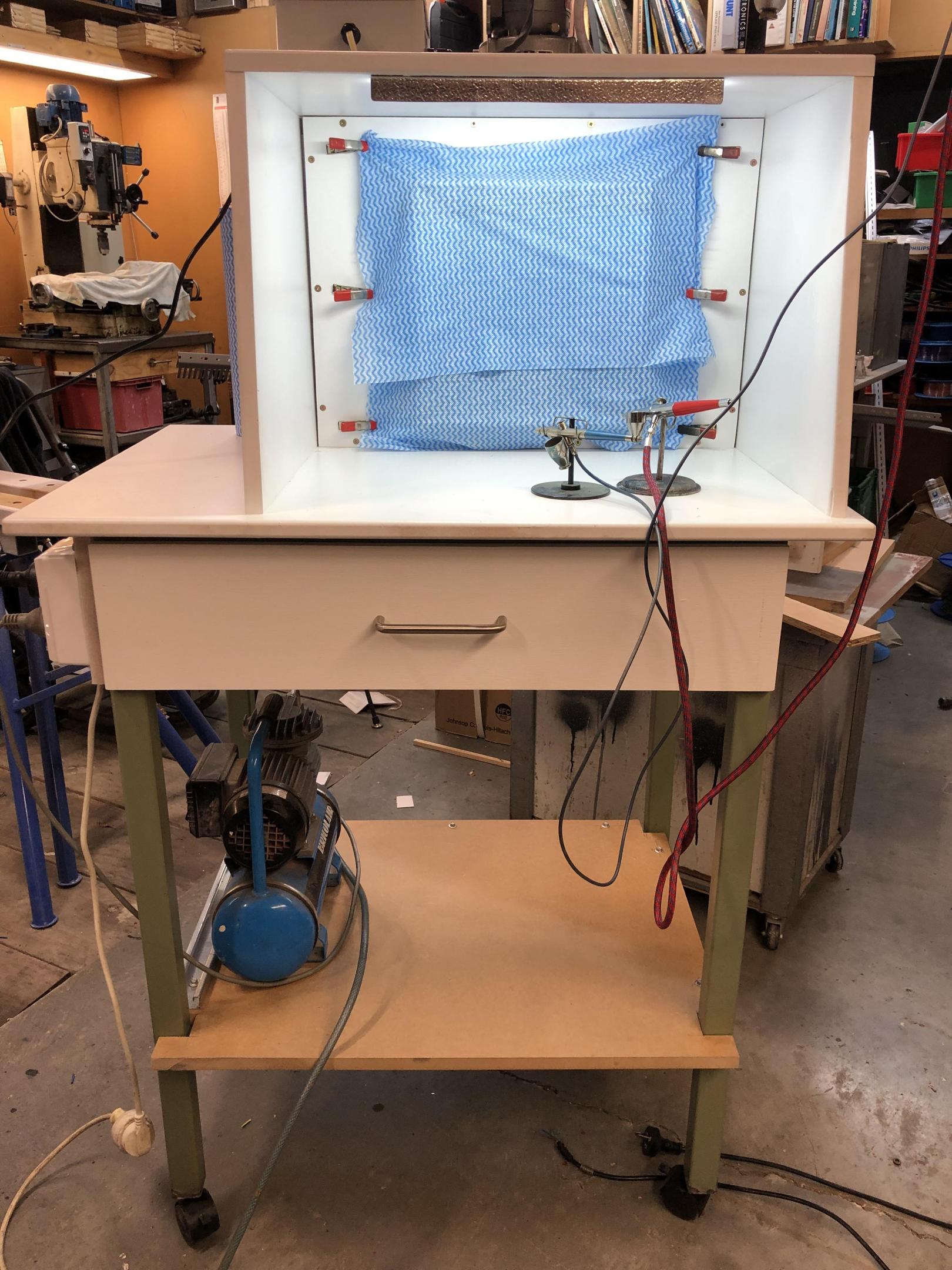

The spray booth is almost done so I can go back to some modeling. It has been one of those bucket list things to get done - I have been collecting bits for a while so the only thing left to do is to incorporate the hot box below the spray booth part

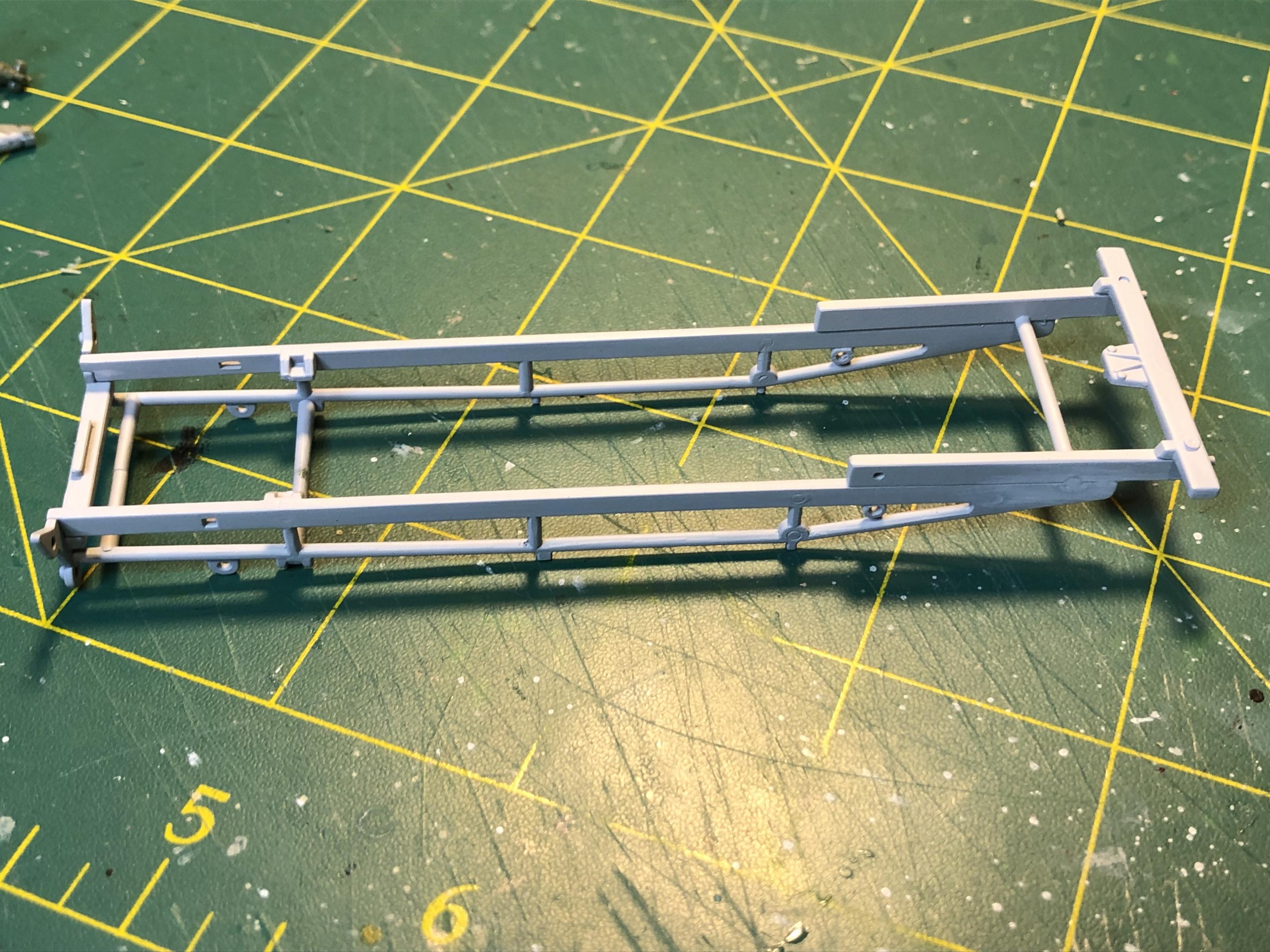

Trimmed out the excess original frame work...
Added the new framing...
