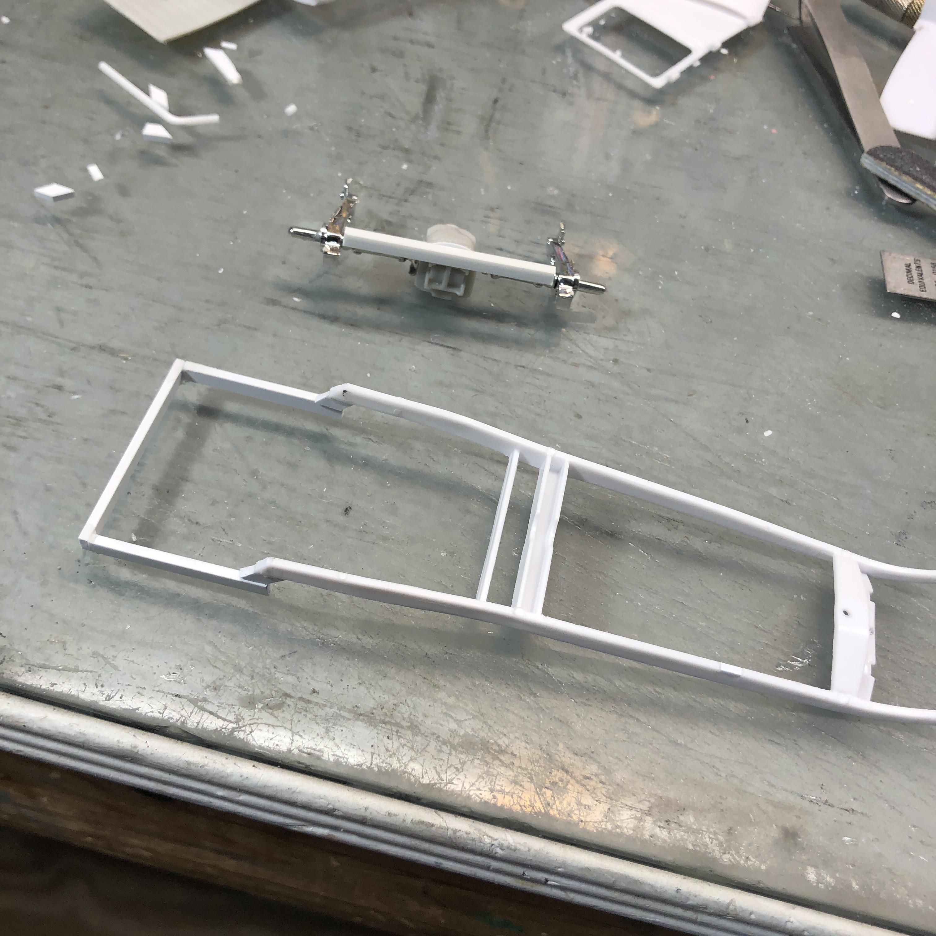

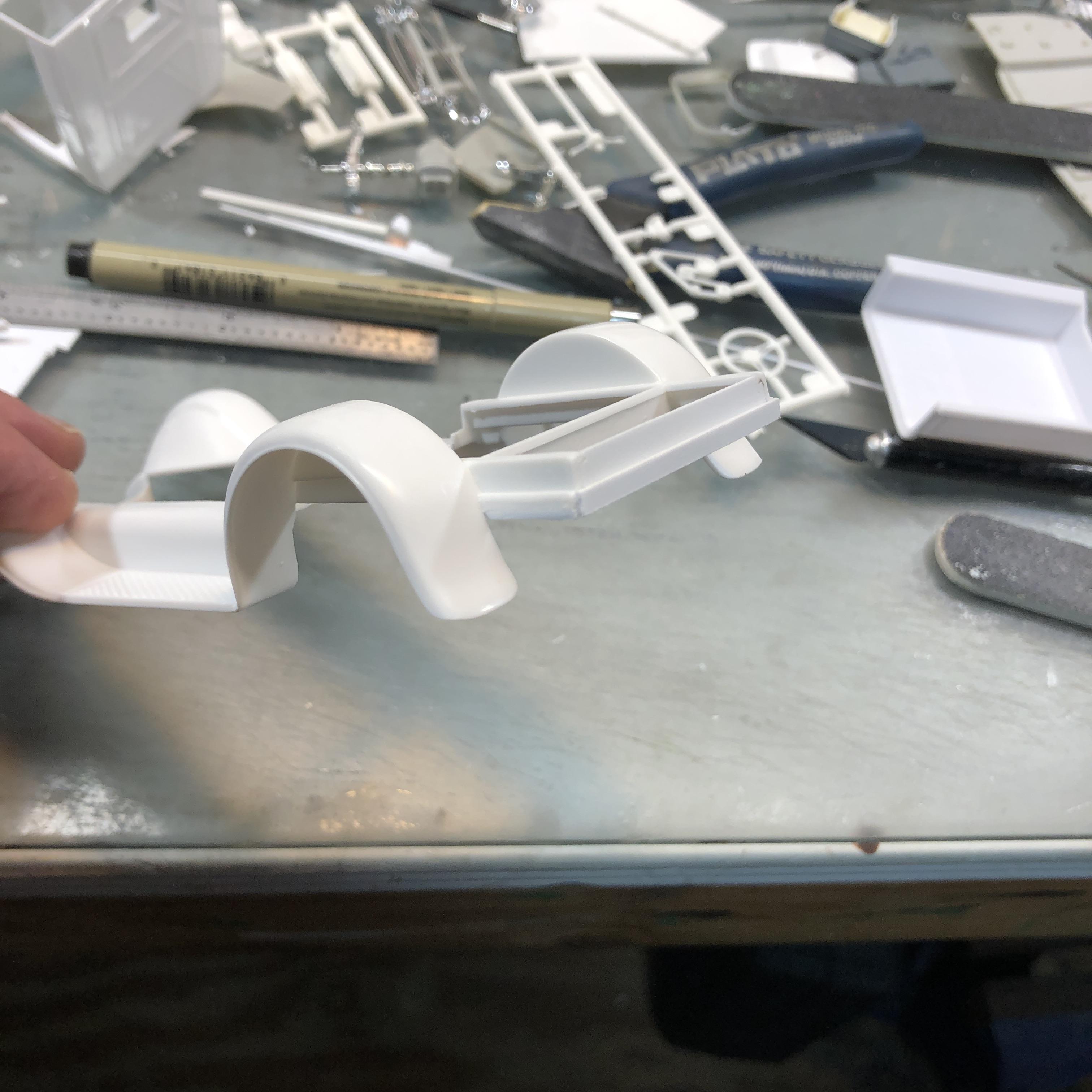

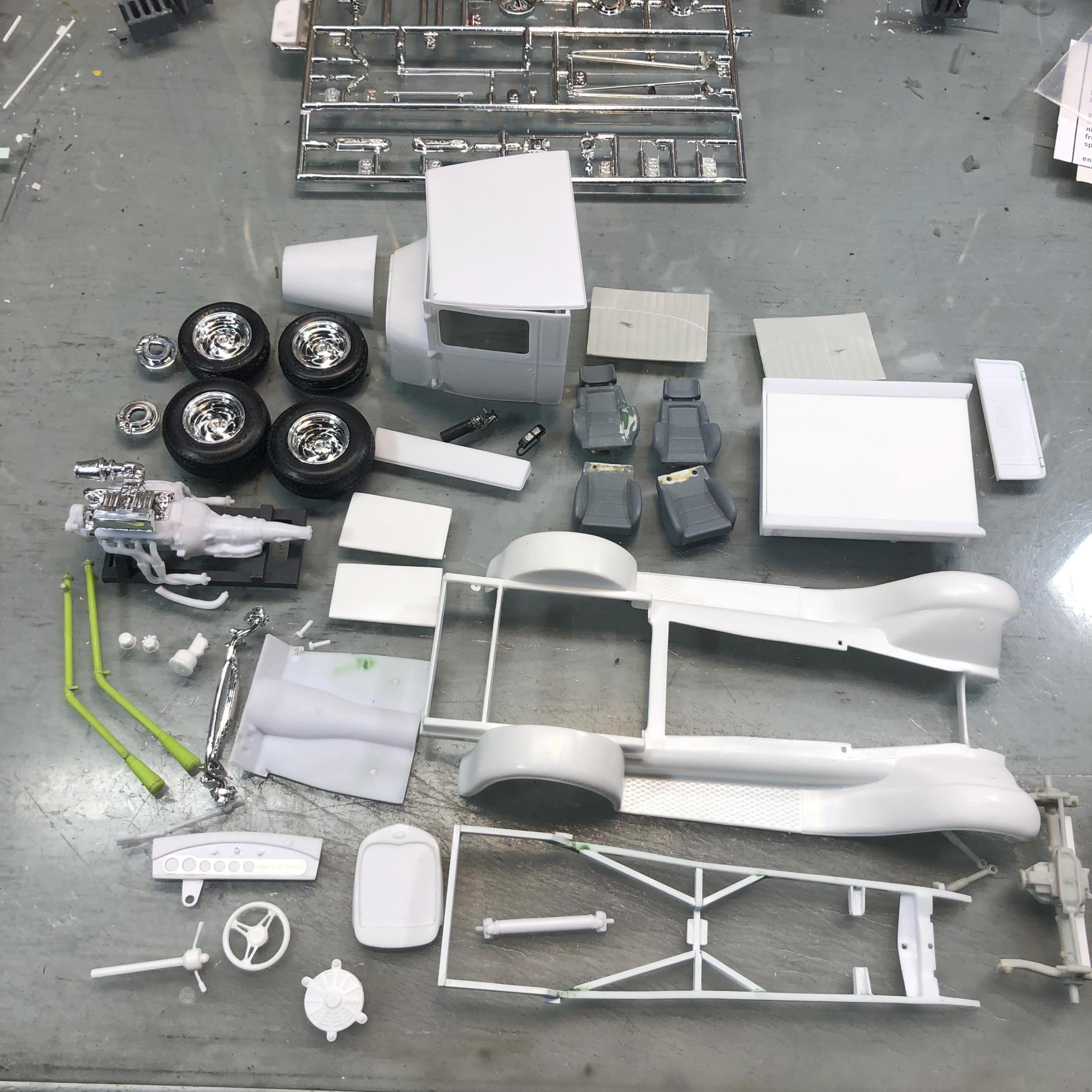

Work is progressing with my version of the "Tim Boyd Tribute" 1929 pickup....
asdfgh.thumb.jpg.dac58f9e565379db388aba97b76be6b7.jpguhh9yg.thumb.jpg.fafd0e5fafe3d94fa71723b973caa700.jpg

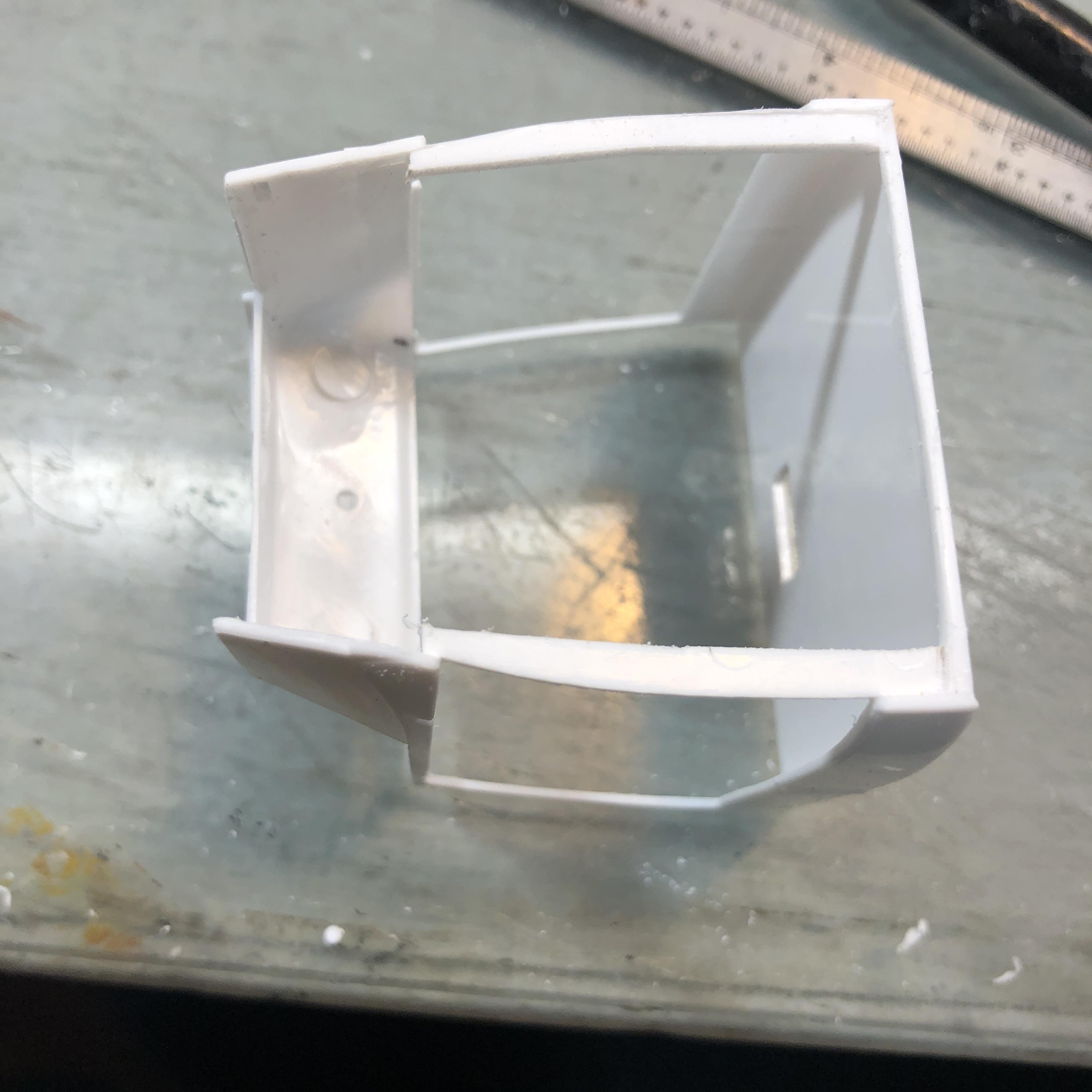

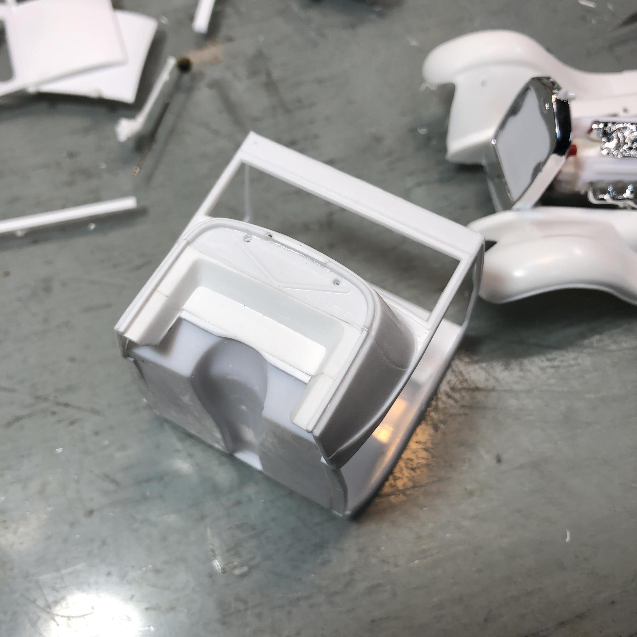

I cut out the floor of the pickup and replaced it with a floor from one of the Revell '32 series cars.

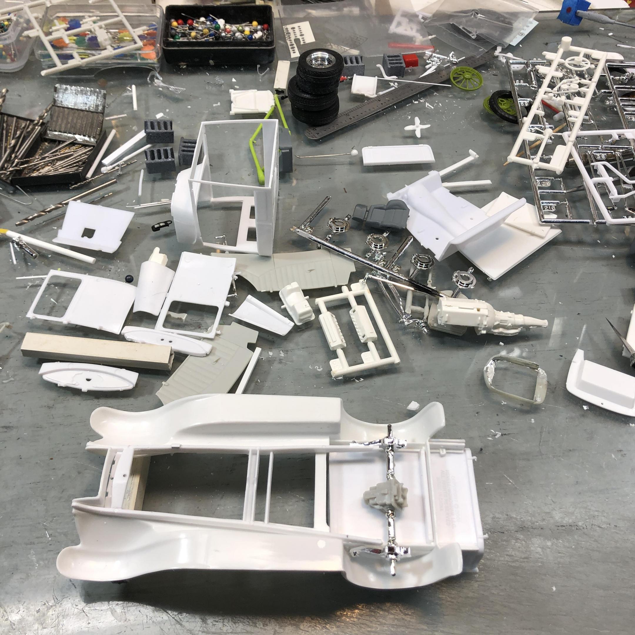

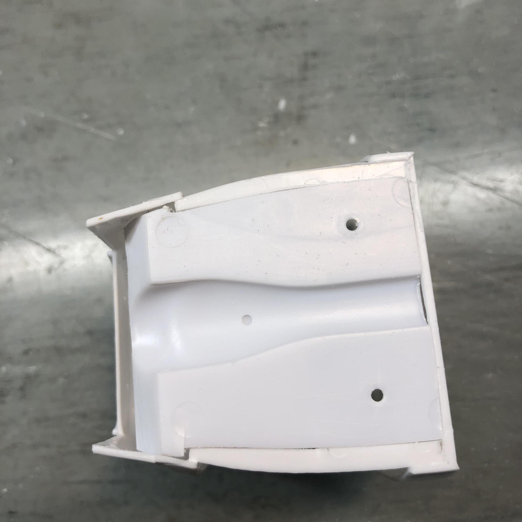

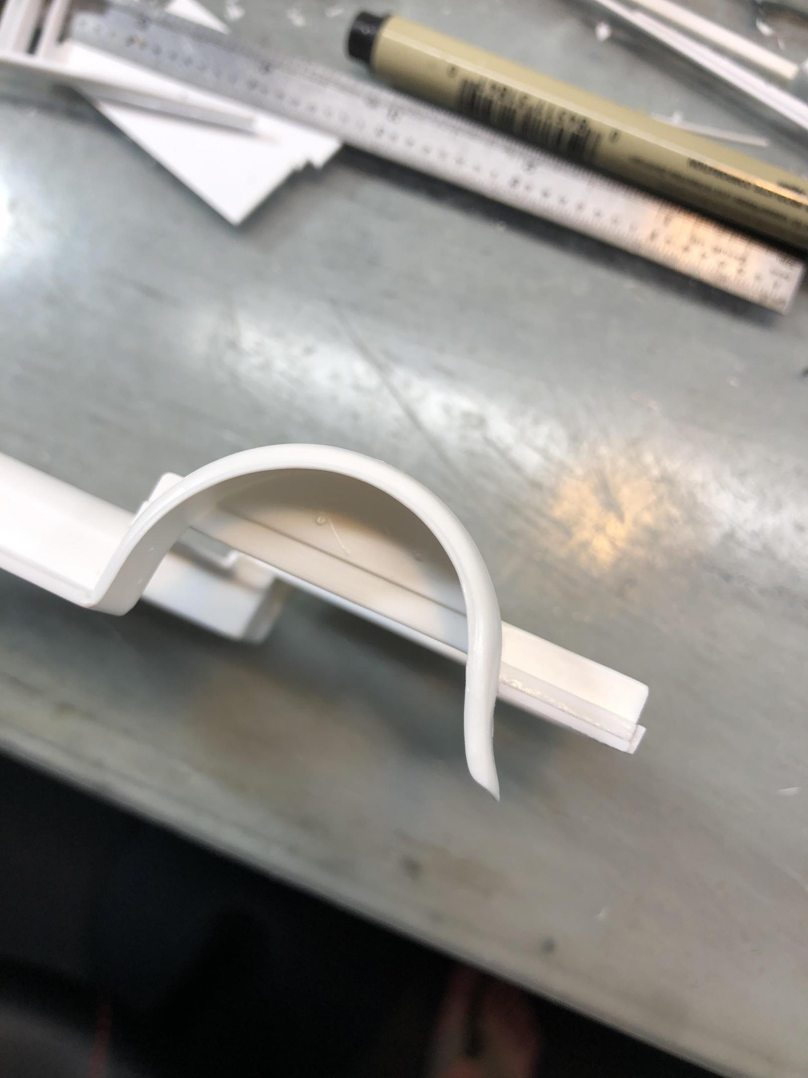

I closed up the area below the bed. This will make a nice place for some Billet tail lights I have.

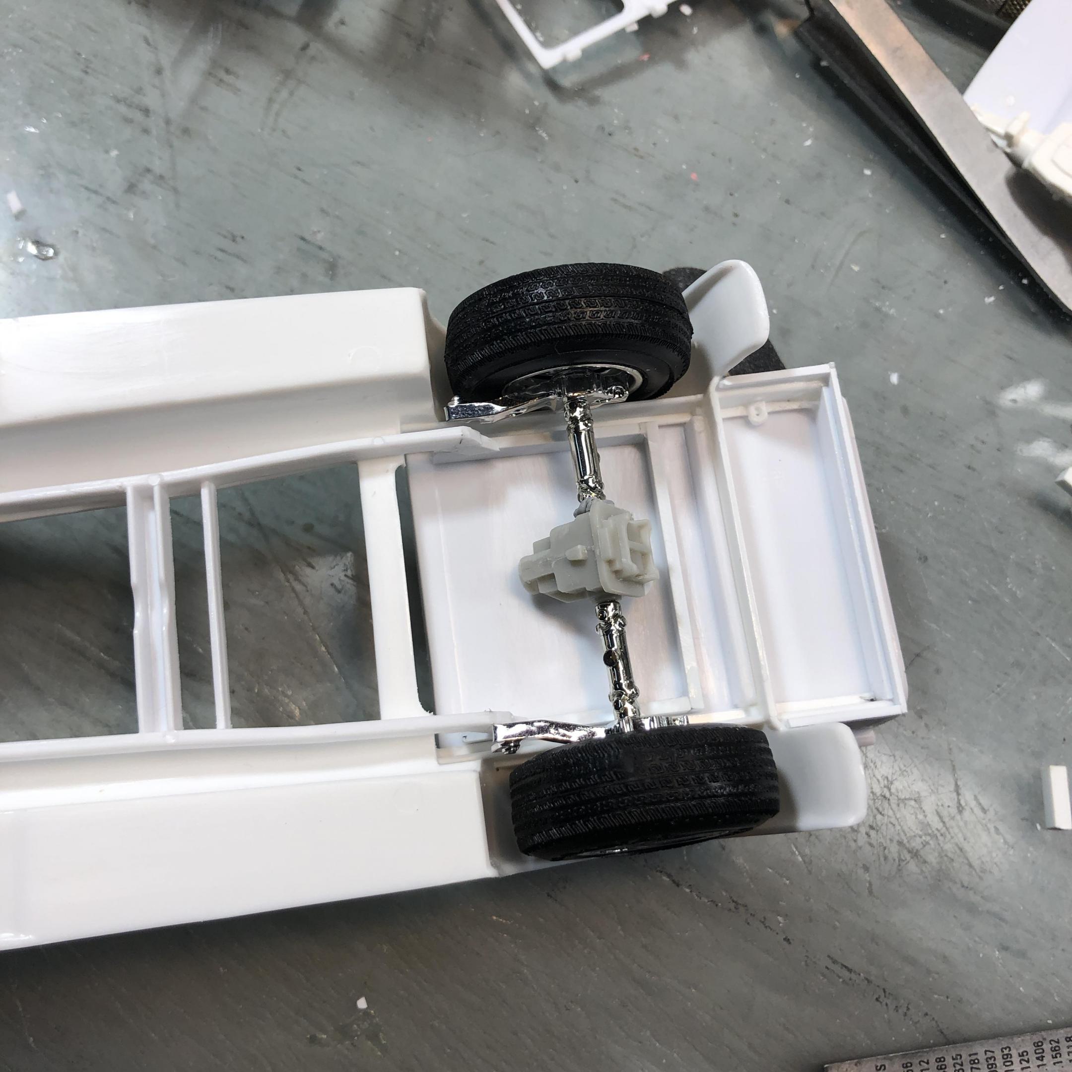

I'm using the Corvette IRS from the AMT '34 Ford, an essential design element of the build....

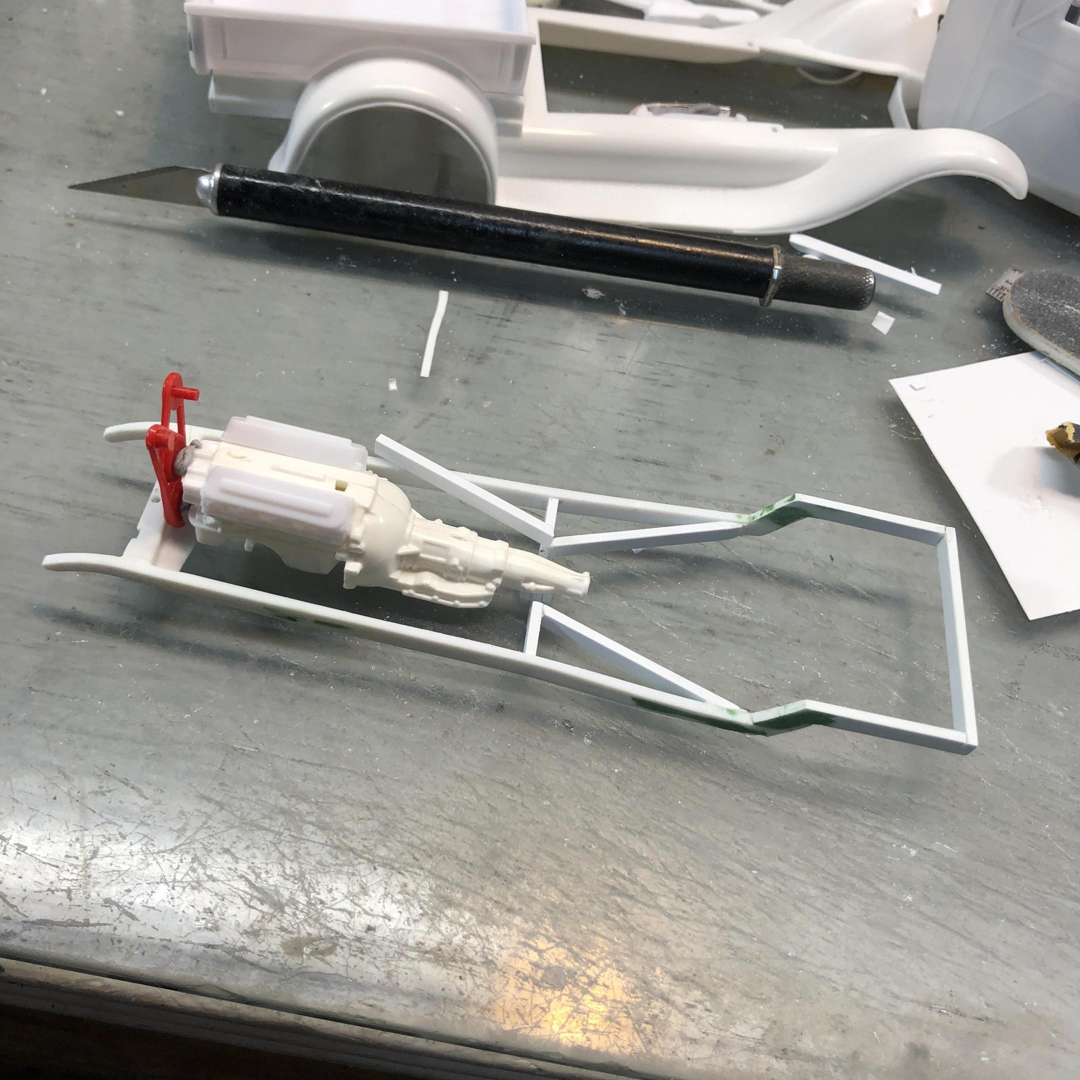

Putting a Z in the frame and figure out engine mounting. I'm using the SBF from the Revell '32 series, but the serpentine pulley and belt system won't fit. I'm still figuring out the solution. This  red pulley and belt is from the venerable ZZ Top Eliminator car.

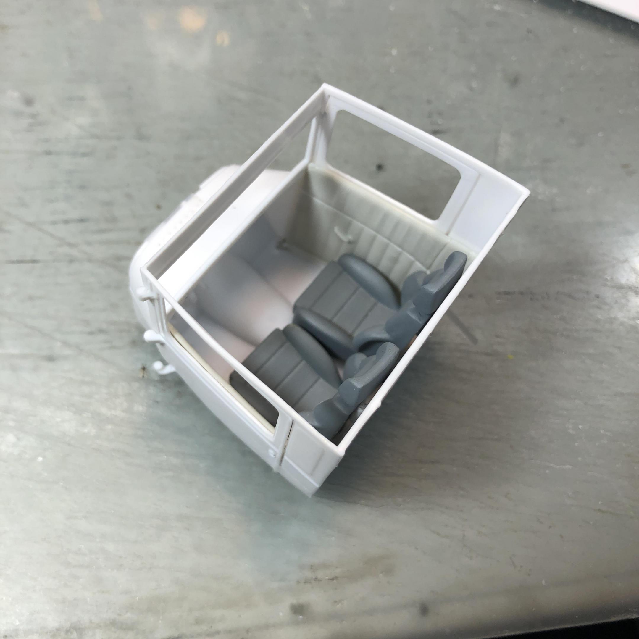

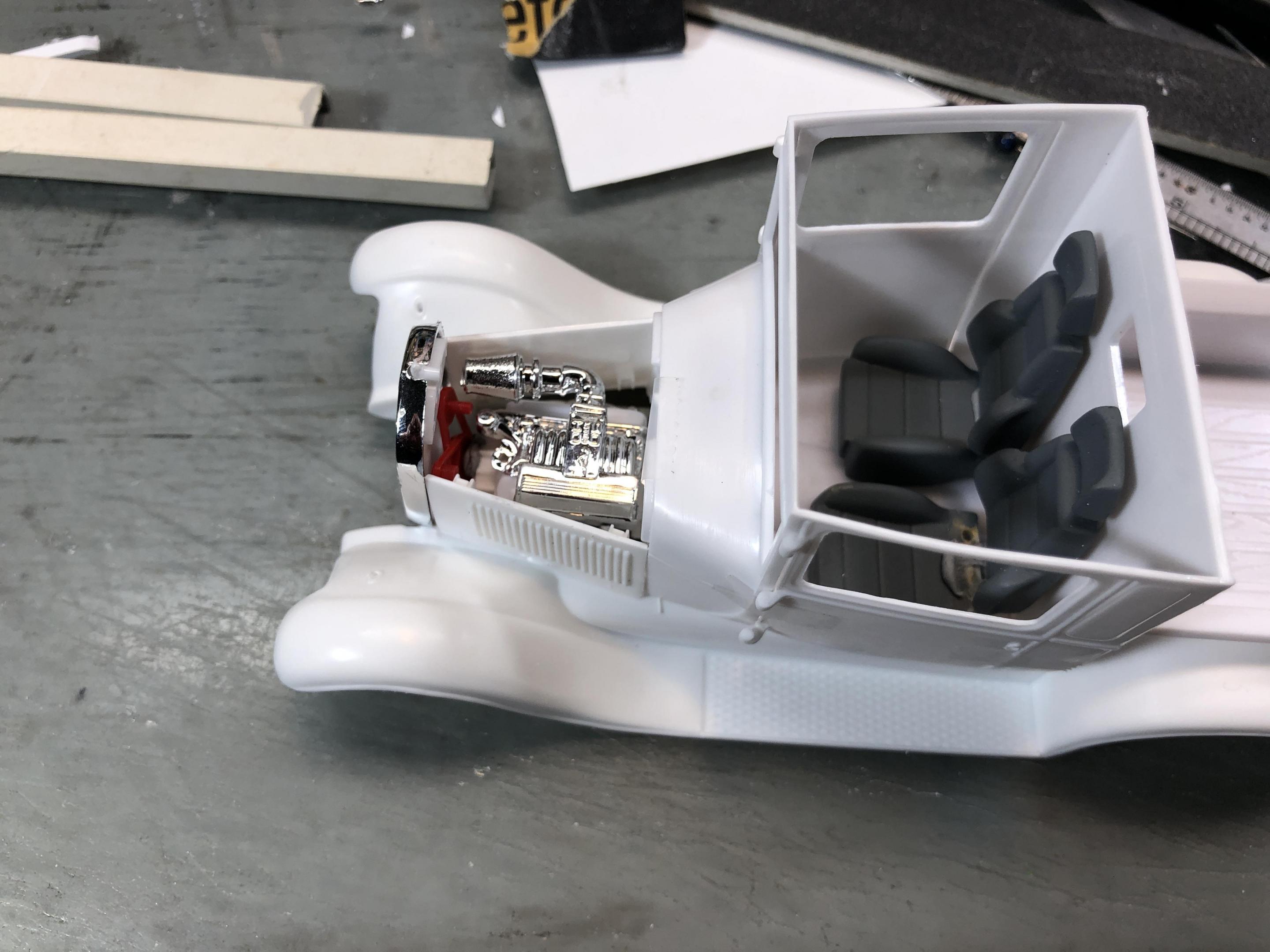

The SBF EFI system will fit between the hood sides...seats from the parts box.
242599404_ltthsset.thumb.jpg.865c447df019db56e9529bb0a19e6f8e.jpg8ybgtg.thumb.jpg.69f417b3217ff03663bfc12b081ed601.jpg
Door panels from the AMT Phantom Vickie [sic] and dash from the AMT '34 Ford....more later, thanks for looking. -RRR

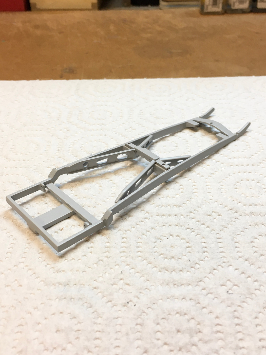

Here's a look at the frame all in one color. I need to wet sand and reprime to clean a few marks up then it will be ready for paint.

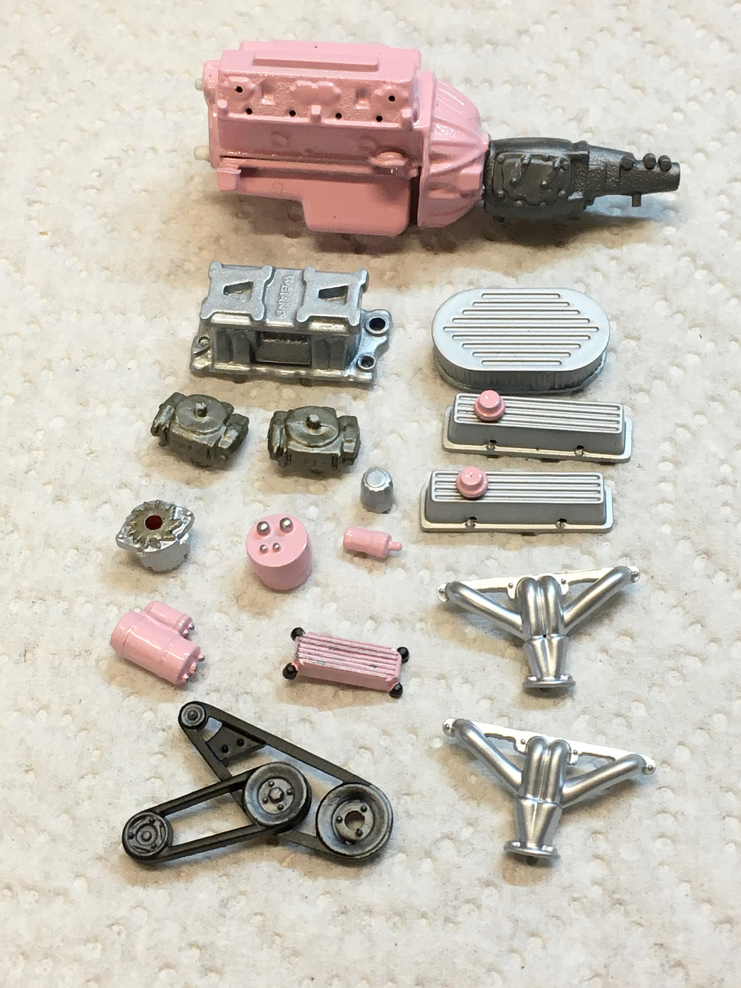

Lastly, I couldn't resist mocking up a few motor parts for a look.

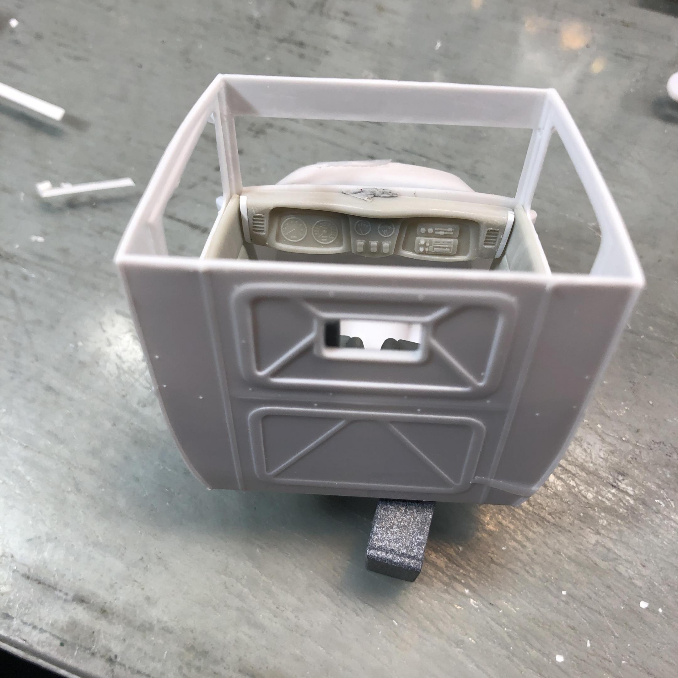

Looks like this one is pretty much ready for the paint booth. I decided make my own dashboard allowing me to use some of the photo-etched gauge panels that have been languishing in a drawer for years (decades?). I made a bed cover from another pickup kit, it has a light fabric crosshatch pattern (that will probably be obliterated by paint). I glued the doors shut (well, TIM did it on his original build), so was there some precedence there. Ford power from the Revell '32 series. I'm using the EFI setup found in the Speedwagon and 5ive window coupes (they're actually slightly different from each other). I found aftermarket chromed front cover and lower intake manifold, so I'll throw them on. I have a chromed serpentine belt/pulley assembly, but it won't fit under the Model A skinny hood....Some light finish sanding and a wash and primer. See ya in the funny papers... -RRR

On 1/30/2021 at 4:01 PM, Rocking Rodney Rat said:
Looks like this one is pretty much ready for the paint booth. ...See ya in the funny papers... -RRR

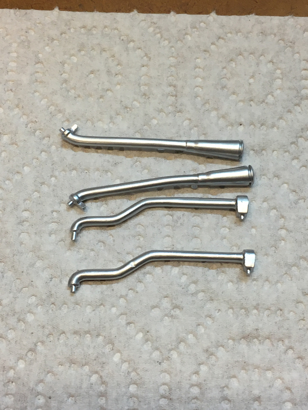

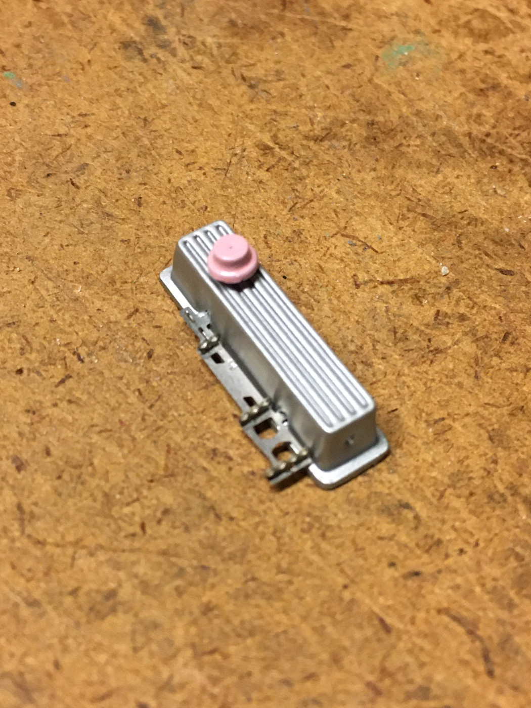

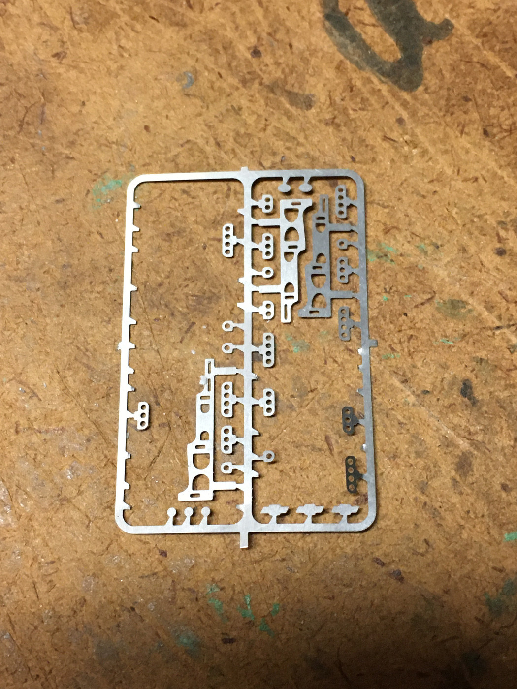

Got the motor completely assembled. Couldn't be happier with the way it turned out both in color scheme and parts selection. Extra detail courtesy of a Parts By Parks pre-wired distributor, a combo of Model Car Garage and Detail Master wire looms, Detail Master #1 fuel line and line nuts with a scratch built T from .040" square rod. If this doesn't scream 80's Billet I don't know what does!
I did run into a snag with the wire looms and thankfully something compelled me to test fit a wire before starting any motor assembly. As it turns out the wire holes in the Detail Master looms (Pic 1) are too small for the wires on the Parts By Parks distributor! Total bummer!! What to do? Well, looking at one of my sheets of Model Car Garage wire looms I found that there are some with stand-offs (Pic 2 circled in red) and the stand-offs could be cut down into a short tab and fit perfectly into the alignment slots on the Detail Master loom plates. So I was able to prepare a new pair of looms combining pieces from both brands (Pic 3). That was a lucky save!

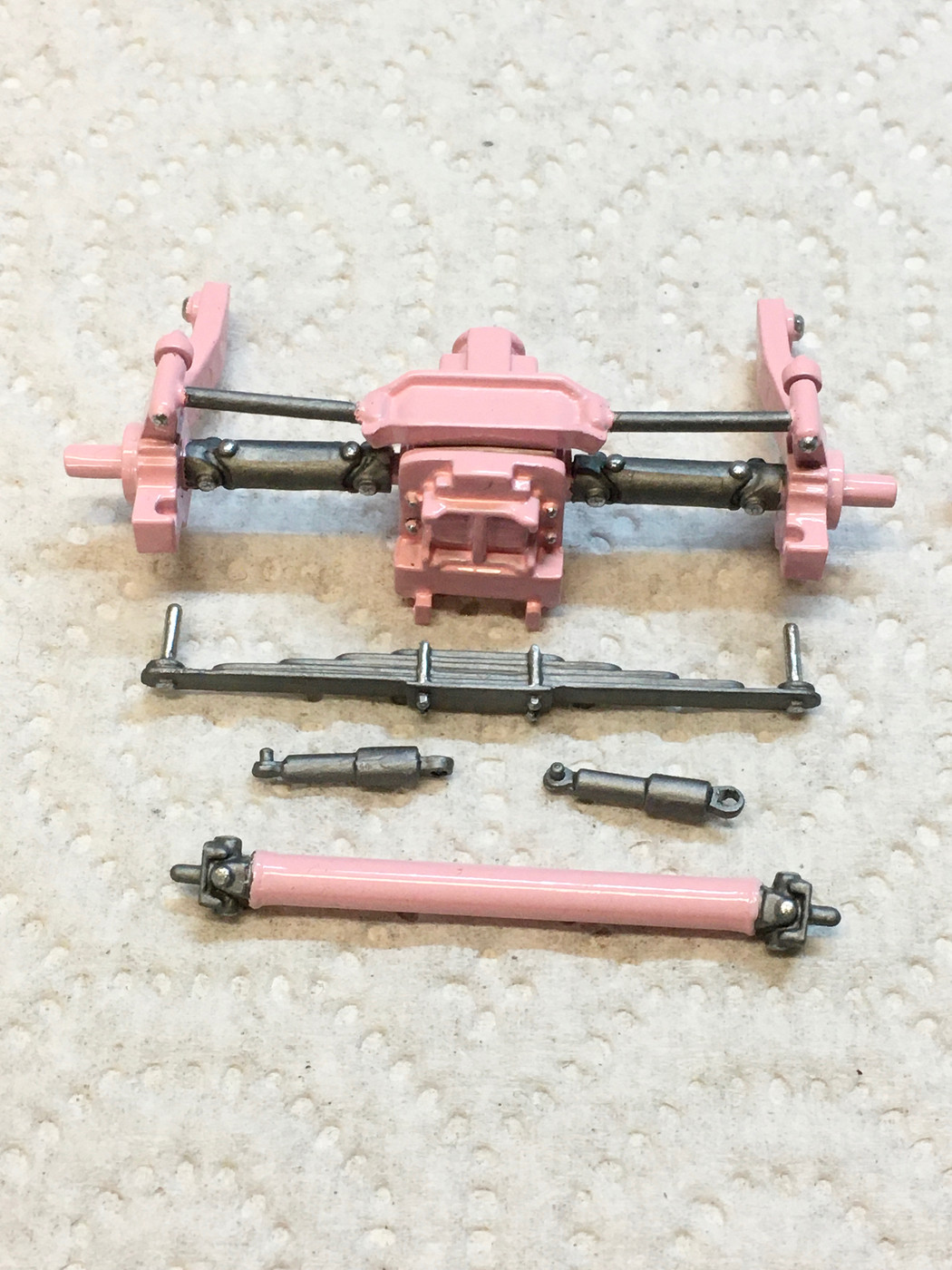

Here's some finish pieces such as the fully assembled Corvette IRS with added disc brakes, front axle with brakes installed, exhausts with hangers, clamps and tips all paint detailed.
And I just could not resist doing a mock up with the finished engine and wheels. I just love the way the paint detailed Corvette IRS looks peeking out the back.
