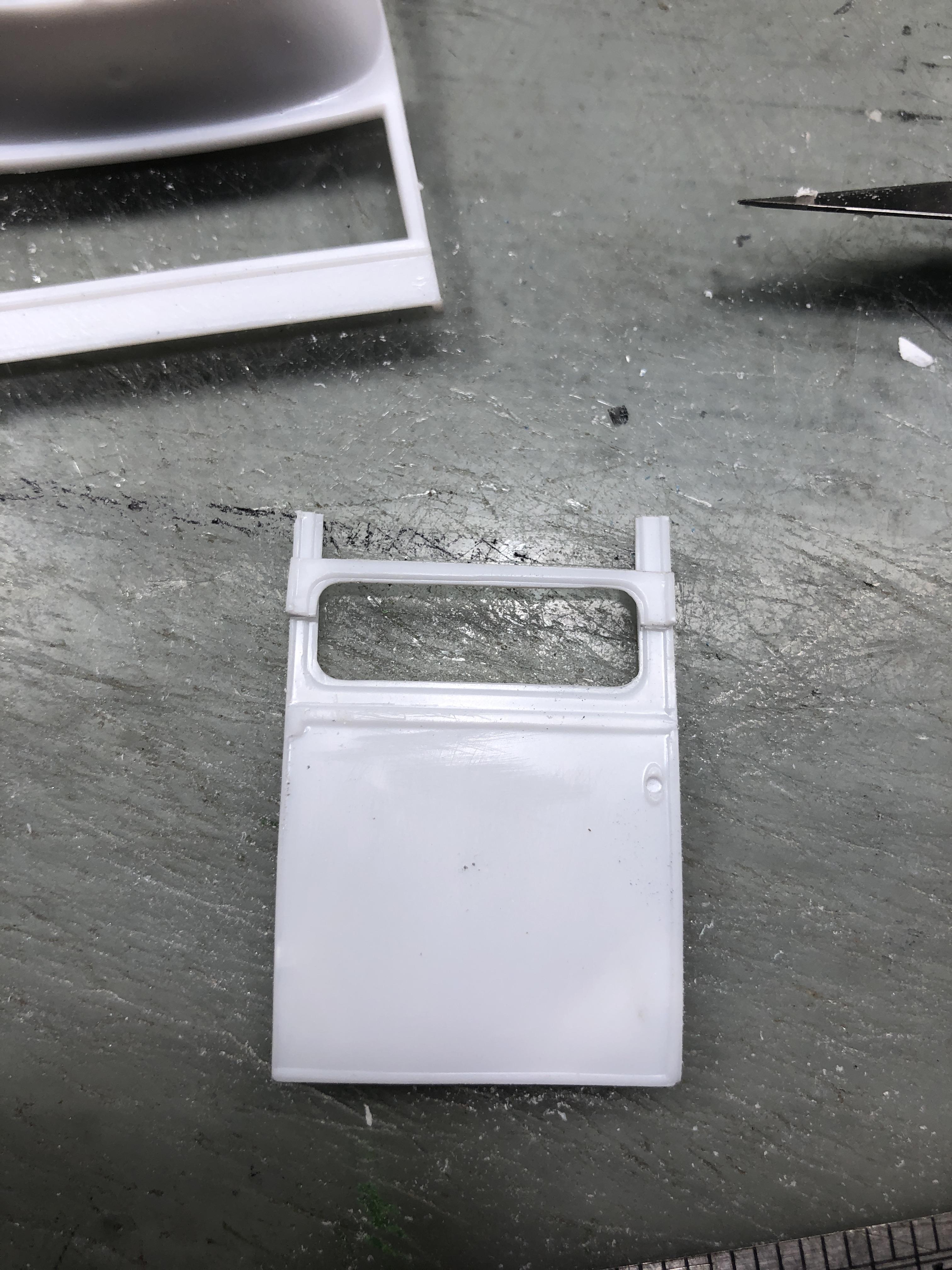

alan barton Posted October 3, 2020 Posted October 3, 2020 Yeah, sports coupes are cool and I look forward to what you do with this one. In Australia, we also had 32 and 33 Ford Sports Coupes. By 34 they had the technology to form up the rear coupe roof section to produce a steel 5 window coupe. There are several hot rodded versions of each on our local scene. In the seventies when everything American was cool, many Aussie 32 coupes were converted into look-alike 5w coupes ( which we never got) by chopping up and welding on the rear quarters of a 4 door sedan. A couple of things to note although Dennis has hinted you might be passed the point of changing anything anyway. The doors in your photo appear to be off a Revell 29 Closed Cab pickup, like your cowl. The clue is the raised ridge around the edges - Model A closed cabs actually used a Model T Tudor or coupe based door (and ironically Henry didn't make a 27 T closed cab pickup to use the T door on anyway!) You could either go searching for the 31 Tudor doors you thought you had or file off the raised edge around those T doors . And for what it is worth, Tudor and coupe doors are the same length on most Ford products - four door sedans have the shorter doors. If you have a left over rear section of that 31 Tudor, it might pay to look at reworking that to produce a lift off plastic roof. You could add additional styrene or putty to the outside and you would have little evidence of hacking on the inside that needed lots of annoying and fiddly cleanup. Finally (sorry if I am dragging this out a bit) if you want the model to "read" like an early 28 or 29 sports coupe and you use the 31 doors, it would pay to use evergreen or putty to flatten out the swage lines across the doors. Early As had a flat swage, later ones had the ribbed swage. This will be only the second model of a sports coupe I have ever seen. A good friend produced a replica of a local, well known heavily chopped 30 model - it was a great looking model and I really look forward to seeing what yours comes out like. If it is anything like your green T it will be a stunner! Cheers Alan

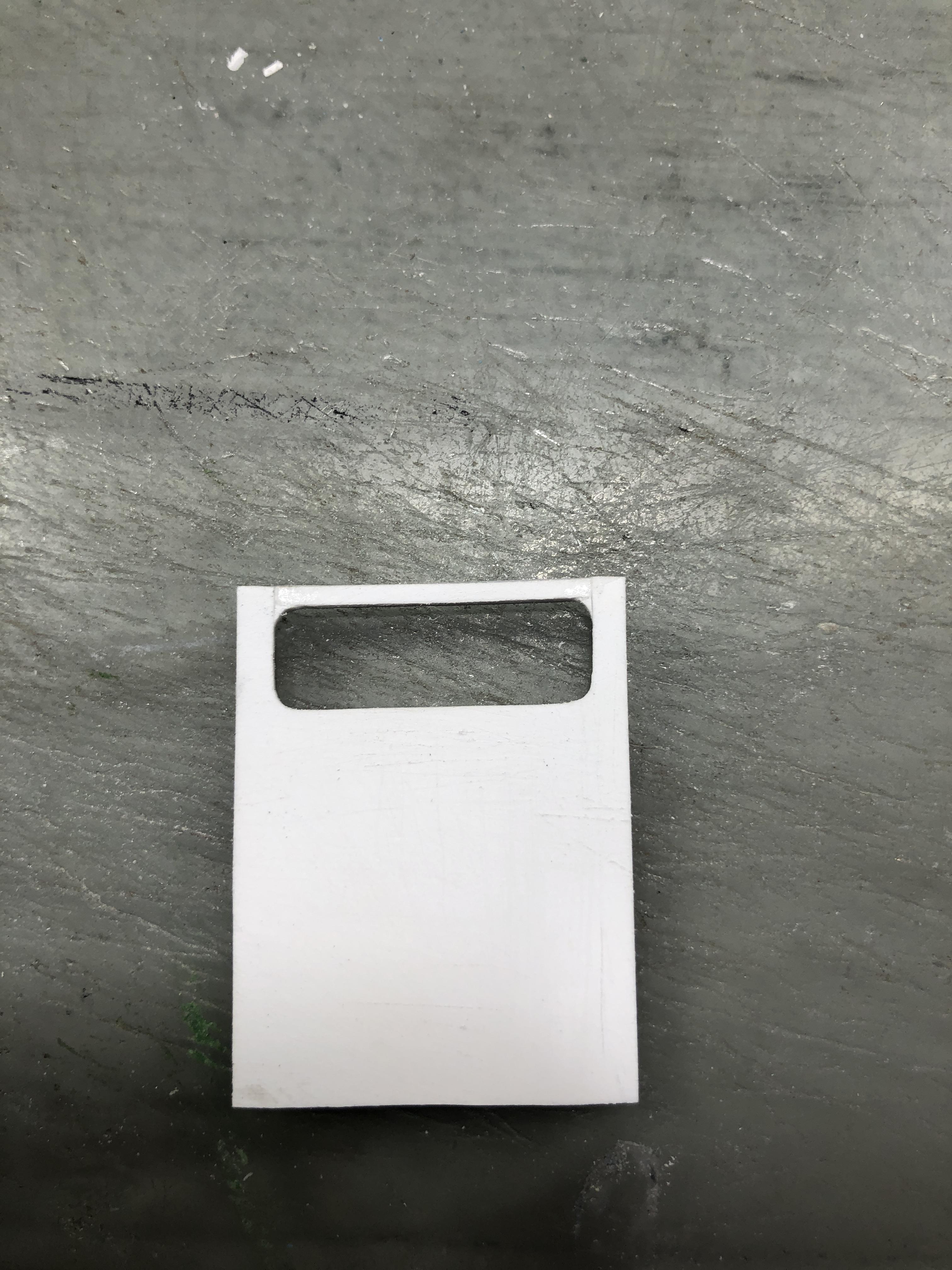

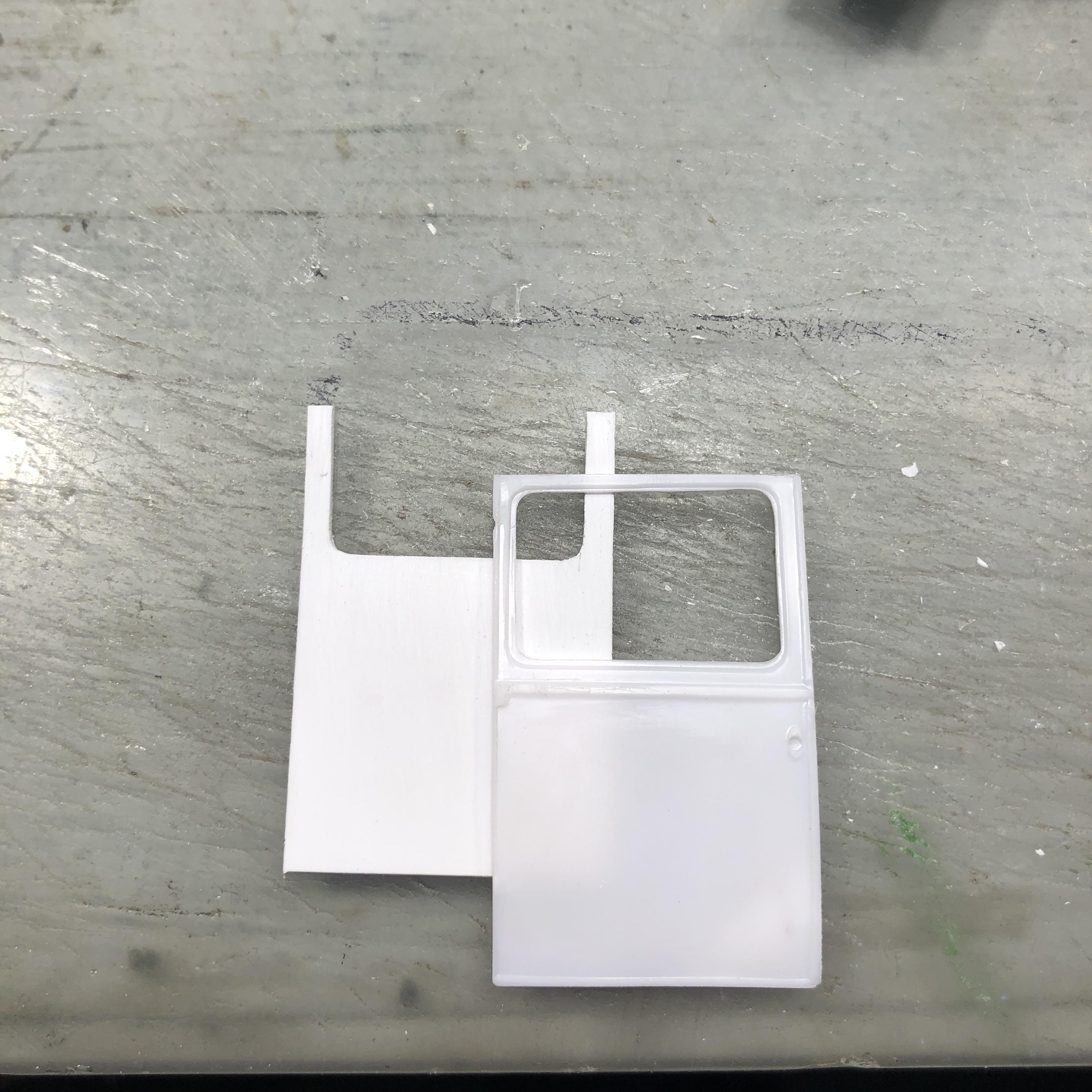

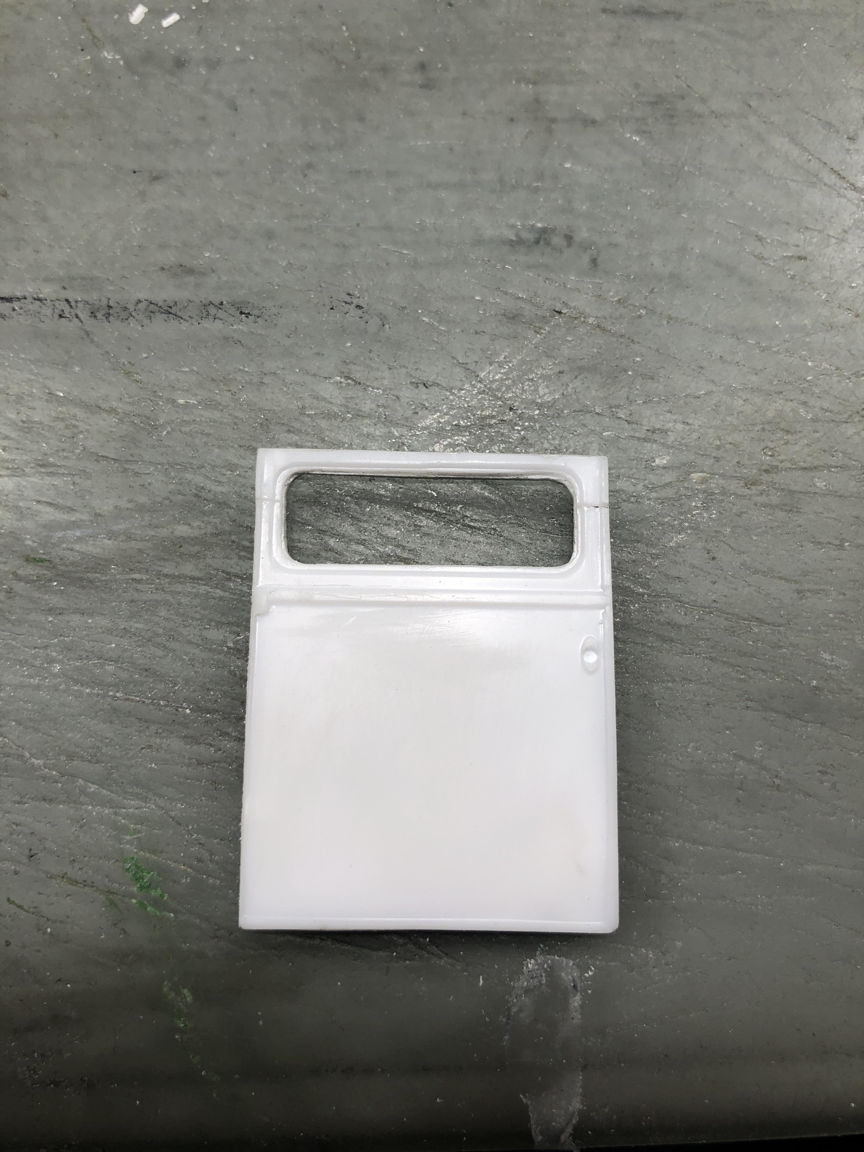

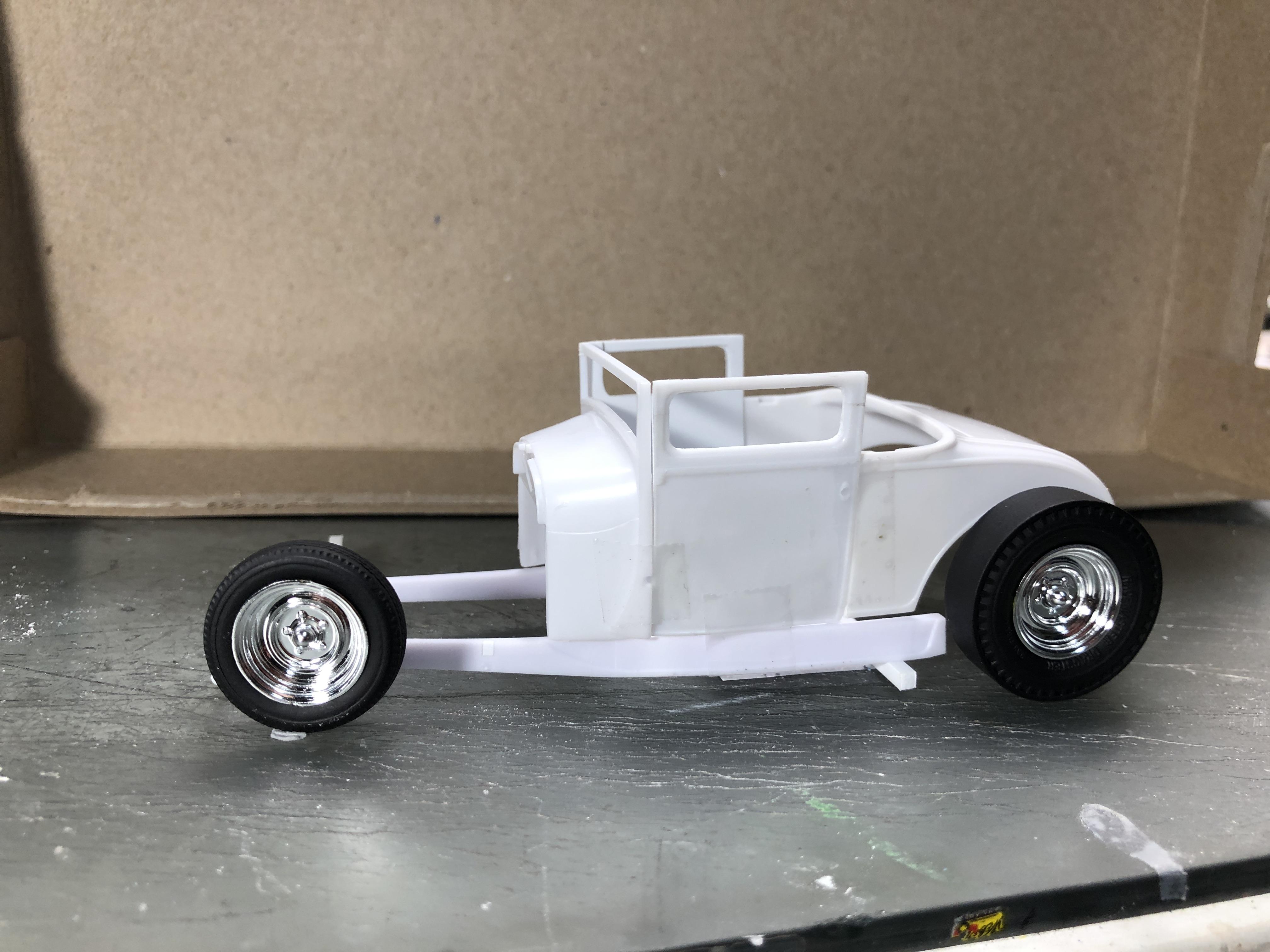

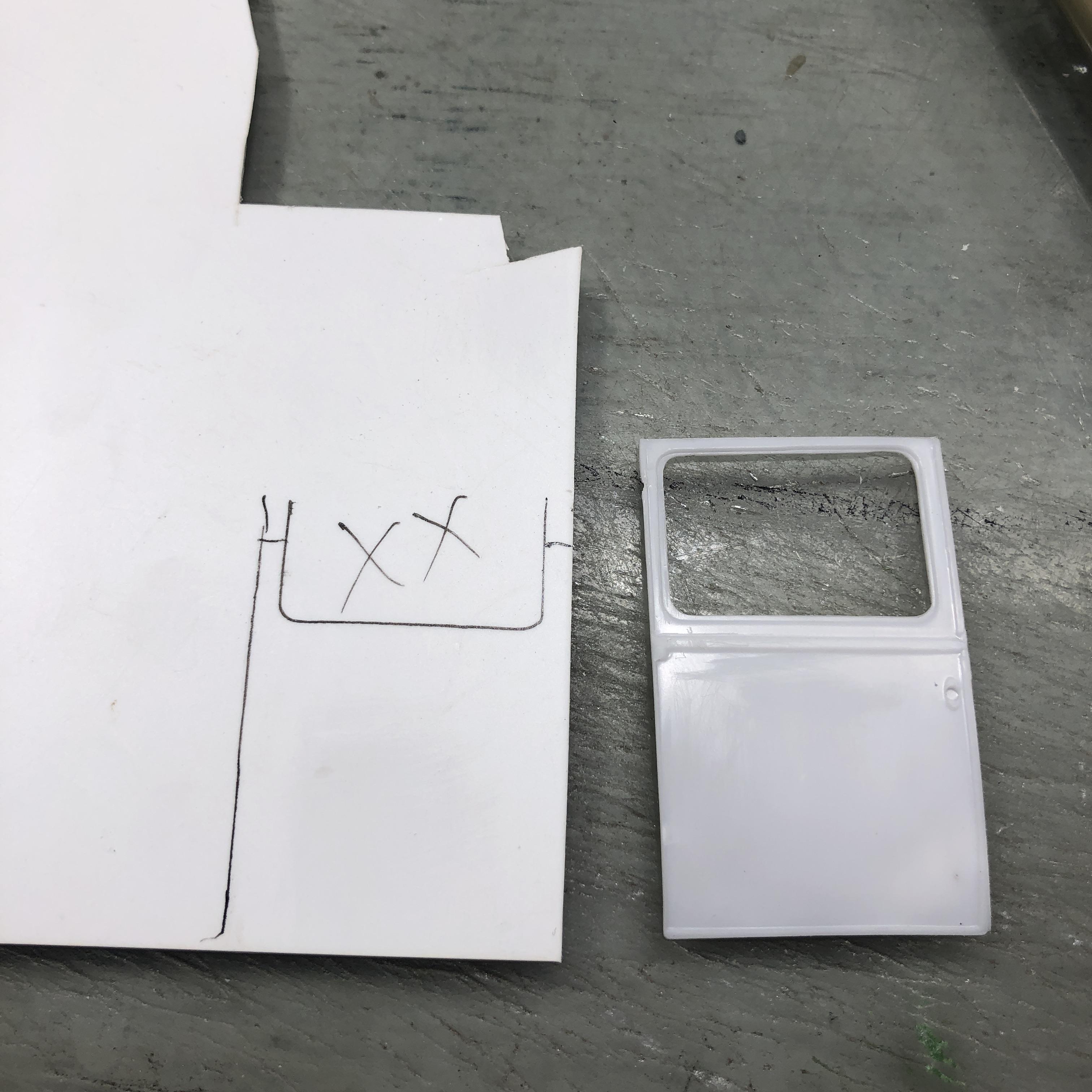

Rocking Rodney Rat Posted October 4, 2020 Author Posted October 4, 2020 (edited) The first order of business is a chop. All hot rods should have a chop. The doors are very thin, so I decided to back them up with a piece of thin Evergreen sheet sytrene. I traced the image, cut it out leaving extra area for the windows. Glued on, chopped down, the extra plastic makes the chop easier and makes the parts stronger... Next up, assemble the body.... -RRR Edited October 4, 2020 by Rocking Rodney Rat

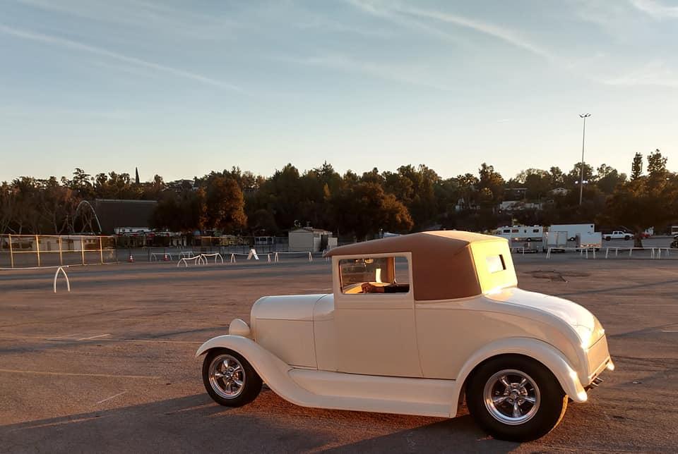

Kit Karson Posted October 5, 2020 Posted October 5, 2020 RRR, You and I both know how this is going to turn out! I watched you in action for quite some time now!! Komments so far are spot on in some kases and kurious in others!?. Keep us kuming back, Brother... with your marvelous kommentary!!! KK PS Remember this 1929 Ford Full Fendered Sports Koupe from the GNRS 2019 Move in Day

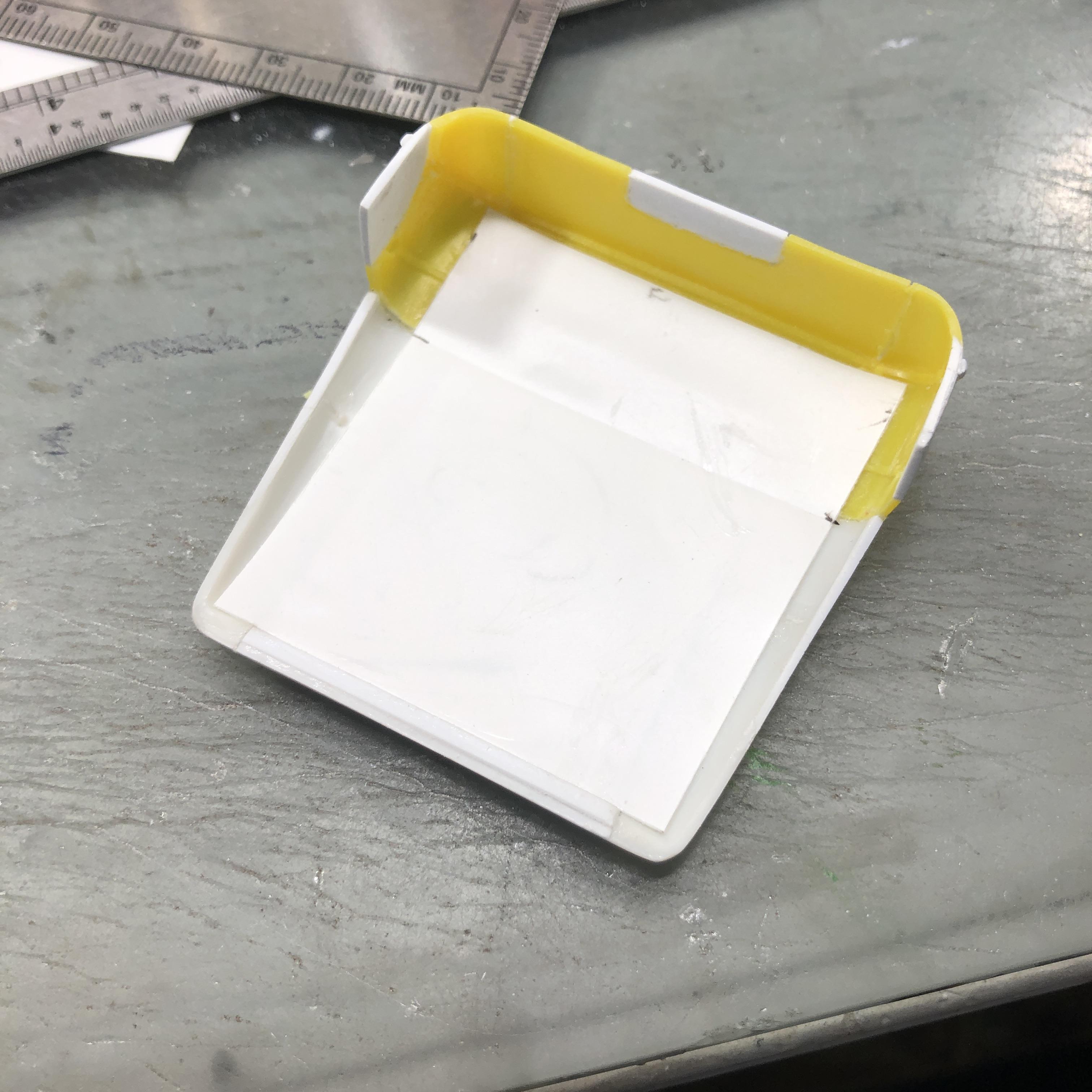

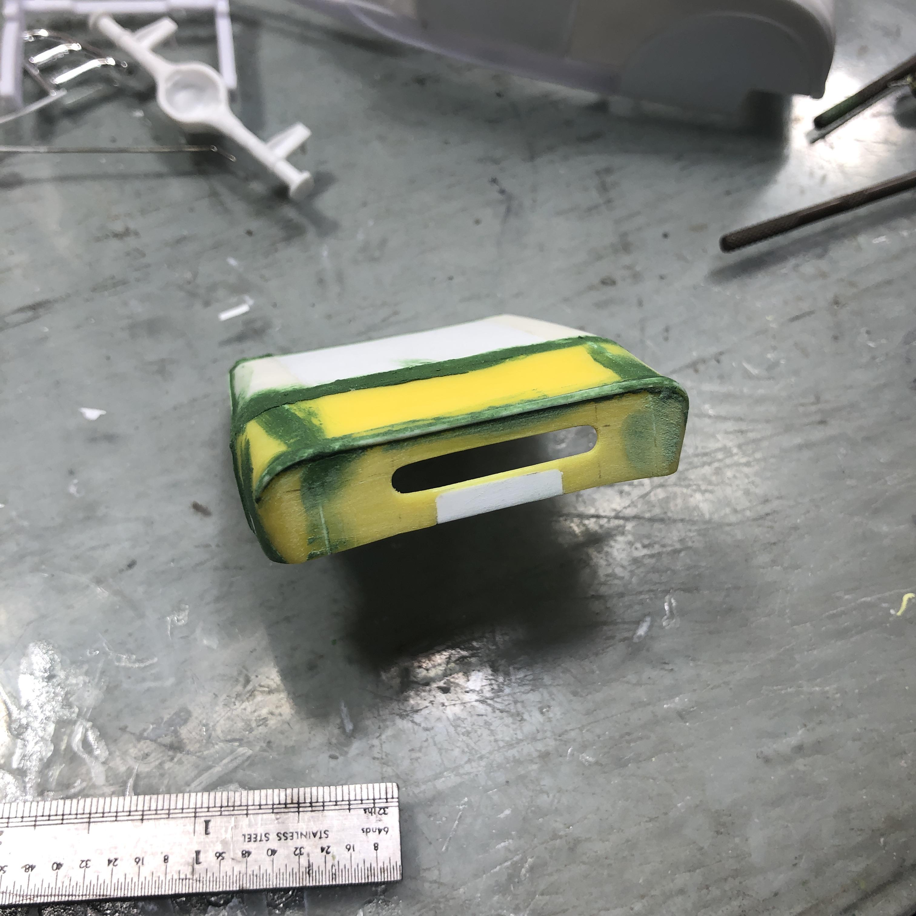

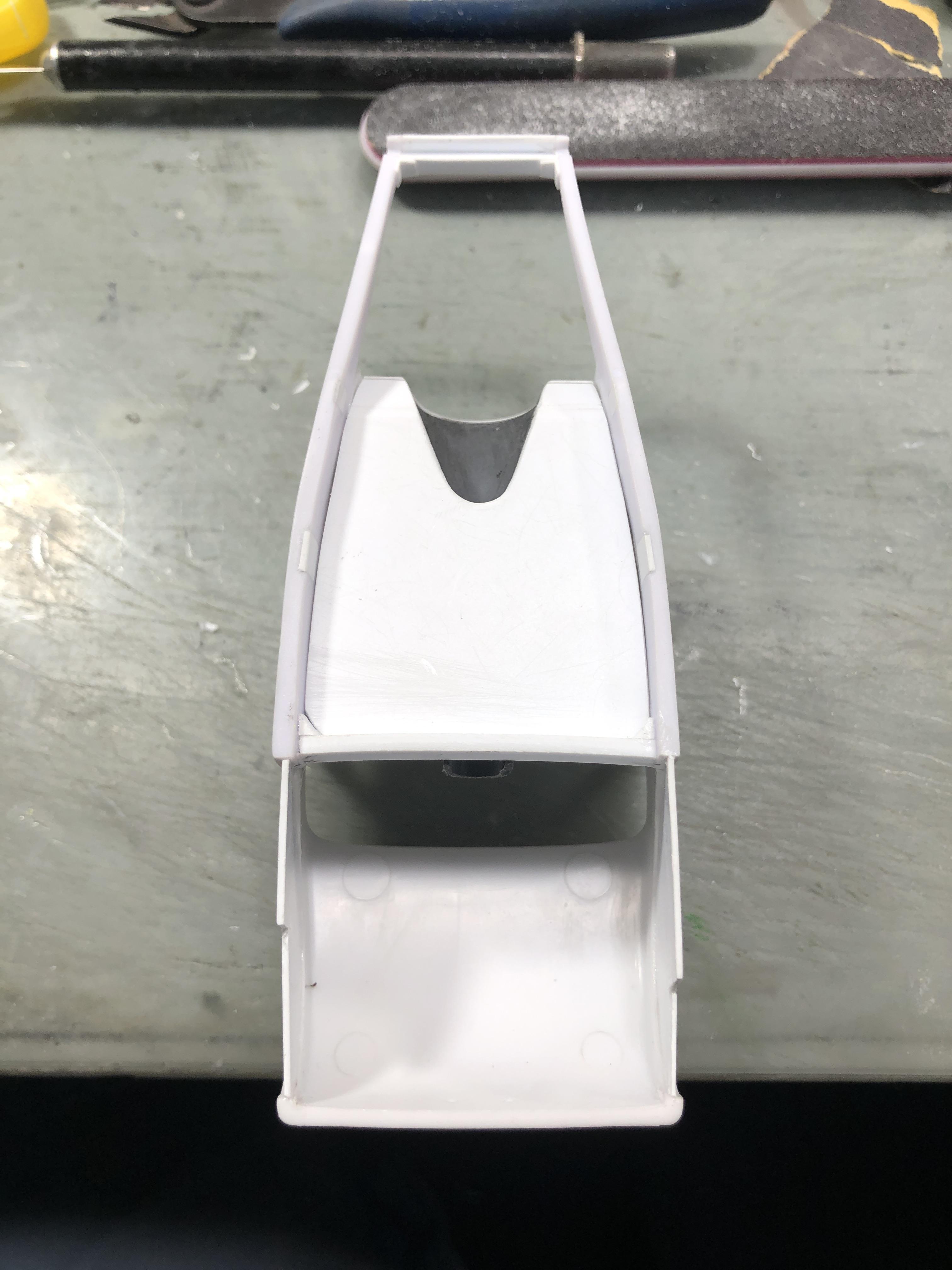

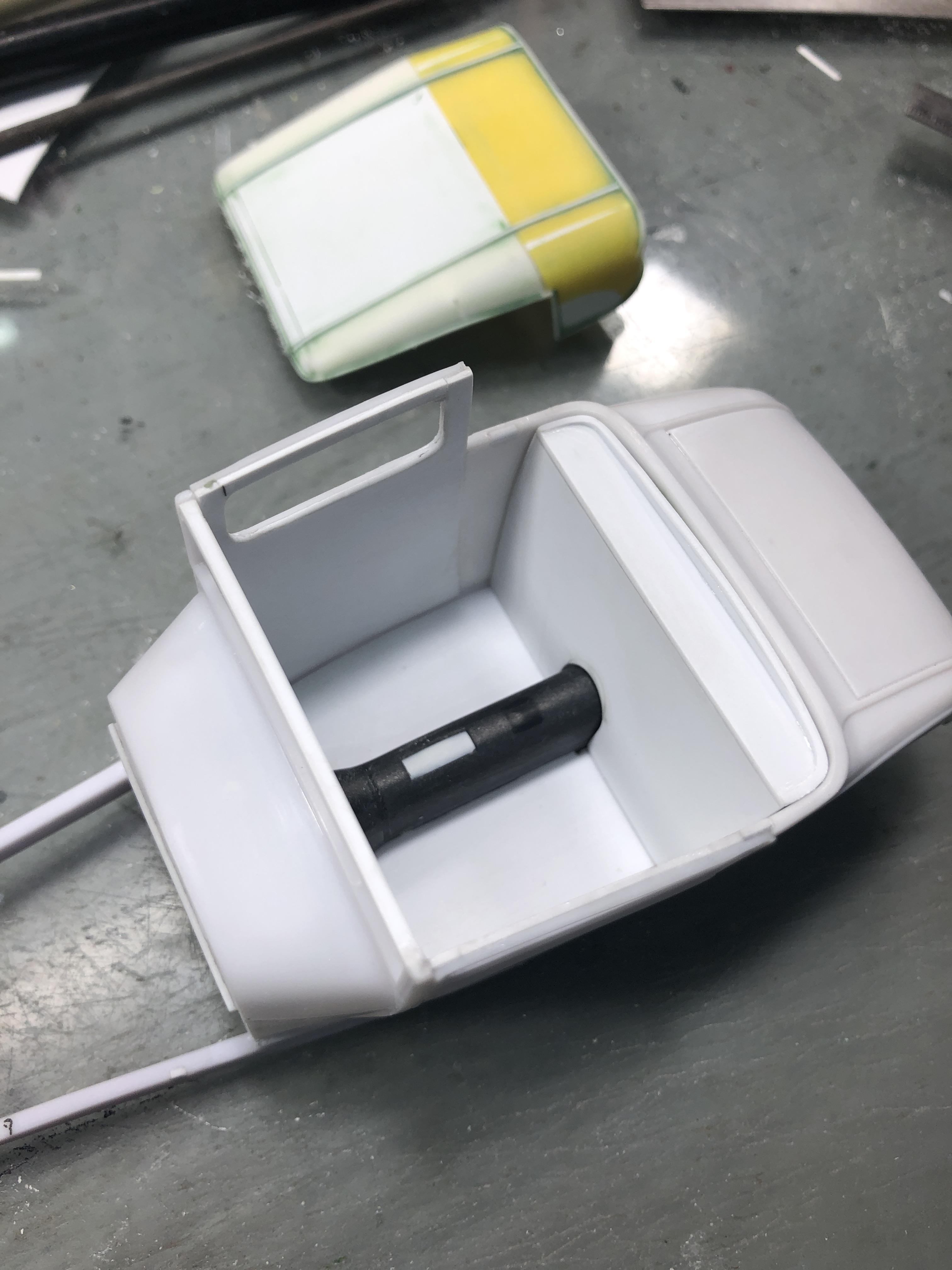

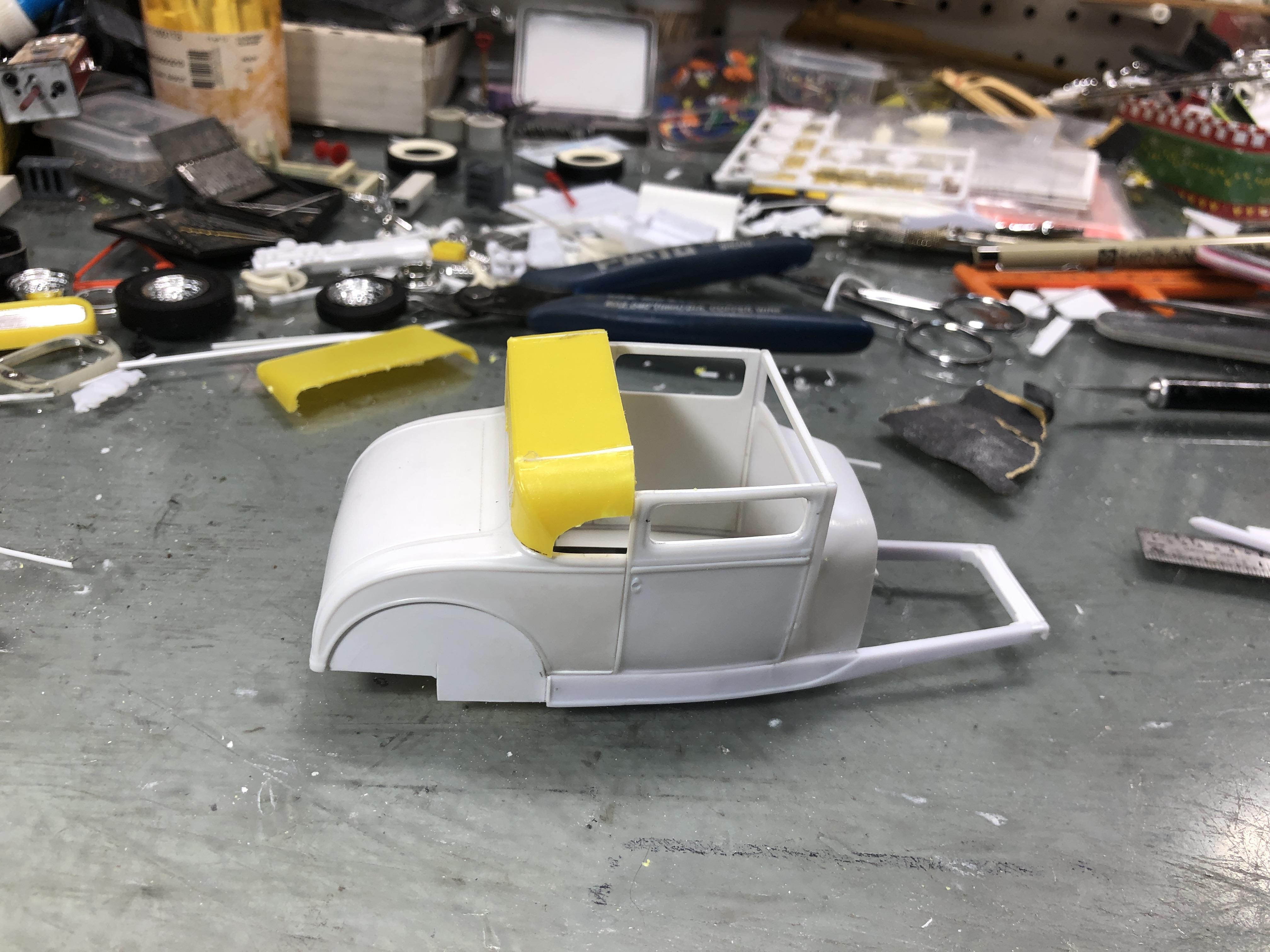

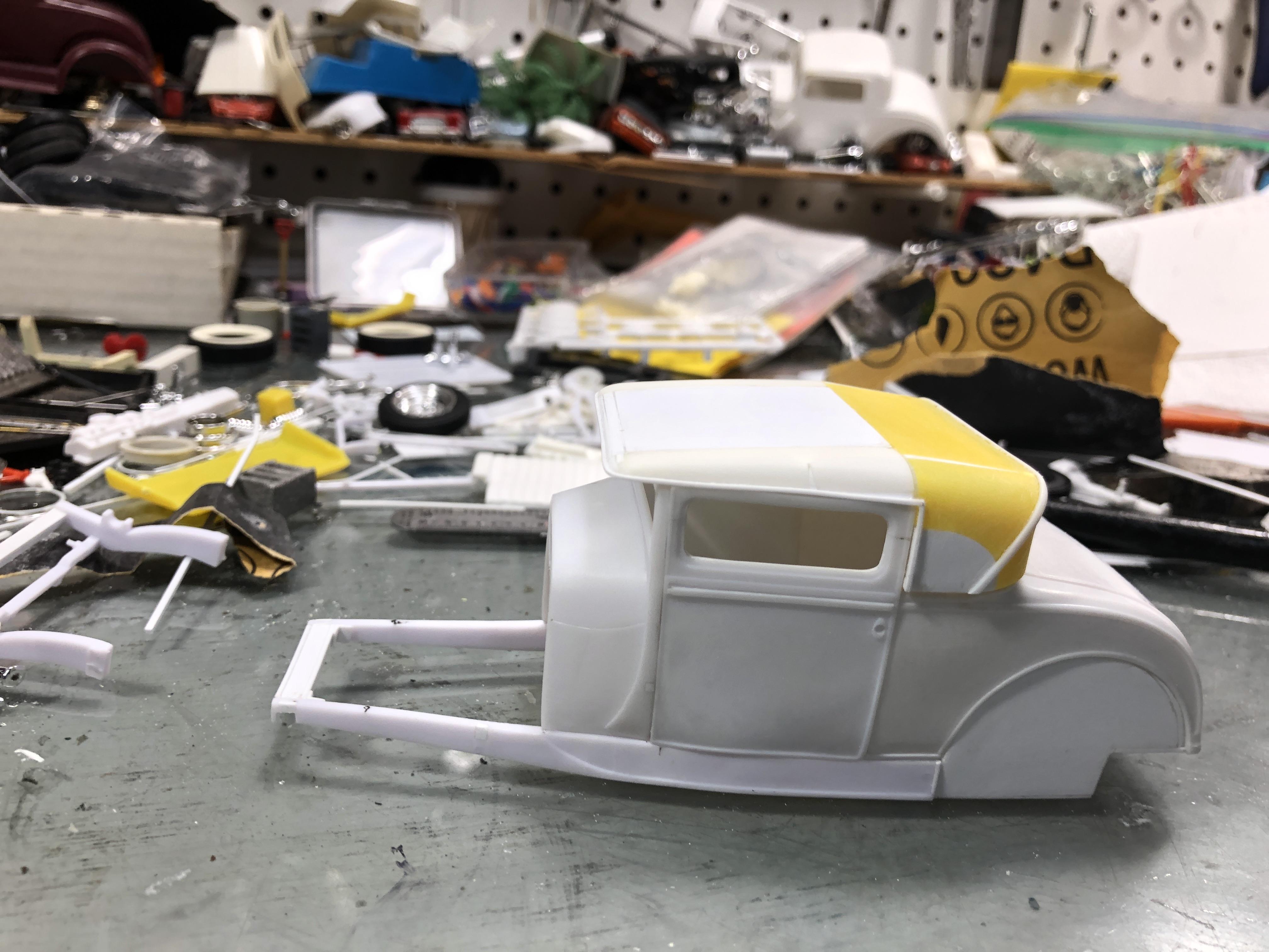

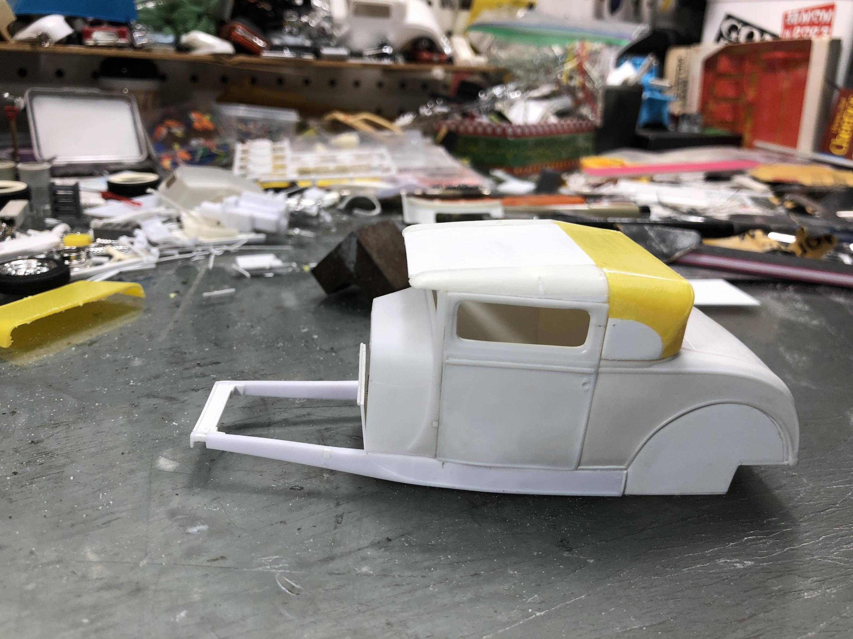

Rocking Rodney Rat Posted October 8, 2020 Author Posted October 8, 2020 I guess I can't go and edit the date on the original post anymore? So anyway, here I'm at the "build the top" part of the build. I started with the top from the recent reissue AMT Mod Rod (in yellow). The side quarter round area is from the AMT '36 Ford rag top. Other pieces of styrene, hacking, slicing, fitting and some putty....

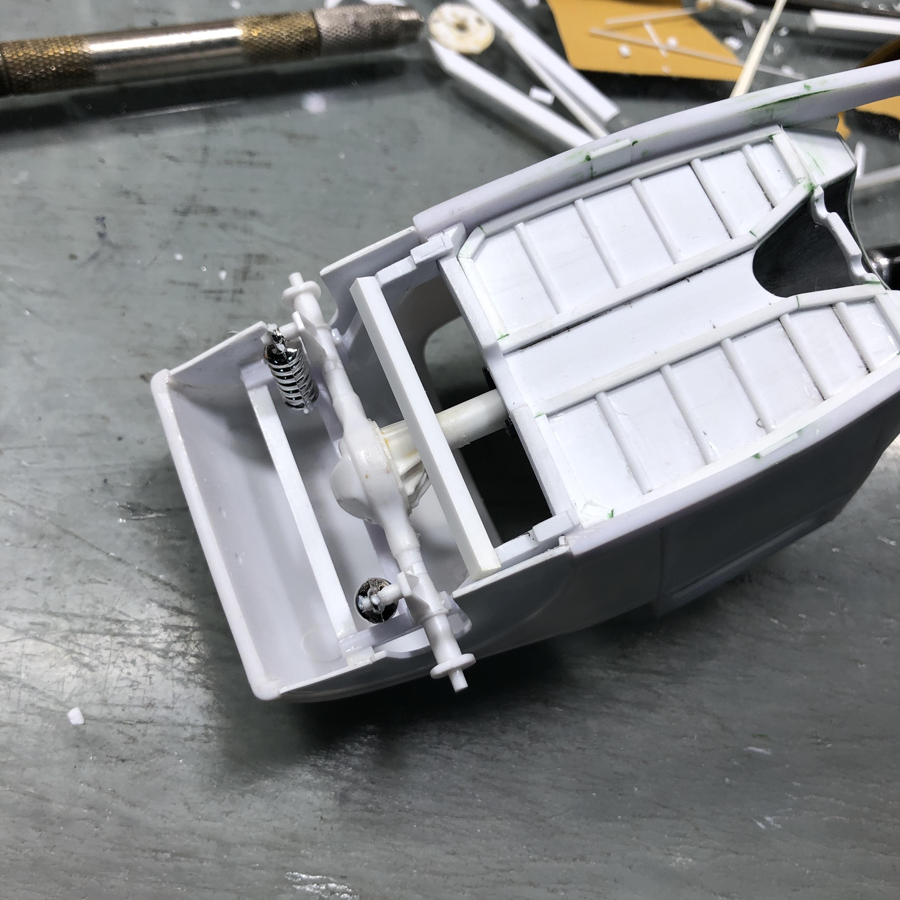

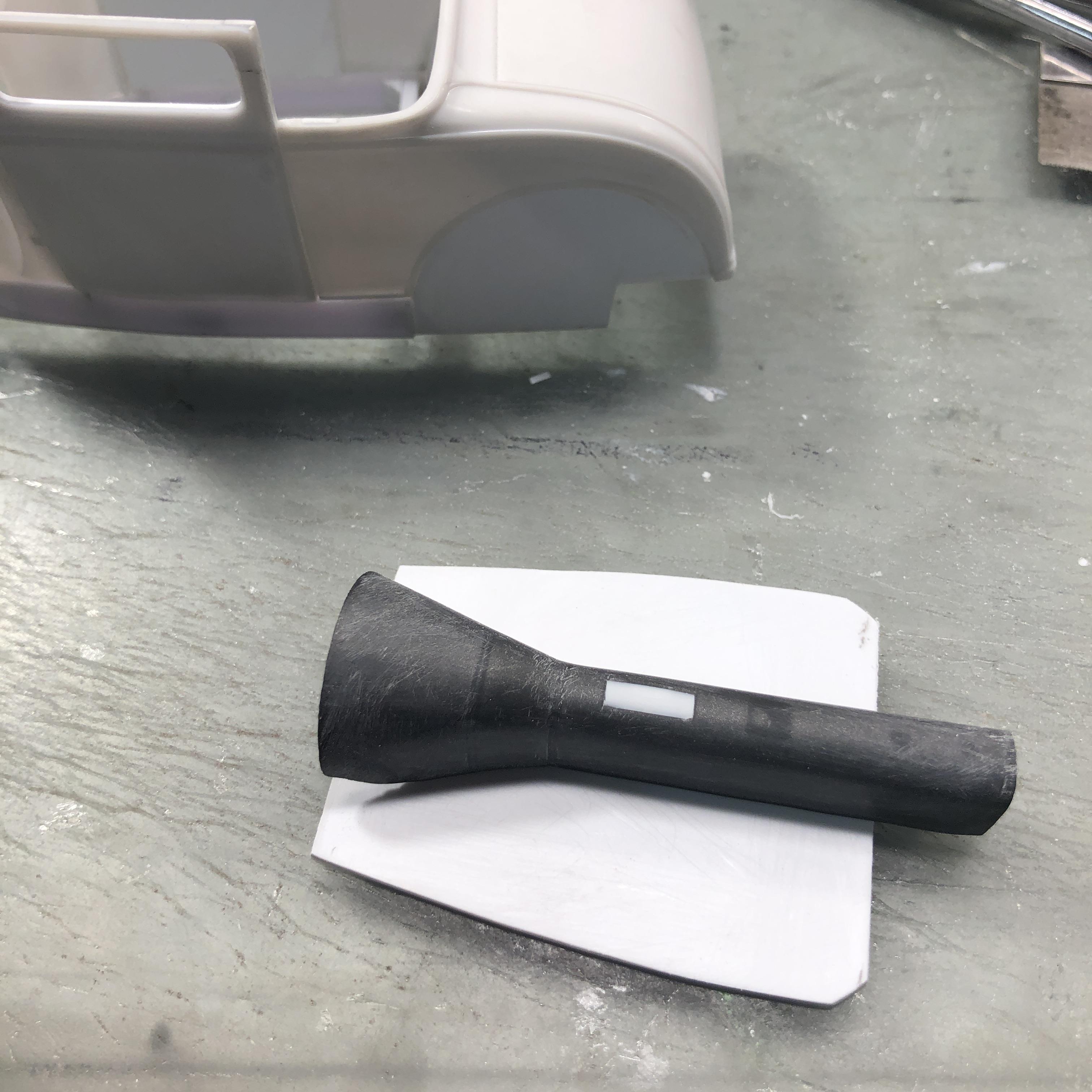

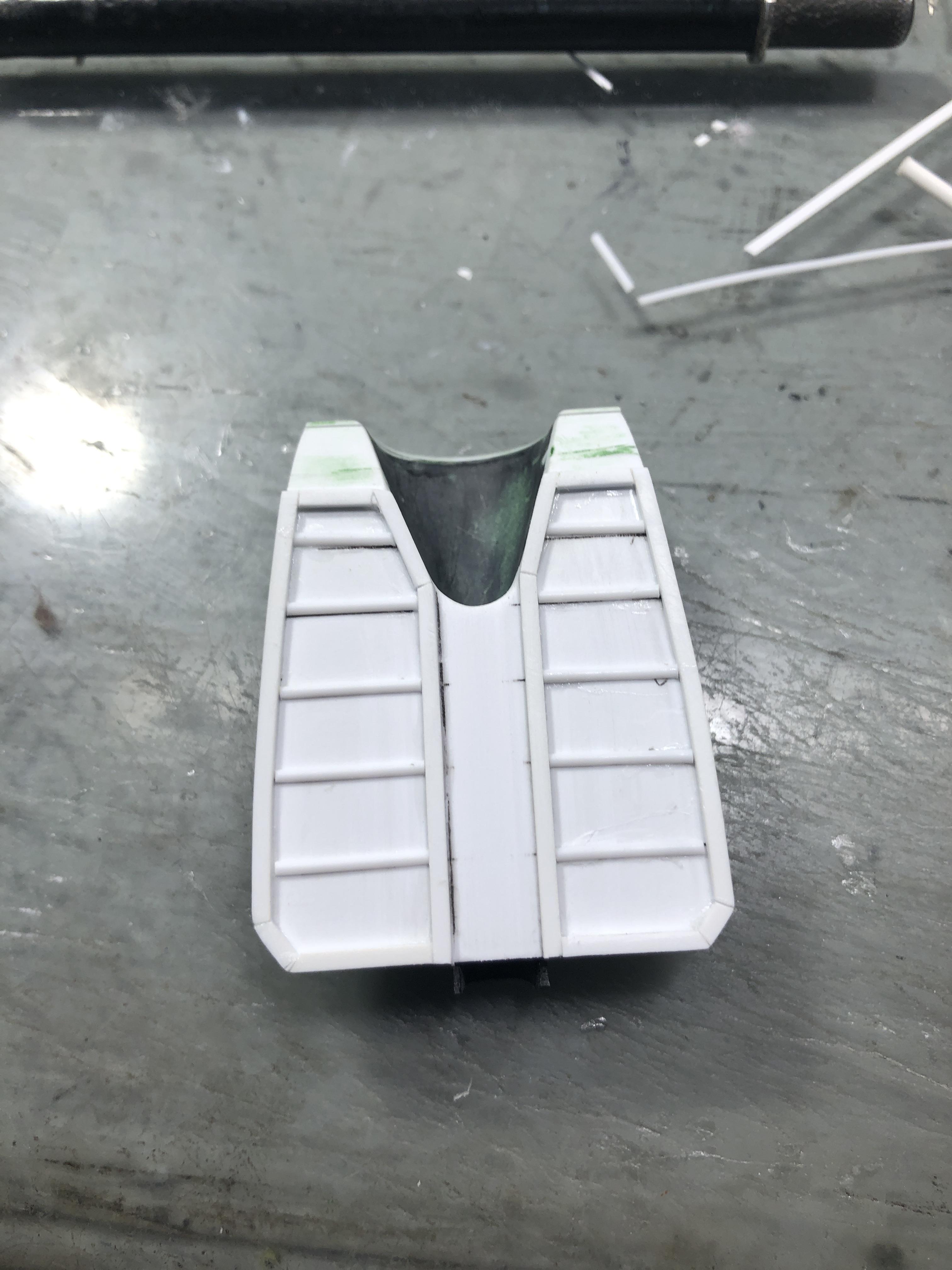

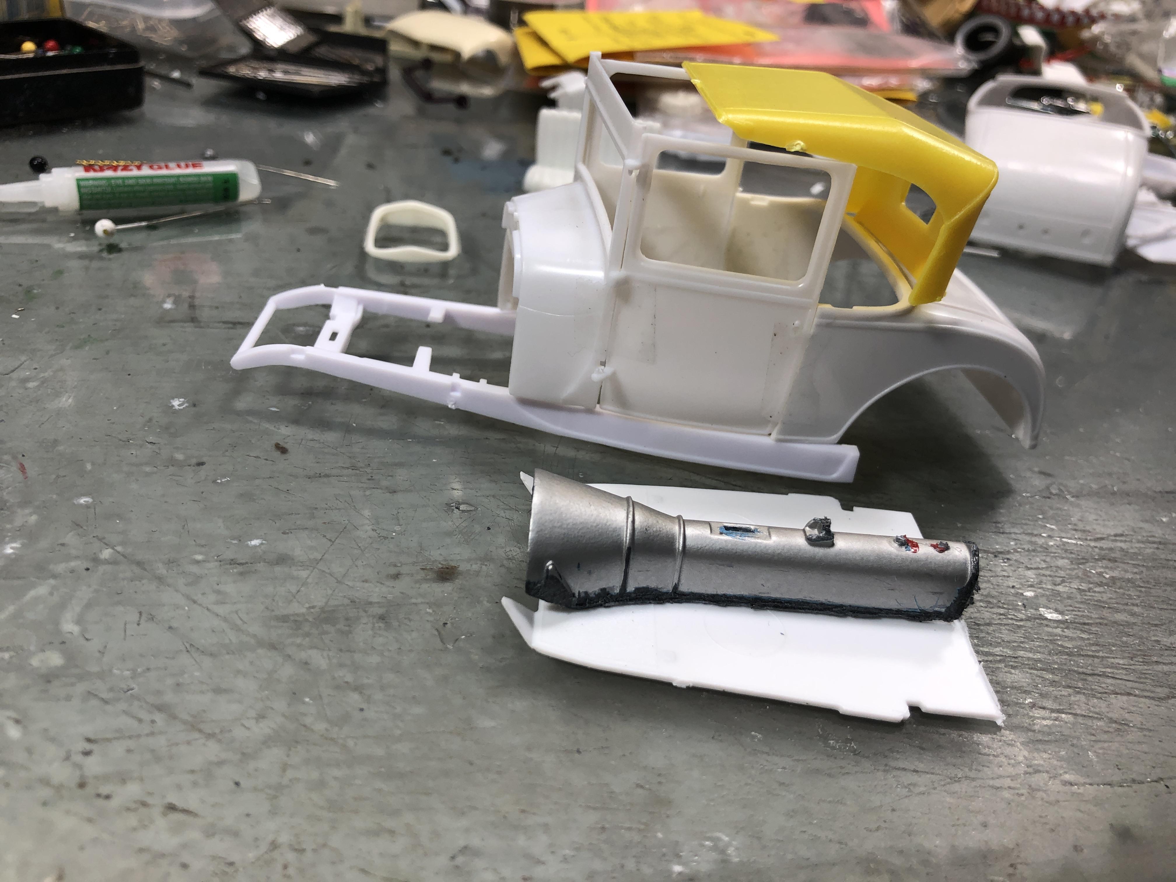

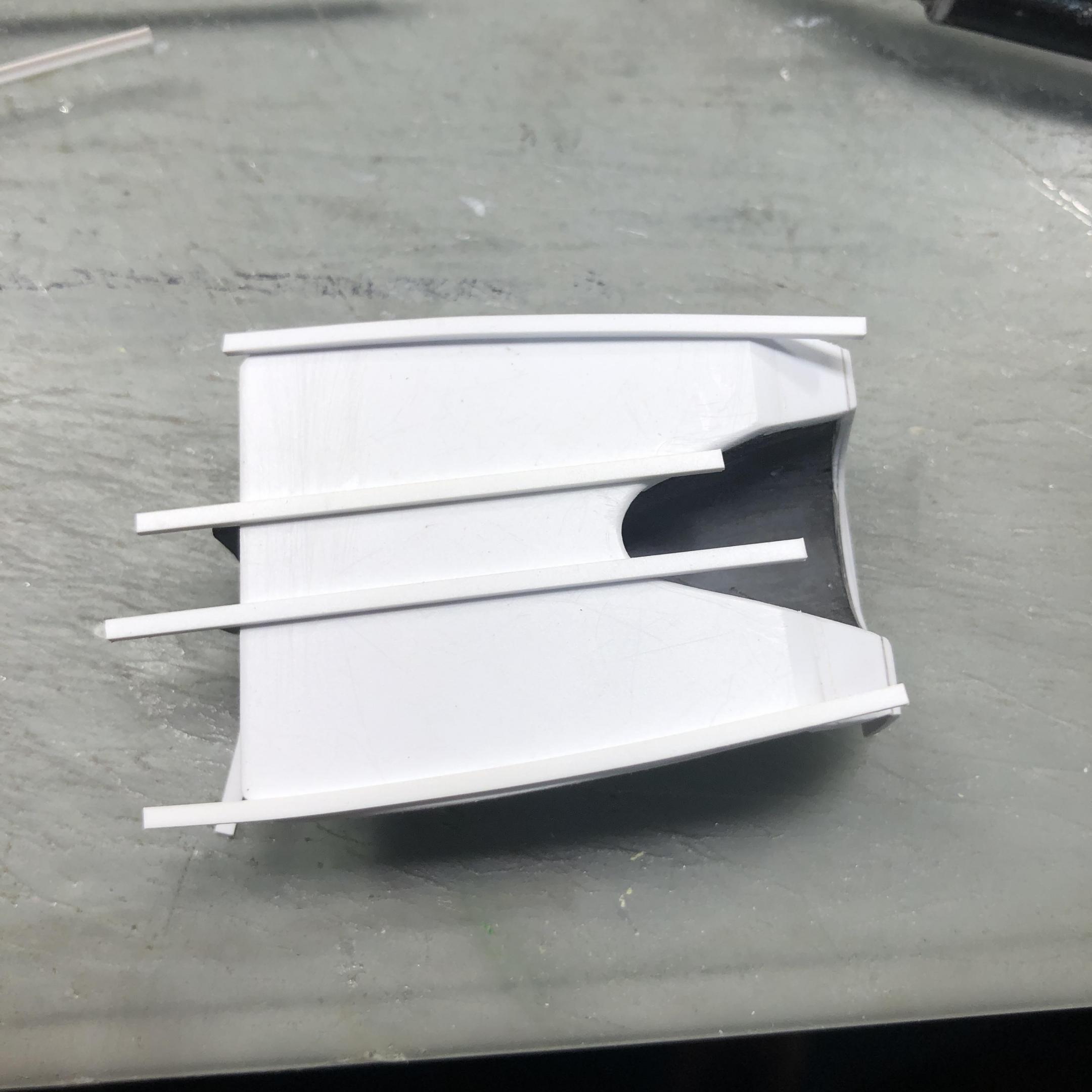

Rocking Rodney Rat Posted October 10, 2020 Author Posted October 10, 2020 More work on the sport coupe.... The idea for this making a unibody is from a post of a 1:1 car on H.A.M.B. Part of that means that the body is attached directly to the frame and that the floor pan is a structural part of the car. To that end, I braced the floor pan like this... The car will sit very low with the engine sitting up high so as not to hit the ground. The trans/driveshaft tunnel is from an old pro street kit. The exhaust will run down the center of the floor pan.... Thanks for looking. -RRR
misterNNL Posted October 10, 2020 Posted October 10, 2020 Looking very nice. I like the structural look of that floor plan. I'll be watching closely.
Rocking Rodney Rat Posted October 10, 2020 Author Posted October 10, 2020 Thanks, Tom. One of the half-round ribs was straightened out, it will all tie together. It's kind of a jigsaw puzzle (with a few pieces missing?).... -RRR
Claude Thibodeau Posted October 10, 2020 Posted October 10, 2020 On 10/5/2020 at 11:01 AM, Kit Karson said: RRR, You and I both know how this is going to turn out! I watched you in action for quite some time now!! Komments so far are spot on in some kases and kurious in others!?. Keep us kuming back, Brother... with your marvelous kommentary!!! KK PS Remember this 1929 Ford Full Fendered Sports Koupe from the GNRS 2019 Move in Day Hi! I've seen this car in person, and it was a stunningly detailed car. You aim high, and that's a good thing! CT
Rocking Rodney Rat Posted October 10, 2020 Author Posted October 10, 2020 2 hours ago, Claude Thibodeau said: Hi! I've seen this car in person, and it was a stunningly detailed car. You aim high, and that's a good thing! CT Yeah, I AIM high and then..... I'm working it!!! -RRR

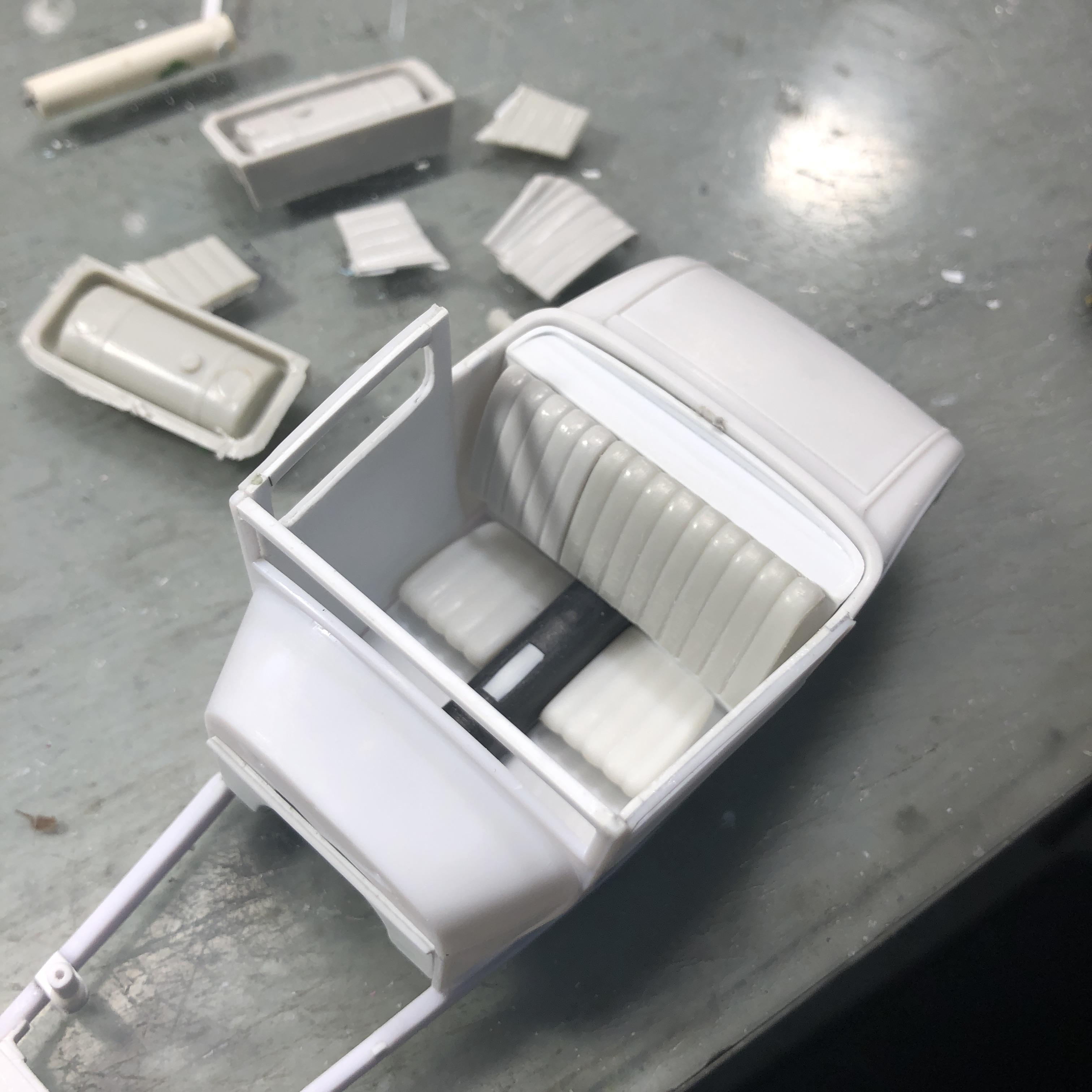

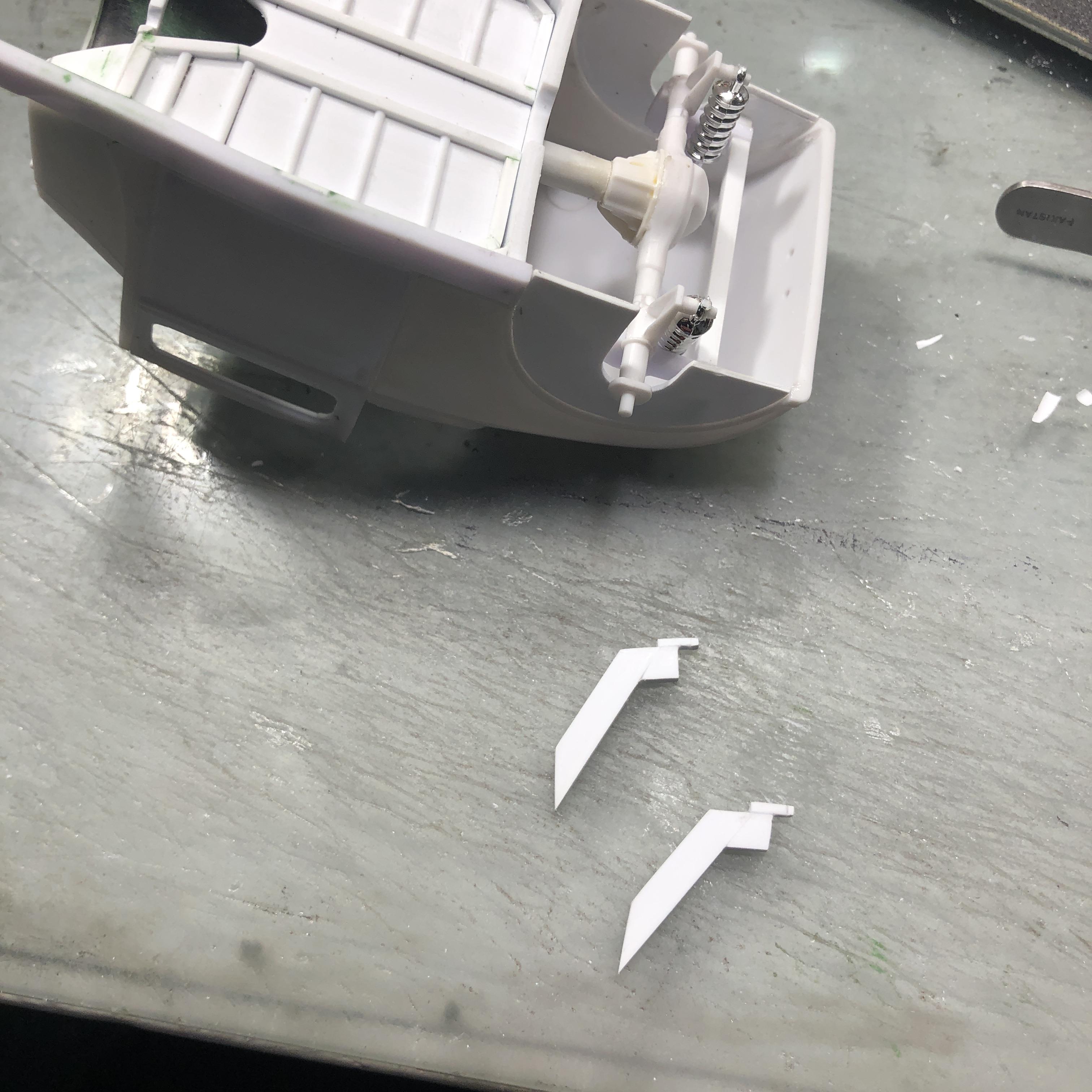

Rocking Rodney Rat Posted October 17, 2020 Author Posted October 17, 2020 (edited) Time for another update... working on the interior and the rear suspension. Fabbed up the package tray and back wall of the interior. The seat is made from two pieces of the venerable AMT 'T' bucket tub, split between the transmission tunnel. The rear suspension is going to a separate piece that will be attached during final assembly. The main part is from the same frame as the rest of the build, is the '32 frame from the Revell 'A' kits. To build this I attached the frame to the body (with axle and springs to get ride height set) with white glue (that can then be soaked off afterwards, taking it apart) and built the two pieces that will attach to the floor pan assembly. I'm not sure how clear this is.... The next pic shows the two frame pieces glued to the rear frame with a brace super-glued to those two pieces (I was concerned about the frame coming apart once I soaked apart the pieces temporarily held on with the white glue). The brace will be taken off after the frame is separated from the body. Edited October 17, 2020 by Rocking Rodney Rat
