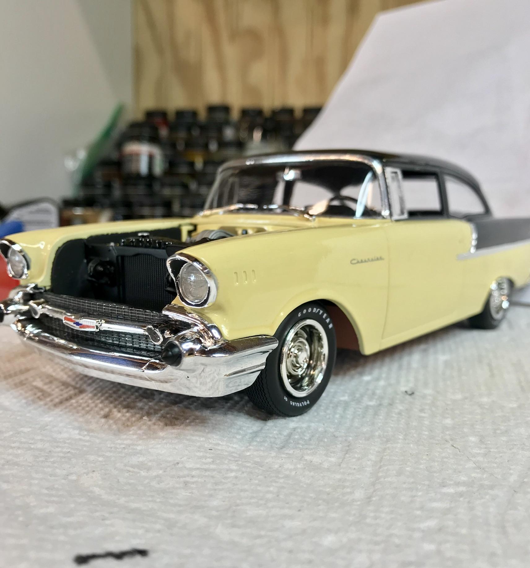

JohnU Posted October 11, 2020 Posted October 11, 2020 Another vote for Tamiya smoke. I use the bottle stuff and brush it on. Used it on the rims (not original to the kit) of this Revell Black Widow. You can see the difference to the bumper where I didn’t use it.
espo Posted October 12, 2020 Posted October 12, 2020 16 hours ago, JohnU said: Another vote for Tamiya smoke. I use the bottle stuff and brush it on. Used it on the rims (not original to the kit) of this Revell Black Widow. You can see the difference to the bumper where I didn’t use it. Great looking '57. Your picture really shows what I was trying to explain. You don't really see the smoke so much as it accents the chrome and the different parts of the bumper and grill assembly.

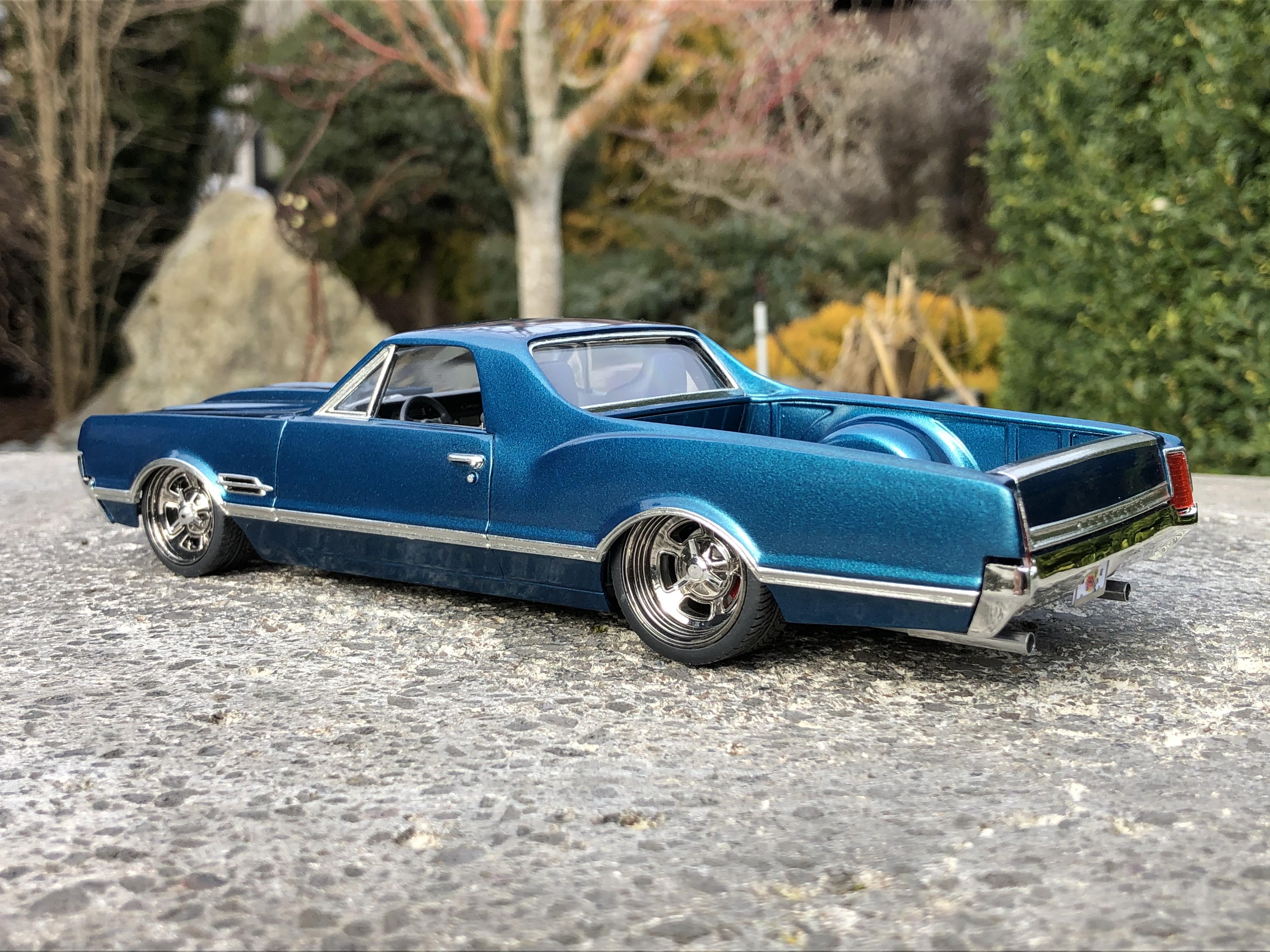

Goodwrench3 Posted March 24, 2021 Author Posted March 24, 2021 Thanks all ! I tried Tamiya "smoke" brushed on these kit wheels (straight from the bottle). I think the effect is pretty good. At least I tried something new.
Dave G. Posted March 24, 2021 Posted March 24, 2021 19 minutes ago, Goodwrench3 said: Thanks all ! I tried Tamiya "smoke" brushed on these kit wheels (straight from the bottle). I think the effect is pretty good. At least I tried something new. Good job, I like the whole model !

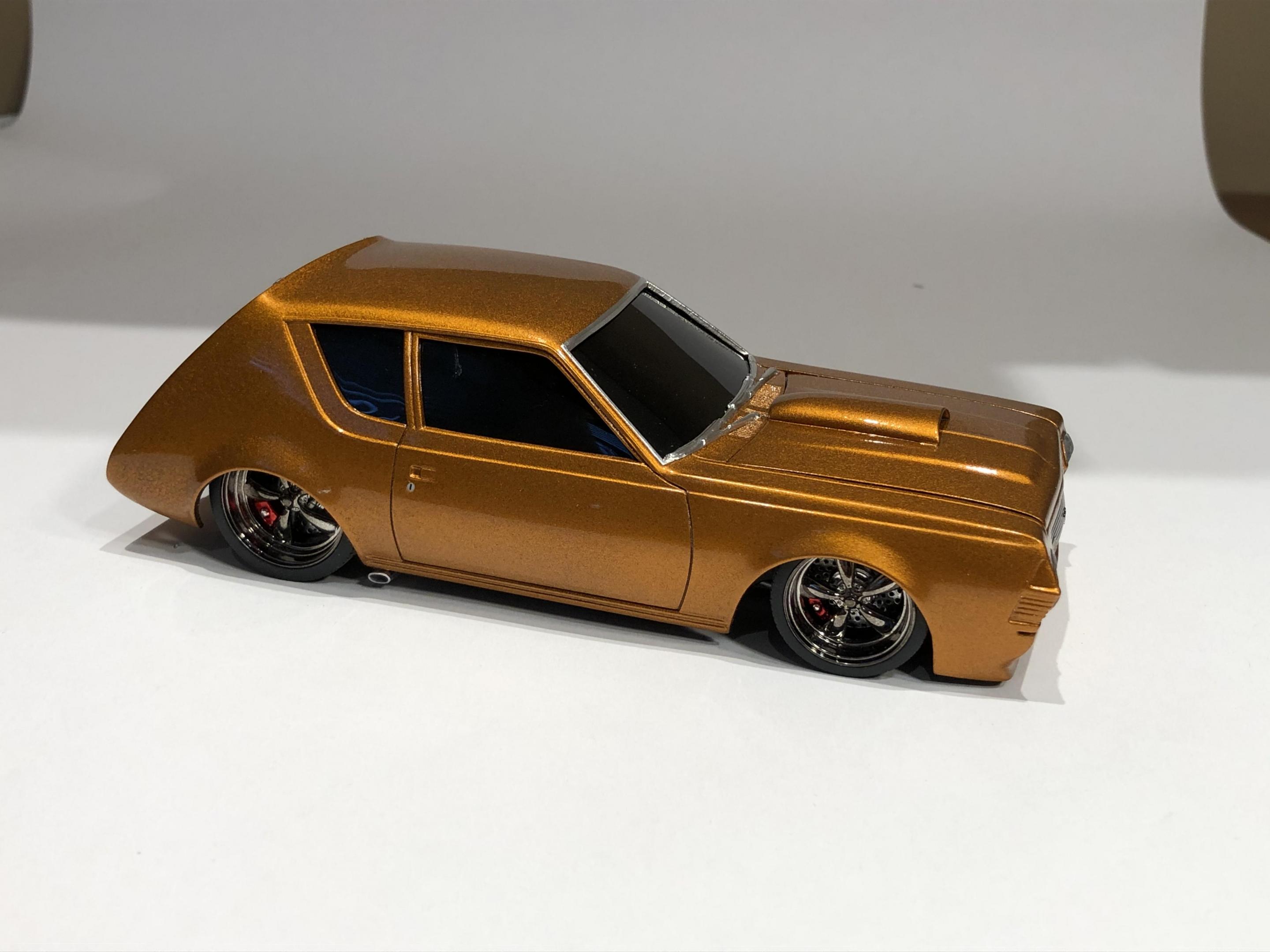

Steve H Posted March 25, 2021 Posted March 25, 2021 I’m way late here but another vote for Tamiya smoke. I spray it in light mist coats. 2 light coats... these wheels have about 6 coats... Cheers, Steve
Goodwrench3 Posted March 25, 2021 Author Posted March 25, 2021 Thanks for posting that ! There was some concern that spraying it might end up putting too much on, so it was recommended to brush it. Did you spray from a rattle can ?
Steve H Posted March 28, 2021 Posted March 28, 2021 On 3/25/2021 at 7:16 AM, Goodwrench3 said: Thanks for posting that ! There was some concern that spraying it might end up putting too much on, so it was recommended to brush it. Did you spray from a rattle can ? Hi Jeff, yes that was straight from the rattle can. I did a test spray on some spruce first. The darker smoke on the Gremlin wheels turned out pretty cool. I will definitely use this technique again. Cheers, Steve
