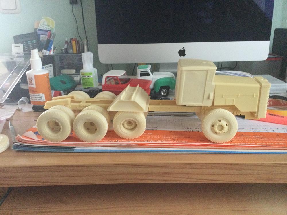

carsntrucks4you Posted October 12, 2020 Posted October 12, 2020 (edited) I had ask for some pictures of a civilian Oshkosh M911. I want to build it based on the Minimanfactory Oshkosh M911 in 1/24 scale. This beast is a 4.4 lbs heavy lot of resin parts. The quality is similar to KFS, Modelhaus or Scale Production kits. No holes no bubbles , but 3 negative points. First the spruce specially on the wheels and rims. Secondly the lack of brake chambers on the lift and the front axle. But they are not visible on the finished model. The last issue is the back side of the tanks which requires a lot of cleaning and fill.Here a first mockup. I did a new grill because it would be a lot of work to clean up the holes in it.A buddy did some work on the diesel tanks and I print them also. Edited October 13, 2020 by carsntrucks4you
gotnitro? Posted October 12, 2020 Posted October 12, 2020 (edited) Serious work truck right there !!! I built the Meng one when it became available, and was blown away by the details. The M911 would look right at home pulling a logging trailer , lowboy hauling heavy dozers or any other rigorous work that would break other trucks ..definitely looking forward to your build . Edited October 12, 2020 by gotnitro?

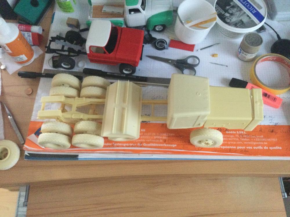

carsntrucks4you Posted October 13, 2020 Author Posted October 13, 2020 (edited) 1 hour ago, HJK said: Hi M.W., Can you please tell a bit about the quality of the resin parts? Thickness of cab walls, smoothness of surfaces, any bubbles and the like? How about your experiences of trading with the supplier? Was it easy to trade with them? Did all go smoothly regarding the payment? How did they pack the parts? Thanks, Juergen Jürgen, as i said it is a clean bubble free casting, the surface is smooth like a glass. There are some issues with the back side of the tanks, therefore I print new ones. The wall thickness cab, hood, doors, fenders and lift axle cover is about 0.059" or 1,5mm. Minimanfactory is reliable in shipping and payment. Gabor Kiss is the owner and he speaks German. The kit came in 2 boxes well packed. There is also some photoechted parts. The metal is easy to bent. There are no decals. Although it is a very expensive kit it is worth the money. They have also a KRAZ 255B in 1/24. This is one of my next project. Edited October 13, 2020 by carsntrucks4you

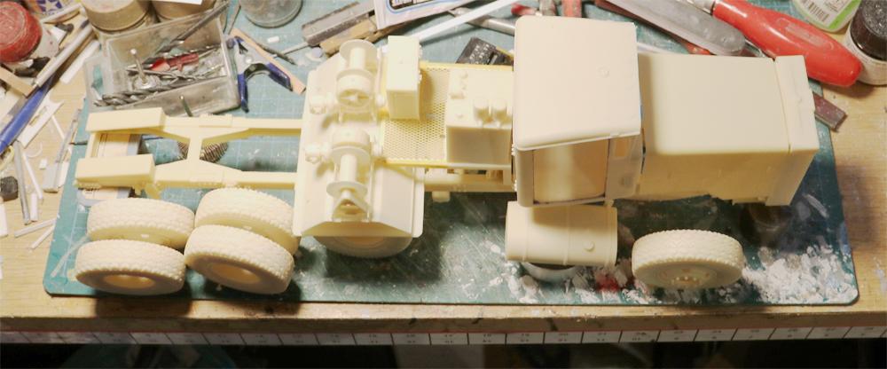

carsntrucks4you Posted October 14, 2020 Author Posted October 14, 2020 Some more progress. Installing the platform is a bit tricky. I will add some support s to the platform so that I could assemble it and then attach it to the frame. The instruction say to attach the single parts to the frame. It is a beast. It would be the largest truck that I have

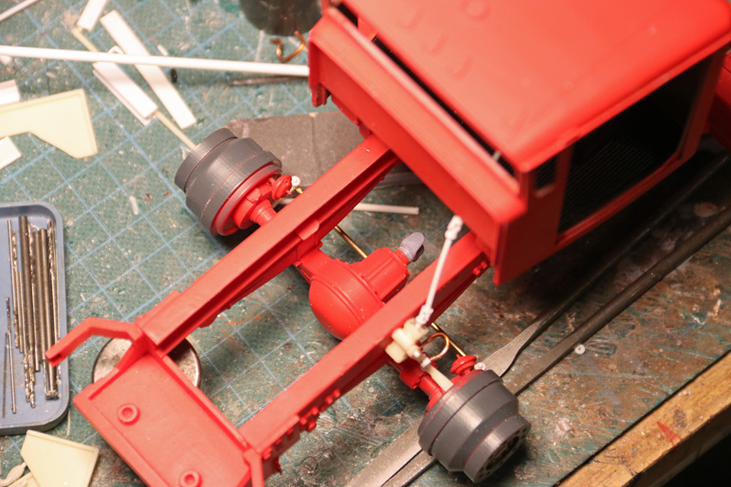

carsntrucks4you Posted November 4, 2020 Author Posted November 4, 2020 The Barnhardt Oshkosh's have different rear axle than the Minimanfactory one. Because I couldn't find pictures of the axle I made a 3 D model of the new hub, brake drums and rims. And I printed them on my Photon S.
gotnitro? Posted November 6, 2020 Posted November 6, 2020 Wow awesome wheels ..look like planetary drives

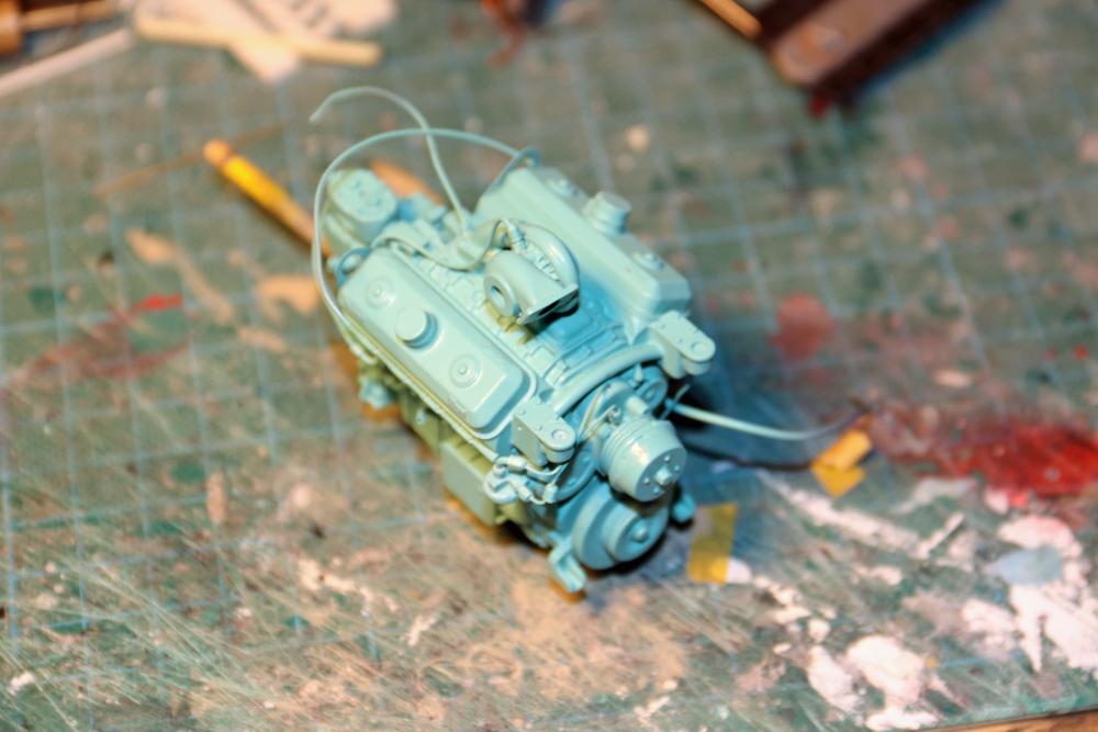

carsntrucks4you Posted November 11, 2020 Author Posted November 11, 2020 (edited) The engine is wired and plumped. Next will be compelting with V-Belt and the add-on pieces and weathering. Paint is Detroit Diesel Green from Zero Paints while the fittings are from Top Studio Hobbys. Edited November 11, 2020 by carsntrucks4you
DRIPTROIT 71 Posted November 11, 2020 Posted November 11, 2020 That engine is looking awesome! Don’t forget to add some oil leaks.?
gotnitro? Posted November 14, 2020 Posted November 14, 2020 Nicely detailed engine ! Like the addition of the alternator too instead of the generator. Thats gonna look awesome under the hood of this workhorse
