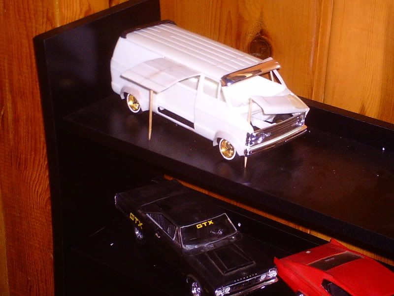

1320wayne Posted November 10, 2008 Posted November 10, 2008 (edited) Here is my next new/old project. I purchased this kit as a partial builtup at a swap meet four or five years ago for a song. That's where the thin coats of red, white and blue came from. As soon as I bought this I tore it apart and then started pondering where to go with it. What I came up with is a mixture of modern and retro custom van ideas. Two years ago I finally pulled it out of the box again and started with a mockup of my ideas. The following pics. are what the body looked like when I bought the kit and how it looks mocked up on the tire and wheel choice, Pegasus Halibrands. Then I started cutting and taped the doors in place as gull wing style to see how it would look. Then the model went back in the box. Edited November 17, 2008 by 1320wayne
1320wayne Posted November 10, 2008 Author Posted November 10, 2008 When I pulled the kit back out about a month ago I decided that it was time to get back into this one. From there I was able to get the side and rear doors hinged in place and working. The front doors will eventually be hinged suicide style just to change things up a bit.

1320wayne Posted November 13, 2008 Author Posted November 13, 2008 (edited) I like this, can you show us how you did the doors? Let me answer this question first. Here are a couple of pics. of what the door mechanics looks like. I started by cutting the individual doors from the body and then glueing them together to form one door. Next was to glue the tops of the doors back into place and create new door lines that extended into the top of the van. I created two hinges for the sides of the door out of styrene and then a hinge frame out of square evergreen stock. I was then able to drill and tap holes on each side for the 00.90 brass screws to attach the doors to the hinge block. A little shaping for clearance and the doors opened perfectly. By using the brass screws I was able to tighten them just enough to give the right amount of tension to allow the doors to remain open without a door prop. Edited November 13, 2008 by 1320wayne
