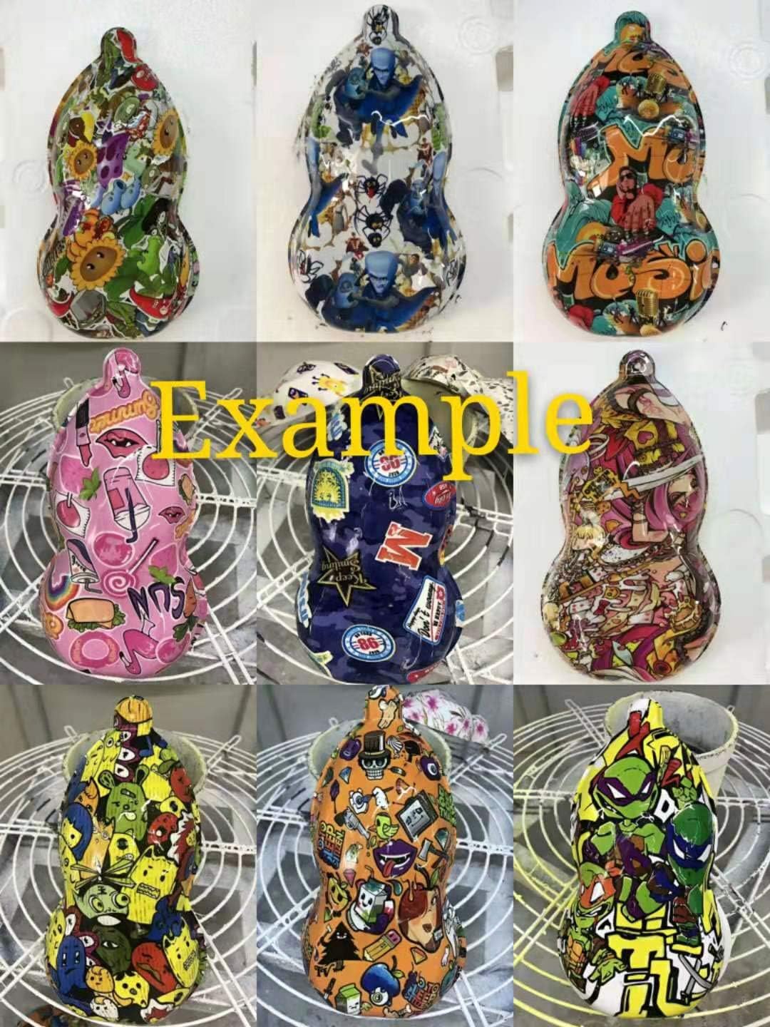

Jonathan Posted October 20, 2020 Author Posted October 20, 2020 On 10/18/2020 at 8:11 PM, cobraman said: If your talking about the film you can buy and not where you put paint on the water....I looked into it a while ago buy could not find any prints that were "in scale" for a model car. This is what I was referring to - the film. I think it's sometimes called "water transfer printing", but I'm not sure. Seems, if you could either find or create your own scale-appropriate patterns, that there might be a way to use this in our hobby. Here's a full-scale version:

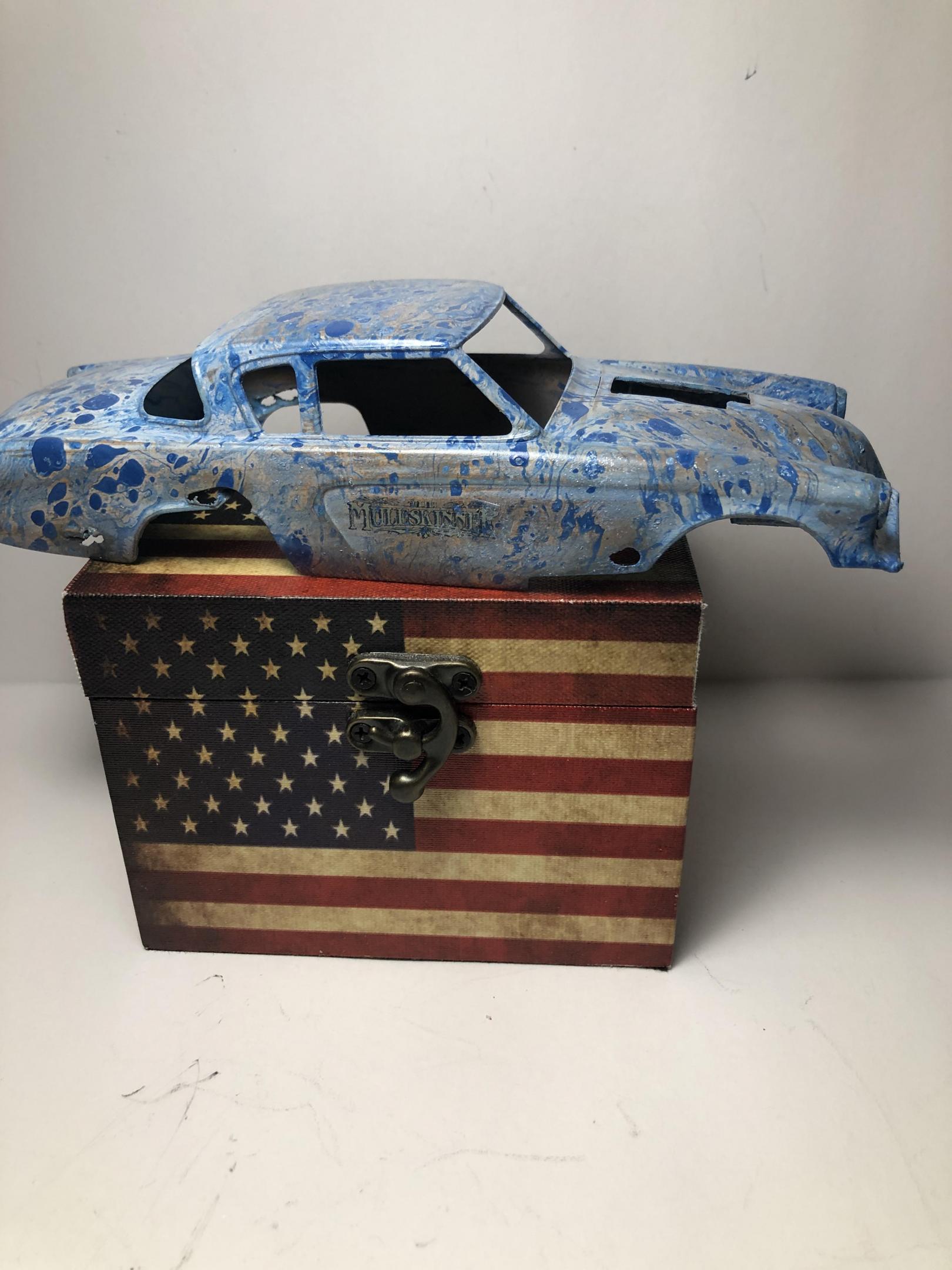

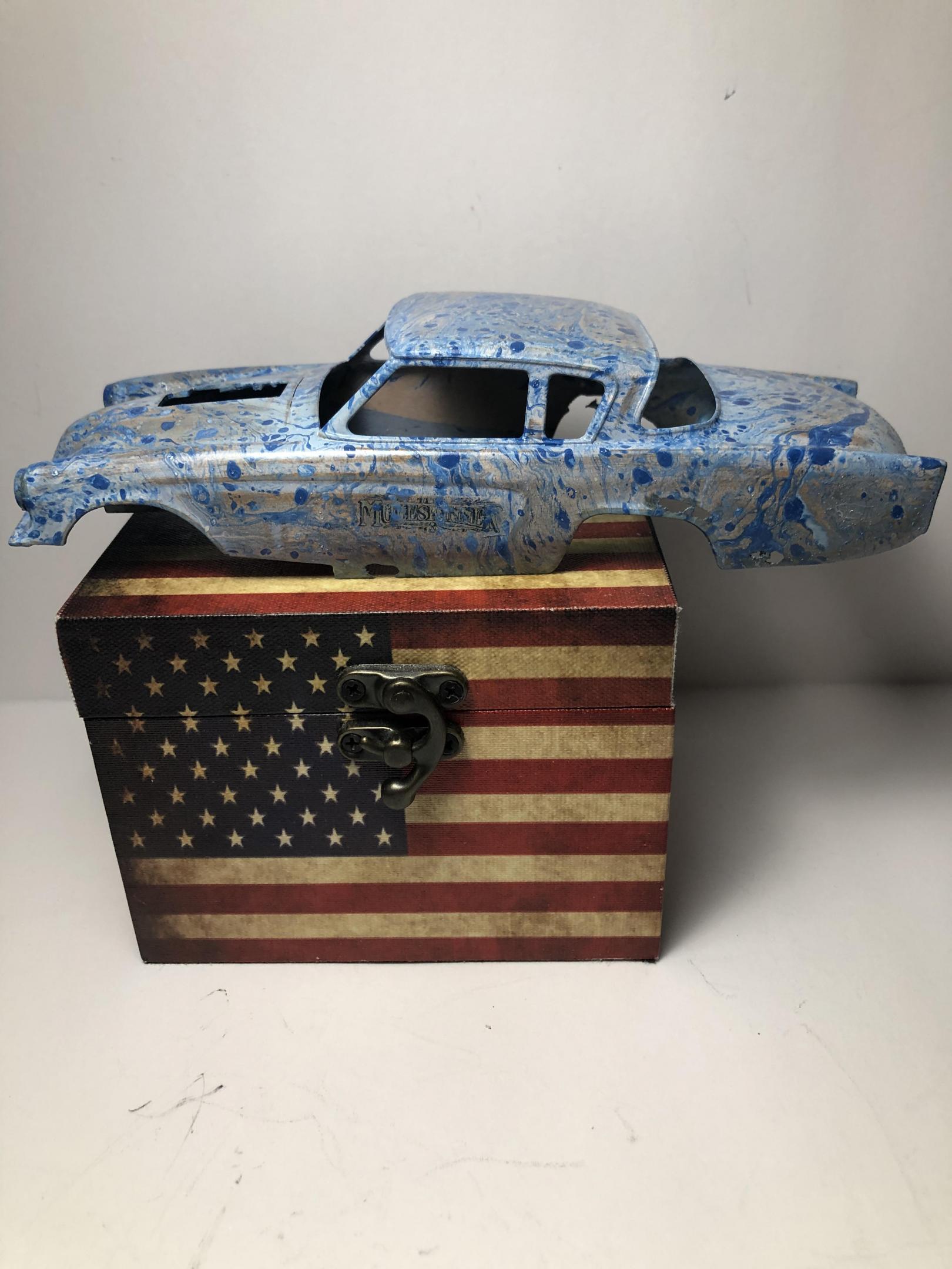

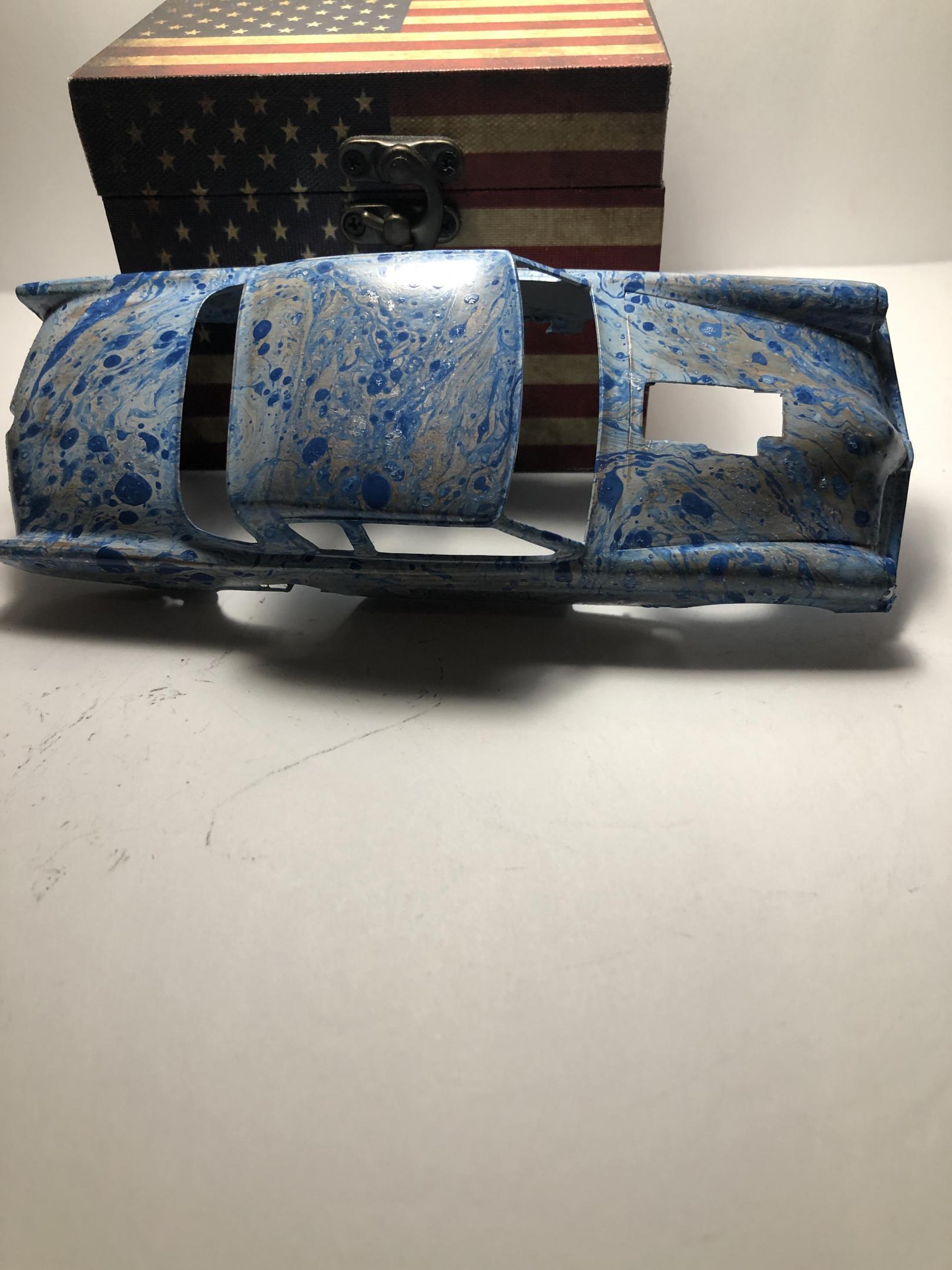

cobraman Posted October 26, 2020 Posted October 26, 2020 Not really a fan of this swirl a delic painting . I recall seeing in all those years ago . That being said I got a bug to try it . Here is my result . As I said , not a fan but I will find something to do with it .
