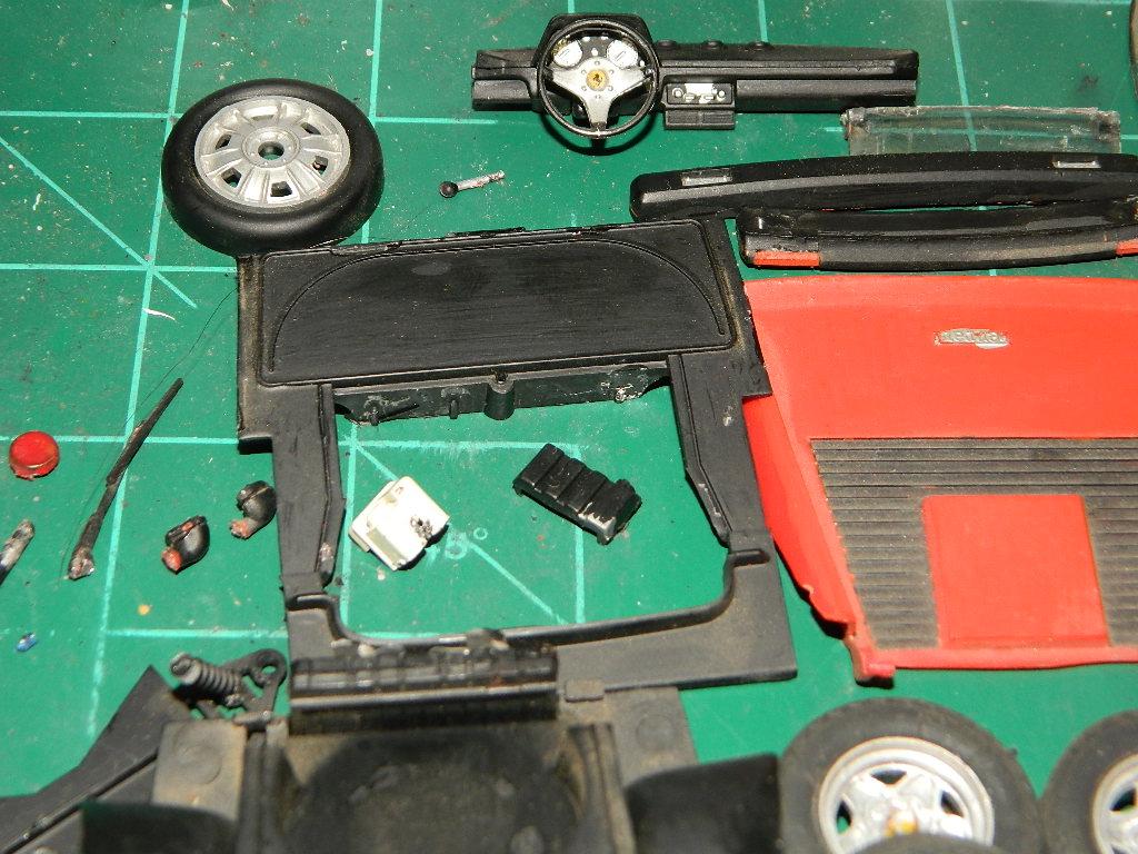

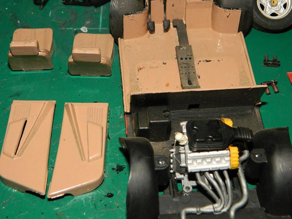

mrmike Posted October 17, 2020 Posted October 17, 2020 Another dirty rotten filthy subject for my model shelves. An original Magnum PI Ferrari 308 GTSi that I disassembled and will be getting cleaned and repainted, especially the body. Due for a good cleaning and a rebuild. There is only one Magnum PI for me and that was played by Tom Selleck! https://www.youtube.com/watch?v=xIaXl7SqkBw More Magnum to come...

mrmike Posted October 18, 2020 Author Posted October 18, 2020 Thanks D.W.! The more I handle this model, the more it just falls apart! I went to drill out the cylinder heads for plug wires and the heads come off! Plus, I need to make a distributor for each head. That should be easy enough to make. I drilled out one of the wheels for a new mounting pin which I ended up making from scratch. More Magnum to come...

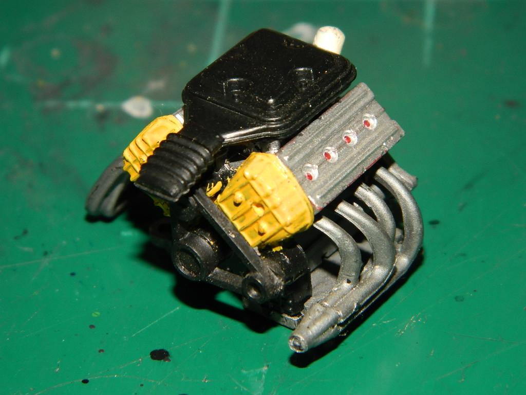

mrmike Posted October 22, 2020 Author Posted October 22, 2020 I got the engine wired with Radio Shack blue wrapping wire. I got the front suspension fixed with a new wheel pin and I detail painted the dash. More Magnum to come...

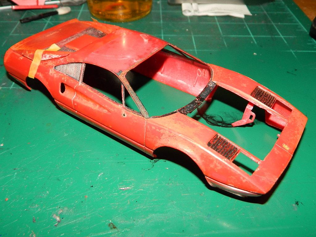

mrmike Posted October 24, 2020 Author Posted October 24, 2020 I went and checked on the body and parts that I am stripping with Easy-Off Oven Cleaner. Not bad. Pretty much ready for a bath and some scrubbing in the kitchen sink. The chassis is up on 4 wheels after I made a new rear axle using some 1/16th inch styrene rod. More Magnum to come...
mrmike Posted October 26, 2020 Author Posted October 26, 2020 The chassis is now fairly complete. I'm still thinking about the exhaust tips since this 308 came with a single exhaust pipe and I want duals like the Magnum 308. I got the interior rebuilt and the rear cover installed. More Magnum to come...

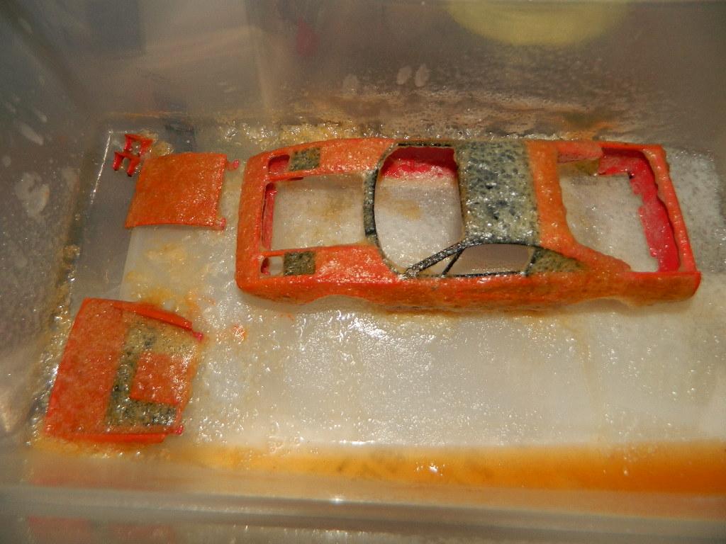

mrmike Posted November 29, 2020 Author Posted November 29, 2020 The body got a bath in Easy-Off Oven Cleaner and as I was rinsing the parts, the hood bent in my hand rather easily. Then the mounting ears for the hood lid fell off and it reminded me that the plastic has become brittle. I must be extra careful with this body so I don't break anything else.

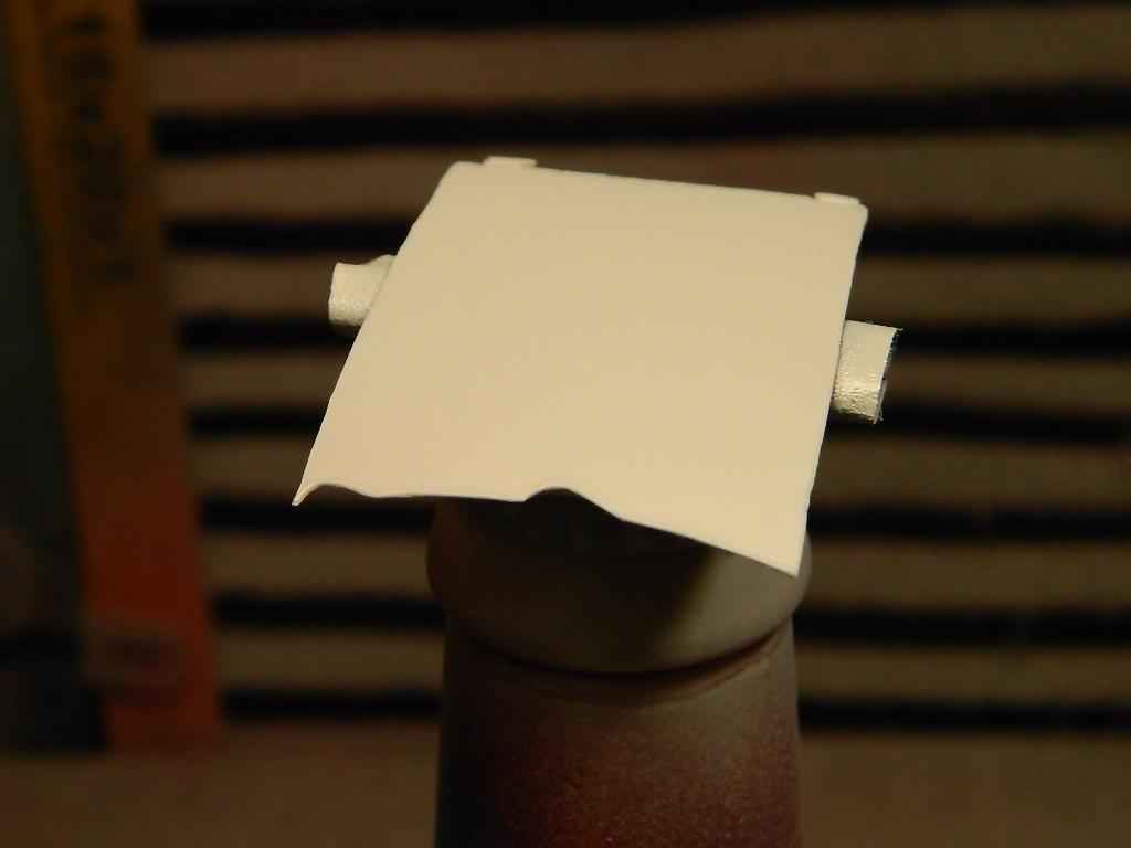

mrmike Posted November 30, 2020 Author Posted November 30, 2020 The plastic in this kit is definitely brittle! I broke the cowl for the Ferrari. I decided to add a piece of .020 styrene about 2 inches long and glued the whole thing together. I'll use my Dremel to grind the excess away when all has dried. I added the broken pieces of the engine cover and glued those back on with plenty of glue. A little sanding is required later when this has had a chance to dry. Magnum PI will return...

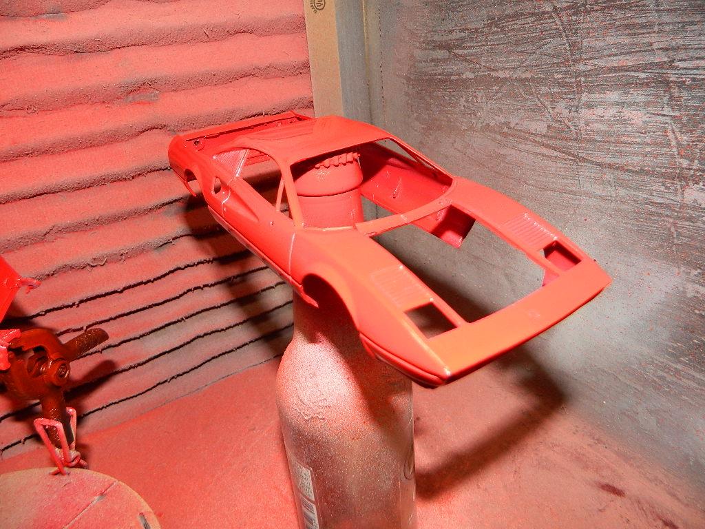

mrmike Posted December 13, 2020 Author Posted December 13, 2020 I finally got the Ferrari into a coat of Tamiya Light Grey Primer. I'll sand this out when the primer is nice and dry. I will have to fix the front panel since the plastic cracked due to it being so brittle. More Magnum to come...
