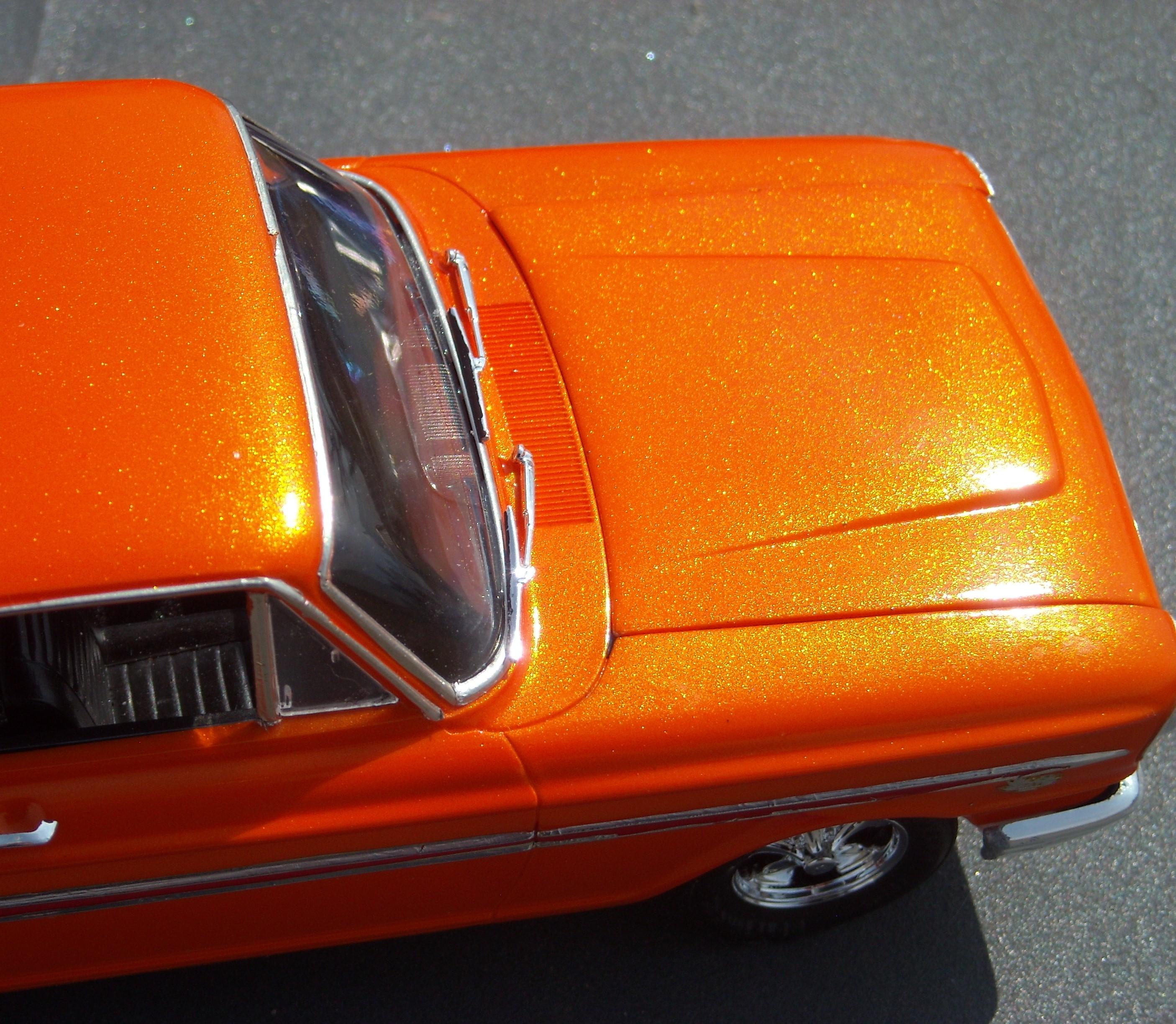

Kit Basher Posted October 26, 2020 Posted October 26, 2020 I have sprayed a fair amount of Auto Air, with pretty good results. There is a bit of a learning curve, and I suggest you download the "Hard Surface Application Guide" from their website. Some of their colors require adding a "balancing clear" before thinning, and others do not. I also use their thinner. They have some amazing colors, especially in the pearls and metallics. Good luck and have fun! This Ford was painted with one of their "Sparklescent" colors.
TransAmMike Posted October 26, 2020 Author Posted October 26, 2020 Thanks Hugh, beautiful sparkely finish. What clear did you use?
Kit Basher Posted October 26, 2020 Posted October 26, 2020 (edited) 27 minutes ago, TransAmMike said: Thanks Hugh, beautiful sparkely finish. What clear did you use? I think that one was Duplicolor "Perfect Match" clear, but almost any clear will work. BTW, I think "Wicked" is also made by Createx, but might be easier to use since it is not intended for 1:1 automotive use. Edited October 26, 2020 by Kit Basher

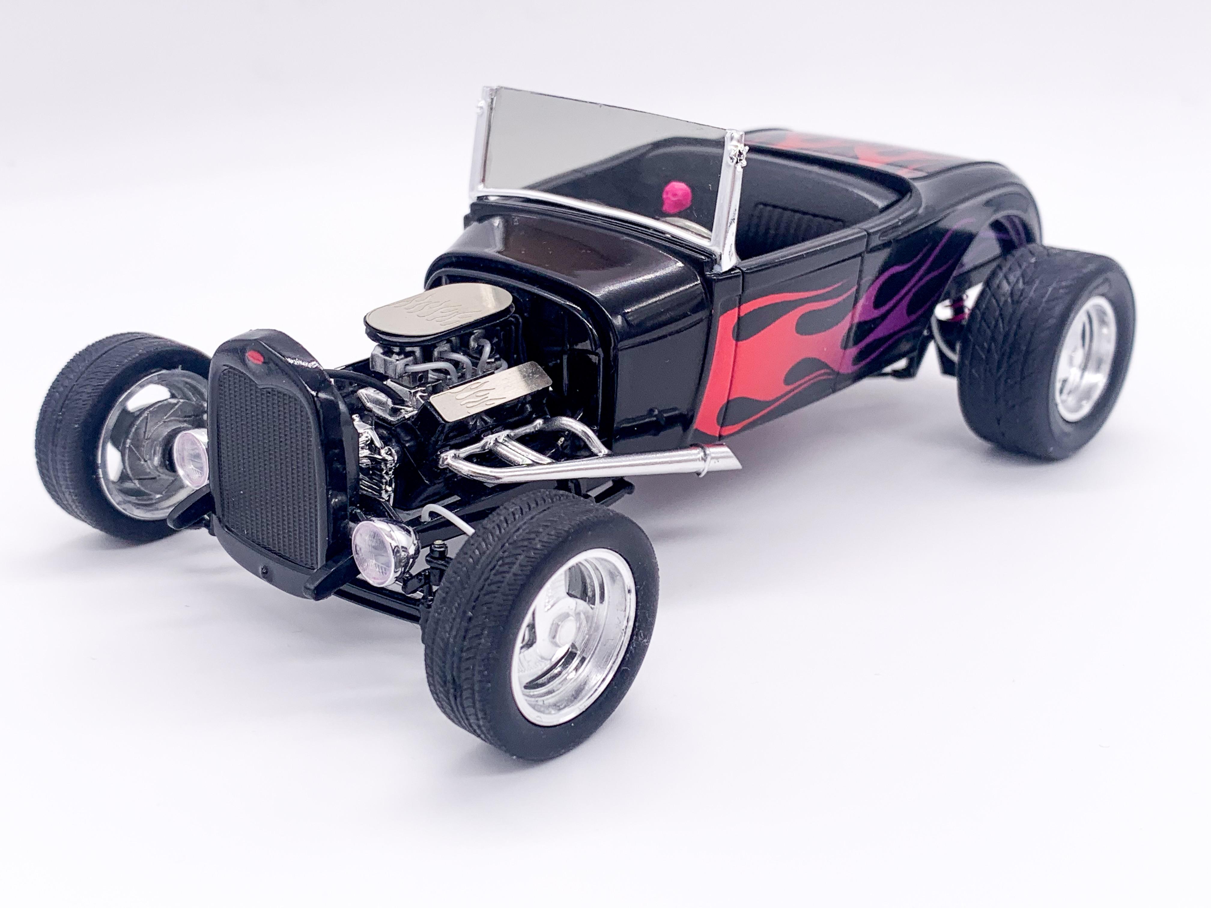

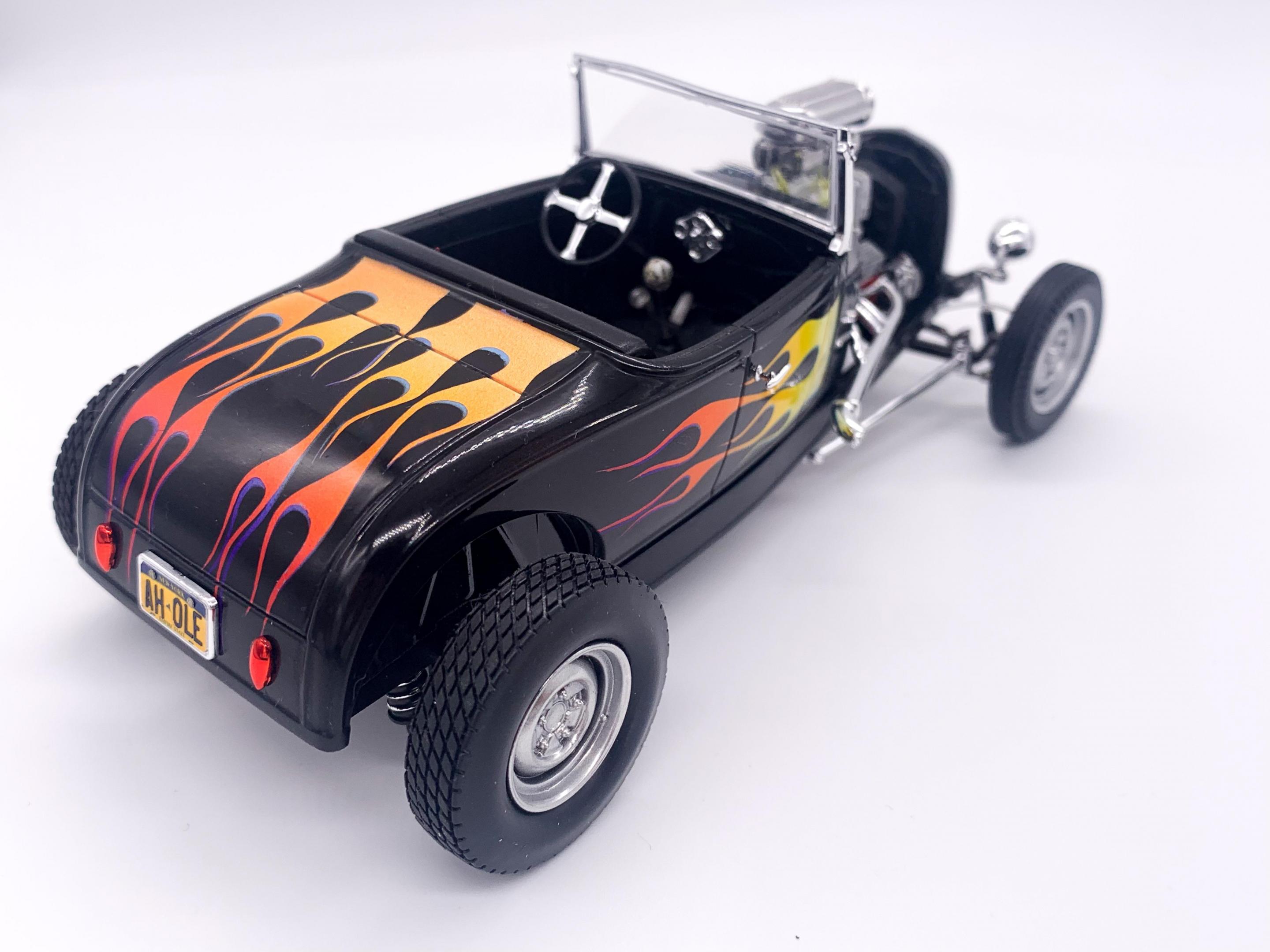

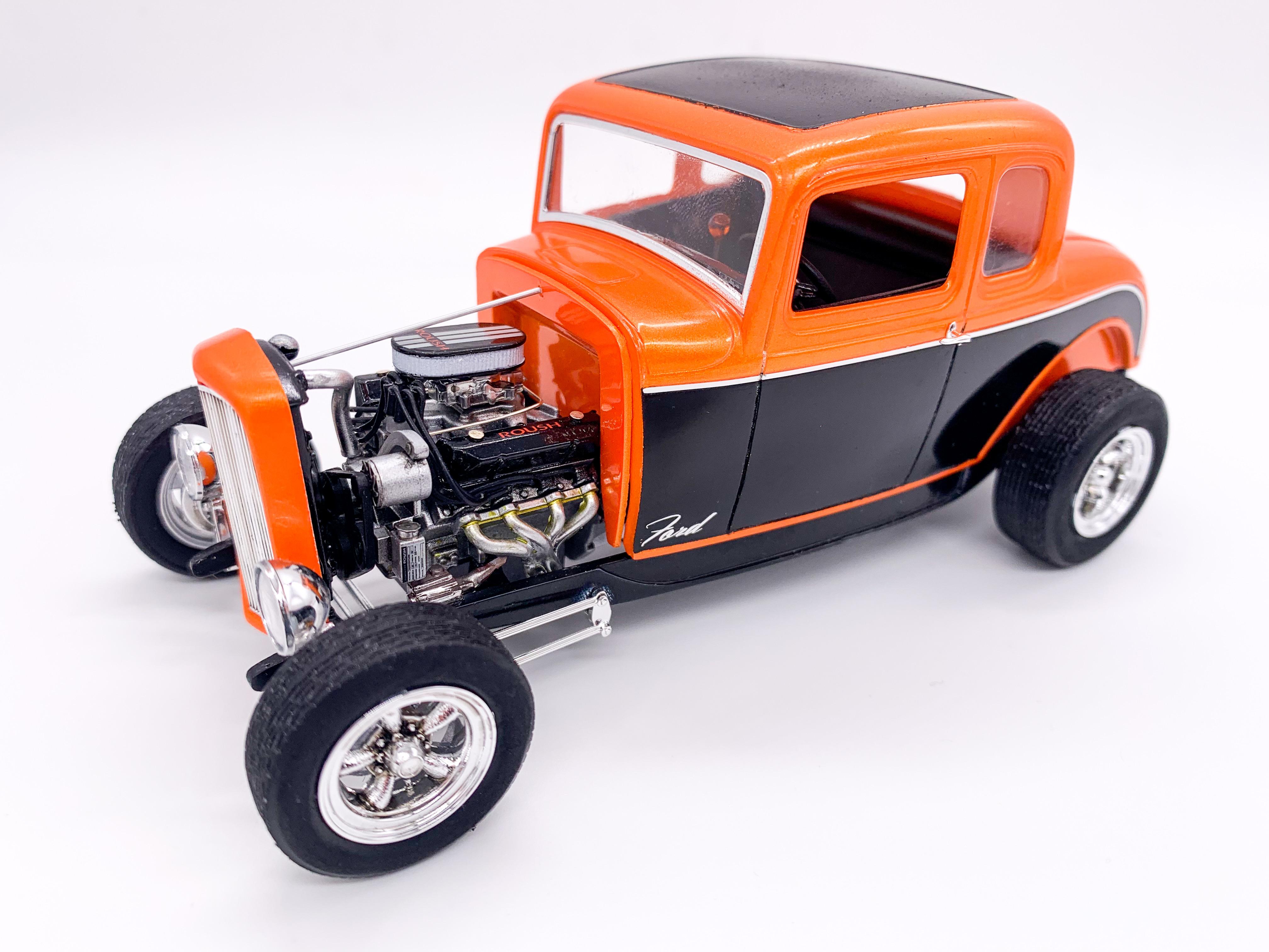

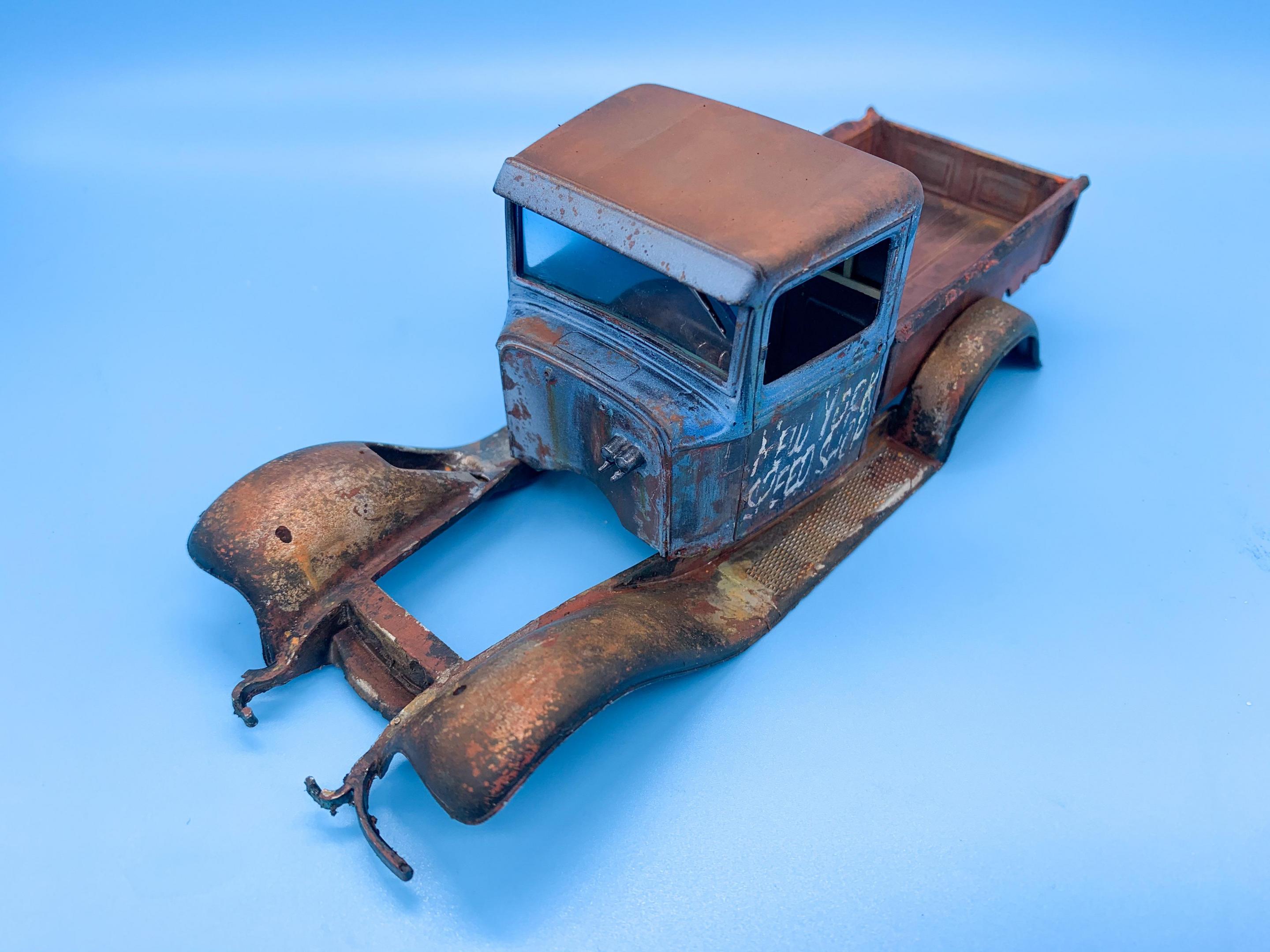

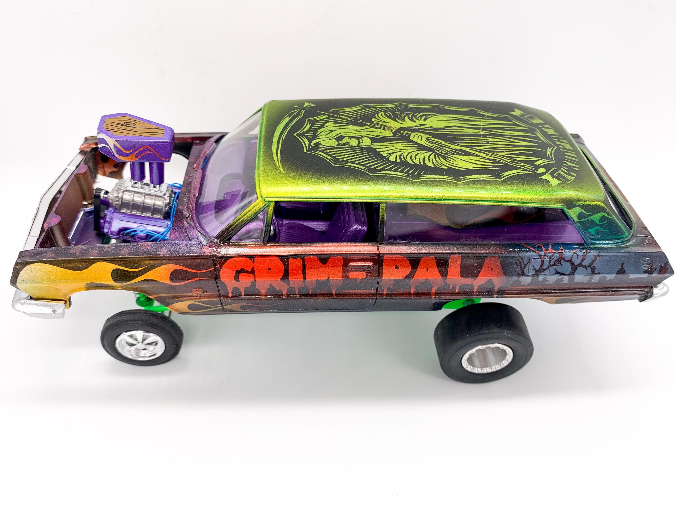

OldNYJim Posted October 26, 2020 Posted October 26, 2020 Yep! Love all their paints! Very forgiving to use, great price, great colors, and they mix easy as pie. Hard to go wrong with them! You can’t polish them like lacquers or enamels, so you’ll need a top coat, so bear that in mind but I love them! All painted with Createx or Wicked Colors paints (mostly Createx):
