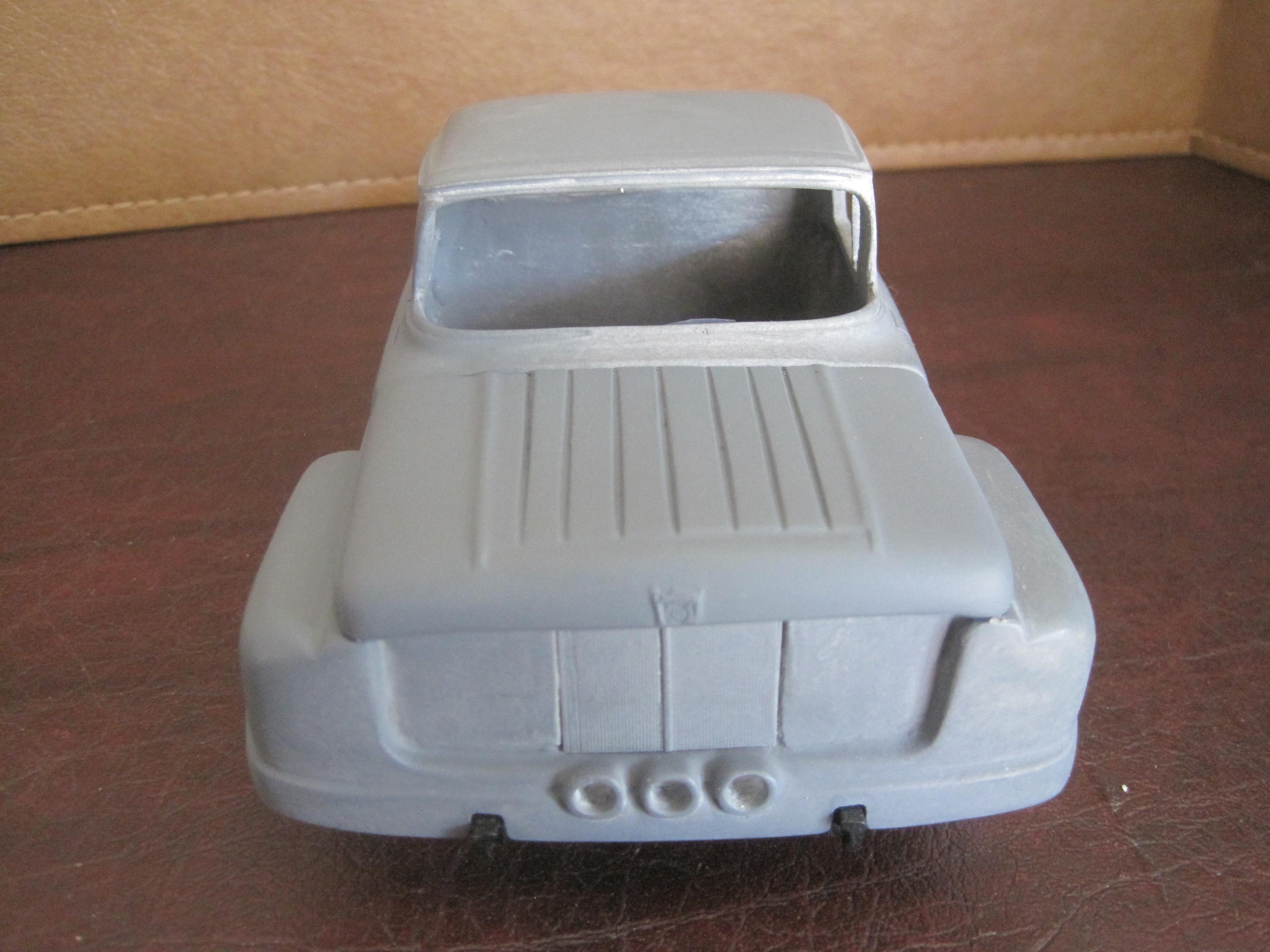

leafsprings Posted October 31, 2020 Posted October 31, 2020 (edited) Doing another Frontier Resins offering marketed as a Big Job. This time it will be a Custom Cab F 1000 2 axle tractor. Will lower the front end under grill 1/4", fill in back cab corners and square out the fenders. Engine will be the destroked version of 534, which is the 477. Spicer 5 speed from KW conventional kit and using frame off the GMC Astro. Budd wheels will be aftermarket resin. Edited November 1, 2020 by leafsprings

Rob Hall Posted November 1, 2020 Posted November 1, 2020 Neat..wonder what the 3 round holes above the bumper were for..
Oldmopars Posted November 1, 2020 Posted November 1, 2020 2 hours ago, Rob Hall said: Neat..wonder what the 3 round holes above the bumper were for.. Just a guess, but probably added air flow to the large radiator. Bigger engines needed larger radiators for cooling and the small truck cab design did not really allow for it. So, when they turned it into the "Big Job" sized truck, they needed more air flow. Those 3 holes would have given them that.
Rob Hall Posted November 1, 2020 Posted November 1, 2020 28 minutes ago, Oldmopars said: Just a guess, but probably added air flow to the large radiator. Bigger engines needed larger radiators for cooling and the small truck cab design did not really allow for it. So, when they turned it into the "Big Job" sized truck, they needed more air flow. Those 3 holes would have given them that. Just unusual looking compared to adding a rectangular grille opening there.

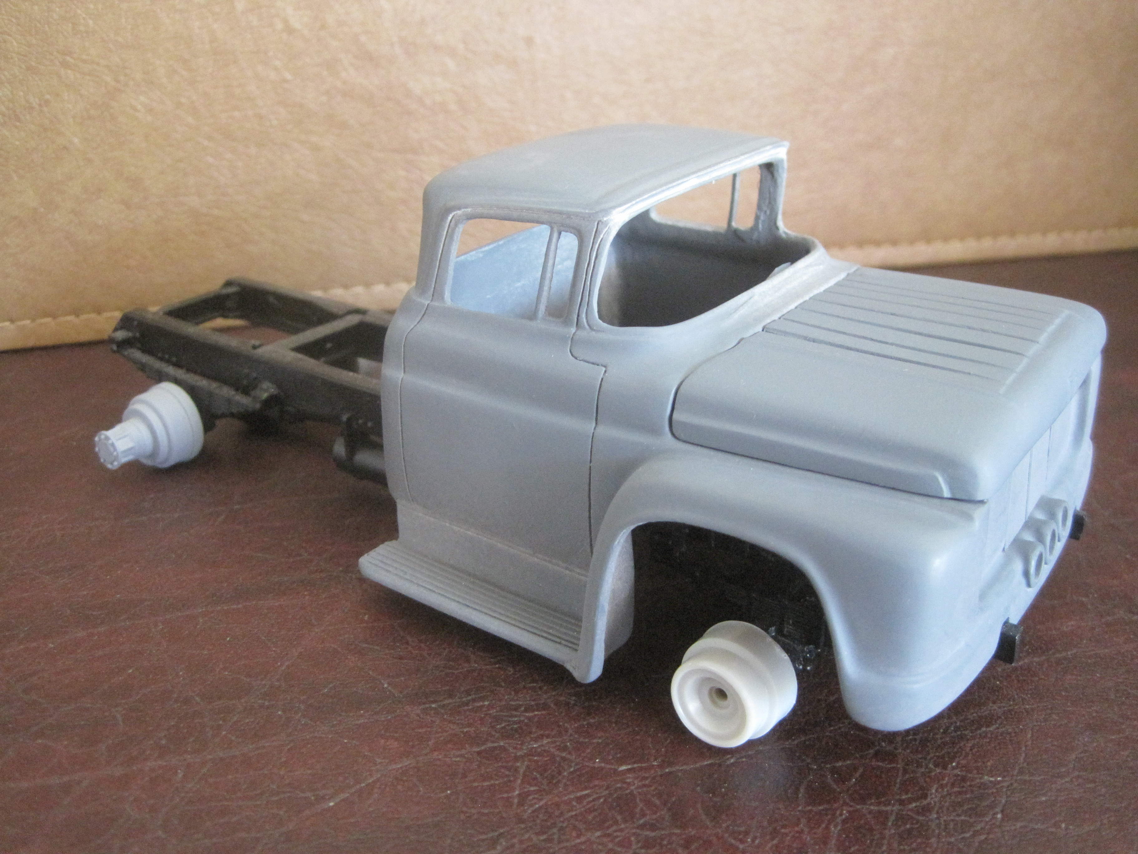

leafsprings Posted November 7, 2020 Author Posted November 7, 2020 (edited) Added 1/4" plastruct to front end, filled in rear cab corners and started to reshape fenders. Will be using dual fuel tank set up from AITM. Edited November 9, 2020 by leafsprings

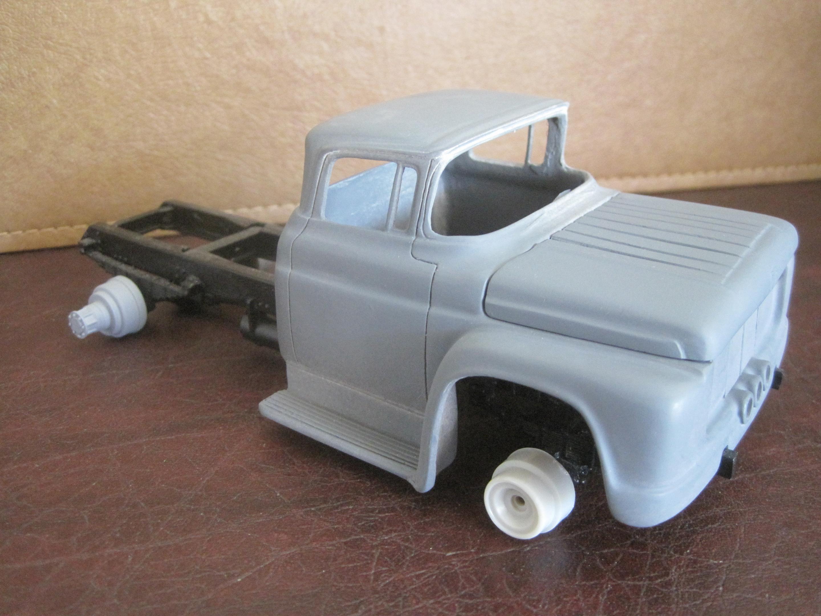

leafsprings Posted November 21, 2020 Author Posted November 21, 2020 (edited) Picked up a Keystone 1950's resin tanker. Another similar reference photo and some data. Some more work on reshaping front fenders and adding lip edge. Edited November 22, 2020 by leafsprings

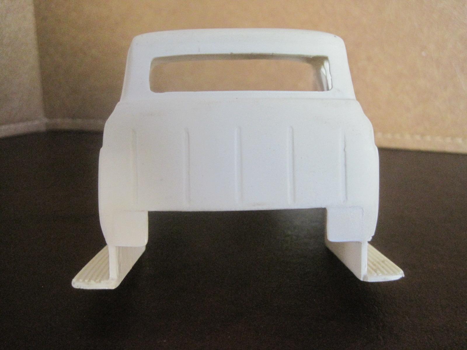

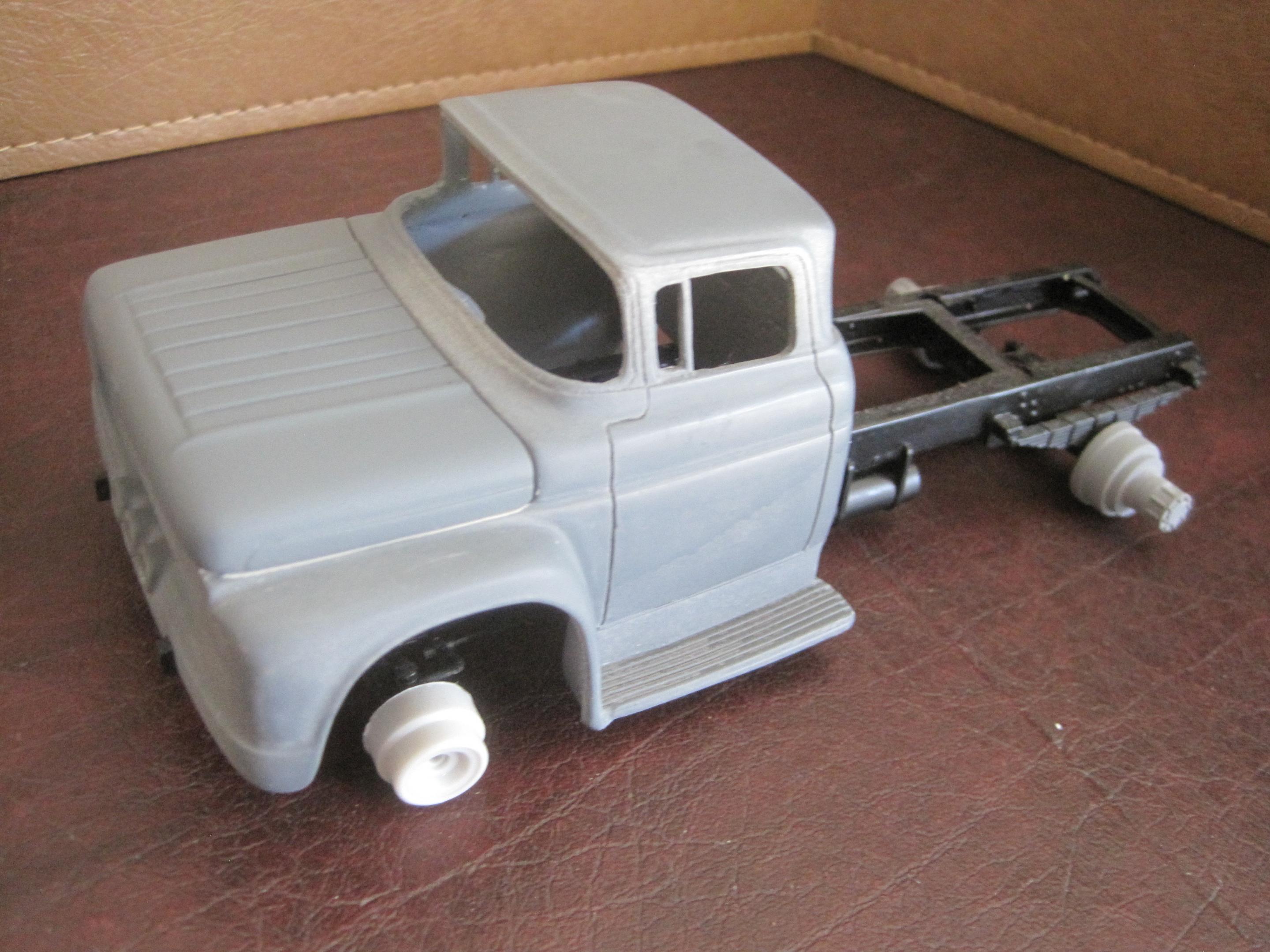

leafsprings Posted November 29, 2020 Author Posted November 29, 2020 (edited) Smoothing out firewall and front end with radiator installed. Edited November 29, 2020 by leafsprings

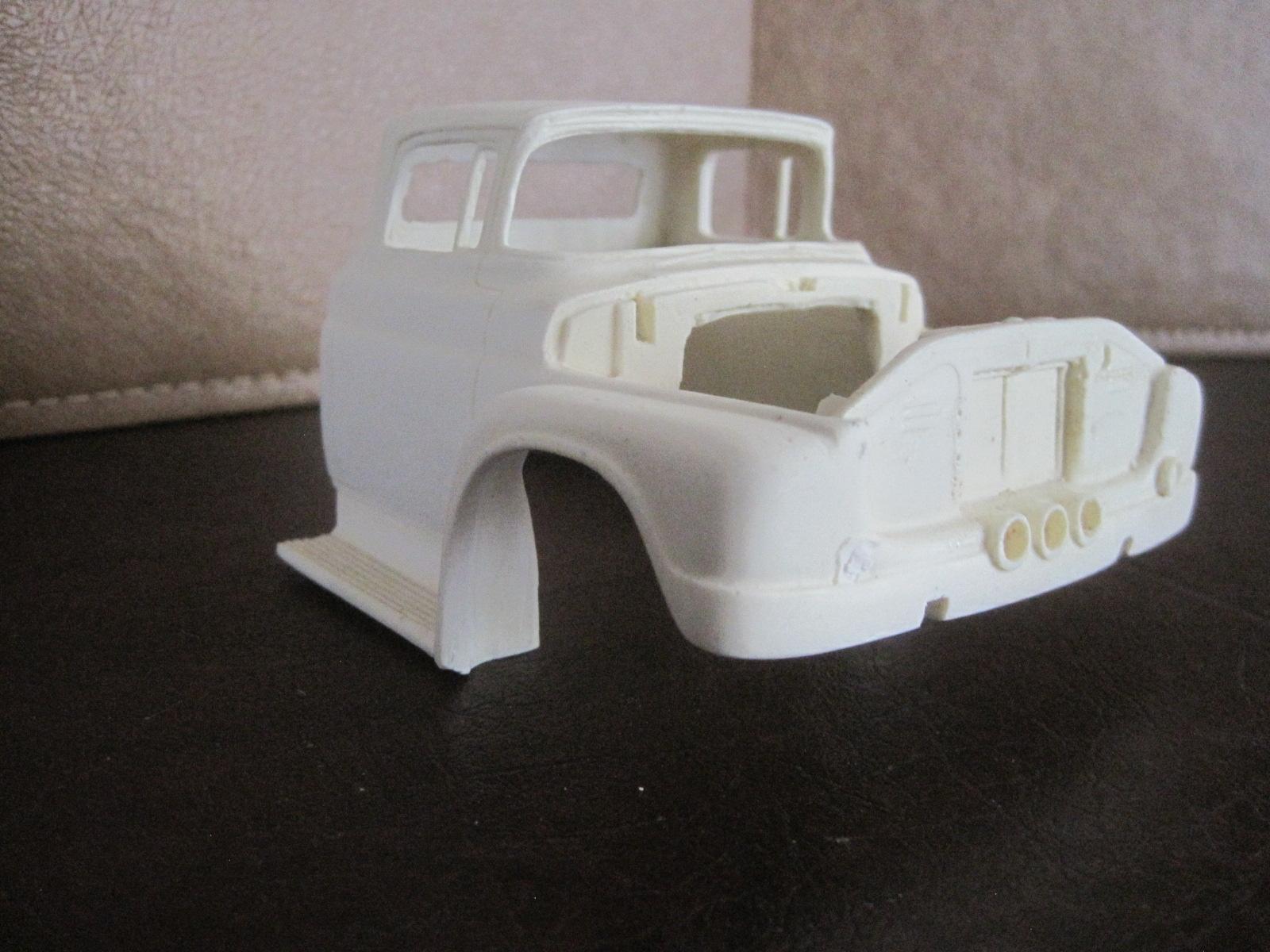

leafsprings Posted December 20, 2020 Author Posted December 20, 2020 (edited) Cab in primer, getting the hood to fit is always tough on these. Edited December 20, 2020 by leafsprings

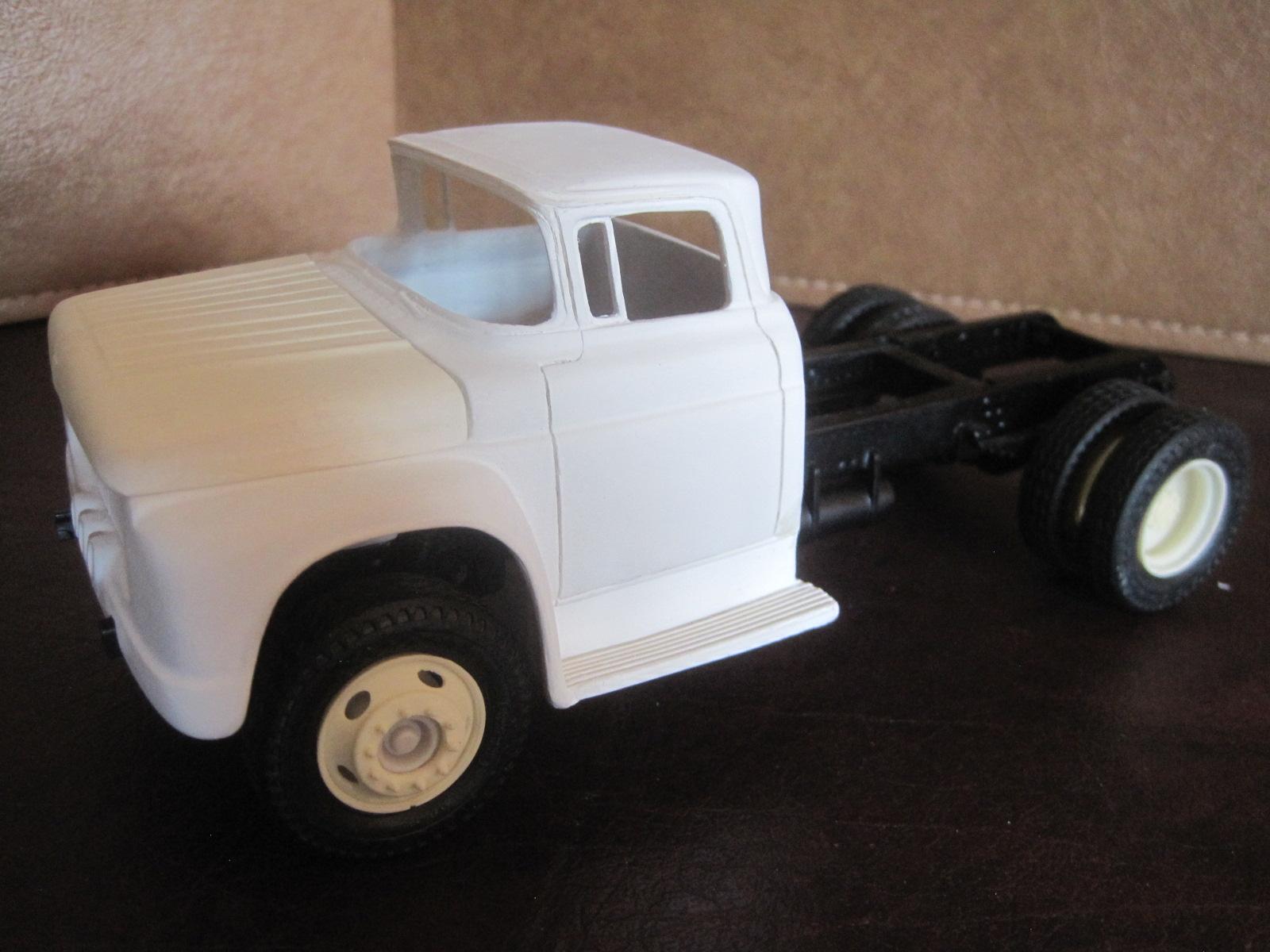

leafsprings Posted May 23, 2021 Author Posted May 23, 2021 Got back to the F 1000 after a break, made progress on hood, cab now closer to paint. 1
