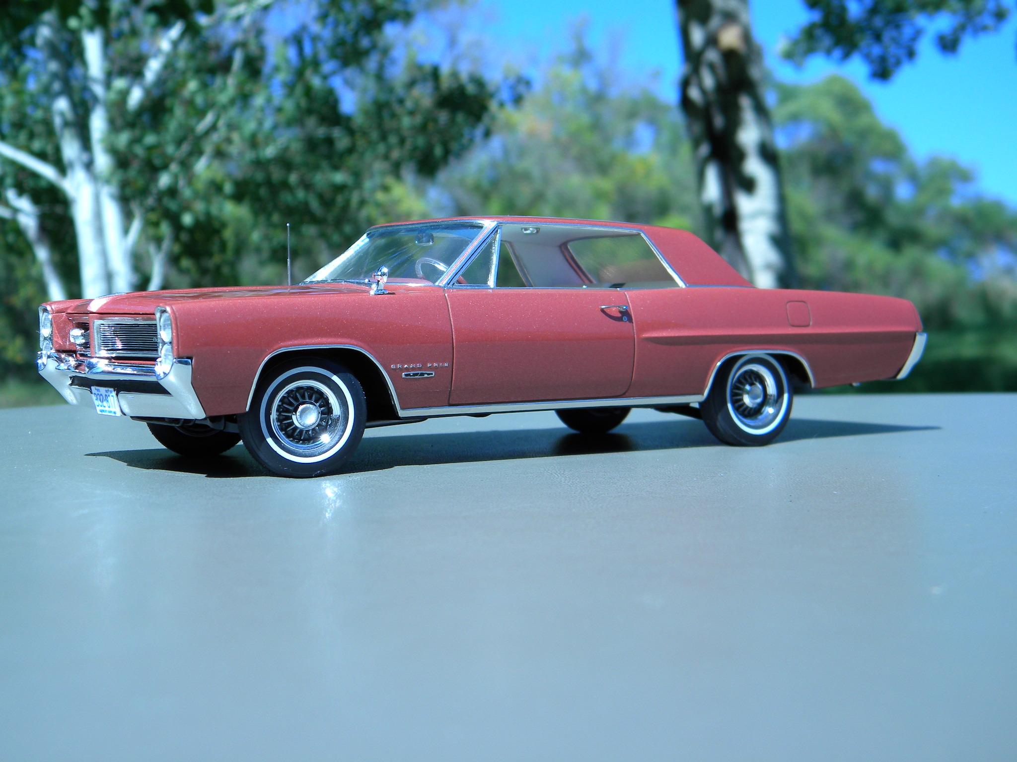

StevenGuthmiller Posted November 2, 2020 Posted November 2, 2020 6 hours ago, Steamboat said: I've been using the bare metal (under paint) method on my latest models with great results. I used a small q-tip and lacquer thinner to gradually remove the paint. I've been using this method for years and believe me, short of PE parts, (which are available for the '58 Edsel by the way) there is no better better way to finish scripts. I use the same basic method as Bill. With paint of any kind, (Molotow included) you have to be reliant on a steady hand. (almost impossibly steady in many cases) With the "foil under paint" technique, not only do you not need to be completely steady, but you will end up with perfect scripts every time once you get the hang of it, regardless of how faint the lettering. My '64 Pontiac Grand Prix had very faint scripts, but as you can see, they turned out beautifully. Steve

jacko Posted May 18, 2021 Posted May 18, 2021 Steve, are the individual letters on the side of your Grand Prix and the trunk of your Mercury covered with one piece of foil or individually? I'd be hard put to cut out the individual letters. Thanks, John
StevenGuthmiller Posted May 18, 2021 Posted May 18, 2021 (edited) 1 hour ago, jacko said: Steve, are the individual letters on the side of your Grand Prix and the trunk of your Mercury covered with one piece of foil or individually? I'd be hard put to cut out the individual letters. Thanks, John The Grand Prix has 3 pieces. One for “GRAND”, one for “PRIX” and one for the badge. The Mercury does have individual pieces around each letter. But remember, you can apply them as one piece and once they’re burnished down well, you can cut around each letter. Steve Edited May 18, 2021 by StevenGuthmiller

crowe-t Posted May 21, 2021 Posted May 21, 2021 On 11/1/2020 at 11:01 PM, StevenGuthmiller said: I've been using this method for years and believe me, short of PE parts, (which are available for the '58 Edsel by the way) there is no better better way to finish scripts. I use the same basic method as Bill. With paint of any kind, (Molotow included) you have to be reliant on a steady hand. (almost impossibly steady in many cases) With the "foil under paint" technique, not only do you not need to be completely steady, but you will end up with perfect scripts every time once you get the hang of it, regardless of how faint the lettering. My '64 Pontiac Grand Prix had very faint scripts, but as you can see, they turned out beautifully. Steve Steve, Your '64 Pontiac Grand Prix looks real in this picture. Beautiful job.
