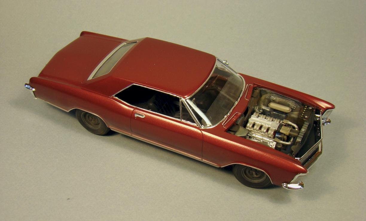

Lunajammer Posted November 22, 2020 Posted November 22, 2020 (edited) As a matter of record I'm compiling this WIP thread of the build I did for this years Cannonball Run CBP to spare viewers from pooling through 22-pages of mixed projects. The theme is movie cars, but prepared as coast to coast trophy dashers. Early in the film, Dalton (Patrick Swazye) buys the car off a lot, then loads up on spare wheels, which we later learn is because they are prone to getting slashed by roughnecks trying to intimidate him. Only it won't be running a "4BRL." But the kit V-8 is being replaced by this Corvette LT5 that I picked up from a vendor at NNL North a few years ago and has been clunking around looking for a project. I've got to hand it to Round 2, they've really cleaned up these old kits. Parting lines are minimal and fit is very good. So after an evening of clean up, I started dry fitting. It all fit so well I just kept going until all the major parts were in place. Chassis was primed with rust colored primer then given a liberal wash of Vallejo black model wash straight from the bottle with a thick brush. I started using the wrong wash product at the back of the chassis, that's why it's pretty dense. Using reference pics from the net, I used Adobe Illustrator to help make detail decals for the dash. Rather than redraw the console radio, vent and air controls, I just cut and pasted photos of the faces into the space. The gauges are vector drawn. Not accurate but I made them bold so when shrunk down you can still make them out a little. Side trim panels are redrawn and vector. Edited November 22, 2020 by Lunajammer

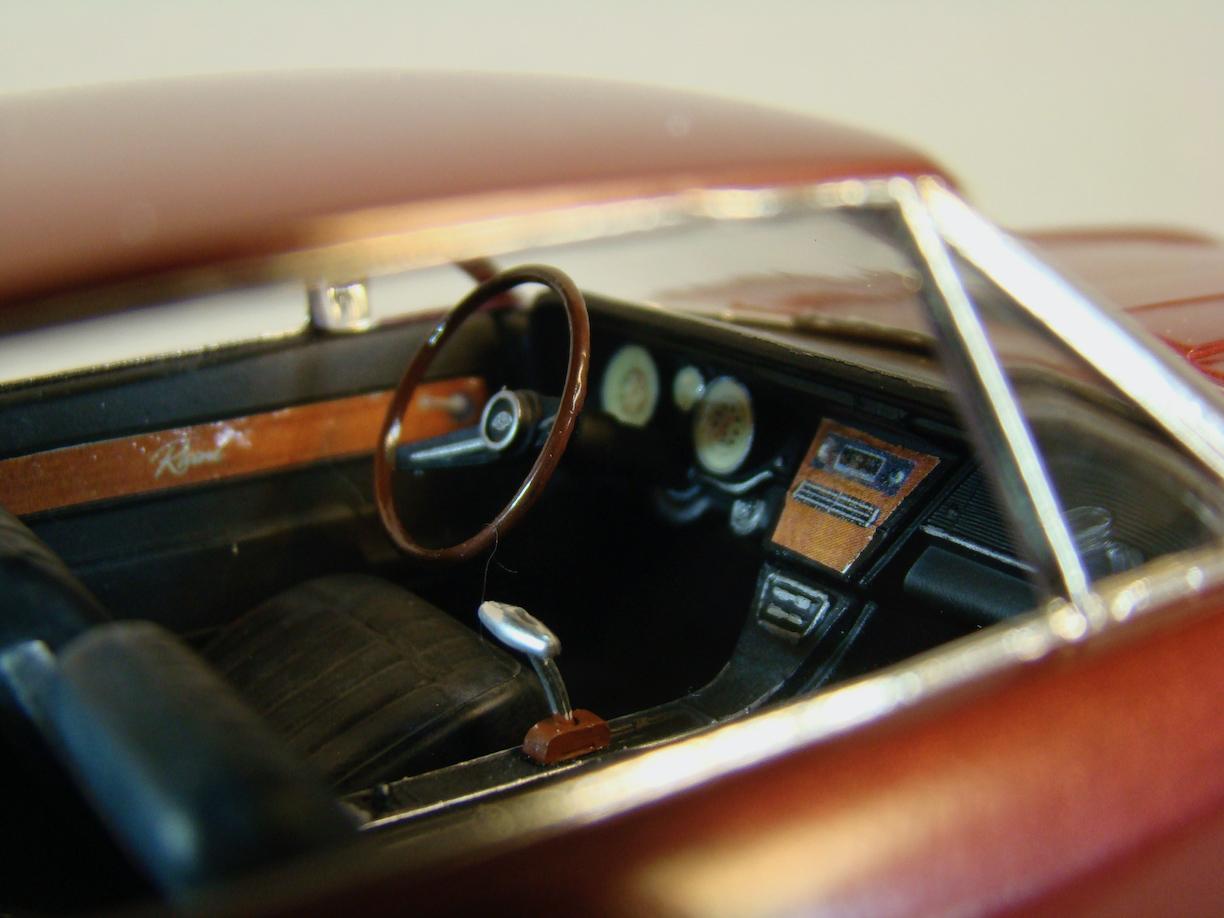

Lunajammer Posted November 22, 2020 Author Posted November 22, 2020 Body painted. I'd like to see a tick more brown but despite the lighting here, this Rustoleum color is pretty close. I added the dent in the front fender as seen in the screenshot below. This is the paint I used. Slow to dry, but in a can, this was the closest I could find. The spray can color looks more accurate than the screenshots imply. Here the interior is mostly done. The movie clearly shows a filthy dusty interior, so I grunged it up with pastels. Printing wood paneling on white decal paper is troublesome as the printing always chips at the edges when trimming. The way to go is decal printed on clear over a painted light surface. Clear epoxy was added to the gauge faces. The kit shifter is a chrome blob so I'll add something later.

Lunajammer Posted November 22, 2020 Author Posted November 22, 2020 (edited) This was probably the most relaxing model I've built in years. Fitting the LT5 into it was an easy upgrade that any novice could enjoy. At the back of the tranny, the chassis needs to be ground away from a crossmember to get the transmission to settle down, but it's a scar that isn't visible. Otherwise, the engine fits itself, sits level and doesn't interfere with the hood on the top side. There's a little fuss with the plumbing at the front but it's nothing a couple simple cuts can't fix. Steel rims were home cast resin and I found suitable tires from my parts box. The selection of beautifully pad printed white wall tires that come with the kit were too nice for this project. Some light wash in select areas and a little pastel dusting on the body, chassis and engine brings it all to life. Edited 19 hours ago by Lunajammer Edited November 22, 2020 by Lunajammer 1
