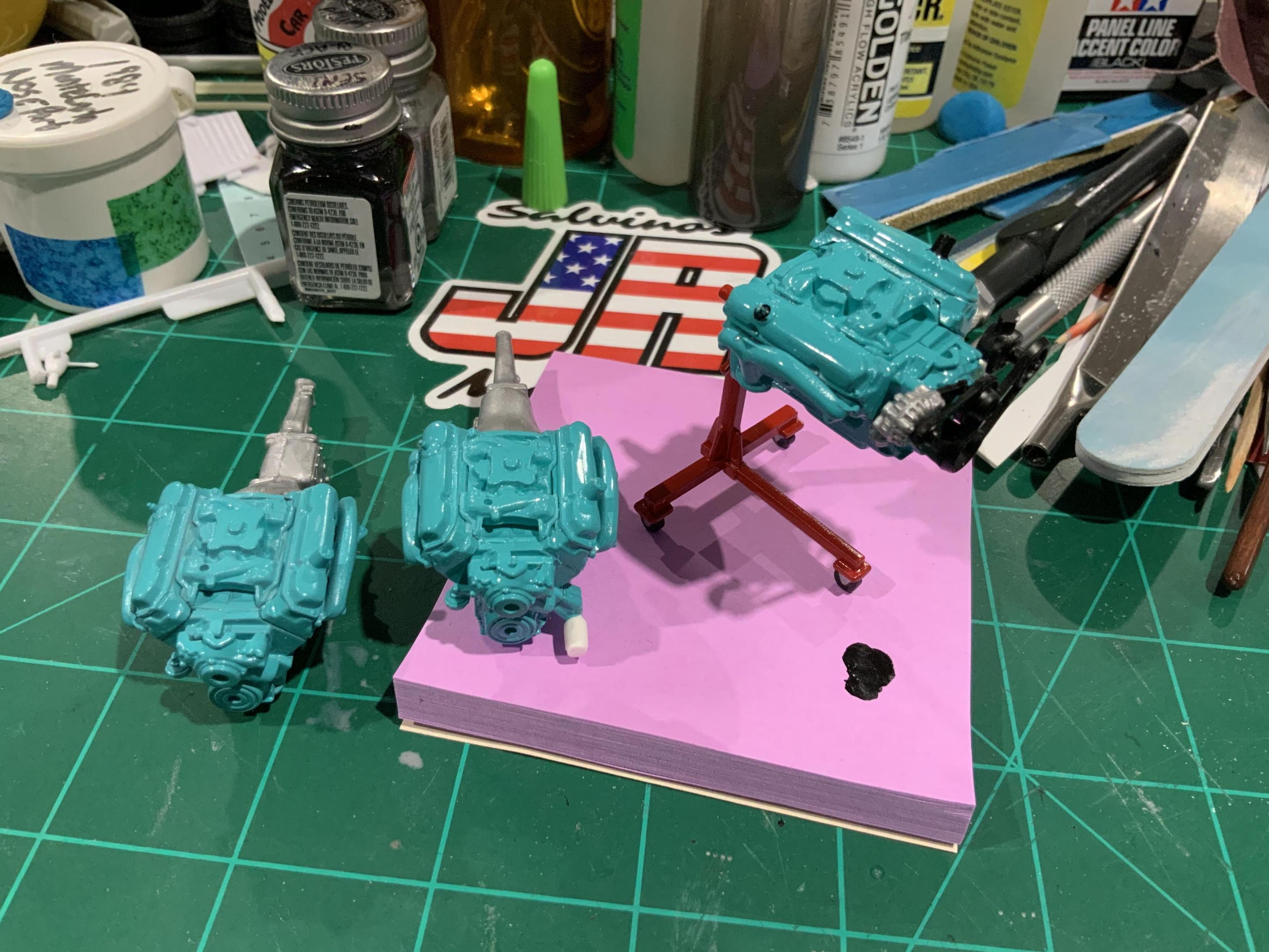

Superbird McMonte Posted November 28, 2020 Posted November 28, 2020 (edited) I saw someone post pictures of a 1969 Charger with then engine painted this color. Regrettably, I didn’t write down his name. But it was the best representation of MOPAR engine blue I had seen yet. It’s Tamiya TS-41 Now I have to build a couple more Chargers!? Edited November 30, 2020 by Superbird McMonte

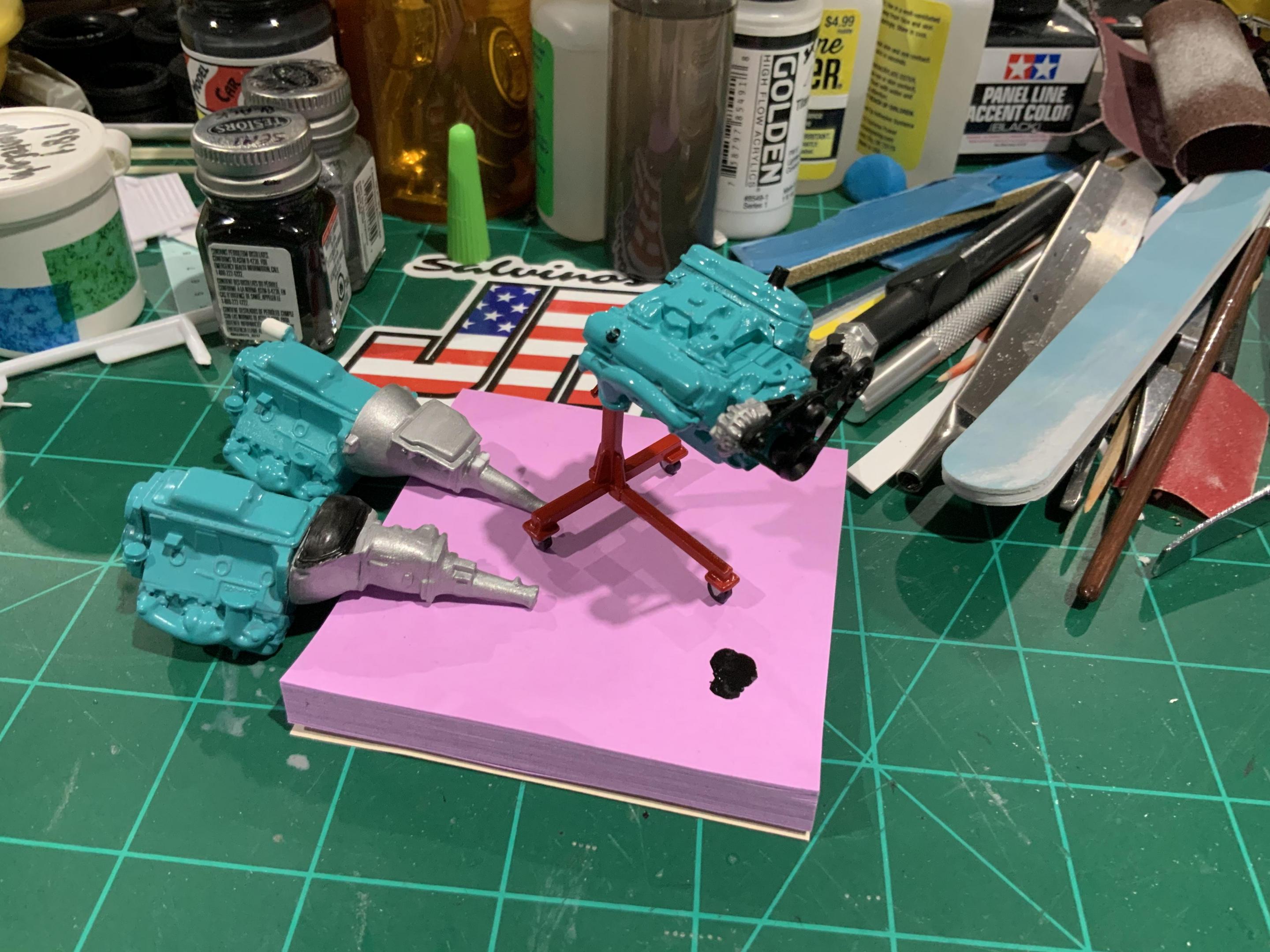

moparfarmer Posted November 28, 2020 Posted November 28, 2020 55 minutes ago, Superbird McMonte said: I saw someone post pictures of a 1969 Charger with then engine painted this color. Regrettably, I didn’t write down his name. But it was the best representation of MOPAR engine blue I had seen yet. It’s Tamiya TS-41 Now I have to build a couple more Chargers!? If you want correct engine paint go to a Mopar dealer and order a bomb of it..One bomb will last you a lidetime..BTW the bottom of the bellhousing is the same color as the rest..
1972coronet Posted November 28, 2020 Posted November 28, 2020 Looks like a close match to Chrysler Engine Turquoise (last used in the 1968 model year ) . There's at least two different shades of Chrysler Engine Blue ( 1971 & earlier ; 1972 & later , with late-production 1971 340's being painted the 1972 & up shade ) . Cool discovery !
Superbird McMonte Posted November 28, 2020 Author Posted November 28, 2020 5 hours ago, moparfarmer said: BTW the bottom of the bellhousing is the same color as the rest.. What was I thinking? GM automatic maybe. That’s what happens when late night modeling I guess! Thanks for the heads up!
NOBLNG Posted November 28, 2020 Posted November 28, 2020 7 hours ago, Superbird McMonte said: I saw someone post pictures of a 1969 Charger with then engine painted this color. Regrettably, I didn’t write down his name. But it was the best representation of MOPAR engine blue I had seen yet. It’s Tamiya TS-41 Now I have to build a couple more Chargers!? TS-41 is what I used on mine with just a touch of white added. The spray bomb from Mopar sounds like a deal if you do a lot of Mopars.
RichCostello Posted November 29, 2020 Posted November 29, 2020 I use a Krylon color called Bahama Sea for Chrysler engine blue. Looks dead on to me, and it's cheap.
dwc43 Posted November 29, 2020 Posted November 29, 2020 On 11/28/2020 at 1:18 AM, moparfarmer said: .BTW the bottom of the bellhousing is the same color as the rest.. Not on a 4 spd car. The inspection cover is black just like the one in his pic. And the trans pan on an auto is steel, different color from the aluminum case.
dwc43 Posted November 29, 2020 Posted November 29, 2020 23 hours ago, Superbird McMonte said: What was I thinking? GM automatic maybe. That’s what happens when late night modeling I guess! Thanks for the heads up! Not on a 4 spd car. The inspection cover is black just like the one in the pic. And the trans pan on an auto is steel, different color from the aluminum case.
