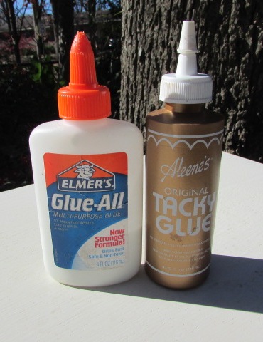

* White glue can be used, but yellow glue is better providing more strength since it is designed for use with wood and it sets up and dries faster than the white glue. Of the two white glues shown below, the tack glue sets up faster and is the stronger white glue.

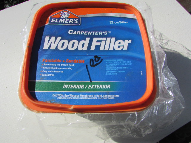

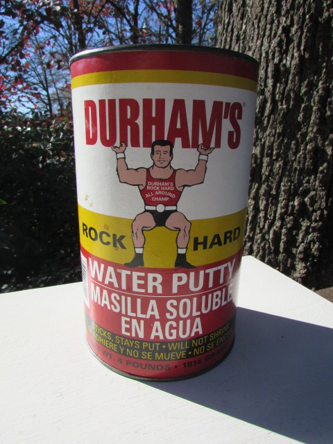

** Note that the Durham's Rock Hard Water Putty mix will set up and cure hard if excess is stored in a covered container whereas the Elmer's Wood Filler mixture will not. Excess wood filler mix can be reused if stored in a closed container. Excess Durham's will be hard and non-reusable.

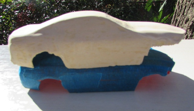

After having successfully removed the cast from the mold, it is time to begin the final operations to complete the cast. Clean and wash off the mold as needed and return the cast to the mold.

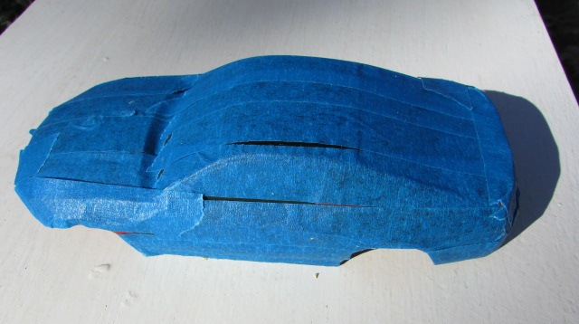

Covering the mold with a protective tape such as masking tape might be a good idea, too. Tutorial-Guide-to-Paper-Models-004.jpg
Positioning the cast again on the mold serves as a solid underlying base for the cast.

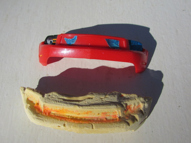

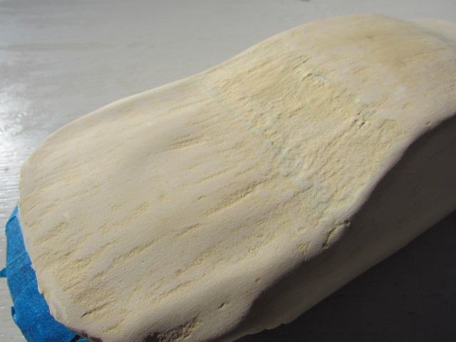

Additional layers of casting material are applied , sanded and formed to obtain a final smooth surface to the cast. Having the cast on the mold lends good support for filling, smoothing, inspecting, sanding and ease of handling when performing these various tasks. Corrections to imperfections in and on the surface and problems with body areas are also corrected here as well.
See how the surface needs to be filled and sanded smooth:
[url=https://postimages.org/]Tutorial-Guide-to-Paper-Models-019.jpg[/url]
[url=https://postimages.org/]Tutorial-Guide-to-Paper-Models-020.jpg[/url]

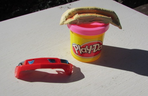

Another aspect that needs special consideration is replacing a part or parts that have to be removed from the mold to expedite the initial application of paper to the mold. These parts cannot be formed from paper and need to be made separately. In Case 3- 2012 Ford Mustang Boss, I had to remove and duplicate the front grille of the model mold. I made an impression of the actual piece in Play Dough and filled the impression with Durham's Rock Hard Water Putty. When the cast is completely finished, this grille section will be attached to it.
