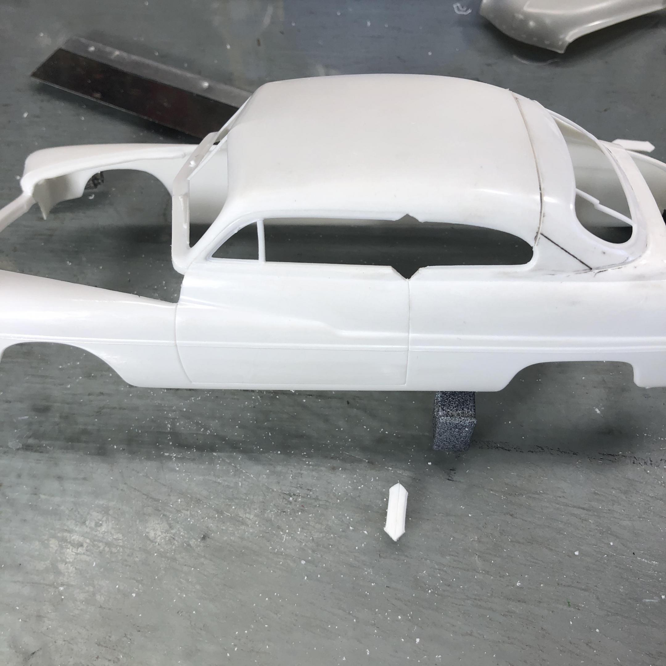

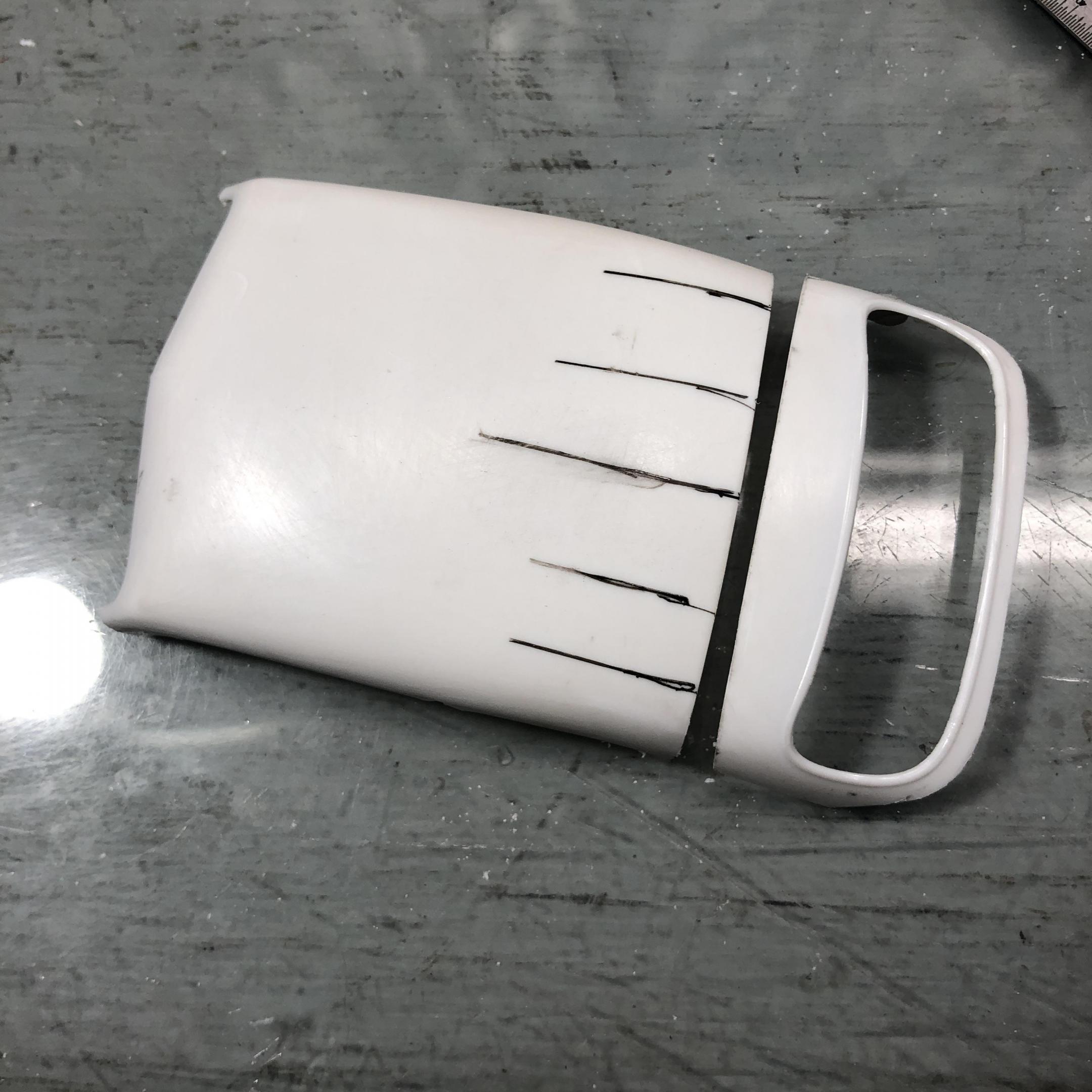

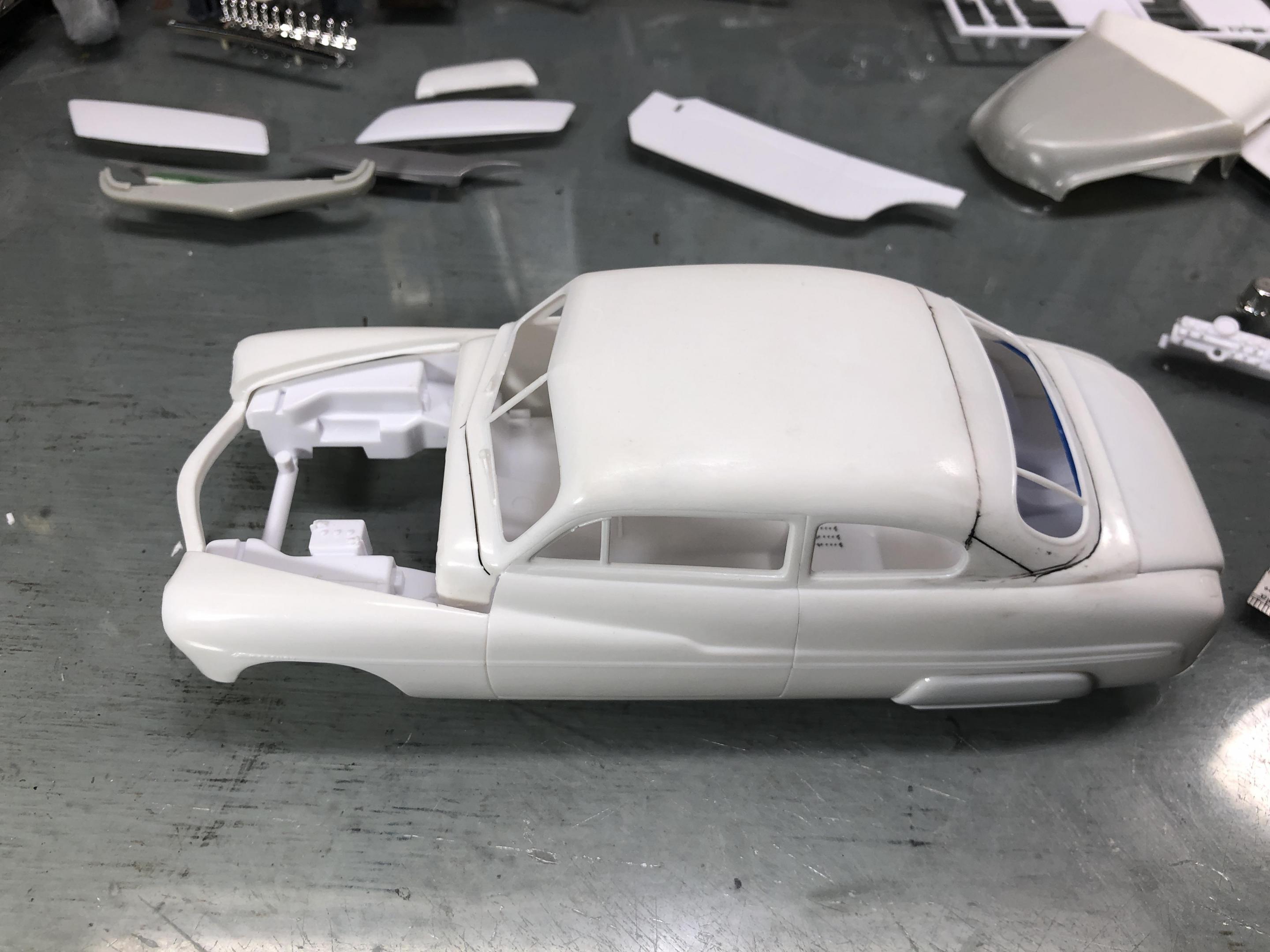

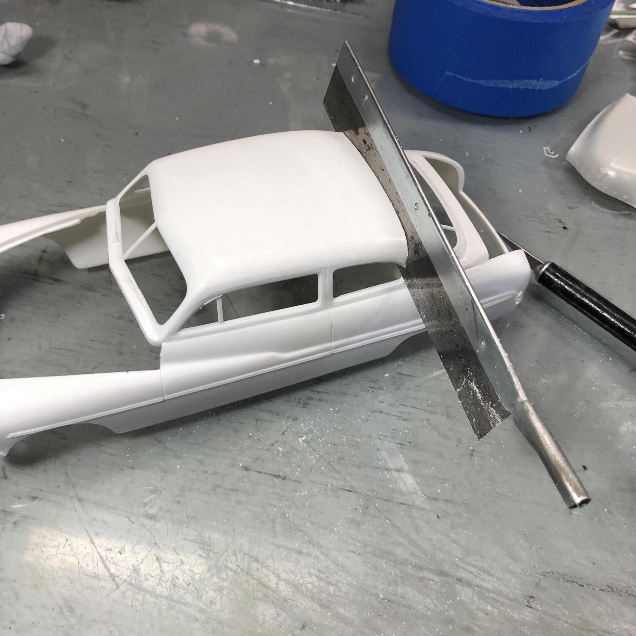

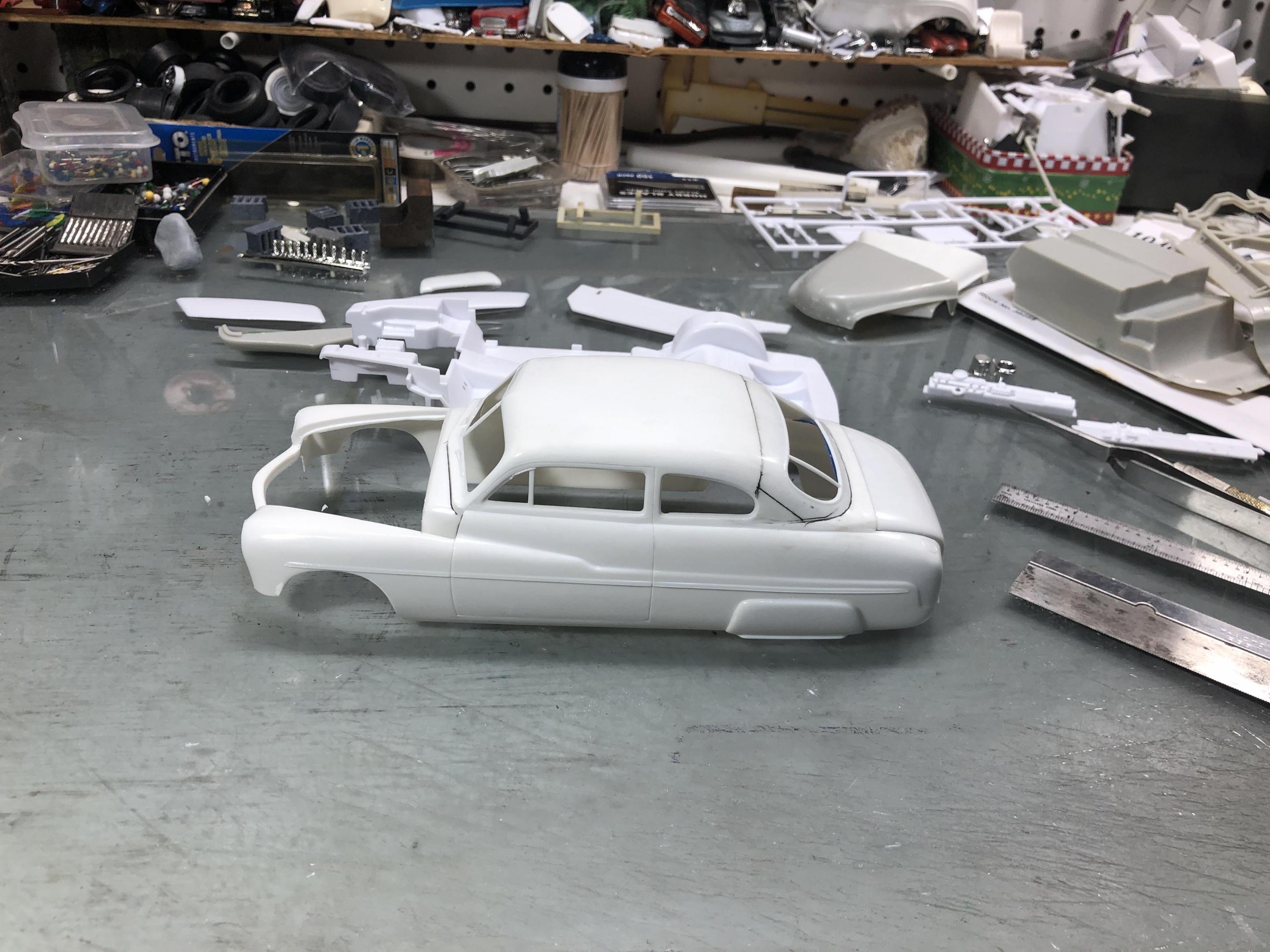

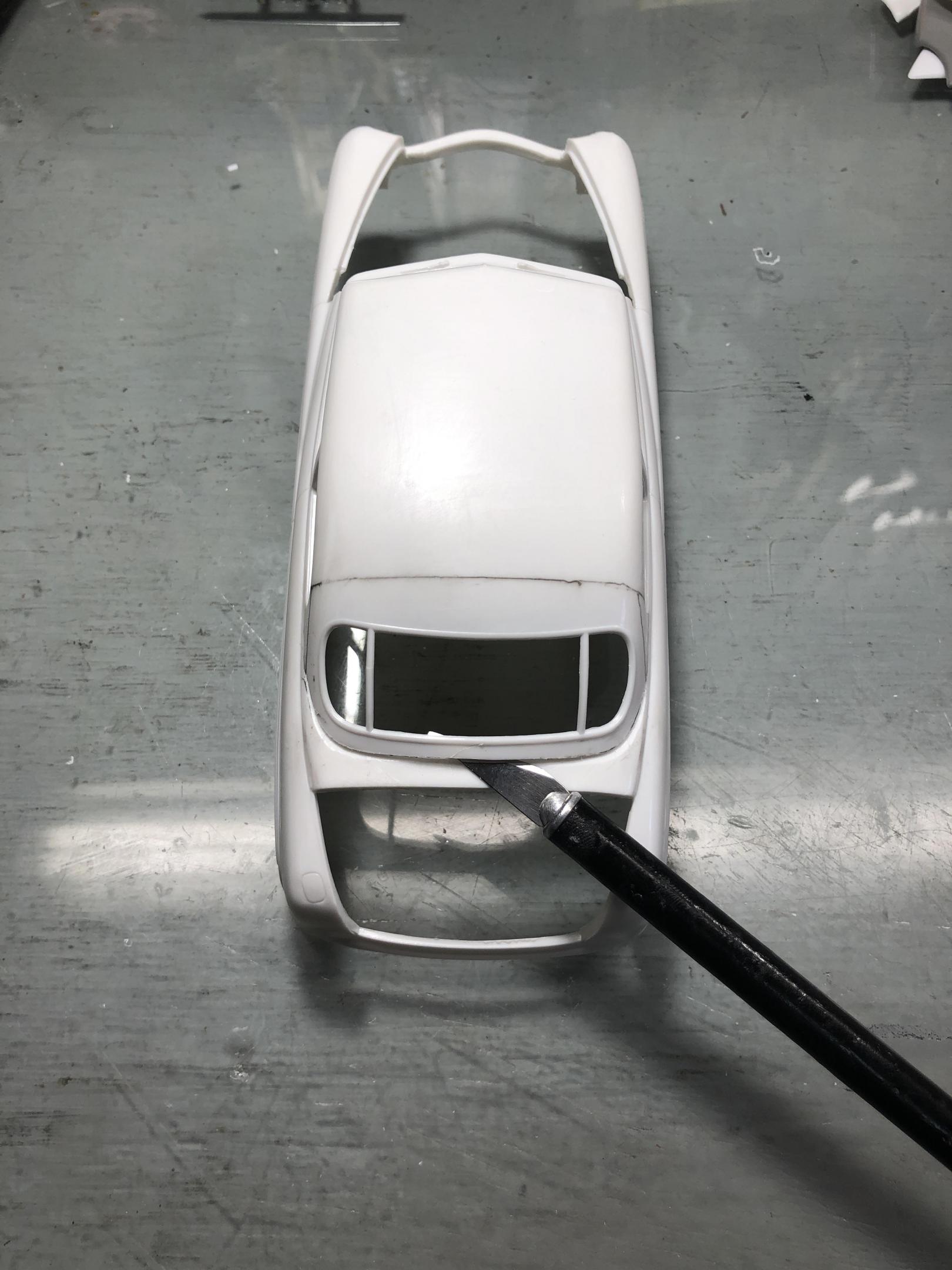

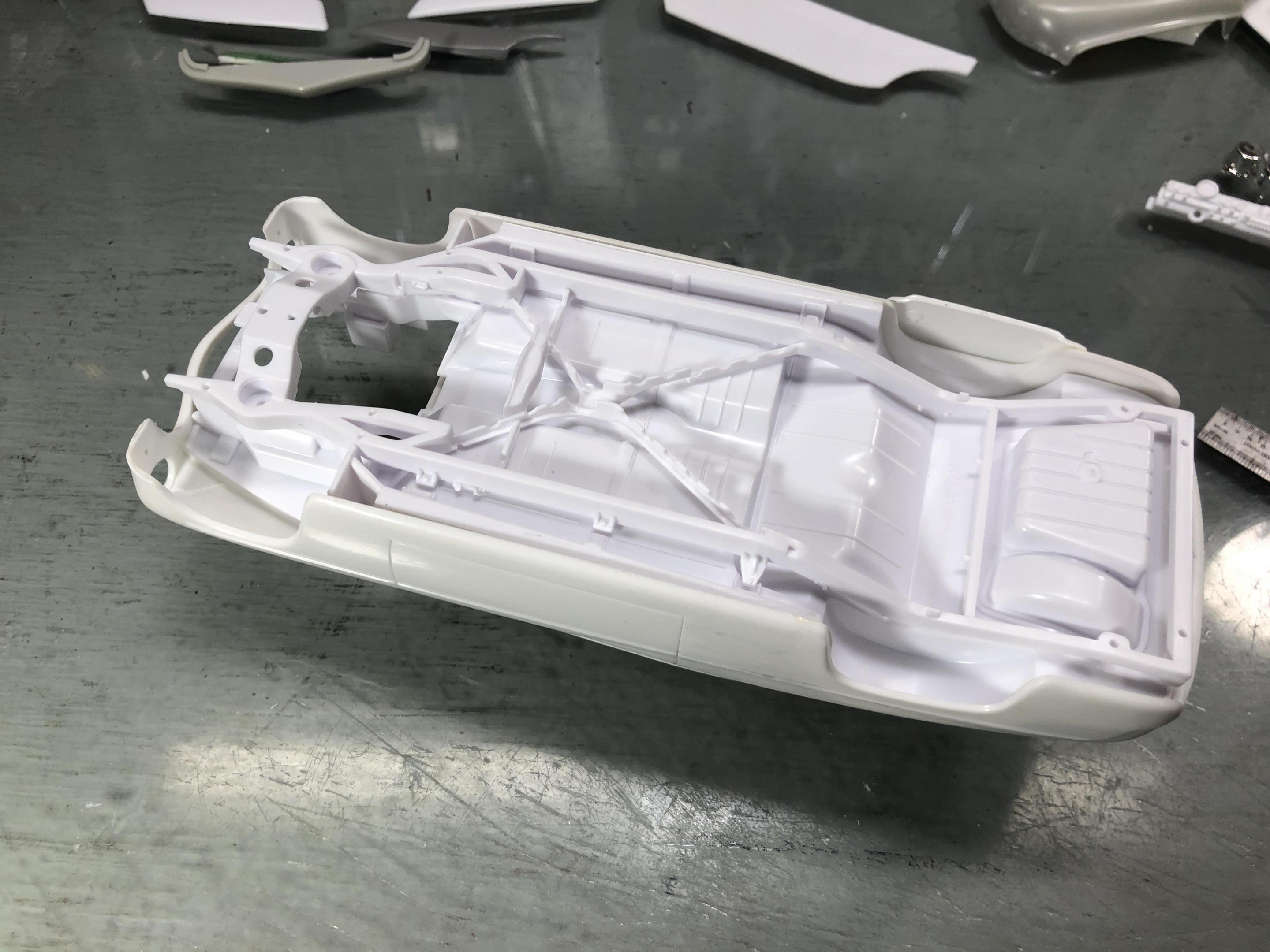

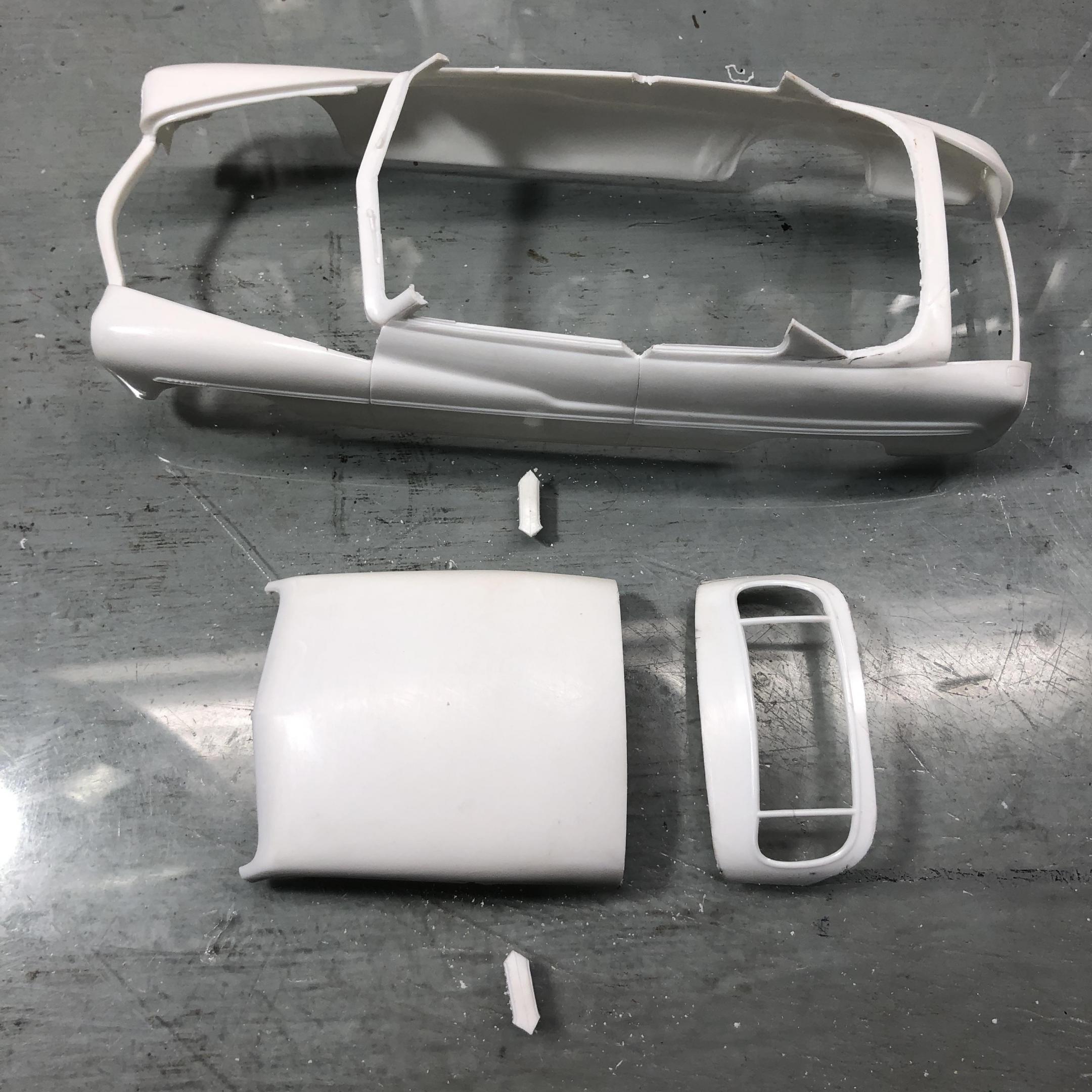

Rocking Rodney Rat Posted December 6, 2020 Author Posted December 6, 2020 Well, I revved up the Sawzall yesterday and made real mess!! LOL. This is the easy part, cutting the roof off... First cut along the crease between the rear window and the sail panel.... then cut across the top of the roof..... cut out the B pillars and put them aside for now.... Free the roof from the body.... With the roof being dropped down, the difference in the roof curve will need to be addressed.... The plan is to make a few relief cuts across the top of the roof, carefully splay the roof open and fill in the slices with some long triangle slivers of styrene to flatten the curve a bit....that's as far as I've gotten so far. I'll see if I can make this all work. You'll notice a cut the firewall off, I'll show you why in a later installment. thanks for looking, more later.... -RRR
