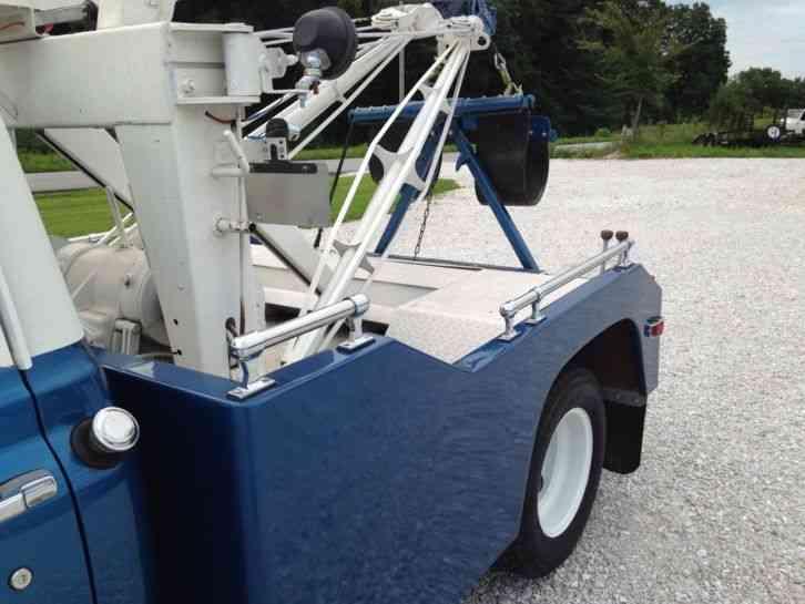

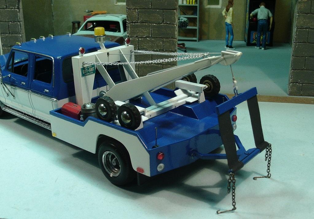

Andrew D the Jolly Roger Posted December 1, 2020 Posted December 1, 2020 Been totally scratch building the wrecker end of a GMC-based tow truck, and have two questions. 1) What guage chain should I look for? I'm considering either 13 or 15 links per inch, but hard to be sure without seeing it in person (trouble with online purchase) 2) Are there charts/illustrations/photos which show where the chain should connect? Most photos do NOT show it coming from the boom arms, until I see photo #1 here. Photo 2 shows it hooked on the body below it and not connected to the booms at all. Tough to scratch build what one cannot see.
mchook Posted December 1, 2020 Posted December 1, 2020 As for the chains, I'm with you, if you can't hold it in your hand it's hard to tell if it looks right. The chains hook to the bottom of the tow bar. There is a hook welded on each side of the bar for the chain link to sit into. The hooks on the top bar of the tow sling is for the slack of the chain so they don't drag the ground. Picture 2 of yours shows Luke taking the chains out of a storage hole in the back of the body. If I'm not explaining this right check out this pic. The tow bar is folded up but you can see what I mean. Here is a couple of mine too but I let the chains drag on mine. I hope this helps. Mark

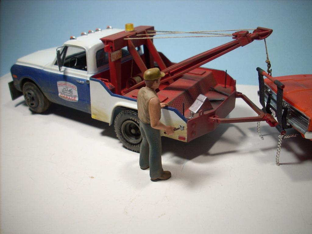

Andrew D the Jolly Roger Posted December 1, 2020 Author Posted December 1, 2020 Nice work on those Mark! Yes, the first two pics show something similar to what I'm looking for, namely the one coming off the very center. Then when I go through the dozens of stills I've taken from the show in my research for this, I often find contradictory info...which is par for the course when one is dealing with Hollywood props. Here are a few more showing what I though I was looking for....there is a single chain coming off the middle, with one large hook stowed along the back to the left. And then, with what you just explained, I re-checked and found two chains coming off the bottom corners of the sling, on the last photo here.....not like the other pics. Grr...
1930fordpickup Posted December 1, 2020 Posted December 1, 2020 (edited) Back in 82 and 83 I spent some time riding with my brother on a wrecker. Too long ago to tell you chain size. The chain in the center is there to keep the sling from swinging around when not in use. Every driver did this differently. That big hook ( that you have circled) is a J hook you use to hook up the car. Does the same job to hook the sling as a smaller chain. You use what is on the back if the truck most of the time. Around here you would leave them on the back of the truck between tows, unless you went into a sketchy place. Edited December 1, 2020 by 1930fordpickup
