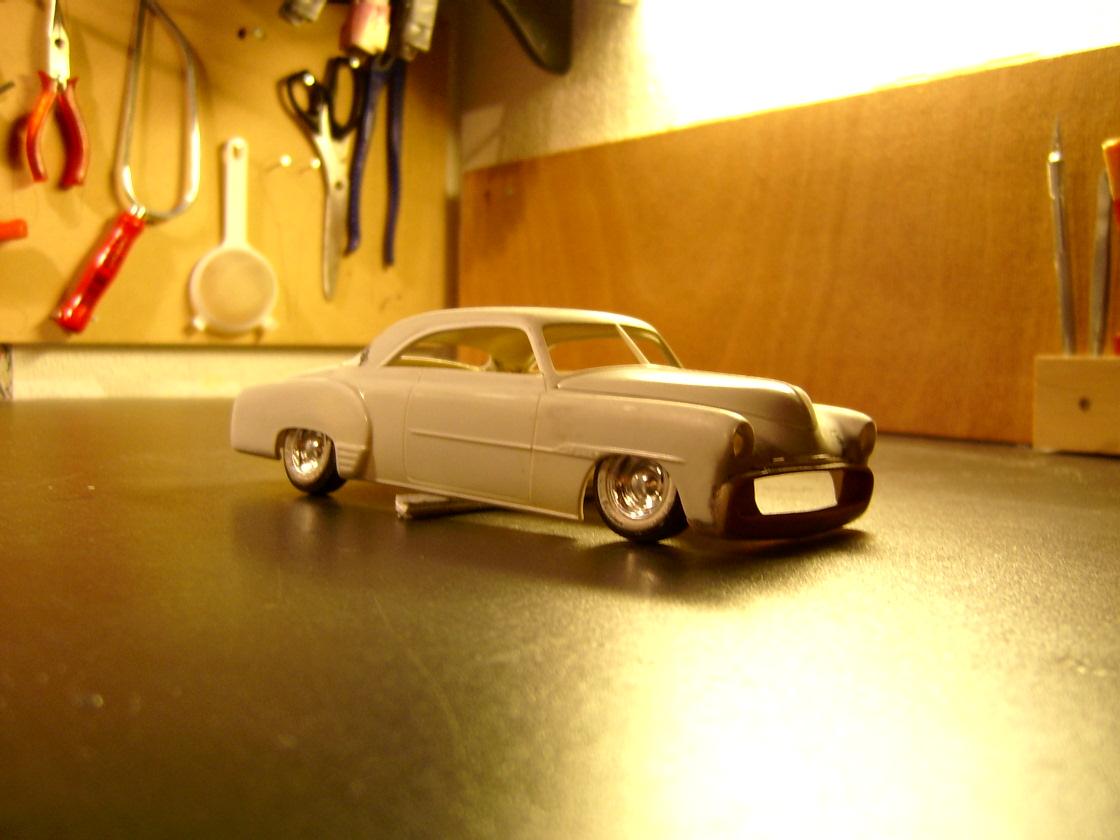

I started this 51´Chevy (can somebody explain my german brain the differernce between the old AMT Bel Air Deluxe and Fleetline Kits?) in 2003 and hope to get it finished in 2020. They elder pics are from my old house and my old workbench. I found out things changed a little bit since 2003. More new tools, paints and of course more internet to find some references.

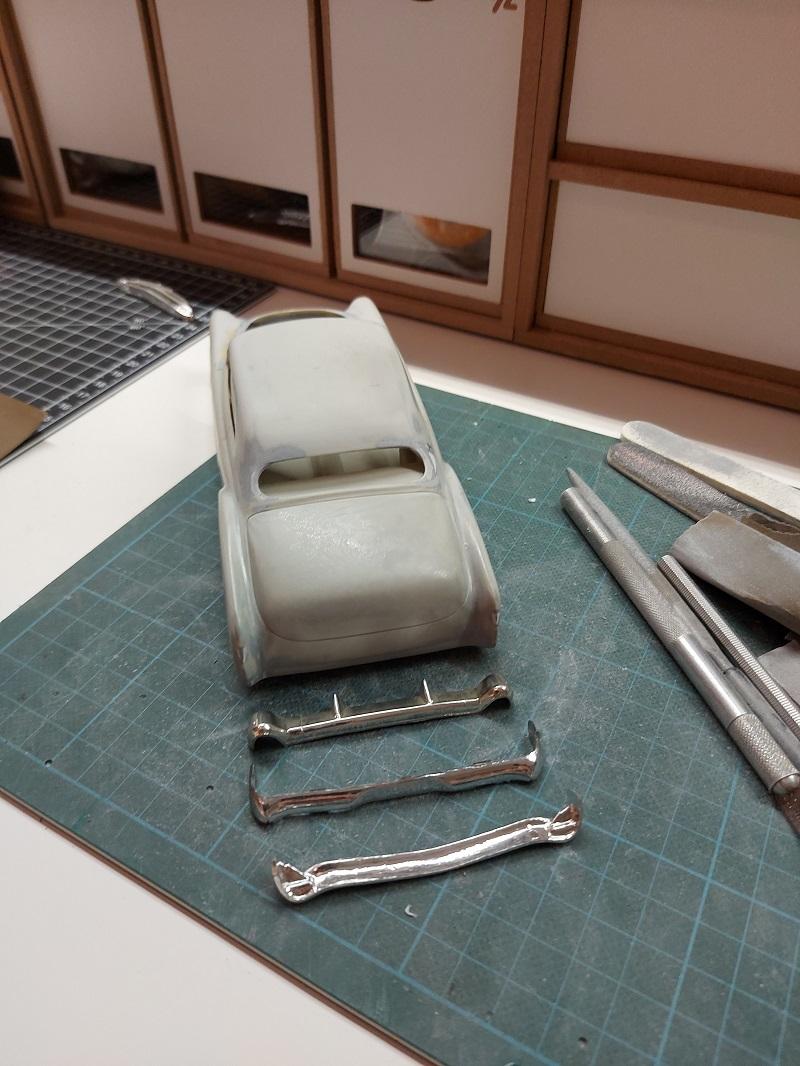

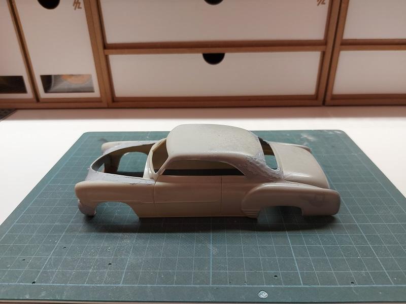

Thank you Tom. Finally my new workbench is ready and i love it. Time to build....I had to round up the rear window a bit. I cut off some wheel rims and put them on. I also have to choose a rear bumper.
Edited by Beamerman
I like your body modifications. As for the rear bumper, who says you have to have a rear bumper?  You already have a front "roll pan" and it wasn't uncommon to have the same treatment for the rear also. I would suggest having a recessed mounting area for the rear license plate in the rear roll pan. The way you chopped the roof and reshaped the rear window looks great.

You´re right David i first plan without a bumper but then i decided to bring on a chrome bumper to get some contrast to the paint. Thank you!

Thanks for looking guys. I added a rear end for the bumper. Had to add two stripes of styrene to the rear fenders to get a better look.

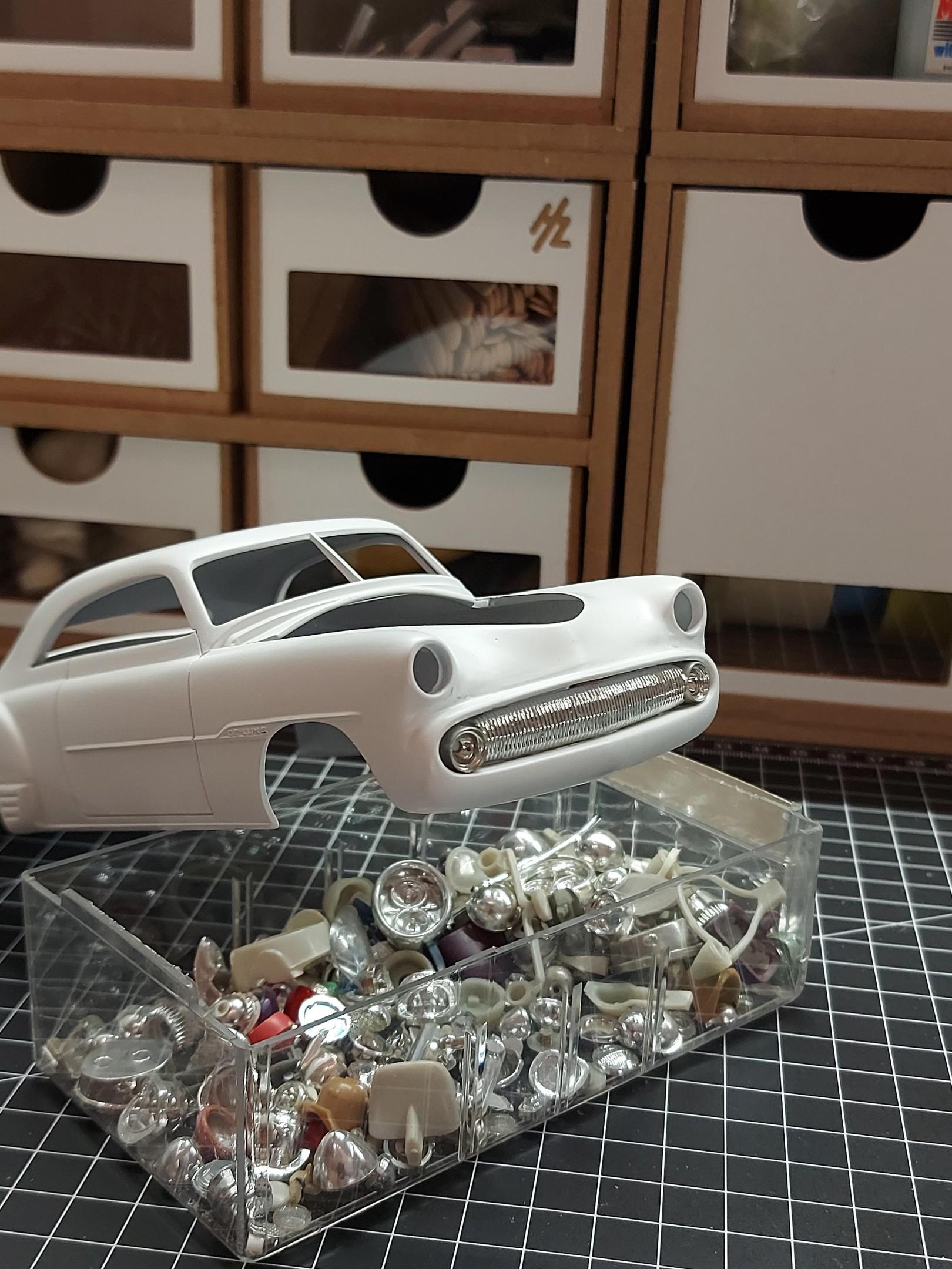

I choose Engine and some suspension parts from a AMT 1957 Bel Air. Frontgrill and rearbumper from my partsbox. Test fittet the Wheels to check the models heigh.

Glad you guys like it. I thought about removing the centerpost but now its allready painted now ?...Pics will come soon...
