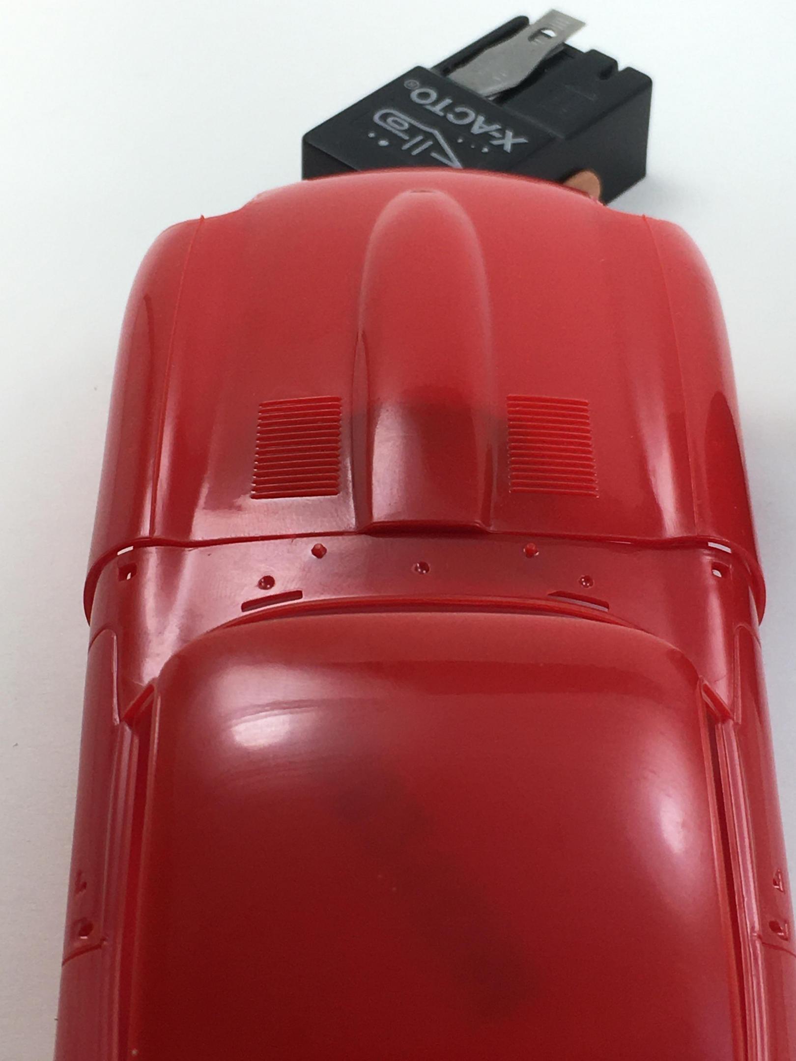

dbostream Posted August 24, 2021 Posted August 24, 2021 (edited) Curiosity got the better of me so I ordered one and the body is good no quality issues that were reported earlier. But I too have the problem where the hood is wider than the body doesn't look like an easy problem to fix. If I have to heat it up I probably create new problems. Edited August 24, 2021 by dbostream

keyser Posted August 24, 2021 Posted August 24, 2021 5 hours ago, DiscoRover007 said: I got the roadster version. Its a nice kit, hood fit is bad. But If you can get some baby magnets in there I think it would fix it. Just FYI for everyone that buys one. Despite your instinct to glue and putty the bumpers to the body and hood, they are actually separate pieces on the real car. I dug through many google photos to confirm this. They are separate pieces with fine panel lines. Heat water, hot not boiling. Put on counter. Drop hood in to warm up. Bend as needed gently. Have body nearby to check fit. Repeat until fits, then run under cold water to set molecules again. Works on anything. Ipms has mini tutorials if you google it 2

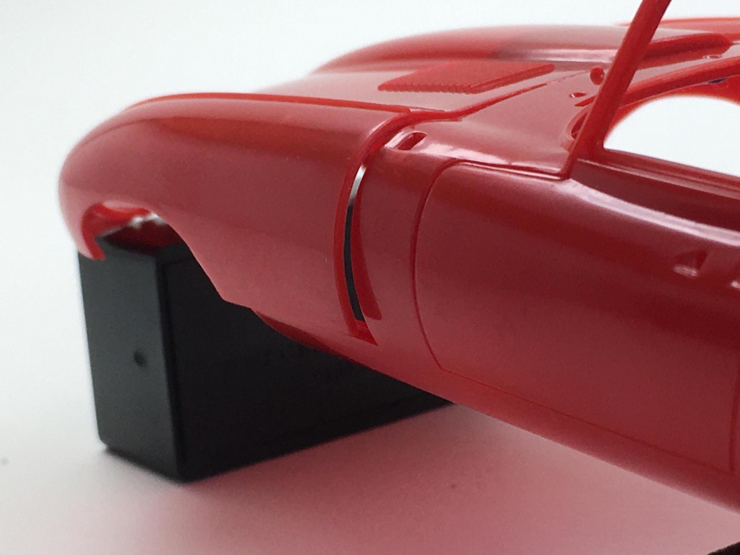

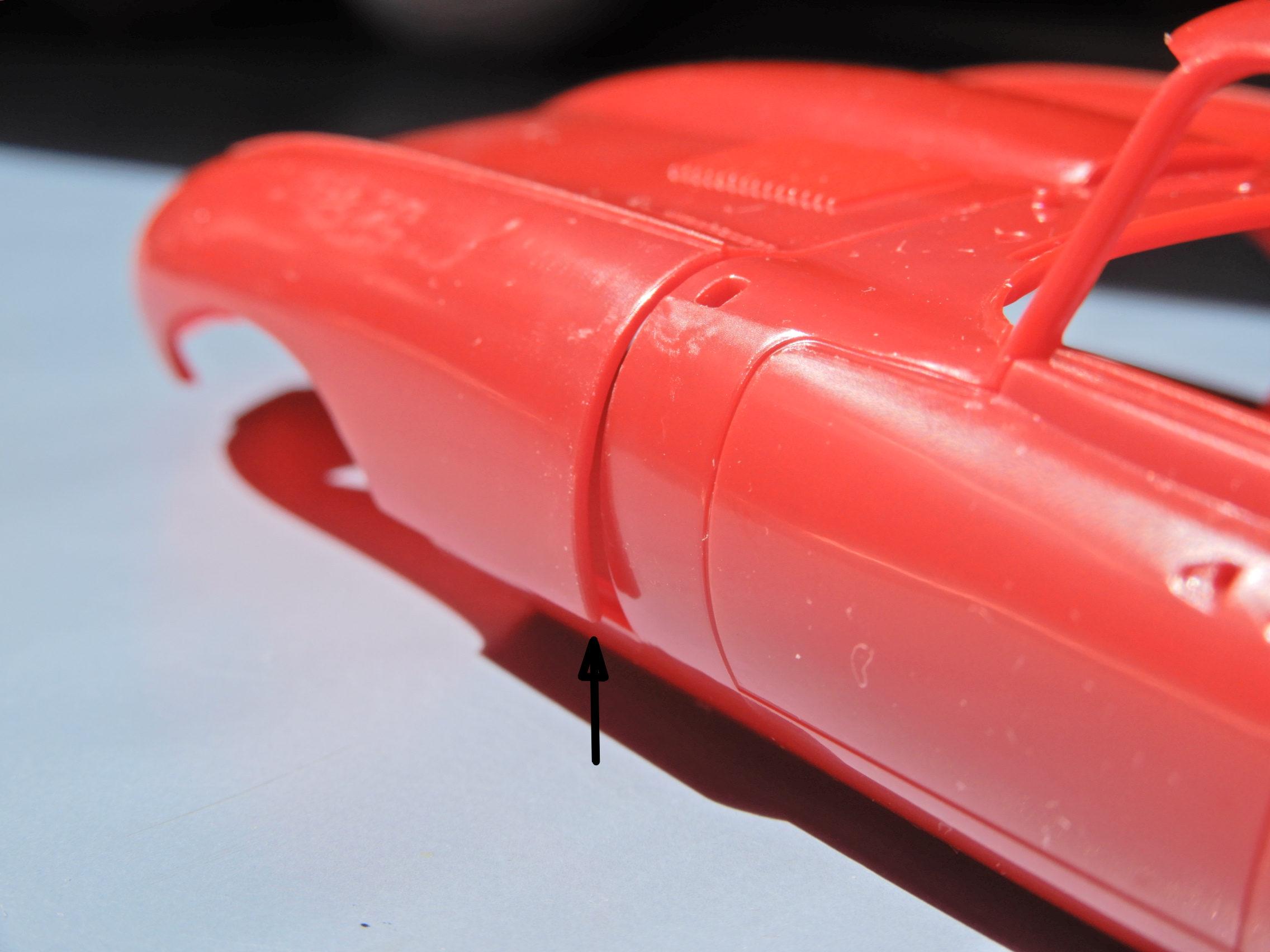

peteski Posted September 9, 2021 Posted September 9, 2021 Just picked up my kit (in U.S.-style box) from Michael's. Also has the hood problem, exactly as shown in Tim's photos. As I see it the problem is that when they package the body and hood, then stretch the hood and slide it over the cowl. At that point the plastic is fresh out of the mold, and when it sits in that stretched state for a long time (being shipped and in the store), the hood is stretched out permanently. This problem could have been easily prevented by either leaving the body and hood loose in a larger plastic bag, or pack the hood and body separately. Such a small change of packaging would have prevented many complaints, and having sent out replacement hoods. What were they thinking . . .

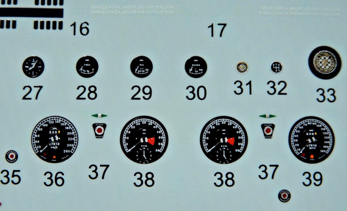

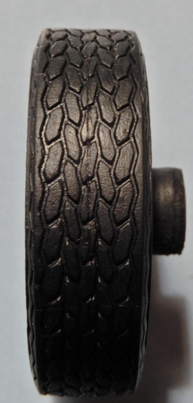

peteski Posted September 12, 2021 Posted September 12, 2021 (edited) Here is mine. The decals however are superb! I guess as-expected from Cartograf. All the colors are solid, and in perfect alignment. Even the very fine gauge markigns are readable However there is a problem. I thought the name of this car was JAGUAR, not JACUAR!! Hopefully someone will be producing aftermarket photoetched scripts with correct spelling. There is a bit of a disappointment for me. If Revell tooled up new tires specifically for this model, why did they choose such a weird tread pattern?! It looks like nothing I've seen on 1:1 tires. Looks like something that might possible be used on truck or SUV tires, not on a sports or passenger car. Weird. The tires also seem to have rather low-profile sidewalls (and again weird pattern). I haven't measured them to see what are their 1:1 measurements. Edited September 12, 2021 by peteski

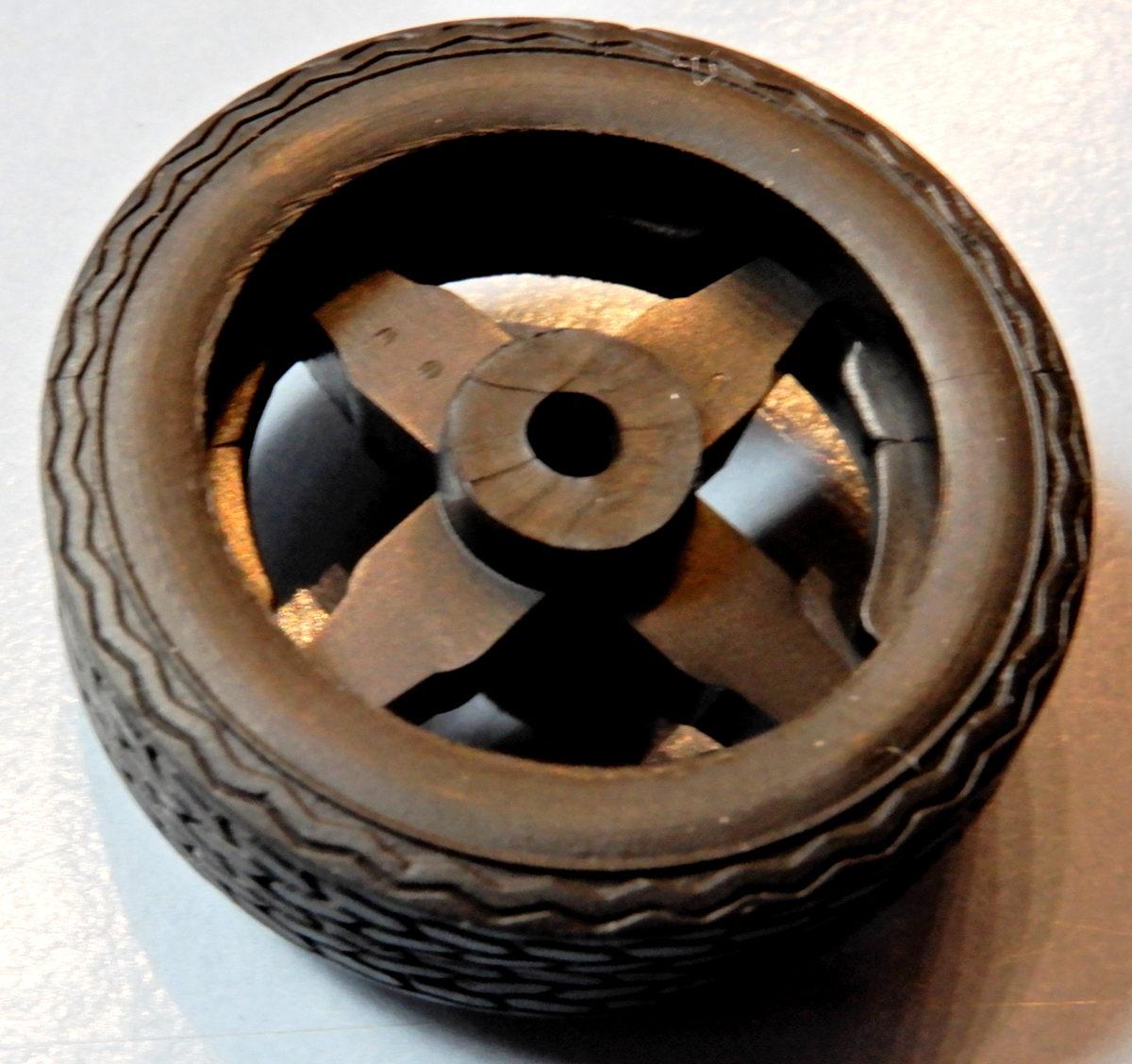

keyser Posted September 12, 2021 Posted September 12, 2021 XWX Michelin. Best tire for high performance cars in late 60’s. Not fabulous but adequate.
peteski Posted September 12, 2021 Posted September 12, 2021 (edited) Good to have knowledgeable people on the forum - thanks! Ok, there is rough resemblance to the Michelin XWX tread, but the Revell version is devoid of a lot of the smaller details, and the shapes are more like smooth lozenges than the slightly S-shaped angular treads on the 1:1 tire. The edge of the tread is also wrong. But I guess it is close enough. Edited September 12, 2021 by peteski
peteski Posted September 12, 2021 Posted September 12, 2021 2 hours ago, Rodent said: Seems to match the 1:1 emblems I am seeing online for all of the E-Types. Looks more like a "G" on the emblem than the decal though. I guess at 1:24 scale it is close enough.
Mike Chernecki Posted September 14, 2021 Posted September 14, 2021 On 9/8/2021 at 10:17 AM, TimKustom said: Yes, I know of one in development. Other than wheels and obvious items, what would be on everyone's wishlist? Hi Tim, Items I would like to see on a detail set in addition to the obvious include printed gauges and dash details, seat belt hardware, chassis/engine brackets and linkages, fitted luggage hardware (latches, handles, hinges etc needed to scratch build a set or a complete resin set), open hood vents, headlight trim.
peteski Posted September 14, 2021 Posted September 14, 2021 Aftermarket printed gauges? I thought the printed gauges decals included with the kit are really good (see the photo I posted).
Mike Chernecki Posted September 14, 2021 Posted September 14, 2021 1 hour ago, peteski said: Aftermarket printed gauges? I thought the printed gauges decals included with the kit are really good (see the photo I posted). Sure, but some of the print is not legible.
peteski Posted September 14, 2021 Posted September 14, 2021 11 minutes ago, Mike Chernecki said: Sure, but some of the print is not legible. I see (or don't see). We do have different standards I guess. I would rather have better tread on those tires, but that is not an option.
