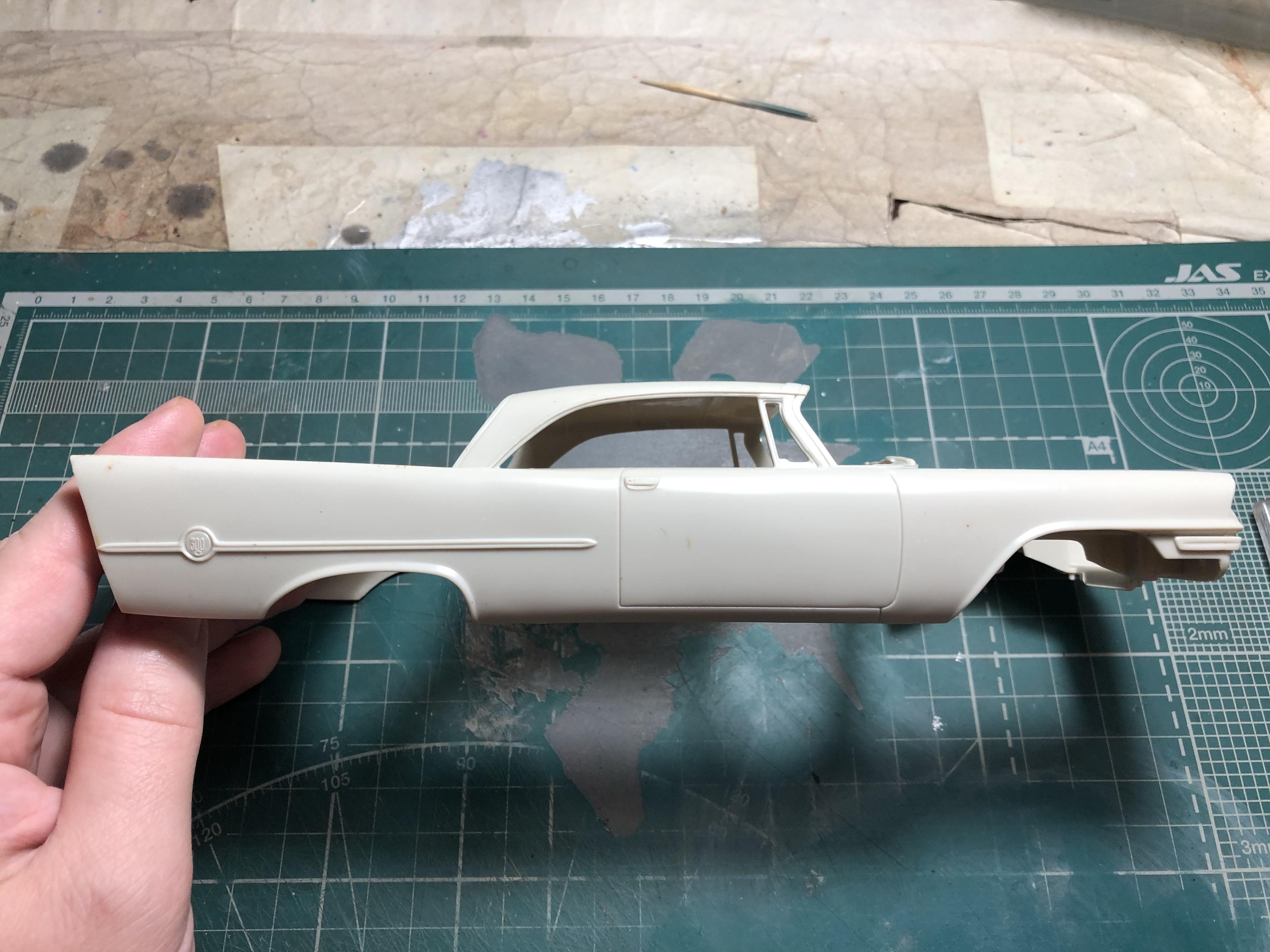

The most beautiful car with chic shapes and huge rear fins. Legendary three hundredth.
Here's a box.
Made in 1999.
The first in the box is a huge body. Really a barge.
So far, my largest model, the dimensions are truly impressive.
Very good embossing, it will be easy to paint in three colors, as on a real prototype.

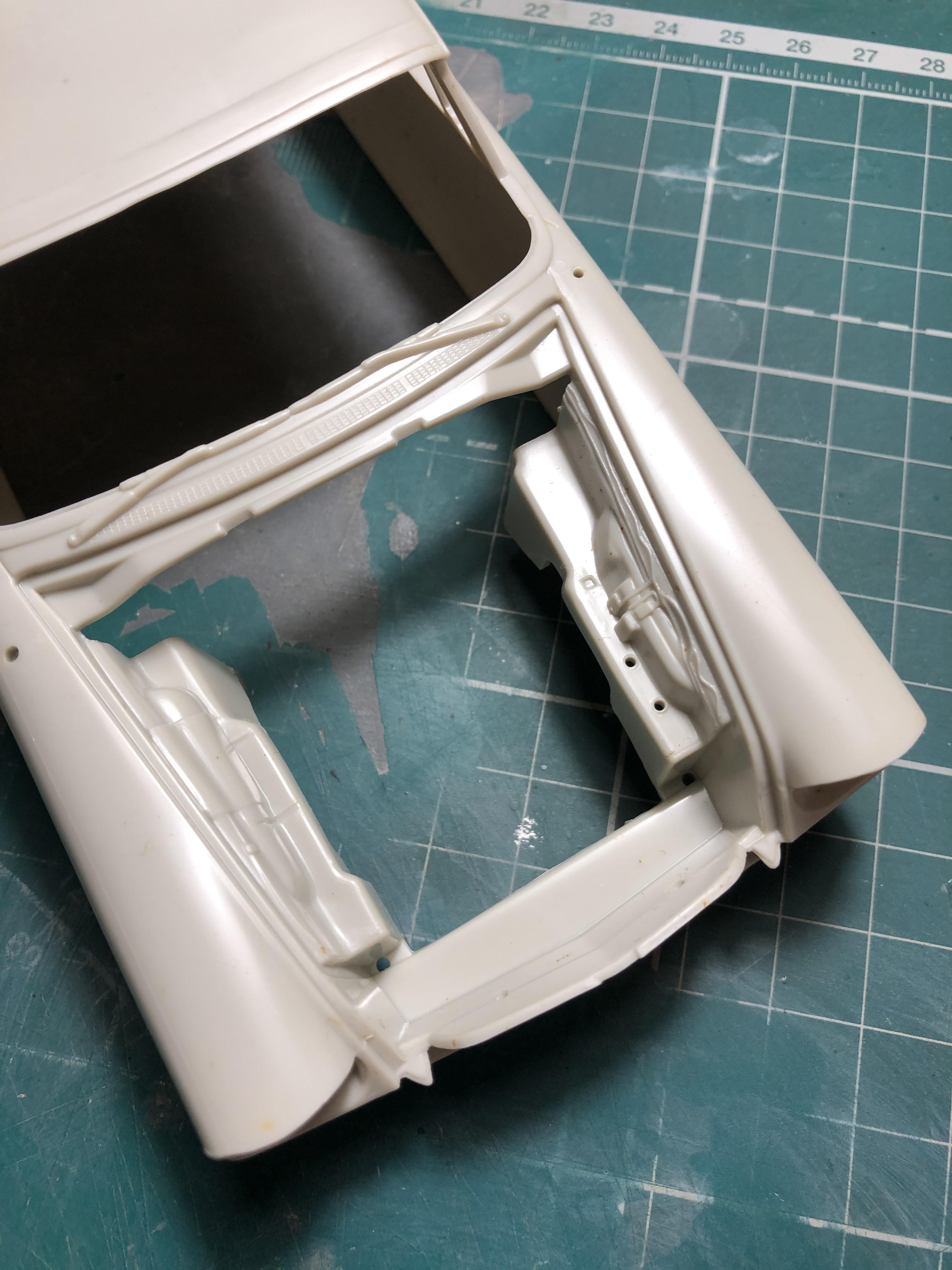

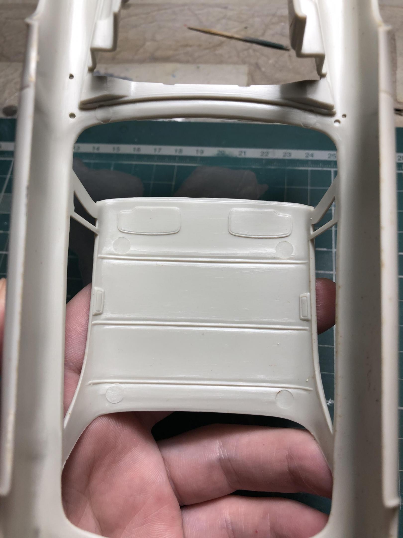

I was pleasantly surprised by the ceiling inside the interior.

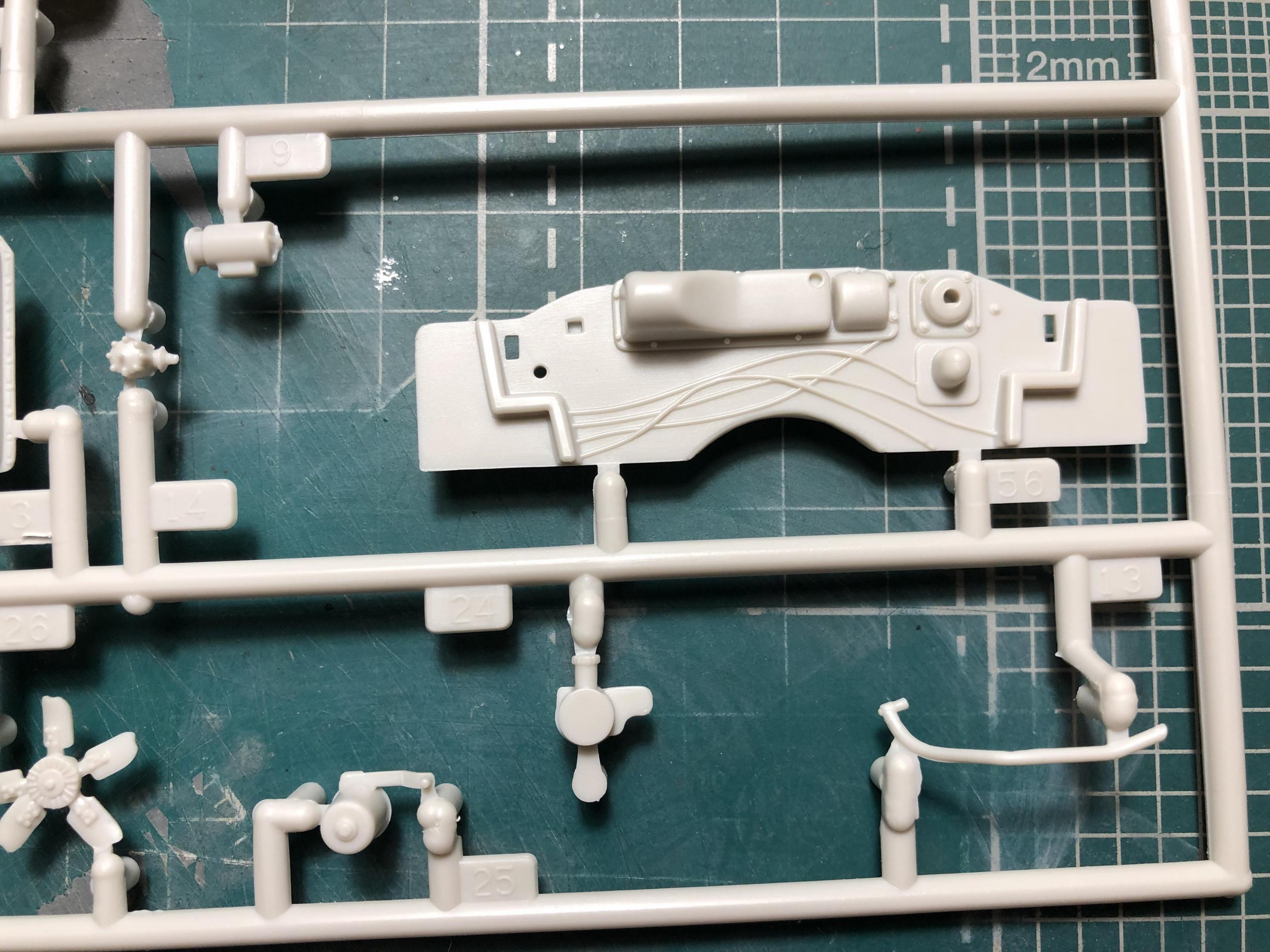

A small imitation of wiring under the hood.

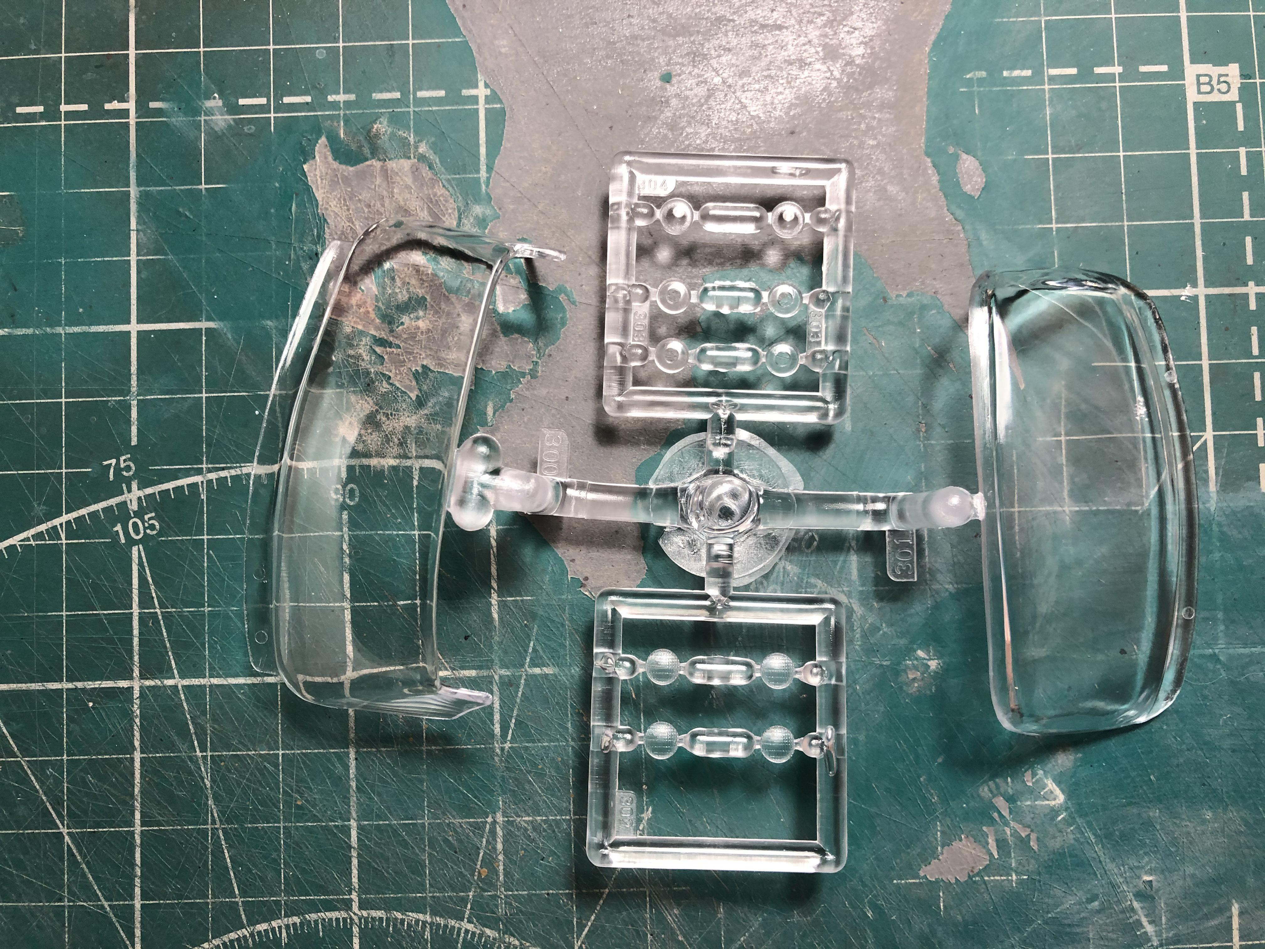

Glass sprue.
It is immediately evident that additional headlights are given for the custom.

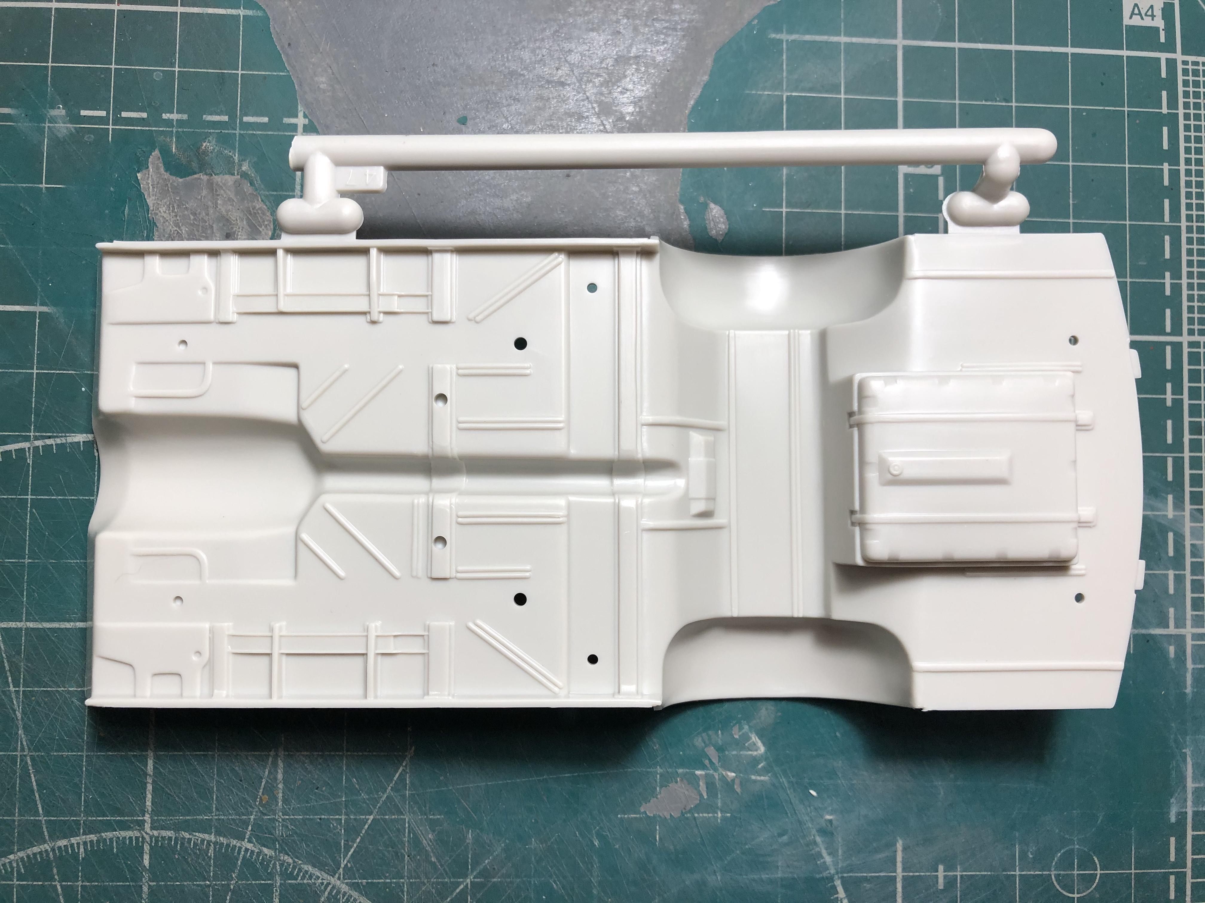

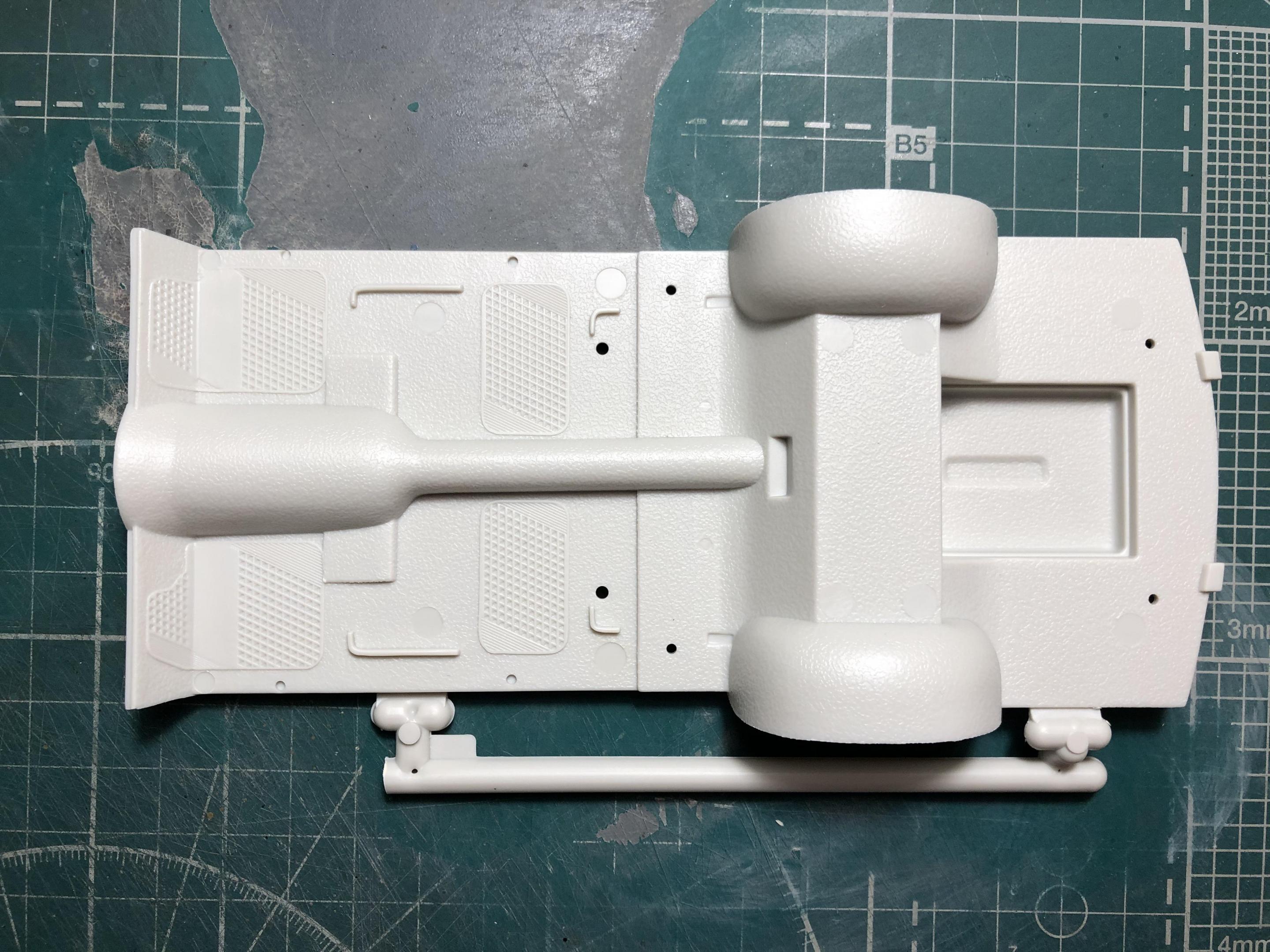

Bottom. Huge.
The carpets on the floor are also very very pleased.

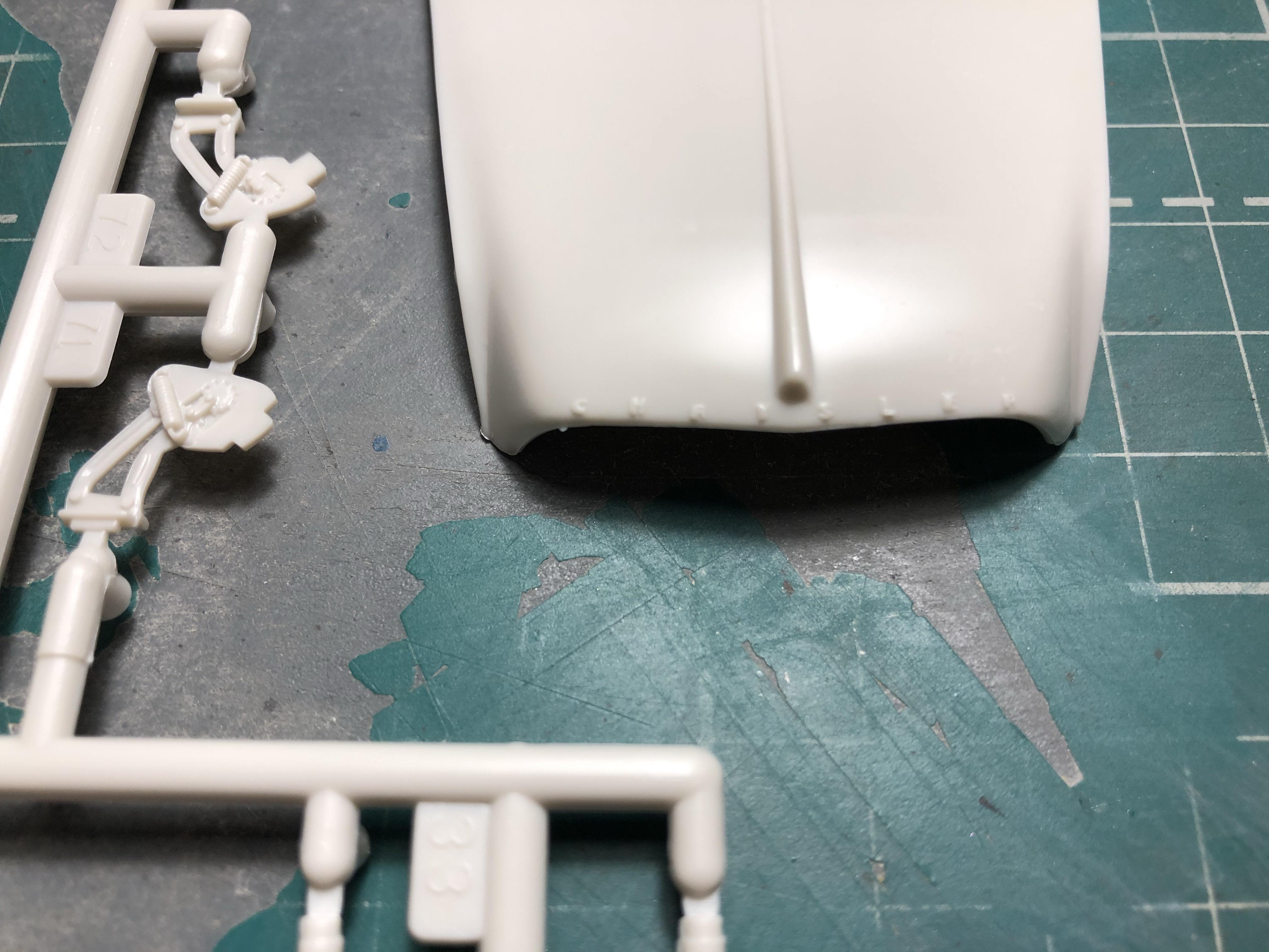

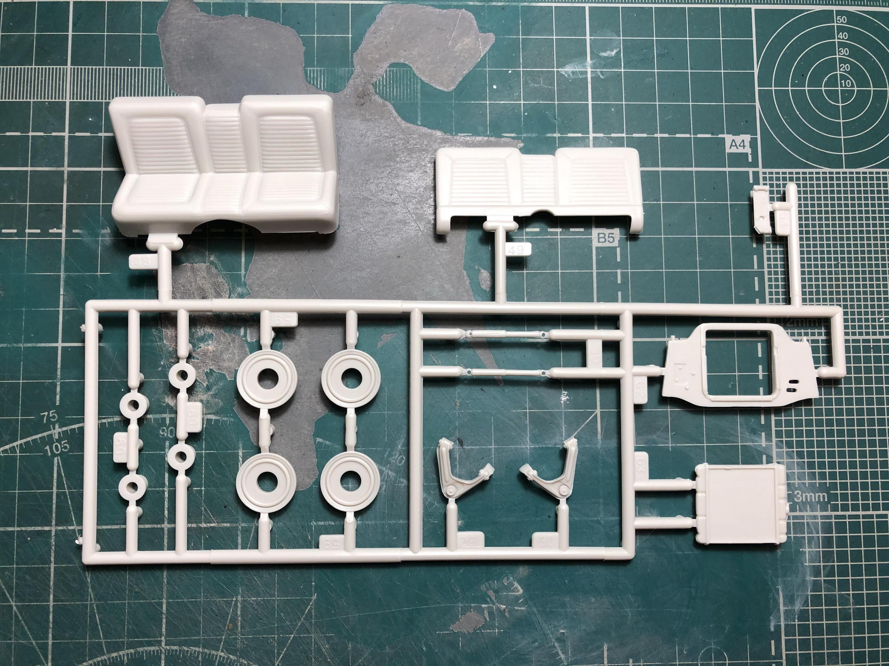

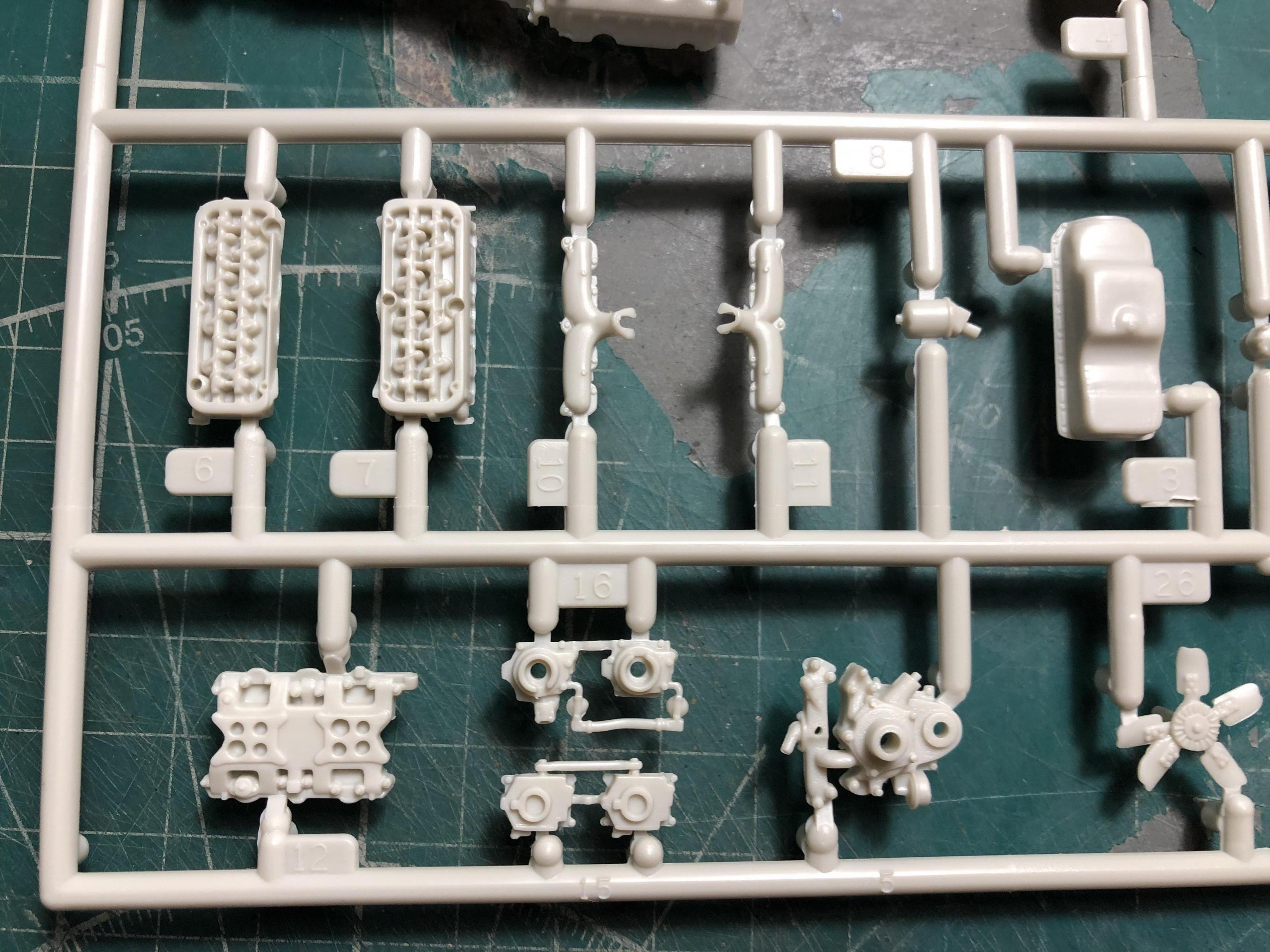

Next sprue
The detail is amazing.
The letters, however, some indistinct ones, upset me a little.

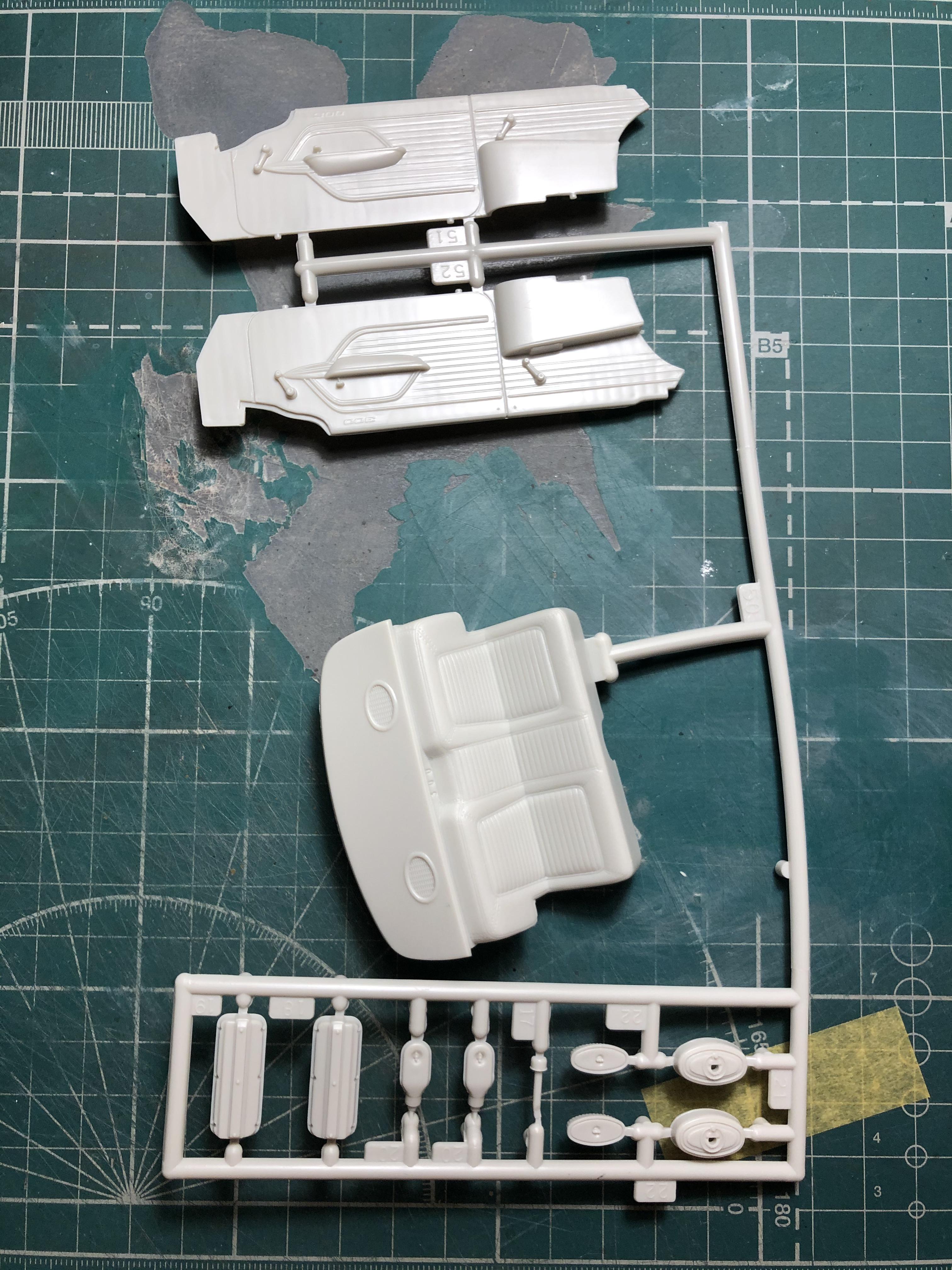

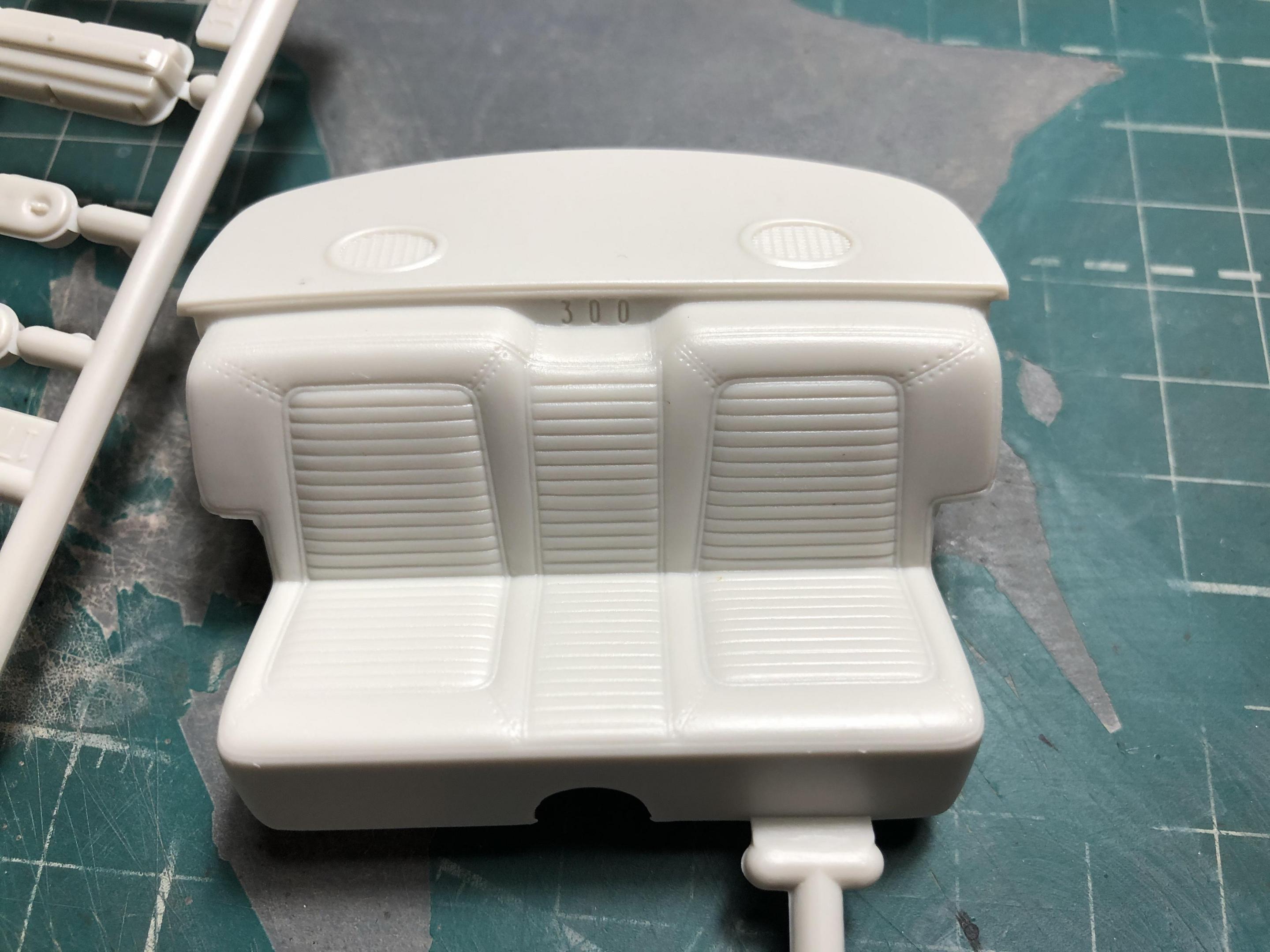

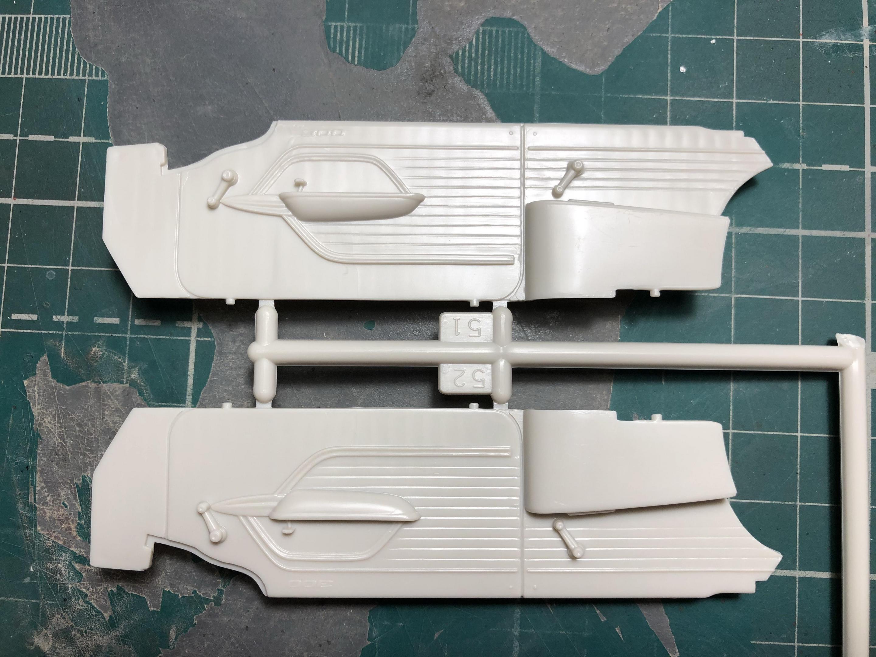

The door cards are gorgeous.
So is the back seats.

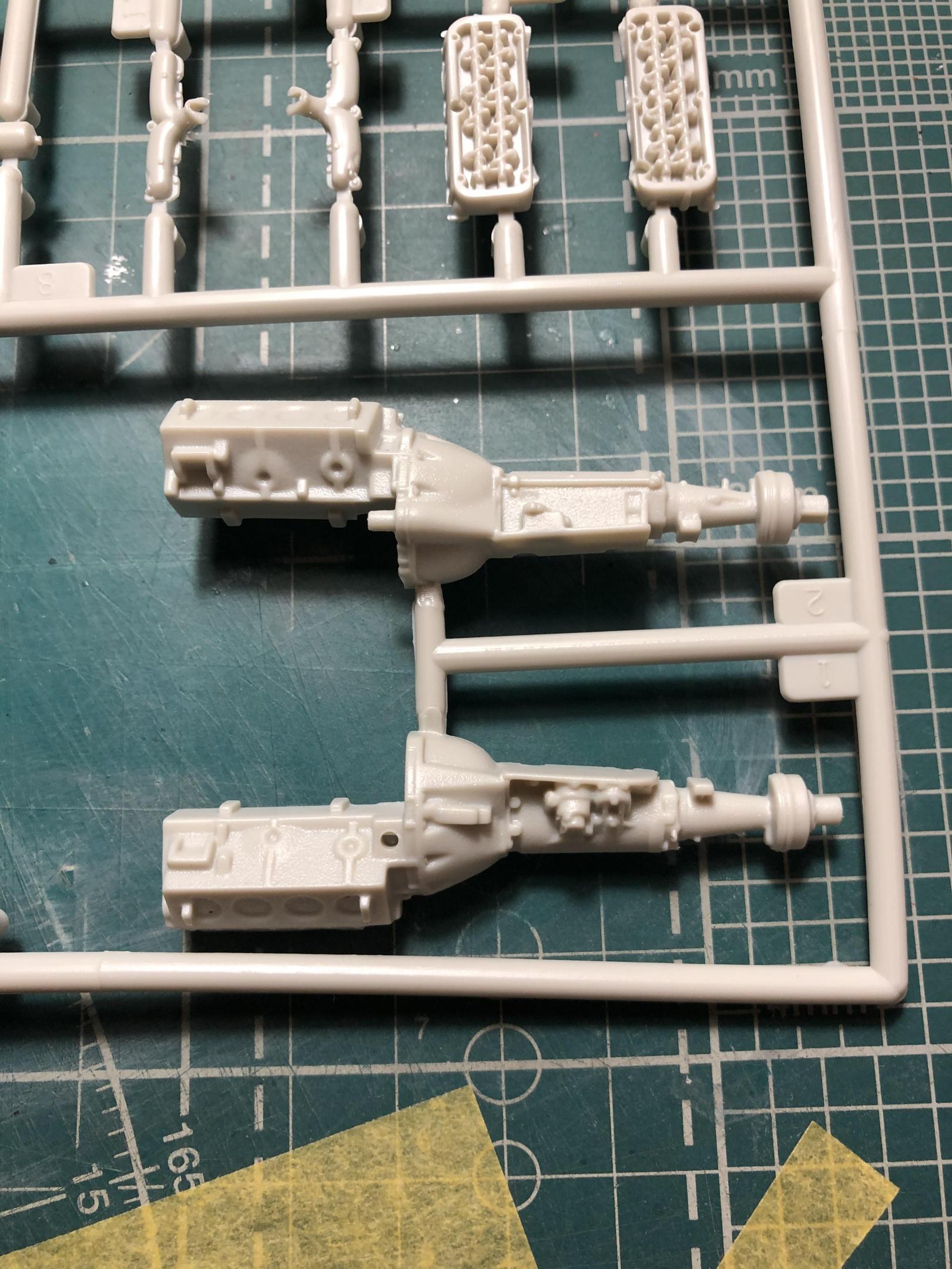

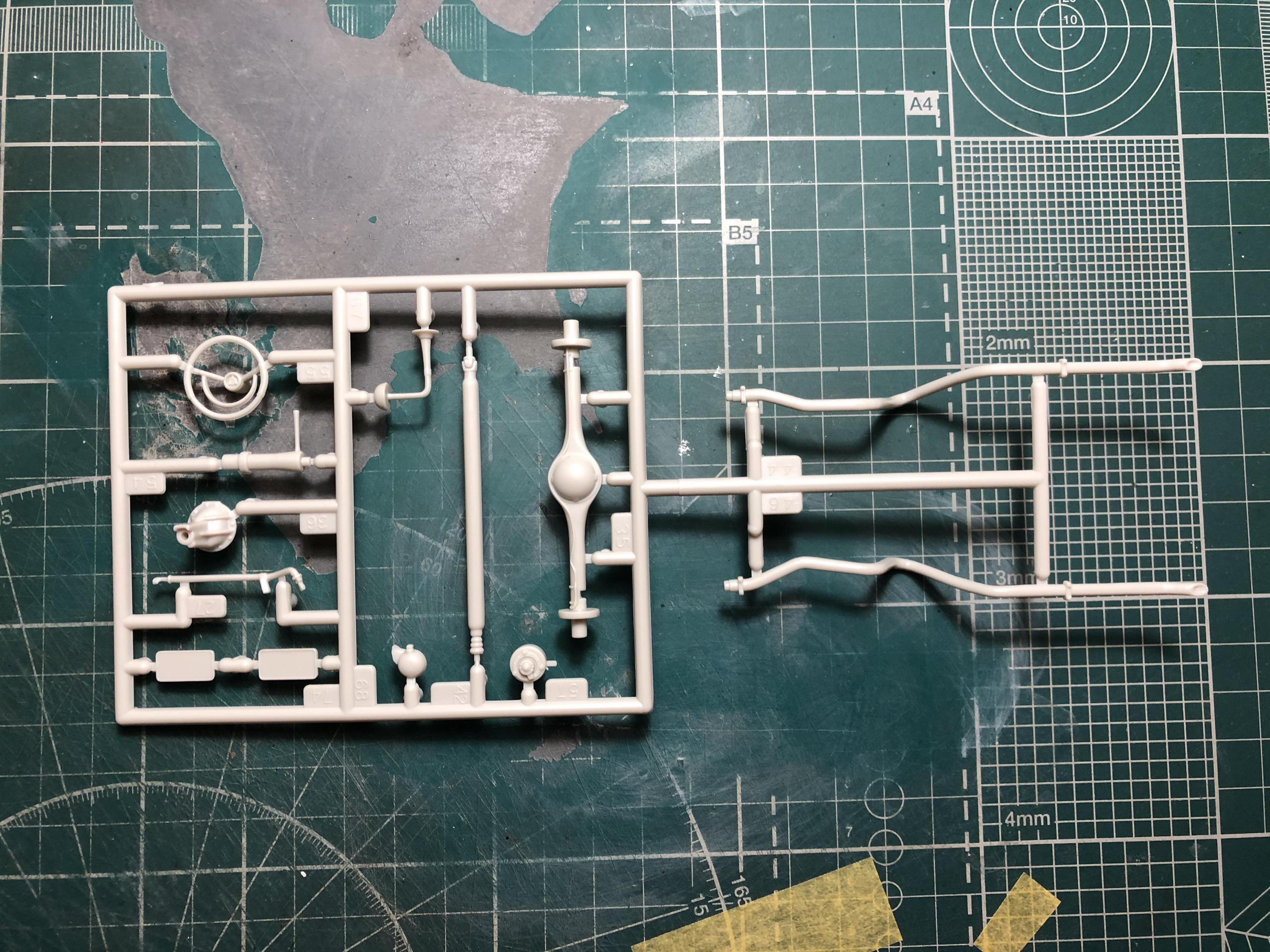

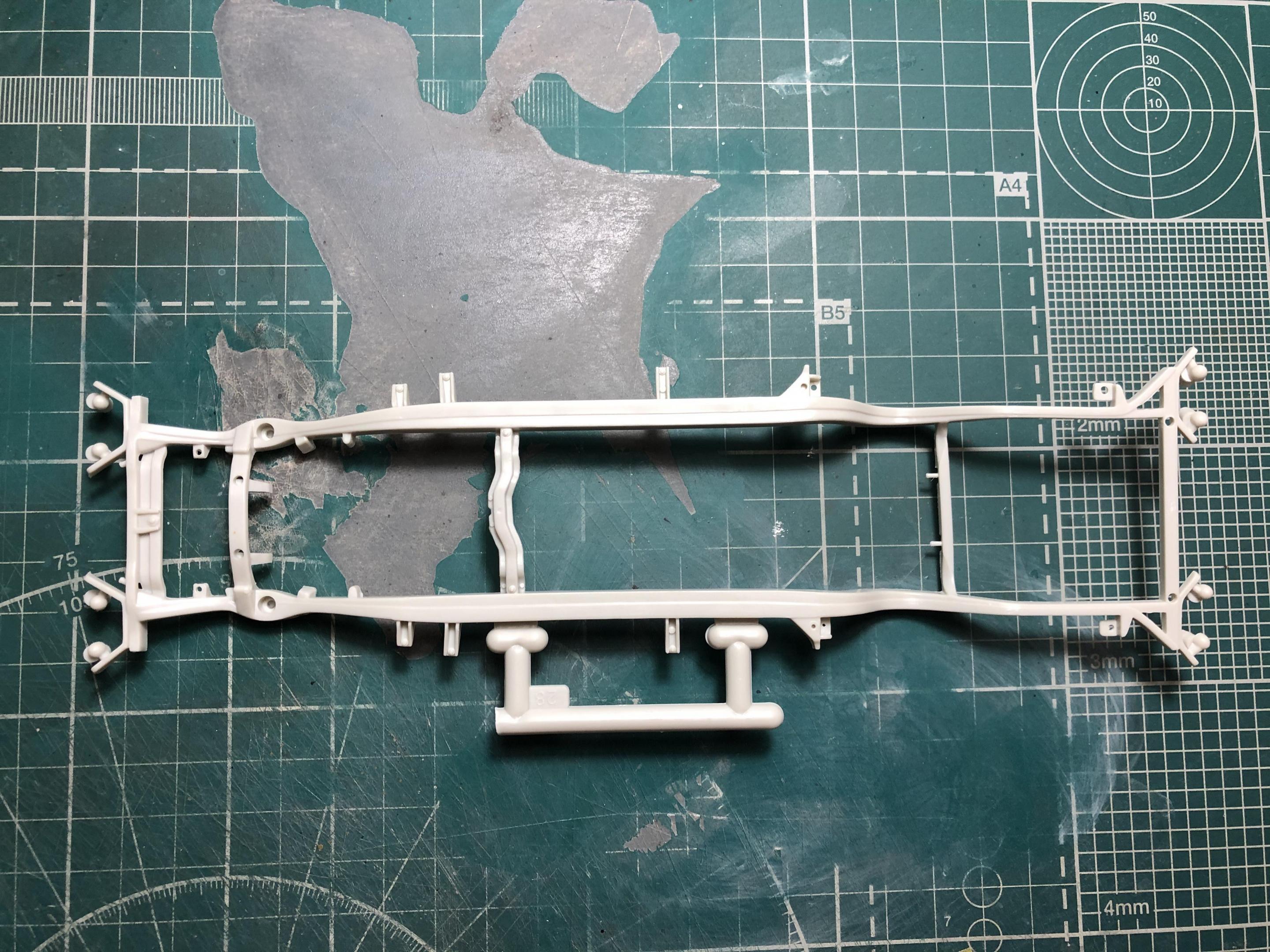

Huge frame.

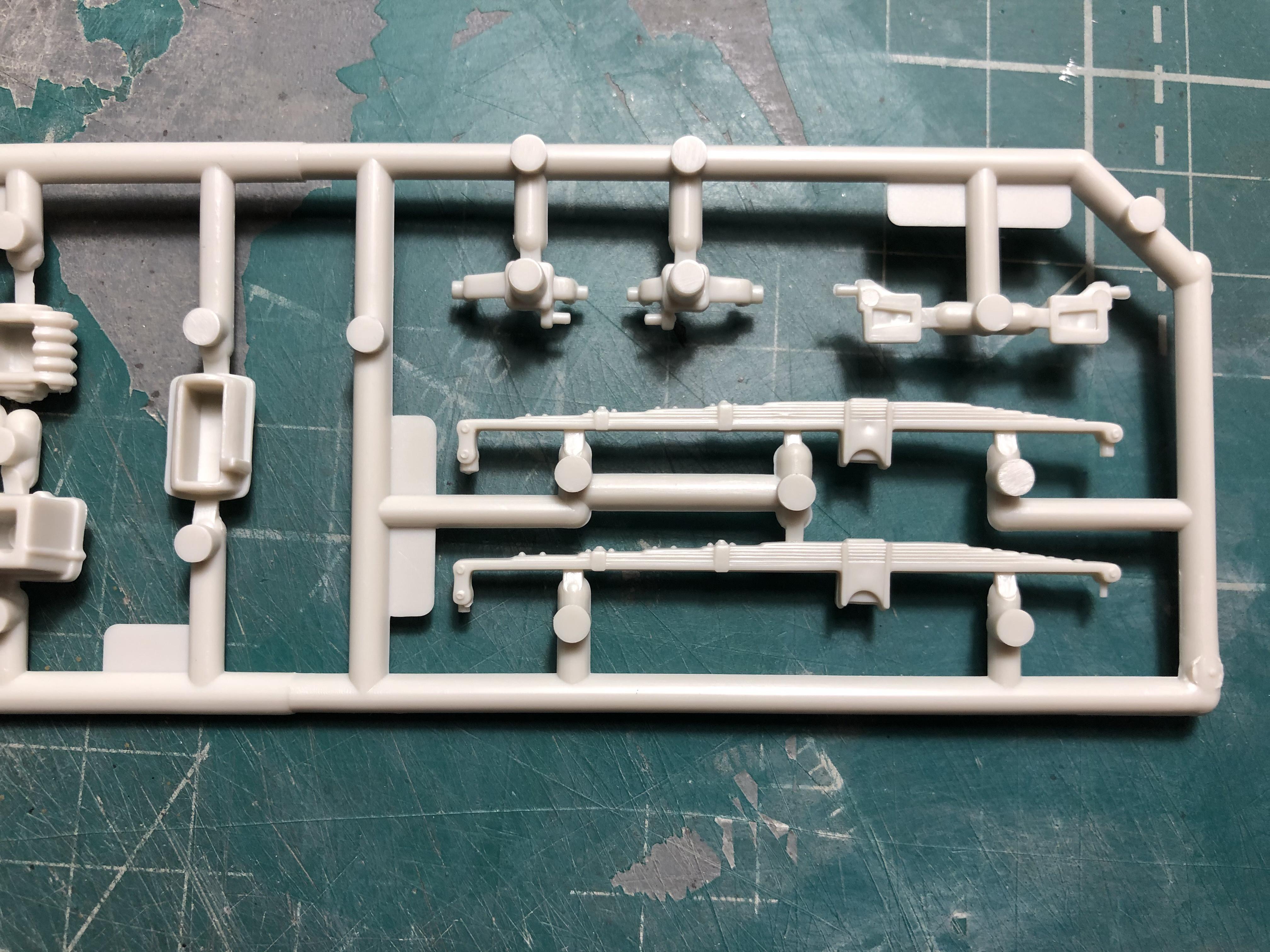

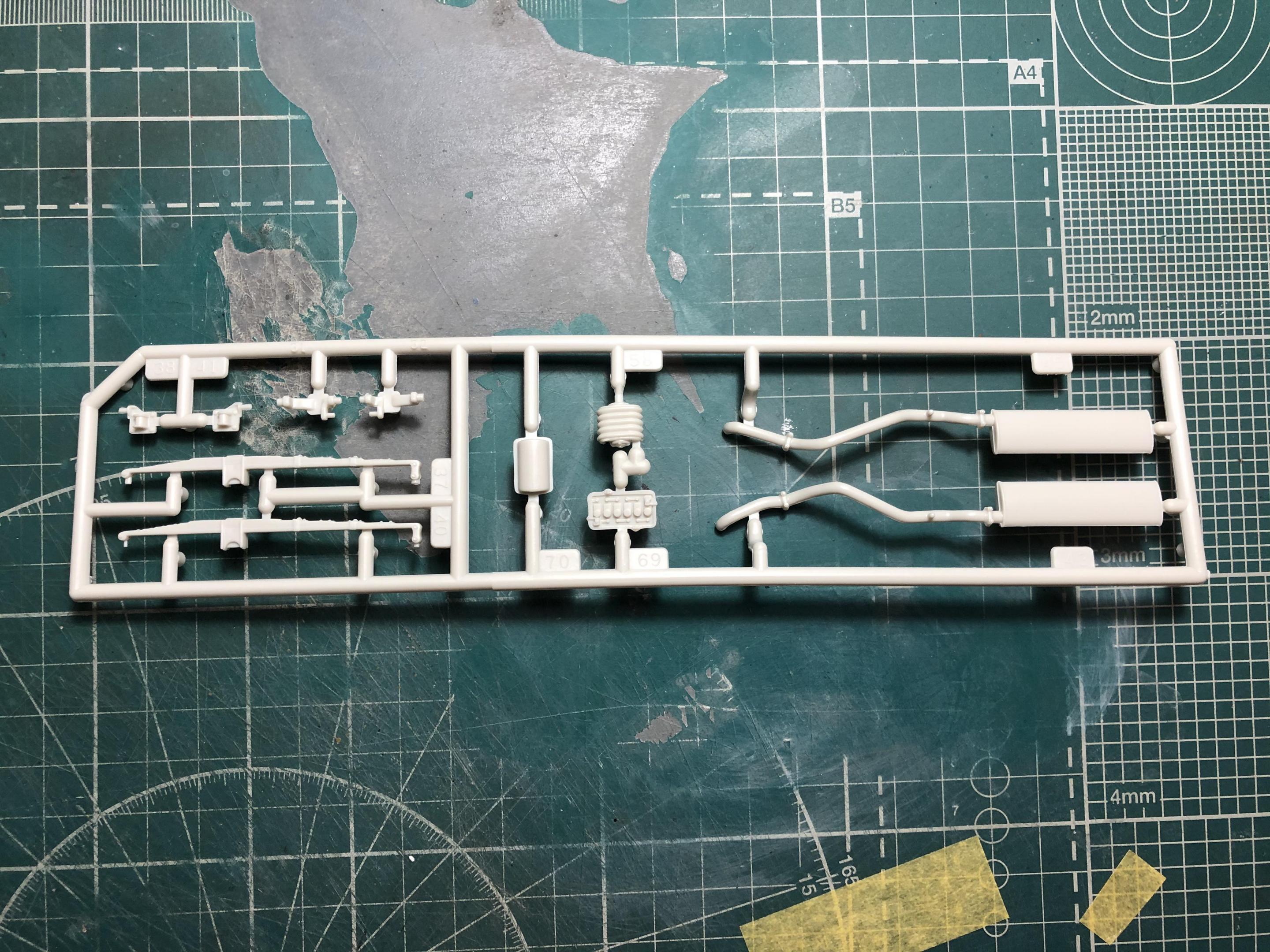

Exhaust, suspension parts.

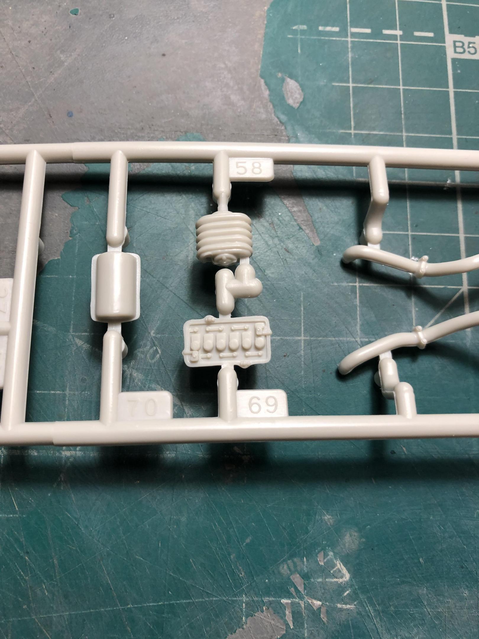

I liked the battery very much.
The springs are also good.

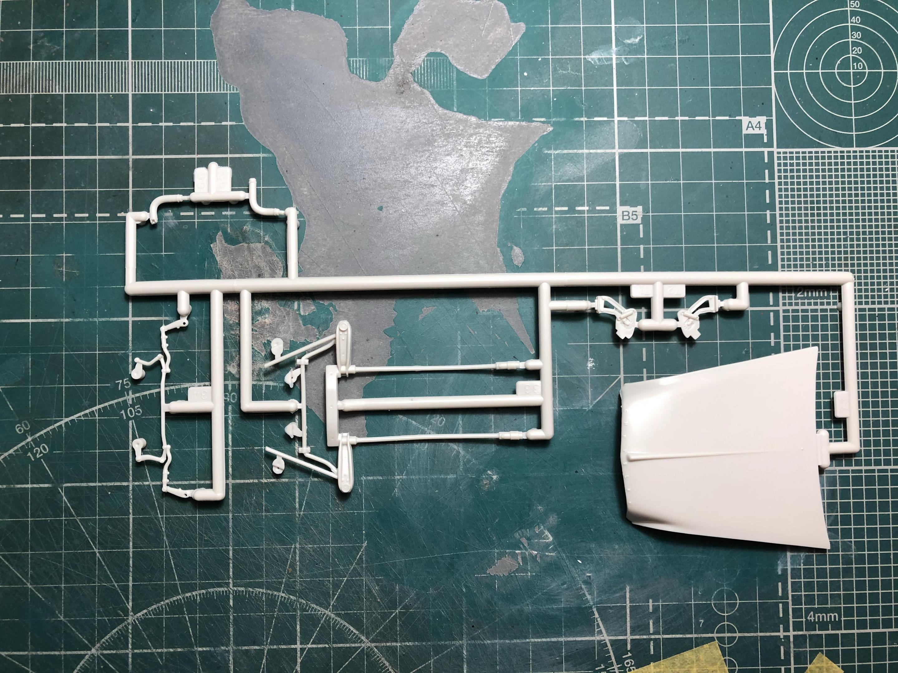

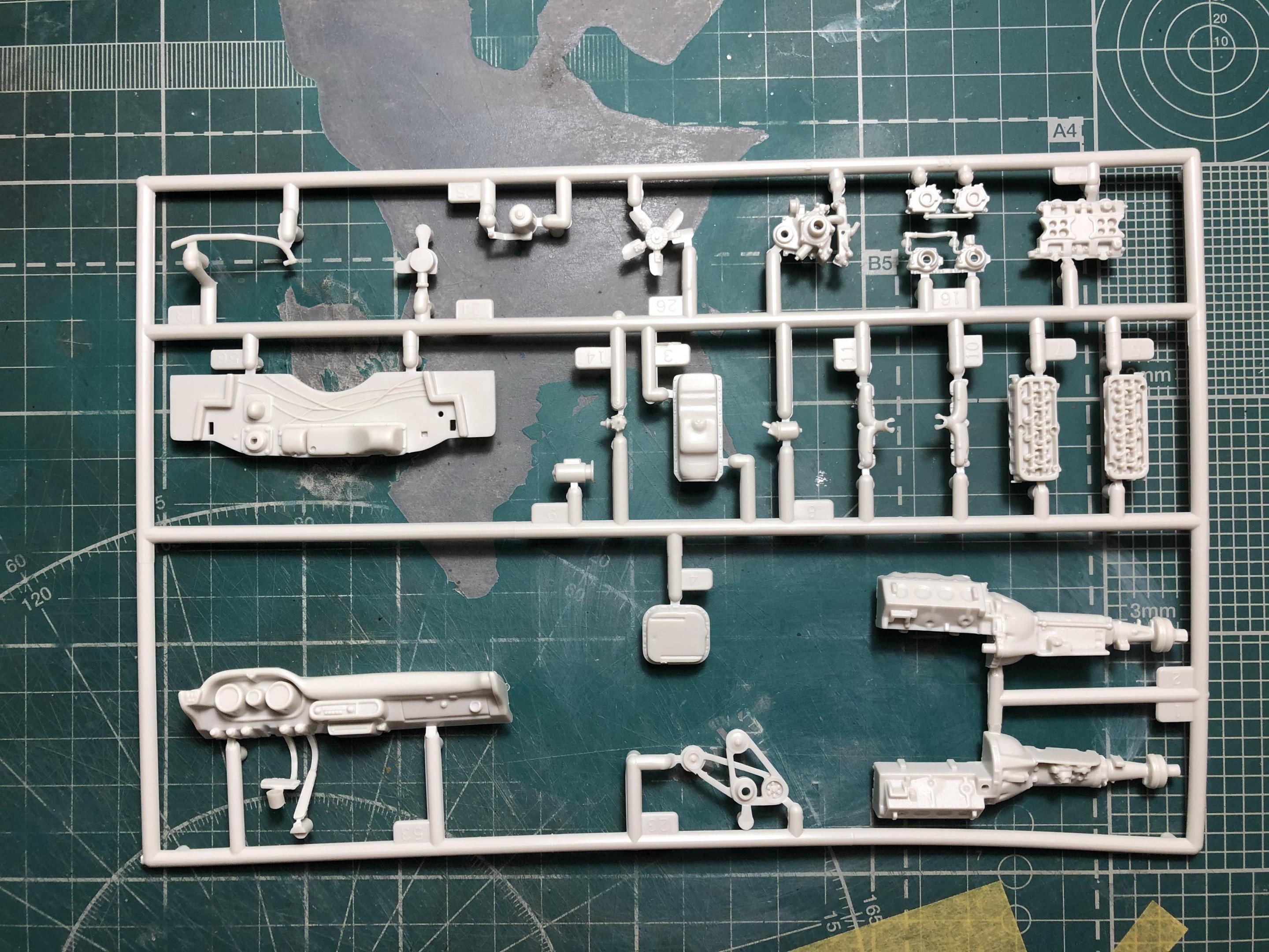

More details.
The steering wheel is good!

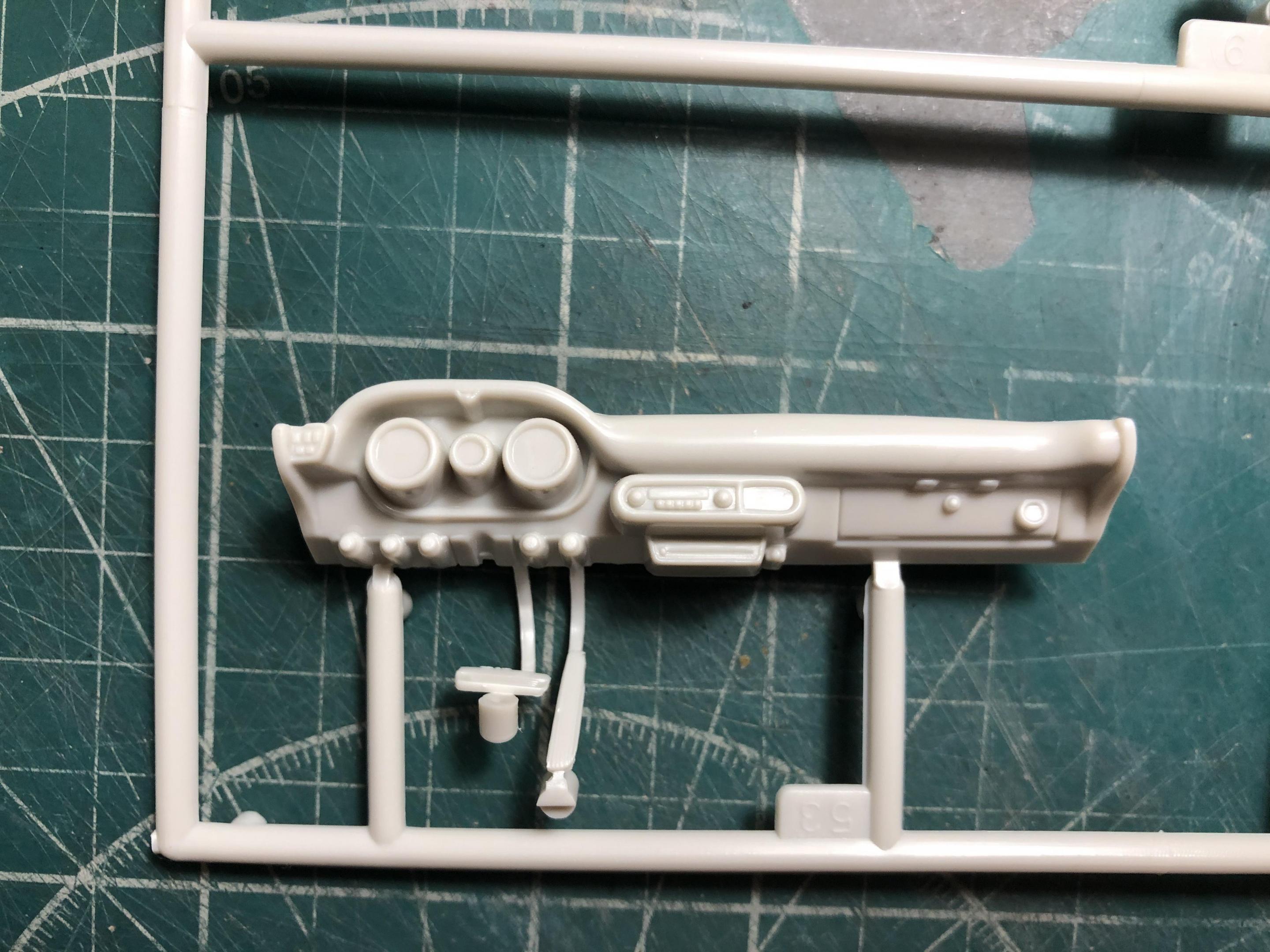

Here it is unusual for AMT, instrument panel up just under the decal.

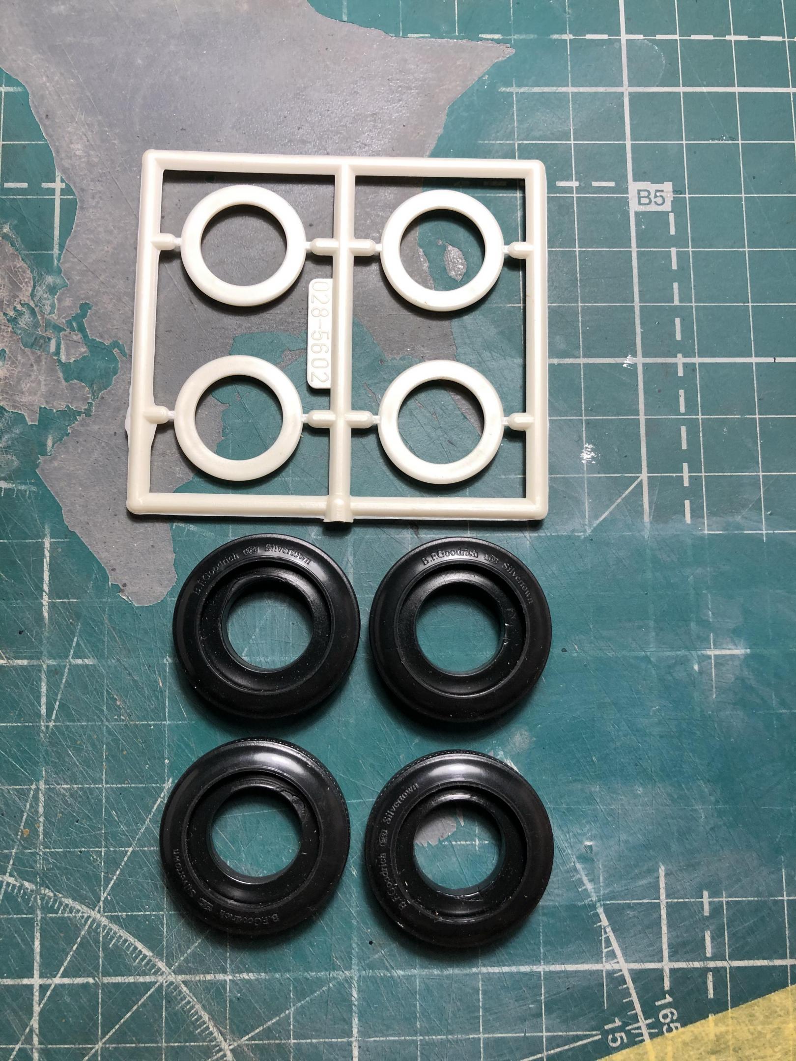

Whitewalls are given with white plastic, but, most likely, I will be painted.

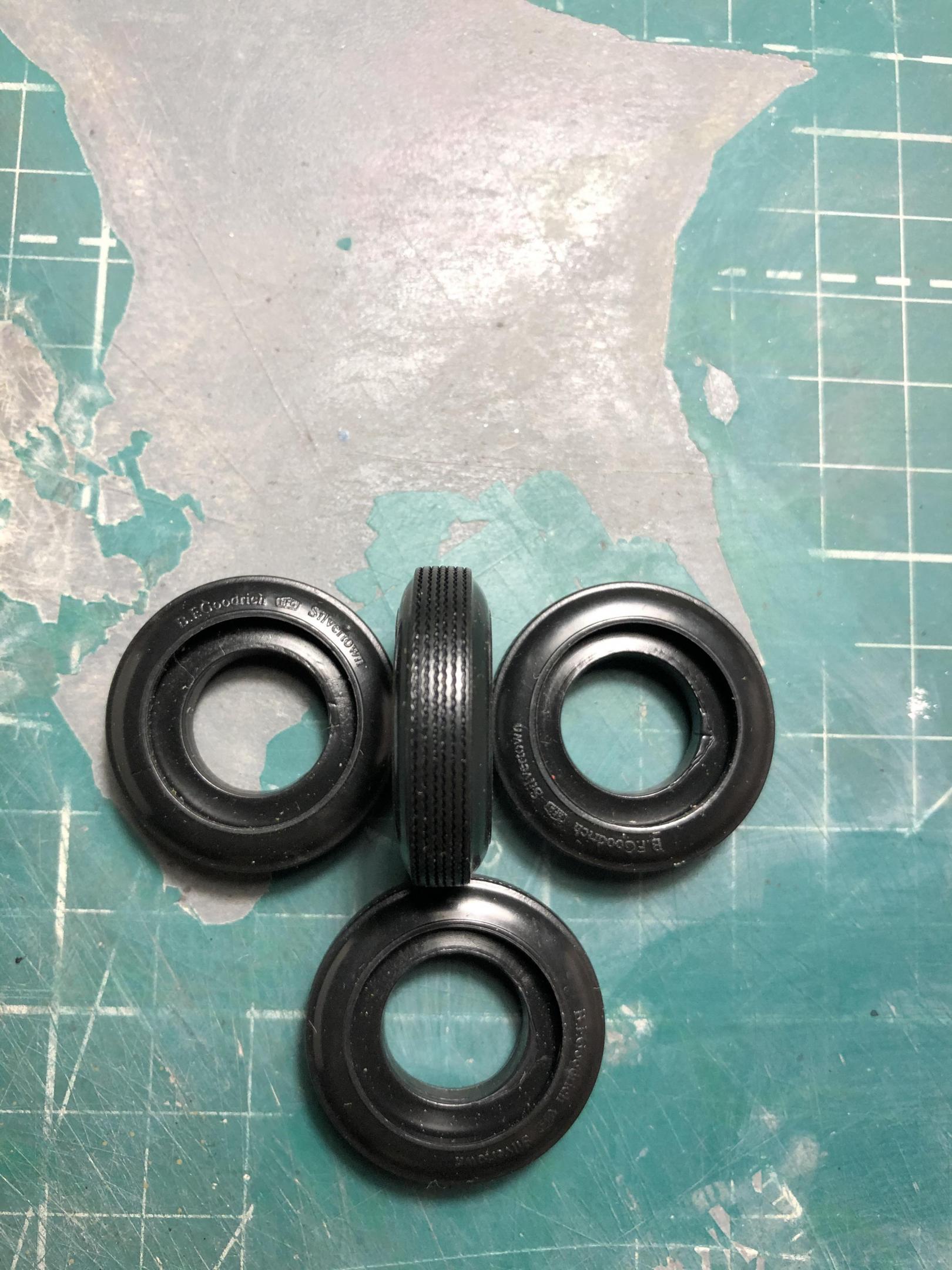

B. F. Goodrich tires.
For the first time! For the first time in my modeling practice, a seamless protector.
Well, they can! Why then is there always a disgusting seam or displacement? Unclear.

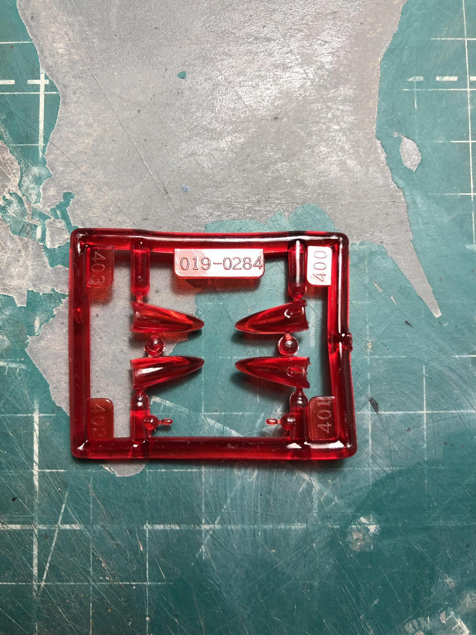

Taillights too - stock and custom.

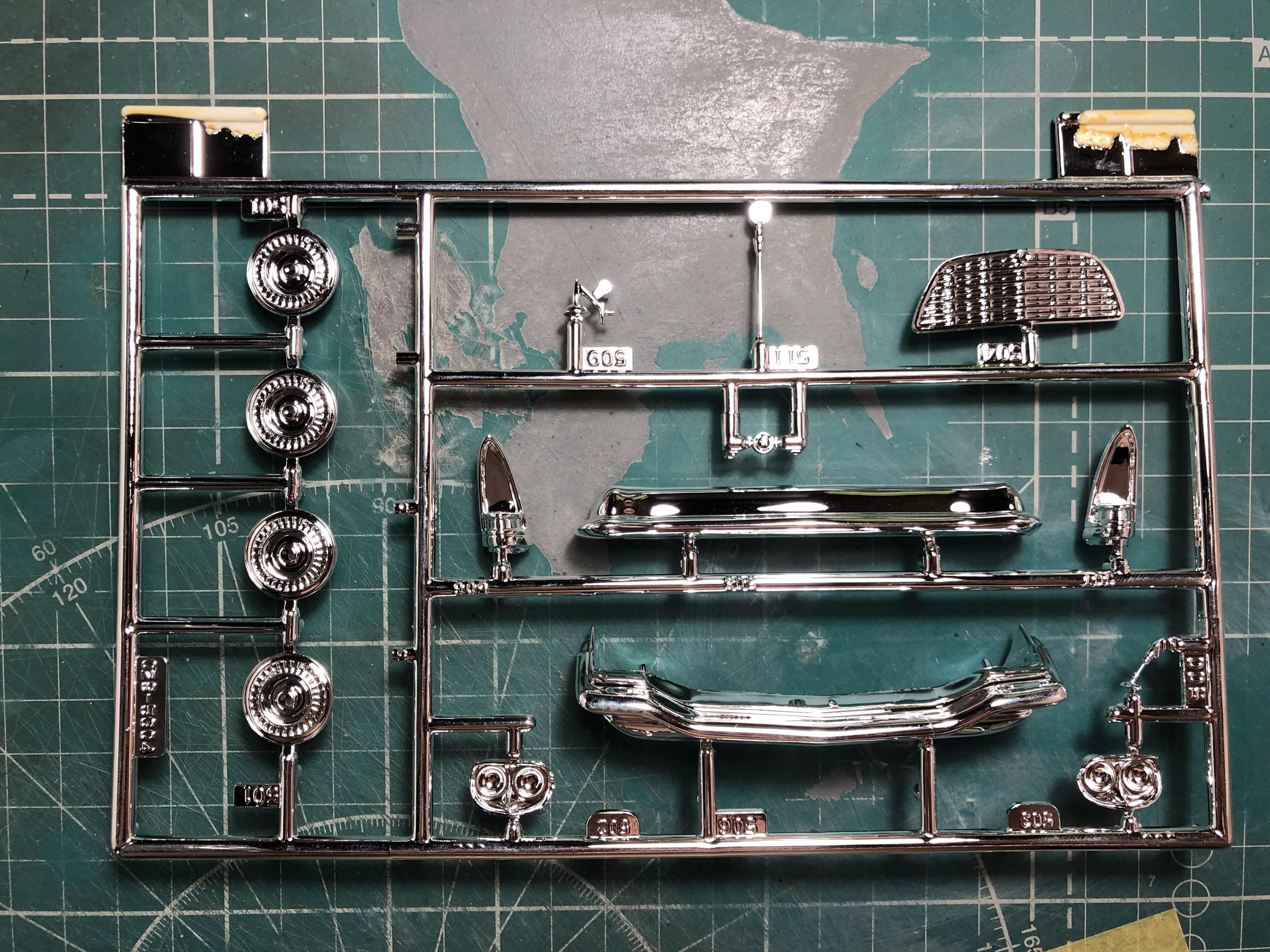

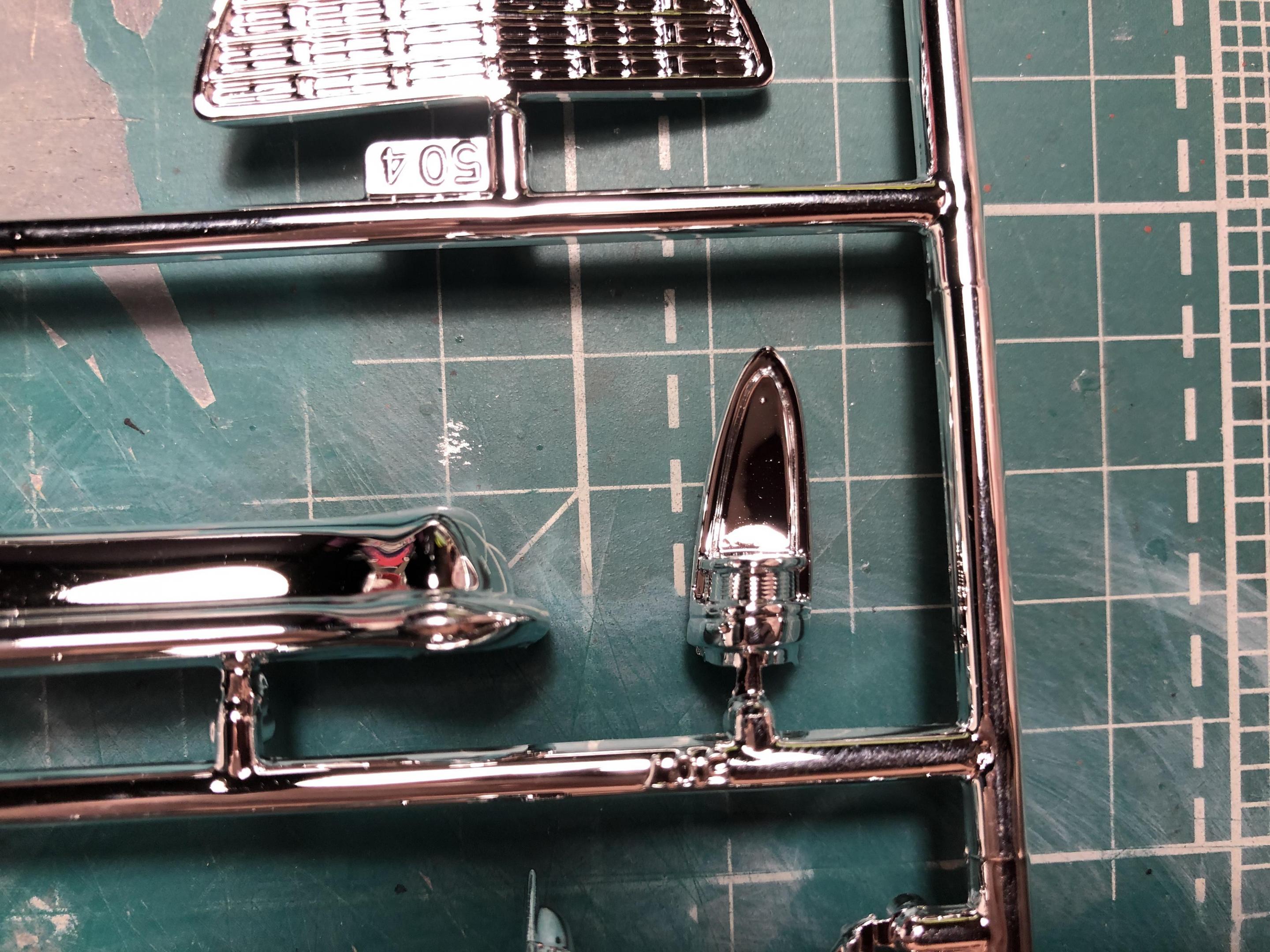

Chrome sprue.
The turn signal should be made of transparent glass, but they give it to us in chrome, a mess, of course.

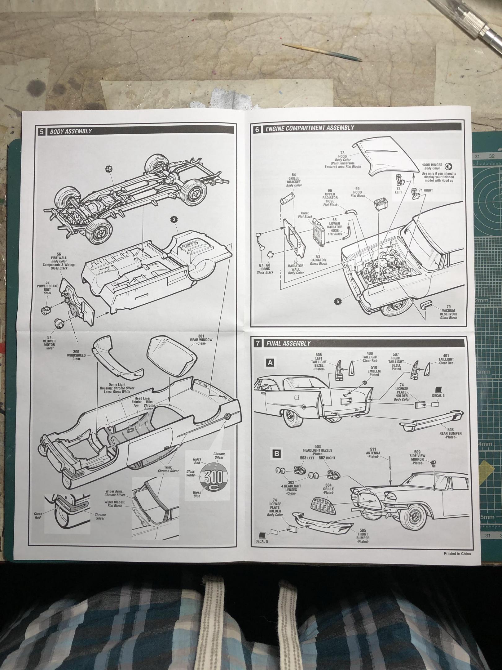

Well, a huge nice manual.

These clever whitewalls, which are molded from plastic and inserted into rubber tires, turned out to be a surprise. The holes in them are much smaller than necessary. The result is pornography. The disc does not fit completely and sticks out because of the whitewall.
Why this is done, I cannot understand. We take a dremel in our hands and grind it from the inside.
Now that's great. Before and after.IMG_5611.JPG.44cc9f06f85c2ef9447307dead1fb4fd.JPG
Comparisons of the whitewall itself before and after.
All wheels are processed.

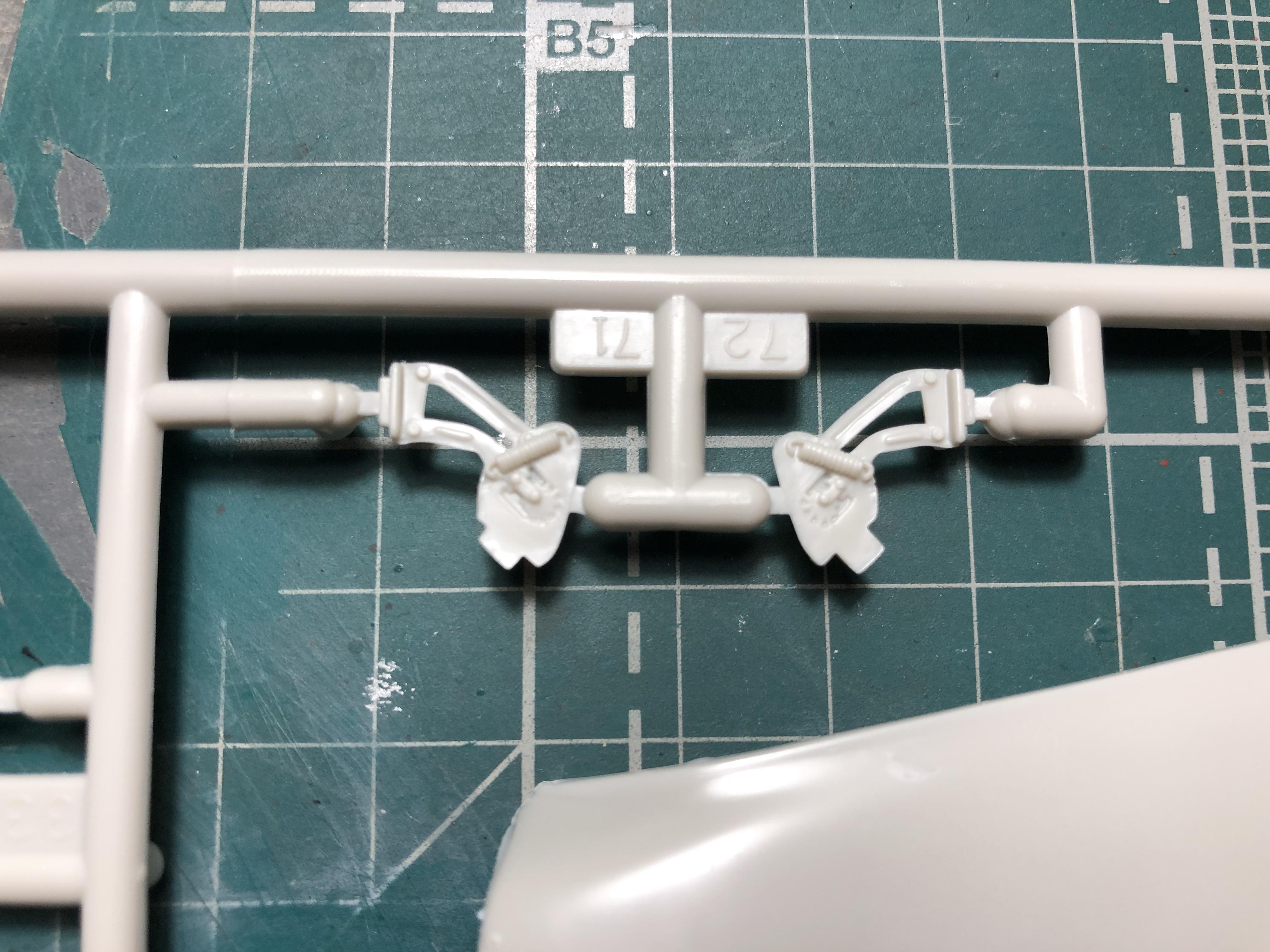

In the set we are given as many as 3 sets of headlights.
Stock at the very bottom, it's strange that there are only 2 pieces without risks, well, the headlights with holes surprized a little, why this is applicable at all.

Just to clarify, the lens under the tail light is not for the turn signal, it's the backup lights and yes you are quite right, they should be transparent clear.
The rear turn signals on most classic American cars are the same as the brake lights wich flicks on and off when it's on and it's in the same bulb as the regular tail light wich has two filaments, one for the tail light and one for the brake/turn signal...so it's behind the red lens.
The front turn signals are often the same as the parking lights and is clear or in some cases amber, in my country they have to be clear as we aren't allowed to have a steady amber light at the front of our cars, amber or orange turn signals yes but not any other lights.

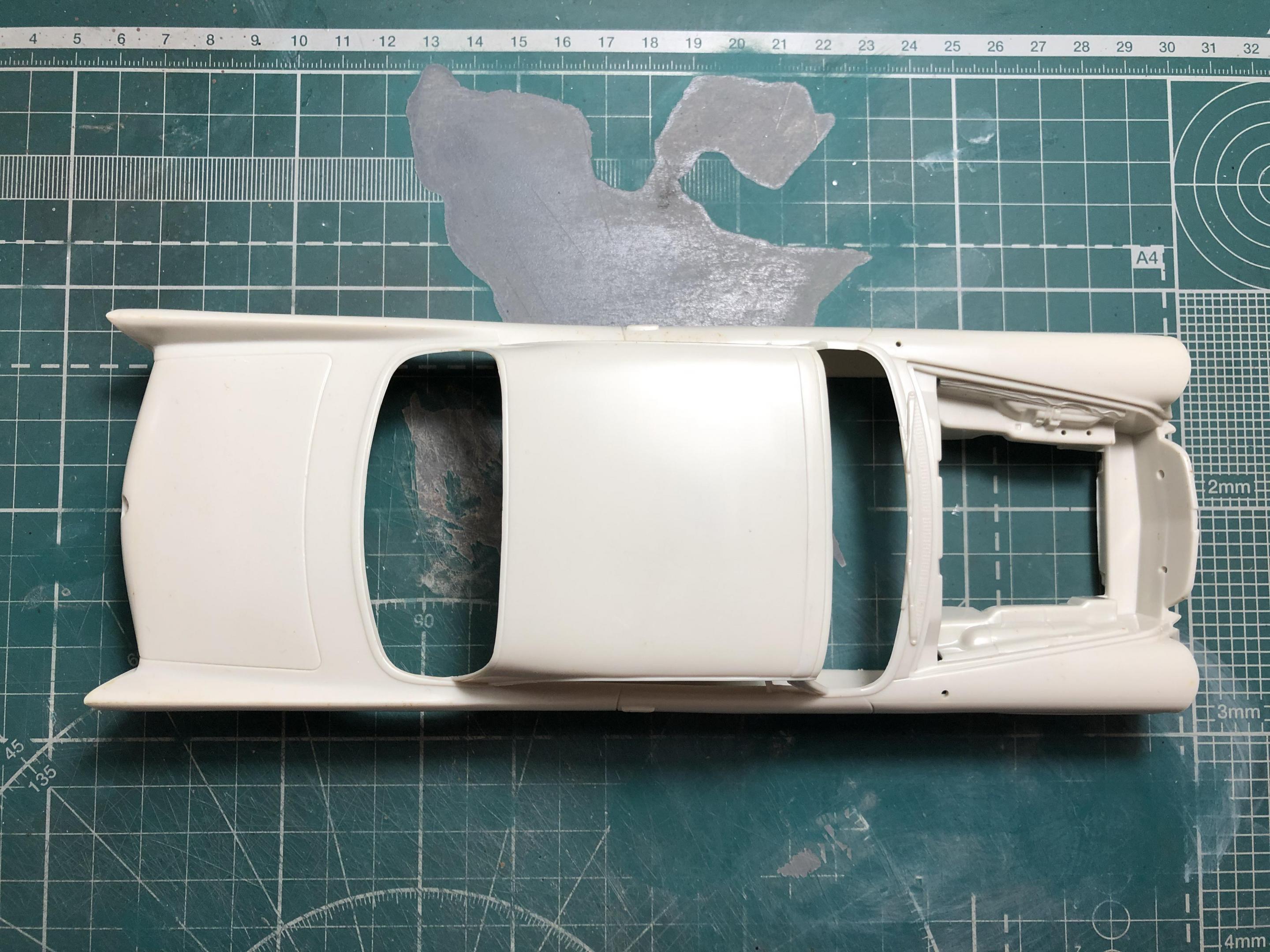

Hello everyone. Body is polished.
So that is all.
Another model on the shelf. A couple of photos for seed, wait on the Under The Glass topic with normal color rendition.
