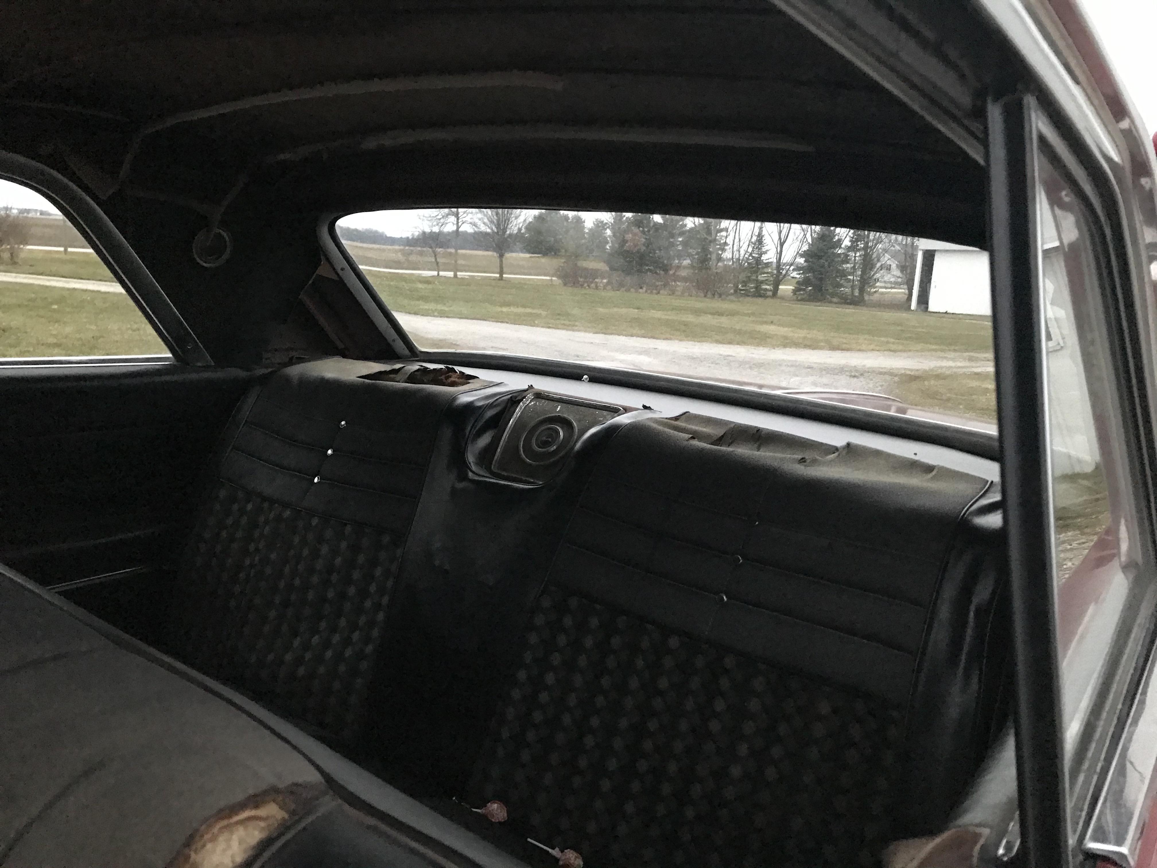

1964 Impala Posted December 6, 2020 Posted December 6, 2020 Does anyone know whether anyone ha produces a 1964 Impala that is not an SS model? In my research I have found nothing. I have included a reference photo of what I want my model to look like. Is there any way to scratch build the trim and hubcaps because they are entirely different than the SS? Thanks In Advance, TR

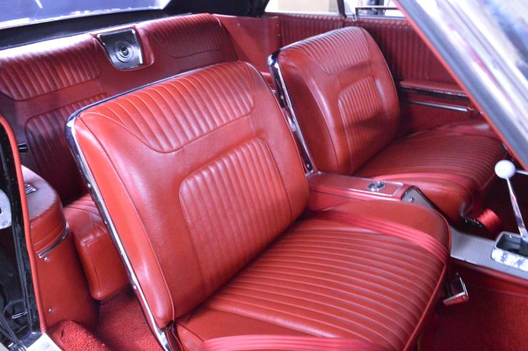

espo Posted December 6, 2020 Posted December 6, 2020 I would suggest following 64SS350's idea on the body side moldings. That and the badging on the rear quarter panel would take care of the exterior of the body. The interior challenge would be the front bench seat. This can be done by modifying the back seat from a second models interior. The seat would need to be widened since the rear seat is somewhat narrower because of the side arm rests. The console would also go away. The correct hub caps may be an issue depending on your wheel and tire combination. I think that most of the kits representing the Chevrolet models, say '63 thru "65, that provide stock full wheel covers might be a good source if you're building a showroom stock model.
Mark Posted December 6, 2020 Posted December 6, 2020 The 1971 Impala wheel cover is about the closest thing out there. If you could track one down and make castings of it, that might be an option. All of the annual kits from '63-'68 were SS (MPC's '69 was, not sure about AMT but I think it was not). No kit has the regular Impala side trim, you'll have to work that out yourself. The MCG photoetch set has non-SS Impala emblems as well as other items you may want to use. I've never been a fan of the "use another rear seat to make a front seat" deal, as the lower portion of the front seat is often wider and shaped differently. I'd start with a bench seat from a similar car like a '62 Bel Air.

Oldcarfan27 Posted December 11, 2020 Posted December 11, 2020 Pr On 12/6/2020 at 7:33 AM, espo said: The interior challenge would be the front bench seat. This can be done by modifying the back seat from a second models interior. The seat would need to be widened since the rear seat is somewhat narrower because of the side arm rests. The console would also go away. Problem there is the upholstery pattern is different too. SS interior. Standard bench interior. If you're going to have to make a bench anyway, might as well start from scratch or use a seat with no pattern on it so you wouldn't have to clean it all off before you can even start. Good luck!
espo Posted December 11, 2020 Posted December 11, 2020 Just now, Oldcarfan27 said: Pr Problem there is the upholstery pattern is different too. SS interior. Standard bench interior. If you're going to have to make a bench anyway, might as well start from scratch or use a seat with no pattern on it so you wouldn't have to clean it all off before you can even start. Good luck! Good point I didn't think of the pattern in this case. The one I did a couple of years ago was in the making of a '67 El Camino I had owned years ago. See my Icon. I used the Revell '66 El Camino as a base and grafted the front end from a Revell '67 Chevelle SS396 onto the body and used the rear seat and door panels on the interior. Mine was a Malibu trim level so that worked well for me since they shared the same interior pattern.

bisc63 Posted December 18, 2020 Posted December 18, 2020 Actually, the '64 base interior is fairly close to the '63 SS interior. I'd start there, and re-scribe a bit as needed.

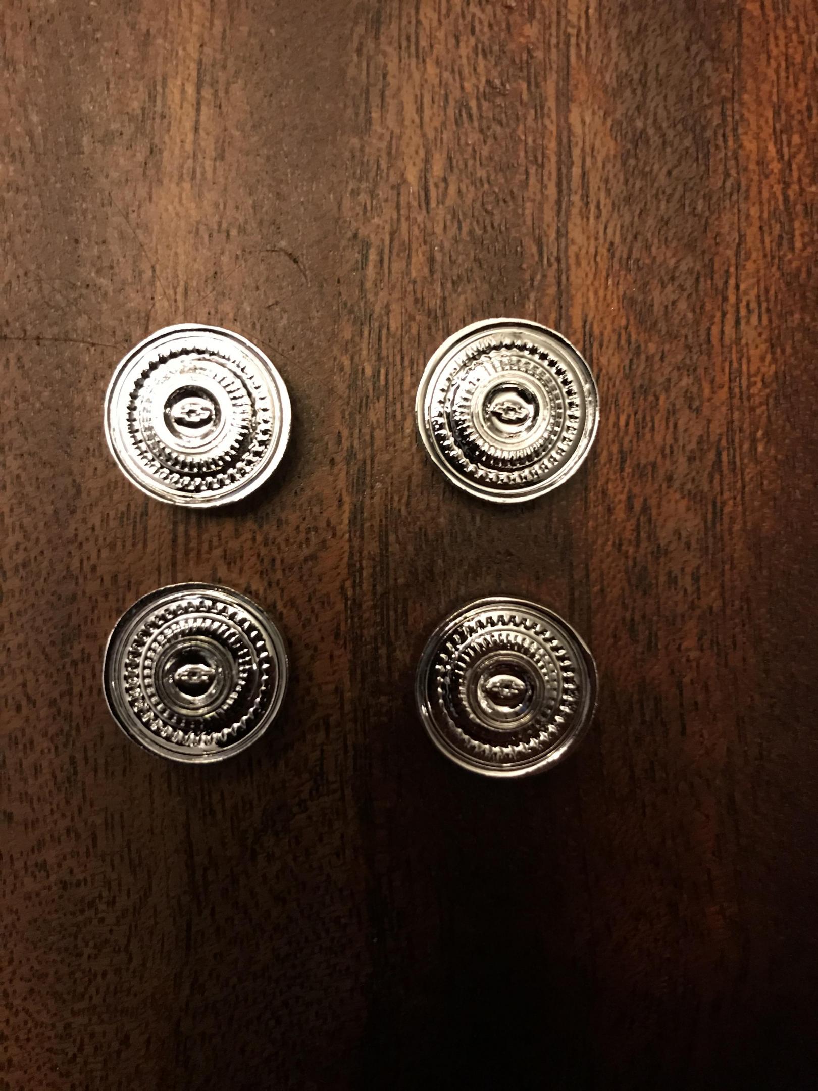

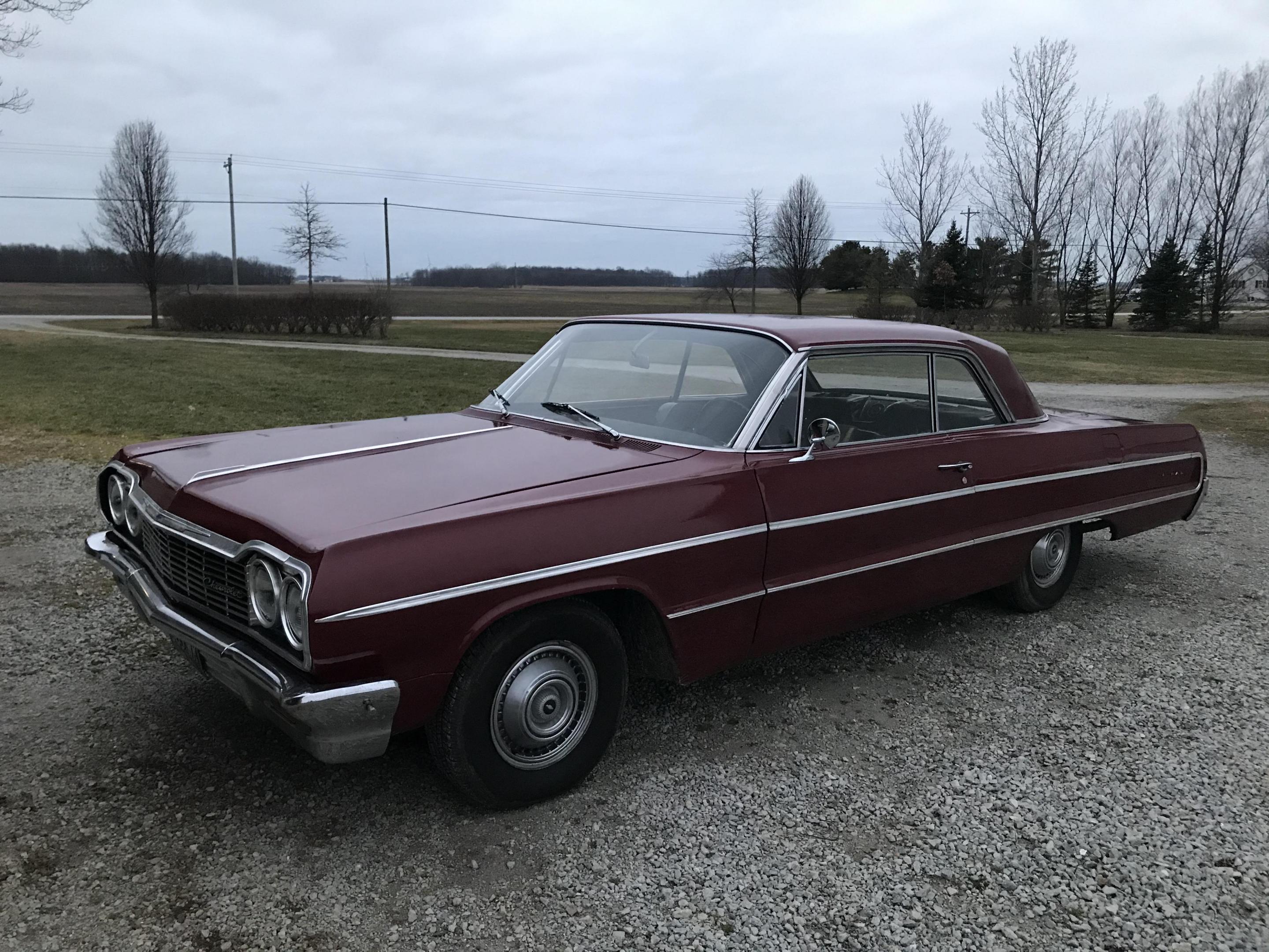

1964 Impala Posted January 7, 2021 Author Posted January 7, 2021 Quick update, I have purchased a set of 1971 Impala hubcaps as suggested by Mark, which were pretty close to the base model hubcaps in 64. Now I just need the 1964 Impala model to go along with the hubcaps. The seats shouldn't be a huge problem because my seats are slightly different than the ones posted and should be fairly easy to replicate. I have included a picture of my 1964 Impala which I restored with the help of my father and my grandfather. This car has been in my family since day one and I got it for free from my grandfather who drove it everyday from 1972 until 1991. Needless to say it was pretty worn out. Anyways this is the look I'm shooting for. Thanks For The Help, TR
espo Posted January 7, 2021 Posted January 7, 2021 You have a really great looking old Impala there. The hub caps look good and only a light black wash to help bring out the details on them. I'll be looking forward to watching your build.
