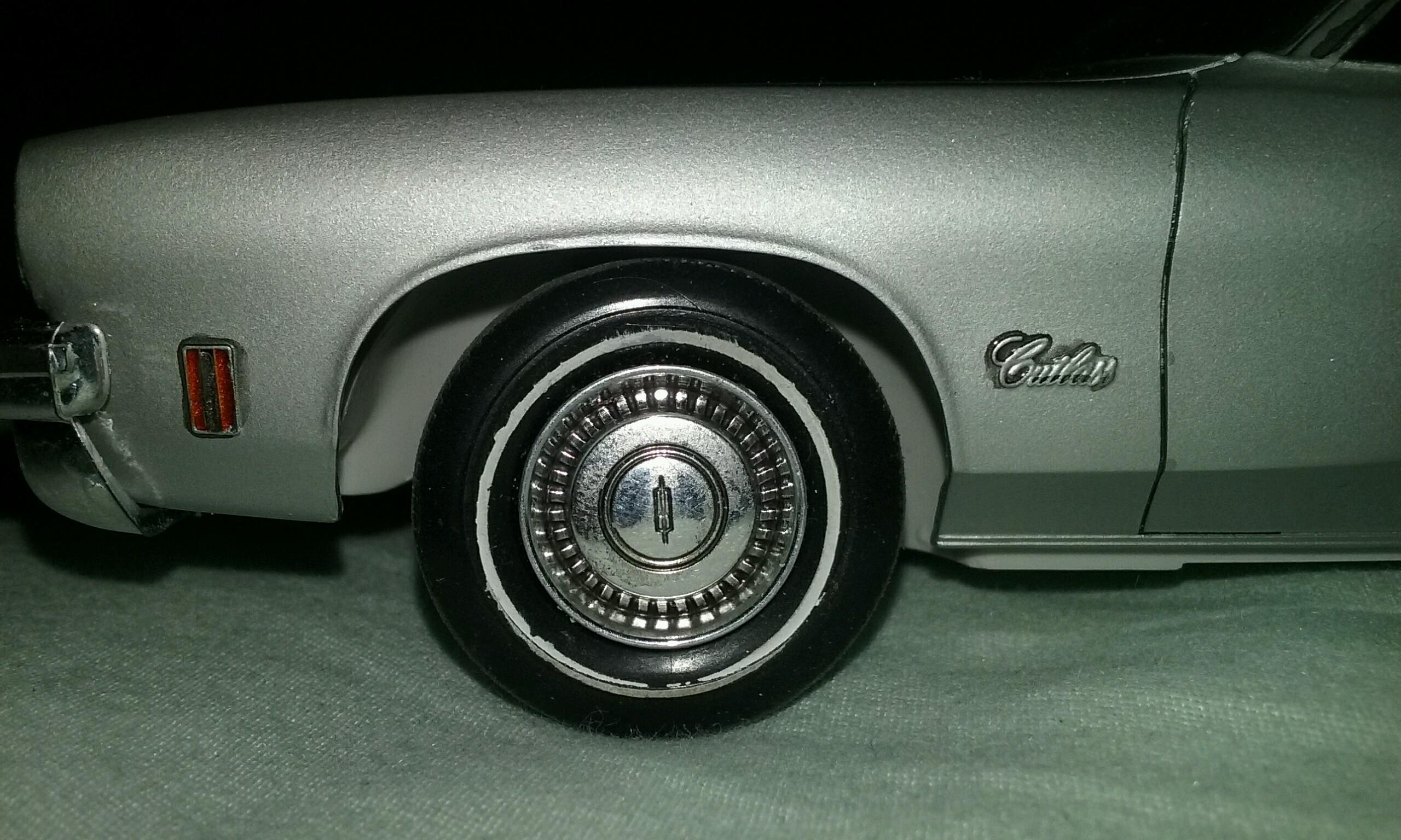

1972coronet Posted December 7, 2020 Posted December 7, 2020 (edited) Bought this as an unassembled promo . One of its prior owners took it apart (cleanly) , and started some body work ( separation marques on the quarters ; moulding dips on bonnet ) . It was originally a factory silver metallic , and I wanted to keep that theme . I rescribed the panel lines ; filled-in the "dents" on the bonnet ; then it was primer-sand-primer until the "dents" were feathered-out (Tamiya White Putty , followed by red oxide filler-primer on the bonnet only ; then Tamiya Light Grey Primer overall ). The colour coat is Tamiya Silver Leaf (aerosol) which was followed by Tamiya Pearl Clear Coat (aerosol) and finally Testors Enamel Gloss Coat (aerosol) . Perfect amount of gloss , close to factory finish . Molotow pen for the trim around the windscreen , backlight , quarter lights , and door trim . Tamiya Black Panel Line Accent was used on the wheel covers , panel lines , windscreen trim , backlight trim , and around the emblems and side marker lamp bezels ; grille , too . Tail lamp lenses were treated to Molotow (for reflective properties) . Bumpers' rub strips were simply scraped of their plating , as the bumpers were plated-over black plastic (perfect !) Headlamps were painted with a mix of Tamiya Clear Blue with Tamiya Gloss Clear ; Black Panel Line Accent was used to 'separate' them from their bezels . So , in other words , I tried some new 'tricks' with this bad boy . I still have to do some touch-ups here and there , but it's done ! Compliments and critiques welcomed . *** EDIT : ALL-BUT-ONE PHOTO DELETED --- SEE NEWLY-ADDED IMAGES IN RECENT POST .*** Edited December 8, 2020 by 1972coronet GARBAGE PHOTOS DELETED

RichCostello Posted December 7, 2020 Posted December 7, 2020 1 minute ago, 1972coronet said: What lights ? I was just kidding. It looks like you took your pictures in the dark.
1972coronet Posted December 7, 2020 Author Posted December 7, 2020 48 minutes ago, RichCostello said: I was just kidding. It looks like you took your pictures in the dark. Oh , okay ! Haha ! Believe it or not , there were two lights on in my (small) bedroom when I snapped those gripping photos ! My bedroom's on the northside of the apartment complex ; the Sun set at 16:50 , so there was no natural light available when I took the pics at 19:30 . Perhaps I'll get some A.M. photos in tomorrow (around 10:30 or so) .
espo Posted December 7, 2020 Posted December 7, 2020 I like your paint treatment on the Headlights, it's hard to get those solid plastic chromed things to look realistic. Suggestions. Maybe use some flat black inside the wheel wells, otherwise I think it looks great as is.
1972coronet Posted December 7, 2020 Author Posted December 7, 2020 4 hours ago, espo said: I like your paint treatment on the Headlights, it's hard to get those solid plastic chromed things to look realistic. Suggestions. Maybe use some flat black inside the wheel wells, otherwise I think it looks great as is. Thanks much ! I , too , was surprised by how well those headlamps came out . I didn't paint the interior nor the chassis , as I didn't want to deviate too far from the promo 'theme' . IF the interior or chassis had been painted or in need of repair , then I'd have done something with those components as well . I really wanted to paint the interior a nice cranberry red , but I didn't want to separate the dashboard from its fixed location . Thanks again !

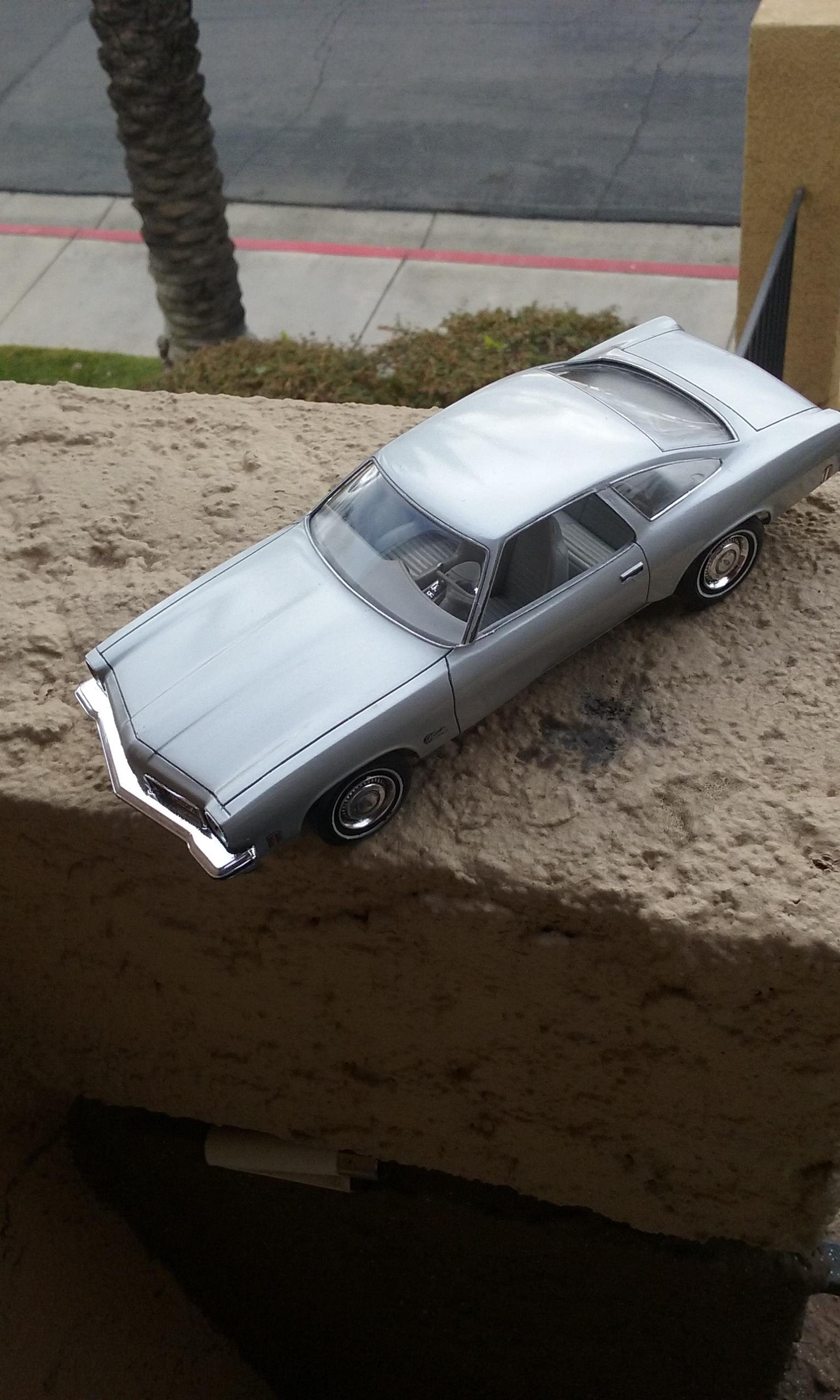

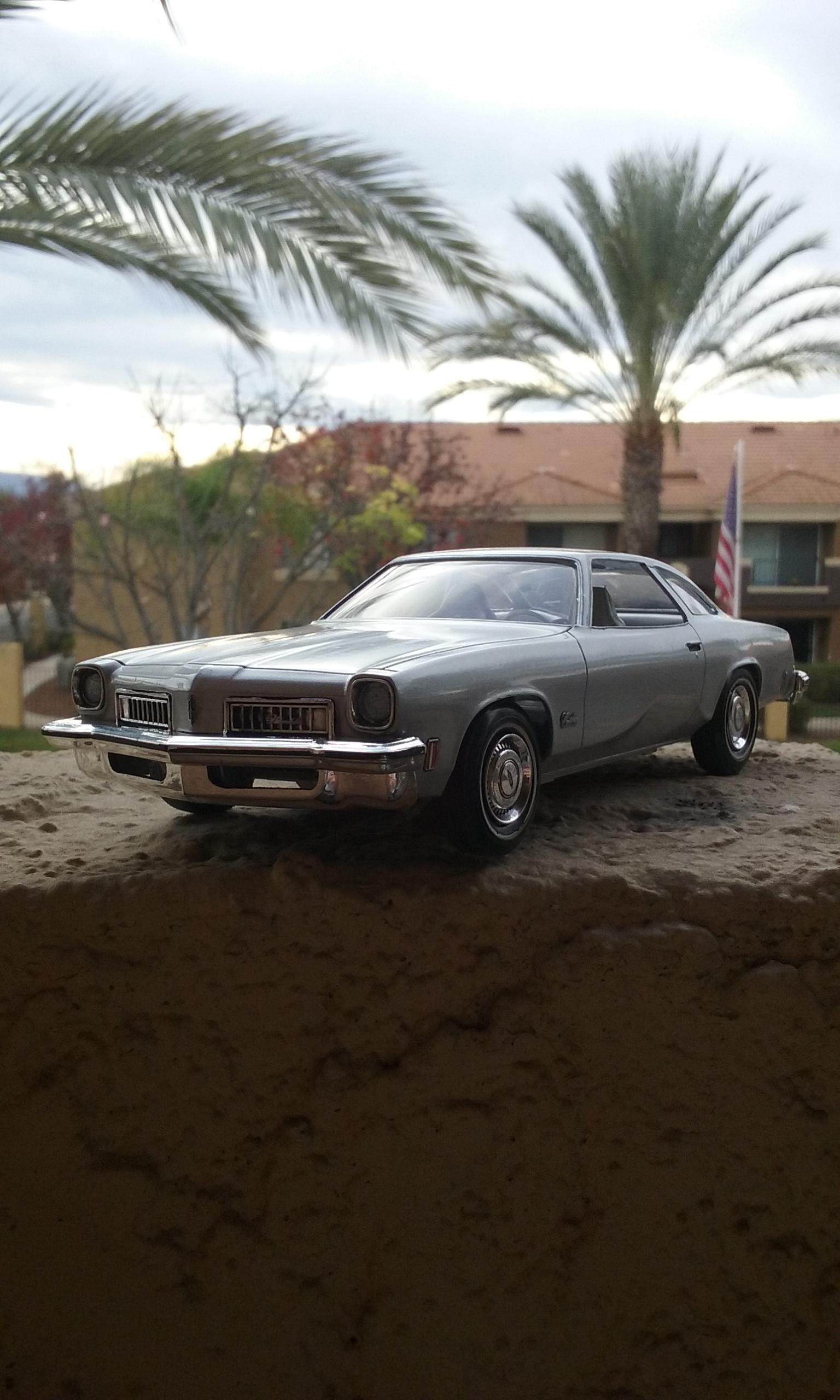

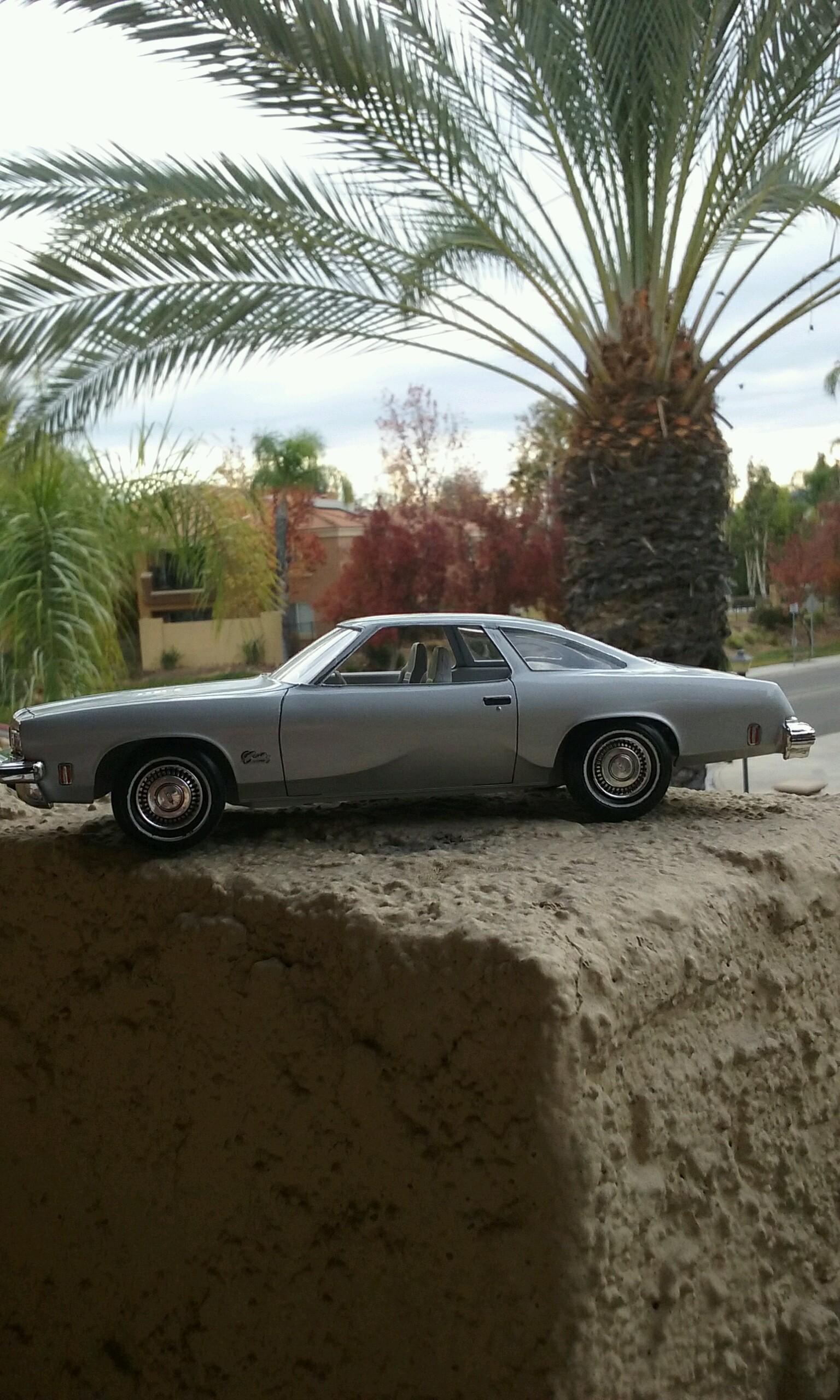

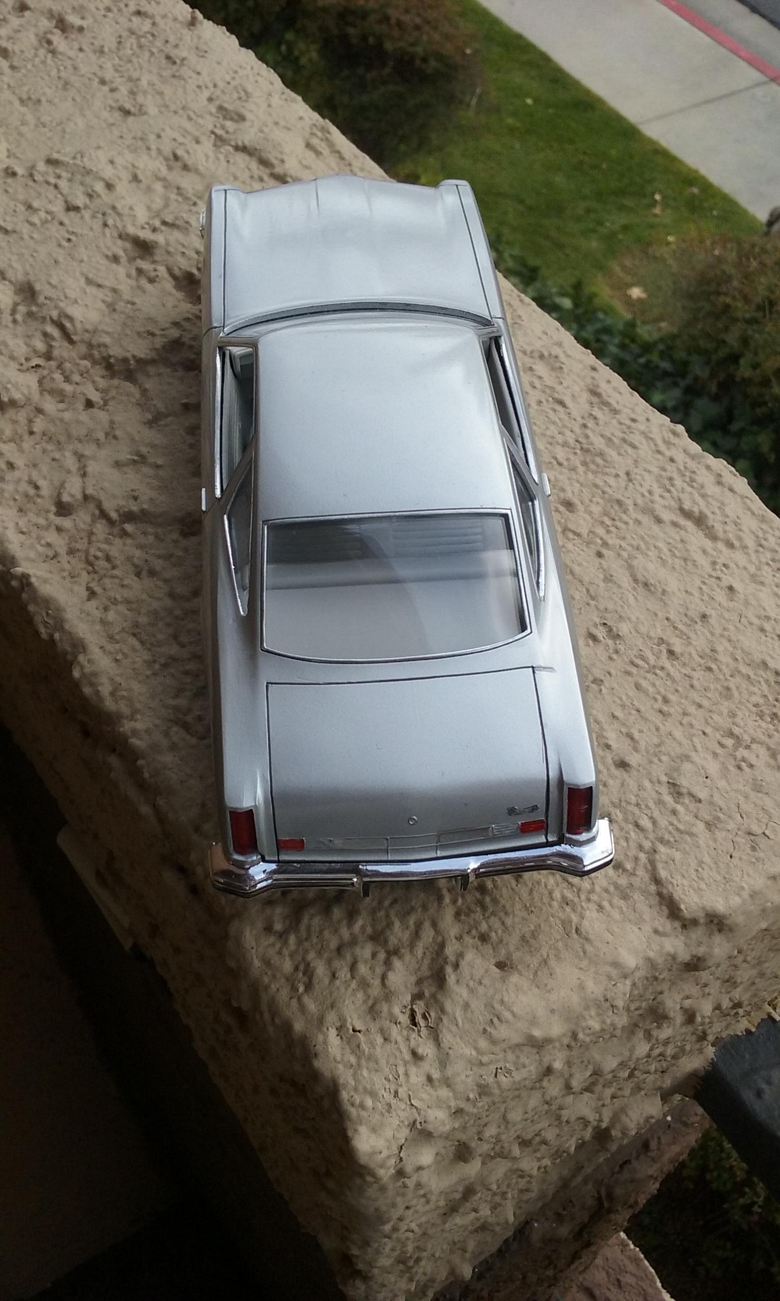

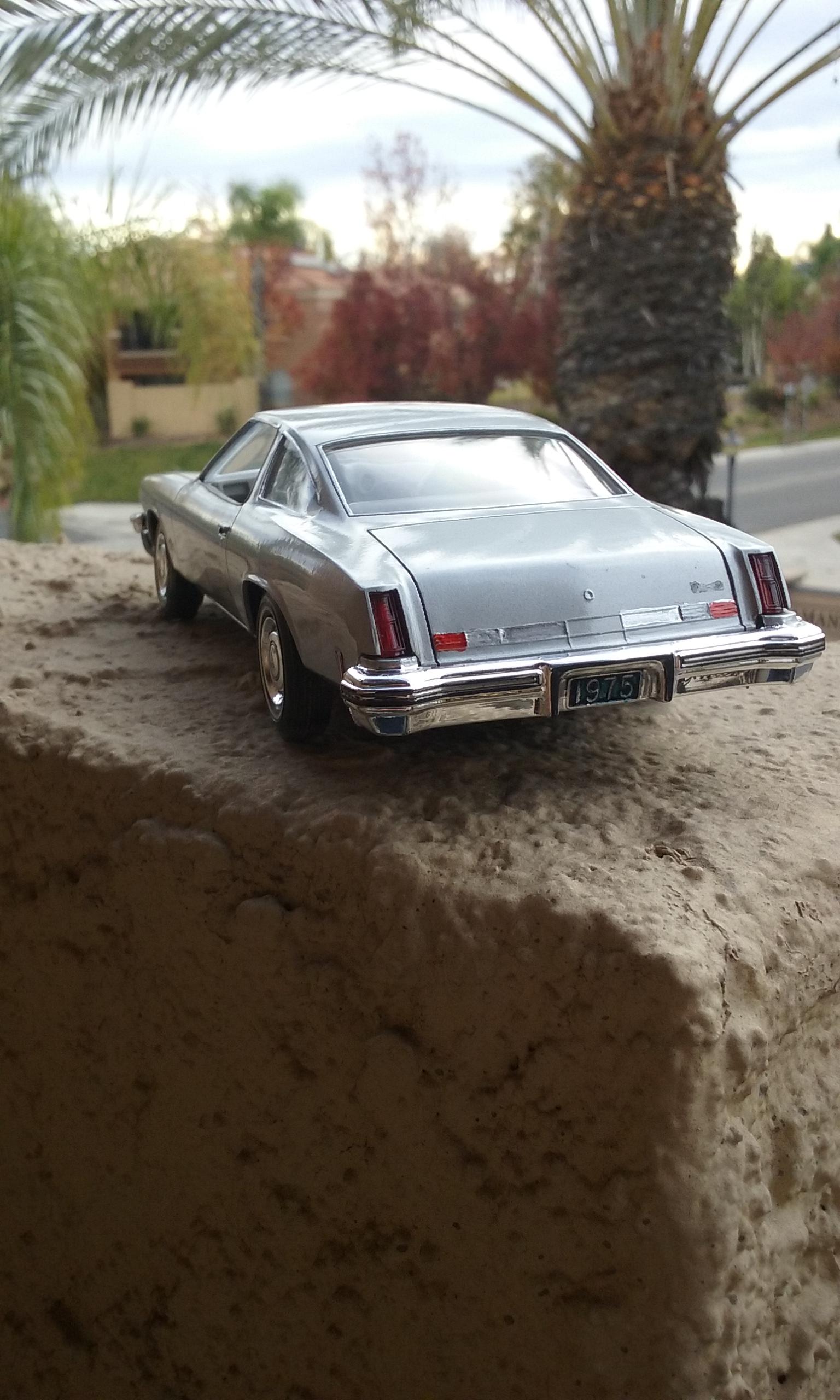

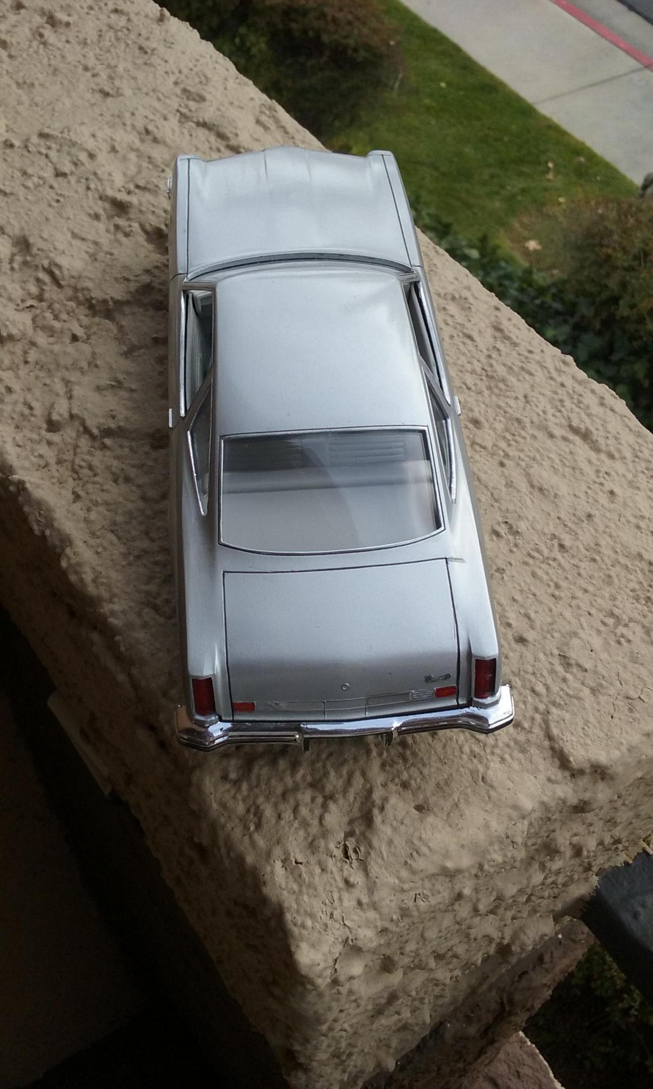

1972coronet Posted December 8, 2020 Author Posted December 8, 2020 New round of photos , much better than the 'Honeycomb Hideout' photos . No sunlight today in "always sunny" California , so no luck with the lighting ( I'm not well-heeled enough for some expensive setup like some of you folks have ) . Hopefully these new photos are satisfactory... if not , then I have no viable recourse . Enjoy ! P.S. : I again seek "cheers and jeers" for my efforts .
AMT68 Posted December 9, 2020 Posted December 9, 2020 (edited) Excellent detail job and a very smooth paint finish. The bumper chrome is extremely nice. I have a couple of the '75 Johan Cutlass kits and have toyed with the idea of creating a "Y76" model by partially blanking off the rear quarter windows. Just have to devise a plan to do so. Edited December 9, 2020 by AMT68
