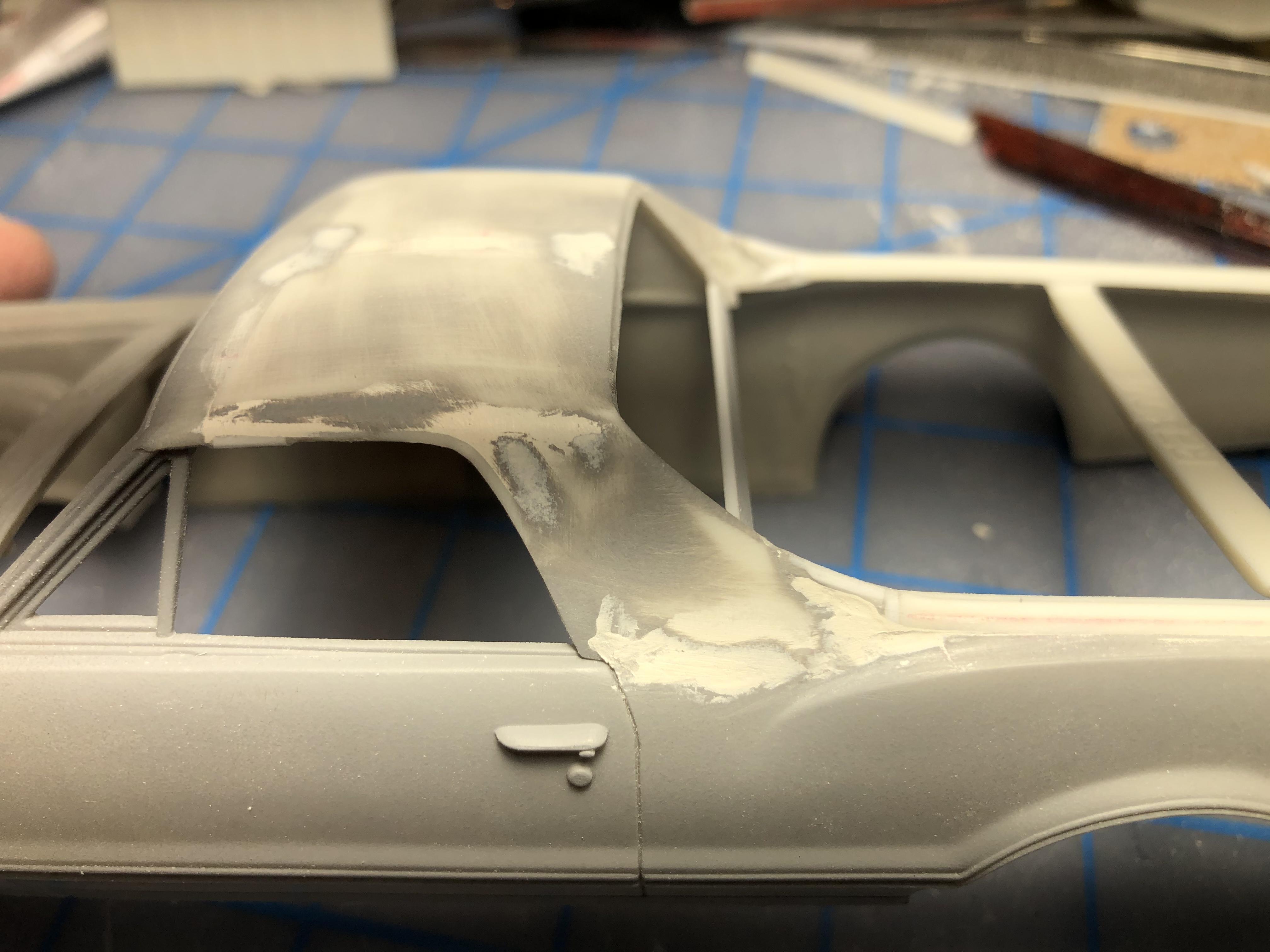

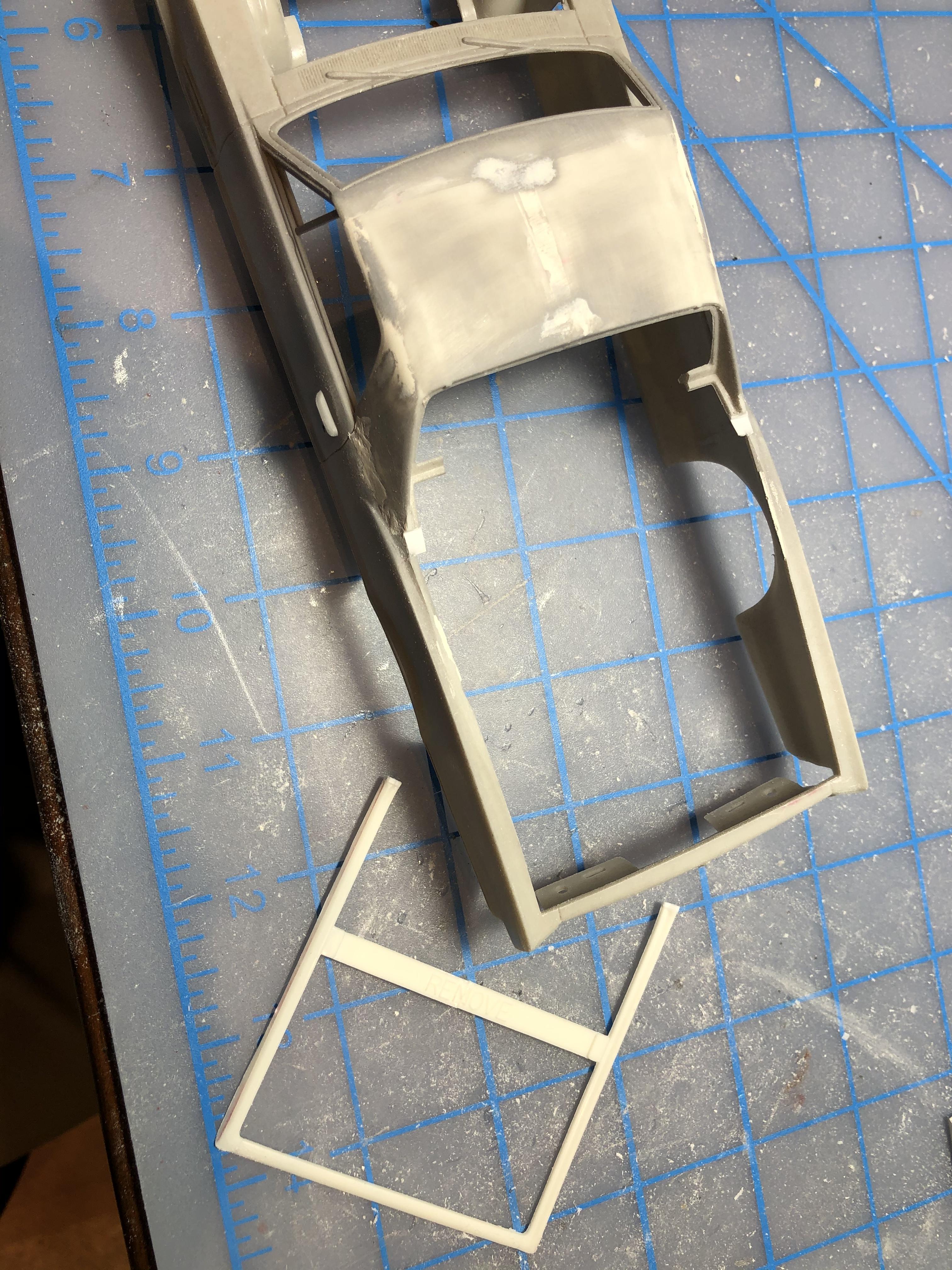

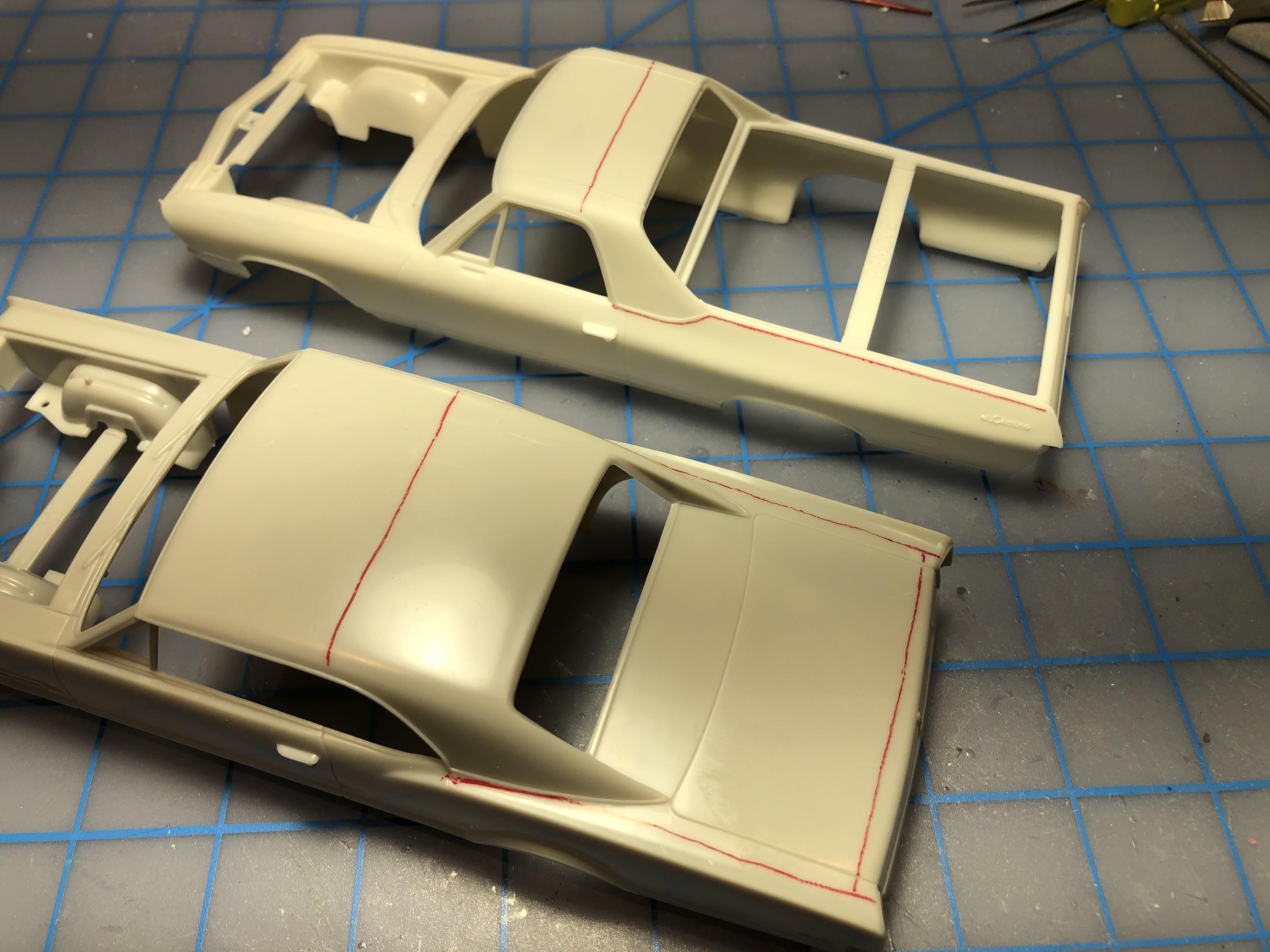

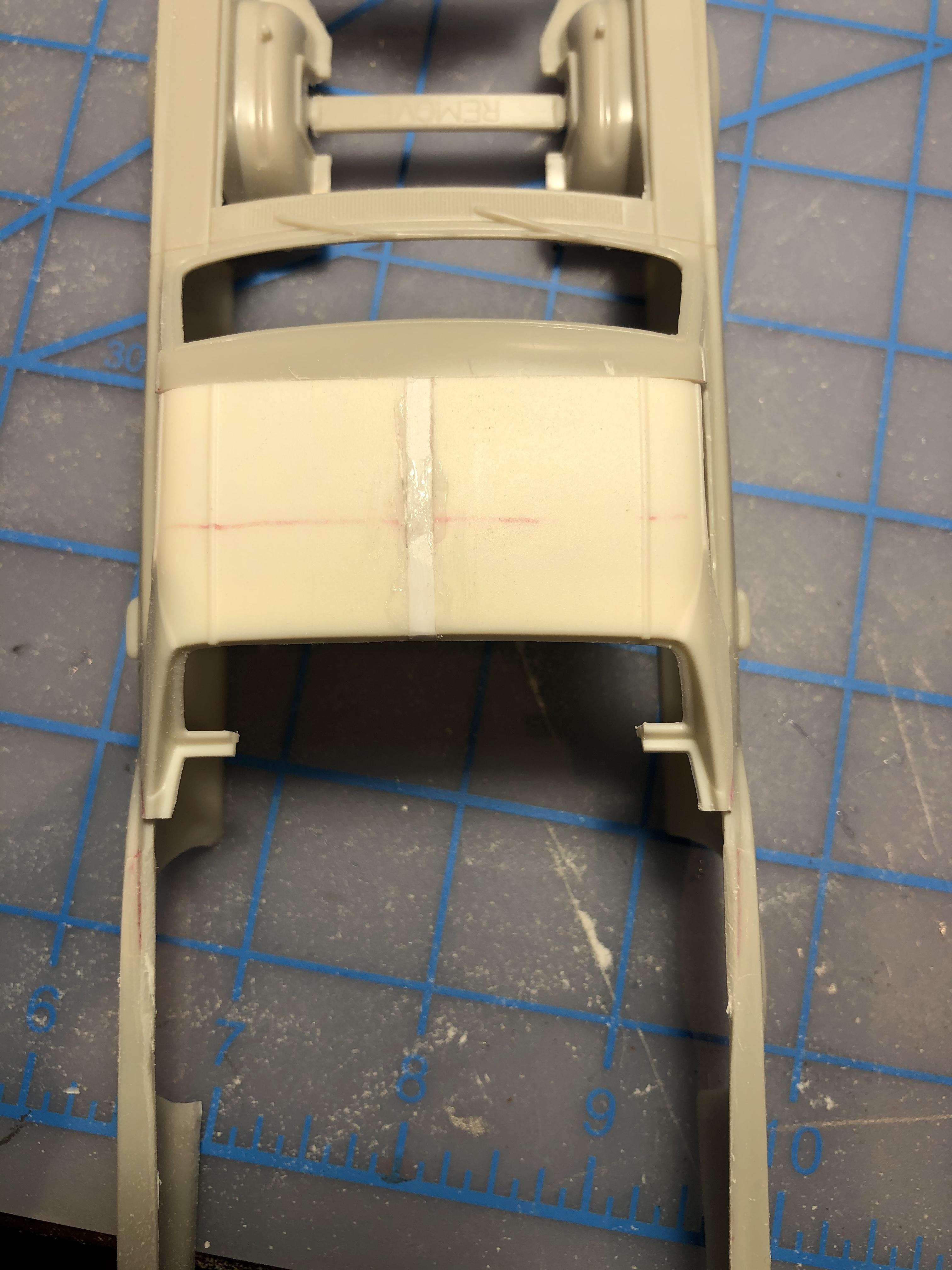

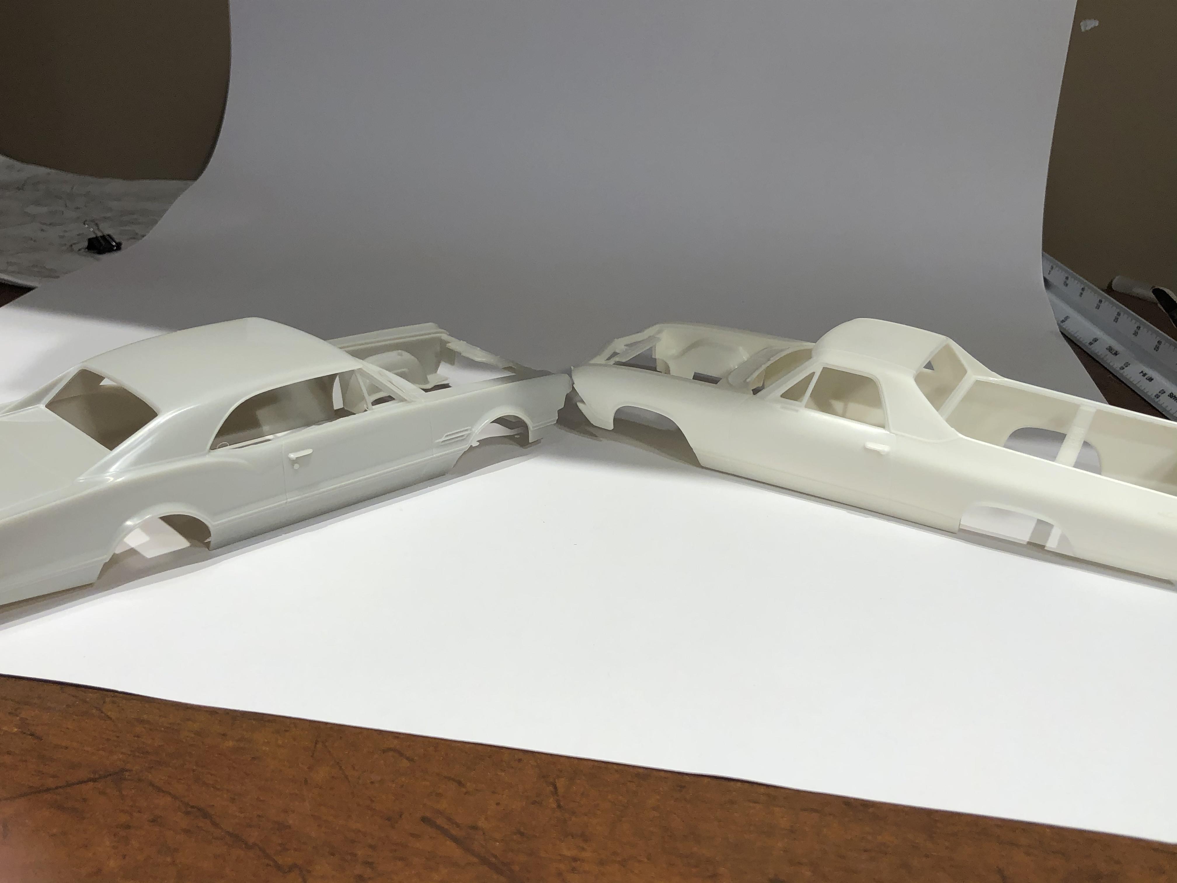

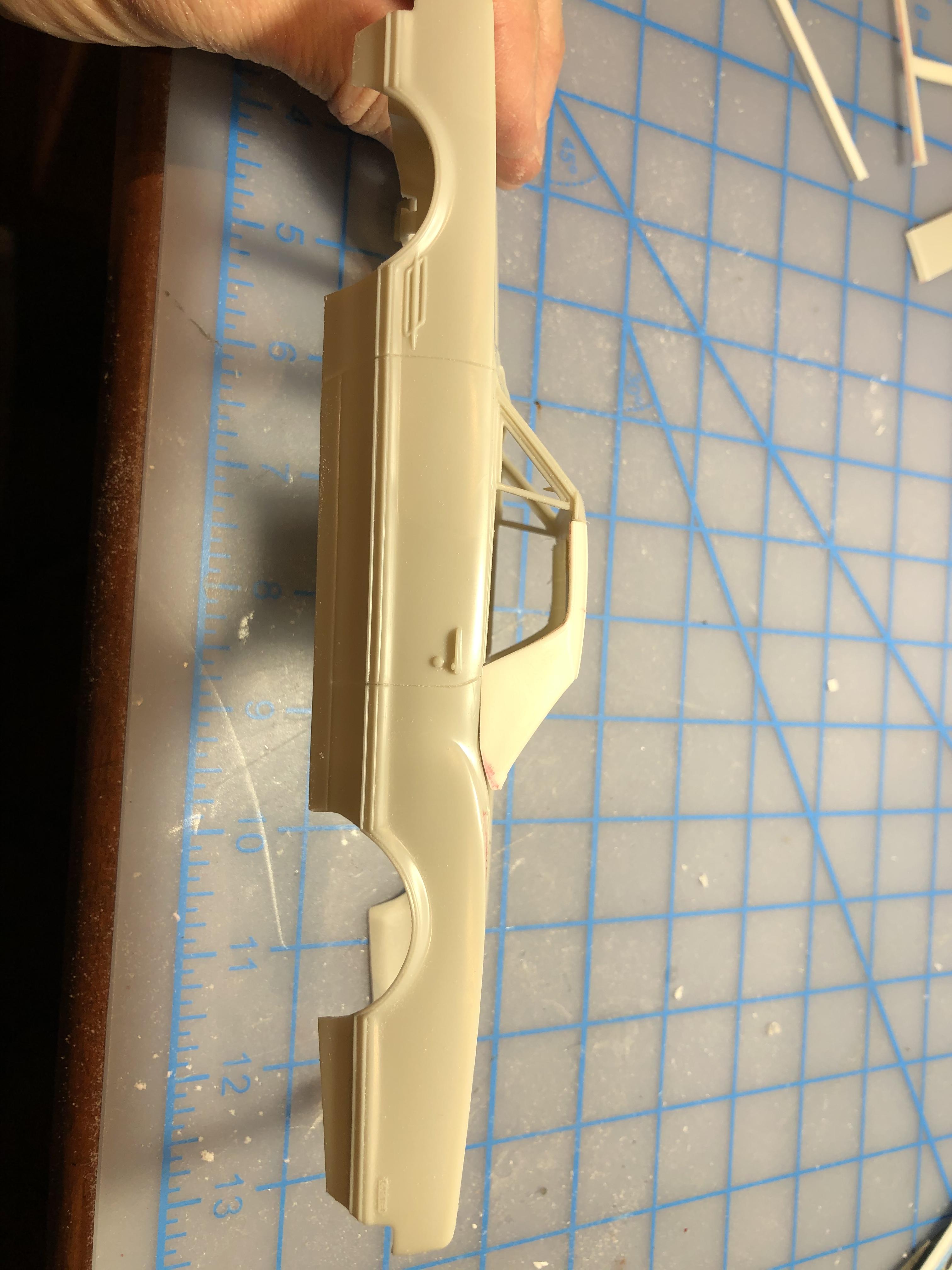

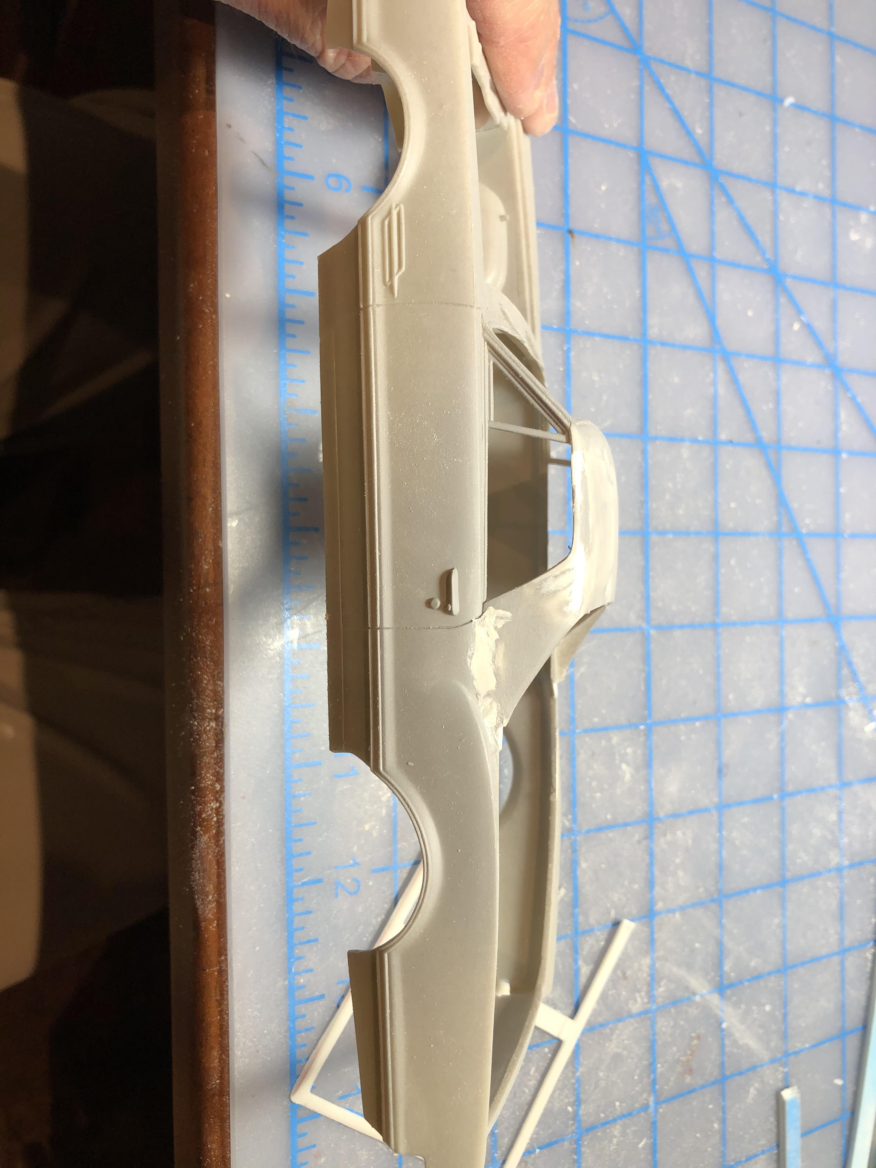

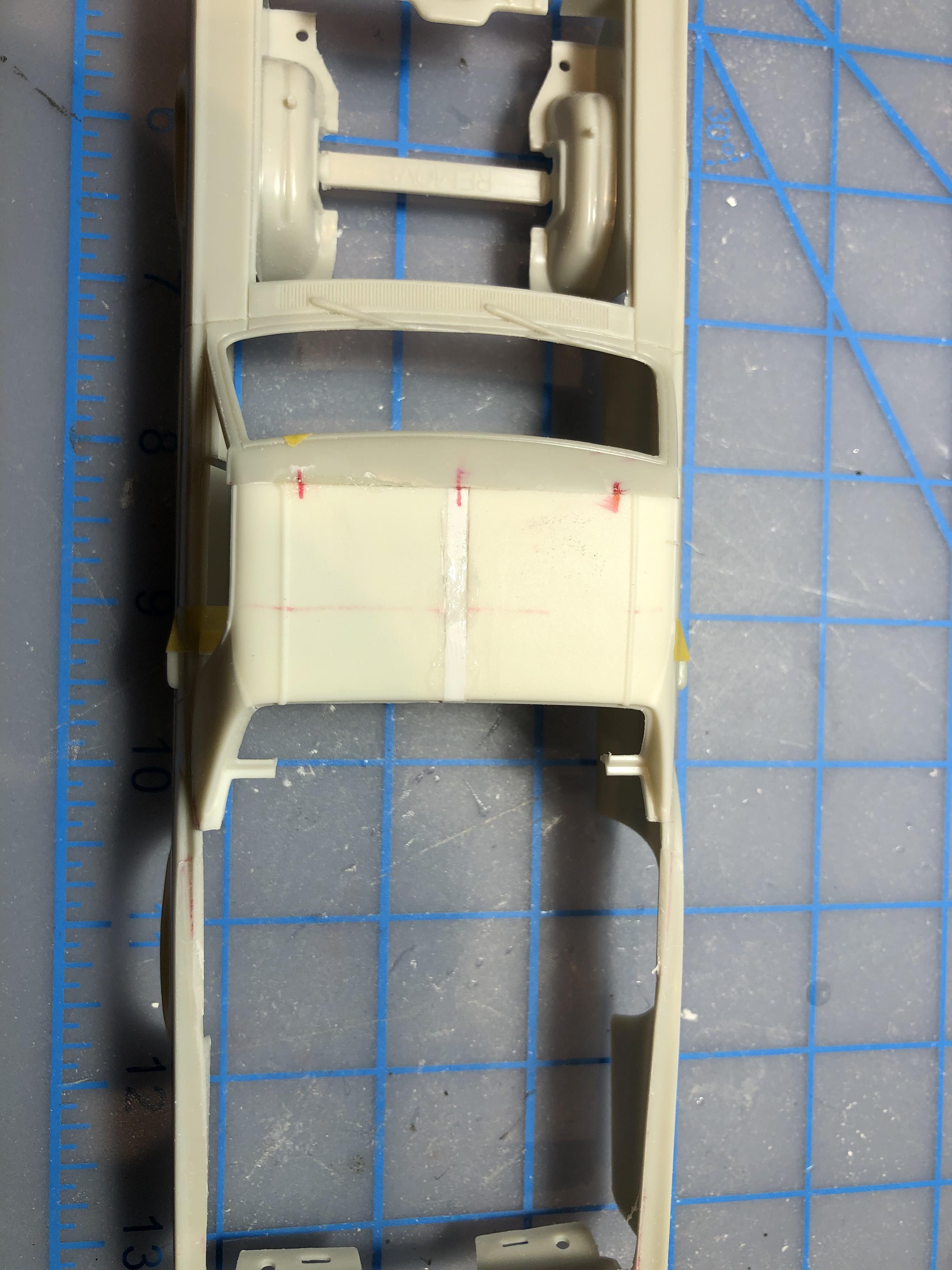

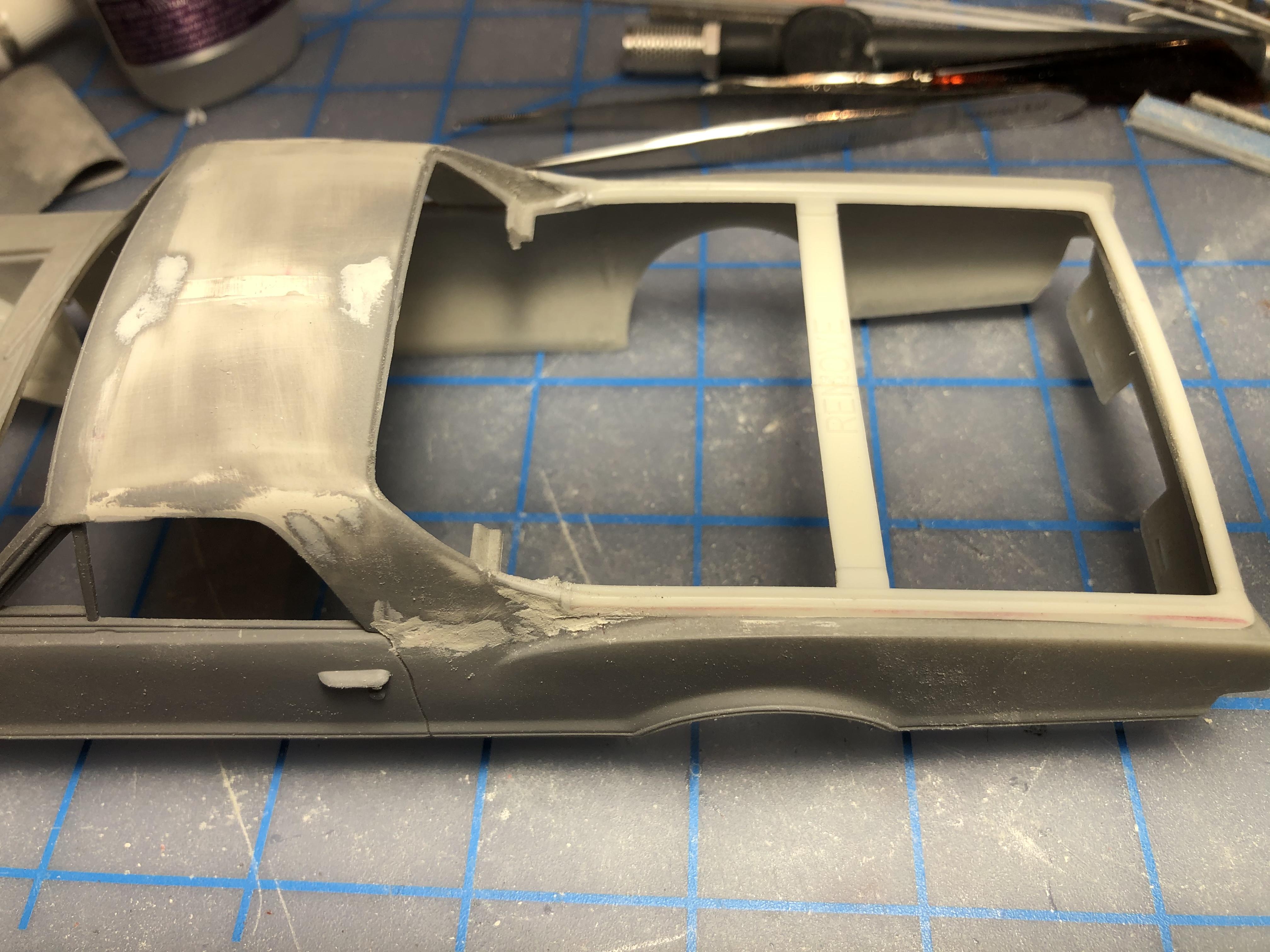

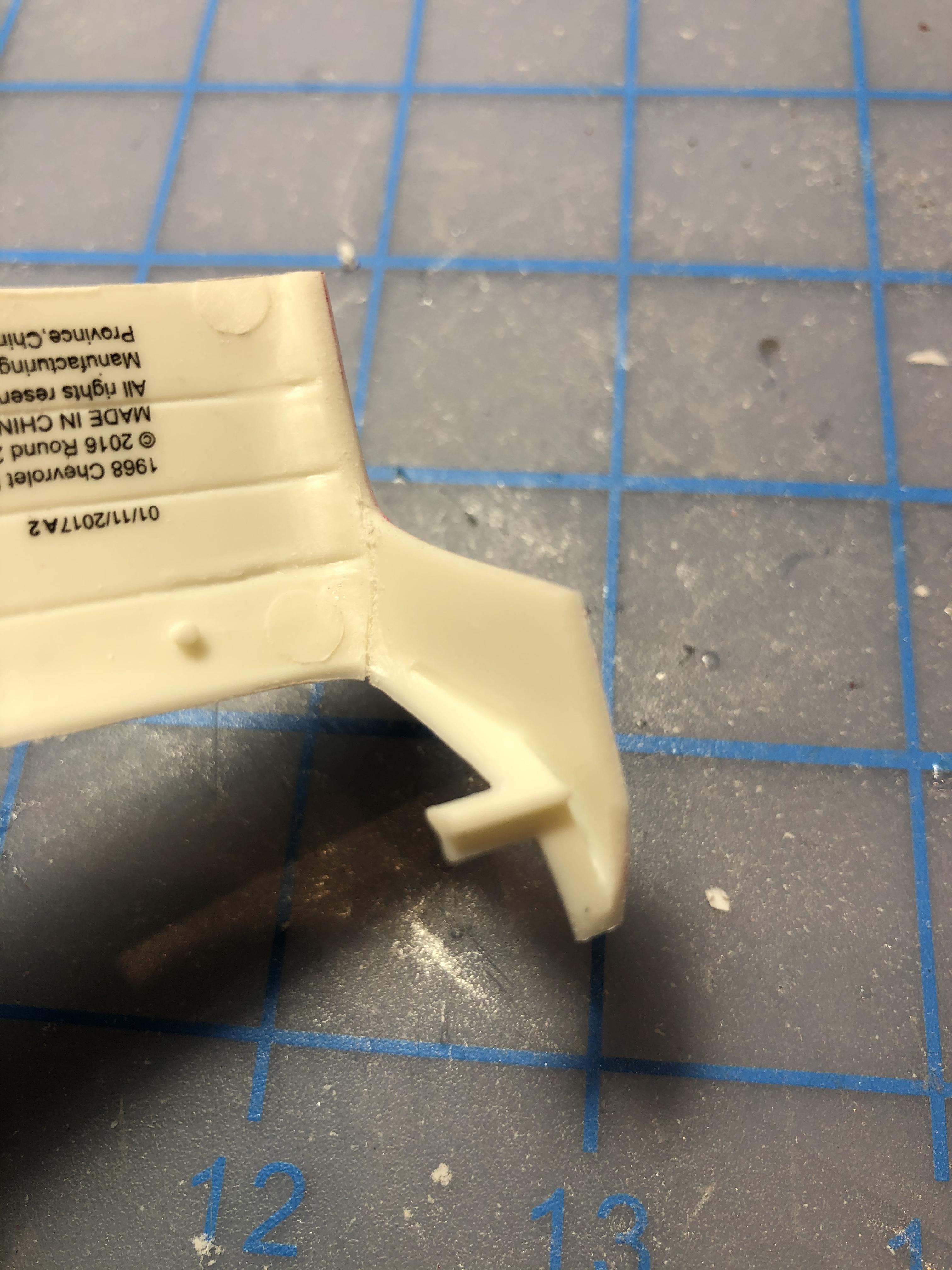

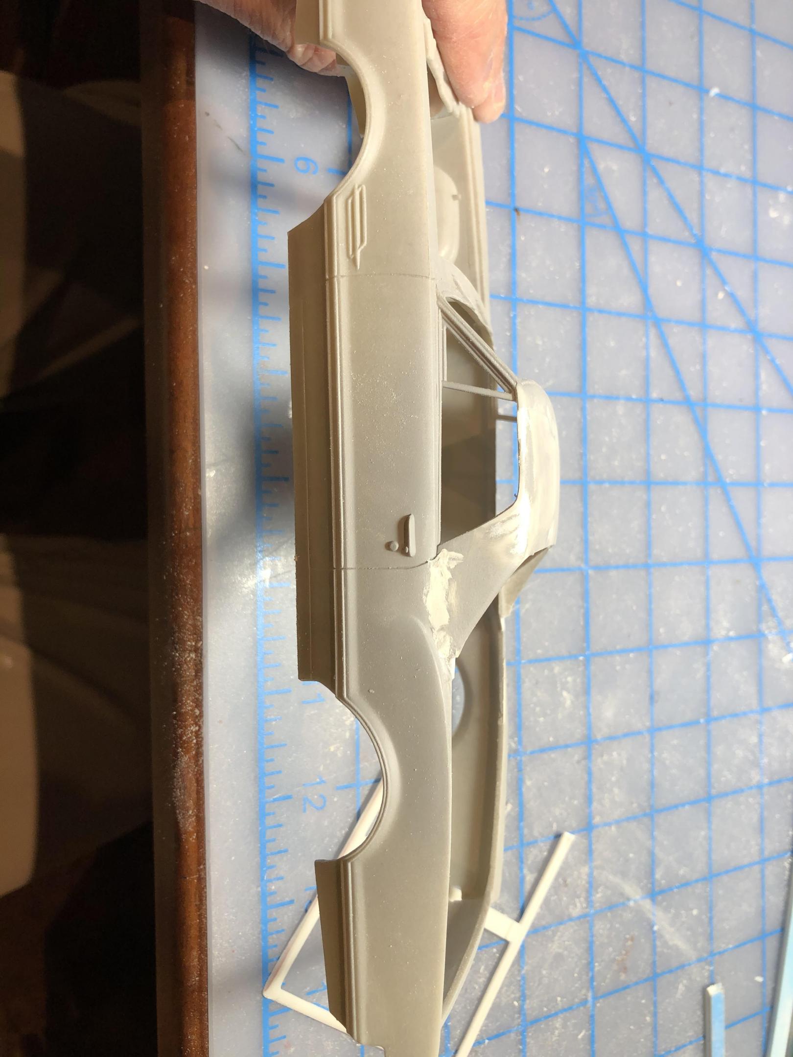

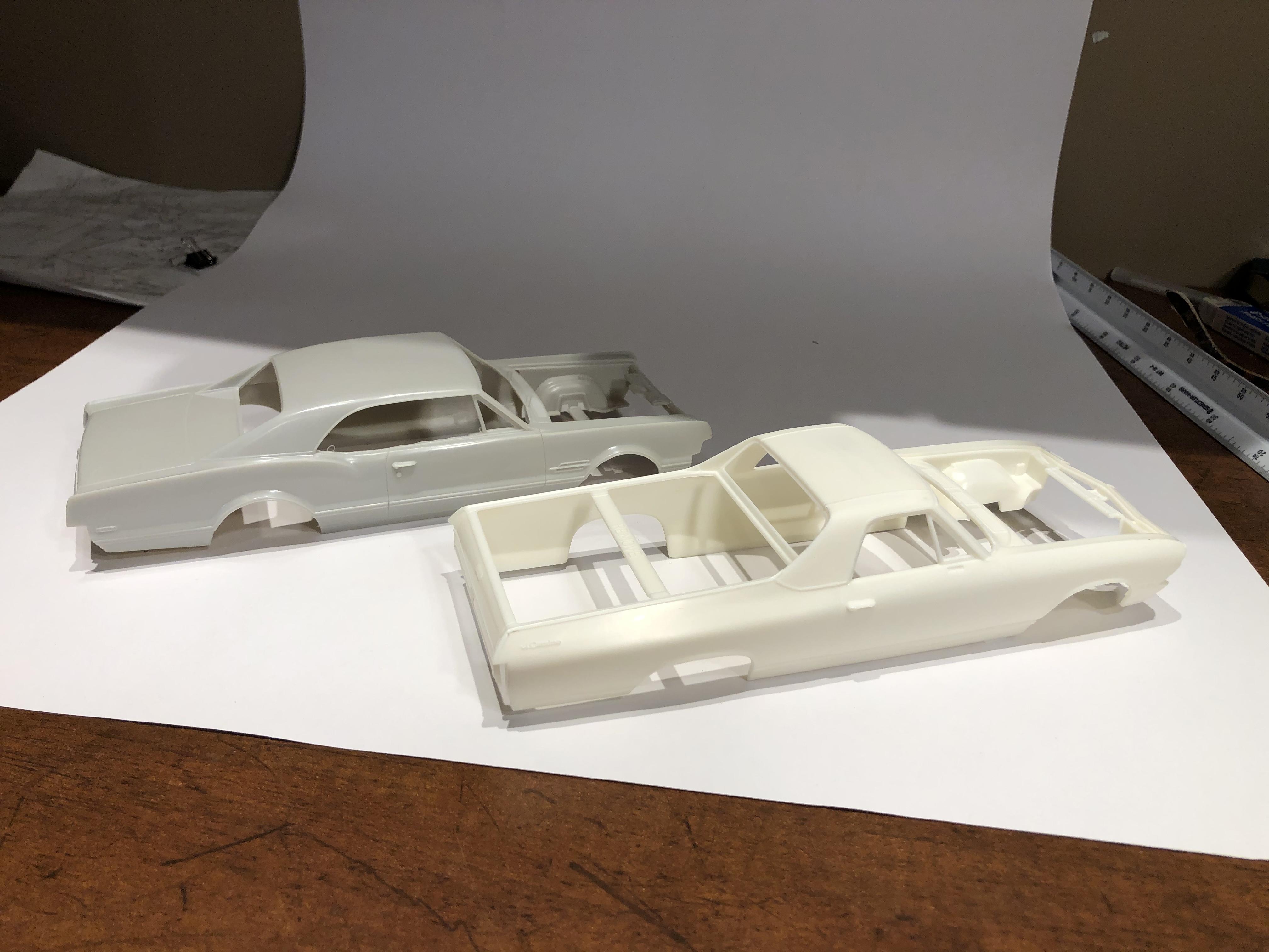

Steve H Posted December 25, 2020 Posted December 25, 2020 Hi all, and a very merry Christmas to you and your families. I have had this project rattling around my brain for several years now. I have always liked El Camino’s, but recently have really been into them. So the plan is to kit bash a ‘66 Olds 442 with a ‘68 El Camino. Most of the inspiration came from my own head, however there was a similar build on this forum a while back that really got me enthused. Sorry, I forget the builders name, I will dig it up again and thank him by name in a later post. It will be somewhere between resto mod and pro touring. I haven’t decided on the power plant yet, but big block for sure, 396...454...hmmmm Of course it will be low, that’s how I roll. For colour, probably a Teal similar to the factory colour available for the Olds 442. So, here we go.... I feel like the lines of the 442 are a natural for an El Camino conversion. I want the area below and behind the B pillar to be “fat”, to me that is an important part of the El Camino look. The roof of the ‘68 is about 2 1/2” too narrow at the top, but too wide at the bottom where it meets the body. So I added some styrene to widen top, cut some relief notches at top of B pillar to help narrow bottom. I also slightly stretched the body while attaching roof. I removed the top of the “bed” caps from the 68 as well, and attached those. I added a few small bits of styrene to blend the roof line to the bed. Again, I wanted this area to be on the fat side. Still some smoothing to do, but I am pleased with results so far. Now that roof is on, and blended to the body, it is a good looking Elky! Thanks for looking, and as always comments welcome. Cheers, Steve Quote

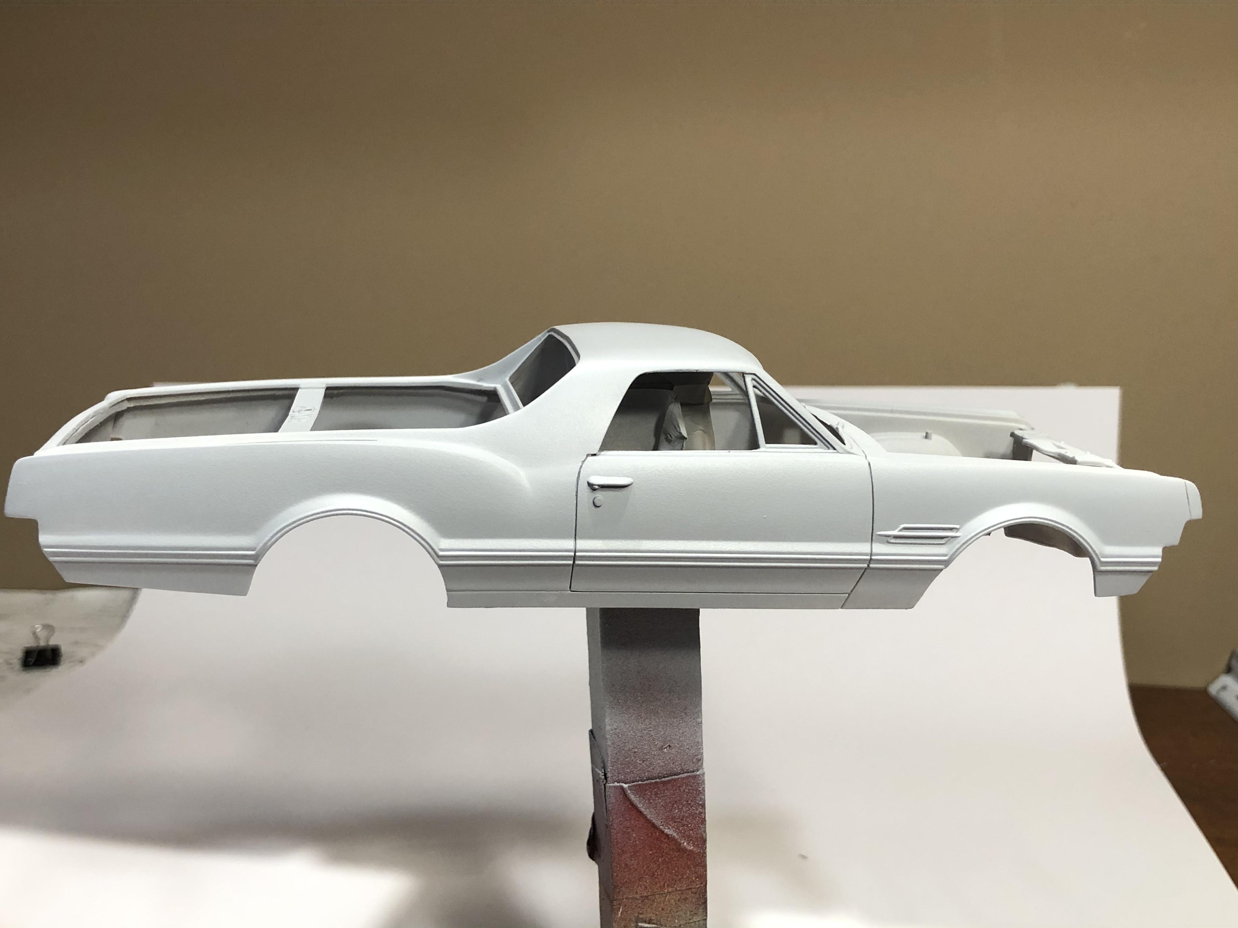

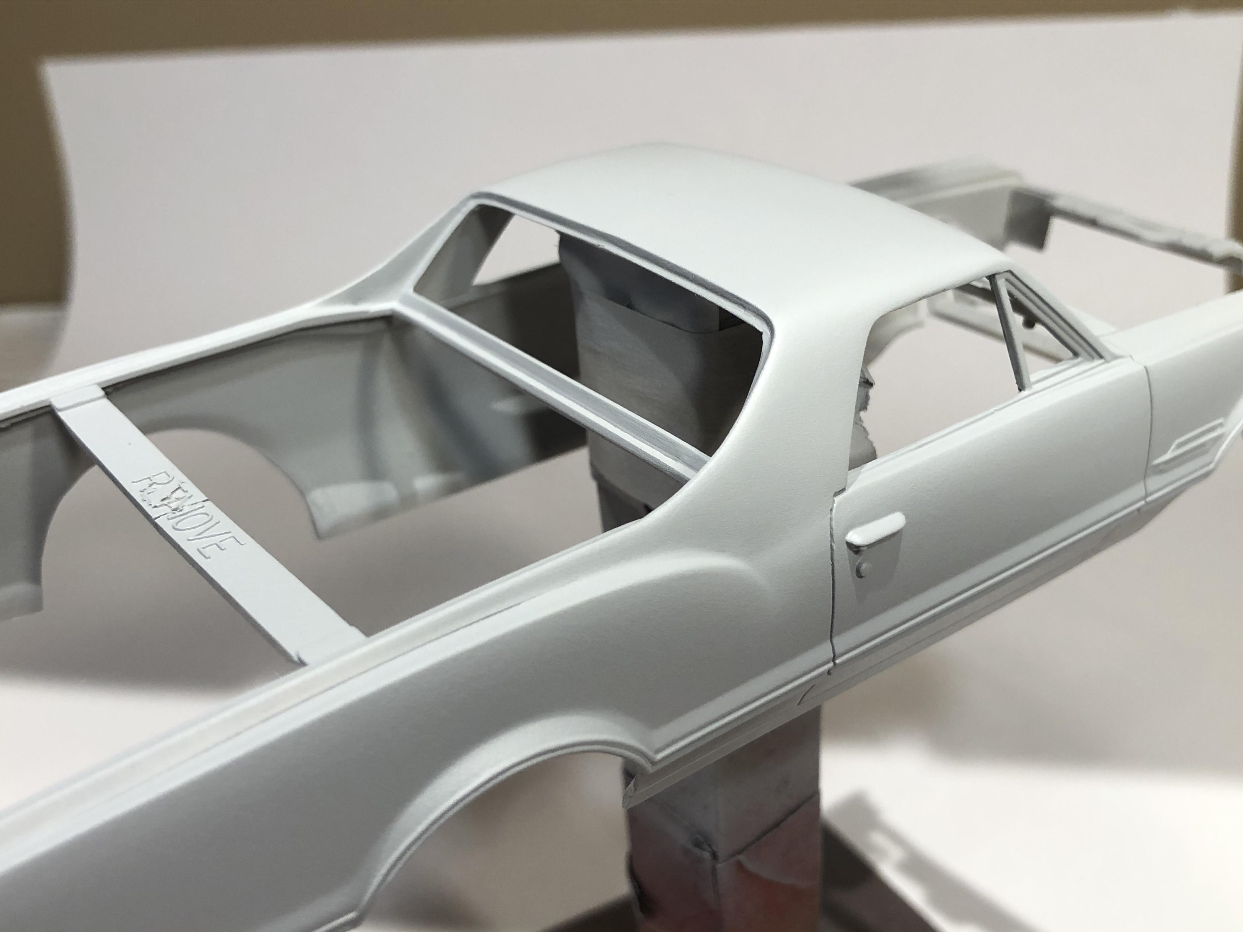

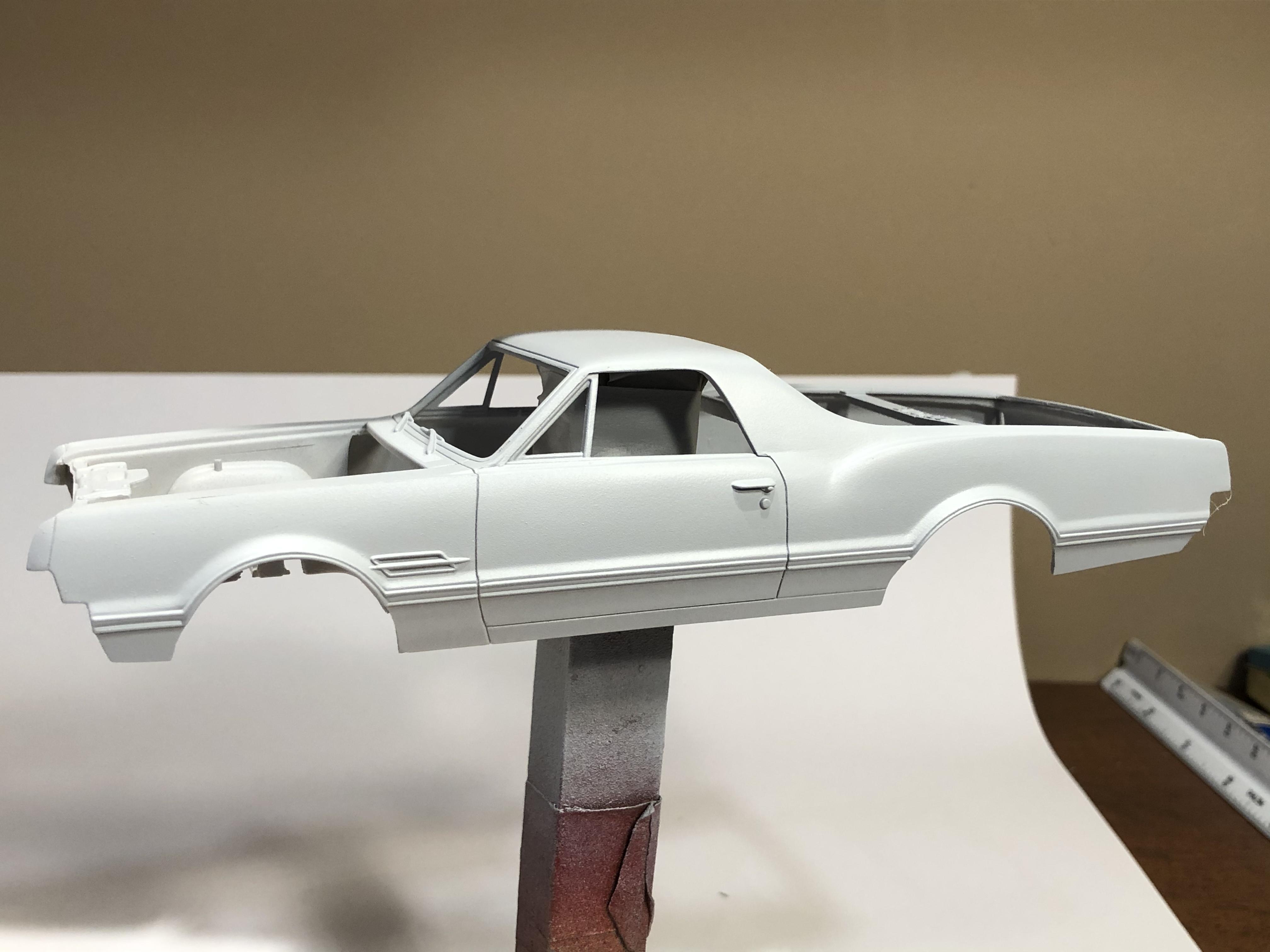

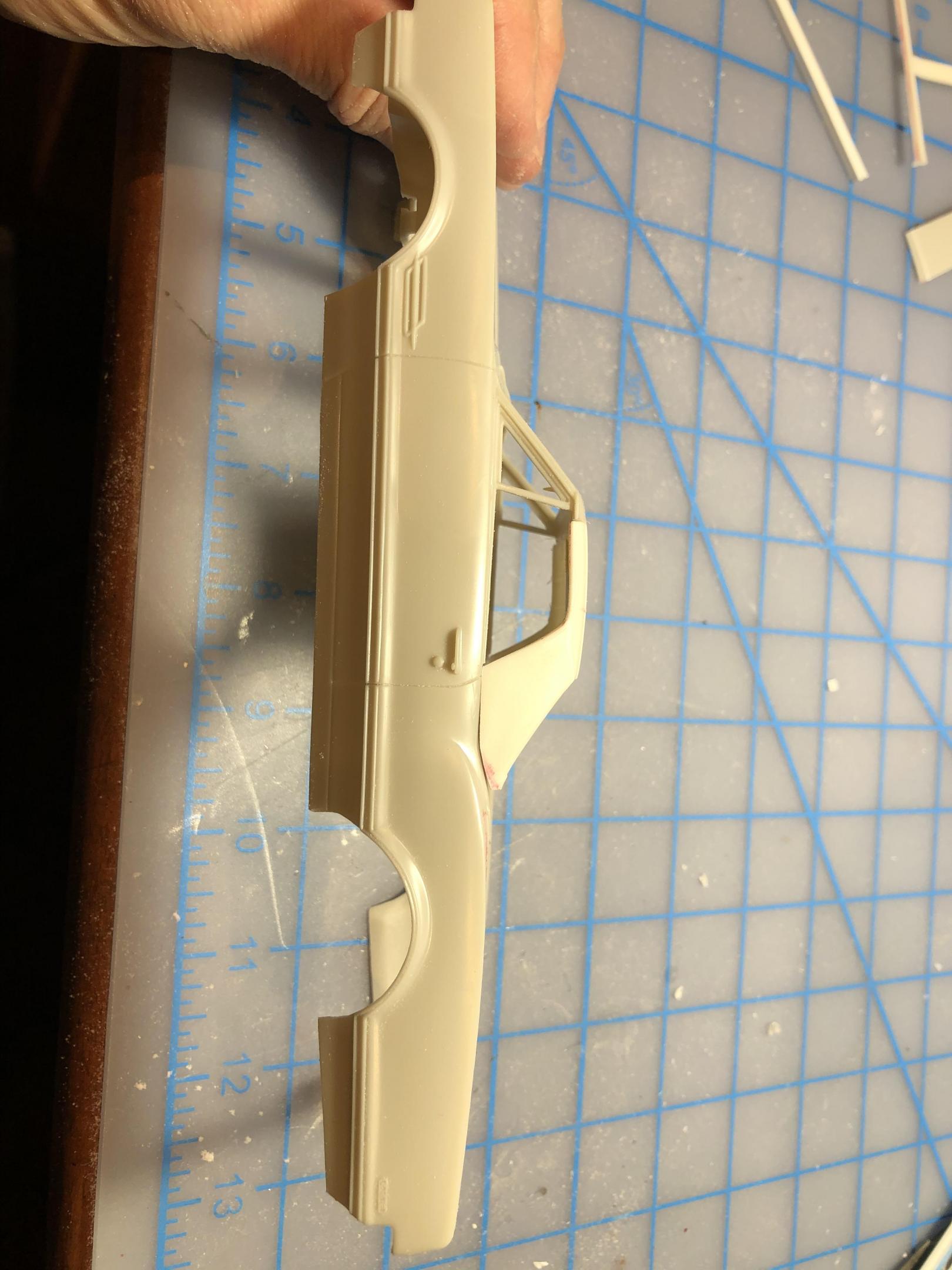

Steve H Posted December 26, 2020 Author Posted December 26, 2020 Quick update, since there was no family entertaining today, had some desk time. The bodywork around the B pillars is close. Very pleased with the overall look so far. I will start playing around with wheel choices and fitting the inside of the bed over the next few days. Still have some work to do on the “tailgate” too. I might even remove the support that says “remove” ? Hope everyone is enjoying their Christmas. Cheers, Steve Quote
Dr Cobra Posted December 26, 2020 Posted December 26, 2020 Very nice work so far, you might look into moving the rear wheel well back just a little or shortening the bed between the wheel wells and the tailgate. Going to be a cool ride !! Quote
Bills72sj Posted December 26, 2020 Posted December 26, 2020 1 hour ago, Dr Cobra said: Very nice work so far, you might look into moving the rear wheel well back just a little or shortening the bed between the wheel wells and the tailgate. Going to be a cool ride !! I agree. Visually the rear overhang it a bit too much. But since you obviously can do body work, you could probably pull it off. It is simply the question if you want to put forth the effort. Since the wheel arches are actually circular, you could cut them in such a way that you could swap them from side to side while maintaining the body line. Quote

Steve H Posted December 26, 2020 Author Posted December 26, 2020 17 hours ago, Dr Cobra said: Very nice work so far, you might look into moving the rear wheel well back just a little or shortening the bed between the wheel wells and the tailgate. Going to be a cool ride !! 16 hours ago, Bills72sj said: I agree. Visually the rear overhang it a bit too much. But since you obviously can do body work, you could probably pull it off. It is simply the question if you want to put forth the effort. Since the wheel arches are actually circular, you could cut them in such a way that you could swap them from side to side while maintaining the body line. Ok, you two trouble makers have got me thinking now.... I definitely don’t want to shorten the body, move the rear wheel openings back 2-4 scale inches. Hmmmm?? I will do some layout and play around with that. What’s a little more fill/sand/prime repeat. Thanks for the input! Quote
mchook Posted December 27, 2020 Posted December 27, 2020 I don't think it looks too bad myself. The Ranchero had a pretty long overhang. Quote
mchook Posted December 27, 2020 Posted December 27, 2020 I forgot to say, I love it, great job! Quote
Claude Thibodeau Posted December 27, 2020 Posted December 27, 2020 Hi Steve! Obviously, if you move the wheel opening back, by flipping the lower quarter-panels, you will also have to stretch the floor pan. As they say: any action creates a reaction... To my eye, having owned a 1/1 73 Ranchero, I can attest that the rear overhang in the quarters was substantial. Your mash-up looks just fine (OEM) to me! Just my two cents... CT CT Quote
