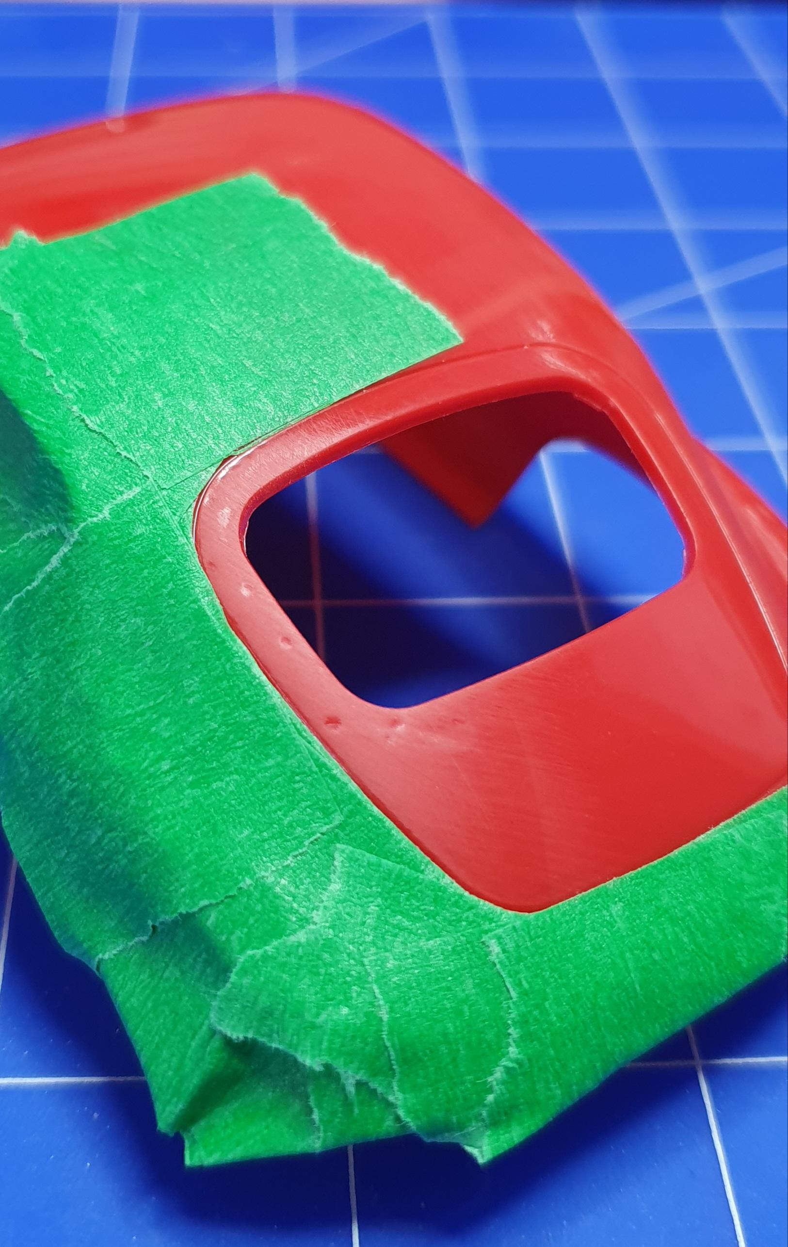

GeeBee Posted January 17, 2021 Author Posted January 17, 2021 (edited) One thing I noticed about the bodyshell was the small sink marks on the tailgate, didn't take too long to sort them out, while I was sorting them out I noticed more mould lines on the rear quarters that needed removing, after I'd got the sink holes sorted, I rescribed the panel lines. Edited January 18, 2021 by GeeBee

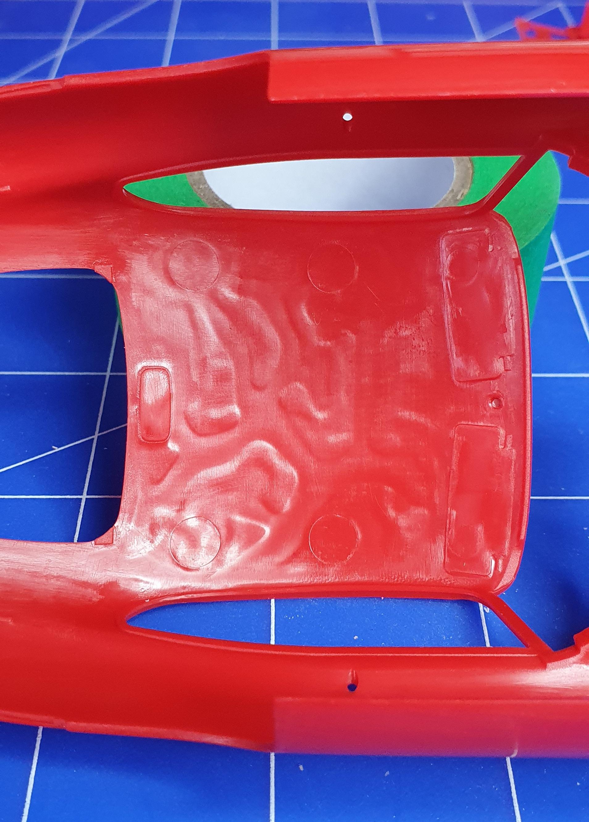

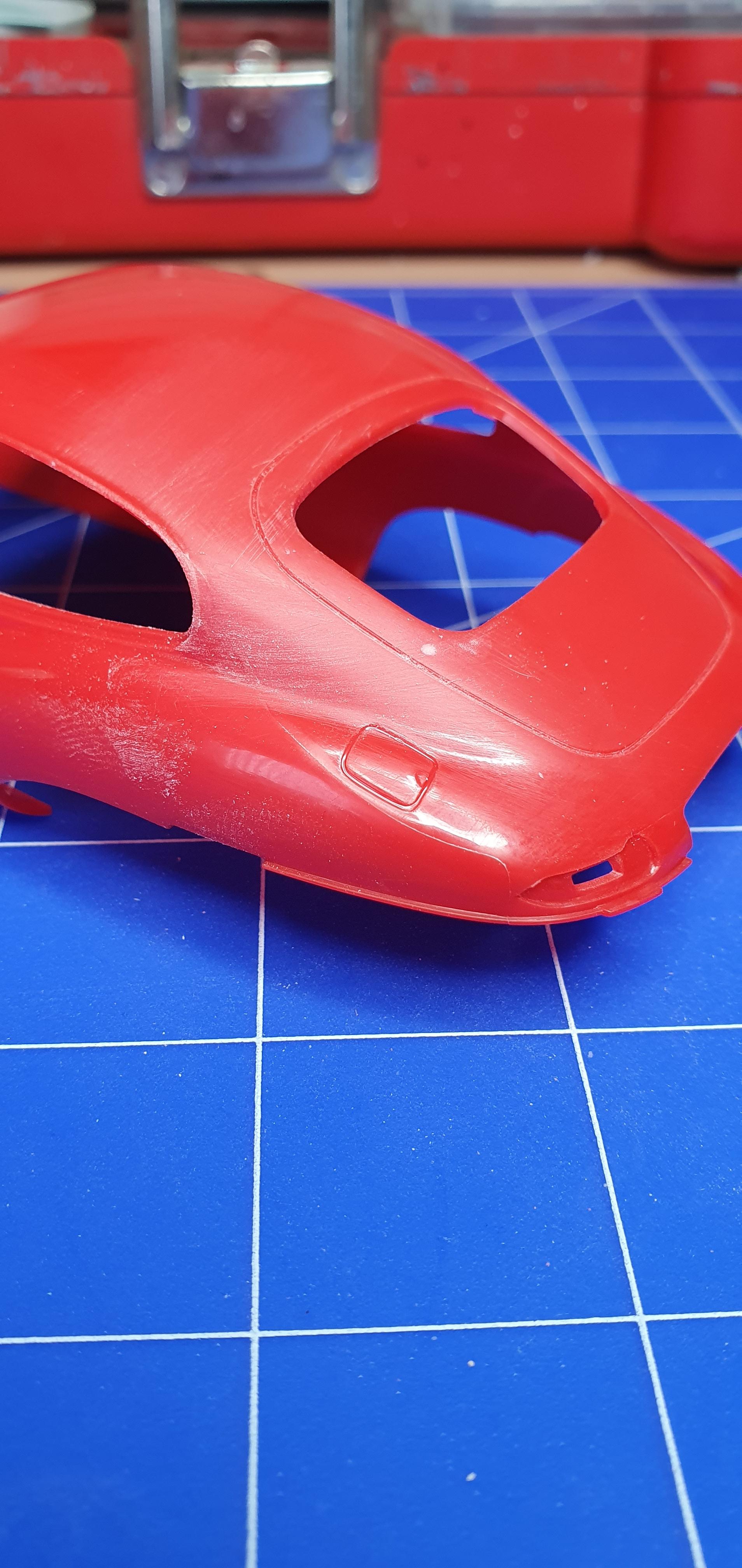

GeeBee Posted January 18, 2021 Author Posted January 18, 2021 Sink marks are also on both sides of the rear bodywork underneath where the bumpers go, didn't take long to sort, but these quality issues really shouldn't be on a brand new moulded kit, I'm not even going to try to sort out the inner roof lining.

GeeBee Posted January 19, 2021 Author Posted January 19, 2021 16 hours ago, dbostream said: The more I see of this kit the more disappointed I get. You are doing a great job though. I'm not sure if it's something to do with the red styrene, as a good friend of mine built this model from one of the pre-production models which was moulded in light grey styrene, and had non of the faults I'm finding, apart from some very fine mould lines. I've got 2 more of these kits in the stash, I opened them yesterday, and there both the same as this one.
espo Posted January 19, 2021 Posted January 19, 2021 3 hours ago, GeeBee said: I'm not sure if it's something to do with the red styrene, as a good friend of mine built this model from one of the pre-production models which was moulded in light grey styrene, and had non of the faults I'm finding, apart from some very fine mould lines. I've got 2 more of these kits in the stash, I opened them yesterday, and there both the same as this one. While you are doing an excellent job fixing the short comings of this kits body I wonder about the quality issues from Revell. Looking at the headliner it's as if there maybe a temperature problem when the plastic is being molded. This may also include the rear fender and hatch issues you have been working on.

GeeBee Posted January 19, 2021 Author Posted January 19, 2021 7 hours ago, espo said: While you are doing an excellent job fixing the short comings of this kits body I wonder about the quality issues from Revell. Looking at the headliner it's as if there maybe a temperature problem when the plastic is being molded. This may also include the rear fender and hatch issues you have been working on. Revell Germany made contact with me this morning, they are taking these problems very seriously, they want to send me some new parts, but as I explained to them, I have 2 other kits of this kit with the same issues, I'll update this post when I know what there solution is.
peteski Posted January 20, 2021 Posted January 20, 2021 On 1/18/2021 at 12:25 PM, GeeBee said: Sink marks are also on both sides of the rear bodywork underneath where the bumpers go, didn't take long to sort, but these quality issues really shouldn't be on a brand new moulded kit, I'm not even going to try to sort out the inner roof lining. That is a really weird moulding flaw!

GeeBee Posted February 8, 2021 Author Posted February 8, 2021 Received these this morning from Revell in Germany, these are parts left over from their pre-production mouldings before they started using the red styrene, not a sign of sink marks anywhere on these parts.
