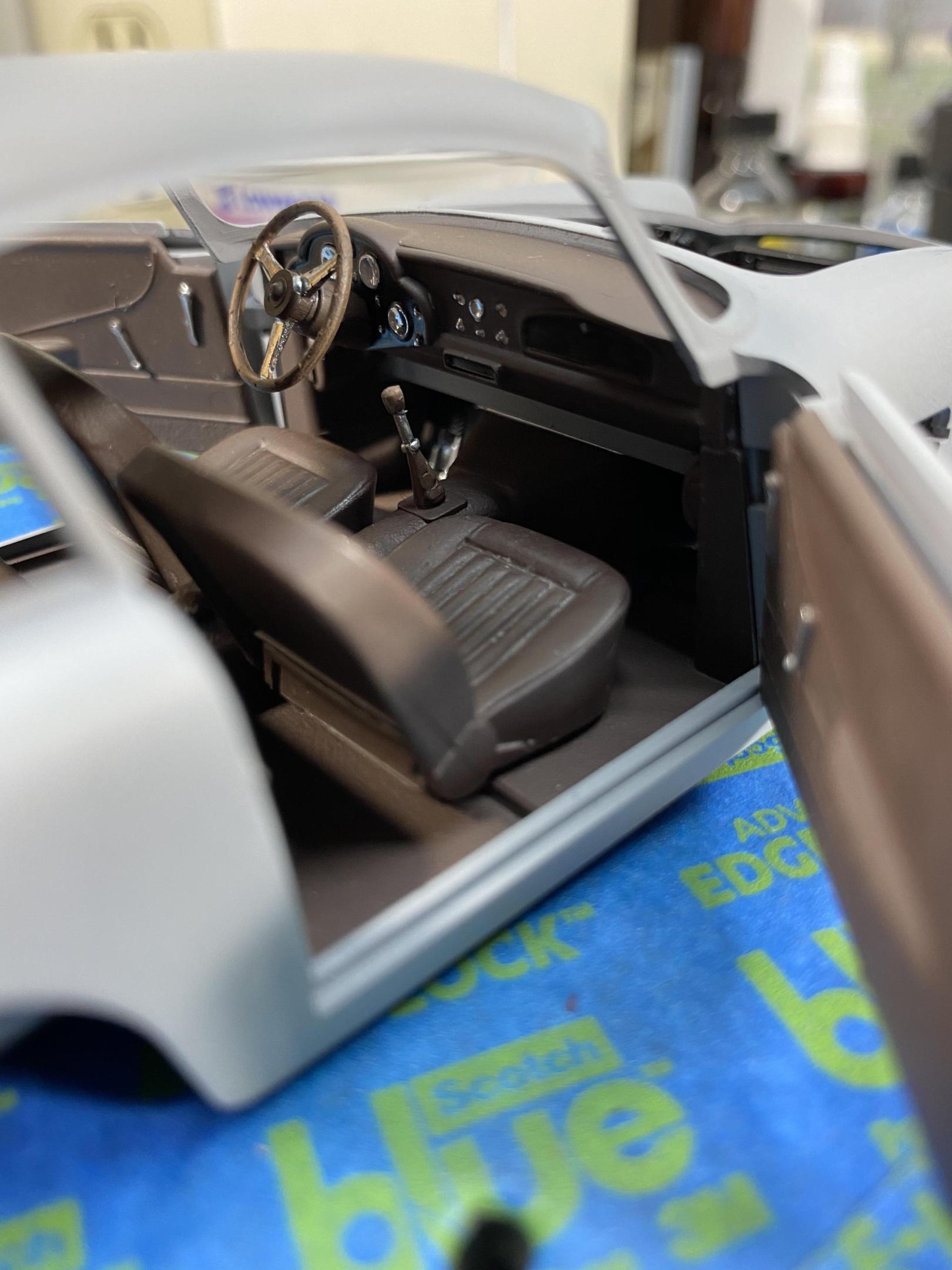

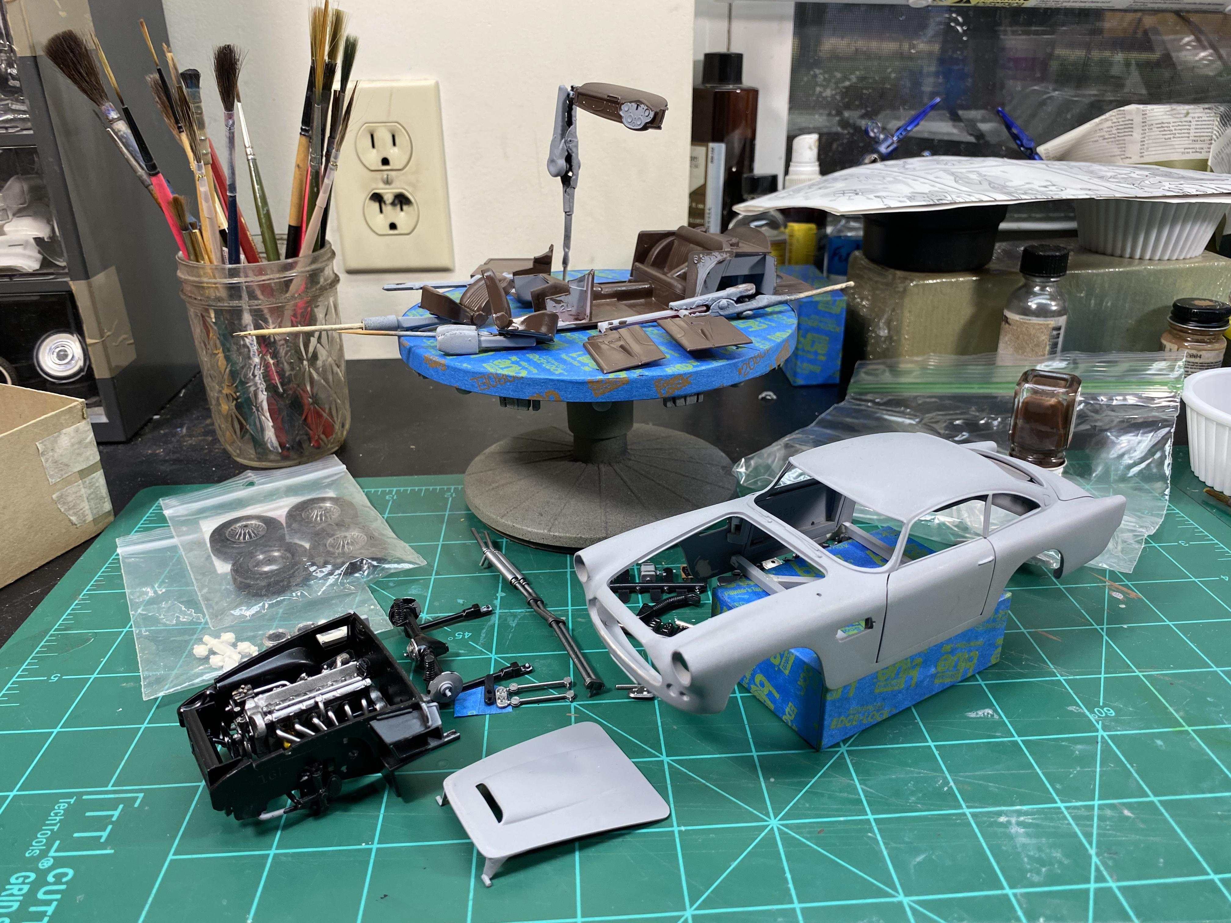

James2 Posted December 18, 2021 Author Posted December 18, 2021 While I wait for the tail lights on the Show Rod I figured this was next in line on “The Finish them all tour.” I finally settled on a suitable color for the interior which I hope represents a nice coco leather as it dries a flat finish. I finished priming the body and am ready to sand and paint it. Almost everything else is ready to assemble.

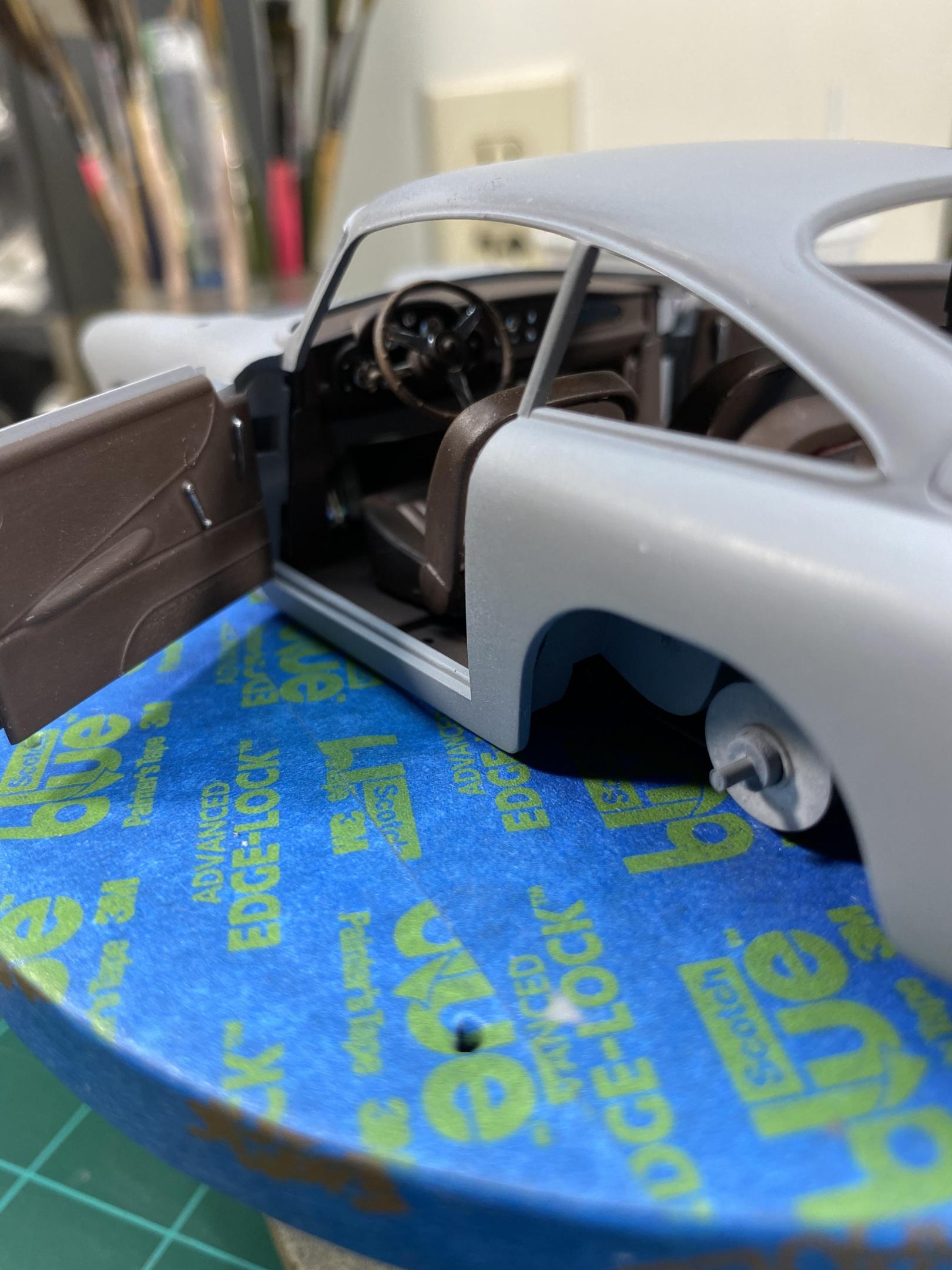

James2 Posted December 19, 2021 Author Posted December 19, 2021 Couple of quick interior pix. Here to hoping it all lines up for assembly. 1

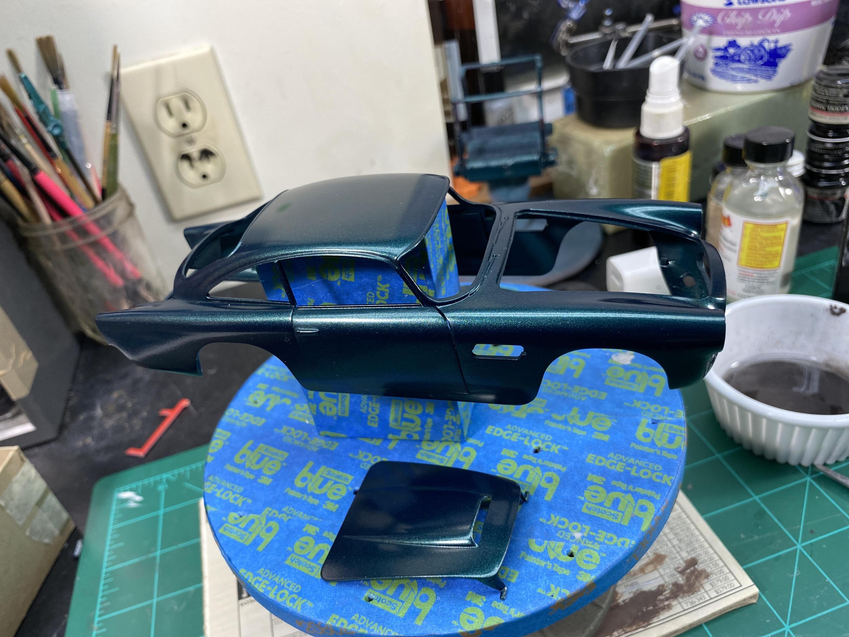

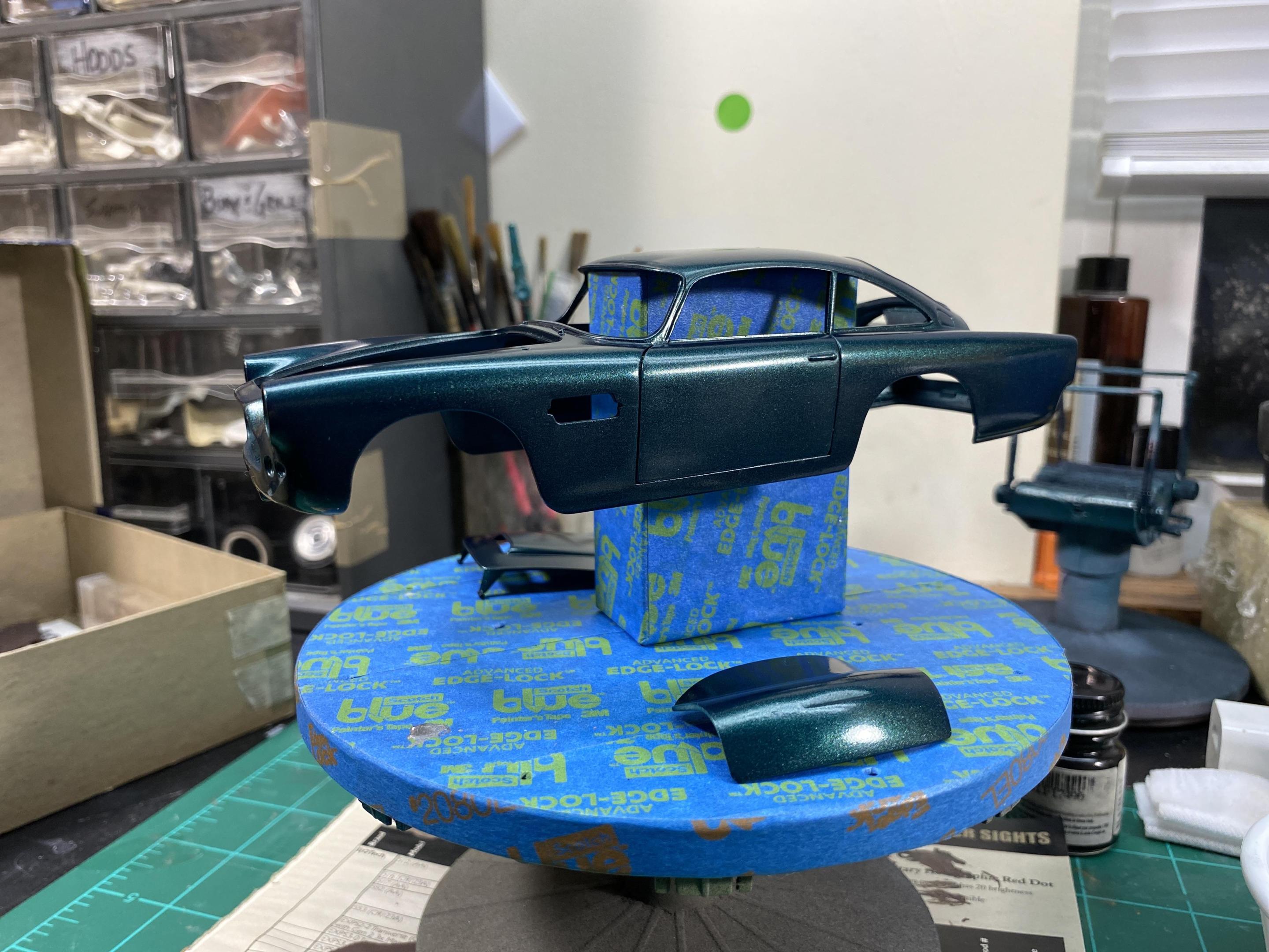

James2 Posted December 22, 2021 Author Posted December 22, 2021 Classic Green Pearl sprayed yesterday.
